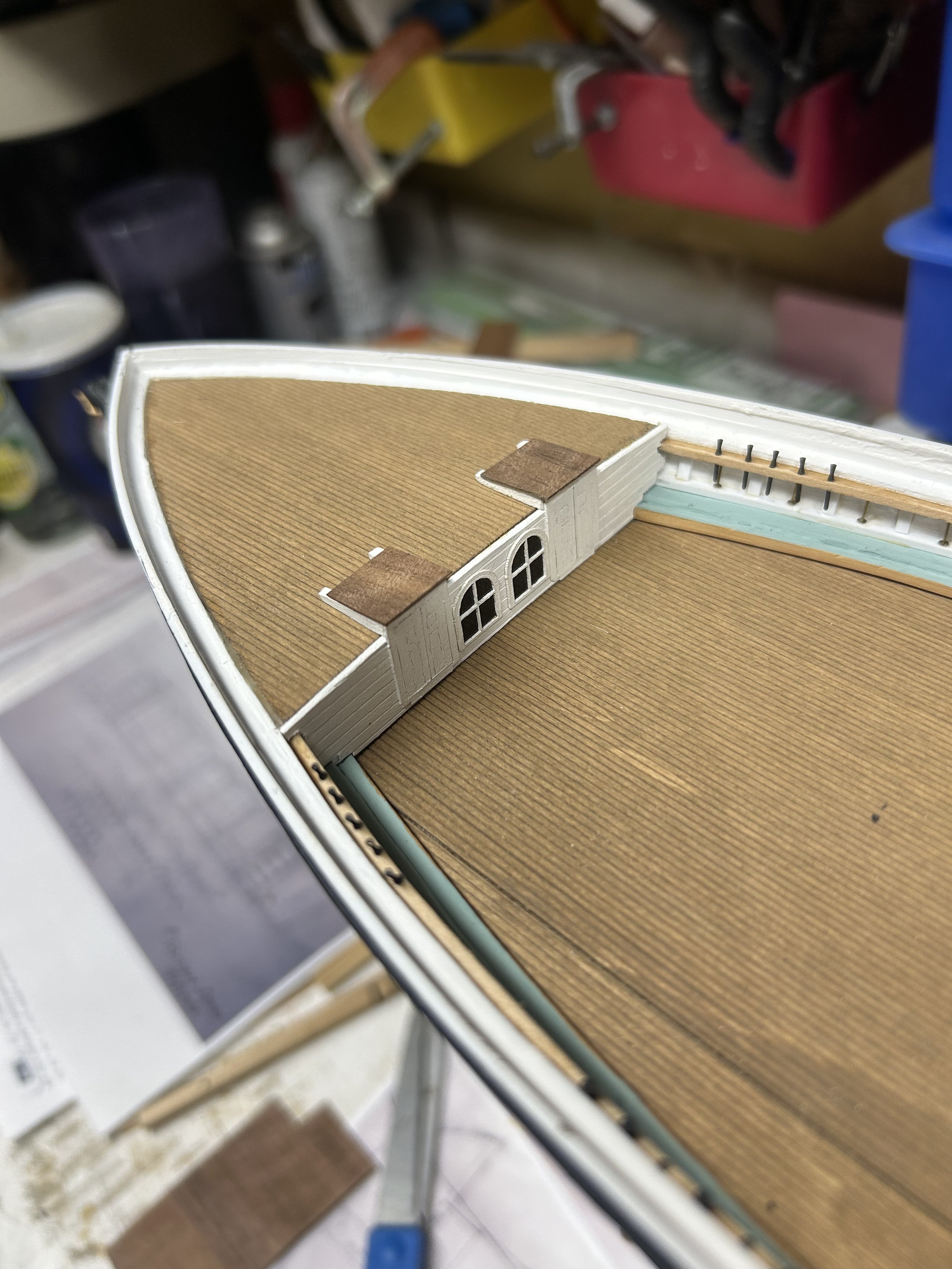

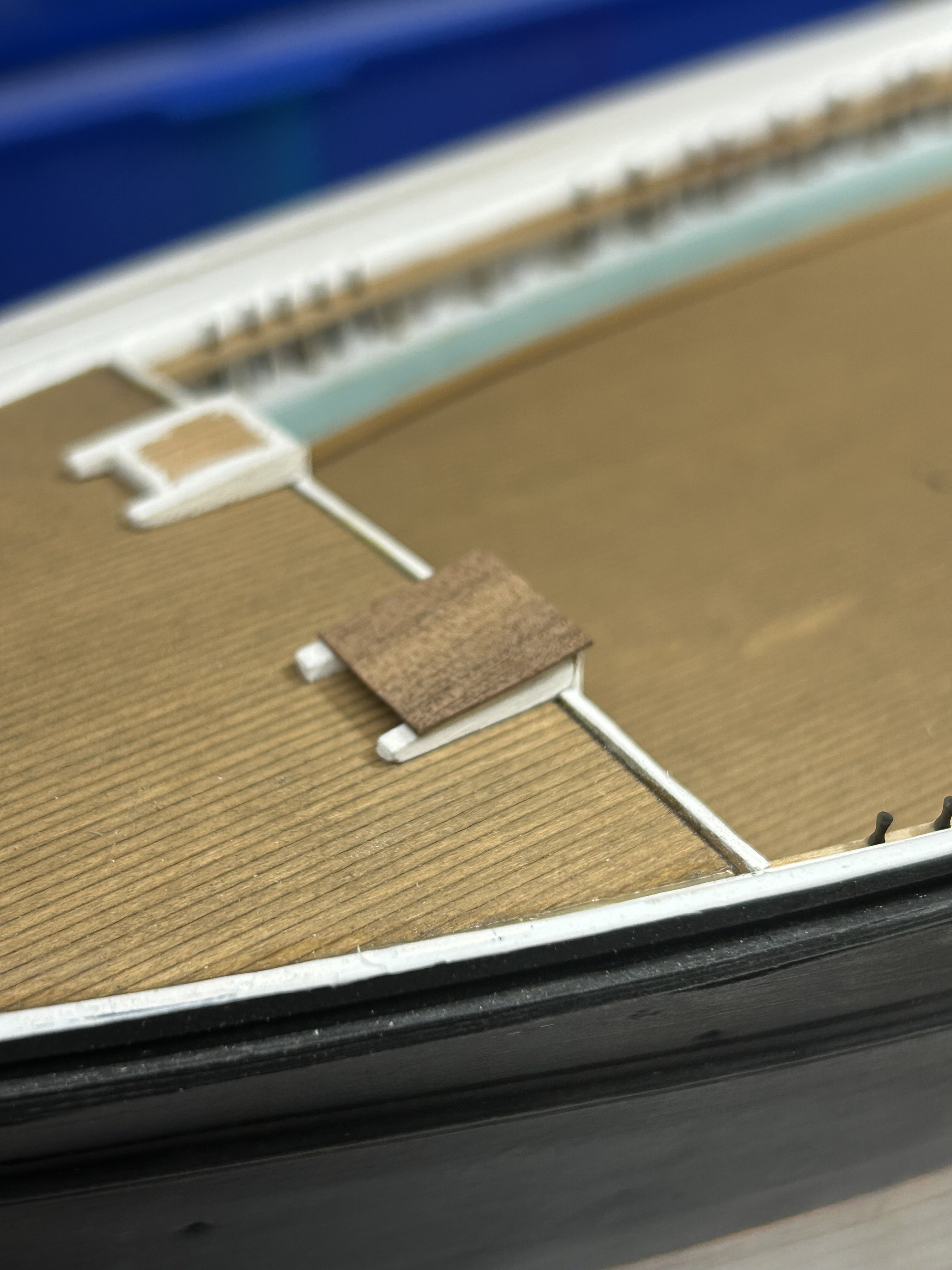

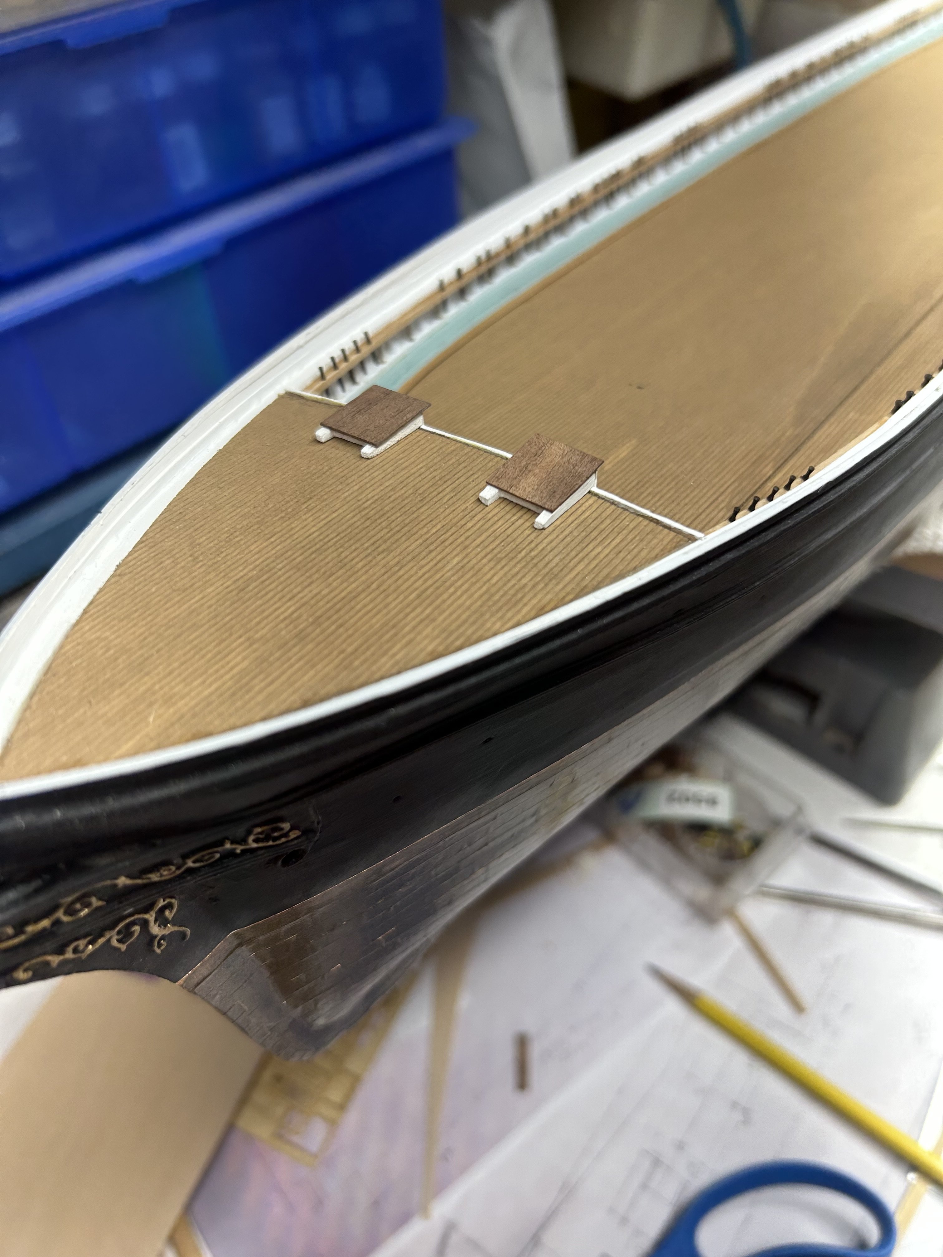

Began the forecastle face and companionways.
Rob

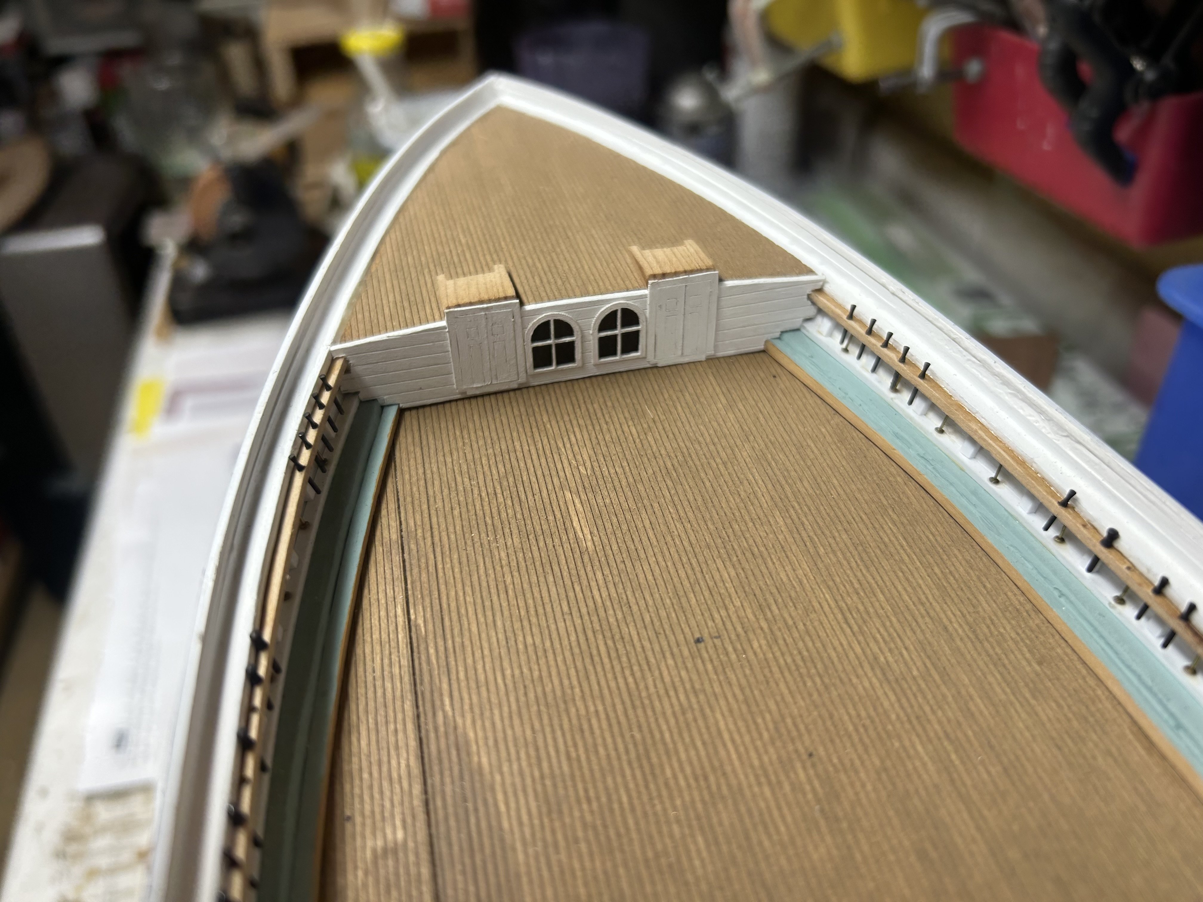

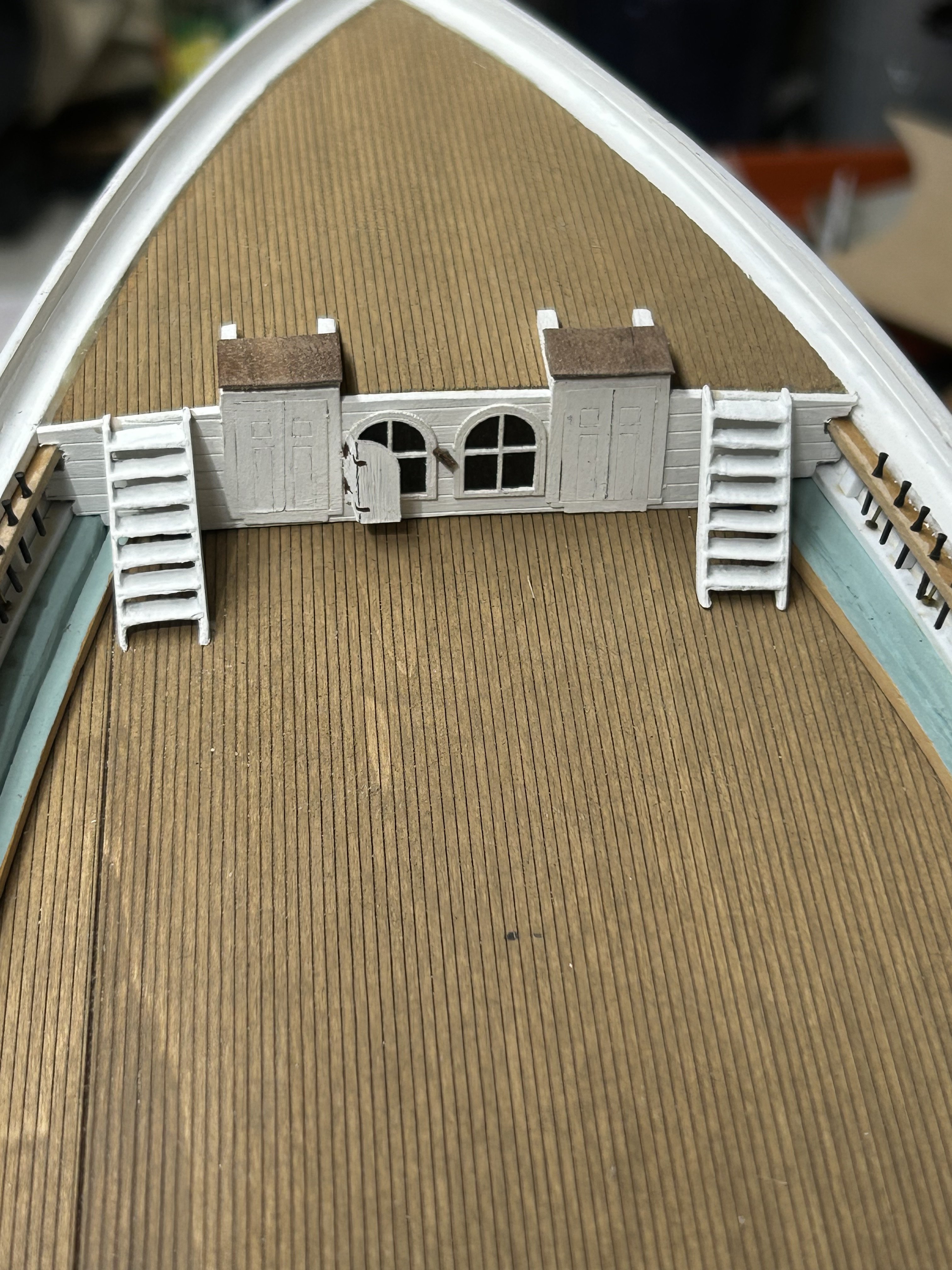

Everything is just test fit.   I’ll reduce the companionways roofs slightly and add the ladders on either side of each companionway outboard.    I opted to add only 2 windows for the forecastle front.   It looked crowded and a bit overdone with four smaller windows.
I figured I’d add this and the poop cabin facing before beginning the channels.
Rob

Rob,
Beautiful clean installation. However, it brings up a different concern. We were working on the expectation that this area was 27' wide. Your build however implies a far narrower space, possibly a third less. Maybe 18-20' ?

See...this is the stuff of scaling transcription errors.  I knew right away, you would bring this up.😆  From your original drawing we *concluded* the width to be 27ft.  No real true dimension is ever given from McLean....only that her entry was the sharpest ever seen on her model.  In this space I could only fit the two companionways,(3ft including jams) and the ladders(3ft),(required to ascend and descend) her forecastle deck.  What was left over was trepidatiously divided for windows, space between fixtures and such.
I don't recall the actual width off my head, but I do know it is around 26.5 scale ft.....not 18~20.   I'll reverify when I get home.  No windows were places outboard the ladders...this space is relocated for the below deck W/C's.
I might still add some paneling embellishments.
Rob

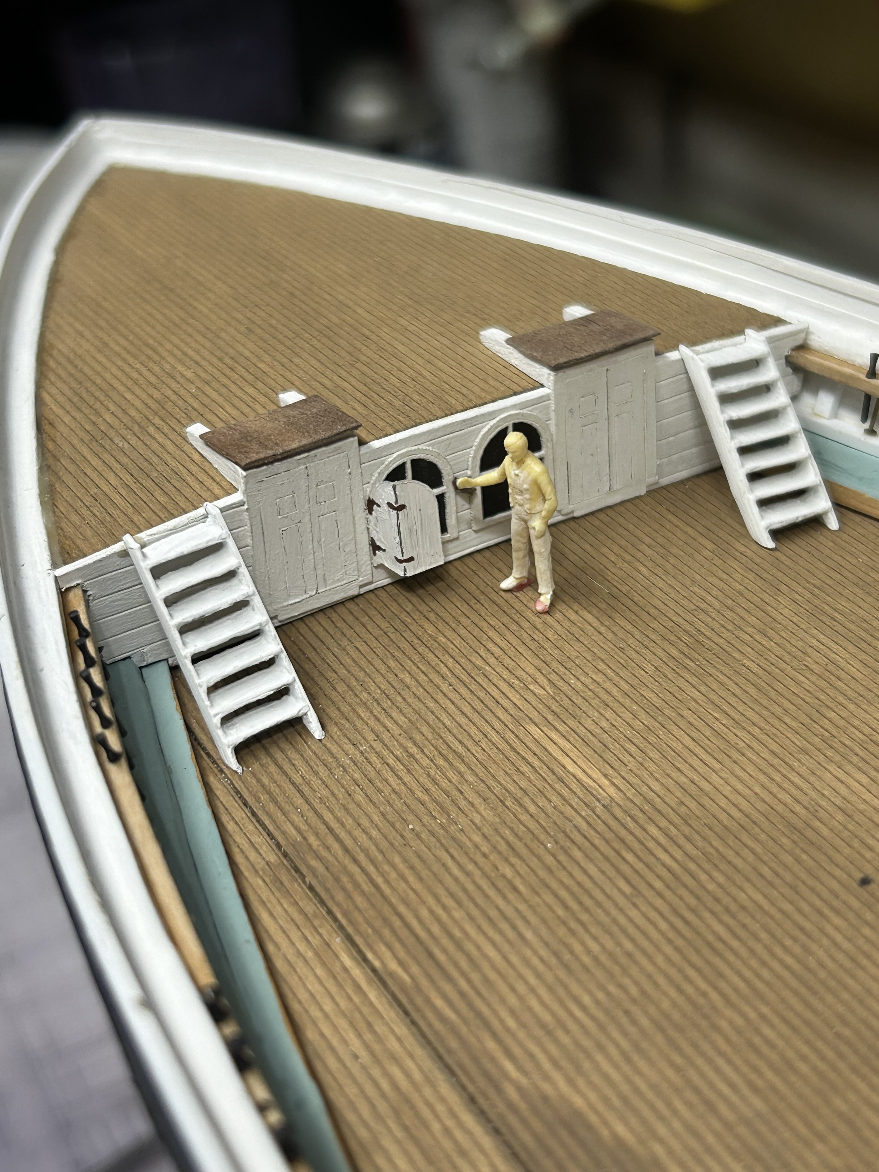

Question: Those windows look awfully close to the deck and hence accidental damage. Were they really this large and low?
Rob

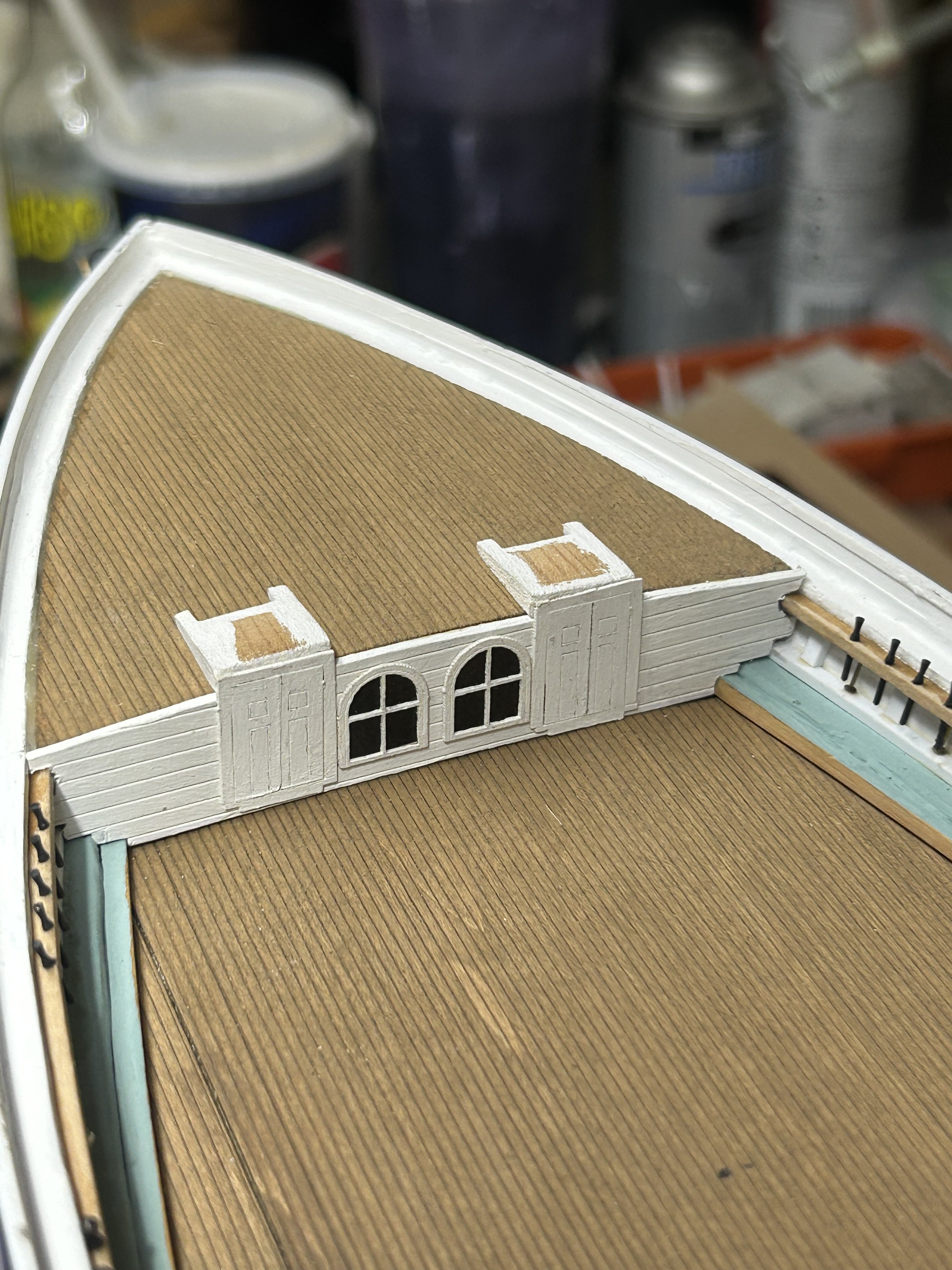

Rob,
When it comes to deck width specifics, we really only know of two: her widest beam amidships was 40 feet and at 8 feet from the stern, her poop deck was only 24 & 1/2 foot wide. Other internal dimensions are a 13 foot wide central cabin with a 12 foot wide captain's cabin on her starboard side below the aft poop deck. Thinking that ship's layouts are usually balanced I figured the opposite port side first mate's cabin would also be 12 feet wide. That would total 37 feet beam at 44 feet from her stern. If my pure conjecture is correct, in 63 & 1/2 feet, she's only 3 feet wider. That's since her widest beam of 40 feet is 107 & 1/2 amidships. Of course, the first mate's cabin could be smaller and that could make the poop deck narrower.
I don't know exactly where a 27' beam was derived from for the foreward bulkhead, just that it was the approximate dimension we arrived at for me to work with. It does drive home necessity of getting more specific deck dimensions to allow for effective scaling. It's precisely why I'm endeavoring to get more exact dimensions from sources available.
Here's the call Druxey.  We do know the space was *airy, well ventilated and well lit*.  This is the first time the forecastle of Staghound or any early McKay clipper has been truly realized.  The working windless was below decks...3ft below, actually.  Like any window...I would assume there were clap shutters that were applied during heavy weather.  I placed the windows just over a scale foot or so above the decking. and the companionways doors 6 scale inches.  this means the windows are 4ft above the floor in the forecastle space and going nearly to the ceiling.  She also had prismatic ceiling light fixtures to aid in her illumination.
I admit it is a deviation from what we have always assumed.....like the McKay stem/cutwater, *hood*.   These interpretations are not of my own doing...however the construction and expression is.
I might even simulate on one window the addition of a partly opened shutter....to drive home the clear practicality and application.
Thanks, for the question.
Rob

Staghound, was probably dimensioned after the typical *fish* body method.  With her fullness being amidships and then tapering aft to her narrowest...at 24.5ft.  Forward, we can only assume her entry followed the natural curvature and inclination to terminate with a sharp entry at her cutwater.  Everything in between, is an educated speculation.  McKay's own half model is our only data point.  A good top view would have been nice.  Still you can make a good educated guess from the images you acquired.  Personally, if her forward extreme was any wider than she is currently....it would change her overall body curve....forcing her widest section to be moved farther forward.  Or at worst, not giving her the smooth contours she has.
This is exactly the issue I was projecting on the issue of scaling transcription errors.  We are moving from the verbal (An that is vary subject specific),to the 3 dimensional.  Even with McLean's measurements....were they inside or outside measurements? Taken from a corner or a projection of molding?  How does one extrapolate...ABOUT?
Rob(Moving forward)

Further research shows that Chapelle's drawing shows the point of the forecastle facing bulkhead is rough 29.5 ft across....making our 27ft rough guesstimate pretty close...considering all other hull modifications. Notably the reconstructing of the forecastle front and relocating the W/C's and windless internally.
Rob

Rob,
Another factor I missed in my sketch is the substantial inward rake of the ship's hull which also would affect workable items such as ladders, companions and windows.  As for future possible projects, I now have trued out the following sheer, body and deck profiles: McKay twin packets Star of Empire & Chariot of Fame clippers Stag Hound, Flying Cloud, Flying Fish, Sovereign of the Seas, James Baines, Lightning, Great Republic, Donald McKay, Mystic, Connecticut clipper Andrew Jackson (Belle Hoxie) and Rockland Maine Red Jacket. Currently for obvious reasons, my total fous is on Stag Hound but all the others have been digitally corrected so that vertical and horizontal lines have been reconciled as accurately as possible.

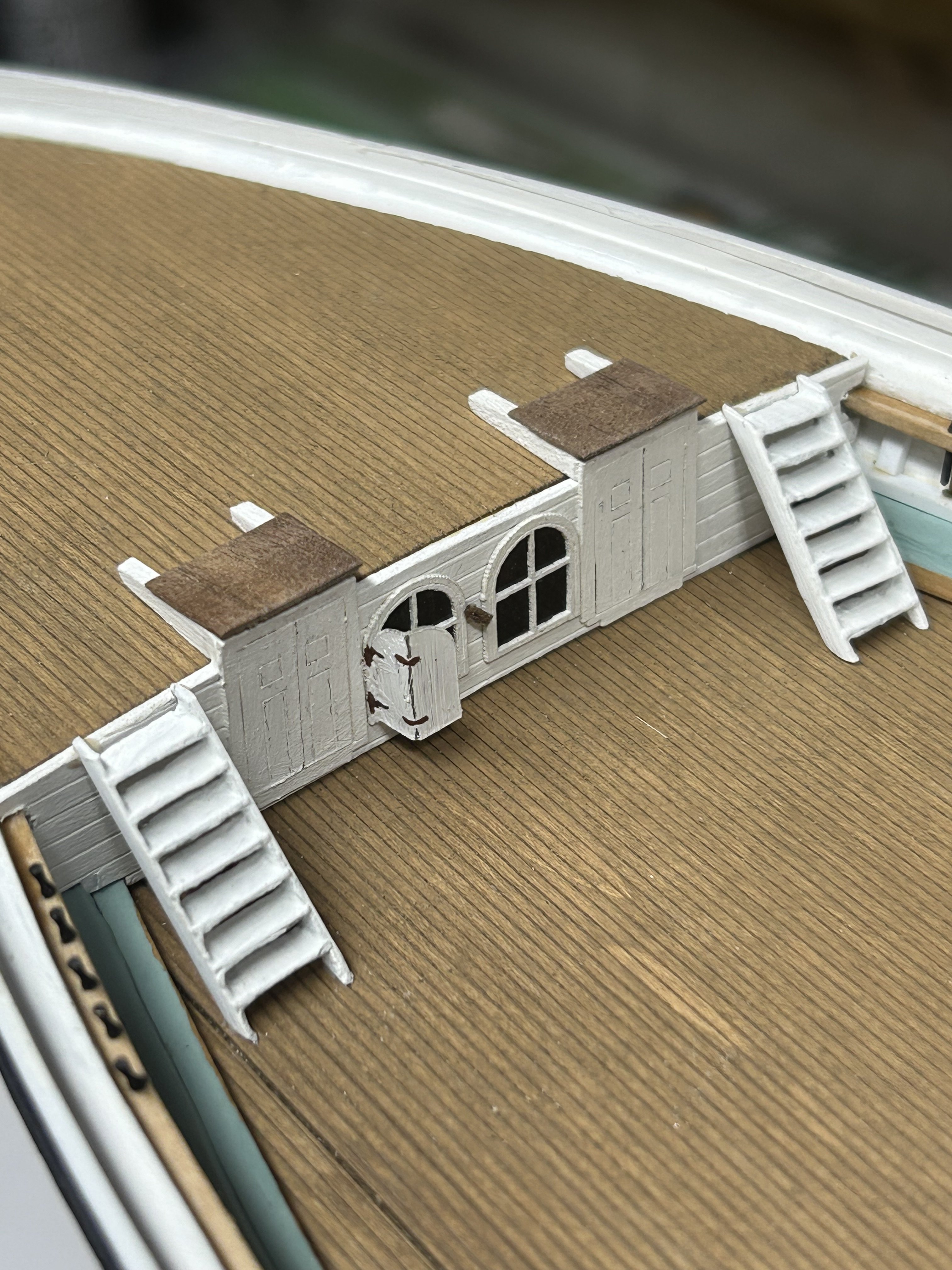

Spent time finishing up the forecastle front and companionways.  I also added a foul weather shutter partially open exposing the window behind.
Rob

Rob,
This entirely new interpretation of an authentic McKay forecastle bulkhead will most certainly raise some eyebrows. From a nautical engineering aspect this makes so much more sense. Placing a new patented windlass below improves weight balance, provides sensible working room for unit maintenance and better weather ability. Meanwhile, closing off an aft forecastle bulkhead is the only logical way to create a safe space to serve as crew accommodations. This also emphasizes a greater difference in substantially larger American clipper design capabilities as compared to much smaller British ones. Incidentally, a description of Webb built New York extreme clipper Challenge has an identical forecastle arrangement for their crew as well. Rob your inclusion of foul weather shutters is a nice touch. Besides, answering questions before asked they provide a nice focus of interest. Painting them the same light blue of your waterways might also help them stand out as well.

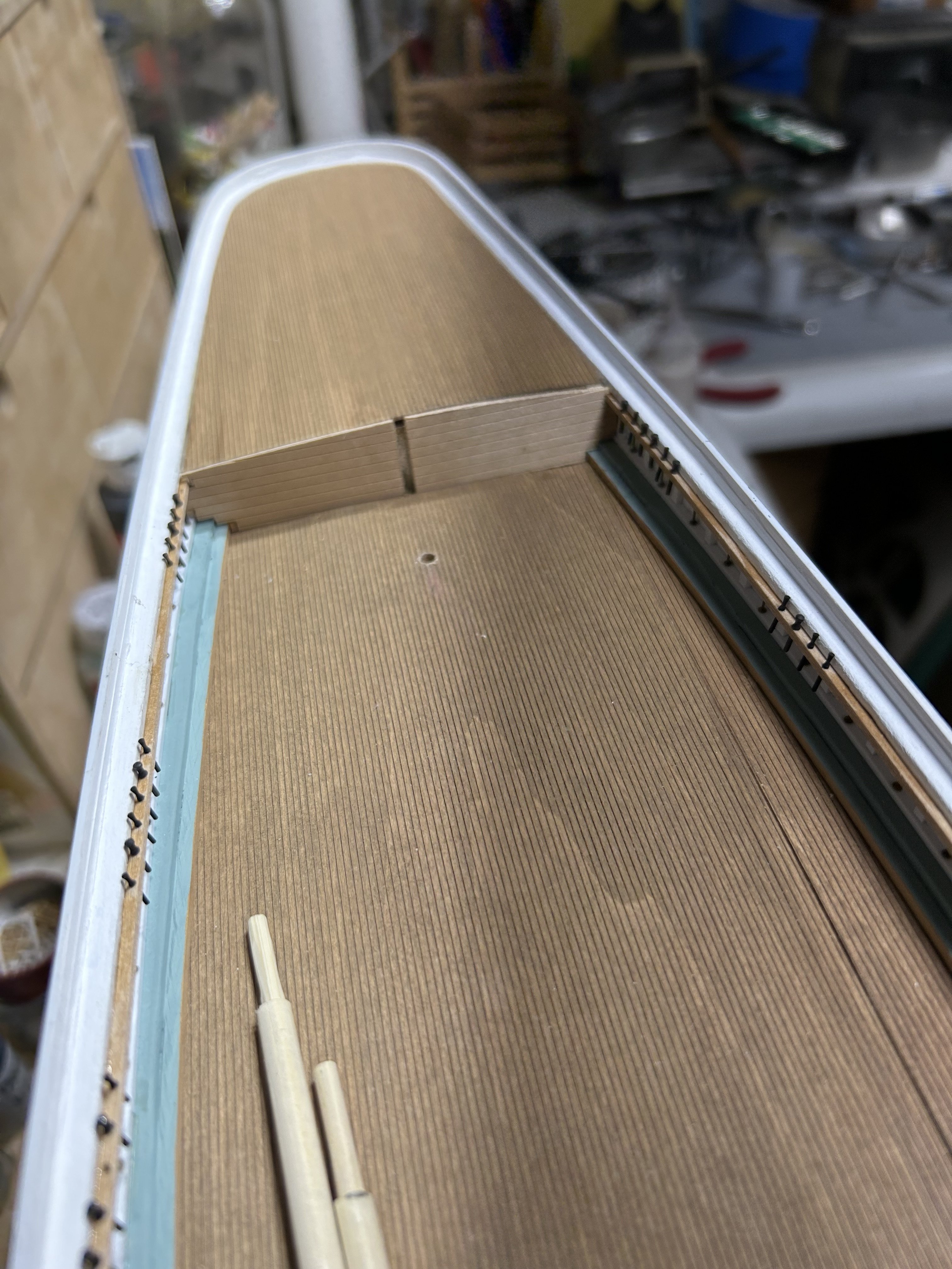

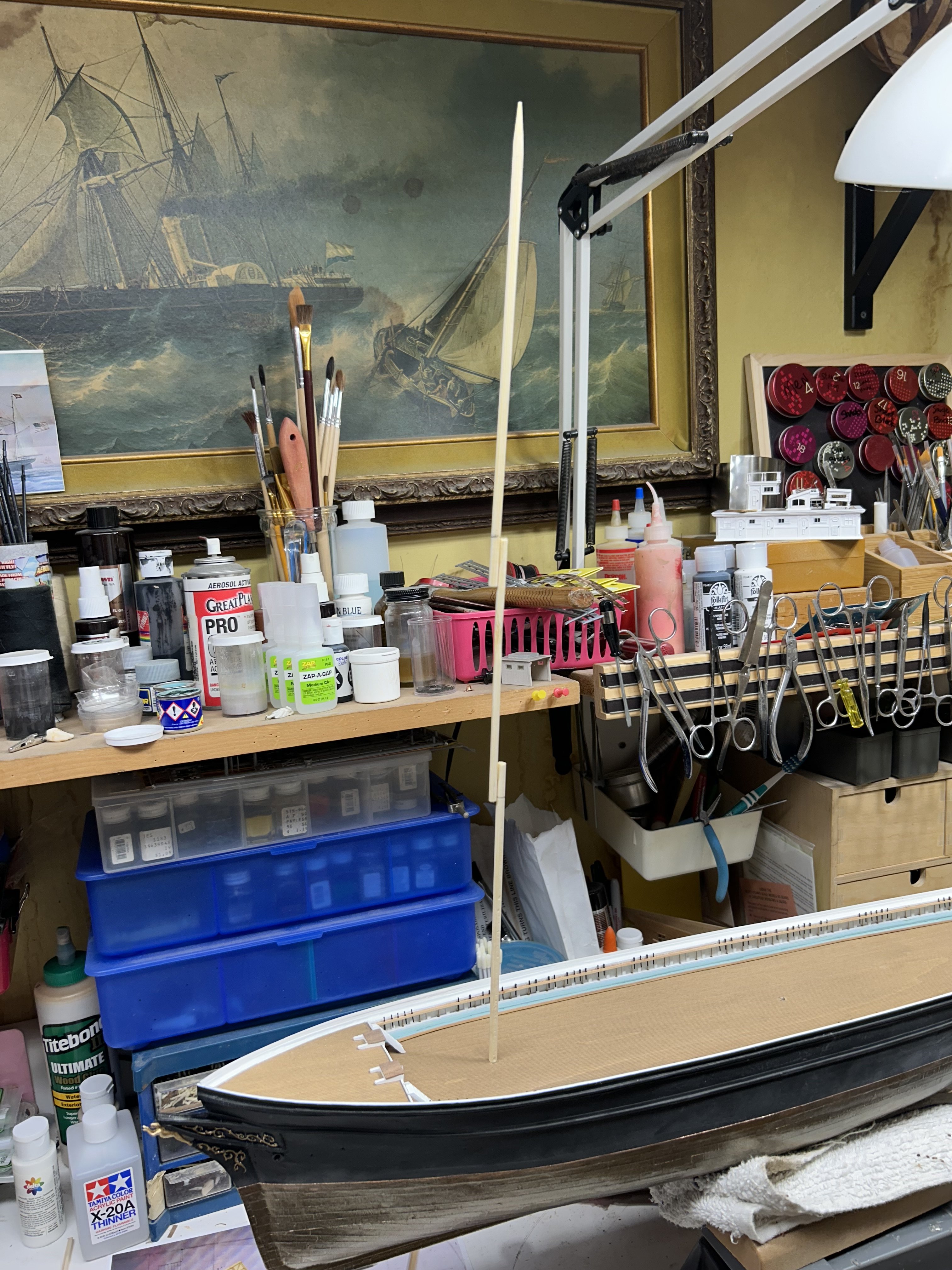

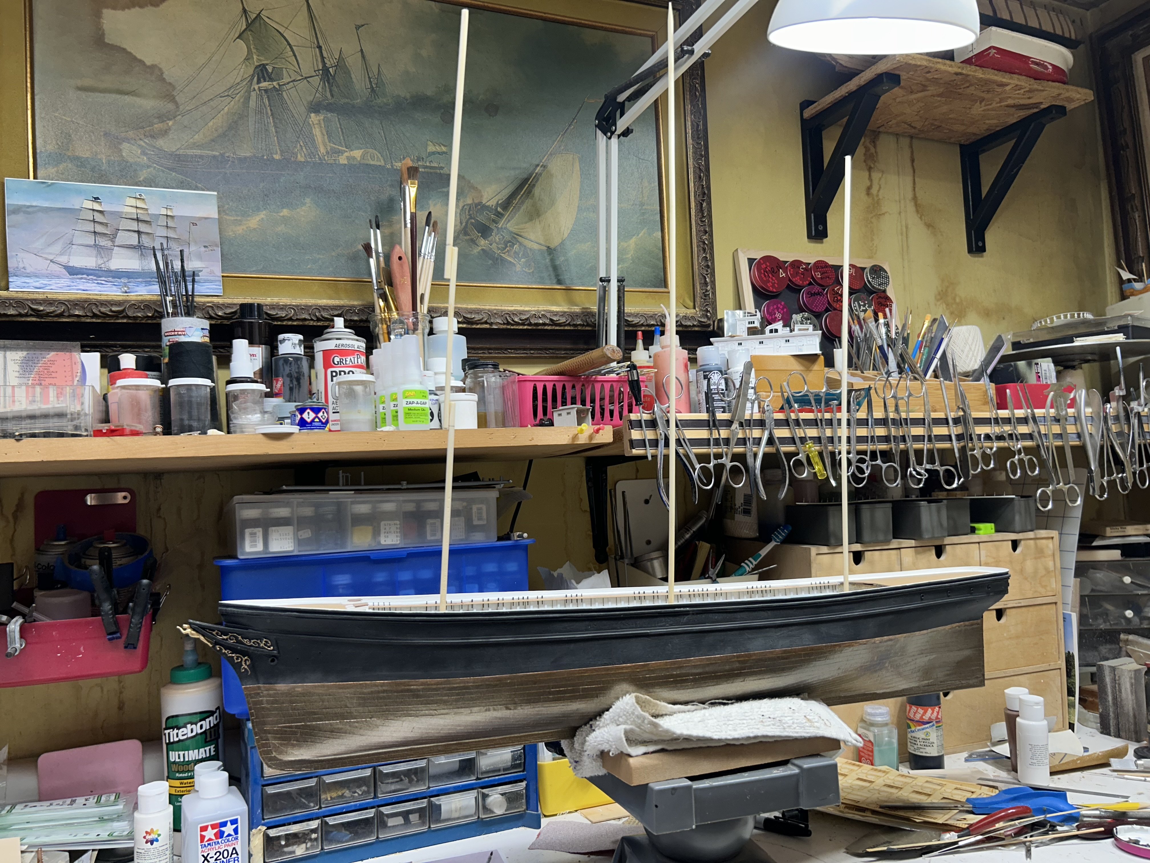

Began to add the mock-up masts so I can get the correct angles for the chain plates.
Rob

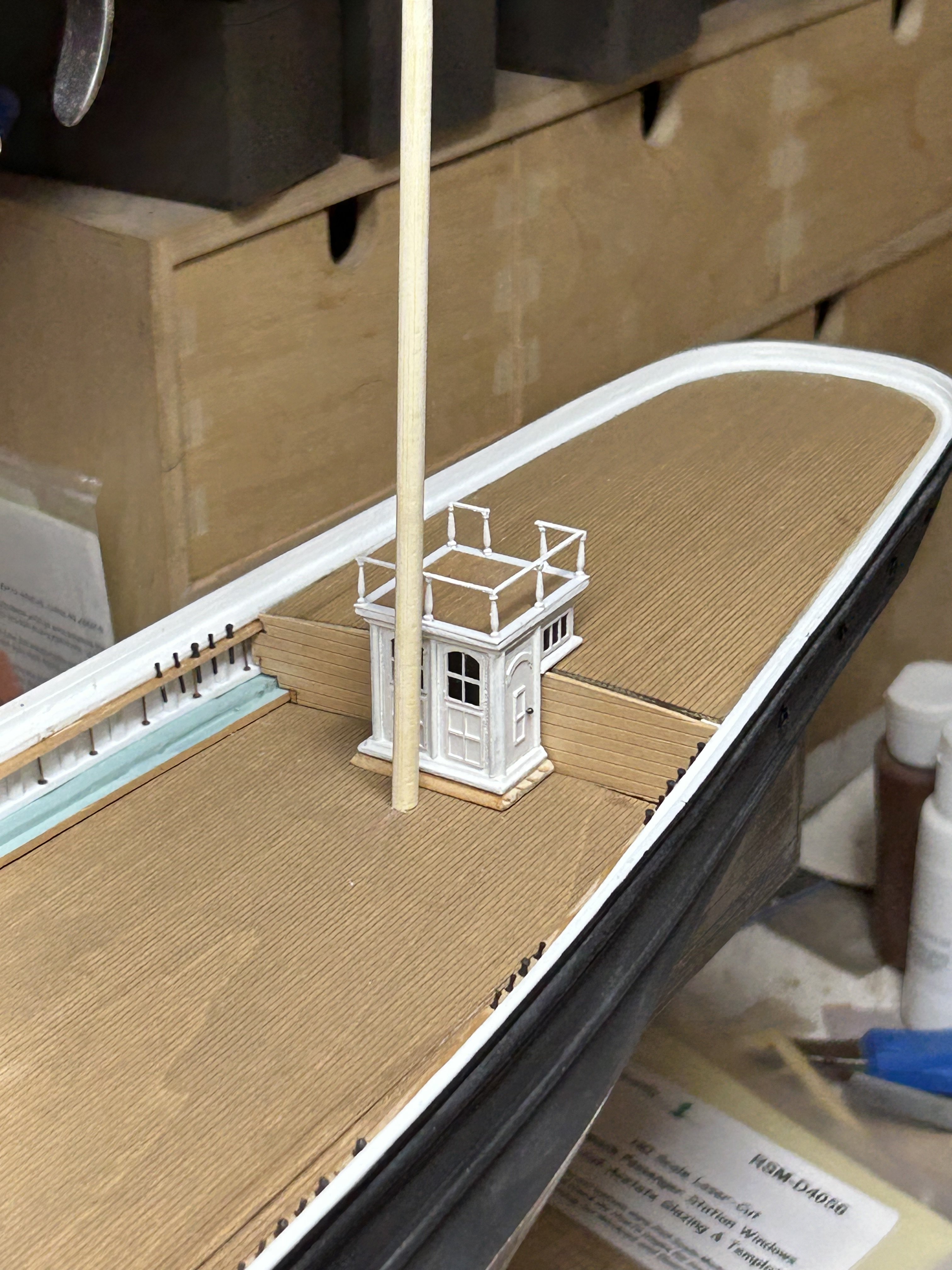

After I set the test masts.  I jumped into the poop cabin bulkhead.
Rob

The lines of Stag Hound are so incredibly beautiful. Her tall masts are quite impressive too. She's becoming a quite lovely build.

Indeed.  the trick with any mast compilation is devising the doubling distances.  We know how long each mast is...but how long the doublings are can be a tricky guess.  Each mast must be included in each doubling...thus that must be included in the total mast height.   These temp masts I made are only proximities at this point.  This is why....I only made the foremast with doublings and the main and mizzen are single sticks.   It's all part of the calculation process.  Is there any data truly identifying her actual mast heights?   Just throwing out ideas for evaluation....as an aid to others.
Rob

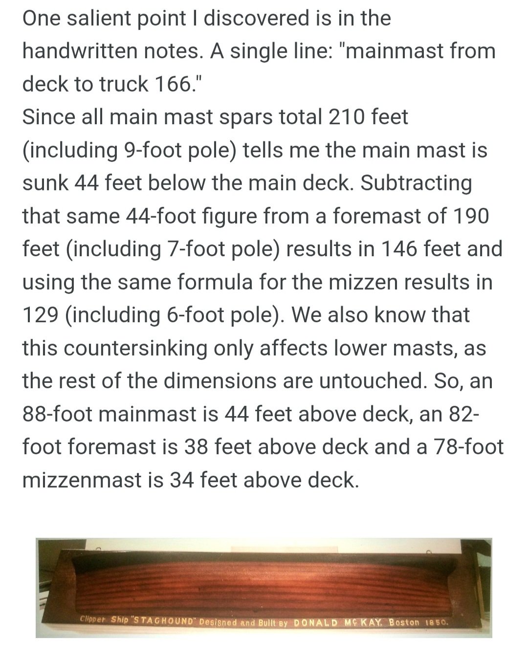

@rwiederrich Rob
Aug 1, 2024 post #268 includes the entire Nov 18, 1896 4 page letter from Cornelius McKay to Captain Arthur H Clark included with delivery of his unique 1850 Stag Hound builder's model and as of yet undiscovered scale plans. On the last handwritten page, last entry reads: "Main Mast Deck to Truck 166." Using mast specs I calculated the total main mast spar heights as 210'. Subtracting 166' results in 44' below deck. Using that same standard, fore mast comes to 146' and mizzen mast is 129'. For convenience, I've attached a screen shot of my notes too.

I knew this data was in the folders...I just couldn't remember where.   Thanks for pointing it out to me Rich.  Now I'll make some comparisons and recalculate.
Rob

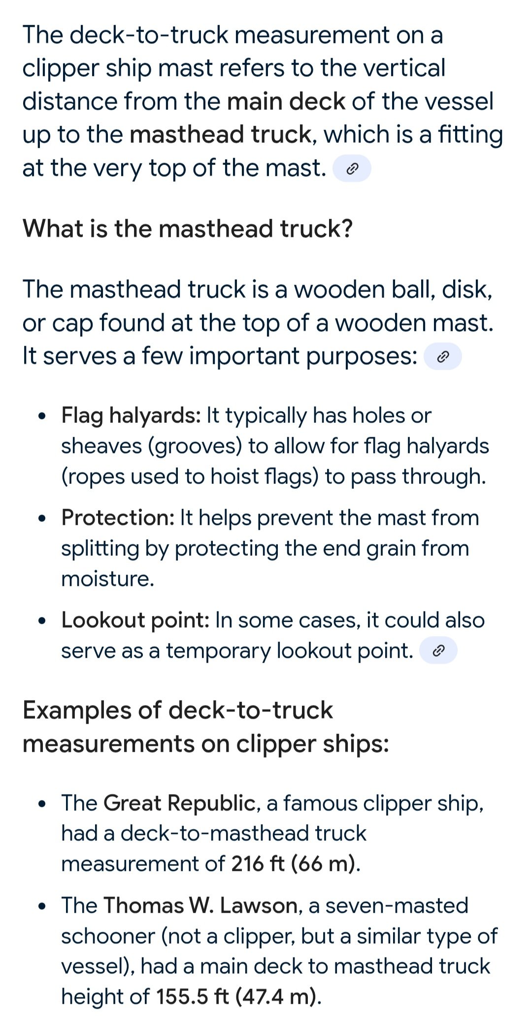

@rwiederrich how I arrived at the original main mast height of 210' is by using the following process: 88' main mast to top, add 14' for hounds = 102' add 51' for topmost but subtract 14' for hounds since it's offset down to the top = 37' + 9 & 1/2' for hounds = 46 & 1/2' + 102' = 148 & 1/2' then add 28' topgallant - 9.5' for 2nd offset down of hounds to trestle tree = 167' + 19' royal, 15' skysail + 9' pole = 210'. I used the same formula for both fore and mizzen masts. As for  "Main Mast to Truck 166" I figure that takes in the pole too, however if it means to the skysail mast top, then 9' would be added to 166' for 175.' I'm just not that familiar with "truck" to know the exact meaning of the word. I do know each masthead was fit with golden tops which would have lightning rods above that.
*update: according to a Google term search "Deck to Truck" measurement is to the top of the flag pole halliard. A screenshot shows that Great Republic had a Deck to Truck height of 216'.

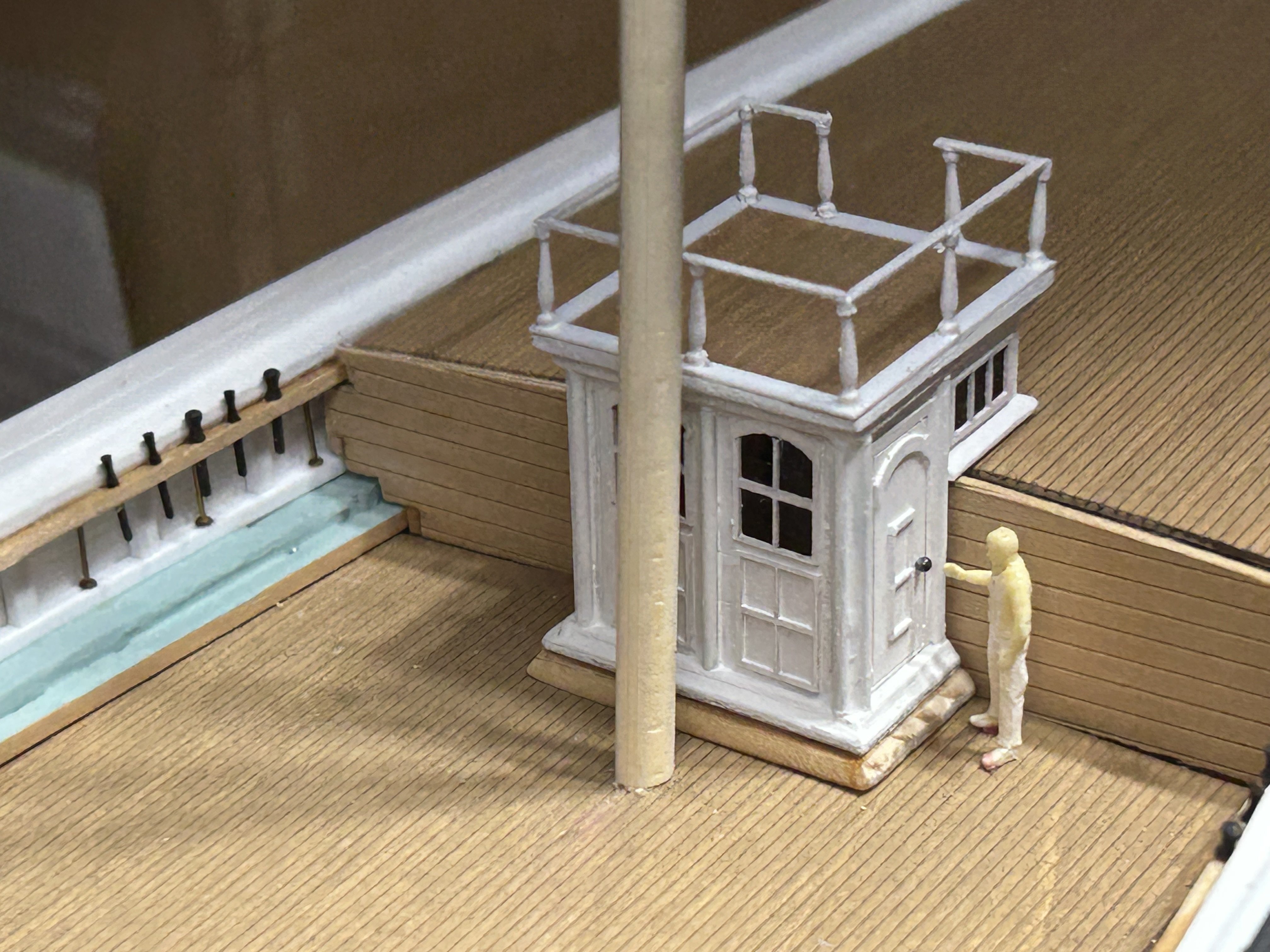

Not much time to work on the aft cabin
I haven’t secured the ladders , cus McLean’s description says the captains cabin “overlooked” the main deck.  So I’m considering adding a small window on both sides.
Rob
