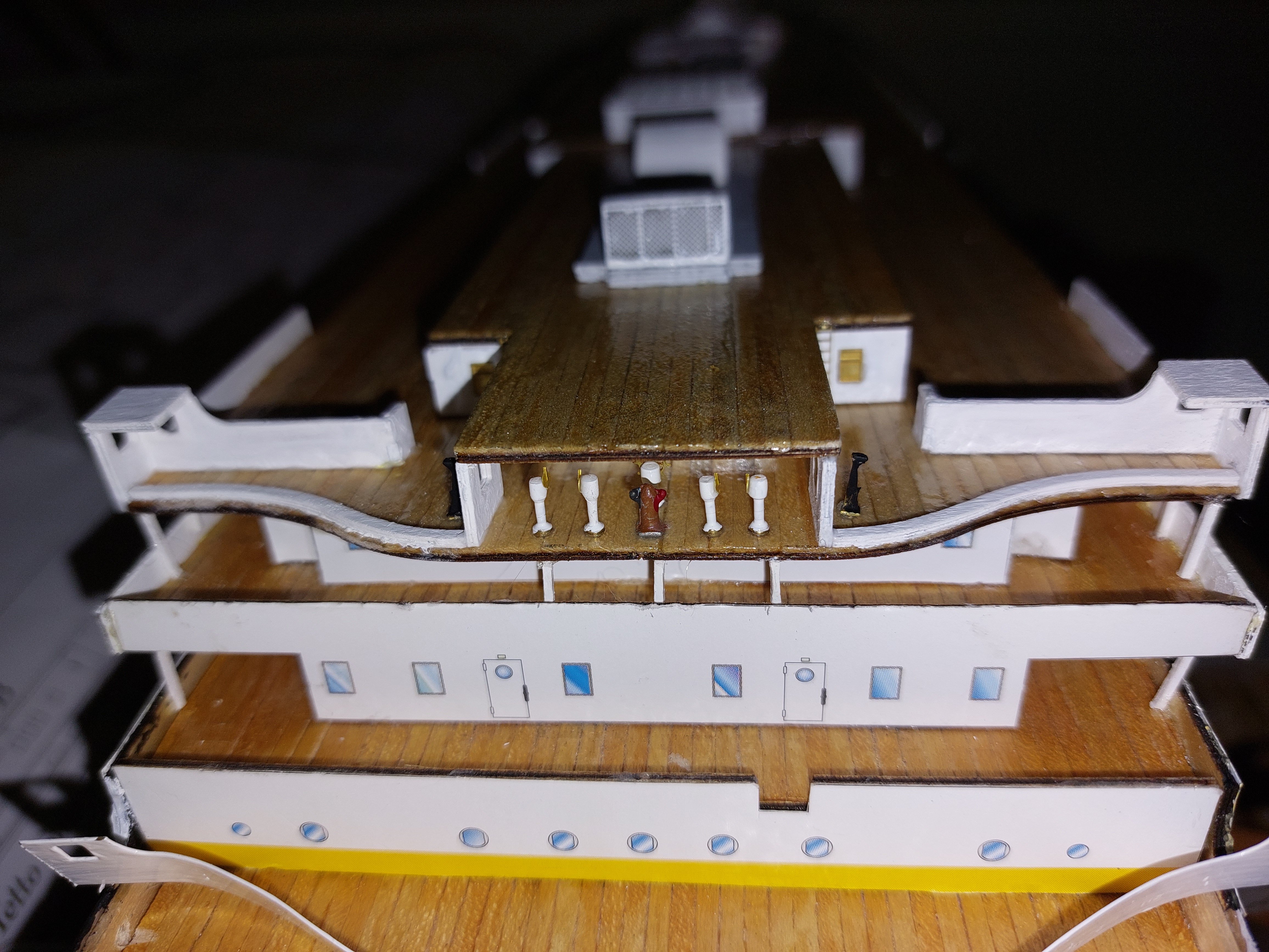

I am making a little more progress with my Titanic model! Unfortunately the bow will never be really sharp anymore but I managed in improving  it a little. After applying the propeller shafts, now I am working on the next layer of cabins. And there I encounter an issue with the set , namely Part 229 from wooden plane 2233.
I noticed that it cannot fit where it should belong because the notch of the component seems to be on the wrong site. When looking at the TAV. 06 print, we indeed see that this is the case. See screenshot. The notch should be on the short site but in the wooden plate it is on the long site.
Anybody noticed this before and has a workaround instead of sawing it out myself in the correct format? I do not really have the tools to saw in perfect straight lines...
I think it will be a better idea to remove the matching end of Part 231 so that part 229 can still be put in place. With some extra glue it will definitely stick. Because it will later be covered with the next deck, it won't be visible.
Also I wonder whether I can expect more of those kind of flaws. Apparently the paper prints and the actual wooden plates are not the same, for example we can see that part 224 at the top is flipped vertically although this is not an issue...
Hope for some hints!
Regards, Klaas
Edited by klaasvg
Klass:
I can't remember this one, but the solution you outlined sounds fine, particularly if it will all be covered up.

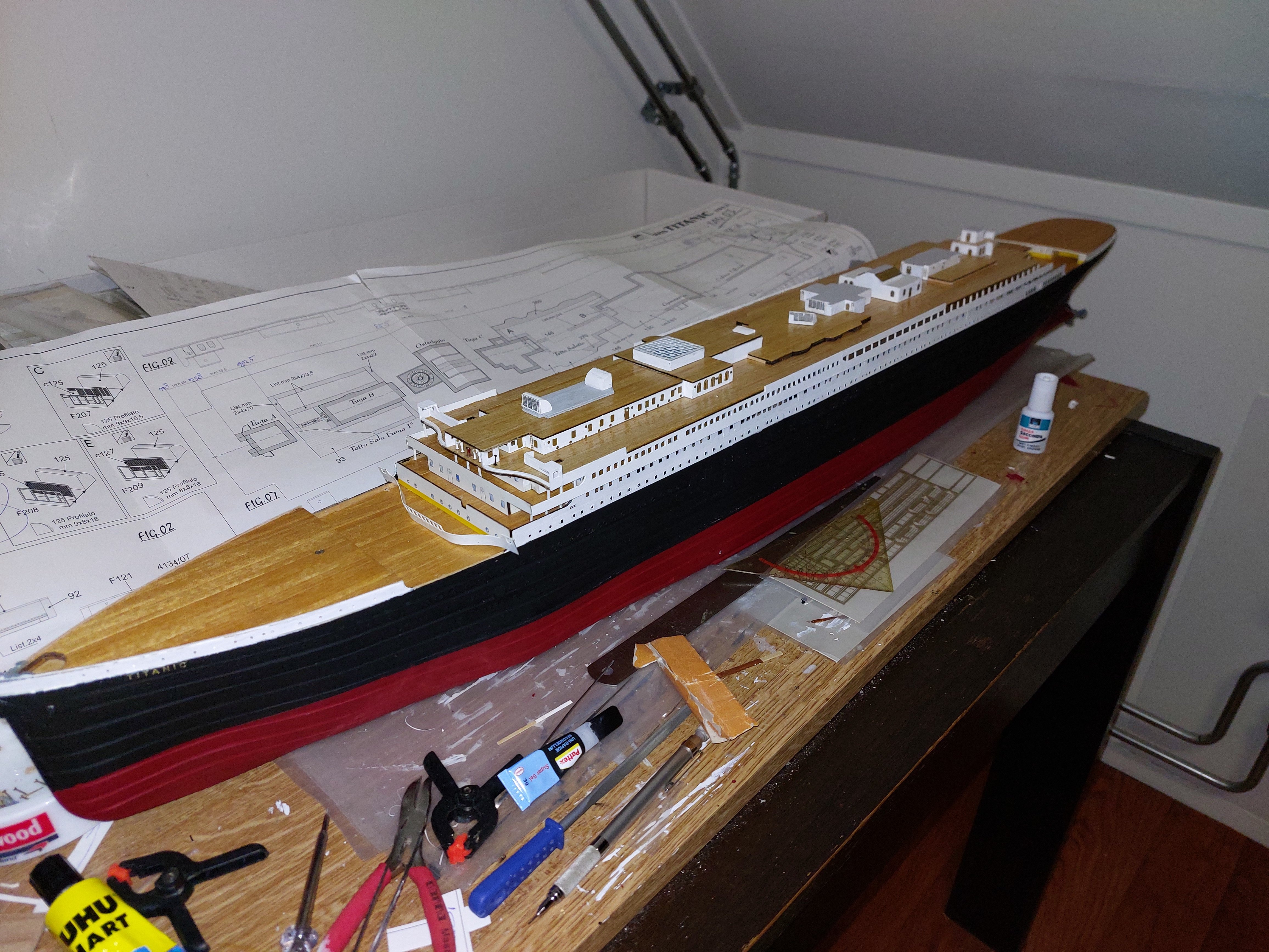

It's not going very fast but there is definitely new progress!
I hope to finish it next year, and then it's been a long road since I started this model around 2009 or so!
