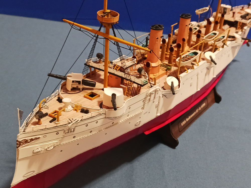

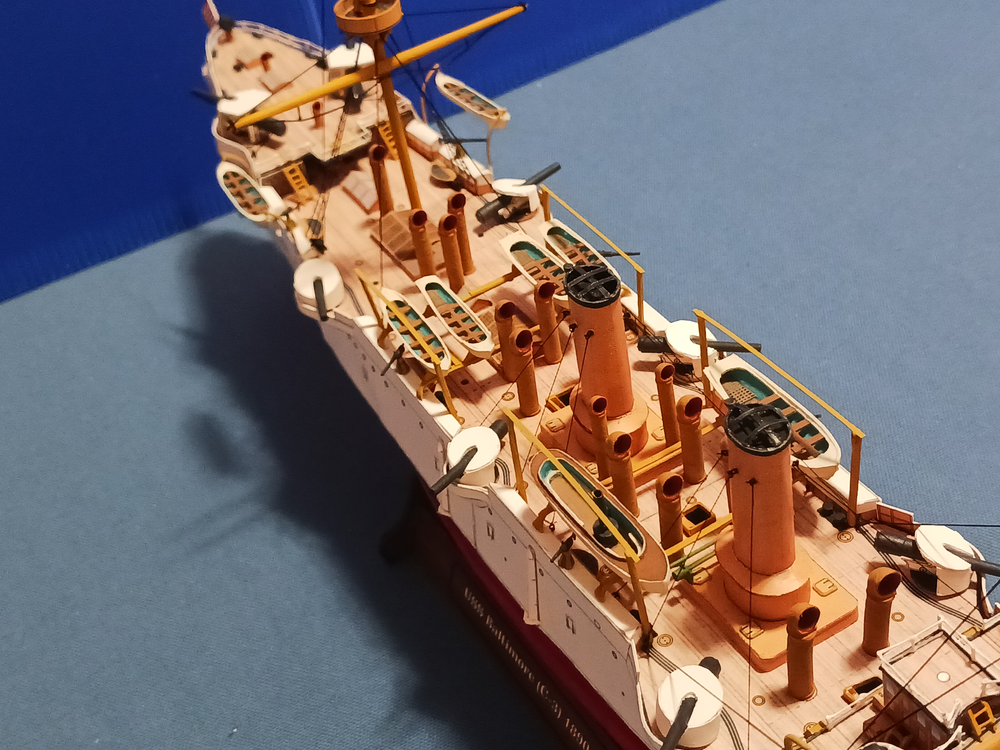

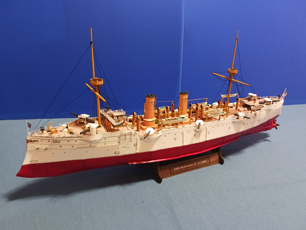

In the shipyard for the final fitting out:
Beauty shots ("No close ups, Mr. Demille, no close ups!):baltimore_180.png.b8d21a23da8aee594b9e0c77d5ea5a73.png
