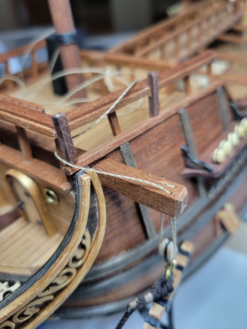

Railing is finally shapped and glued.  Broke a lot of wood in the process. Used a wood burner with heat turned down.  Made multiple curve templates.  Thanks you occre providing a lot of extra wood for this size!!
Worked on later parts when I would get frustrated.

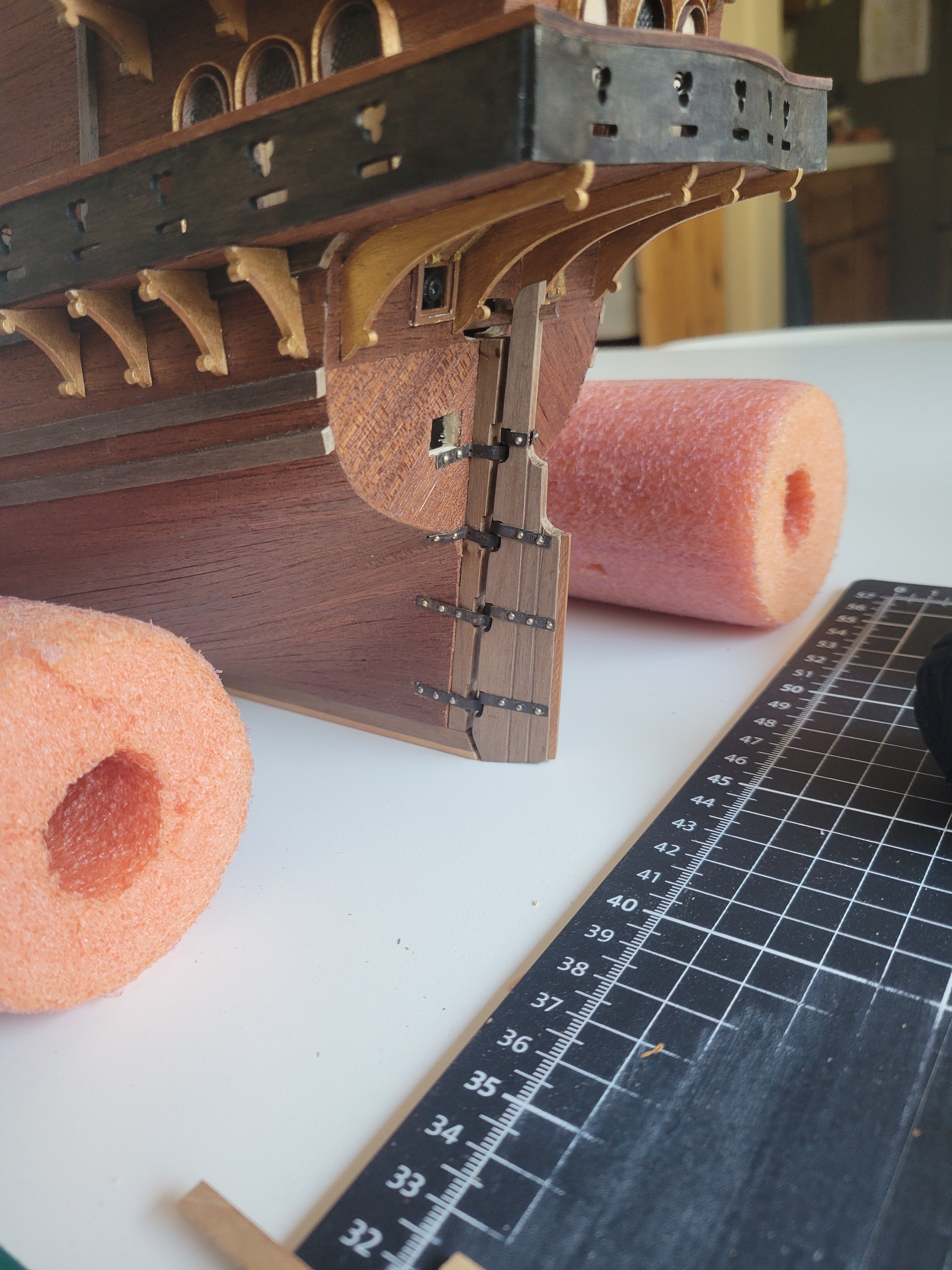

Bow bulwark with gilded adornments.

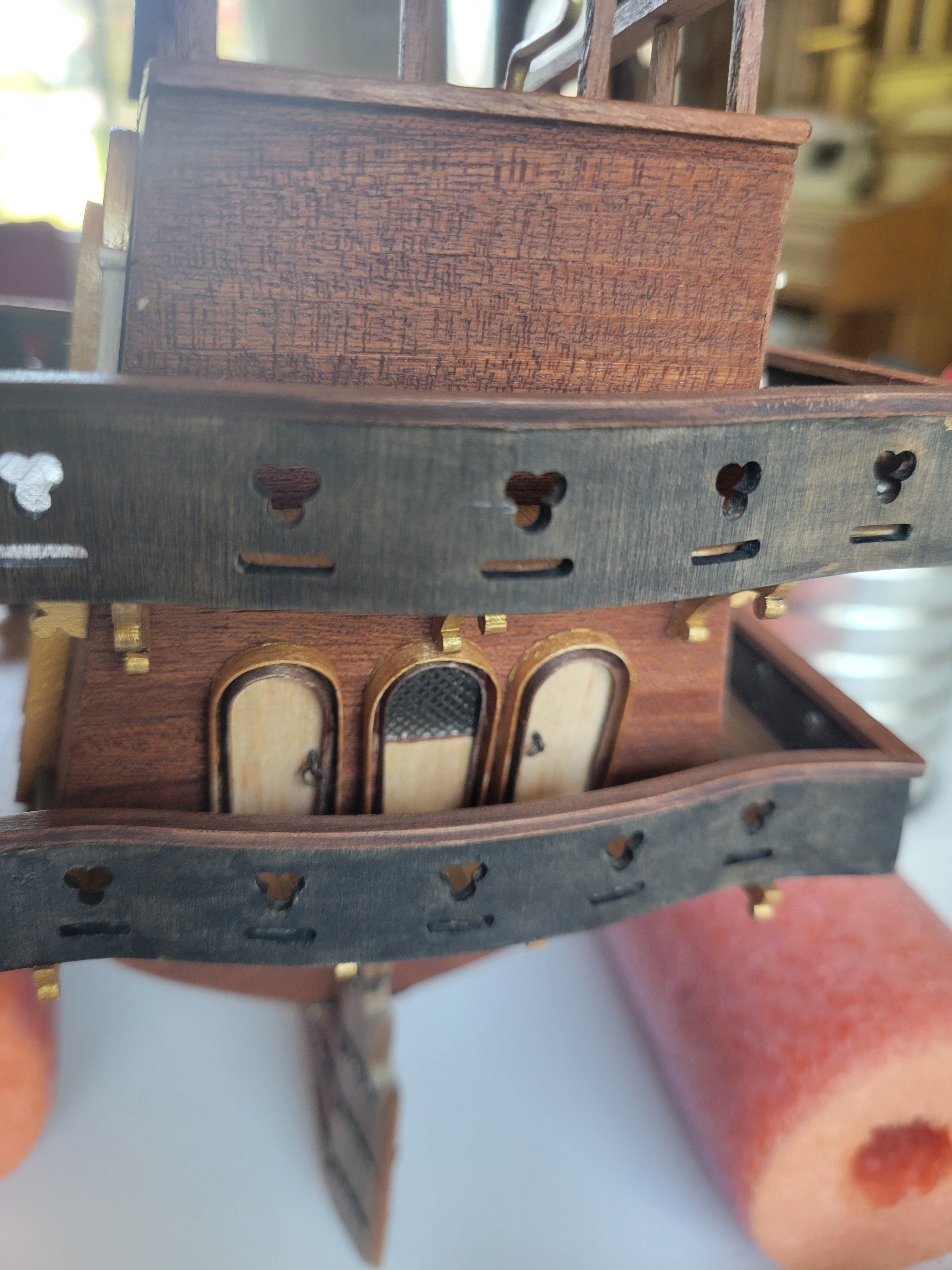

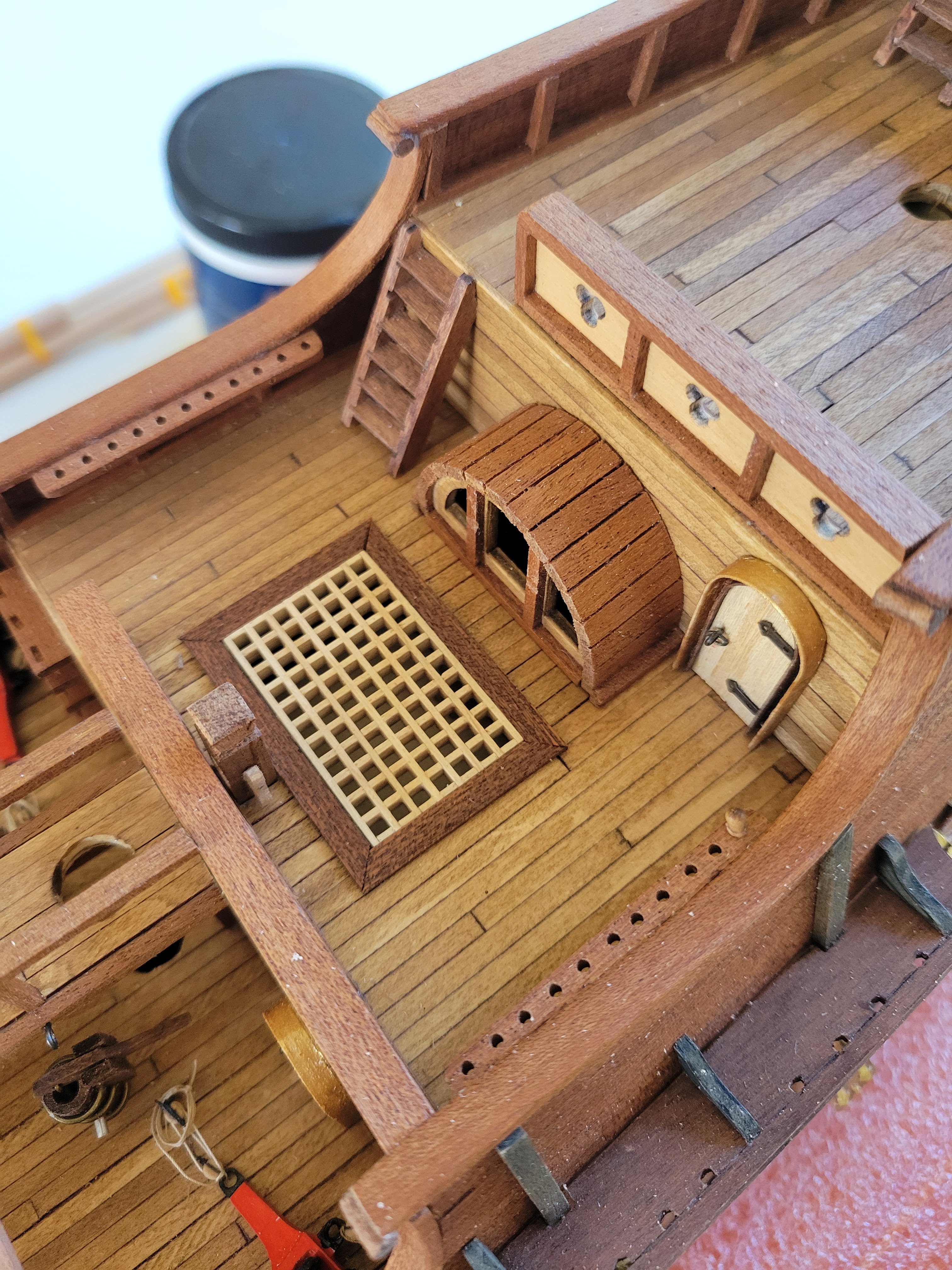

Also working on the doors. Really don't like the metal doors.  Painting them just looks like an afterthought.  But fabricating at this scale is a challenge!  Worked through lots of samples. Here are my latest alongside a painted door. Far right one is window screen on thin plexiglass, adhered with clear parts/window maker cement.  Probably going to ditch the double door jamb style from metal.  Just too small/thin and hard to bend.  The upper aft breezways on the model also have the extra adornments that the imagery gets glued to.  Don't really like the images so I'm going to play with option to fabricate them a little differently and maybe add some windows instead.

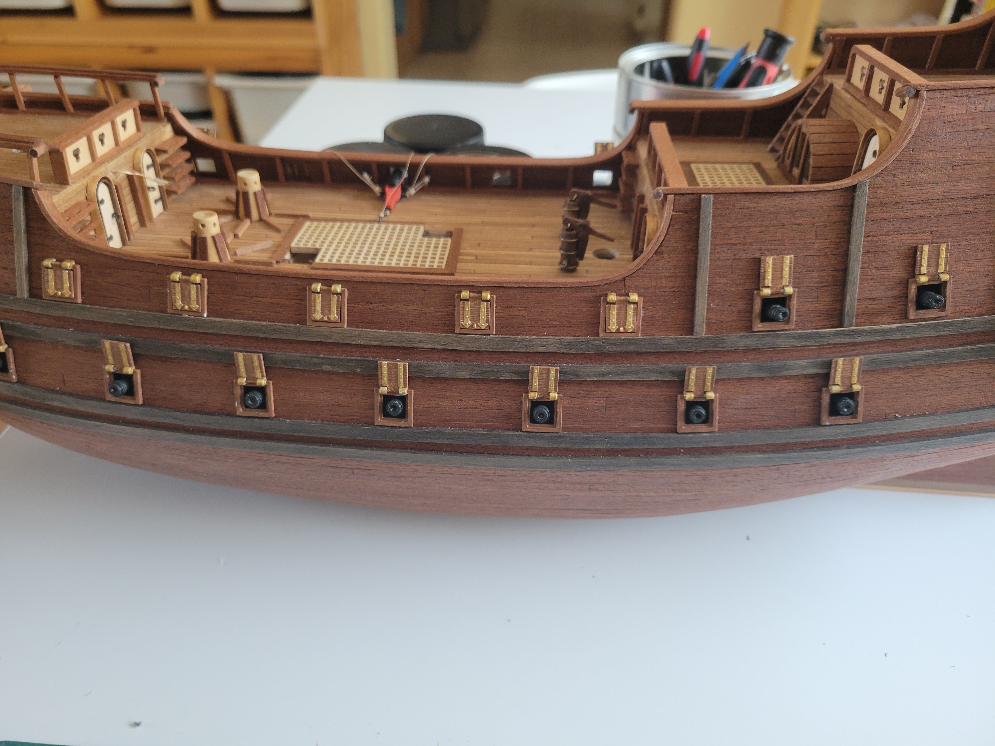

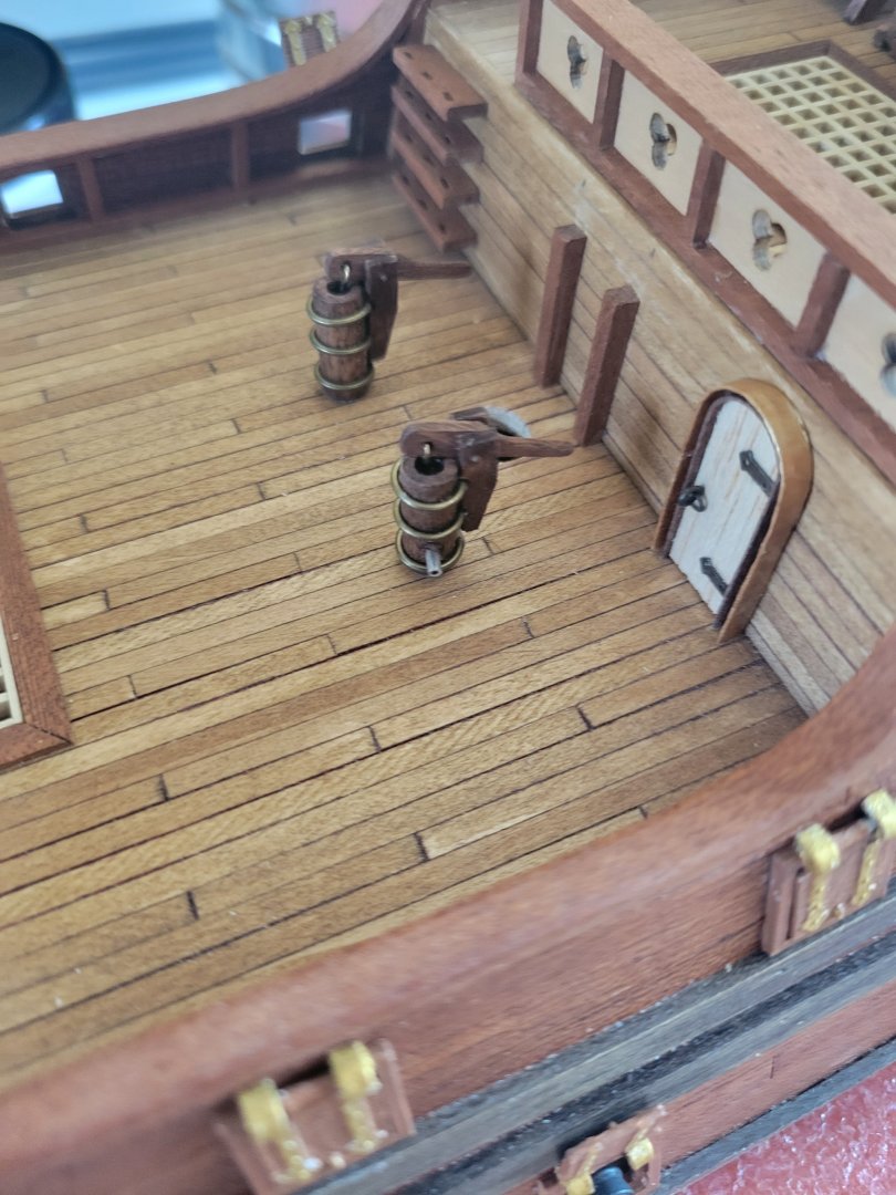

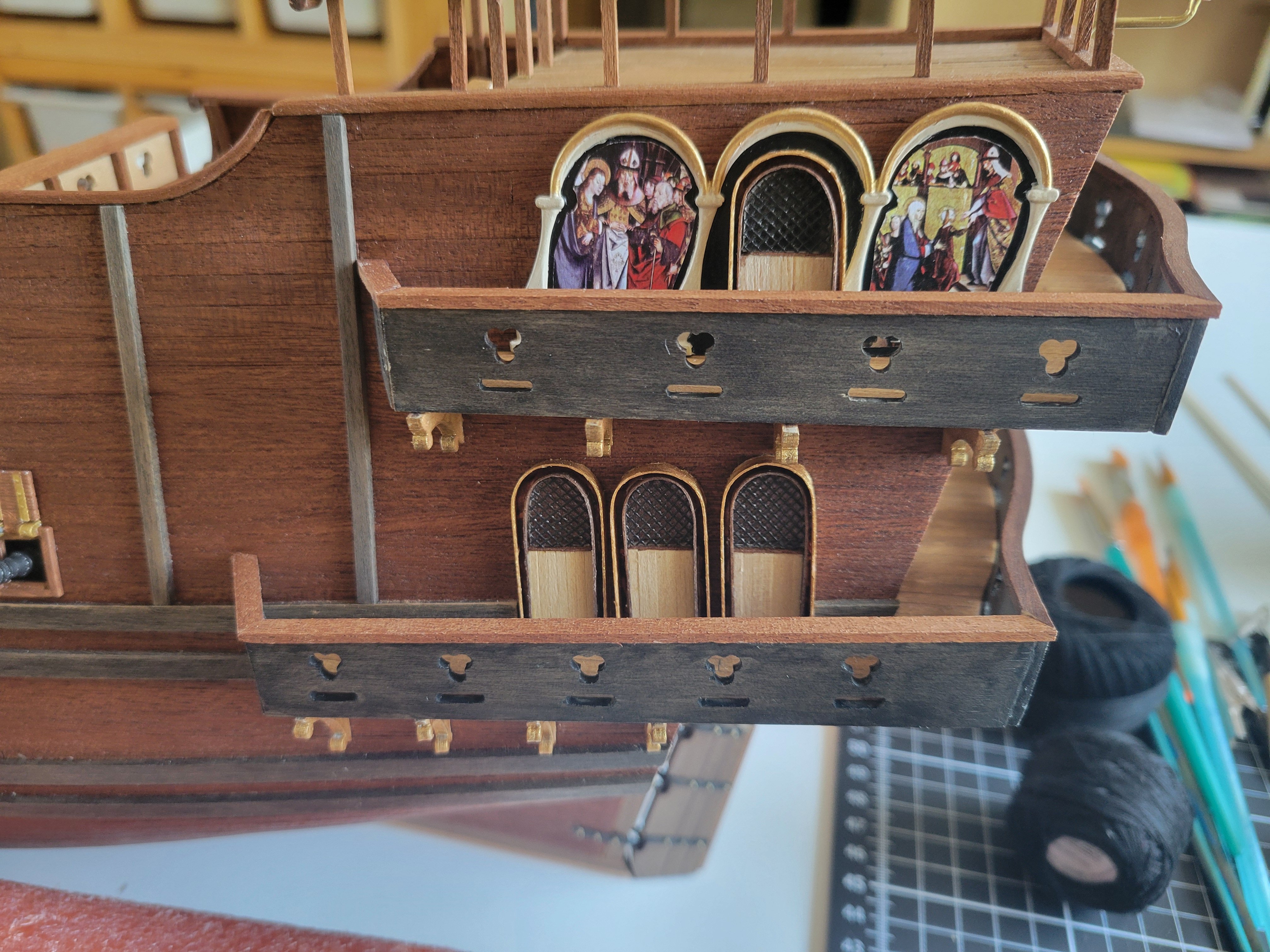

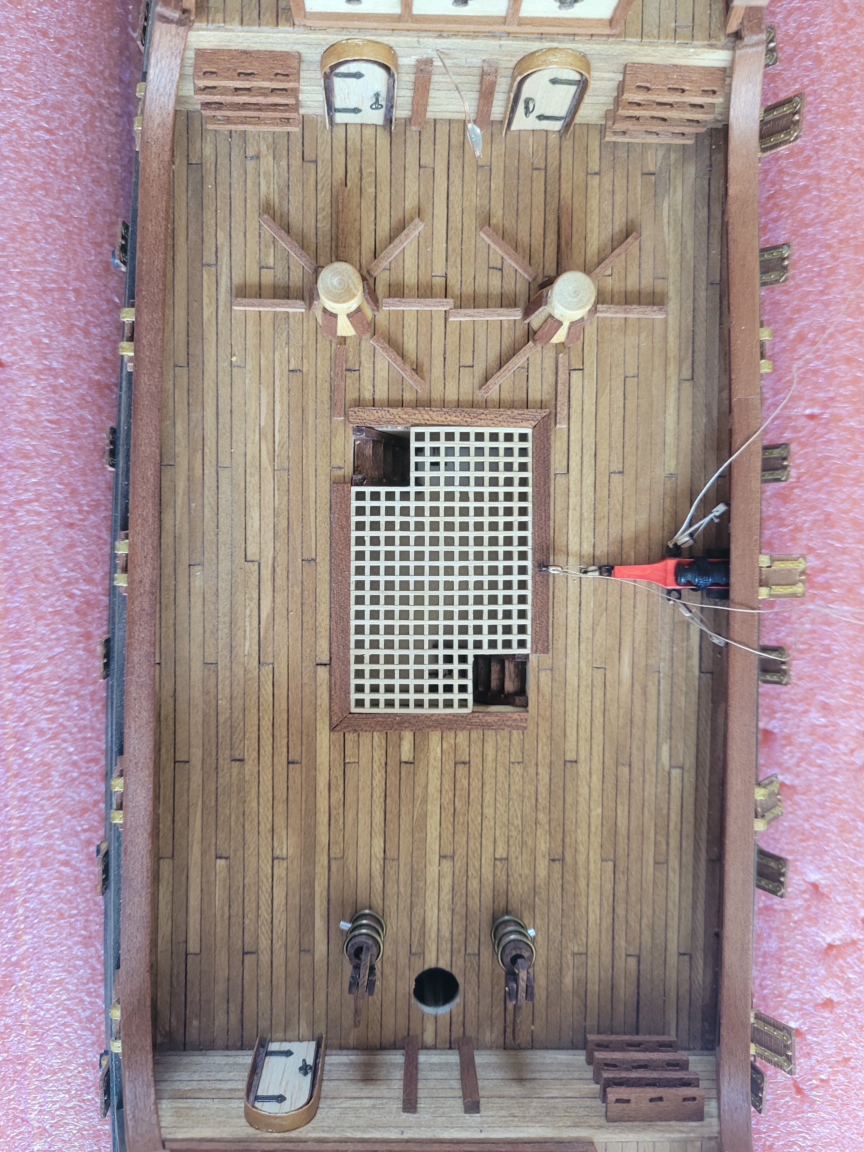

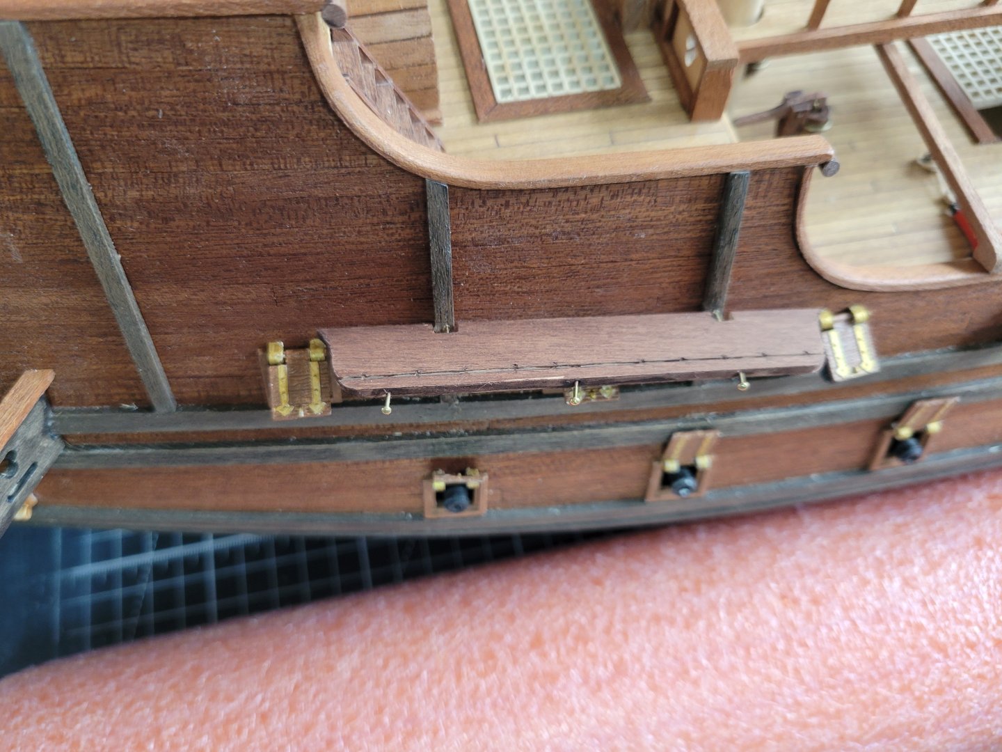

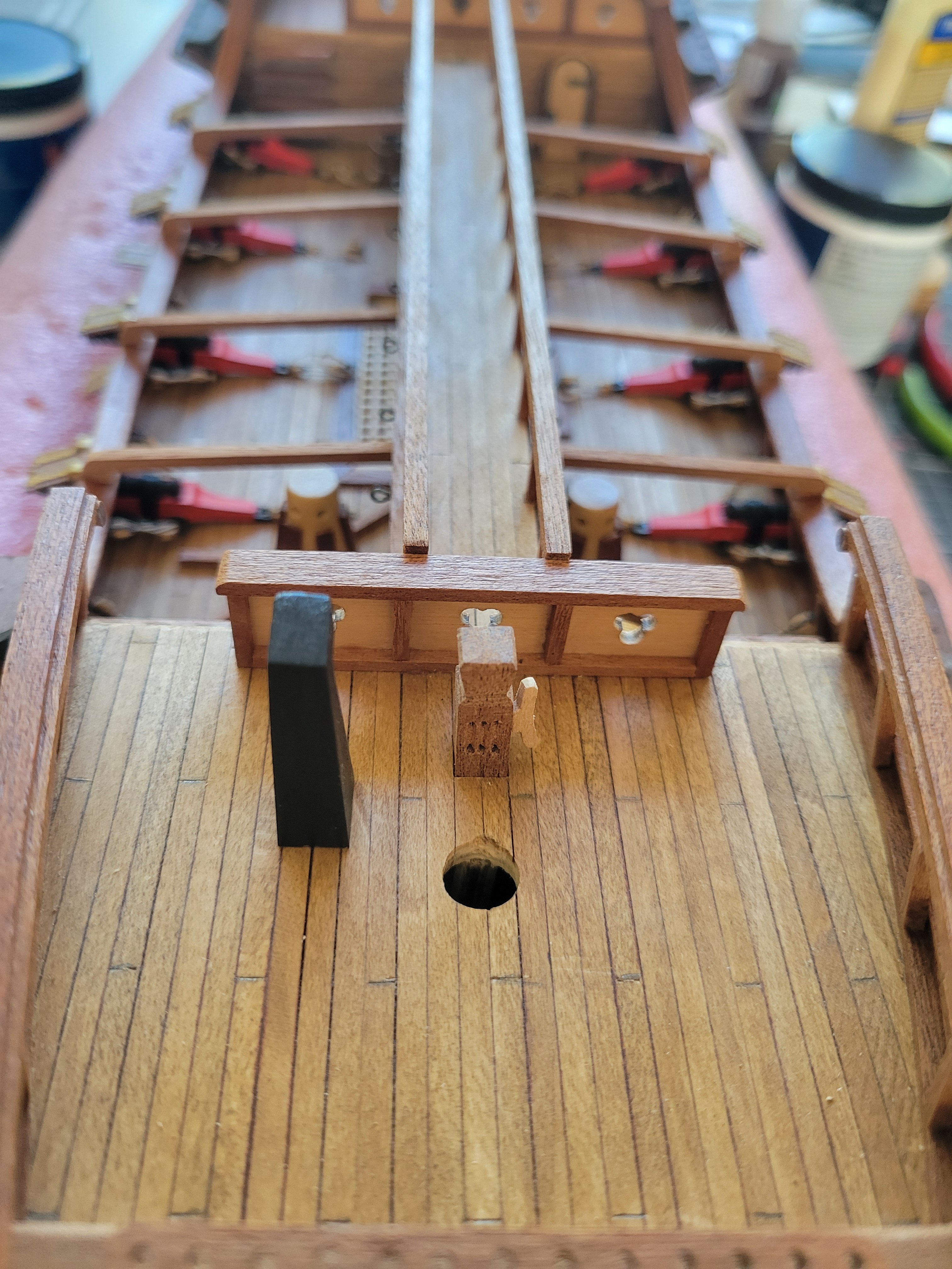

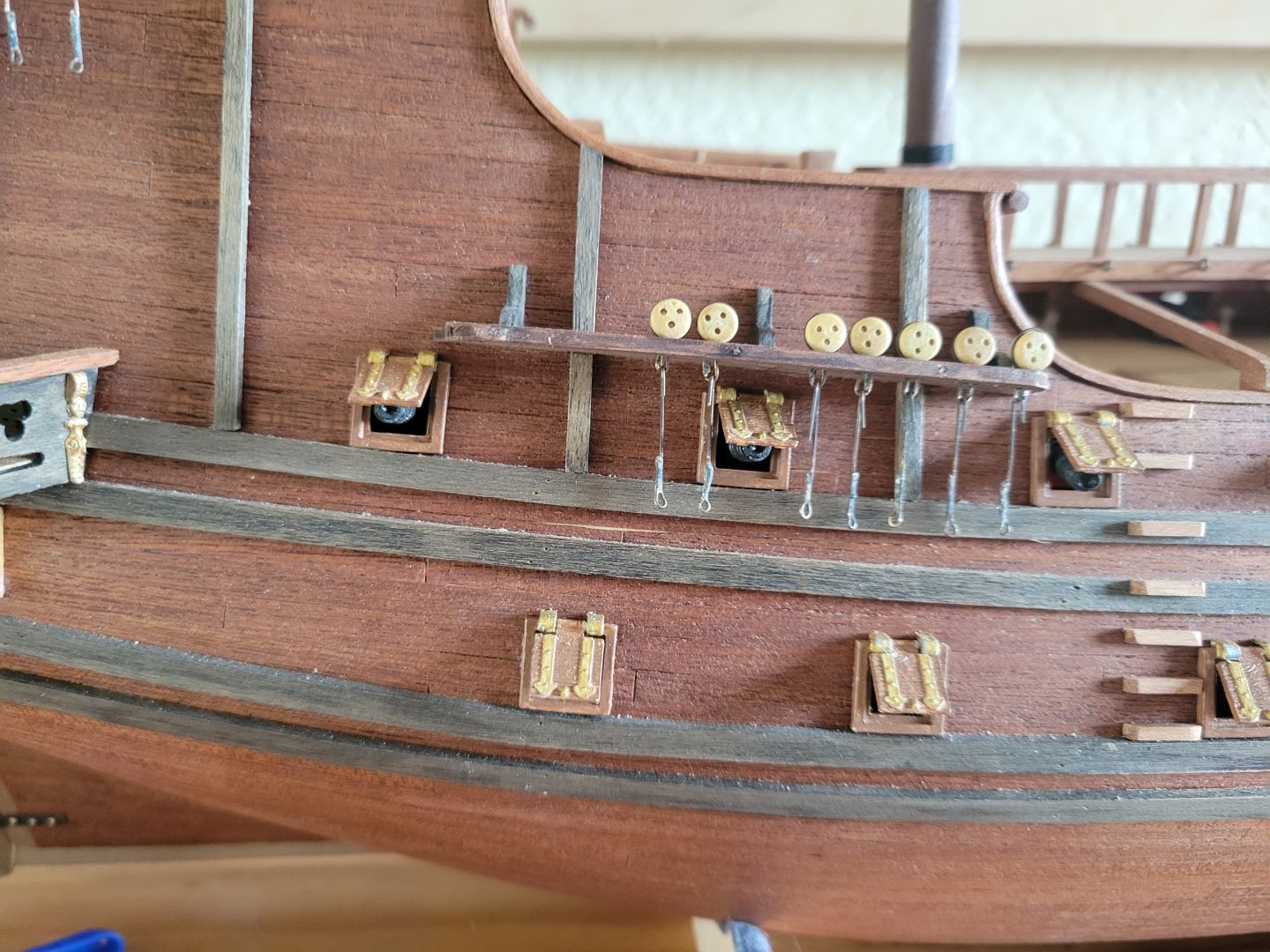

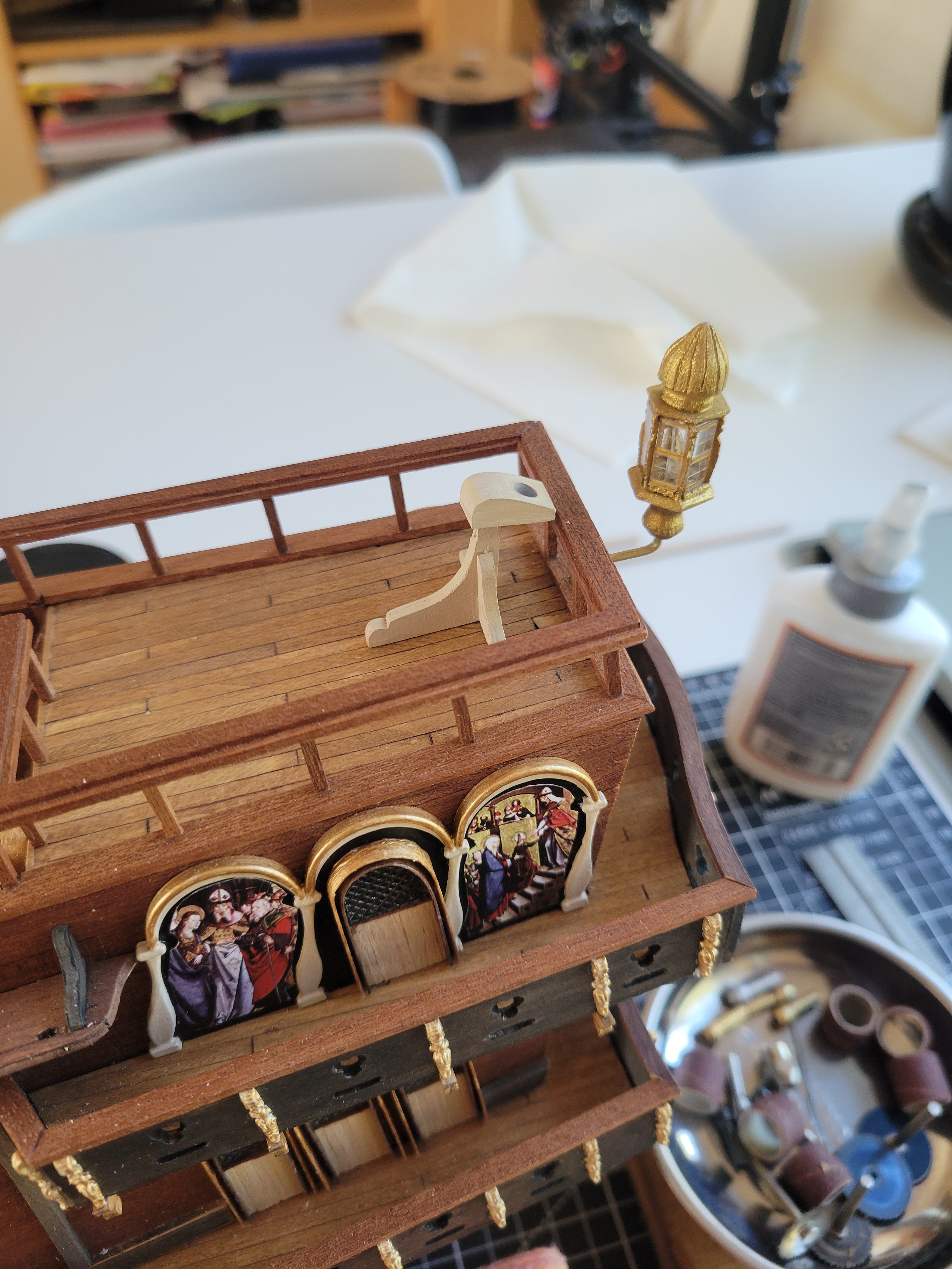

Lots to add since last post.  Finished the aft galleries (decided to change some the the door styles and all the doors are scratch made).  Gun ports in place (haven't decided how i want to hold them open yet.  Scale is small rigging but not crazy about just gluing them).  Some deck items added (scratch made pumps, ladders, capstans).

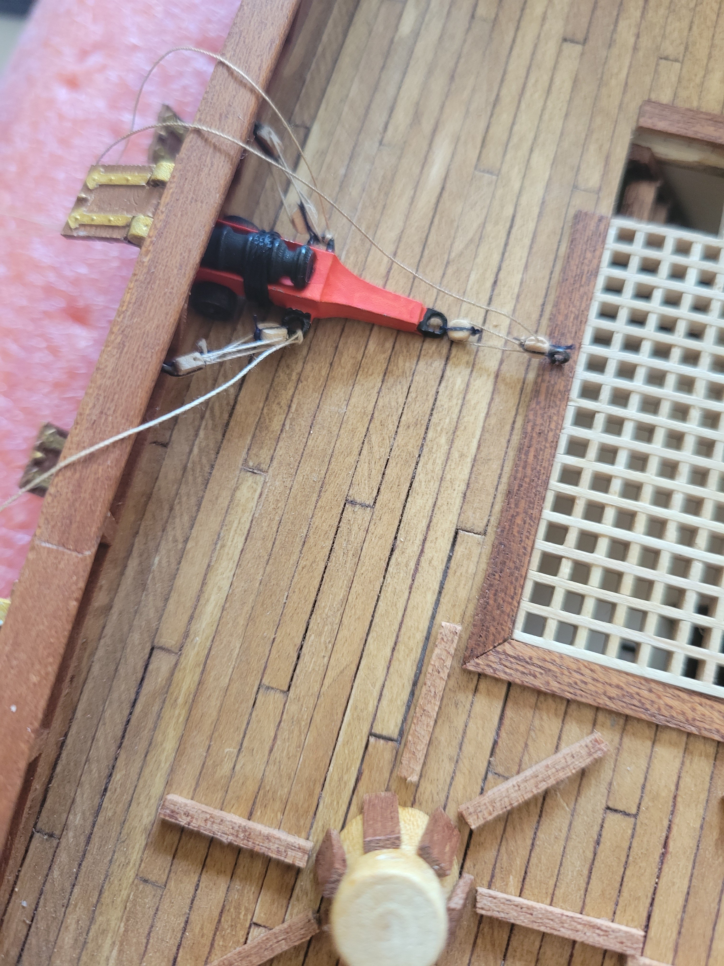

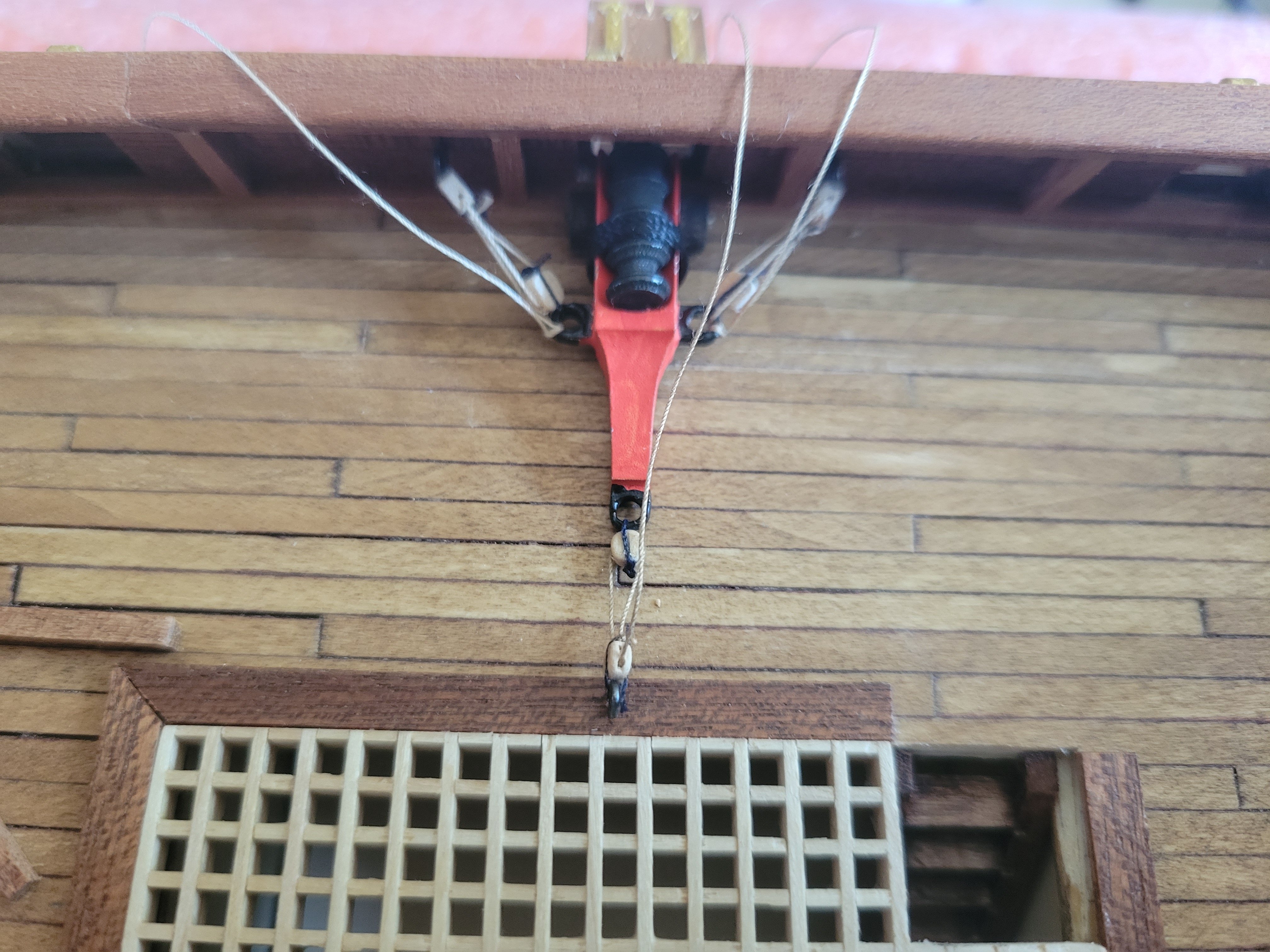

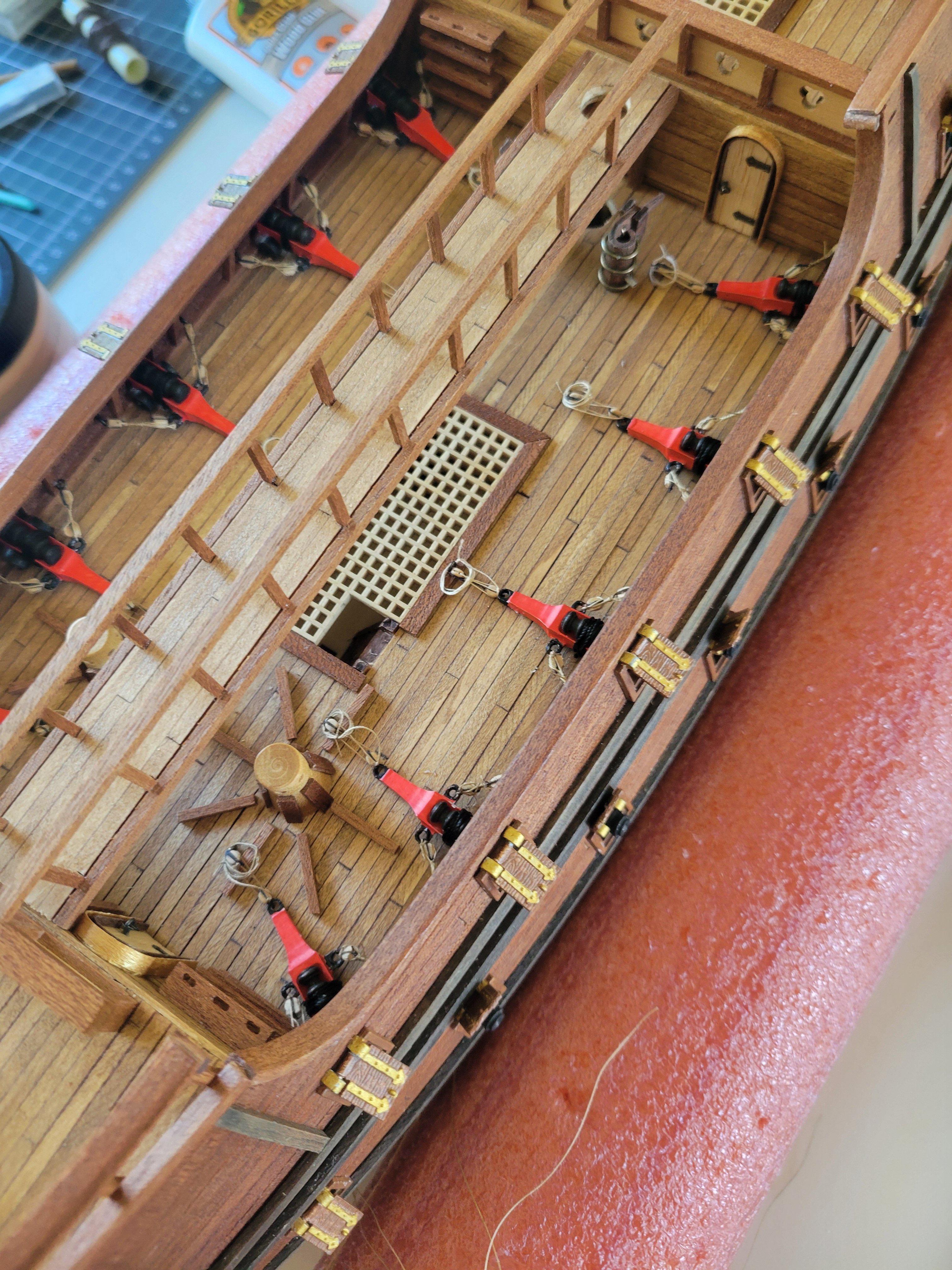

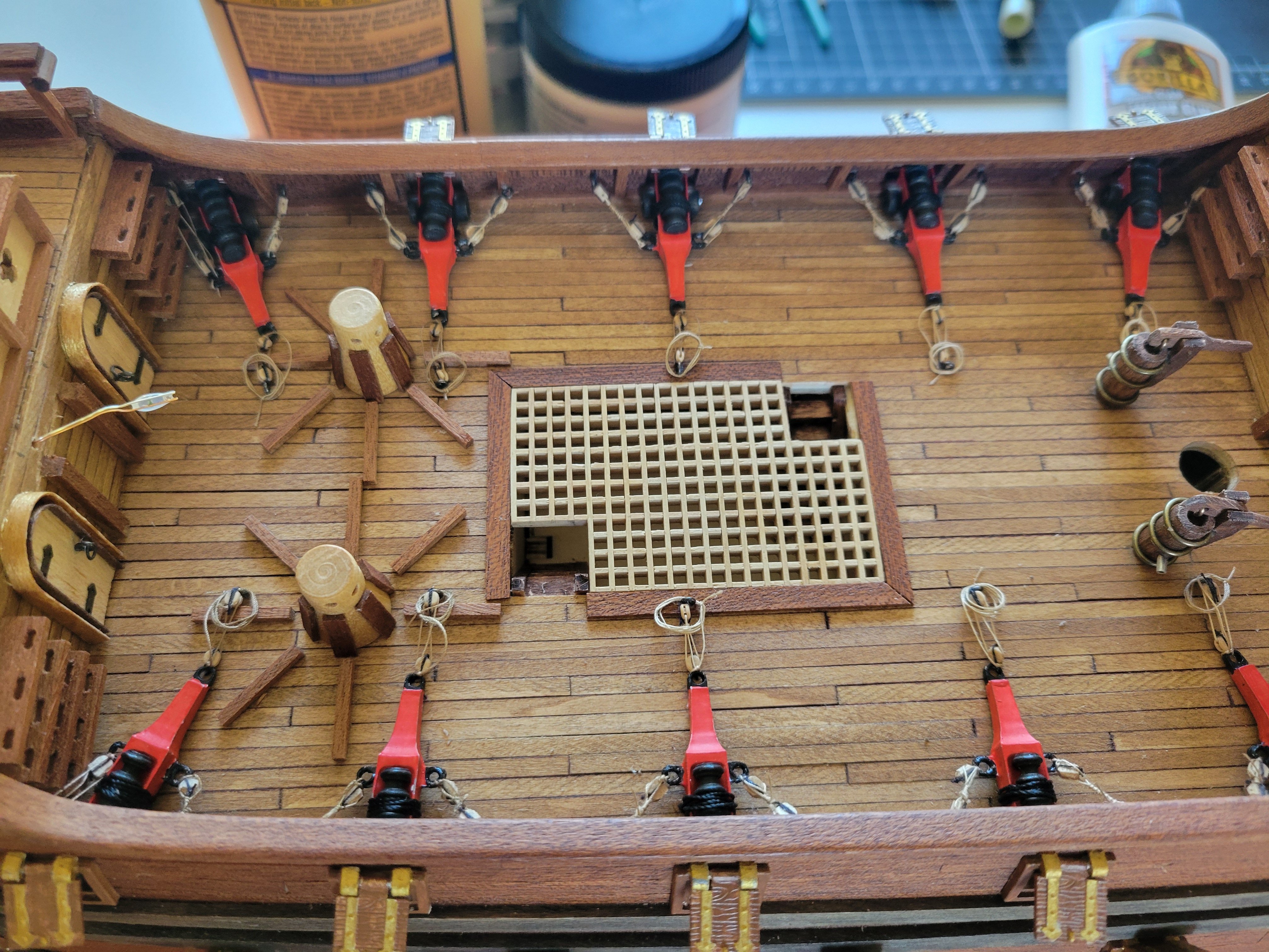

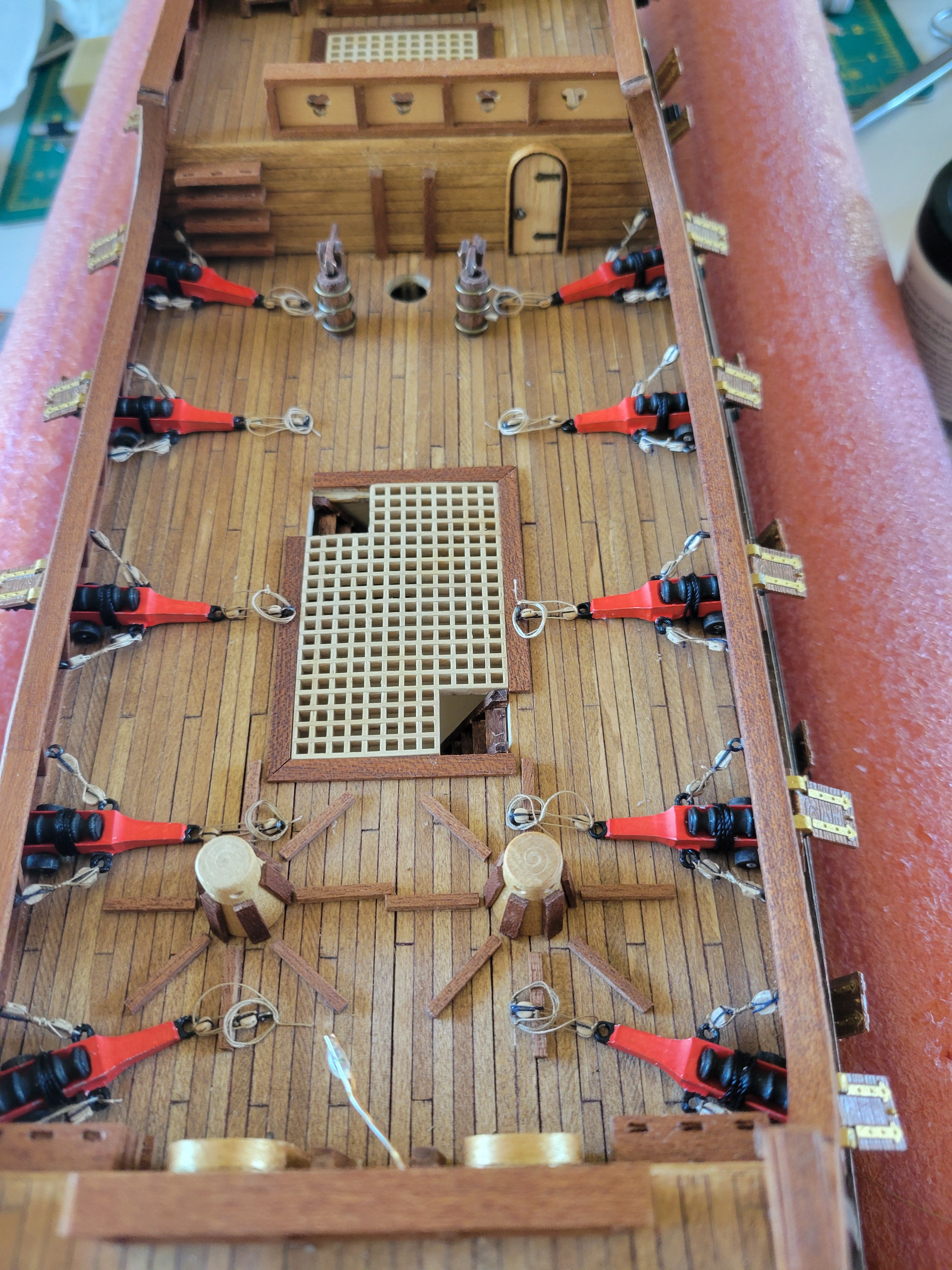

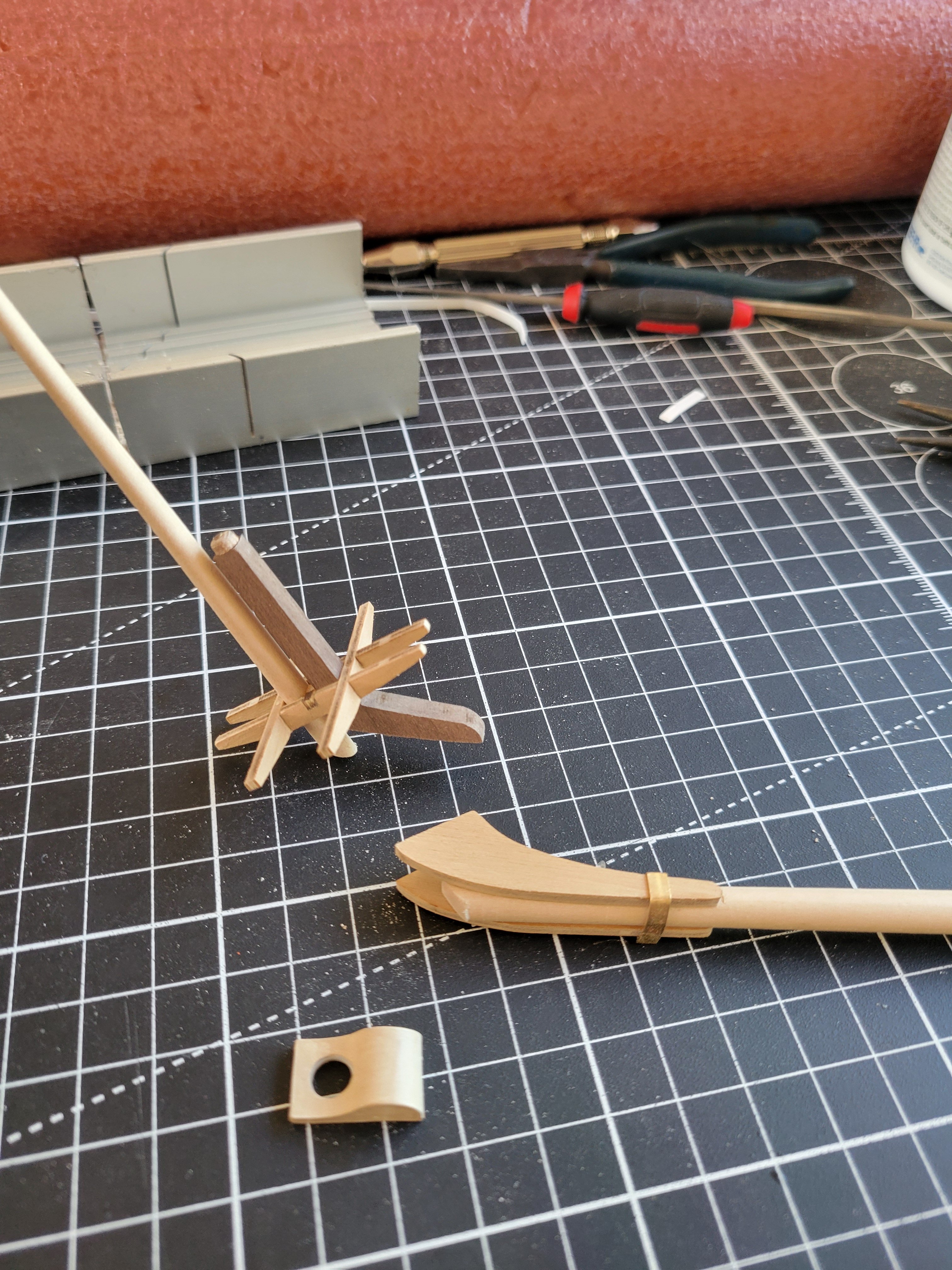

Working on the carriage guns.  Again, pretty small and kit was just glued on place without rigging.  Had a few 3/32" blocks and fabricating more to at least have some of the cannon rigging in place.

Is having two adjacent capstans historically accurate though?
Migt not.  I can't find evidence this particular ship actually existed as part of the spanish silver fleet so hard to say.  It still a good looking ship, even if it wasn't real so I'm just using this on more for artistic and fun than accuracy!
Working on the carriage guns and since I'm trying to actually replicate the rigging on the guns (kit has no rigging for this), I'm needing to order more blocks.  Tried making by hand but they just don't come out very well compared to the ones we can get from Syren (love his blocks and rope by the way!).  Don't want to get hit multiple times with shipping so I'm going to try for a single order which means I need to get all my rigging figured out!!  I used an excel spreadsheet with my last build and I'm updating to a newer version for this one.  I also used the rigging/block calculator spreadsheet from HiSModel and I'm liking the result.   I may not use as many rigging sizes but it's a good starting point.  I'm providing a link here to both files on goole drive if anyone wants to take a look (should be re-usable for other builds, just clear the values and fill it out!).  I'm really interested in feedback from anyone who has already built the Apostol Felipe or in progress (call out to @Slowhand who's running at a similar pace to me!)
Rigging Plan: https://docs.google.com/spreadsheets/d/1qdIoDKW4J_ew731MBVsXbNcc1gGYI1vB/edit?usp=sharing&ouid=105861869683818061516&rtpof=true&sd=true
HiSModel Sizing Spreadsheet: https://docs.google.com/spreadsheets/d/1lAamZoHs4X4V92qfZpVcueICTyBd3p9-/edit?usp=sharing&ouid=105861869683818061516&rtpof=true&sd=true
Also, if anyone has questions updating this to their own build, I'm happy to walk it through.  It's my own "method to my madness" but I hope others might find it usefull.  In the rigging plan, the first tab is seting up "picklists"  Second tab it the primary work.  Remaining tabs are just collections of screenshots I gathered to help figure out the specific rigging setups I will probably use.

I think the central walkway above main deck makes positioning one capstan difficult.

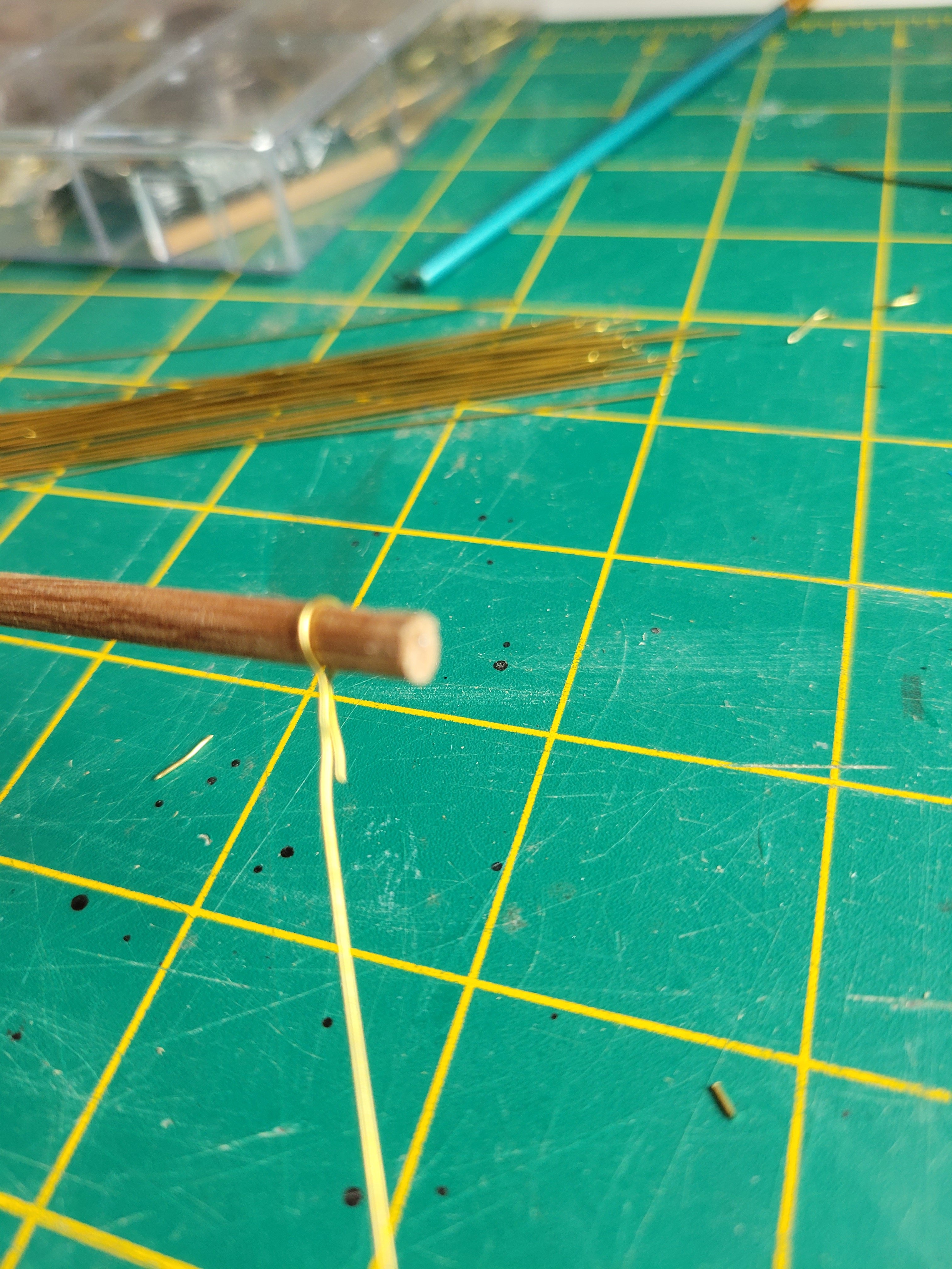

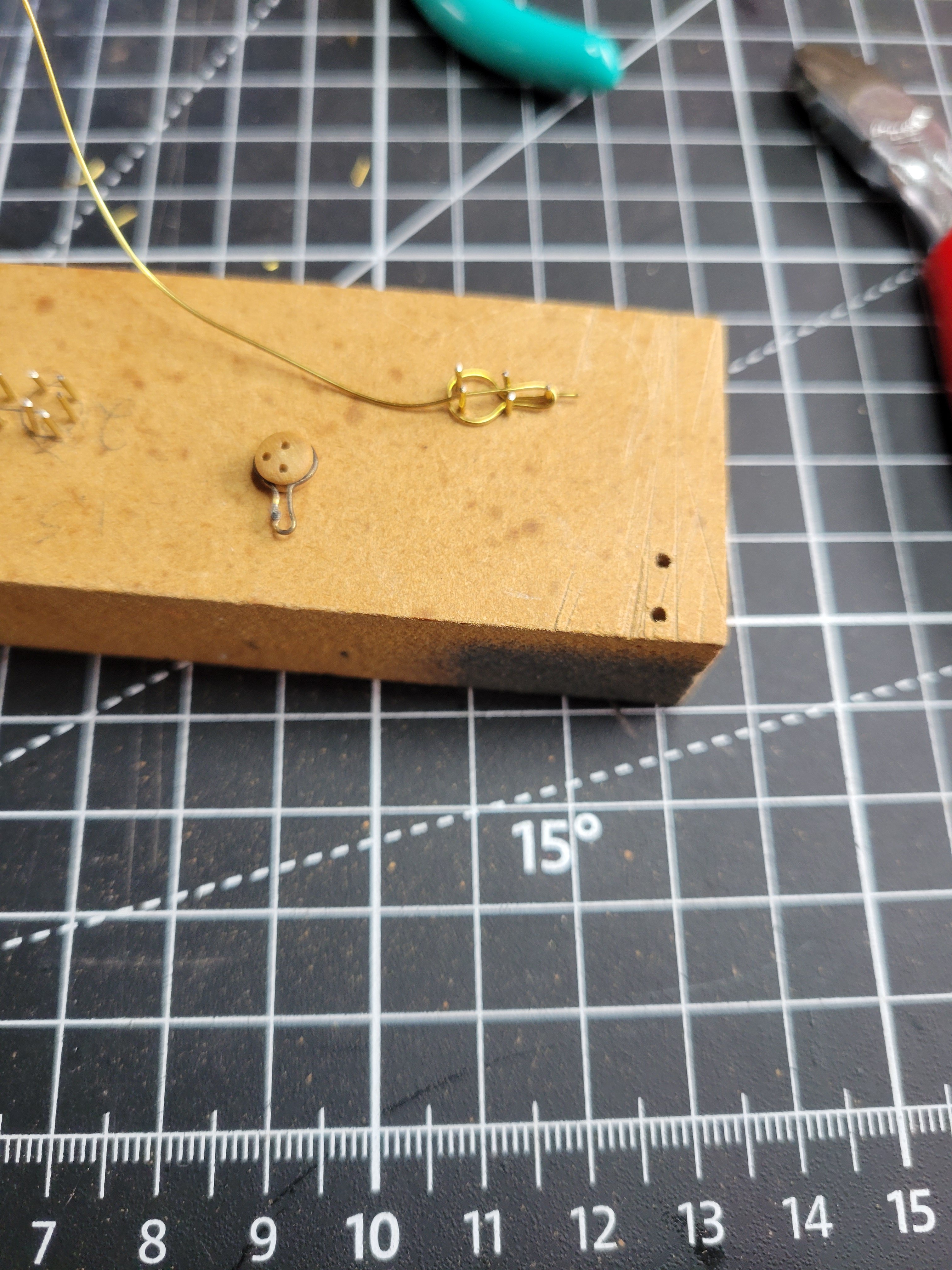

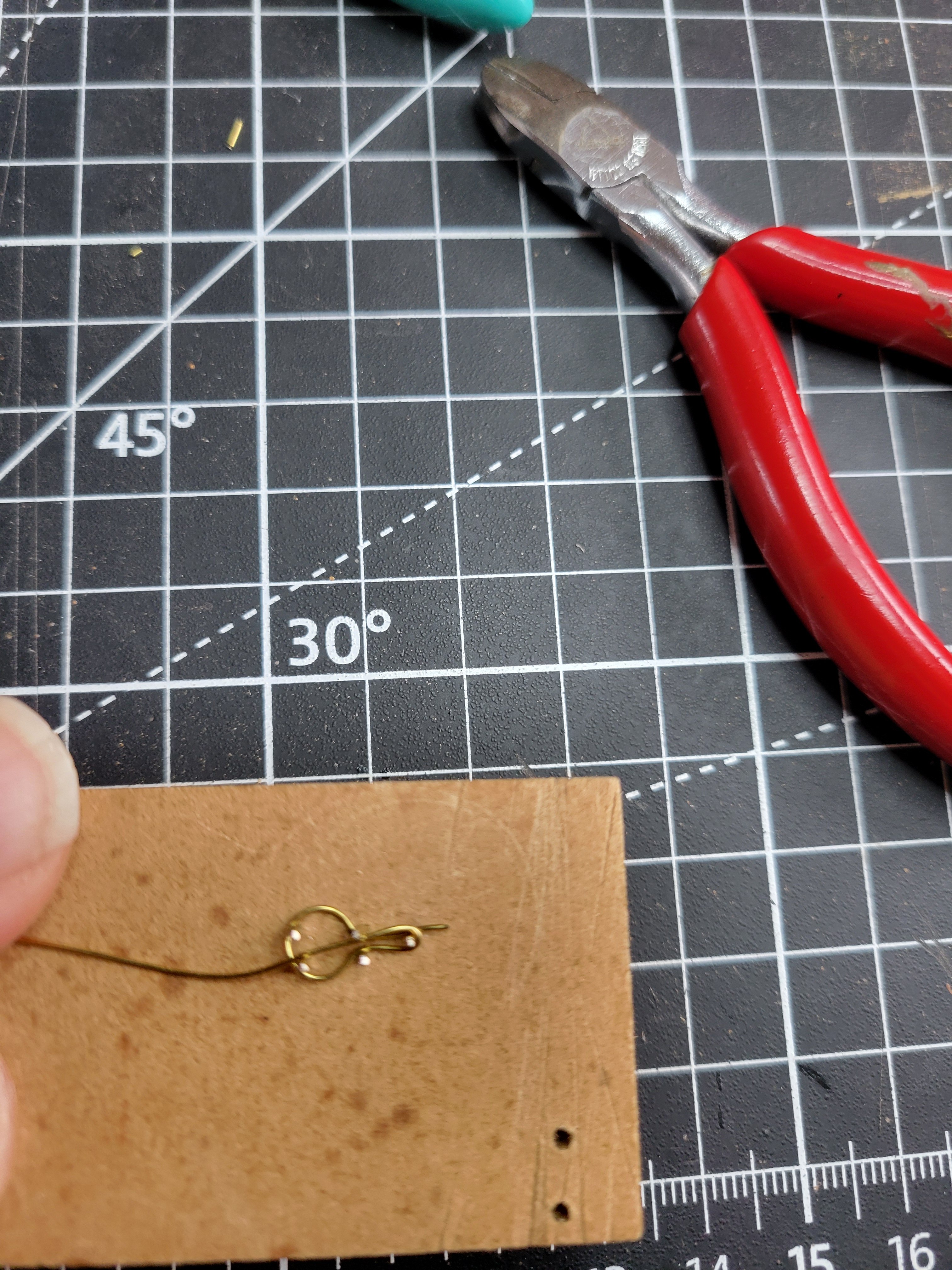

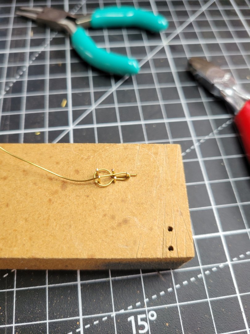

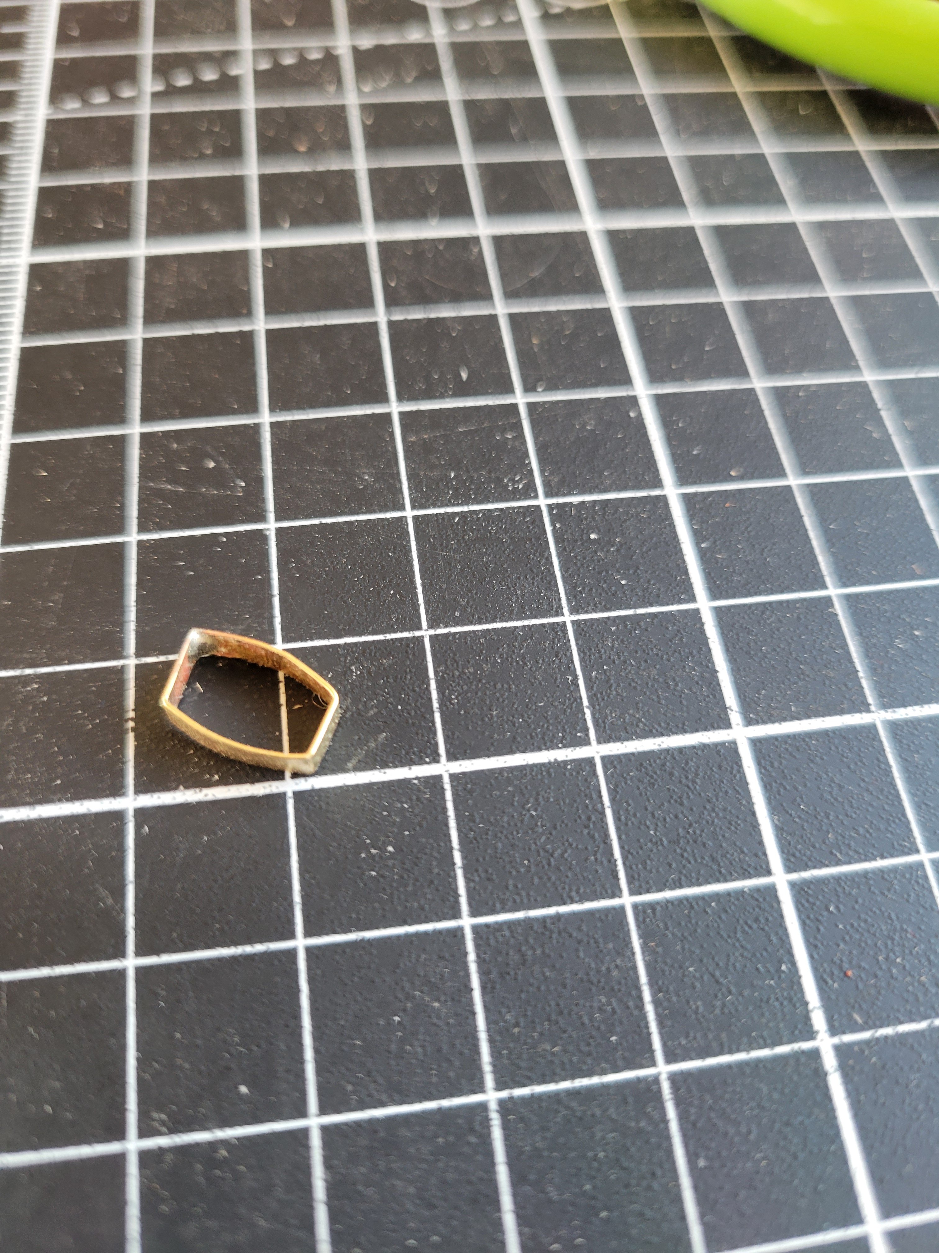

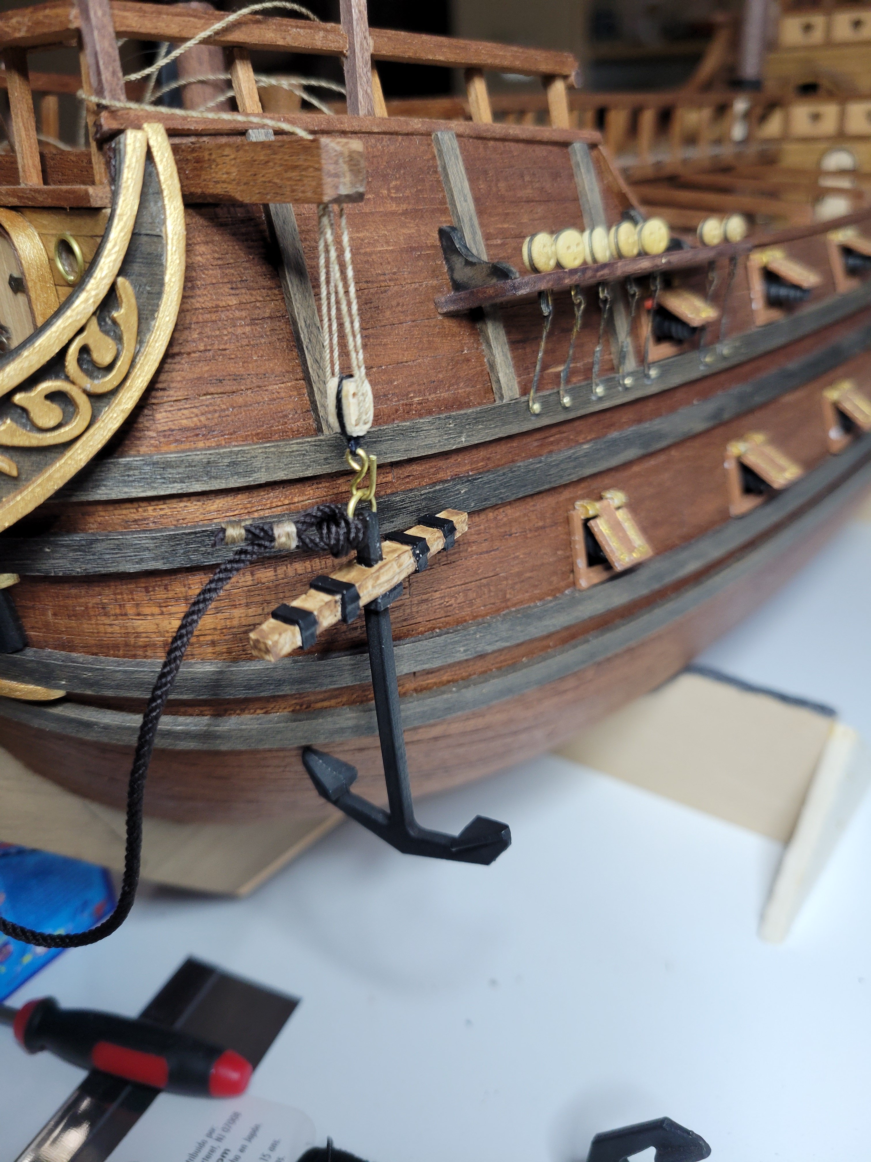

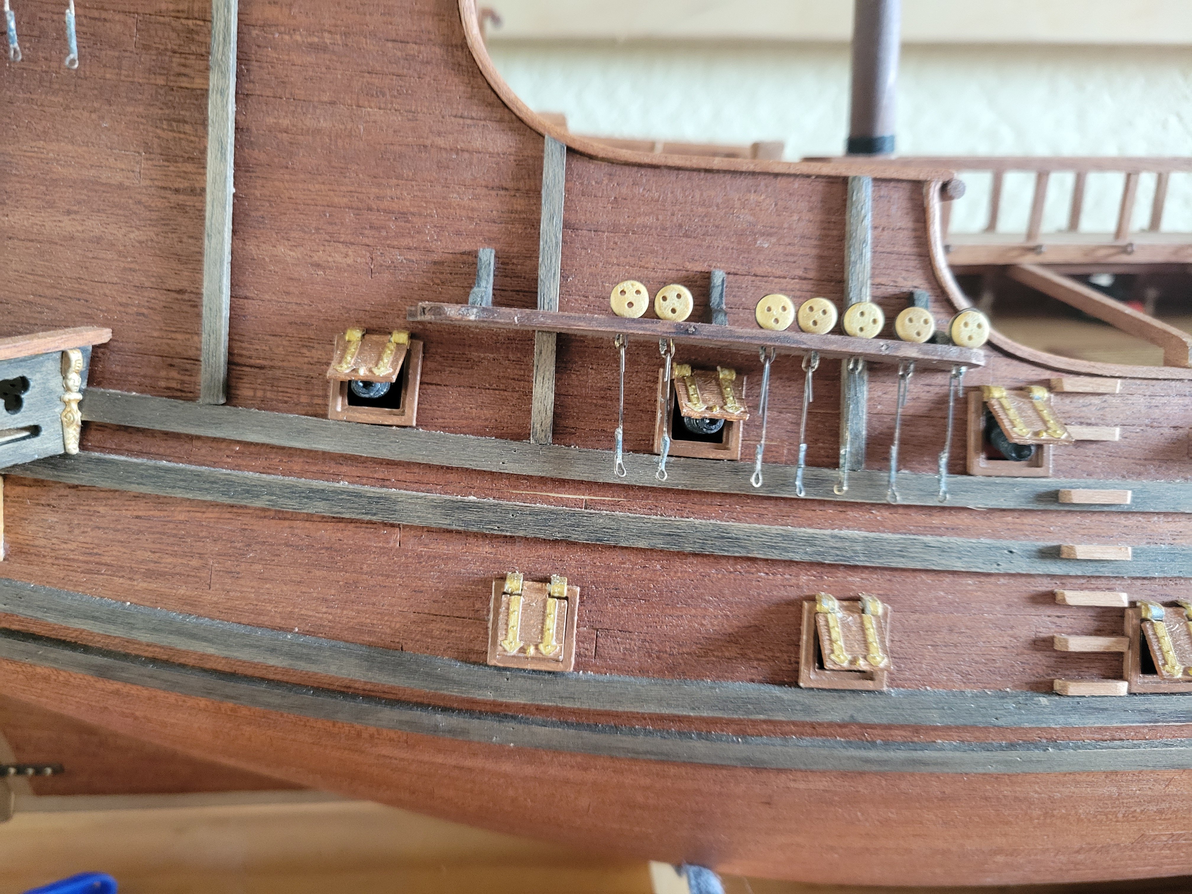

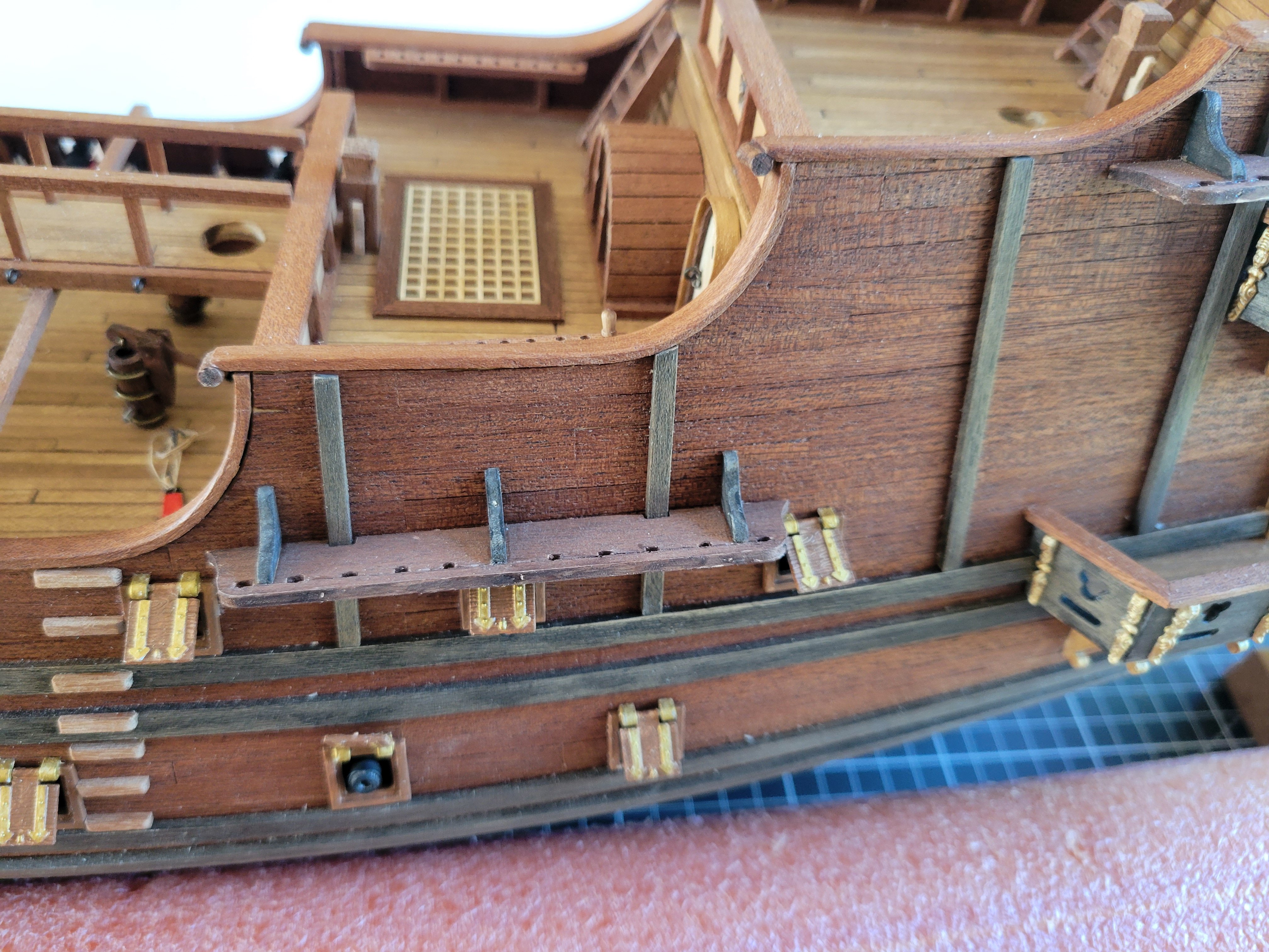

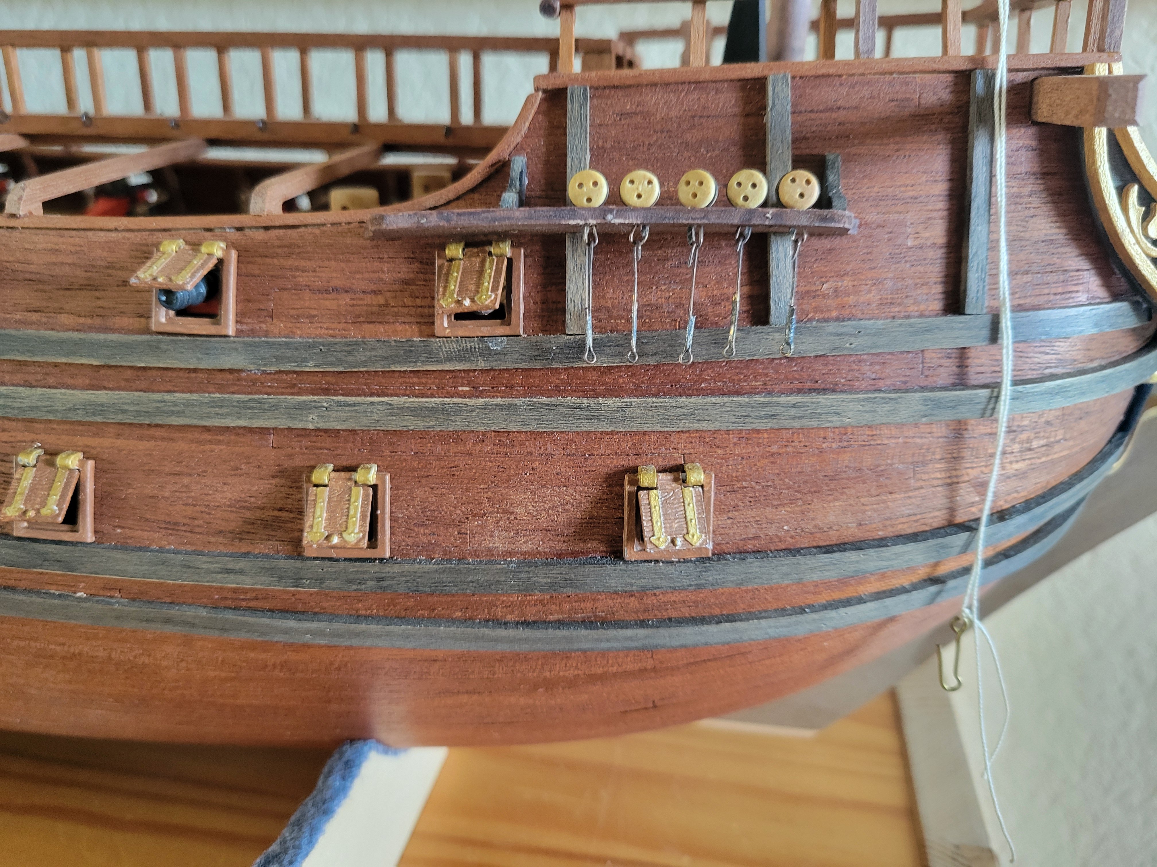

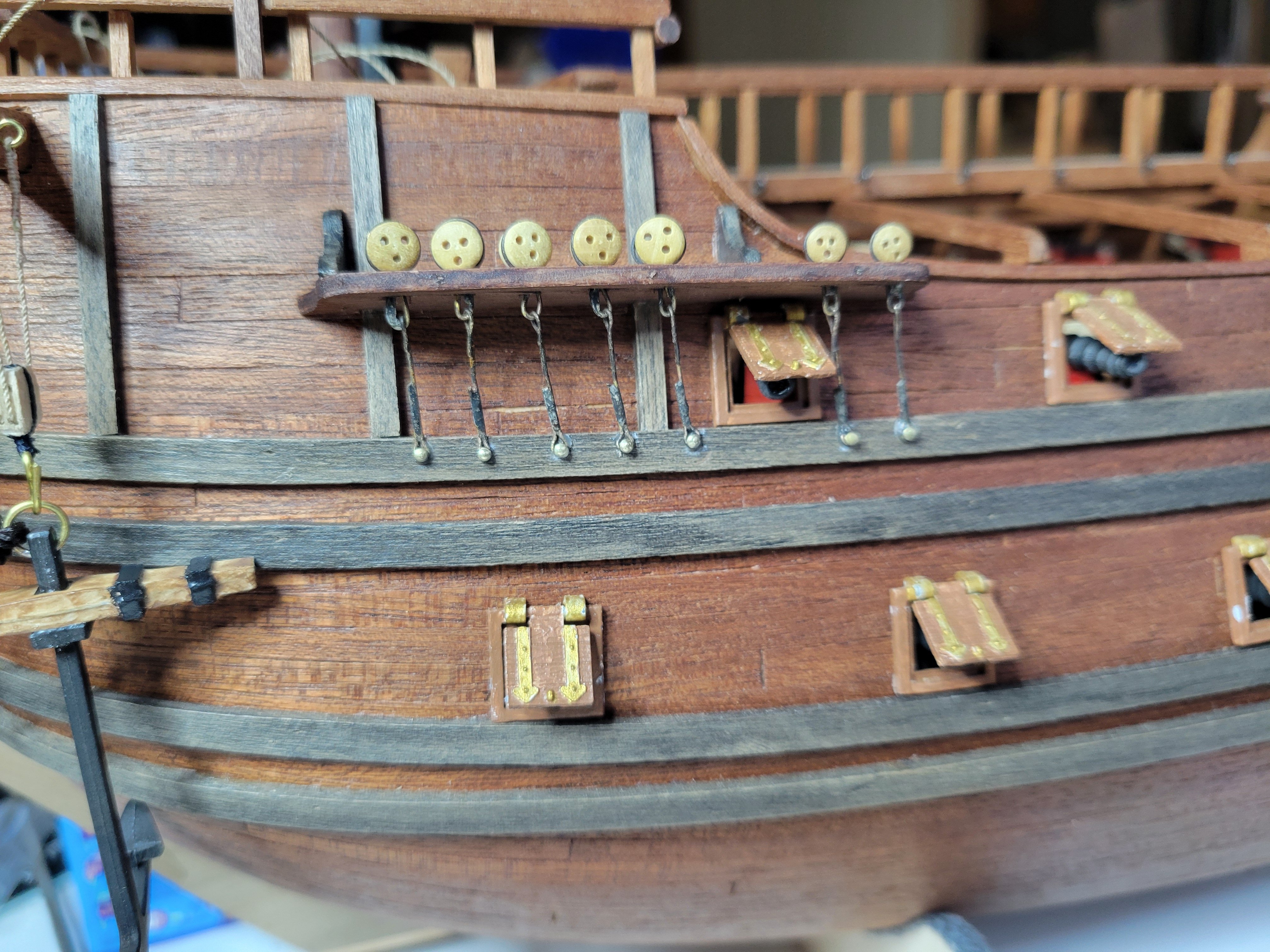

Channels and chainplates.  Im just off the end of the channel to replicate a more classic approach of adding the strip to the end of the channel rather than just drilling holes.
For the chainplates, trying this time to follow a proper approach with soldered chainplates.  Found the right diameter dowel to match the deadeyes.  Setup a jig and the solder, blacken, and set the deadyeye.

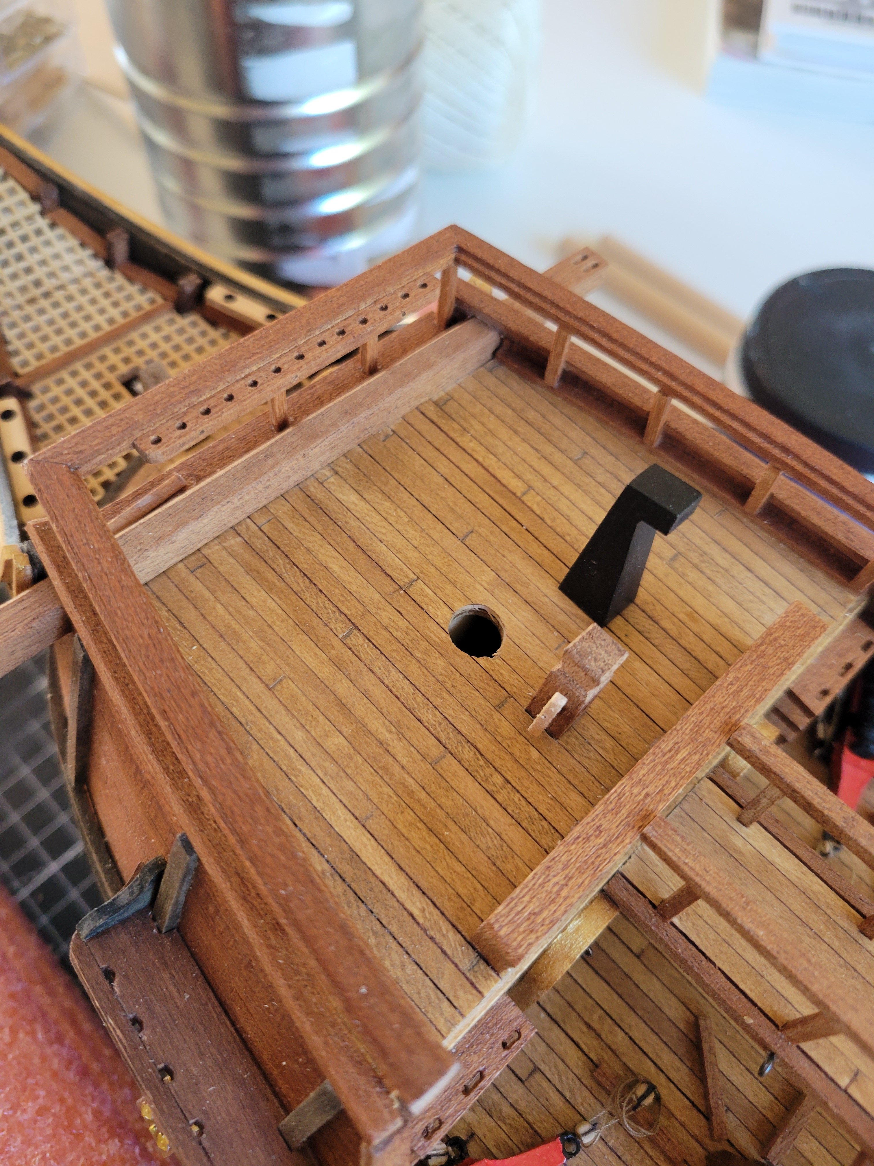

Jack staff stand assembled.
Channels assembled and stained.
Adding pin rails.  Using a dremel press to allow brass pins to strengthen.  Adding extra pins too and may add extra pin rails instead of the sad eyeballs in the deck these kits like to use.

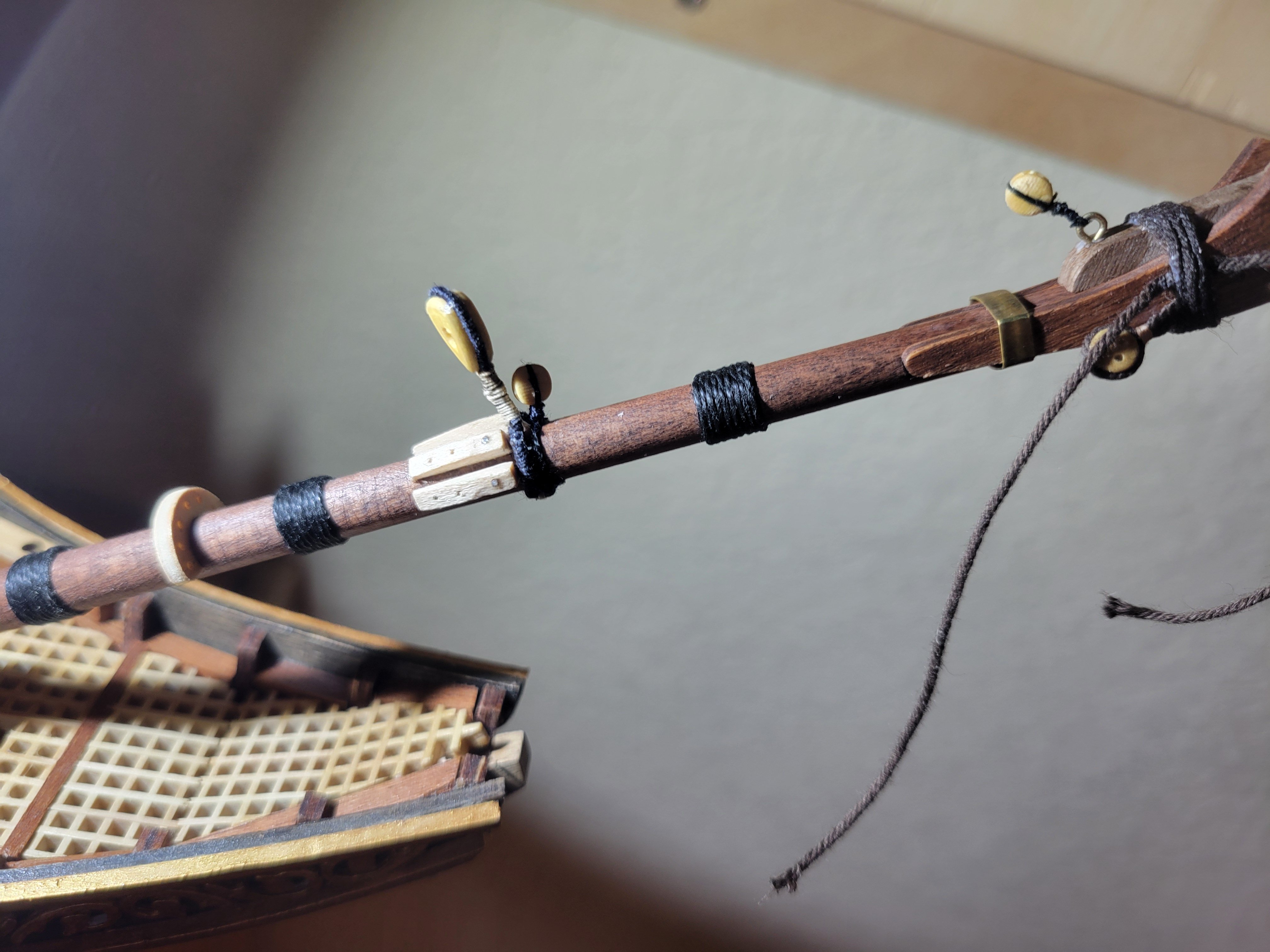

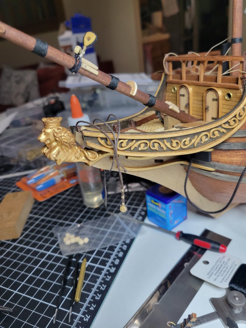

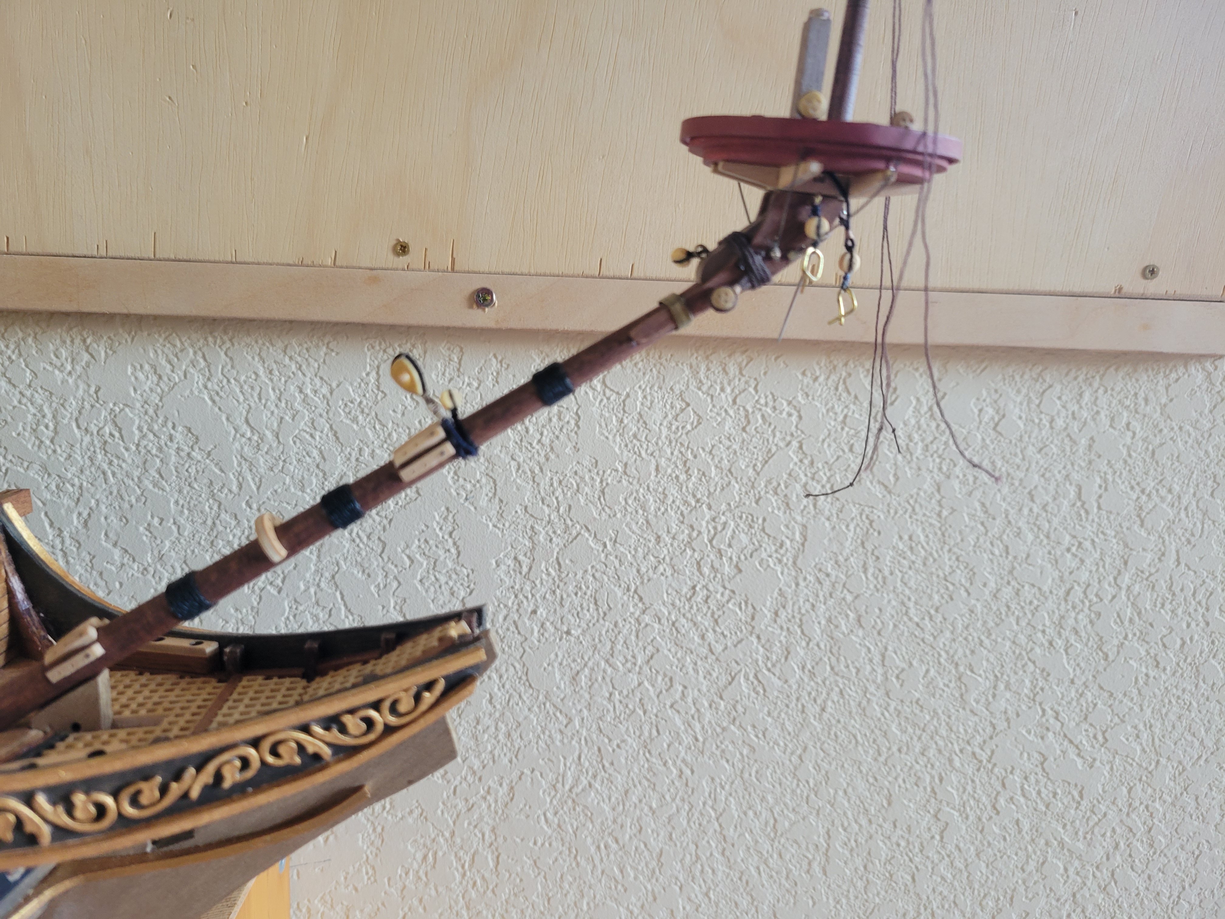

Soldered the brass band for the bowsprit.  Dry fitting spritsail topmost to bousprit.  Took some research to figure out right connection at the knee there.  I think the spanish followed the Dutch in thar period so in that case, I've got the bousprit running up to the sprit mast.  Later (and English) would put the sprit topmost on top of the bousprit and I think a lot of kits so that but I think it would be wrong for spanish treasure fleet or armada ships.

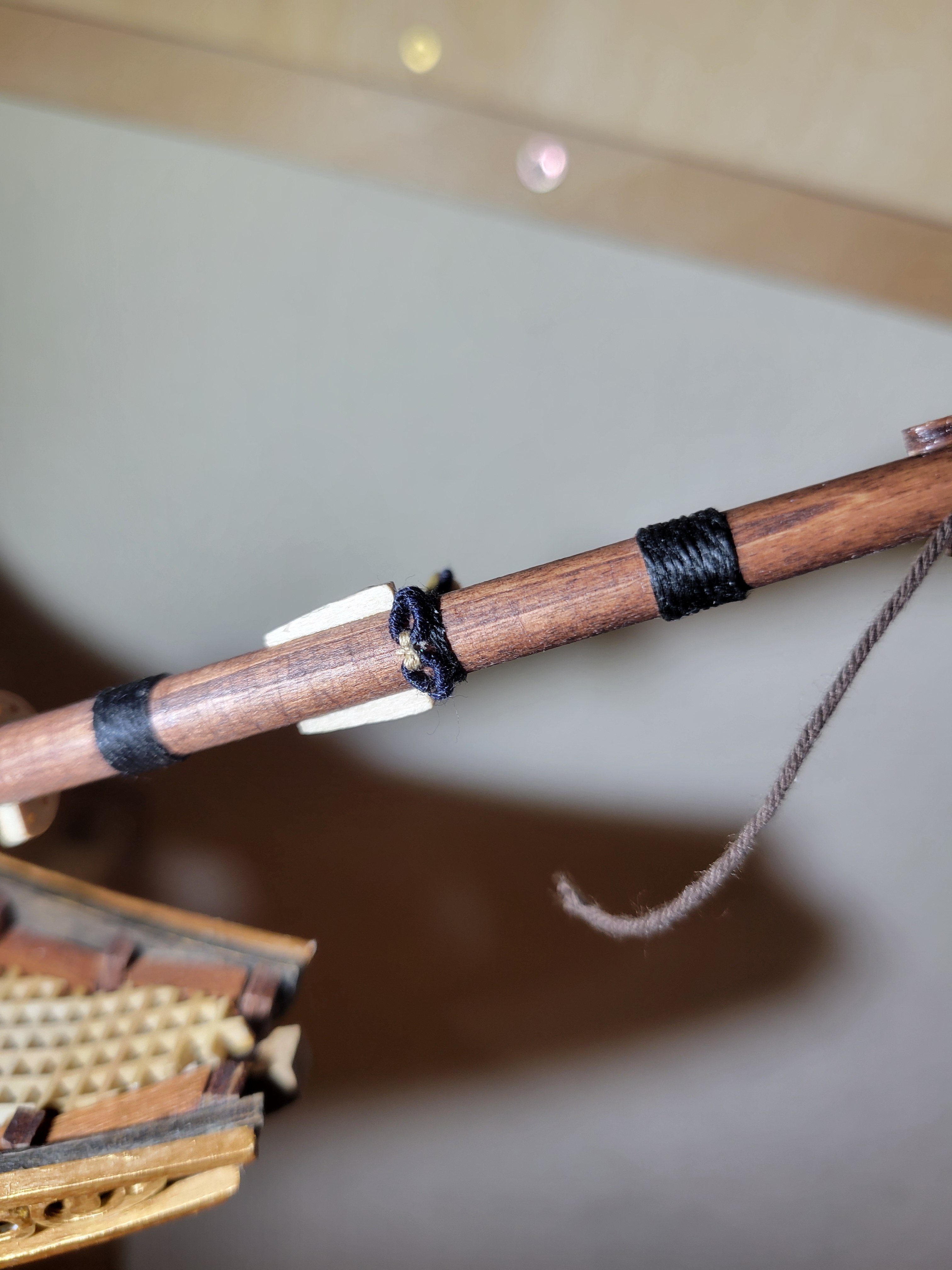

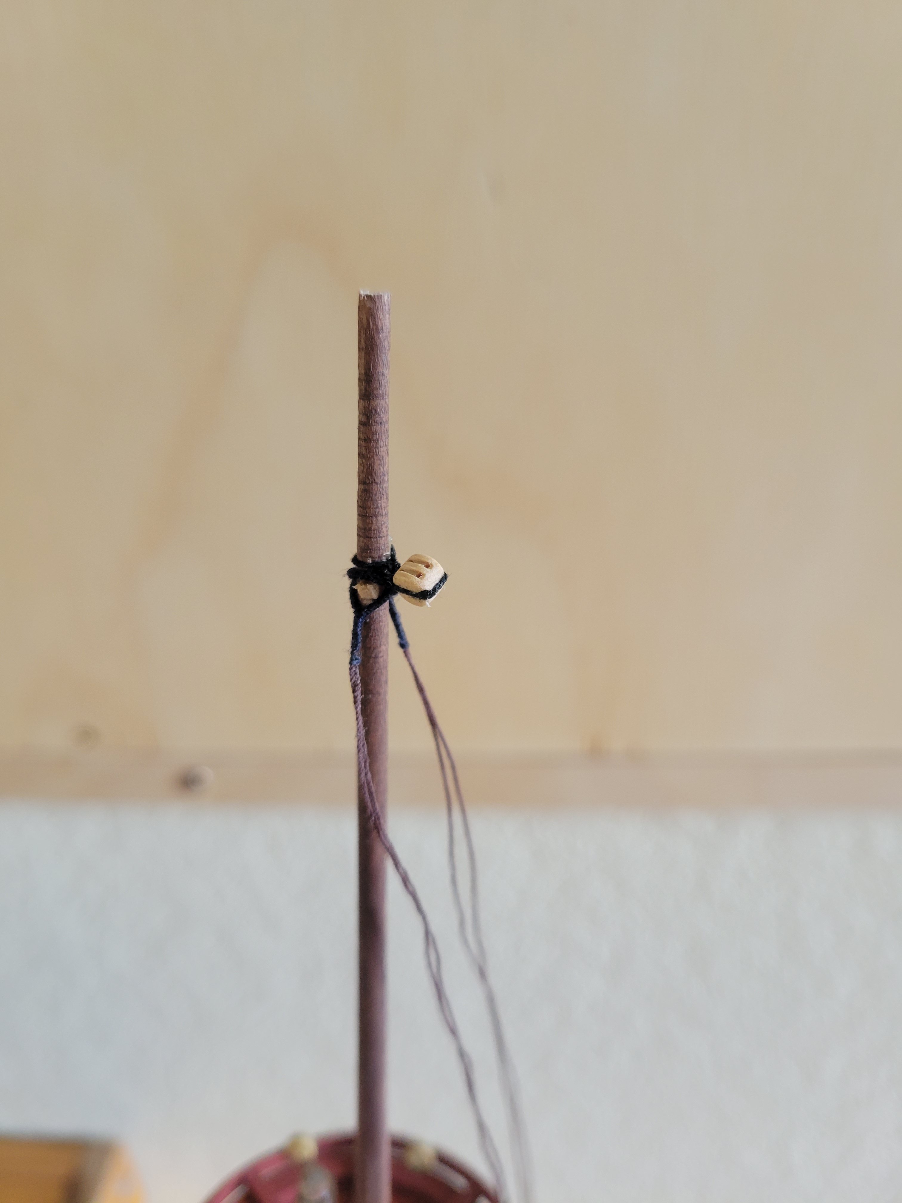

More updates.  Continuing the bousprit.  Stained, woldings, fairness color, bobstay deadeyes and topgalant stay blocks.  Forestay collar is served with two eyes lashed to draw tight.

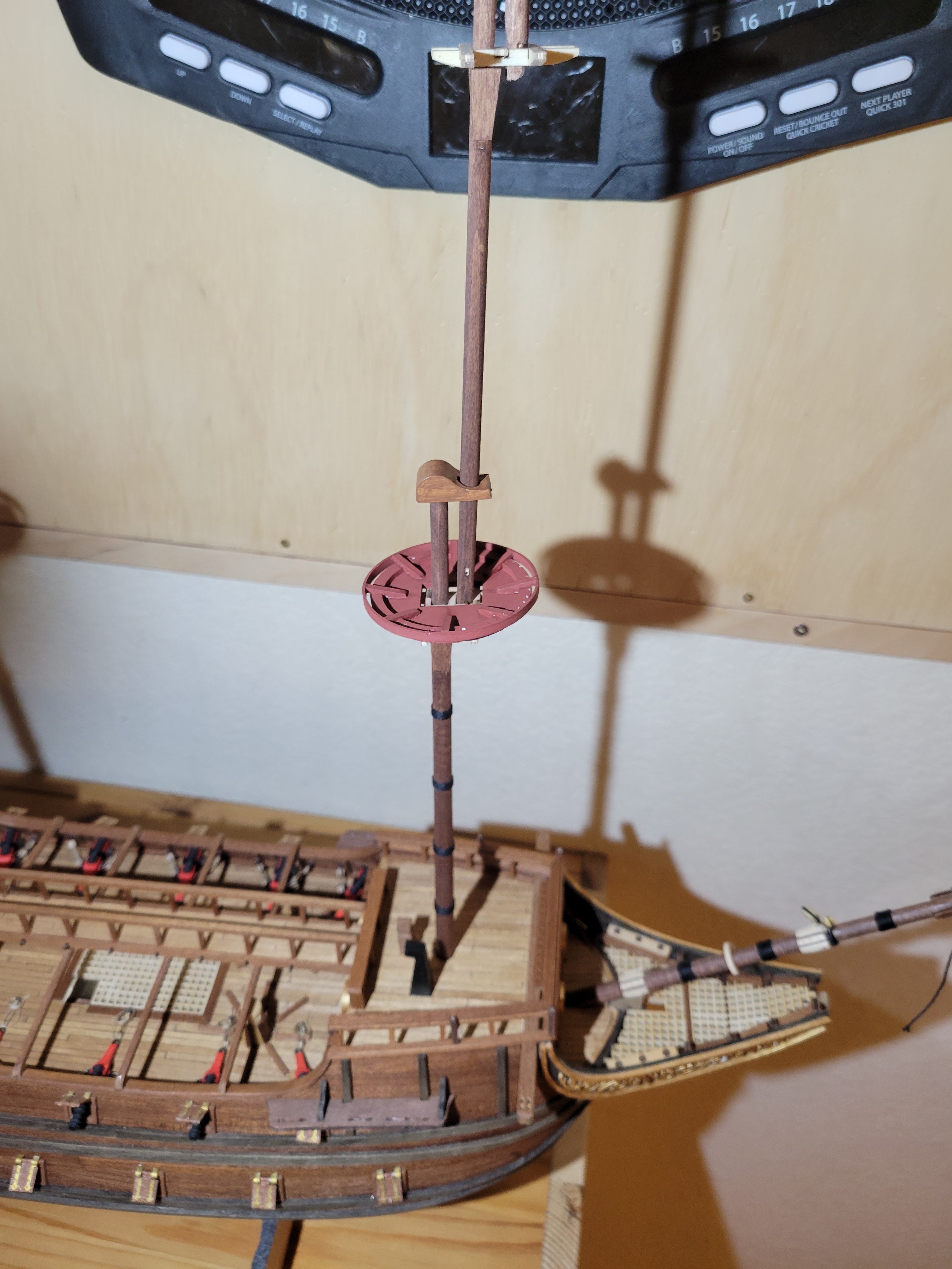

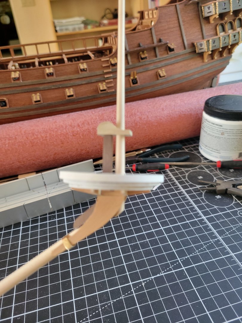

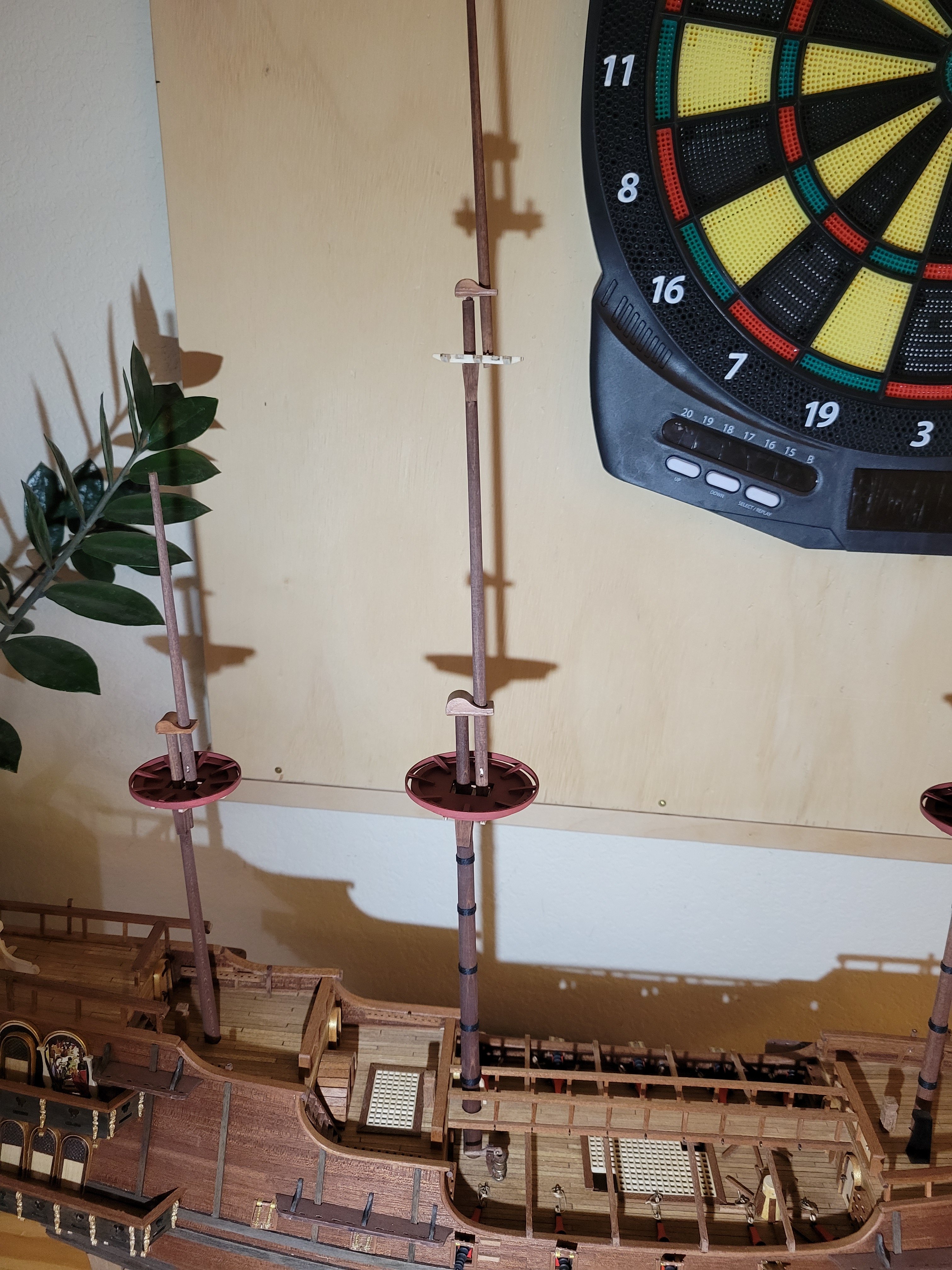

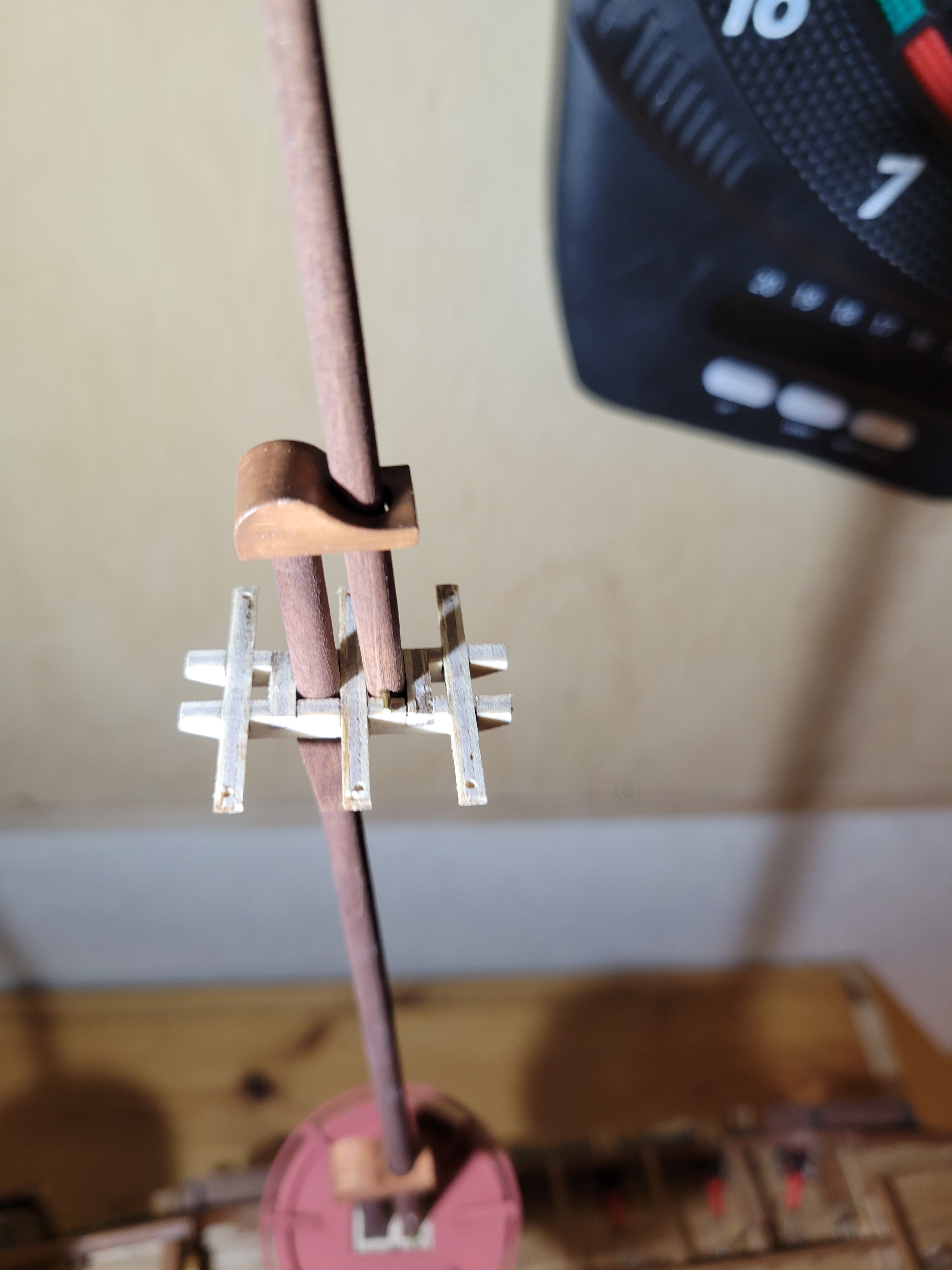

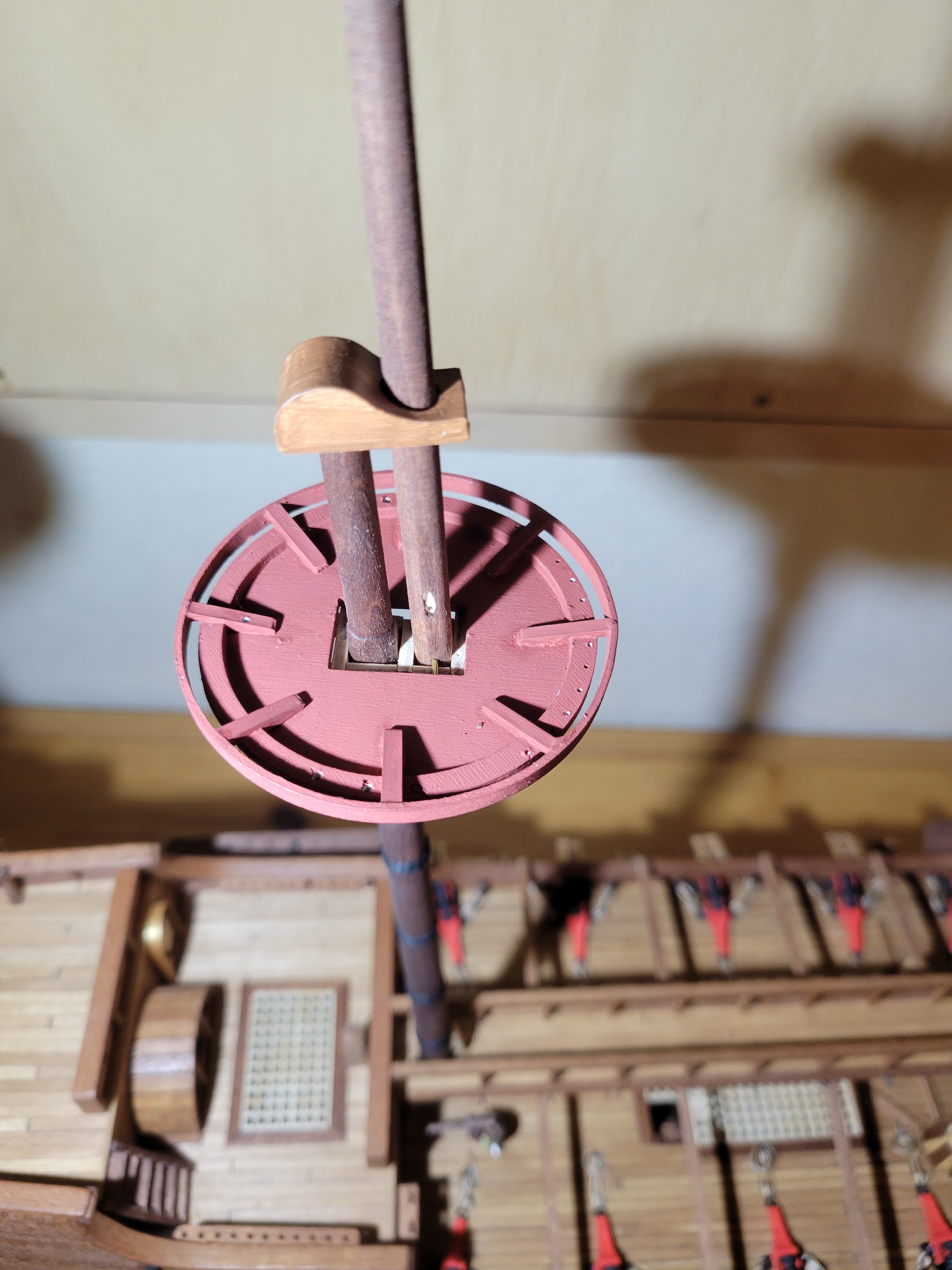

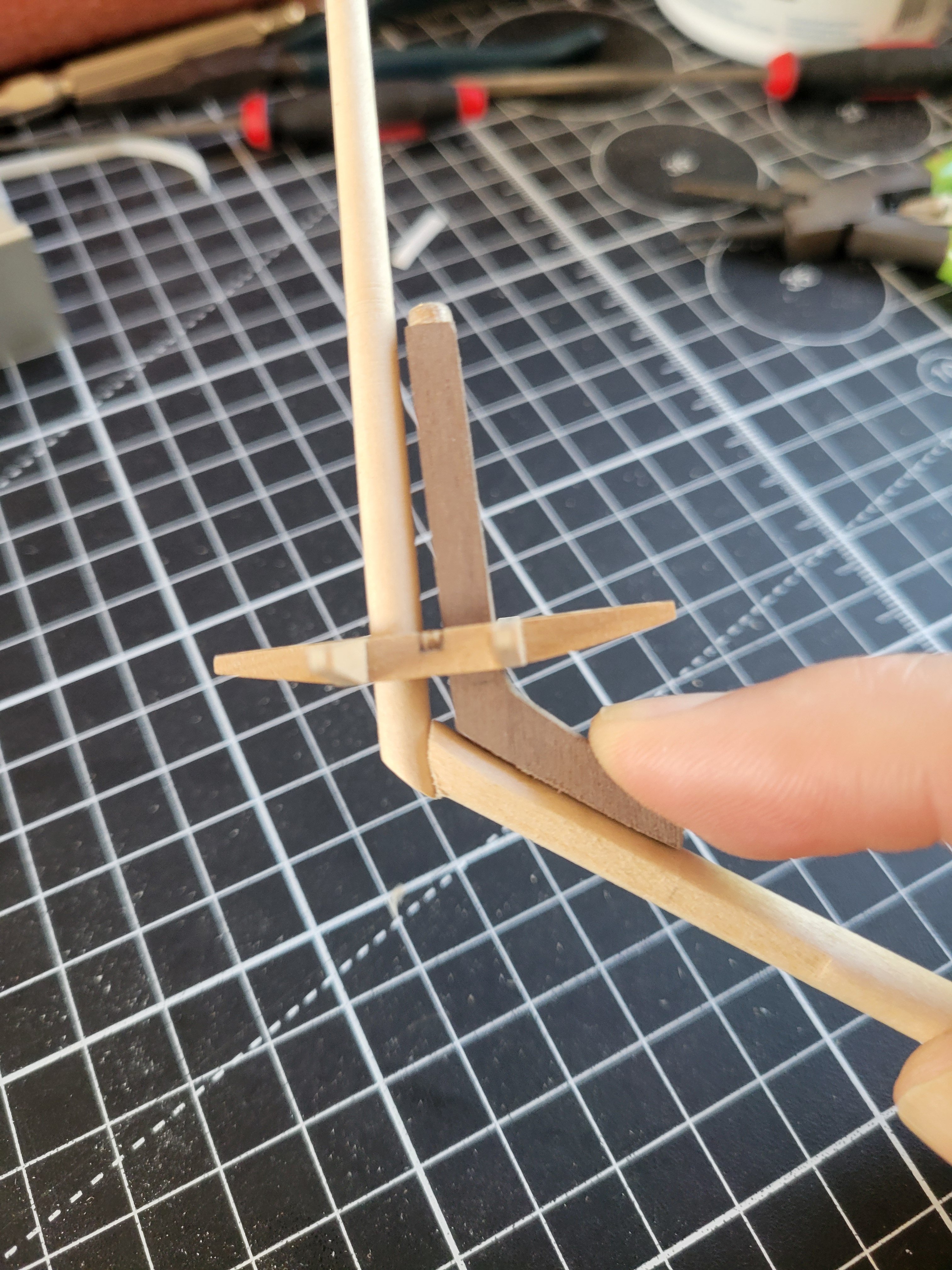

All masts shaped (drill press on its side as a mini lathe)   woldings.  Cheeks, crows nest and trestle trees.

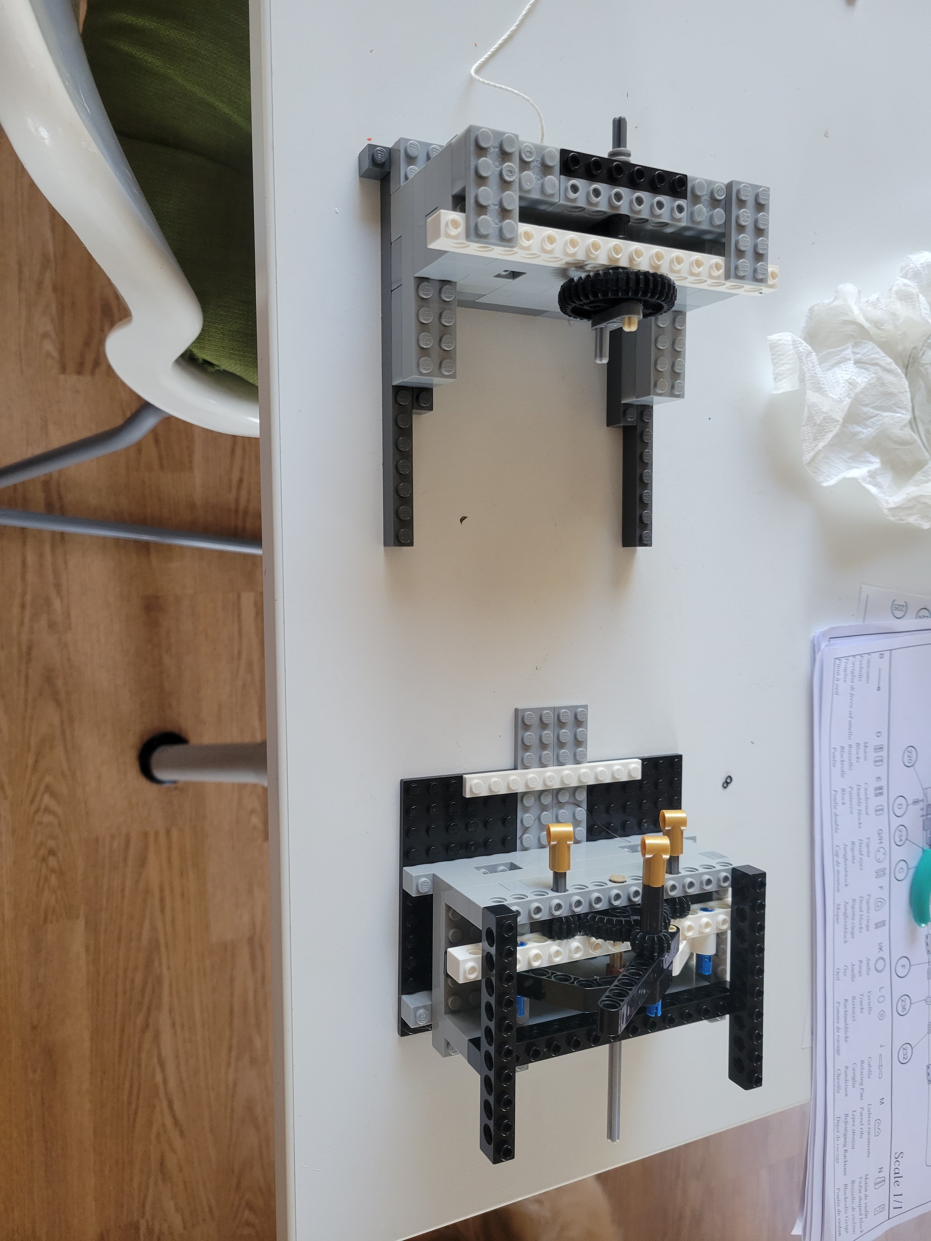

A LEGO Technique ropewalk!  Very cool. In a similar vein, here is my meccano serving machine using parts I had as a kid:

Thanks.  I was worried about creating "perfect rope" but quickly realized, my simple lego machine paired with a couple practice runs and my so-so inexperienced rope is already so much better than kit rope.  Certainly not at the quality and consistency of chuck's syren rope or ropes of scale (shout out to both for not only fantastic rope products bit lots of content to help the rest of us make our own!) but definately good enough for me.  When I lay up the next rope I'll take more pics if anyone wants to see it in action to build their own.  Next trip to a hobby shop I'll probably pick up gears and other parts to make a more permanent version.

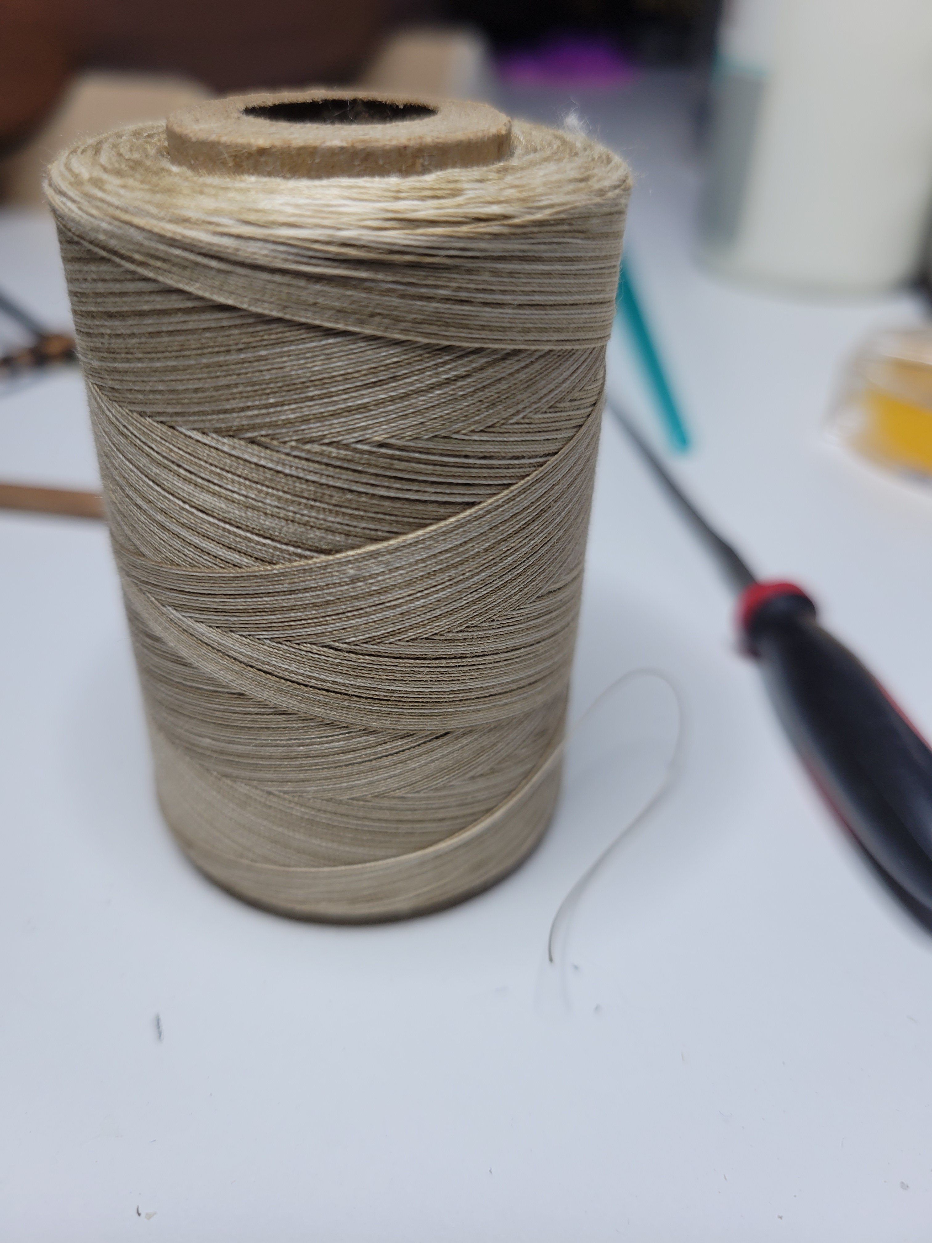

Just a note on ropemaking.  I have a thread with some variation in its color.  Made a small rope from it and at first figured i couldn't use it because of the variation.  Realizes that this would actually perfect for any rigging lines that I want to "accentuate artistically" so that they stand out from others on purpose.  For example, using it on the cathead/anchor tackle.  I know thats not "accurate" but I like the look anyways so now I just need to think through anywhere else I want that done intentionally!
