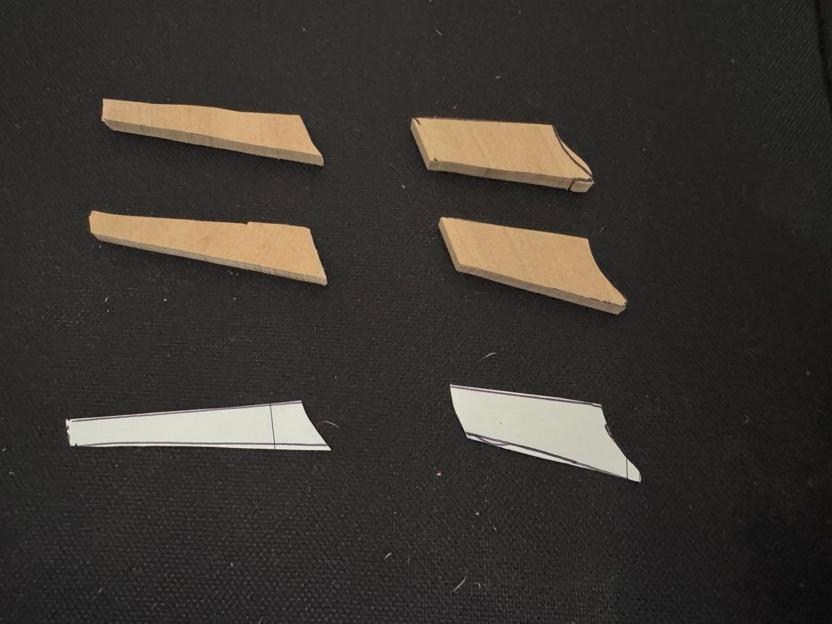

I've taken a bit of a detour.  As above, I was working on bending the strips for the rail around the edge of the deck.  But before installing that rail, I decided that it might be best to install the sheer trim strip on the upper side of the hull first.  It is likely that my only way to "clamp" that piece is with some tape and I'd prefer to do that before putting the rail on.  But, before putting on the sheer trim strip I wanted to put on the trail boards because I envision the sheer trim butting against the aft end of the trail board.
The kit indicates using some of the 1/16th basswood sheet to make the trail boards.  I was hoping to carve some design into them and basswood is not the best for that.  I had some other thicker sheet that I believe is Castello Boxwood and thought that might be a good alternative.  But so far in working with it I am not sure.  It seems very hard and difficult to carve, though I have not yet tried soaking it in water, which I have found to be helpful carving other hard woods.
Anyway, the pictures below show my patterns and the original pieces I cut out  (Though I made the rookie mistake of not considering orientation of the grain when laying out the pieces.  Not sure if that will be a factor).  The second picture shows the pieces with some initial sanding and marking for port/starboard.  The third picture shows the port side pieces with additional fitting and shaping, but no carving yet, temporarily fitted using a bit of double sided tape.  I'll probably continue a bit down this path though no guarantees I won't turn around.

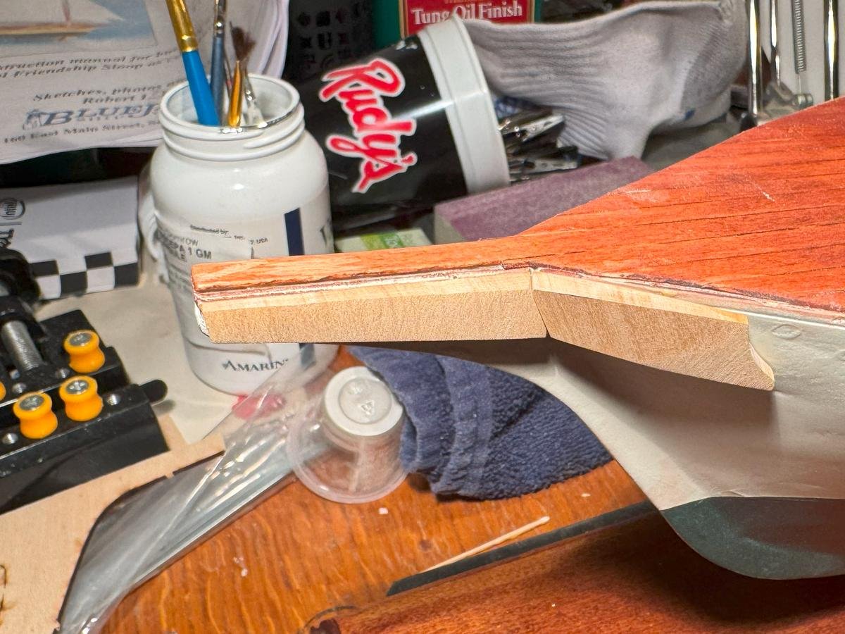

Just another quick update....I have completed the sheer trim all around the boat.   Below is one picture showing how I taped the trim on while the glue dried and then a few pictures of the finished trim.  I started off using the tamiya masking tape to hold it and decided that was a bit of a waste so switched to the cheapo blue painter's tape.  Next up is to put the rails on around the perimeter of the deck.

This first two pictures show the rail being glued on, and the next two show closer views of the rails without the tape "clamps".  I still need to add the rail on the stern.  The gap between the rail and the bowsprit will be filled with a chock on each side.  The rail consists of a basswood strip on edge capped by a mahogany strip.

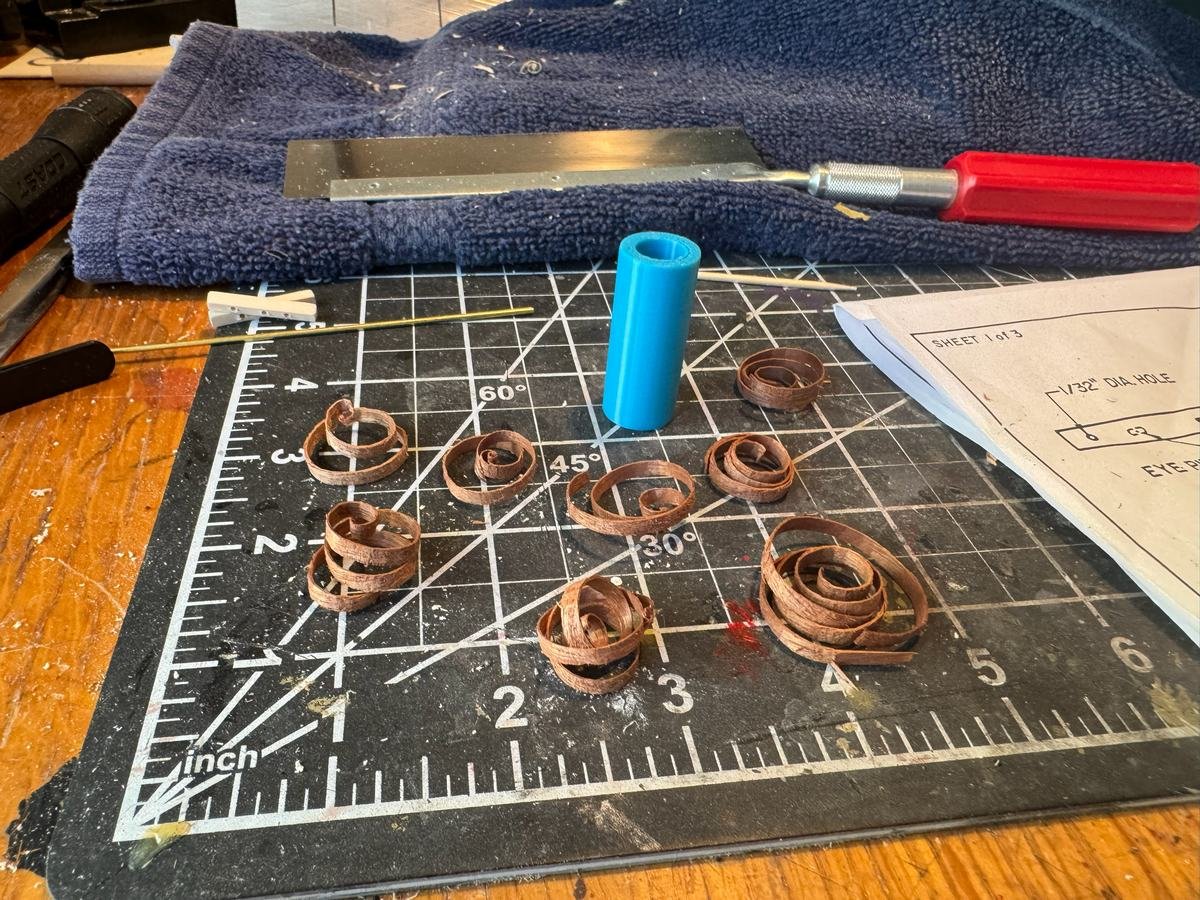

This time with some pictures.  Continue to work on the mast and spars and the mast rings.   Similar to when I built the America, I am making wooden mast rings.  I start with shavings created with a small plane that naturally curl, wrap them around a circular object and coat them liberally with diluted PVA.  More details below.
First, I start with the shavings and the jig/former.  For the shavings, I used a small plane on some of the leftover 1/16th x 1//8th mahogany.  They tend to be pretty rough but I am hoping I can smooth things out adequately.  As for the former, I have exploited at least 1% of the potential of 3d printing by printing this tube that is 5/8ths of an inch in diameter, to wrap the shavings around.  The mast is 1/2 inch in diameter so this will allow the mast rings to fit easily over the mast.

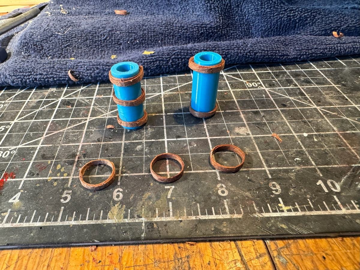

Here you can see 5 rings wrapped around two formers, and three rings that I have removed from the formers.  To wrap the rings, I start by using CA to glue on end of the shaving to the tube, then wrap it around securing the end with more CA.  If I need to add more layers, I grab another shaving and secure it with CA just on the ends.  Once satisfied, I brush on a bunch of highly diluted PVA and let it sit over night to dry.  I then sand the outer surface of the rings while still on the former, try to remove the ring from the former without breaking it, then carefully sand the top and bottom surfaces.

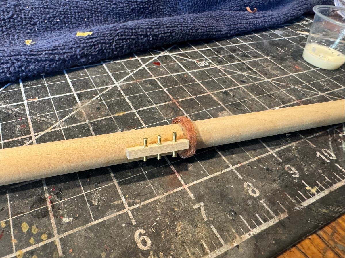

IMG_2765.jpg.99c53c31449b69a235bf34f135eb561d.jpgBelow is the main mast, the end that goes into the deck on the left.  The picture shows the boom rest, created similarly to the mast rings, as well as one pin rail.  There is a second identical one on the other side.IMG_2766.jpg.6f55d81e5233d99031525dc4e48cbbf8.jpg

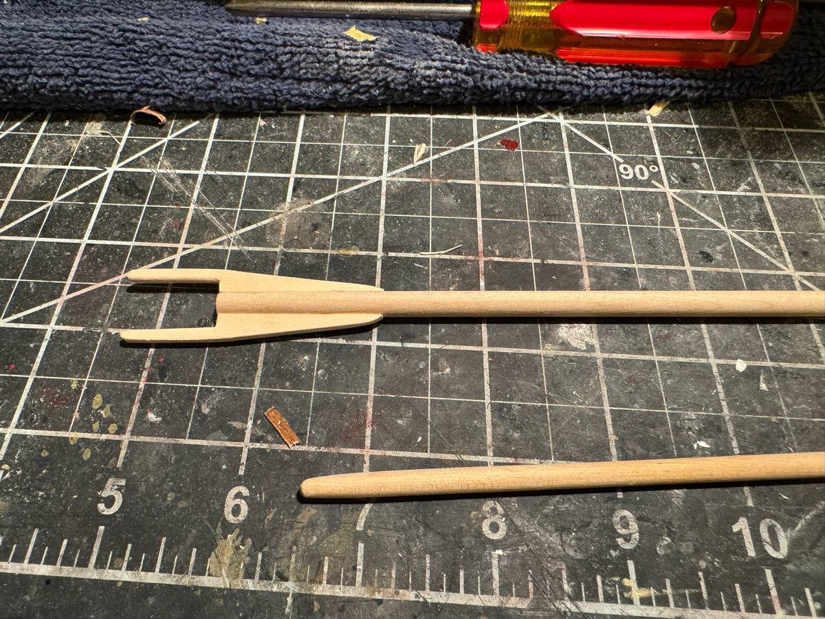

And finally, the end of the gaff with its jaws, as well as the simple jib club.  I still need to do the main boom....the dowel needs to be cut and tapered and then jaws added.  then all the spars need to have some holes drilled and eye pins put in place.  I also still need to figure out exactly which parts will be painted vs stained.IMG_2767.jpg.1cd26f1538d3648229ddc4a2c8796e03.jpg

I have the mast and spars almost done now.  I added the jaws and other wooden bits and I've painted some of the ends, and stained the areas where the various sails are attached.   Then I added the eyebolts specified by the plan and drilled holes as well.  The one thing yet to do....the boom is supposed to have a couple of cleats on it.  I've not yet decided if I am going to use the metal cleats supplied by bluejacket or make some wooden ones.
