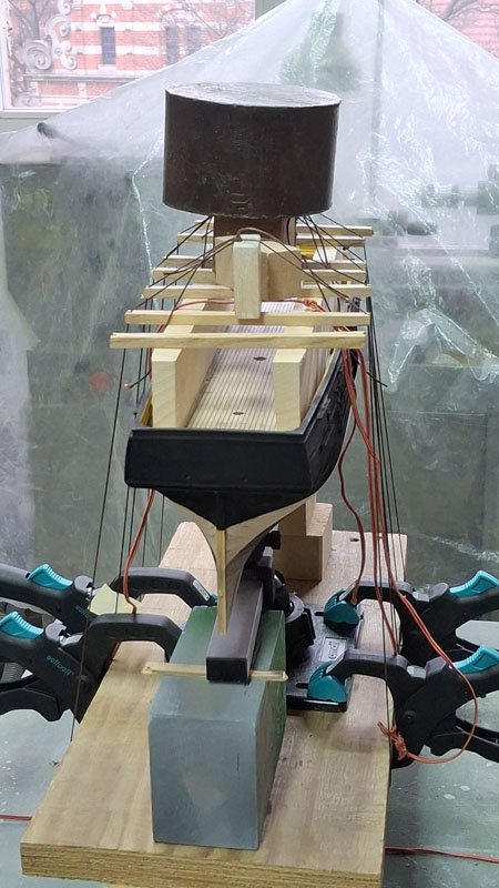

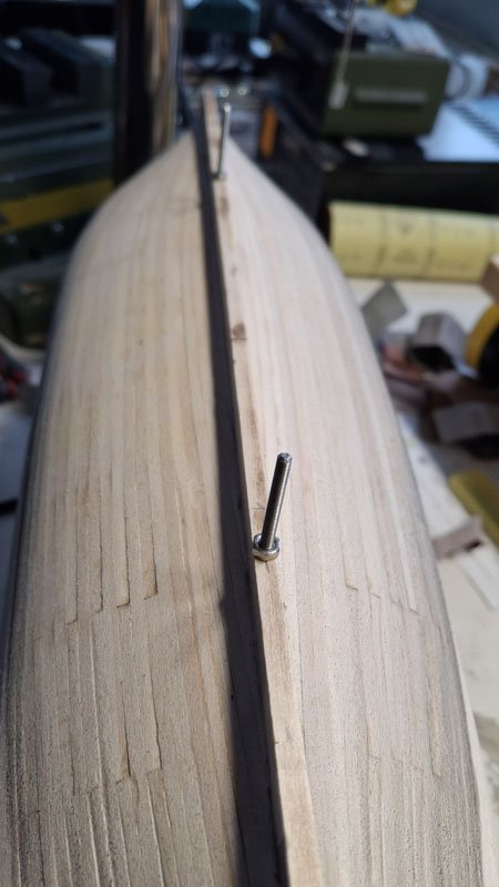

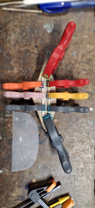

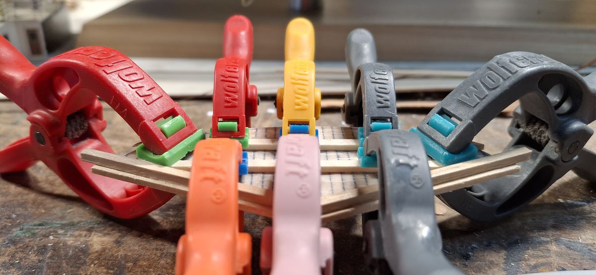

My Charles is supposed to be an aged model, linden wood is perfect for this project, it adds a natural age to the model and the atmosphere of those times. The lower part of the ship is made of copper, which makes it easier to make the planking, which does not require so much focus. The modeler should focus his energy and precision on watching the hull axis and symmetry, controlling rotation and uncontrolled deformation while the glue is drying. At this stage, there is still a lot that can be fixed.

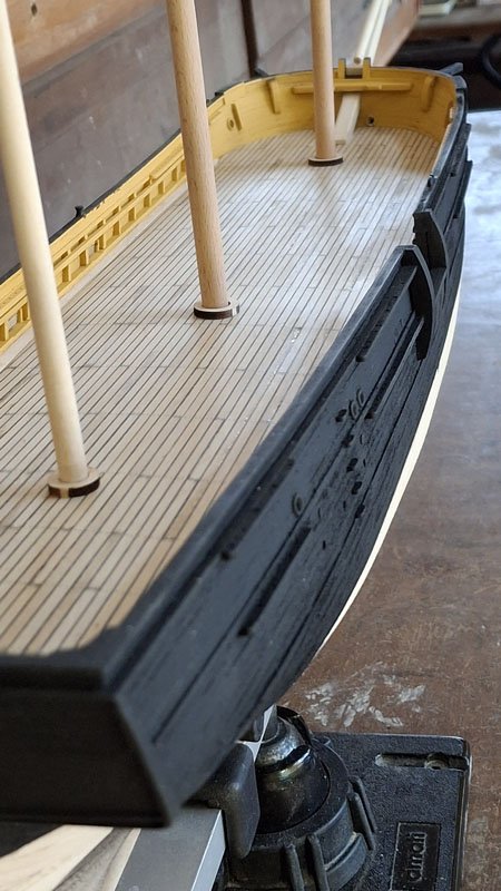

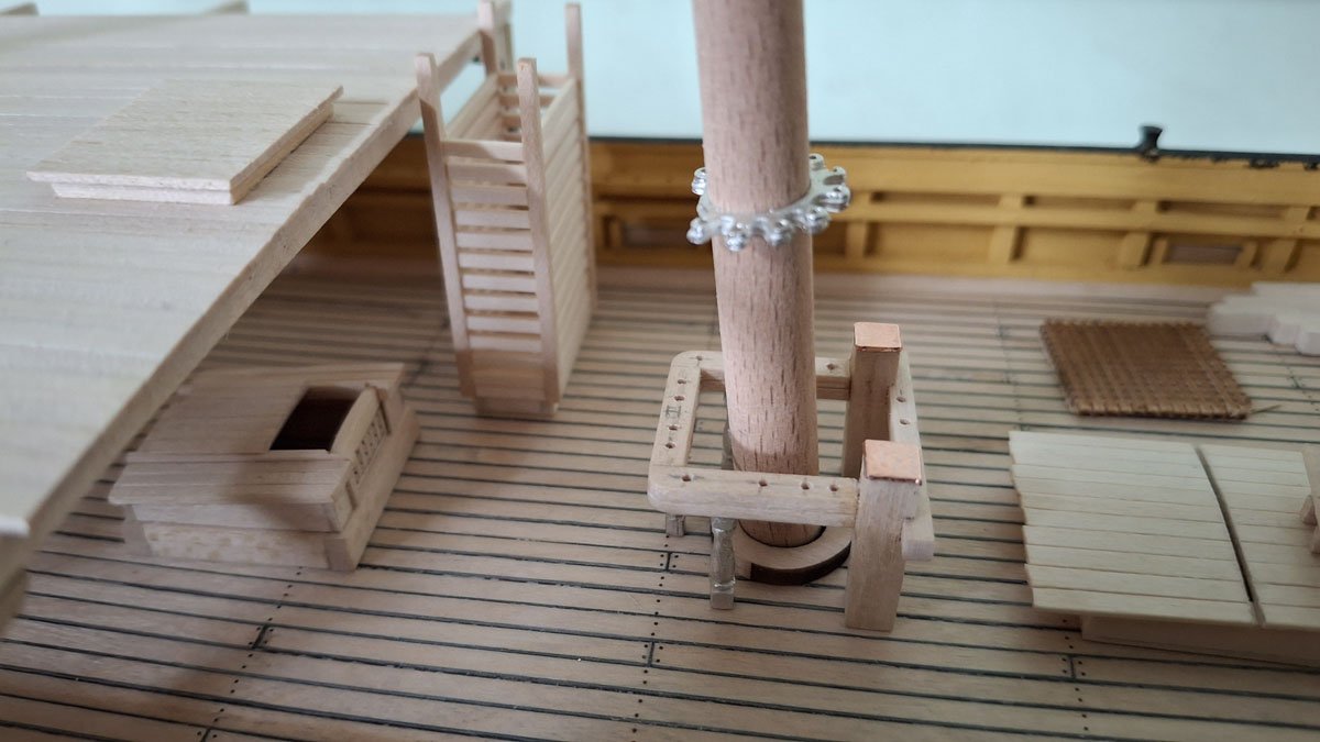

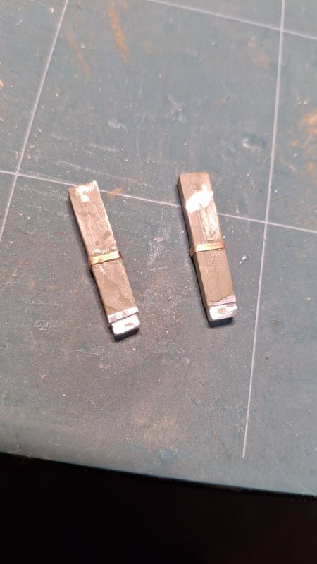

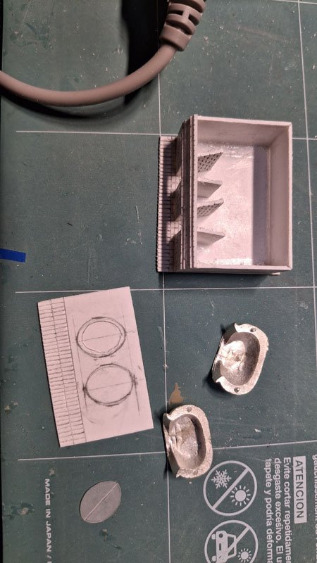

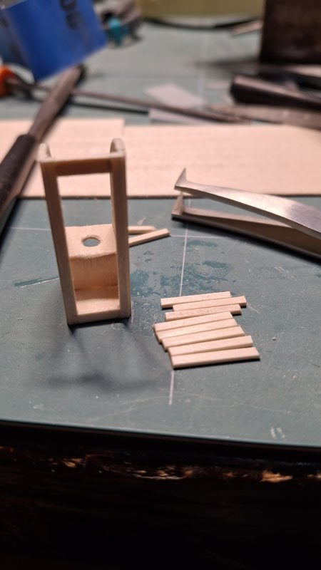

I decided to make fasteners, I made the device by making a 0.4mm hole in a flat bar and a 0.3mm drill. I knocked them out of an aluminum can, making small circles.

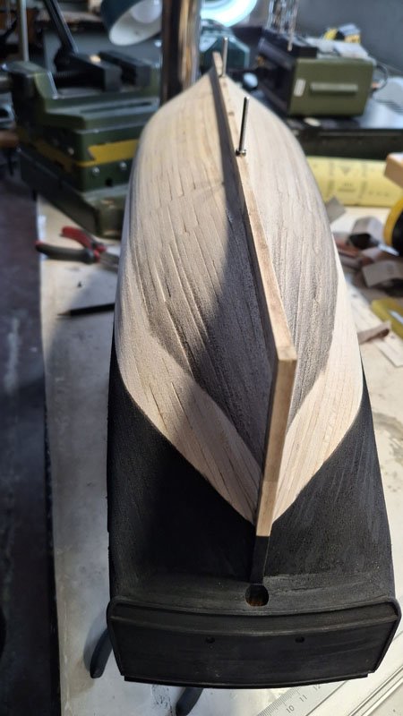

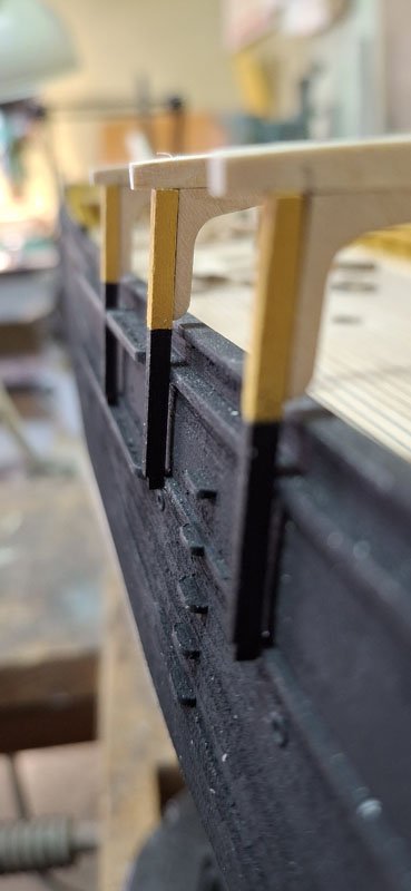

First painting after previous cleaning and checking for glue residue. I wanted to make the hull skin elements visible as much as possible and the detail of the plank structure as visible as possible. To achieve this, remember to dilute the paint and use a drying retarder. Good and careful preparation of the masking for work with an airbrush is half the battle.

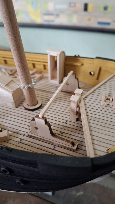

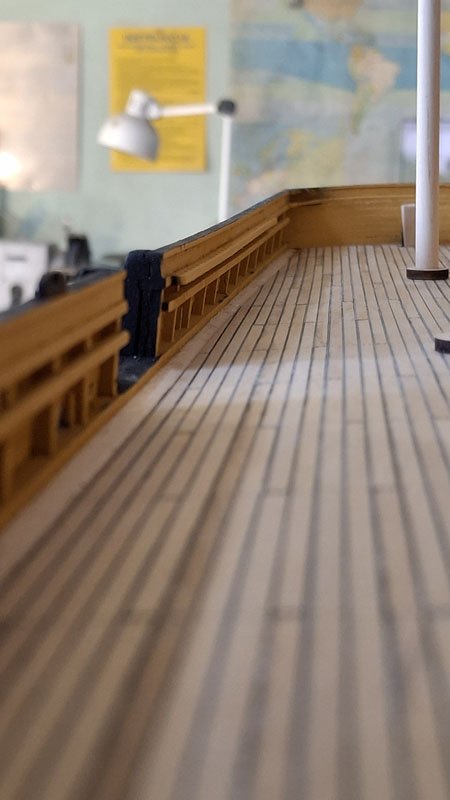

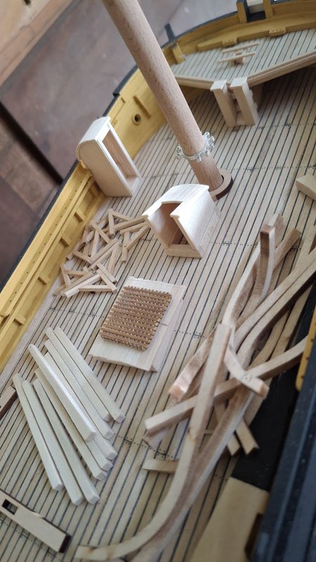

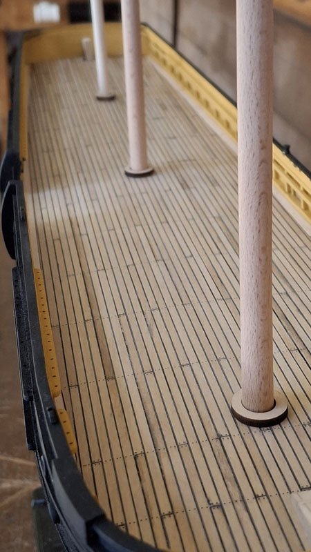

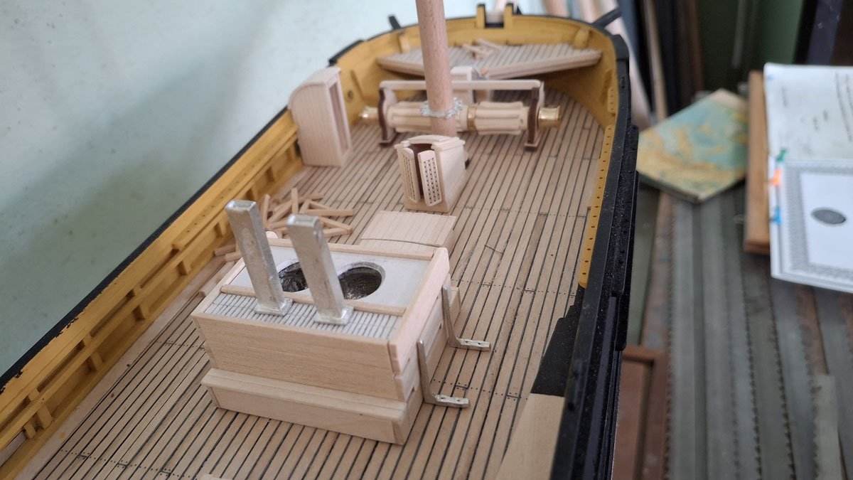

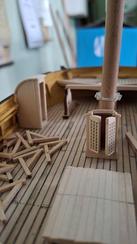

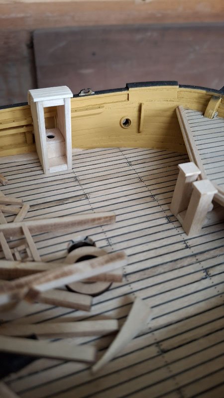

The deck and playing with pegs that I made from 0.3mm fishing line. It is not a faithful copy of the deck because over the years of intensive use of the ship, the arrangement of the boards is a complete chaos and without being there I am not able to faithfully recreate what is there.

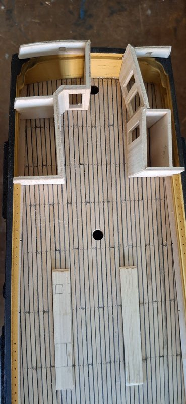

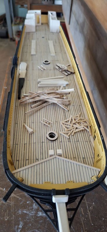

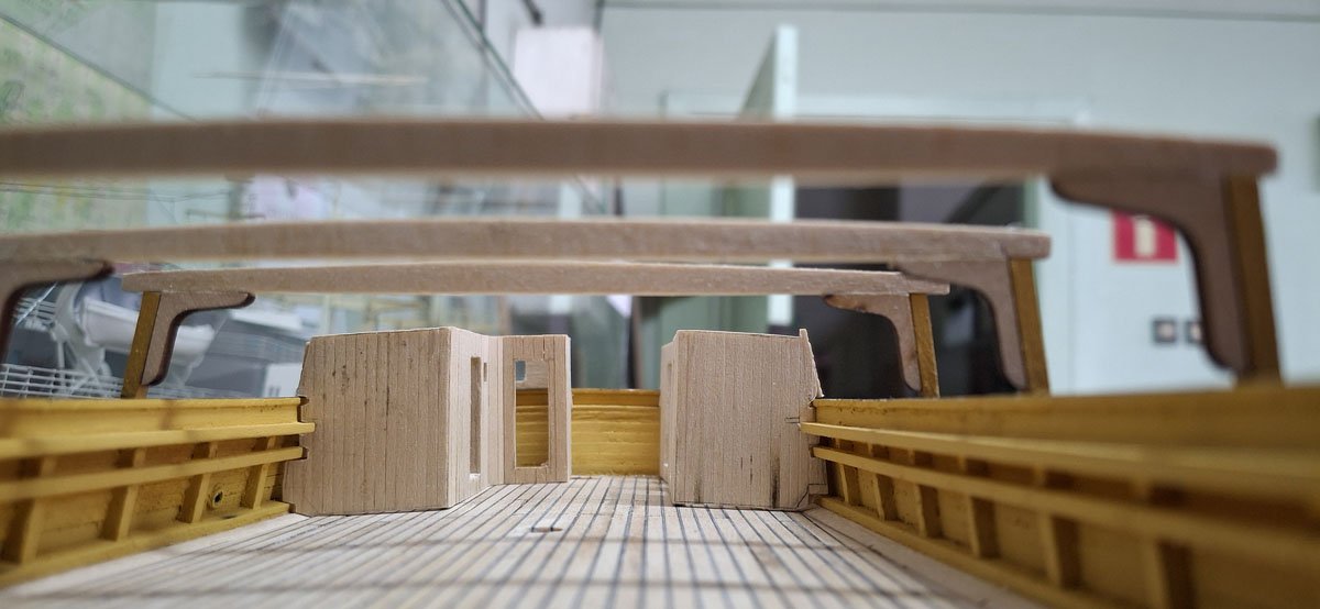

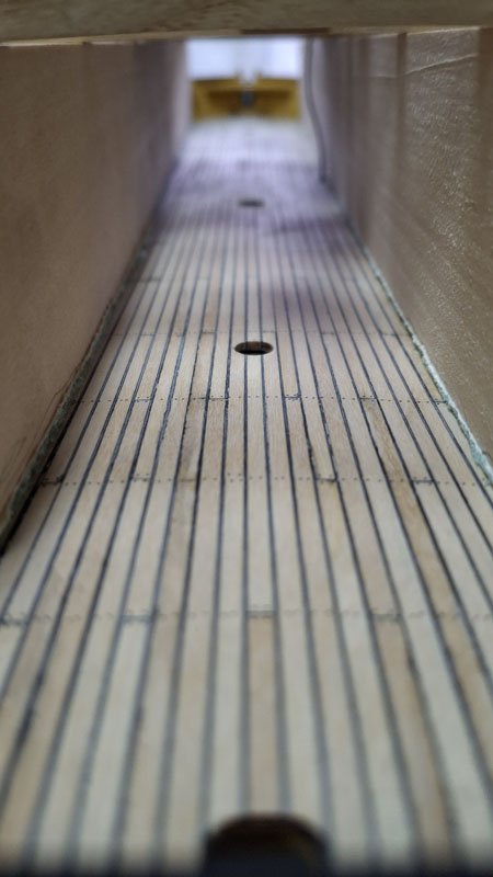

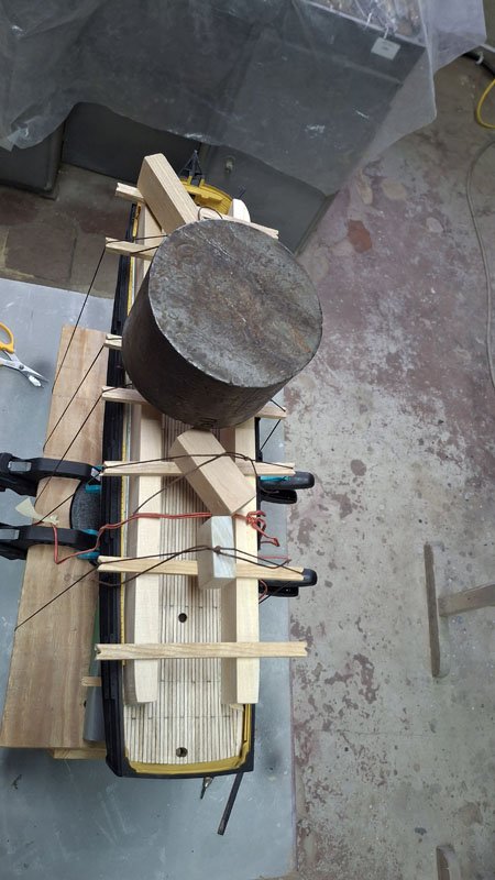

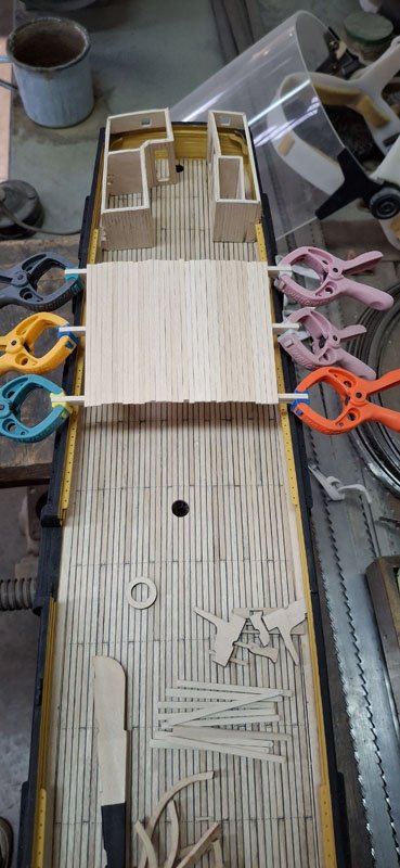

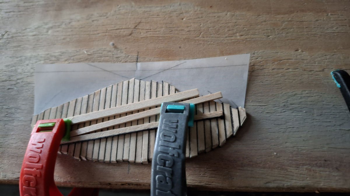

First attempts at gluing the deck, the effect is satisfactory I think. I used epoxy resin to glue it, thanks to which I had a lot of time to adjust it calmly, about two hours for the resin to harden. Attention! You have to watch out for resin leaks, think carefully about planning the gluing and prepare everything in advance.
  • 3 months later...

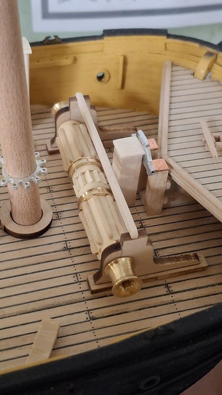

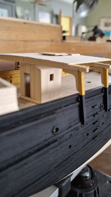

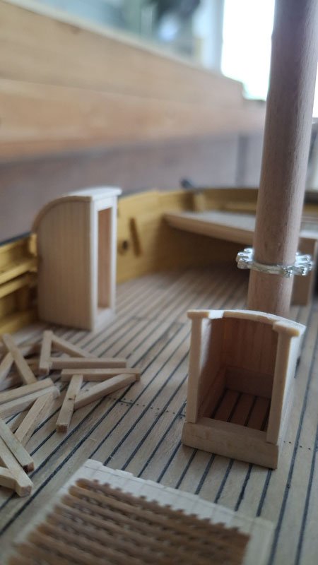

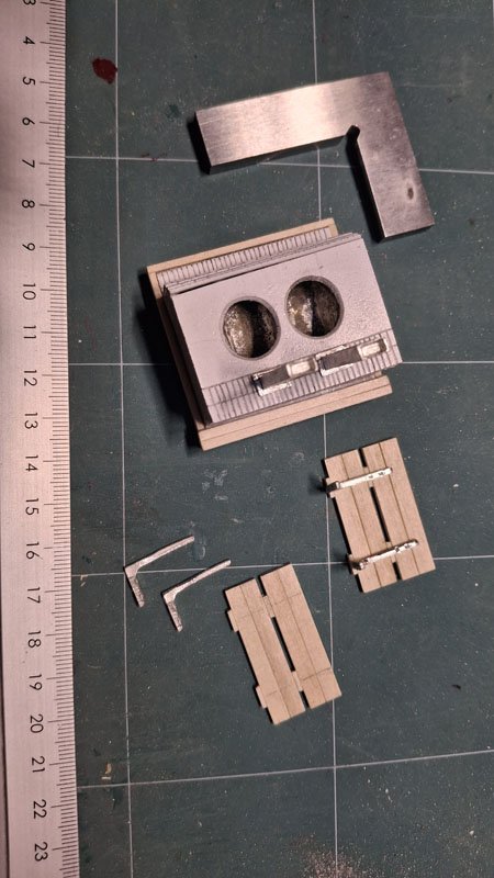

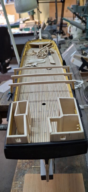

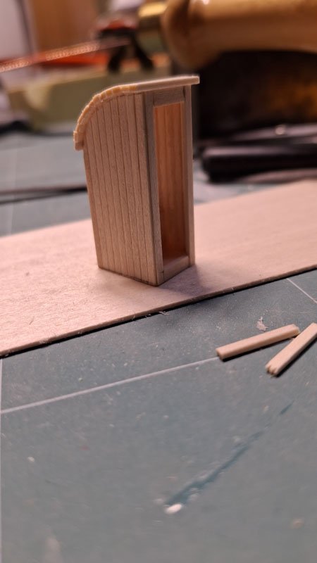

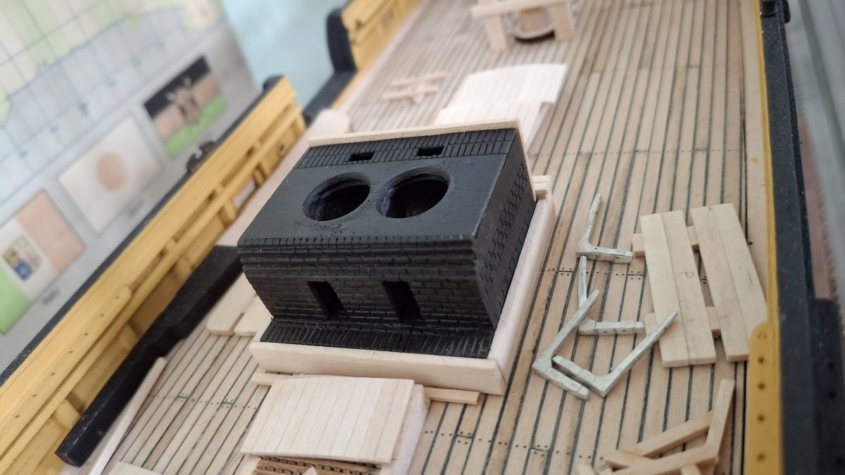

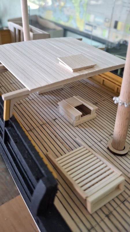

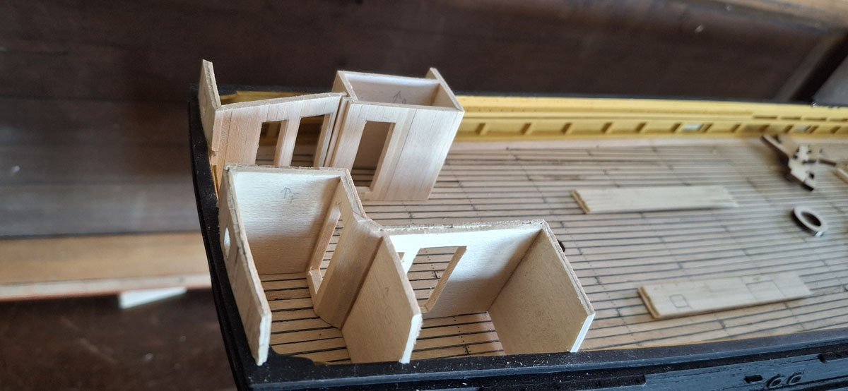

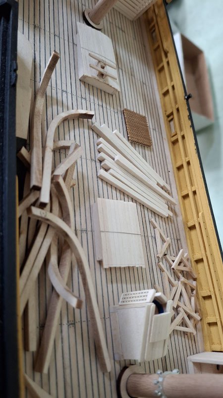

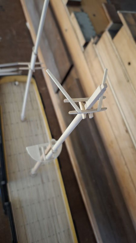

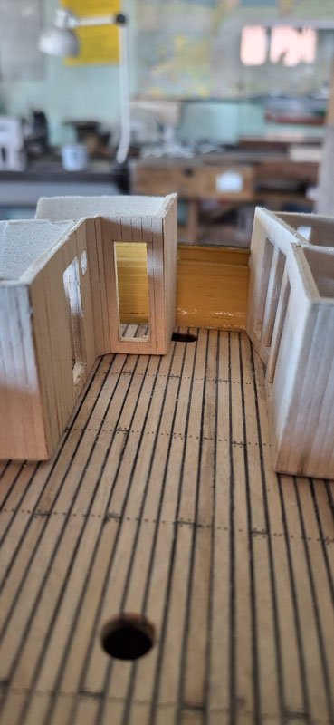

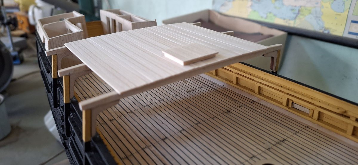

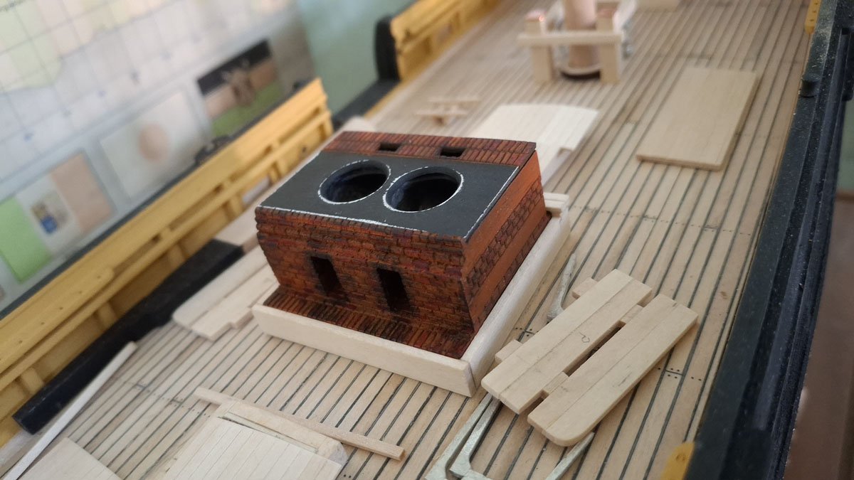

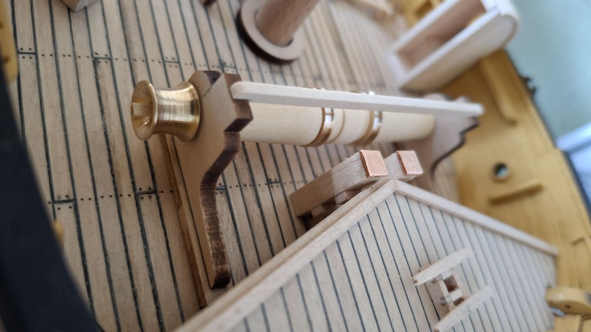

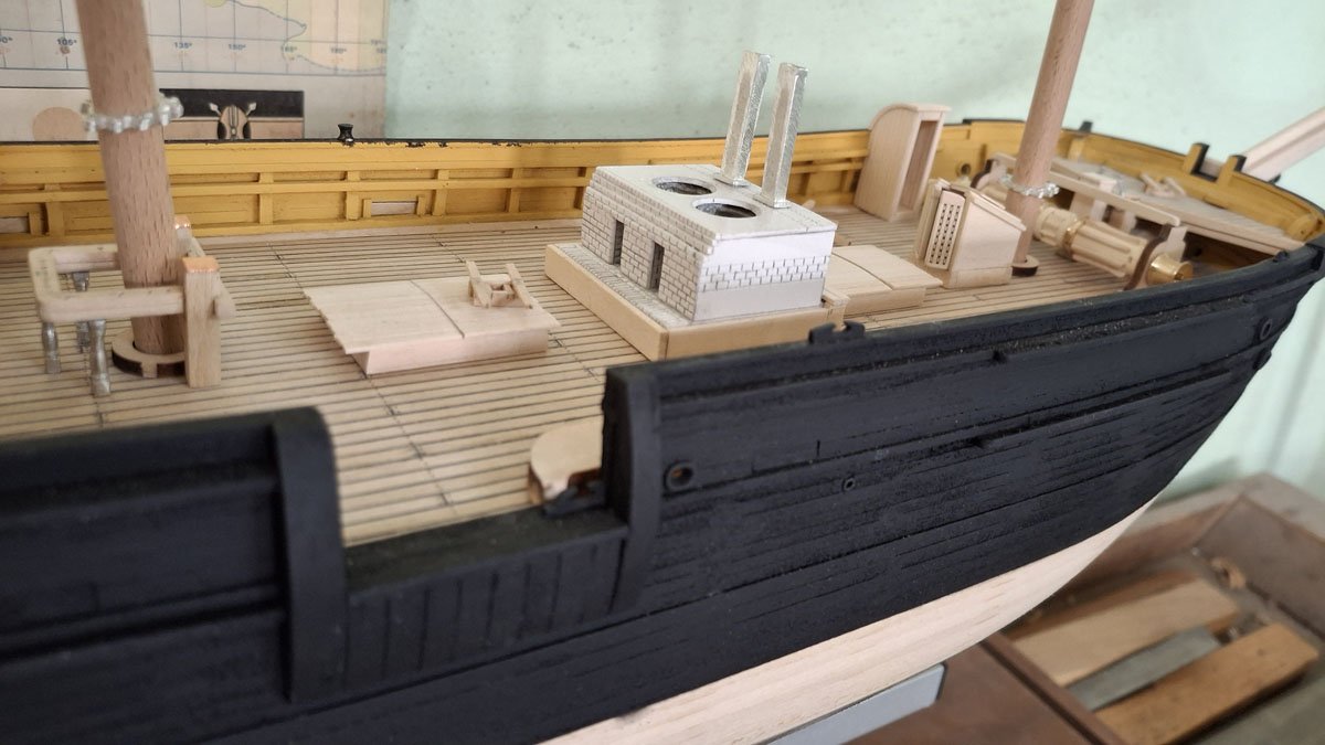

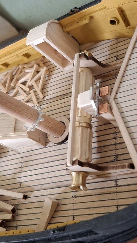

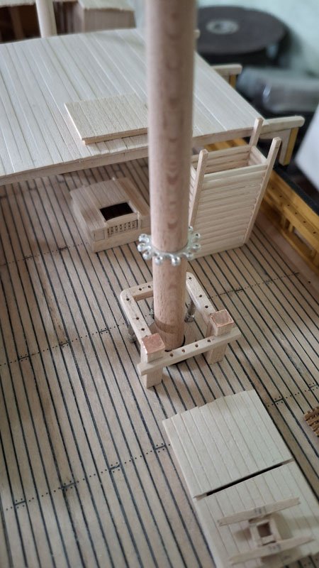

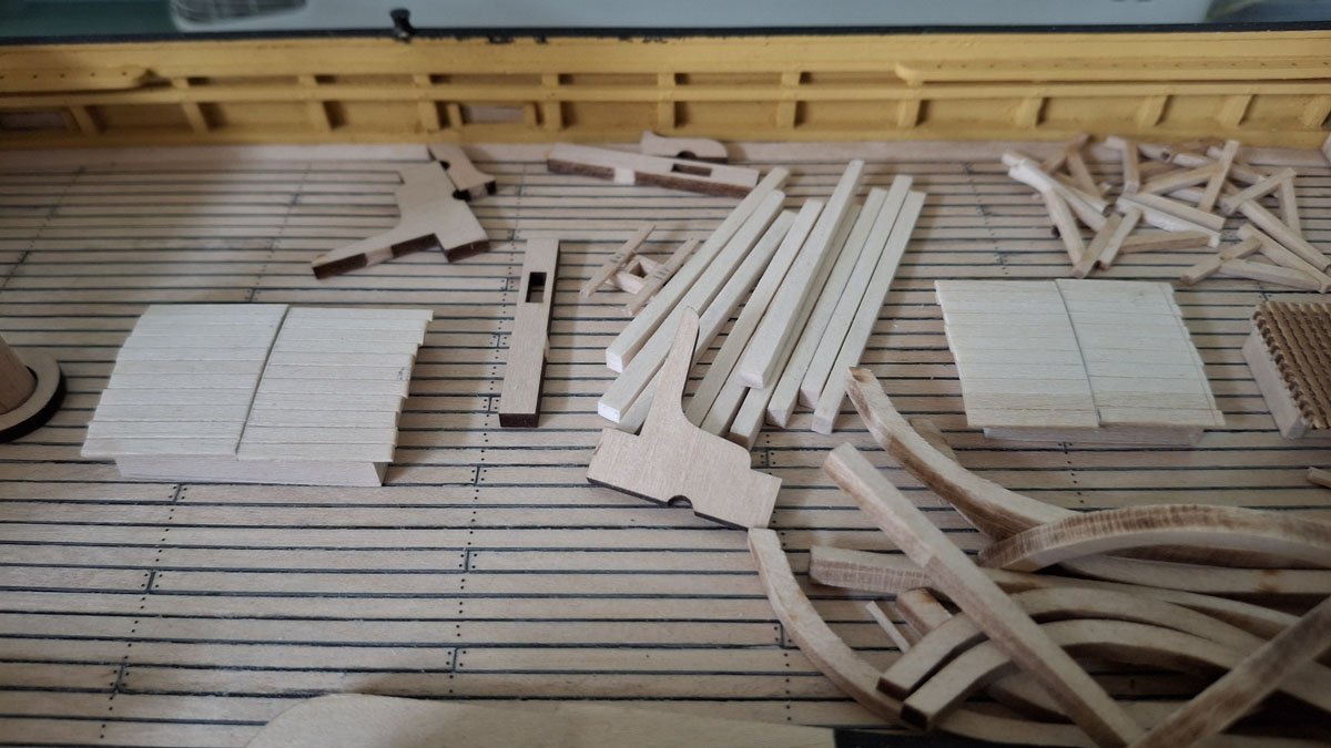

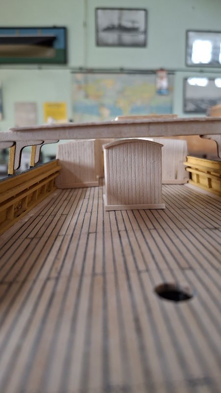

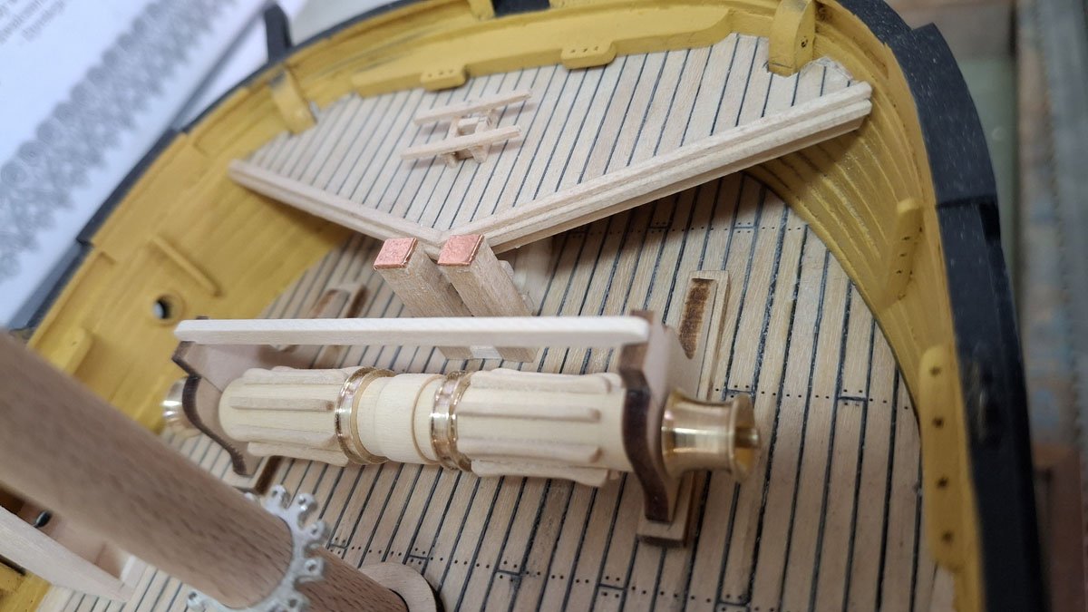

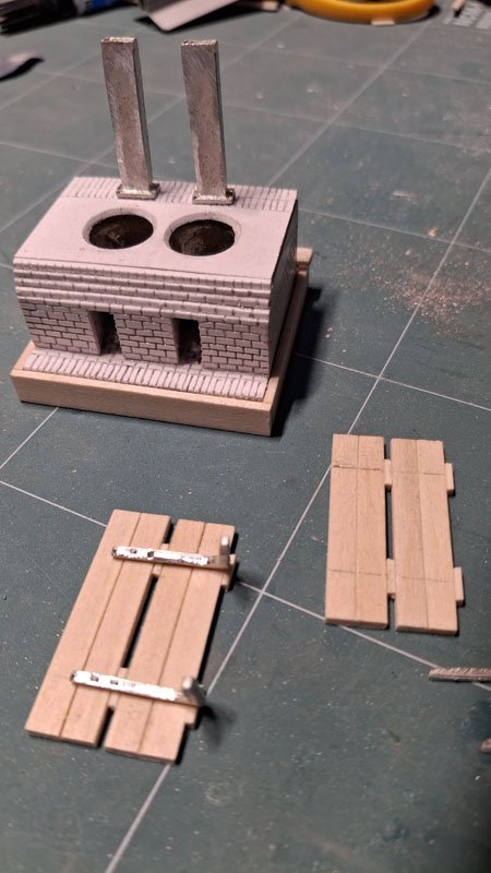

The deck is in place, glued with epoxy resin. I had plenty of time to place the finished deck in the right place. This did not protect me from epoxy leakage in the hole where the rudder is. But every cloud has a silver lining. I started producing all the parts on the deck one by one. For now, in raw form, so that when the time comes, I can paint and polish them.
Some parts from the set are unacceptable to me. I am forced to make them myself. I still have a dilemma about choosing the color of the deck, whether it should be more bluish gray or maybe bluish brown. In different photos in Real Charles W. Morgan looks slightly different colors. I think bluish brown will be a better solution for painting the deck. I would be happy to hear some advice from other experienced modelers or those lucky ones who have visited the ship in person.
And that's it for today, more progress photos coming soon. I'm getting ready to cover the hull with copper plates, I think it will take some time. But in the meantime I'll try to upload some photos of painting the deck and all the elements. Best regards.
