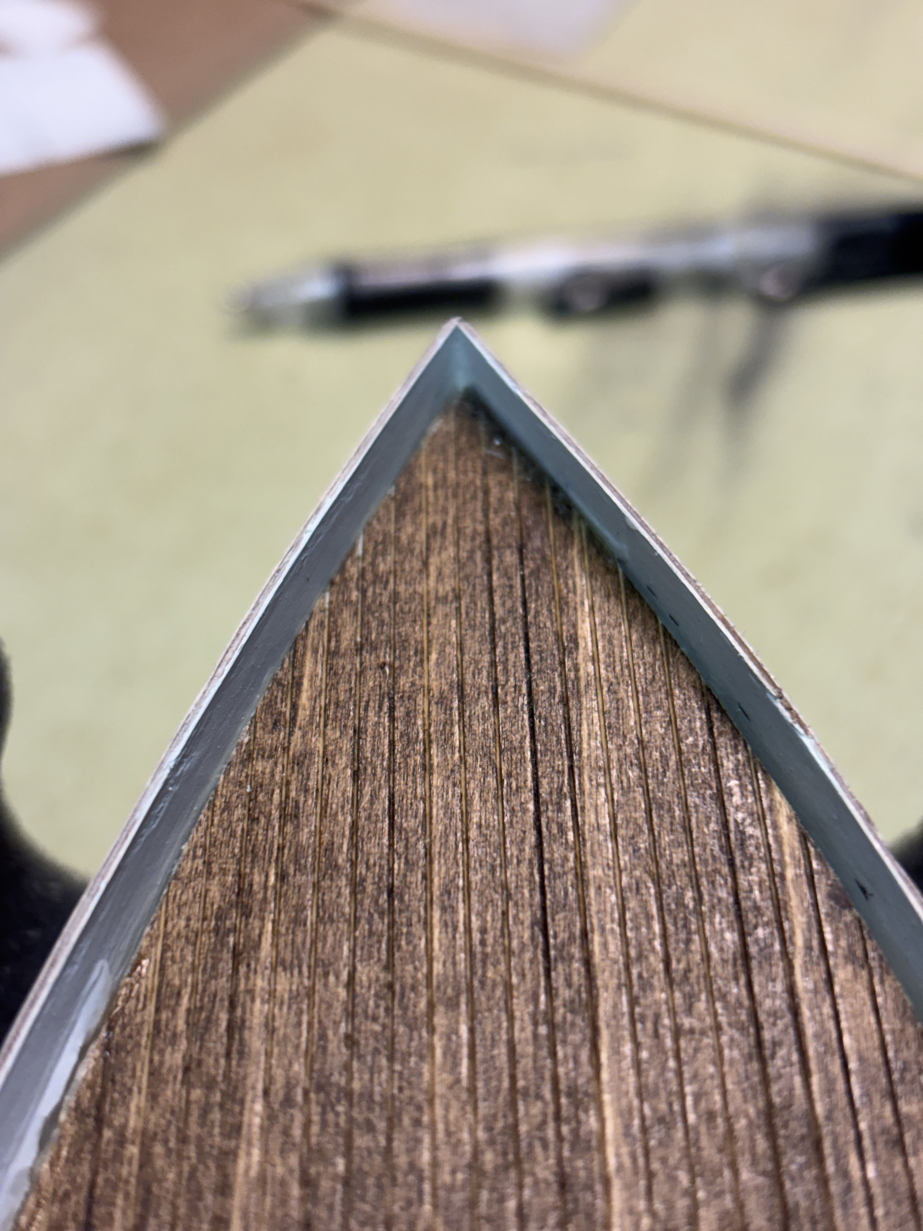

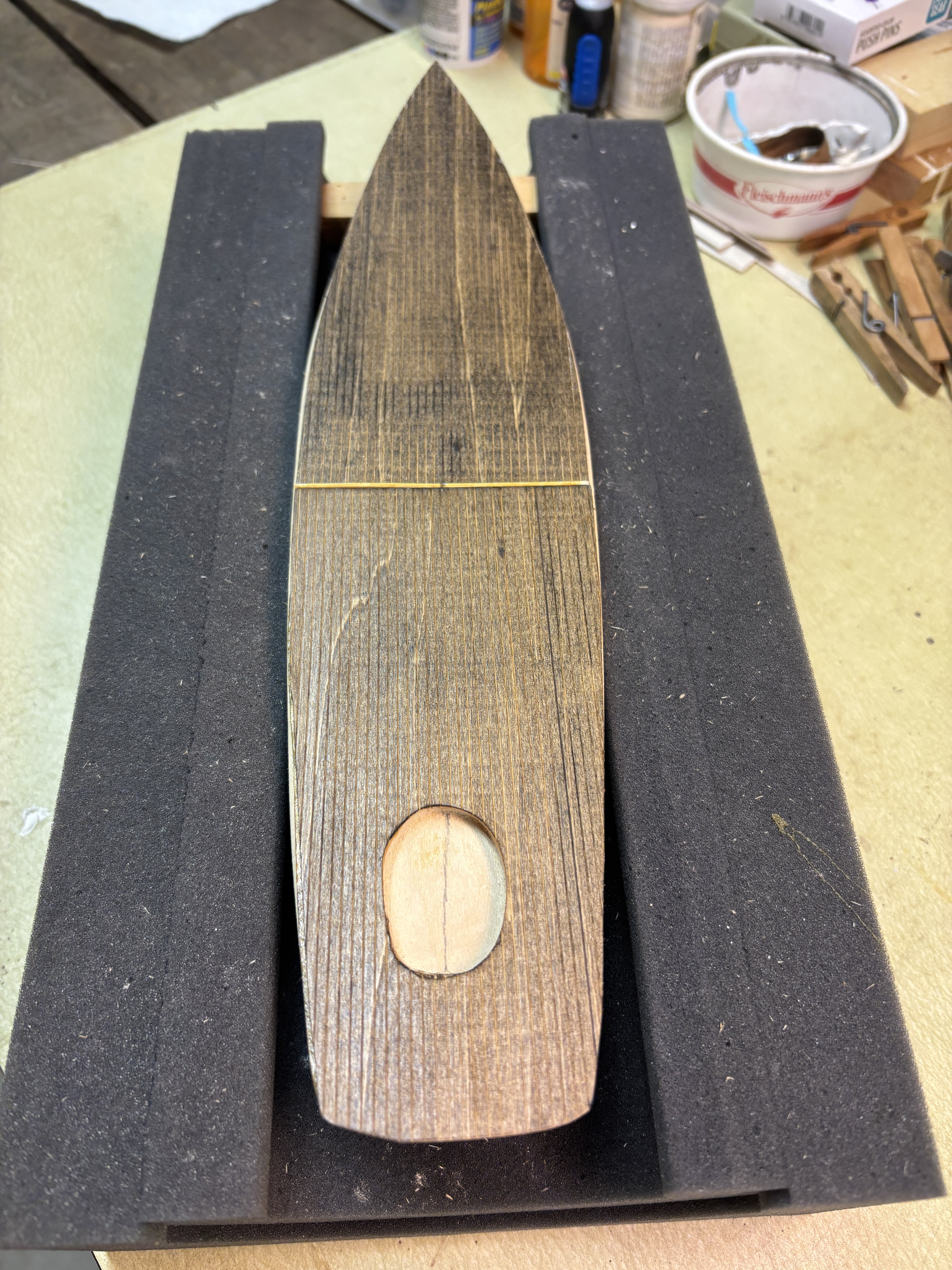

Here are hopefully current pictures of the build. Most of the bodywork is completed, the sternpost is in place, the rudder has been fitted and shows a reasonably parallel line with the sternpost. One of the problems I encountered was the supplied keel, while laser cut, had quite a warp to the forward 2 inches. That caused misalignment with the stem. Wood filler and a lot of cautious sanding has got the area looking much better. The tool shown is a Dremel round cutter. I used that to create the small cutout to accept the flat at the top of the rudder. I also worked on the cockpit area. The problem I ran into there was the supplied cutout was oblong and to the right of center.

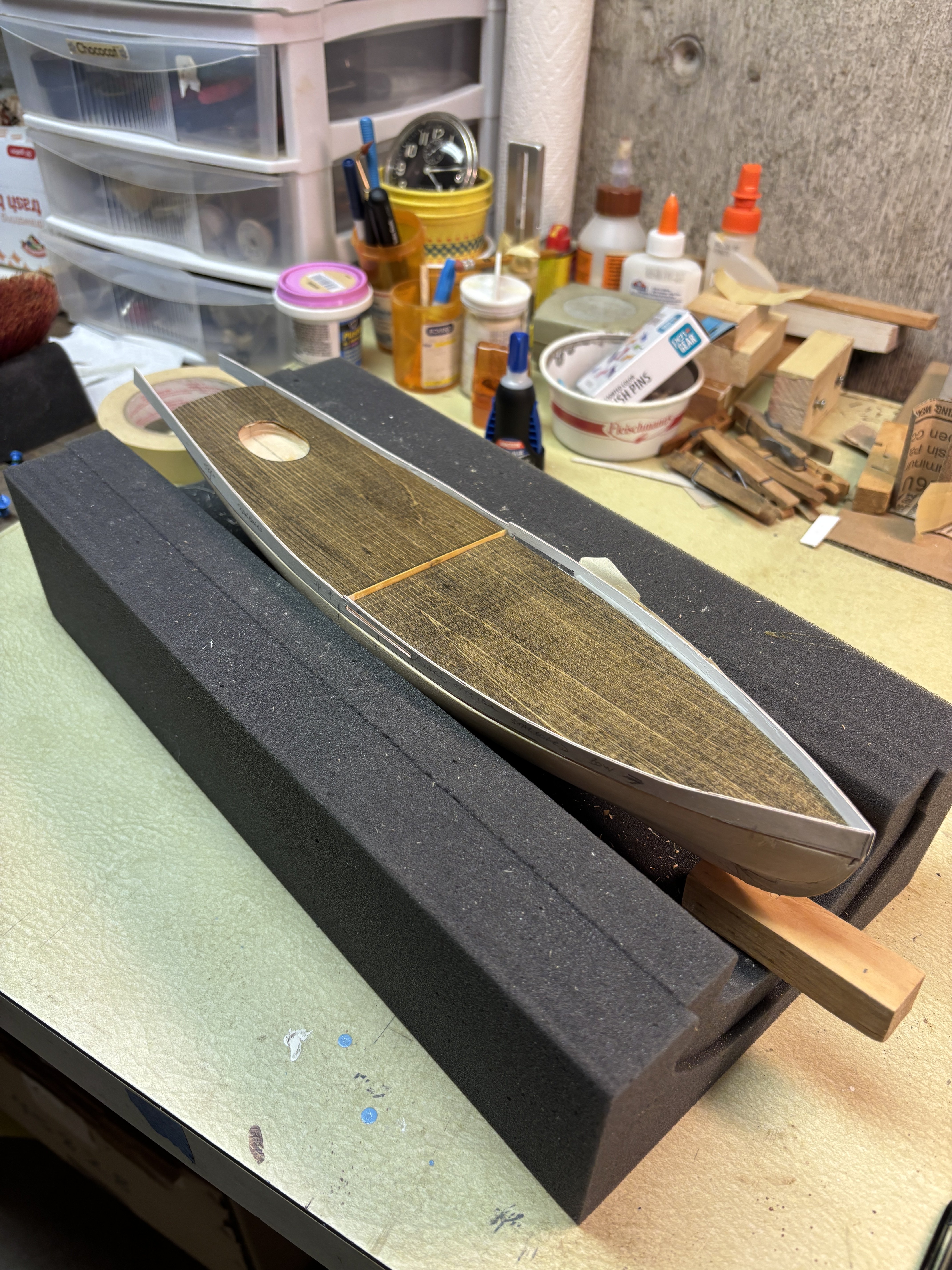

Could anyone advise an effective method to clamp the bulwarks to the hull? I plan on using Elmer's wood glue and can pin the bulwark to the hull. That would not provide any real clamping though.
Secondly, I am confused on the shape of the stern. It looks like it has a very sloping or angled stern, but the templates are a distinct oval oblong shape. Thanks for your assistance.

Update on progress, just about ready to install bulwarks; quarterdeck was fitted but not installed this afternoon. I have gotten an angle into the stern. I kept it very shallow to allow increasing the angle if I wanted. Instructions don't really tell you much but nonetheless, moving ahead.
To locate the cockpit, I simply used a pushpin and starting from the center of the depression worked my way out to the perimeter of the cockpit and worked my way around. Then just trimmed with scissors to neaten up.
