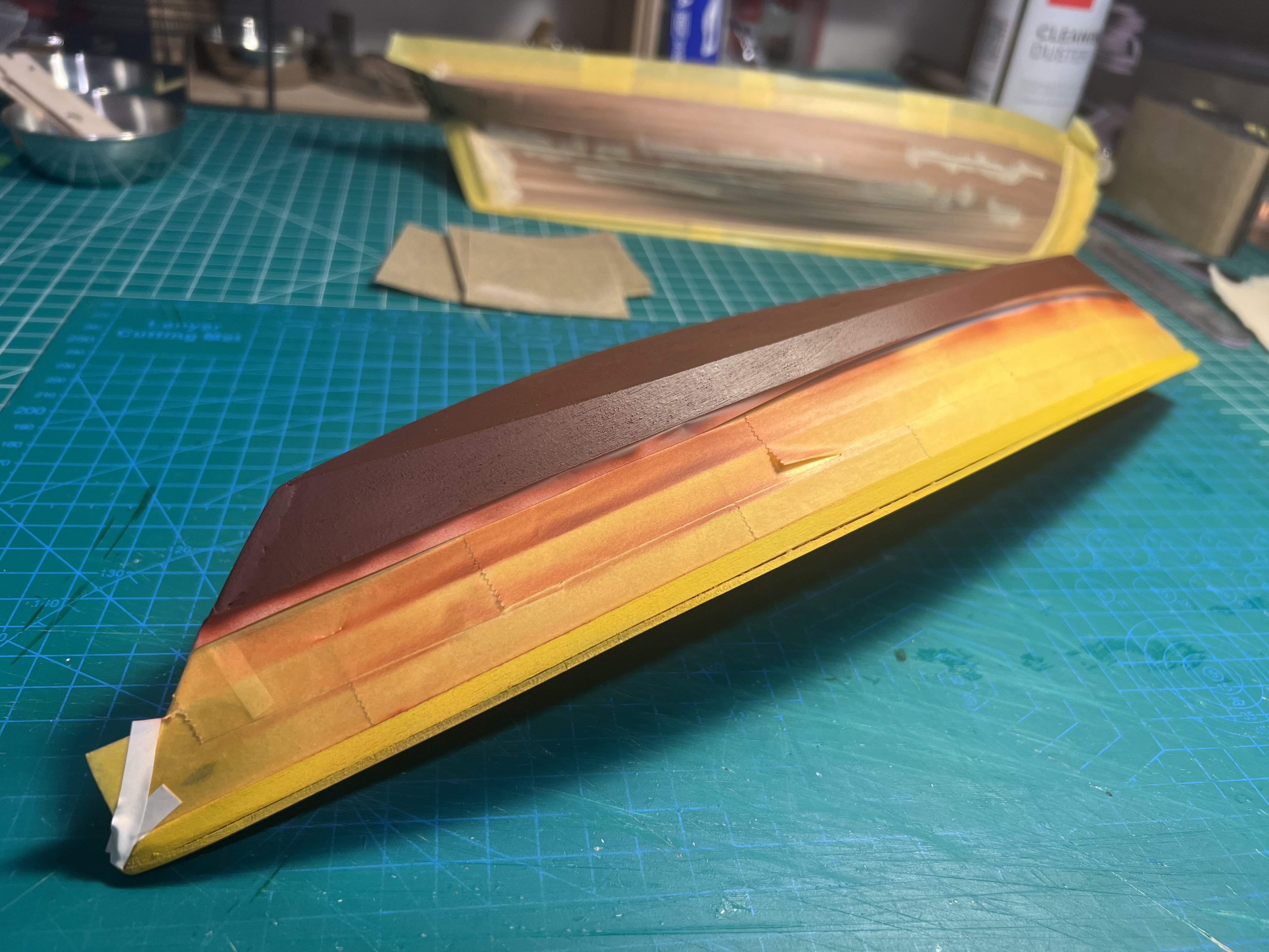

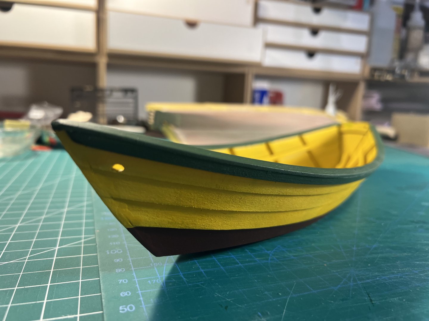

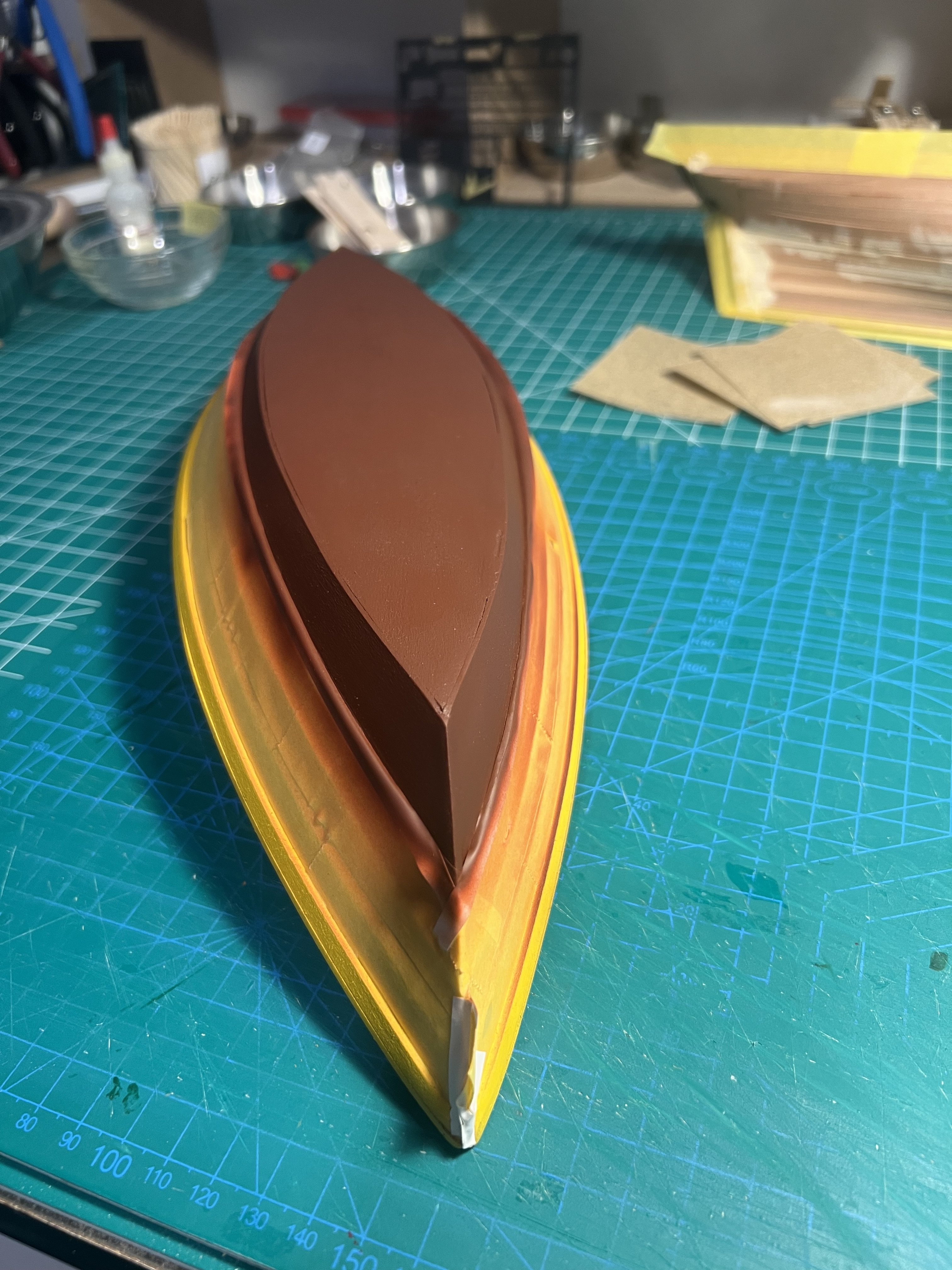

I started airbrushing the Dory. I found a couple sources for some colors and after playing around with some colors in my stash I decided on Vallejo Model Air 71.135 Chrome Yellow for the inside and most of the outside, Game Air 76.123 Angel Green for the gunwale, and I’m doing the garboard and bottom in Model Air 71.271 German Red Brown.
I don’t know if it’s a combination of airbrushing and the model being basswood but it’s been hard to paint over pencil marks I had made. With my Sherbourne (offwhite Vallejo Air on pear wood) I didn’t have trouble covering the pencil marks I made). I ended up painting with a brush to get a thicker covering over the pencil marks and I will do more airbrush coats.
https://goodmorninggloucester.com/2009/03/22/dory-buff-dory-paint/
Dories and "dory buff" paint are still very much a living tradition in Nova Scotia. Human memories fade, of course (though not as quickly as the pigments in 1920s marine paints 😀), but I've never heard of anyone doubting that all Lunenburg schooner's dories were buff with green trim. That's just the way to was and still is.
Trevor
I know that yellow is not quite Dory Buff color, it was the closest I had in my paint staff. The green was in the ballpark. I think I saw some photos of some Dorys with some reddish undercoat on the garboard and bottom and just went with it.

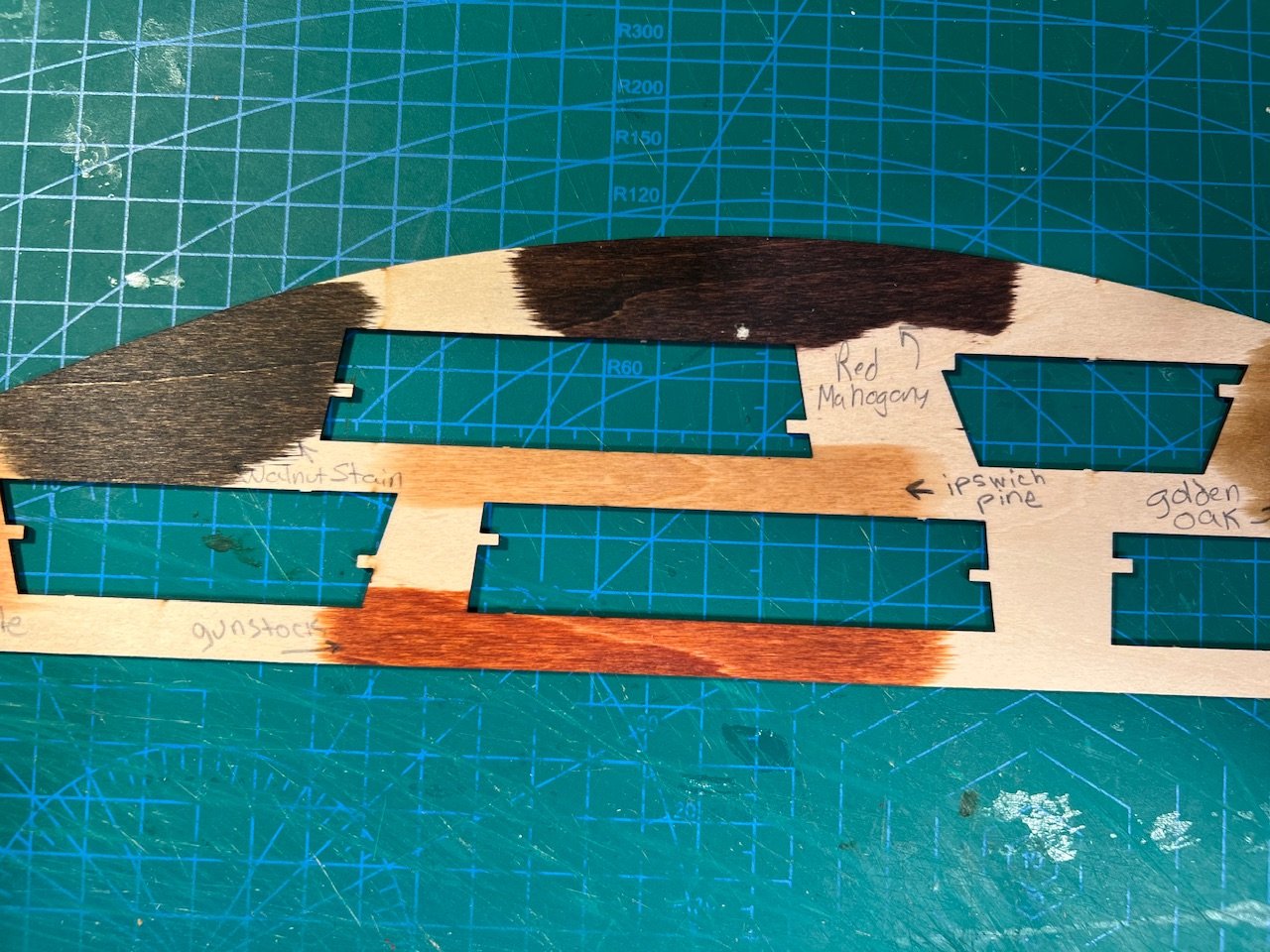

I'll need to make and paint my oars and I've been researching paint/stain schemes. The Midwest kit instructions say "Thwarts, Oars, Mast, and Boom - Clear", which I assume just means putting a matte varnish on the oars. I might do the same. I have some stains I could try to use too. I also saw a model that had them painted the same yellow as the interior.
This great build (of the Model Shipways kit) just has the oars plain, I think stained and weathered:
