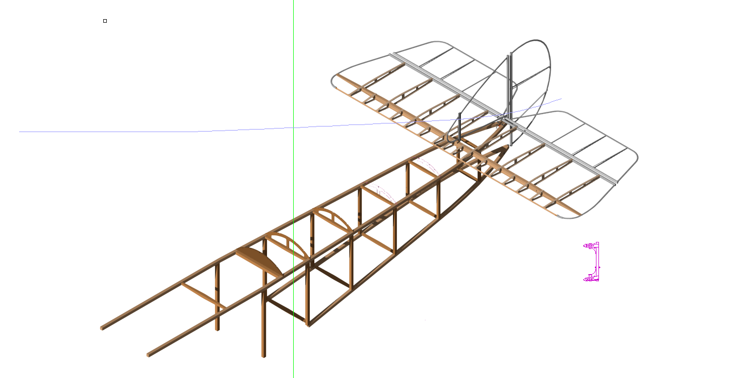

The Demoiselle came in three main variants, the 19, the 20 and the 21. I believe Santos-Dumont was only involved in the 19 and 20 while other third parties made versions of the 20 and 21.
Santos-Dumont made changes on the fly, the 20 started with a V8 but was refitted with a two cylinder horizontally opposed engine slightly more powerful than the 19.
Anyway, it's confusing. I'm drawing what I think was the latest 20 which I'm designating (unofficially) the 20d. It won't by any means be perfect but should be reasonable:
The main bit are mostly done, just everything else to do.

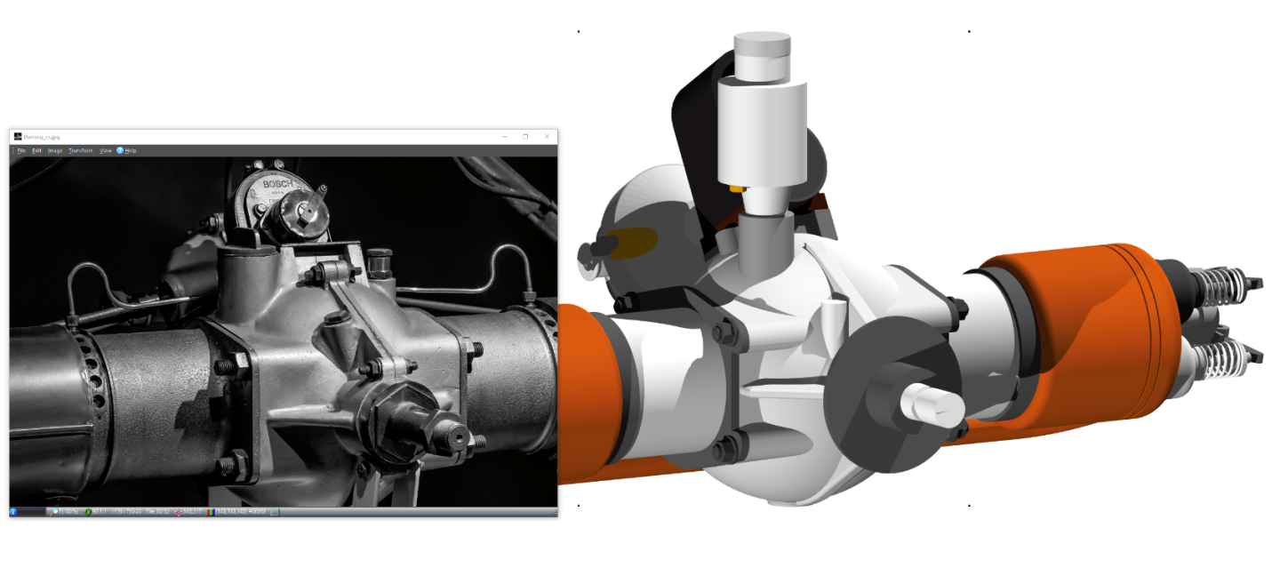

Some more progress on the engine today.
It should look like this (note, rear view):
It currently looks like this:
Craig.

More detail on the engine:

Not much visible progress, I built the intake manifolds and piping (you can see one, rear right, in the second last photo.
And that's a real crankshaft:
I found some more photos of a 40hp Darracq, very close to the one used. I was wondering how they moved the Oil Tank and Pump to clear the bamboo longeron, now I know.

The progress is a little more visible this time, I've added a cam housing, cam shaft and cams, cam followers, a water pump and a magneto. I've also moved the oil tank to the side and done some stupid things we're not going to talk about.

A bit more, oil separator plugs and leads:
And a comparison with a real (later?) one:
