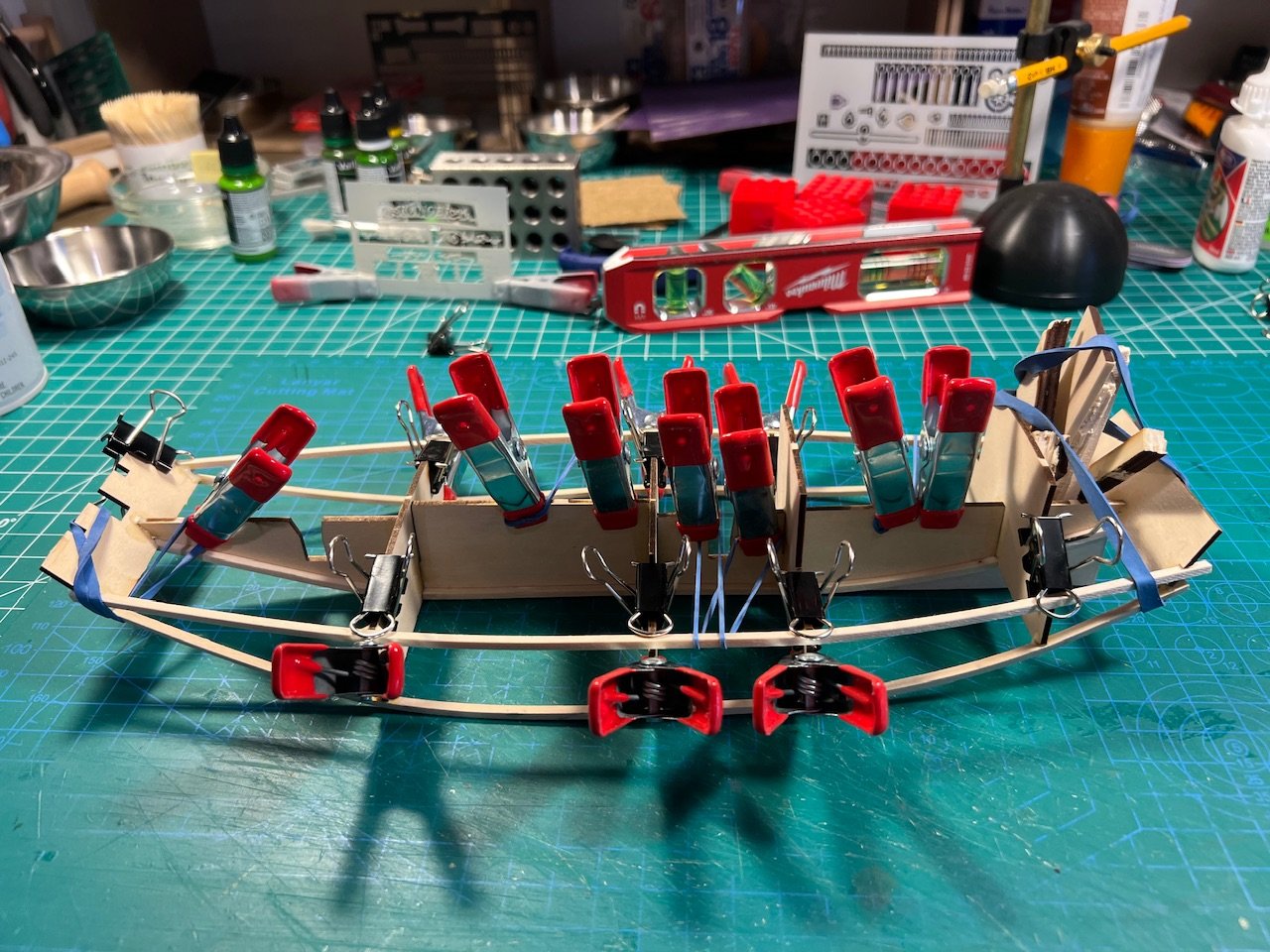

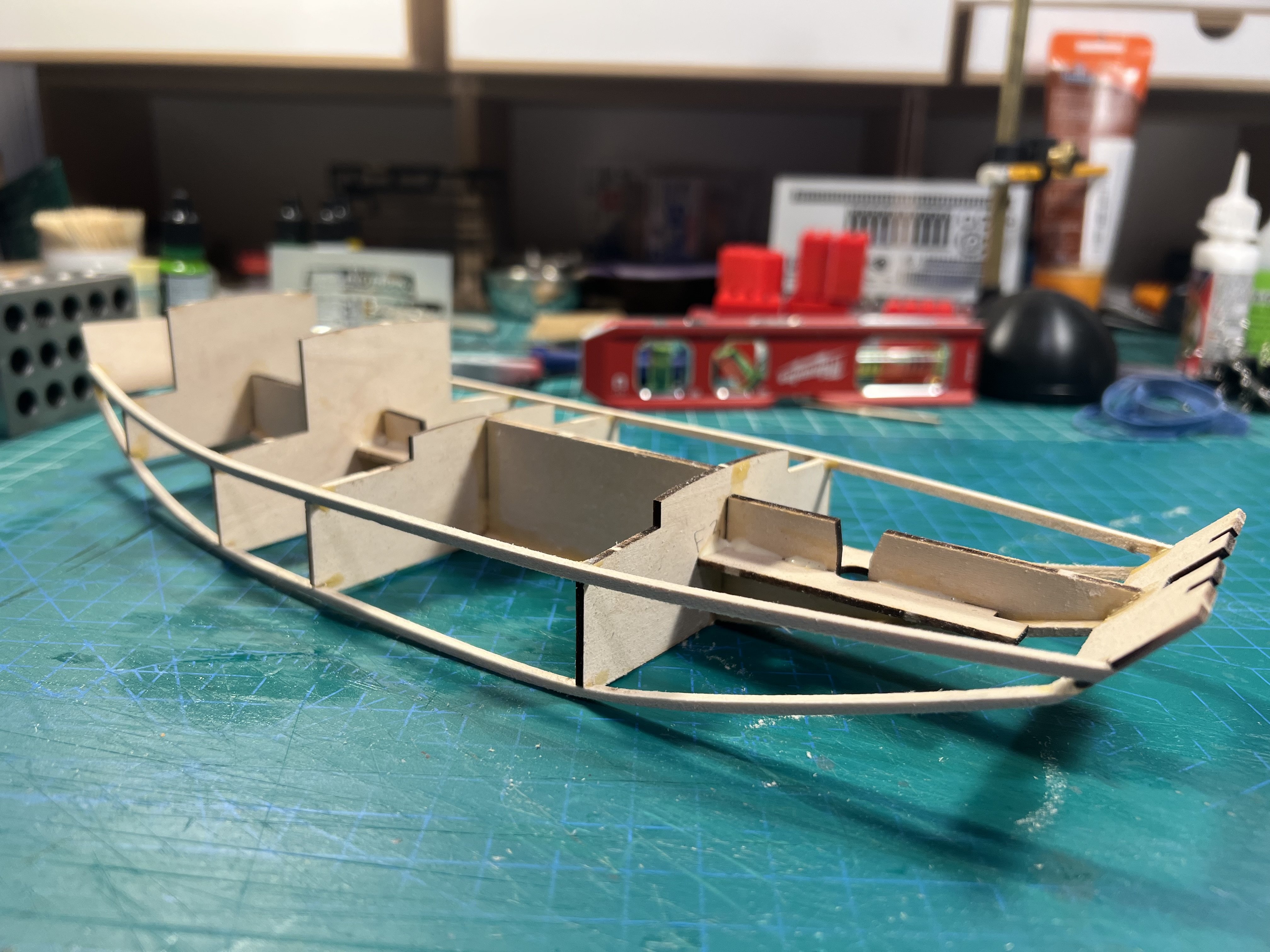

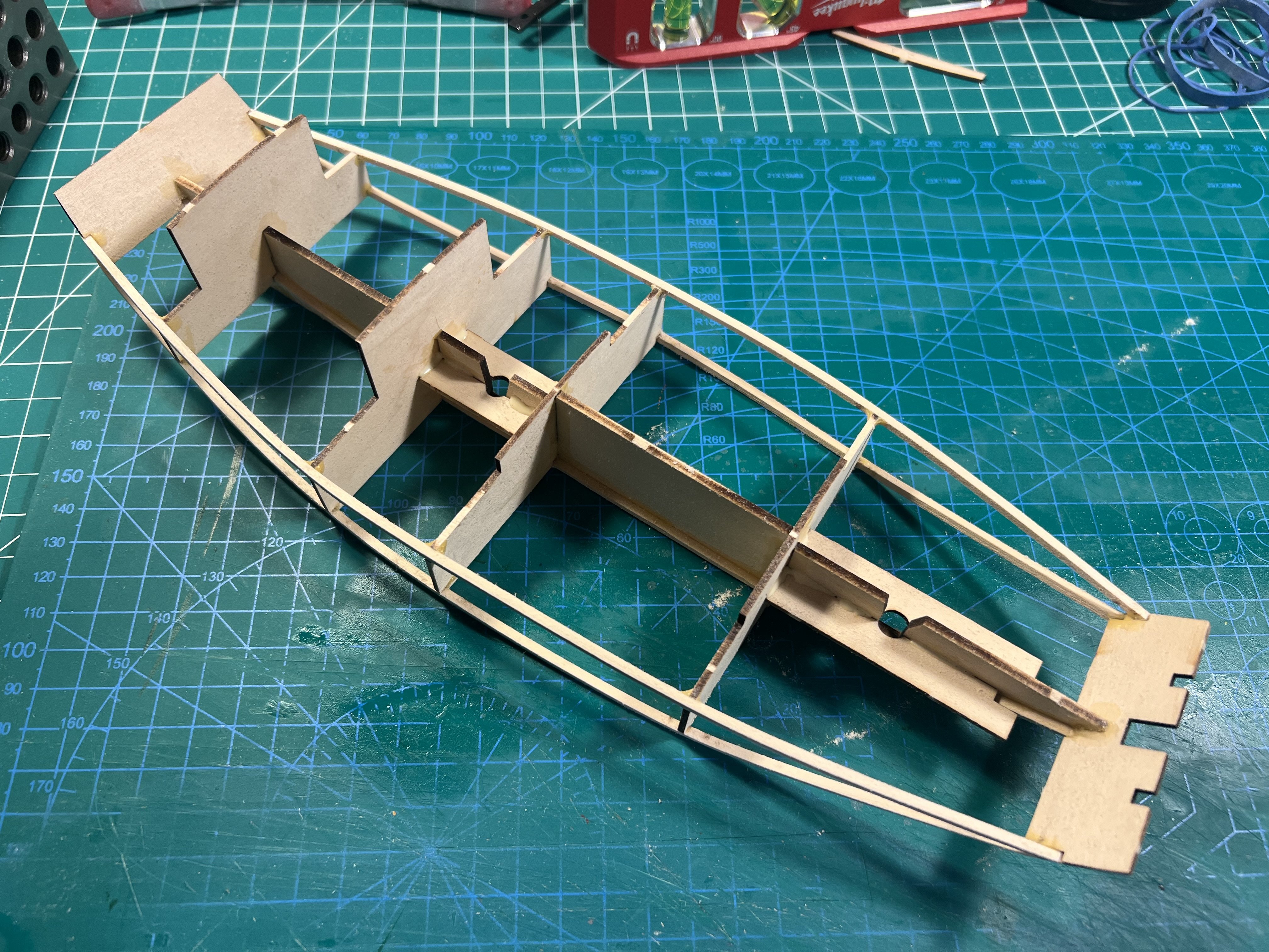

Shaping the battens along the keel and side. This boat has fairly straight bottom and sides (not planks). It’s flat bottomed and fairly boxy. These battens provide the structure the hold the sides.
The instructions say to just glue part and then bend using windex. I instead soaked in hot water for a bit. I just have them clamped in place to dry. I’ll glue them in place after they’ve dried to their shape.
I’ll need to still add sheer battens along the stop. The two I installed are what the bottom pieces of the boat are glued to. The sheer battens (and chine batten) are what the sides are glued to.
Very different construction from anything I’ve built so far.
