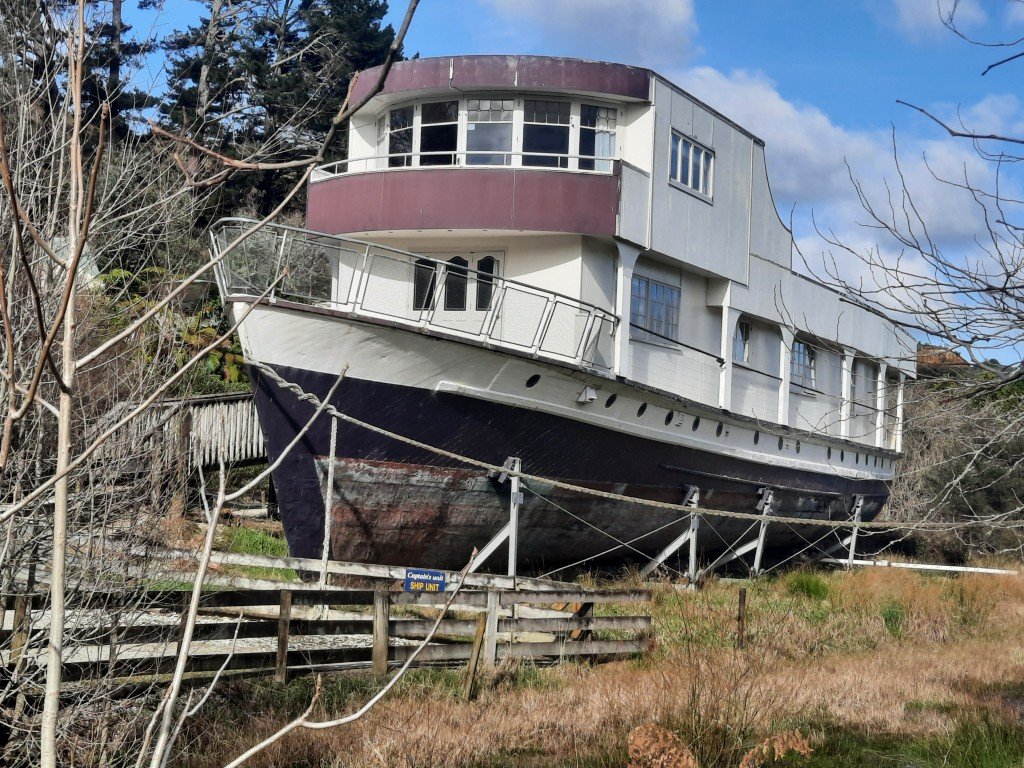

26 minutes ago, Pat Lynch said:
A RNZN Fairmile - almost identical to the vessel Q406 I chose to model. Why did I choose Q406? - I travelled on her many years ago after being converted to an Auckland ferry! Then, when touring around New Zealand a few years ago, found old Q406 way inland being used as a quirky motel unit!
Pat

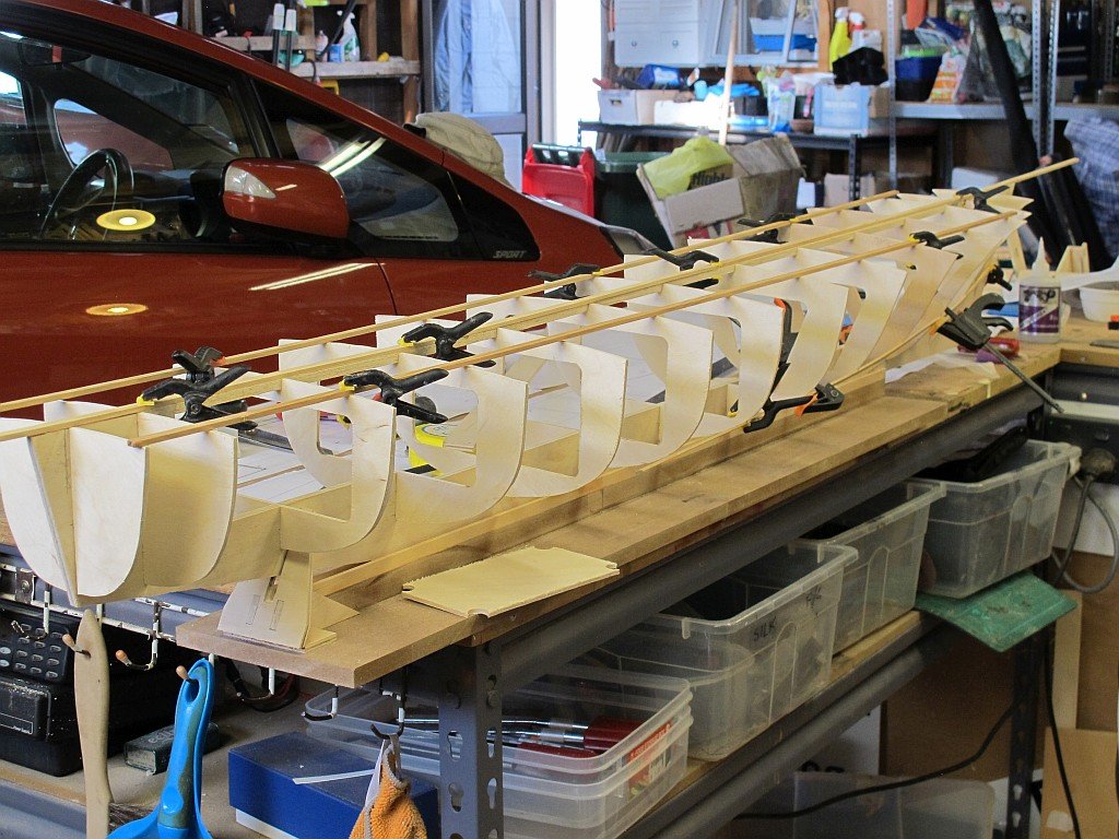

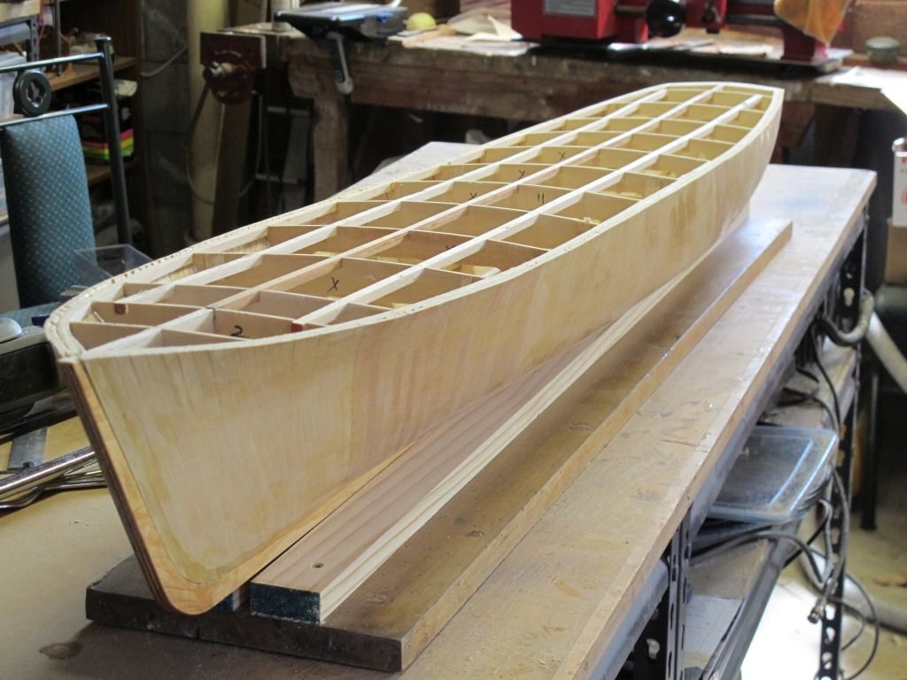

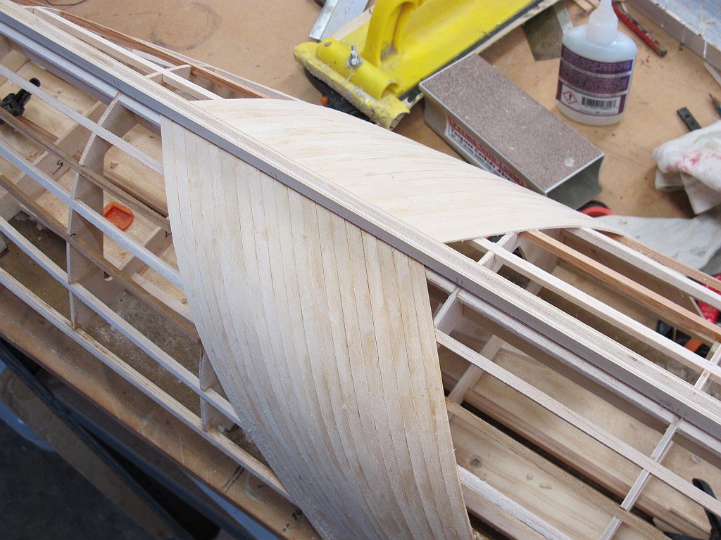

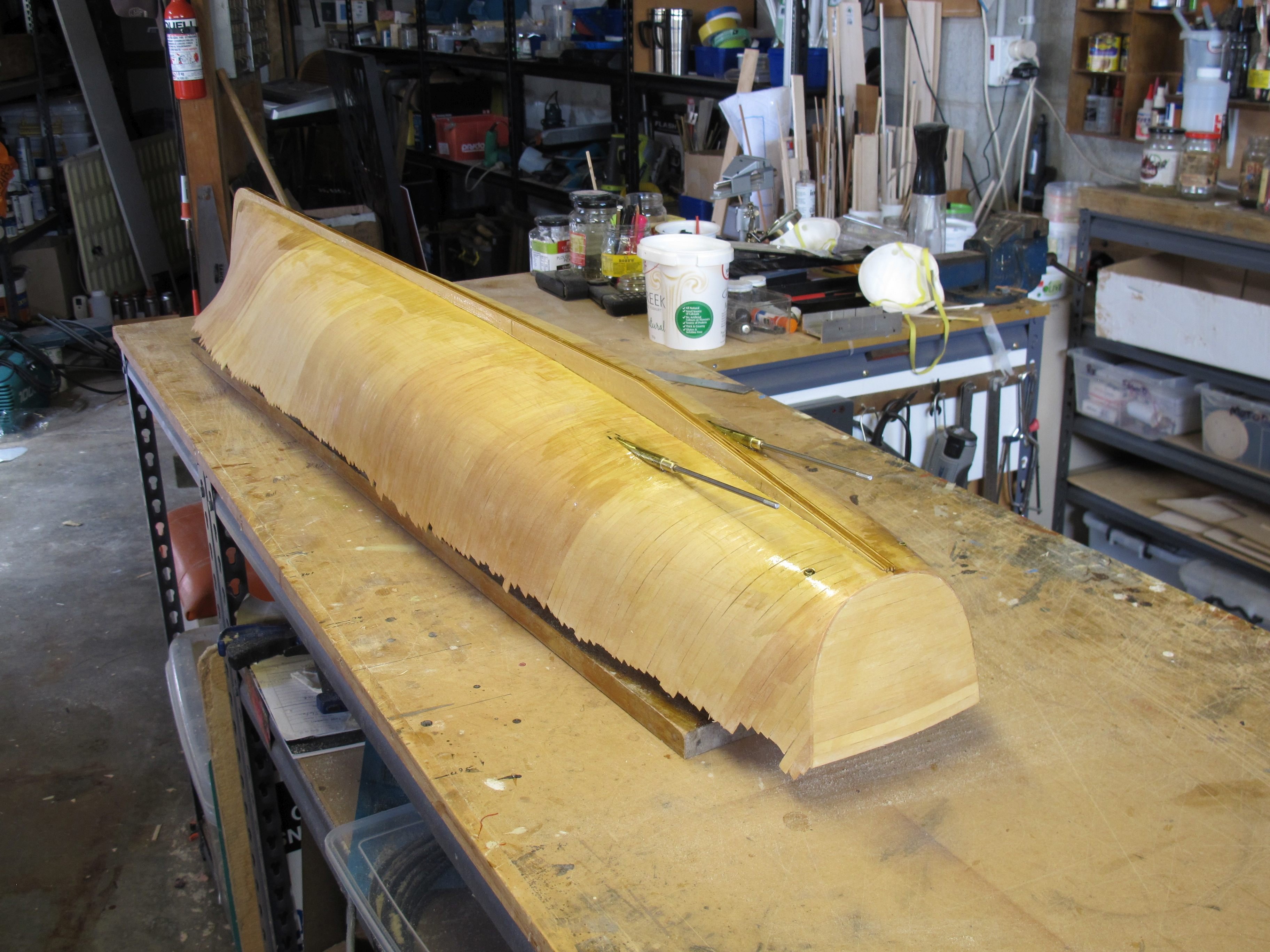

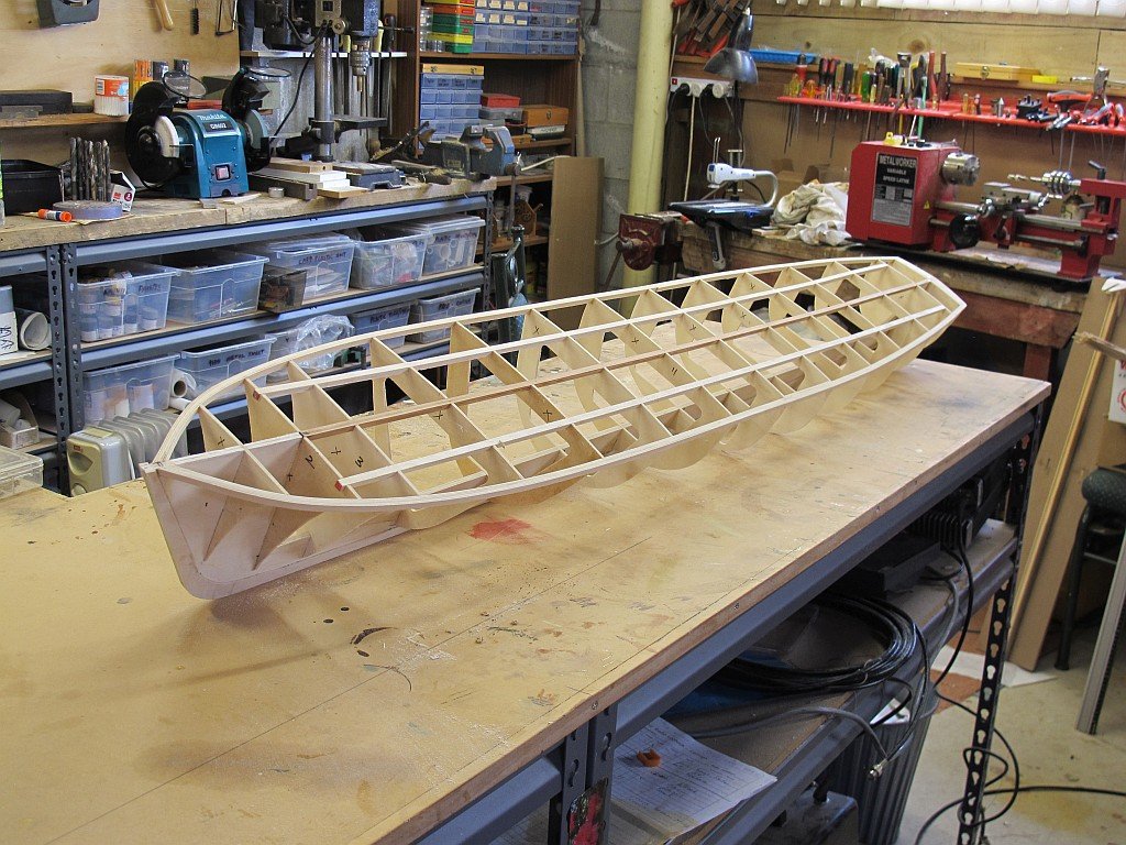

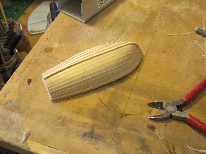

The real Fairmile C launch was constructed from plywood frames and clad with 2 diagonal layers of timber. This seemed an ideal way to build the model as well! A set of drawings of the real ship were obtained from the UK and although the detail and scales were of variable quality, they were a good start for a 1/24 scale model - a length of around 1500mm. This scale would give plenty of scope for detail and would still fit in my Nissan Dualis wagon.
The basic side view was drawn out and the keel cut from 6mm 7 ply birch. The frames were also sketched out using an old version of AUTOCAD and cut from 3mm ply and the whole lot assembled on a jig and basic stringers notched into the frames. The construction looked almost exactly like the real thing. When all was checked and sanded, the frame was inverted and remaining stringers fitted. Two diagonal layers of 2mm Basswood were fixed using medium CA with a bead of waterproof Titebond along the edges. After sanding to a nice finish, a second layer of diagonal Basswood was applied at 90 degrees to the first layer. While still on the jig, the two prop shafts were fitted, carefully aligned and epoxied in place. Now it was looking like a proper boat 🙂

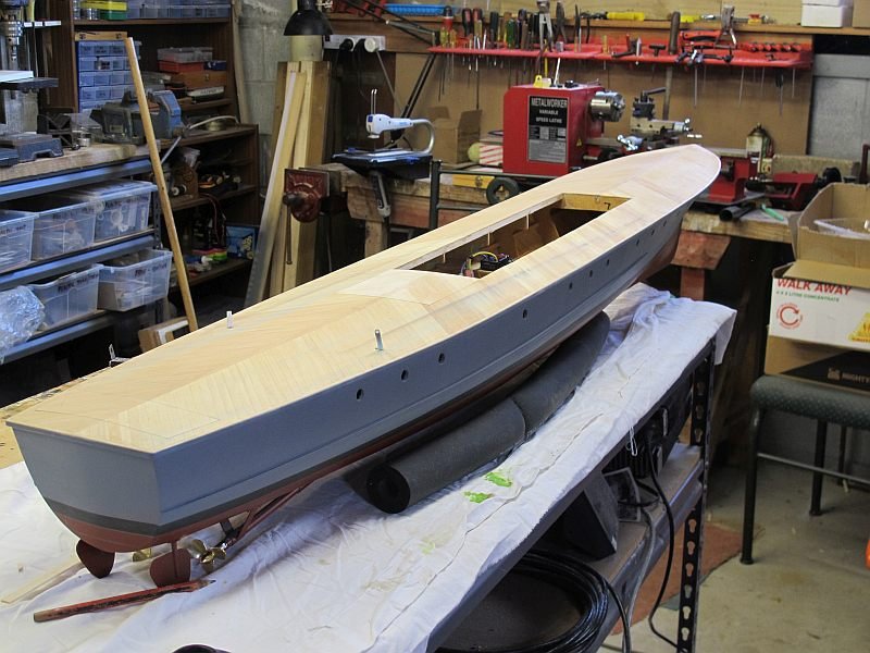

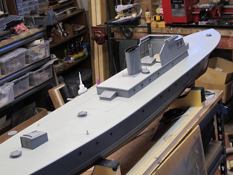

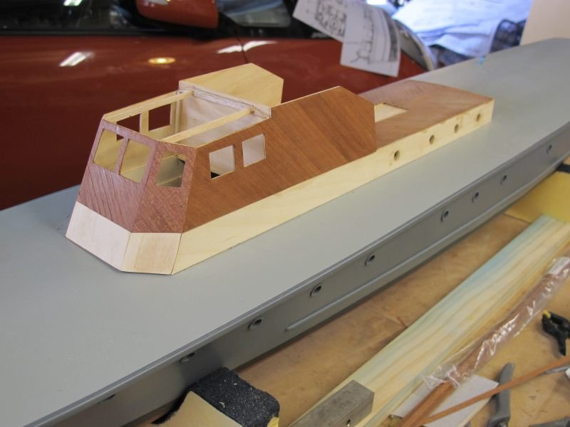

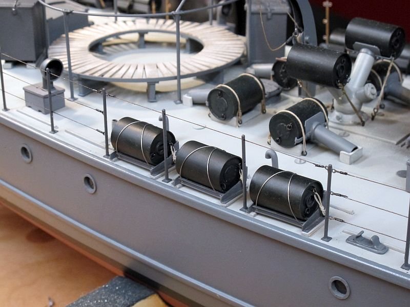

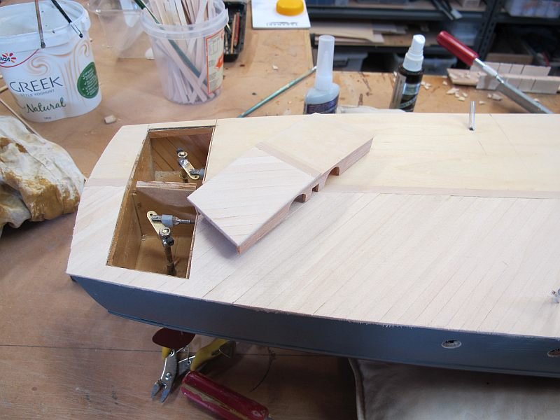

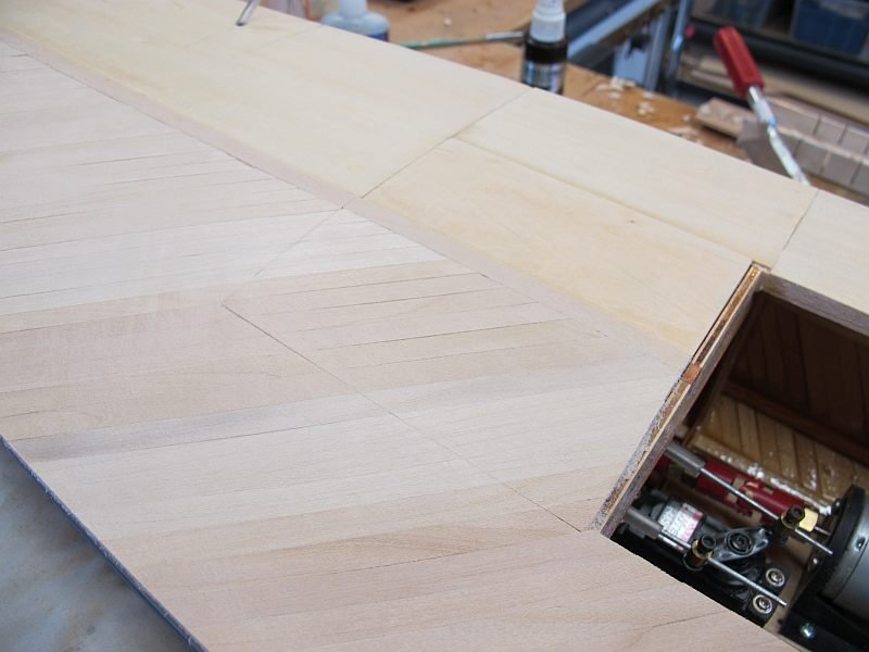

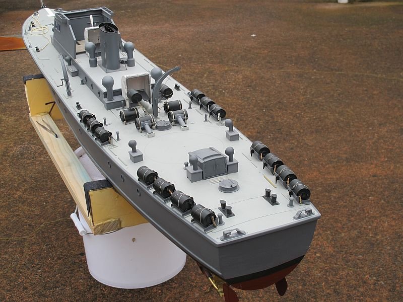

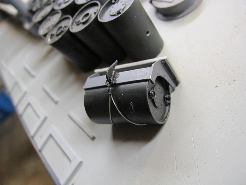

Moving along.....Next task was installing the power and control stuff - twin 600-size brushed motors (cheap) and controllers, radio and switches etc. Later, I also added a sound system with actual recording of the big petrol engines with start-up and linked to the throttle. With all the 'innards' fitted, The deck was framed and sheeted with 1.5mm ply. As per the prototype, the deck was planked diagonally as was the upper superstructure - a simple bit of work from 1.5mm ply. There are various hatches and companion way structures also added at this stage. The rows of depth charge racks around the rear deck were added to make sure they all looked ship-shape!🤔
A start was made on the many charges themselves - slices of a piece of correct diameter plastic tube. (old knitting needles actually). The vents, port-holes and other details shown are made from styrene sheet and tube. If anyone wants more detail, please ask!

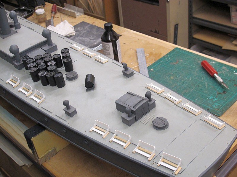

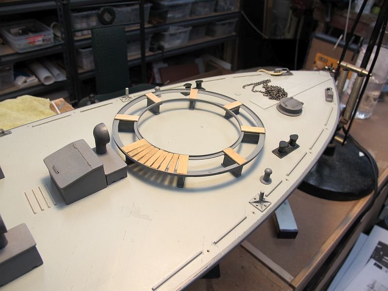

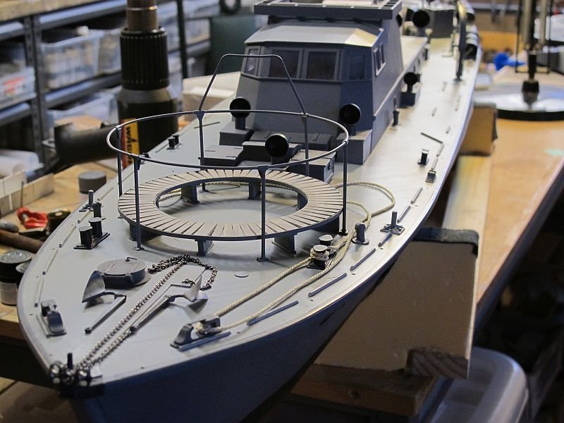

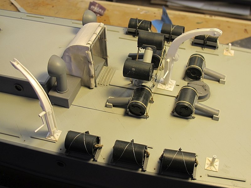

A few more details of the Fairmile as the build slowly progressed. Almost all the important stuff on the vessel is scattered around the deck - virtually covering it by the time the project is complete. At 1:24 scale, there is no excuse for leaving off visible details such as depth-charge securing cables and quick-release catches - I guess they were given a good boot over the edge! The forward gun platform has a raised wooden walkway and much of the foredeck clutter is complete. All parts have been scratch-built. This was my brief to myself when I started this project. I love the research and effort needed to work out ways of creating the odd-shaped bits on the model. ☺️ ps. I didn't make the chain or rope!
Pat

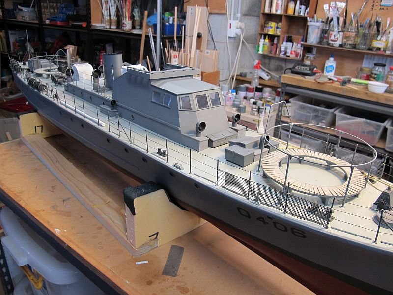

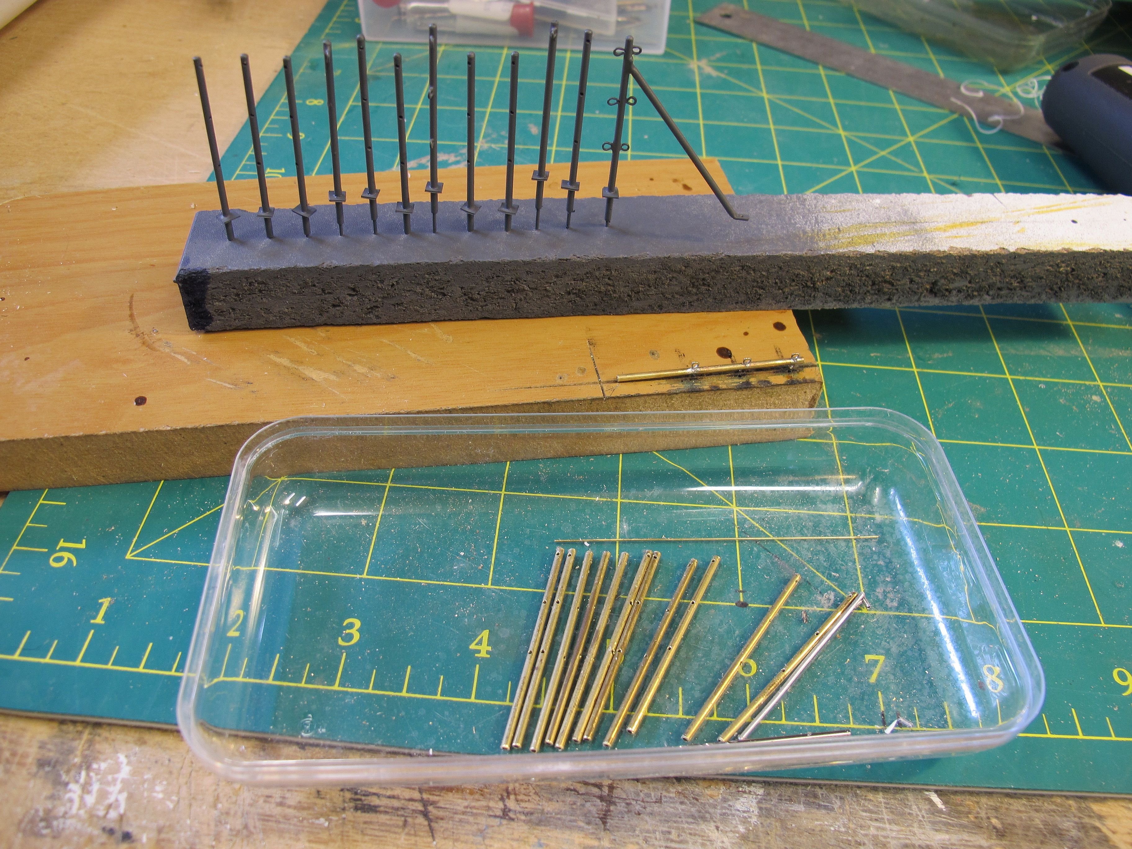

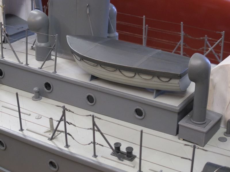

Continuing the model - 1:24 is a great scale for those who love detail! When to stop is a major problem - I guess when the next project was being considered, then this one needed to be finished. The railings were a learning curve and a few ways were tried and I eventually settled on 1.5mm brass tube stanchions, and stranded beading wire giving a realistic look. The little 'captains gig' dinghy is a shaped balsa block with Basswood planks. The cover is rc model plane textured covering material "Solartex".

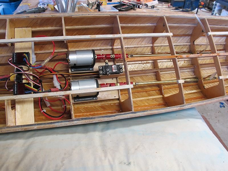

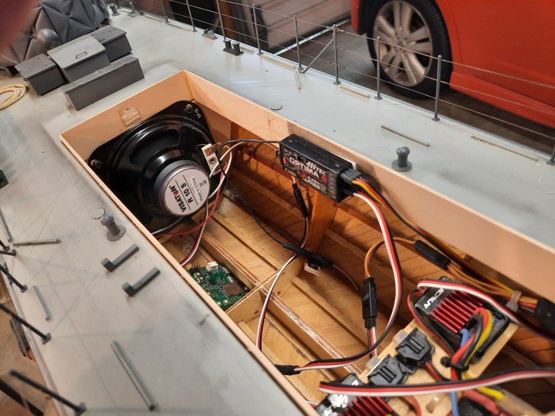

I'm curious how you handled the dual steering. What kind of linkage did you use?

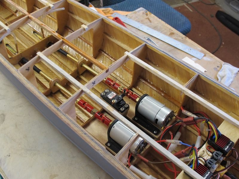

Thanks for the kind comments folks. Here are some photos of the basic internals. The rudder servo is in the 'engine room' with 2 steel pushrods in nylon tubes down to the stern. Each rudder has crank on the rudder shaft. Easy and it worked well. I had also intended to have the motors independently controlled to give each prop the chance of going in opposite directions for tight steering. Haven't done that yet. 😉
Also visible in the engine-room photo - the prop shafts each have an oil tube which can be re-oiled by removing a small cowl ventilator on the deck above!

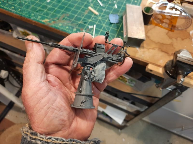

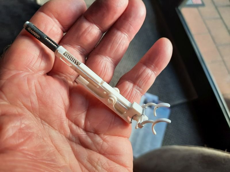

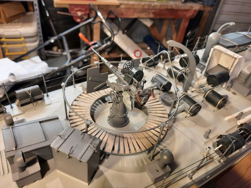

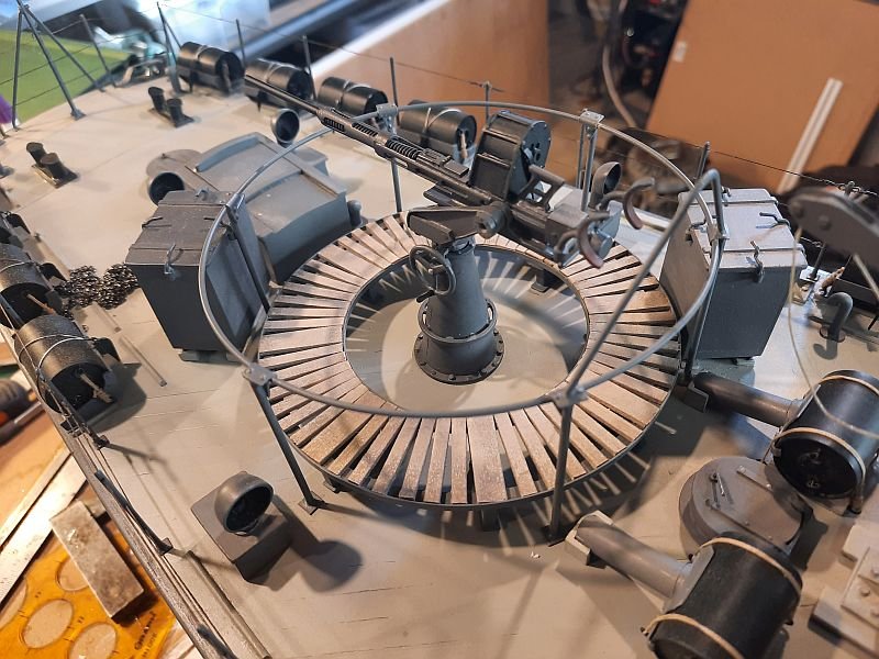

The armament was fun (despite its lethal purpose). An Oerlikon 20mm gun down the back was built from scrap tube, wire, old ballpoint pen springs and masses of plastic scraps. It was quite fun as there is only one to make - and there is plenty of accurate scale drawings available.
Other detail can be seen around the deck as the model progressed.

The forward gun is a Rolls Royce 40mm - I'm told it wasnt all that successful but I doubt the NZ boats even used it - except for practice.
The deck is finally getting the look I was aiming for - a lot of clutter.

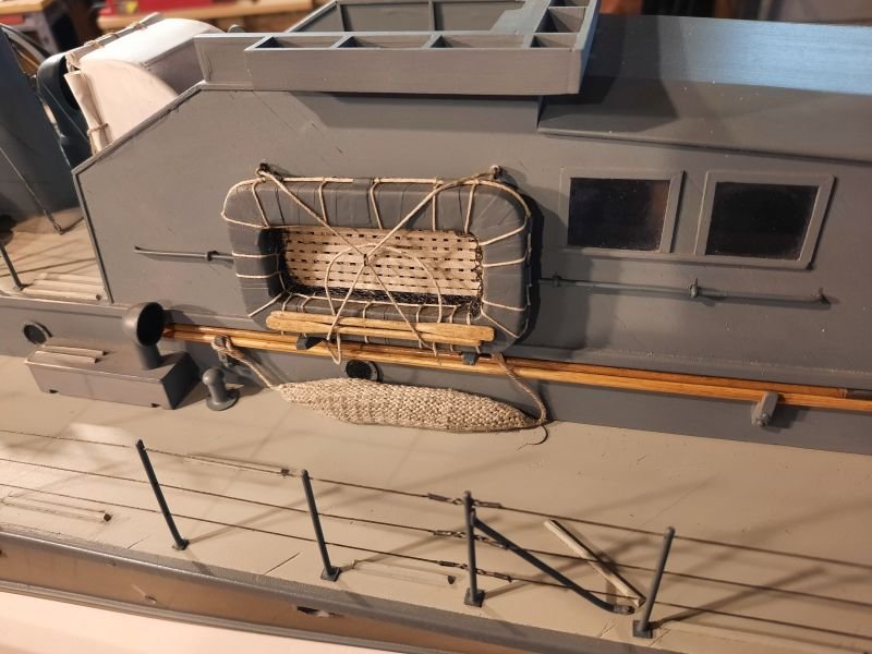

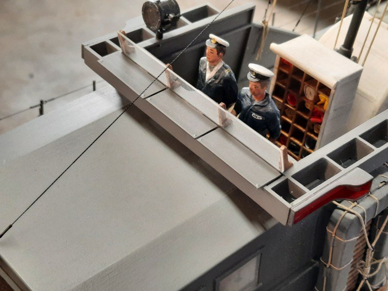

However lots of little things were still in progress - Life buoys, flotation matts, a bridge crew and flag locker etc etc.......here are a few pictures.....

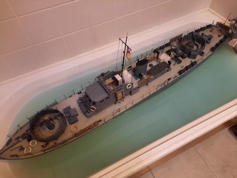

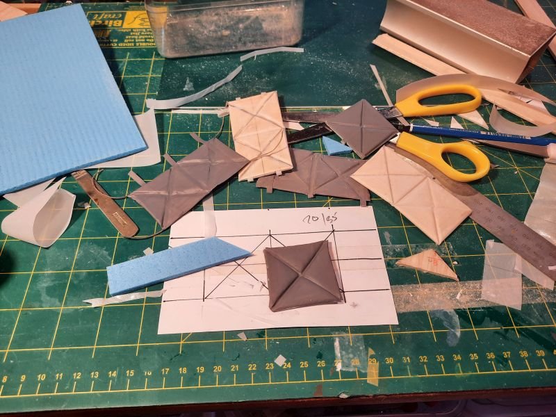

The life rings were cast with resin, the flag painted onto an old, very worn piece of handkerchief - it actually flutters when in motion. The shrapnel matts were made 'squishy' with thin kitchen sponge and model rc plane covering - 'Solartex'. The sound system installed - it has the actual Fairmile twin petrol engine startup and running sounds. Then the requisite bath tub test - it almost didnt fit! But no leaks - now we are ready for a proper sea trial!

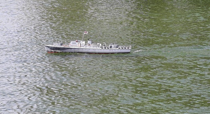

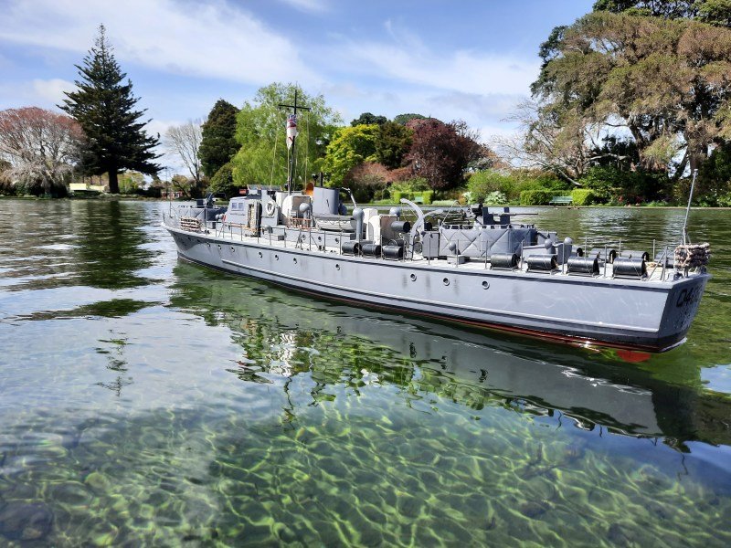

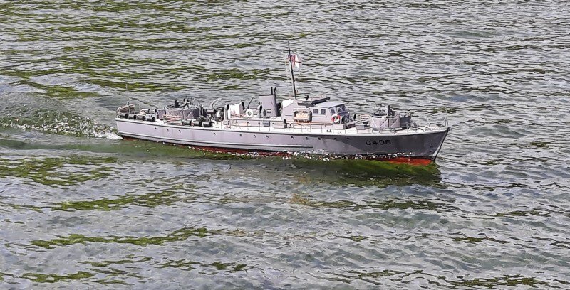

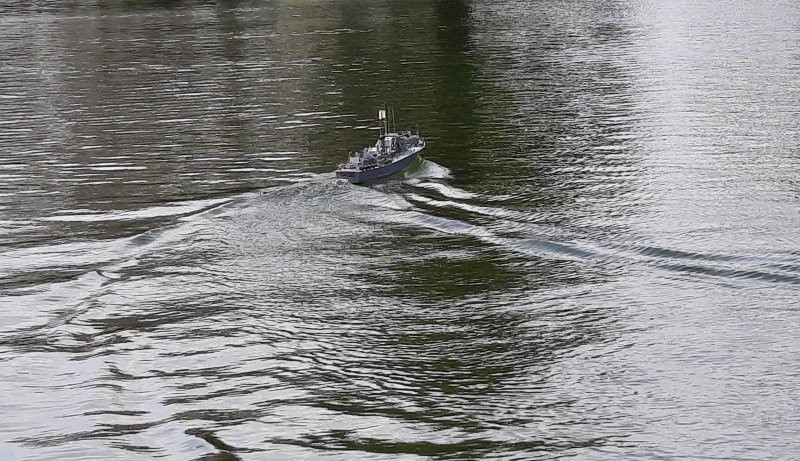

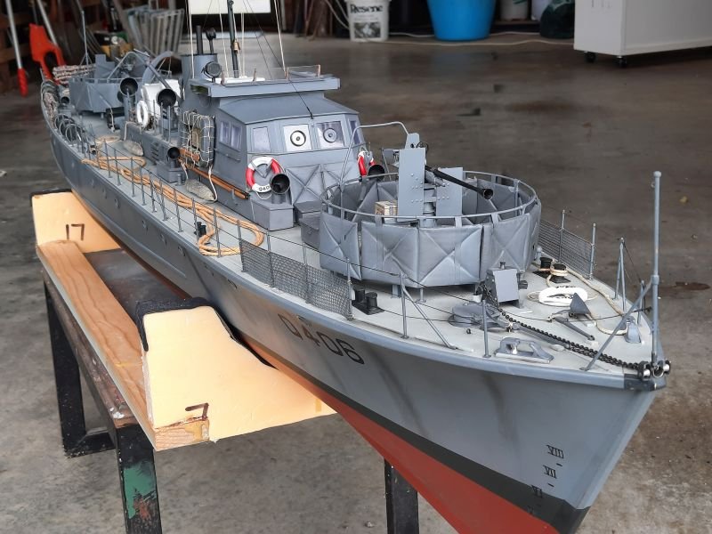

I guess that just about finishes my nearly 2 years of building - a good COVID project! The maiden outing was totally successful - she needed about 2Kg of steel bars to get her sitting properly and a brass reinforcing strip added to the bow to protect her when running into the concrete at the local model pond. She's been out several times and after a few more minor details added after the maiden, Q406 was declared "finished". Young onlookers loved it - esp. when the loud fog-horn sound was played!
There is video posted on a popular video-sharing site under my name and Fairmile!
Thanks for the interest in my efforts.

Congratulations, pat! She looks magnificent on the water. I especially like that low angle image from the port quarter.
