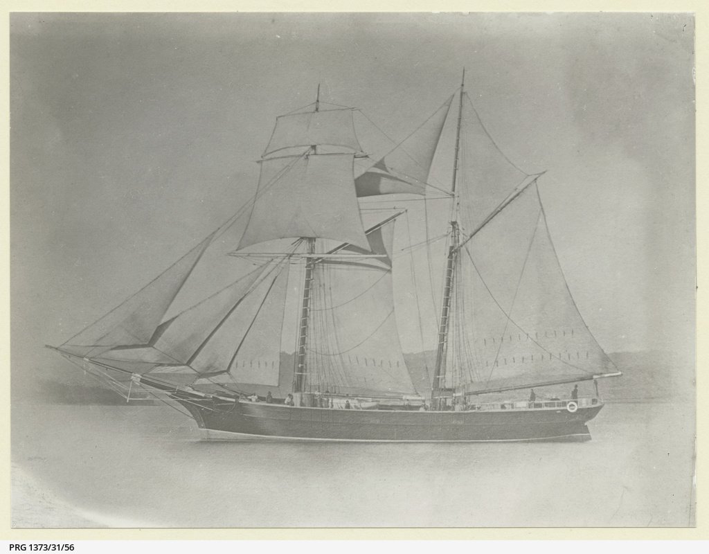

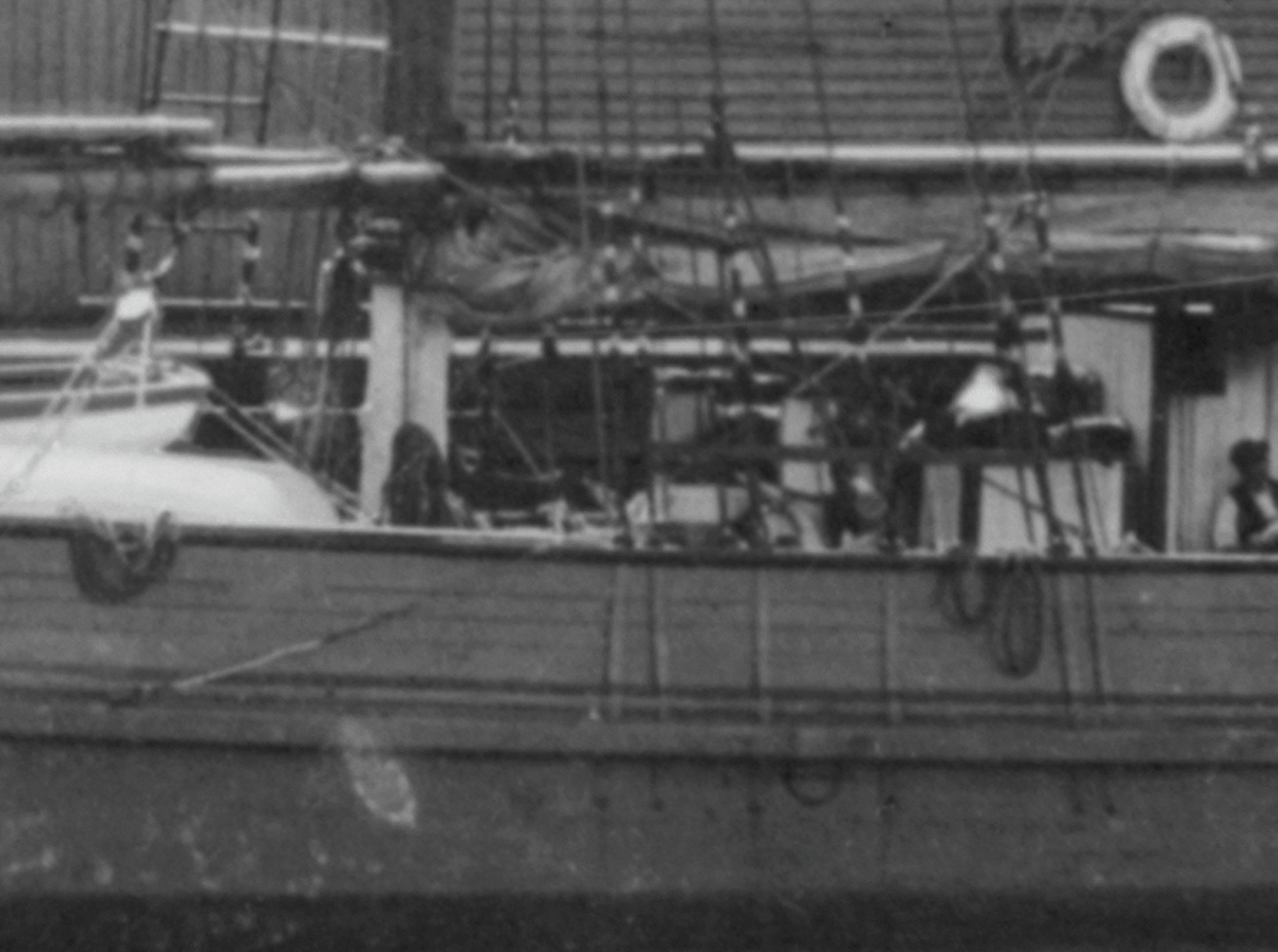

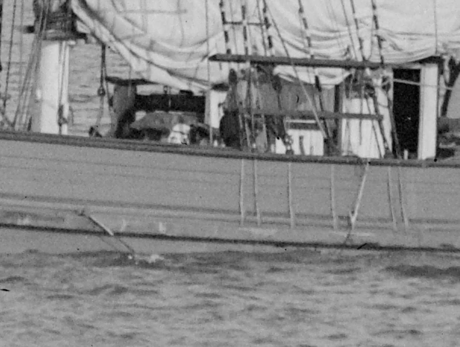

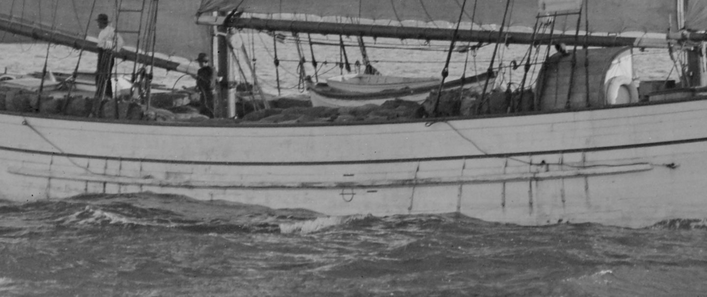

I'm uploading seven images showing a wire rope seen running across the chainplates/shrouds on a pre-WWII three-masted coastal trading topsail schooner (150 tons approx). It appears on both port and starboard, on main and mizzen; so four instances on the vessel.  I have no idea what it is.
You can just see that the lines in question are bolted at their forward end to the top of the thick rubbing strake that is fixed running down both sides of the hull fore-aft just below the deckline. The aft end seems to be loosely shackled to any convenient shroud. All images are of the same ship, between 1917 and 1936.
The vessel is Australian, but the influences in its fittings are British, American and vernacular. So the rope could be a thing from America, UK, or else an Australian idea.

Is it a line that a ship's boat could grab/hold temporally before a securing line is tied off?
It could be. Along slightly similar lines, I've called my computer folder where I've collected photos of it, "painter thing". But why have so many such grab lines if just for that convenience? And why wouldn't it be seen more widely around the world if it was so useful for that purpose? Why leave one end loosely tied and not just fasten both ends to the rubbing strake, kind of like how a rope is becketed around a lifeboat? So I'm not satisfied with the grab line / painter idea.
I have found photos of ten coastal sail traders with this feature, all located in the south east region of Australia (except one, from northern New South Wales). So it wasn't restricted to one vessel or one captain's own idiosyncratic ideas. All those vessels were coastal traders around the 100 to 150 ton mark. Smaller vessels in that region didn't have them, nor did larger vessels; and not all vessels in that region and of that size had them.
Ian, were these vessels engaged in any particular trade? A possibility is 'guest warps', used to secure boats that are loading or discharging cargo from the schooner. Not the usual configuration for 'guest warps', but at the moment I can't think of anything else.

But why four such ropes? Excessive if the idea is to moor a boat to the ship. But perhaps not excessive if there is something peculiar about how these ships needed to come alongside a bush wharf to load sawmill timber or drop cargo to an isolated settlement. In which case two lines per side would make sense, which as circumstances required, might need to have been port or starboard. But it doesn't fully explain why ordinary mooring ropes wouldn't do. I don't feel this is "solved", but it might be getting close -- or else might just be barking up the wrong tree. I can't tell.

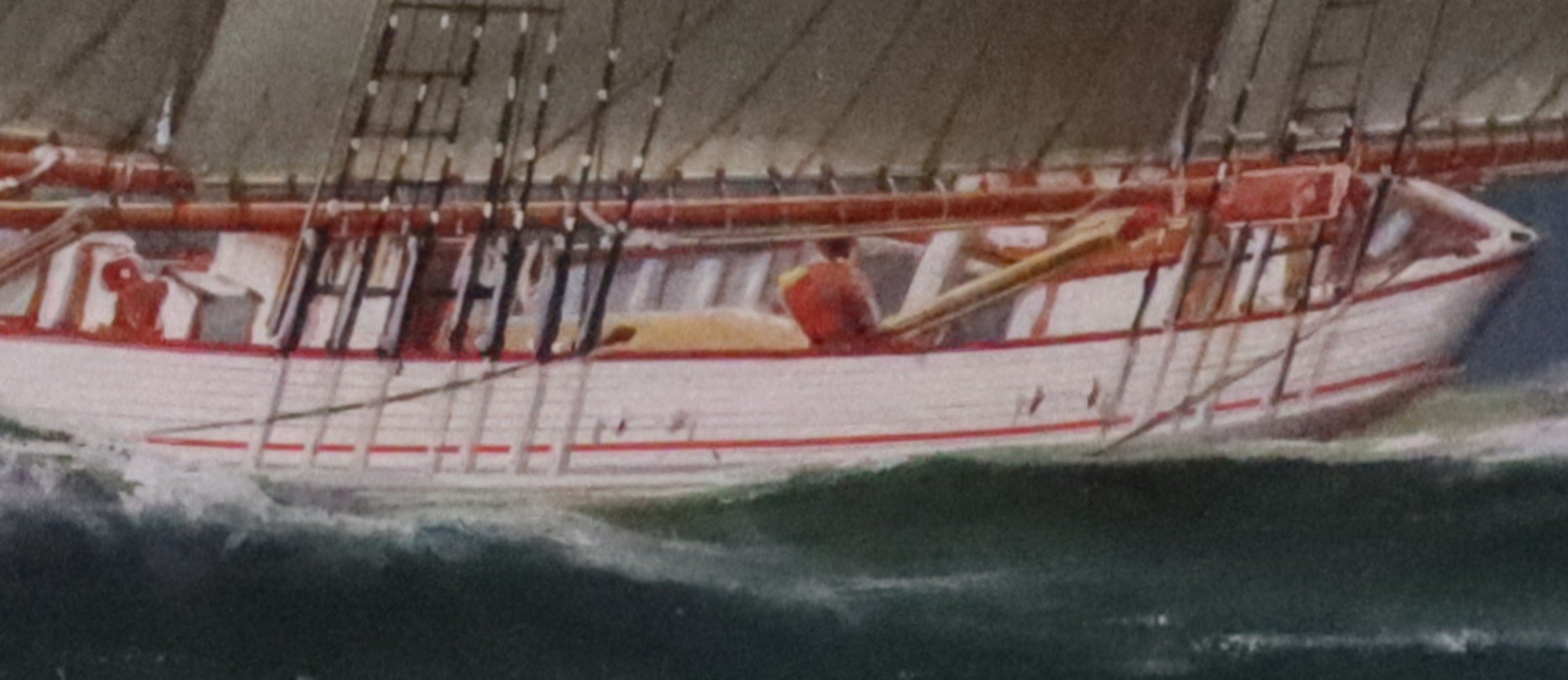

I love a puzzle, and those are really intriguing images - both paintings and photographs.

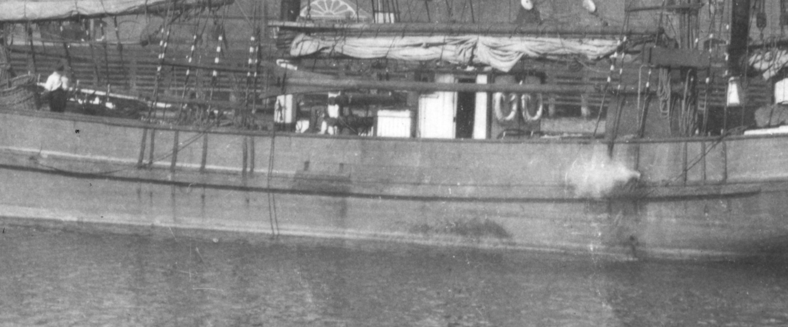

In some of the photos the forward end of the line appears to be attached to the outside of the hull approximately at the line of the deck edge?
I've no idea what they could be for. Fascinating!

Yes, intriguing. As a guest rope to secure to -- say -- a river wharf, Jim Lad's suggestion for what these wire ropes might be has merit, I agree. But why not ordinary mooring lines from bow and stern? These wire ropes in the photos are always located at the shrouds. Perhaps one other possibility is that, since these small ships had no gangplank but rather, at low tide when the deck was well below the wharf, the crew had to leap or fall onto the shrouds and shimmy down to deck (noted in a book called Bass Strait Ketches (Harold Salter 1991), which is roughly what these vessels were). A guest rope at the shroud might have helped haul in the vessel to shore for that purpose. But that's just speculation -- I still don't know.

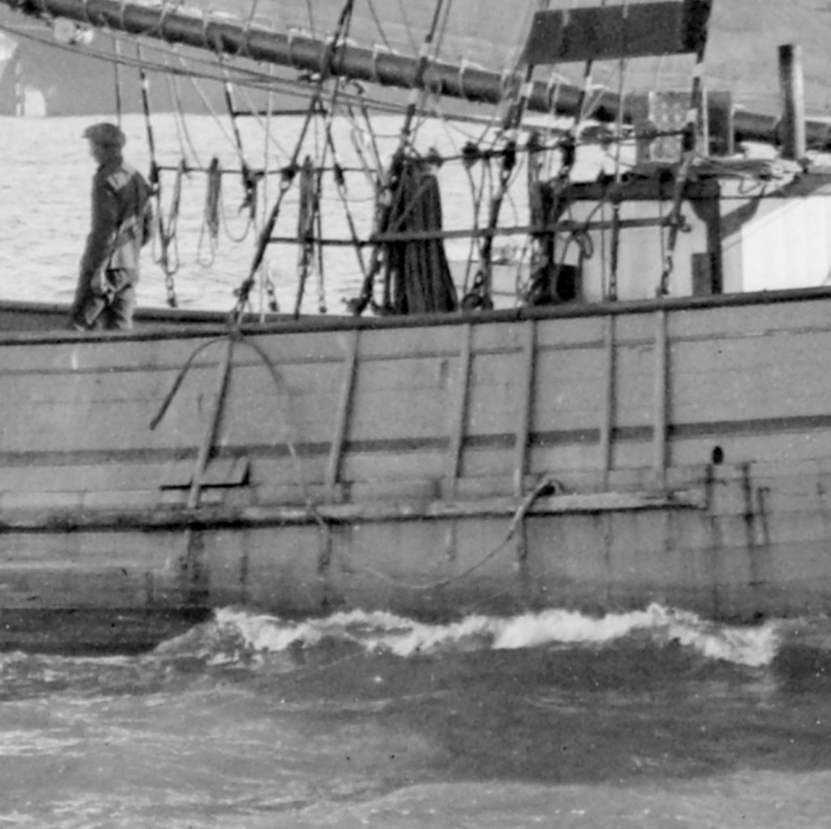

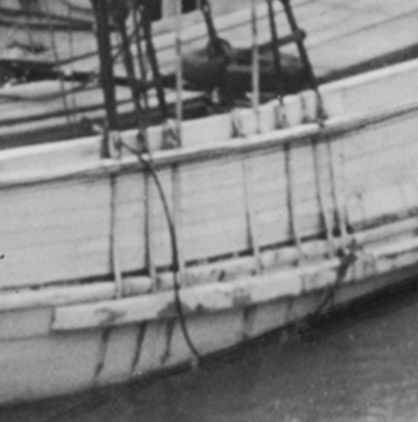

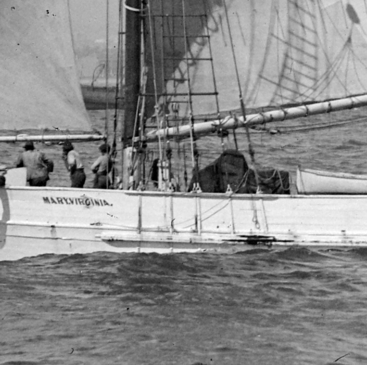

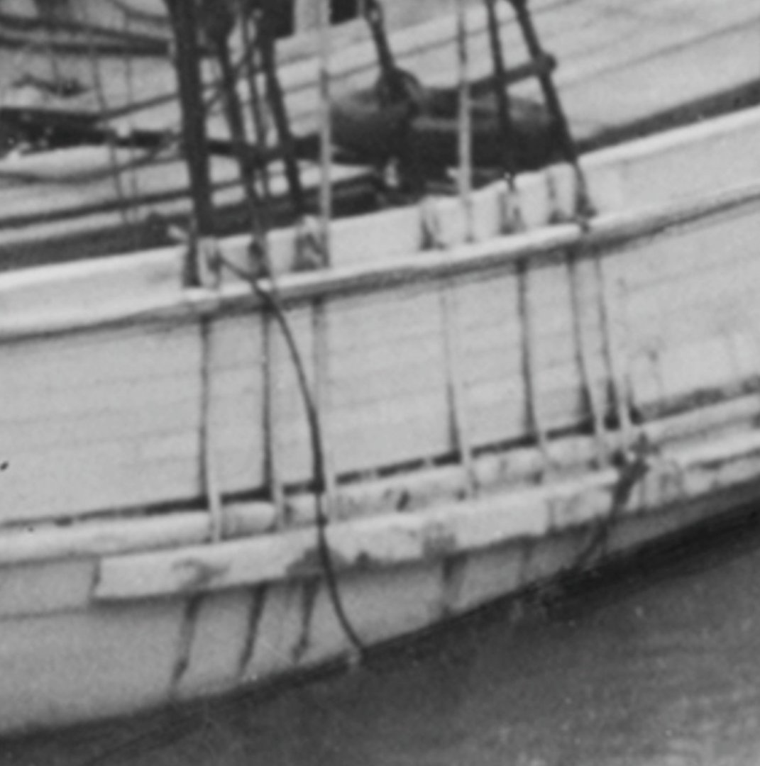

Here's a few more photos that show how the fore end of the wire rope is fastened to an eyebolt (or so it appears) on the rubbing strake or thereabouts (actually called a 'sponson' in SE Australia back in the 1920s/30s, a terminological hangover from paddle steamer days I suppose), just below the deck-line. The aft end of the rope appears to have a spliced eye. In some of these photos -- which are all of different vessels -- you can see the rope is becketed to the back shroud.

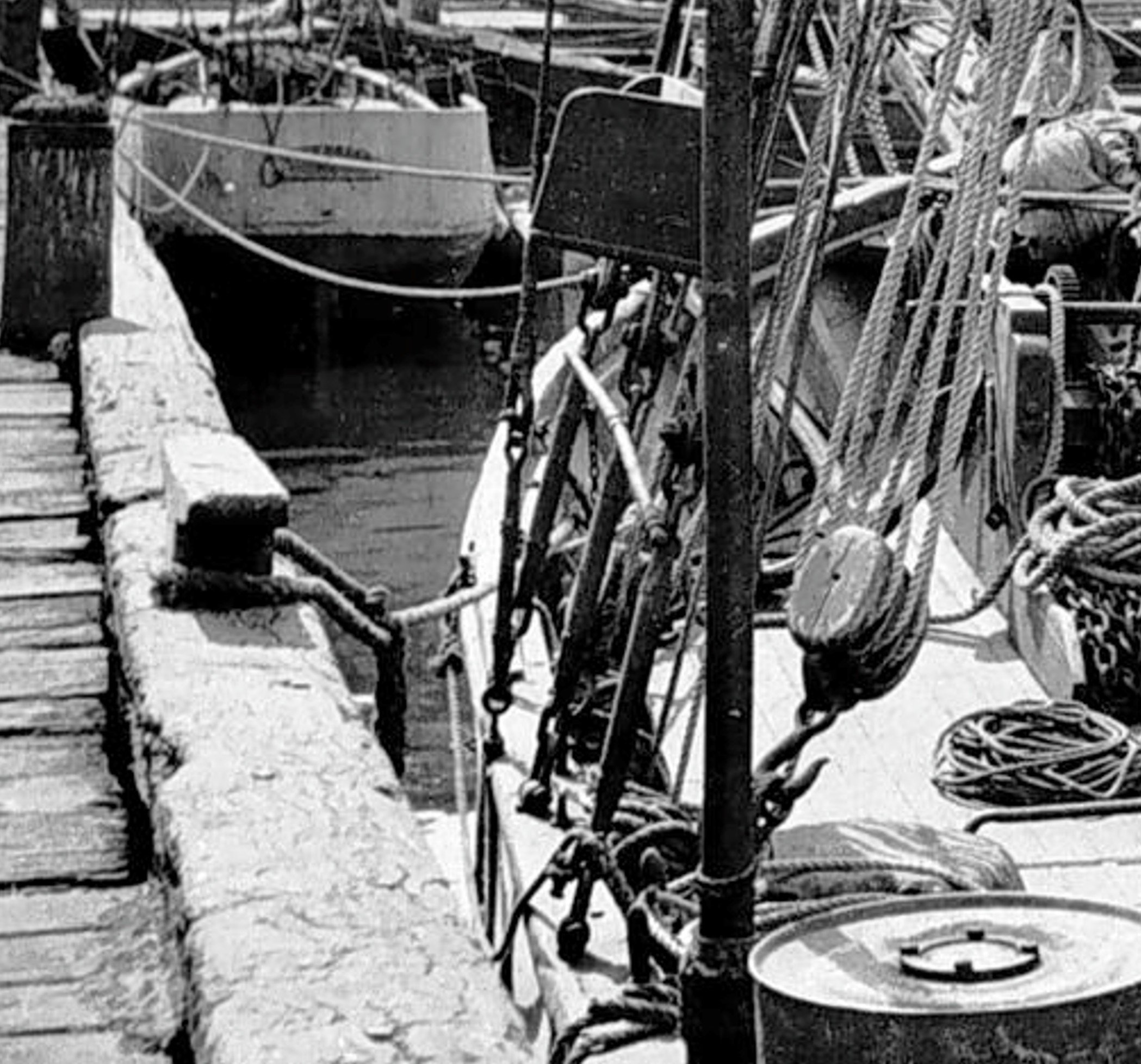

Never heard the term 'guest-rope' before, but seems to make sense for something a boat crew could hold onto while coming alongside. However, in such a case, I would have expected the hope to be running more or less horizontally, while on virtually all the pictures one end is tied up to the bottle-screws or thereabouts.
I know that yachts-people sometimes jump ashore and grab the shrouds to pull their boat towards the quay, but I am not so sure that would work for a 150 ton schooner. Otherwise the 'guest-rope' could help in such endeavour. However, I would rather expect one man to jump ashore and another throwing the mooring line to him, with which the ship could be coerced more safely towards the quay.
A puzzle ...
Another pure guess: lightning conductors?
to be tossed into the water in thundery times?
XXXDAn
With the forward end fastened to a strong point, it looks like the wire was supposed to take substantial strain. Yet every illustration shows it loosely and lazily draped, with a temporary fastening somewhere towards its after end. My conclusion is that they all show the gear in its "stowed" position, not when it was serving its intended purpose.
Given where the wires were attached, my guess would be that, when they were serving that purpose, they projected  out from the side of the vessel. Being wire, with no rope tail and no tackle, they would project a set, fixed distance. So what needs such a rig?
I'd go with Jim Lad's thought that they were specific to some kind of cargo handling. Did these schooners work with lighters alongside? Maybe with rafts of logs floating alongside? Was there a particular arrangement on the wharfs were they worked, allowing them to be hooked on in some way?
Whatever the purpose was, the wires were important enough to the schooners that they were included in the one painting. Photographs capture every detail but artists only include what matters to them or their clients, so the wires were significant to someone.

Good discussion! Based upon what has been said/speculated here is another guess.
It just looks to me to be a quick way for boats to tie up alongside.
If these vessels regularly took alongside small boats or barges to transfer mail, cargo or passengers, having the fixed lines for the boats to tie up to would be simpler and faster than having the ship's crew dealing with mooring lines and such. It appears (in some photos) that the free or aft end has an eye spliced in it. That would be convenient for the boat's crew to tie on to quickly. That end would be on the boat while they were tying on, and that would be easier to tie to than trying to tie onto a fixed part of the ship with the boat bobbing alongside. This would work with the ship moving, so the ship wouldn't need to anchor.
The lines would automatically position the boats alongside at convenient positions for transferring cargo, etc. Since you wouldn't want a boat alongside the shrouds the best place for the shipboard end is at the shrouds, with the other end trailing aft to position the boat away from the shrouds.

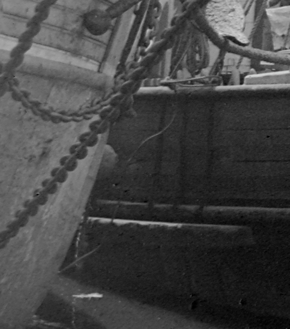

There are quite a few photos of these vessels in various collections, there surely must be one that shows one of these lines in use. Especially since they would most likely have been used when in port, where photographers most often lurked.
Over the years I've found many photos of these vessels, since they are my interest and I'm a deep-research type. Yes many were taken in or near docks, but surprisingly few taken of the dockside moorings. Usually it's a vessel approaching/departing port, or moored but taken photo taken across clear water showing the side away from the dock. But, I've attached the second of only two photos I have of these "mystery rope" vessels  where you can see the actual "mystery rope" at the mooring. The first of those photos I included in the OP above. The second I'll attach below. Note that the rope is not in use. The ship is moored in the usual way. See my next post which I'll write immediately following on from this, with a big surprise. Anyhows, here's the photo -- at Little Dock in Melbourne, I guess in the 1920s, ketch is small but still unidentified. The rope is there, look hard and you'll see it.

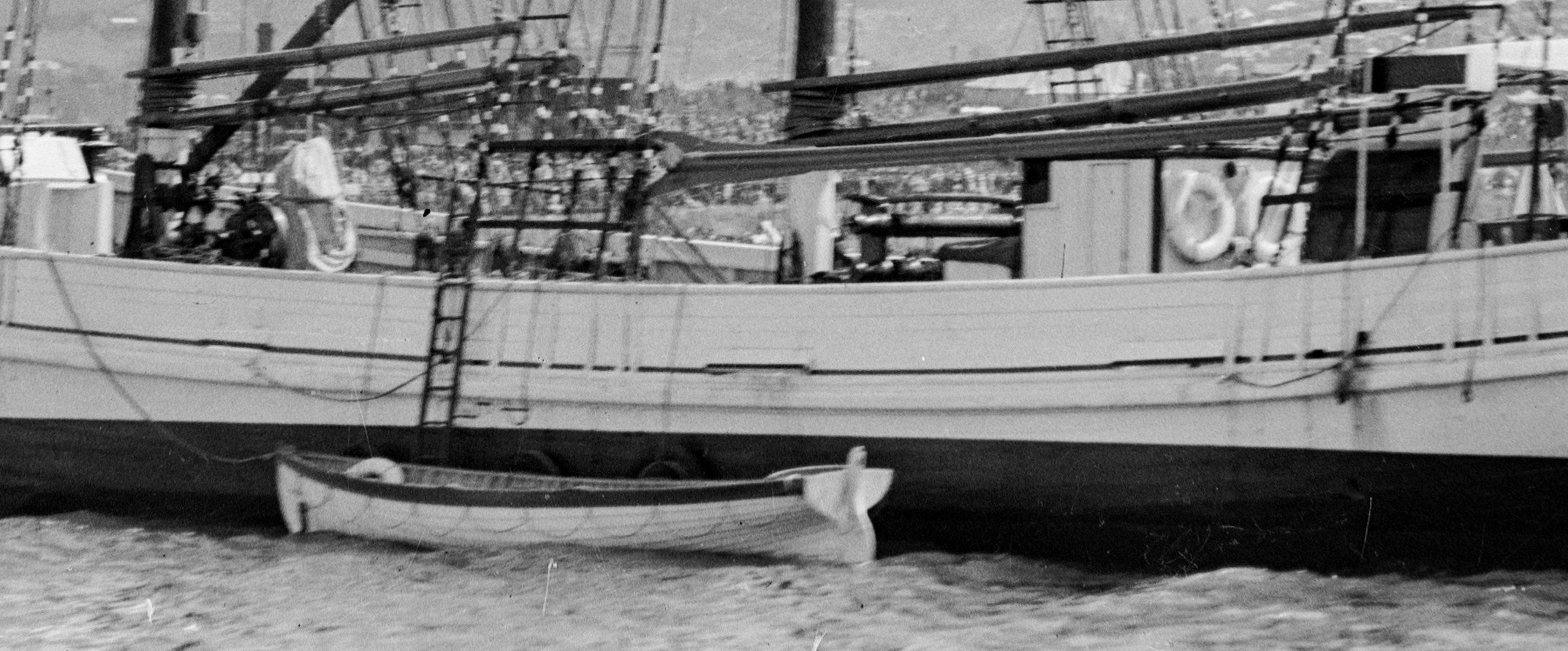

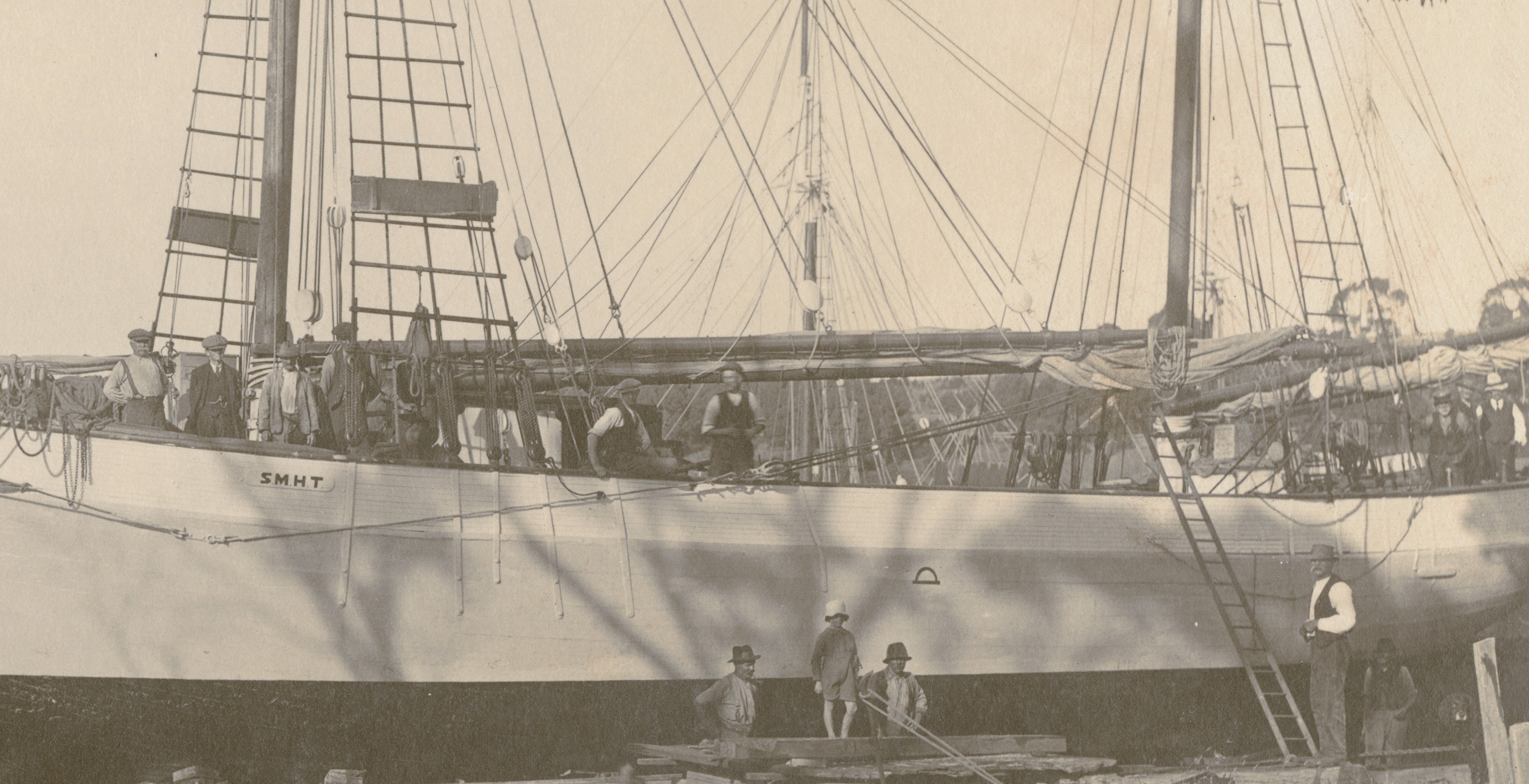

I think we may have all been barking up the wrong tree. The following photo, which I've only just found (online at the Tasmanian Archives, I thought I'd exhausted that source years ago but here we are ... ) shows the rope in question. It is hooked to the single-sheave block of the foremast boom tackle of the gaff sail rig. So it's a part of the running rigging. I think what is in all the photos I've shown would be called a boom tackle pendant (or pennant).
It relates to an explanation of boom tackles (also called boom guys) in Chapelle's "American Fishing Schooners" (p.357): "Their purpose was to hold the booms outboard when running before the wind the vessel rolling." (sic, seems to be missing a word or two). In the photo I've attached below, we see the single-sheave block with a hook that if not in use would be hooked to an eye under the boom a little aft of the boom jaws. The other block in the tackle is a double sheave block, hooked and moused to a wye band near the sheet wye toward the end of the boom (can't see that in the photo, but Chapelle's diagram shows it, as do Figs 10-12 to 10-14 of Bennet's Schooner Sunset. In Chapelle's description, "To guy the mainboom, the single block was unhooked and brought to the rail near the aftermost fore shroud and hooked into a staple on the rail cap. The fall was then led off and set up, then belayed on the pin in the boom jaws.". So there should be a pin in the boom jaws in the photo below, but it's obscured, so you can't actually see it.
Chapelle goes on, and his next comment reflects what is also clearly depicted in Bennet's Fig 10-13, which shows the British version of the boom tackle pendant (or pennant): "The foreboom guy led to a staple on the bow chock rail ... the fall belaying on a cleat on the side of the foreboom. Racers sometimes had pendants for guys to hook into, to avoid overhauling the tackles, which were very long on a large schooner."
So, unless someone raises objections, there we have it. These southeast Australian skippers in their sweet picturesque old-time sailing vessels, the seas already full of steamers and motor vessels, when out on the seas far from land where nobody was watching, turned into insatiable speed freaks who held the booms as far outboard as they could, by extending the boom tackle on long outboard pendants.
The photo below, in full and at higher resolution is at https://libraries.tas.gov.au/Digital/LMSS761-1-595
So we have it? I'd be interested if anyone can provide more detailed references to boom tackles.
