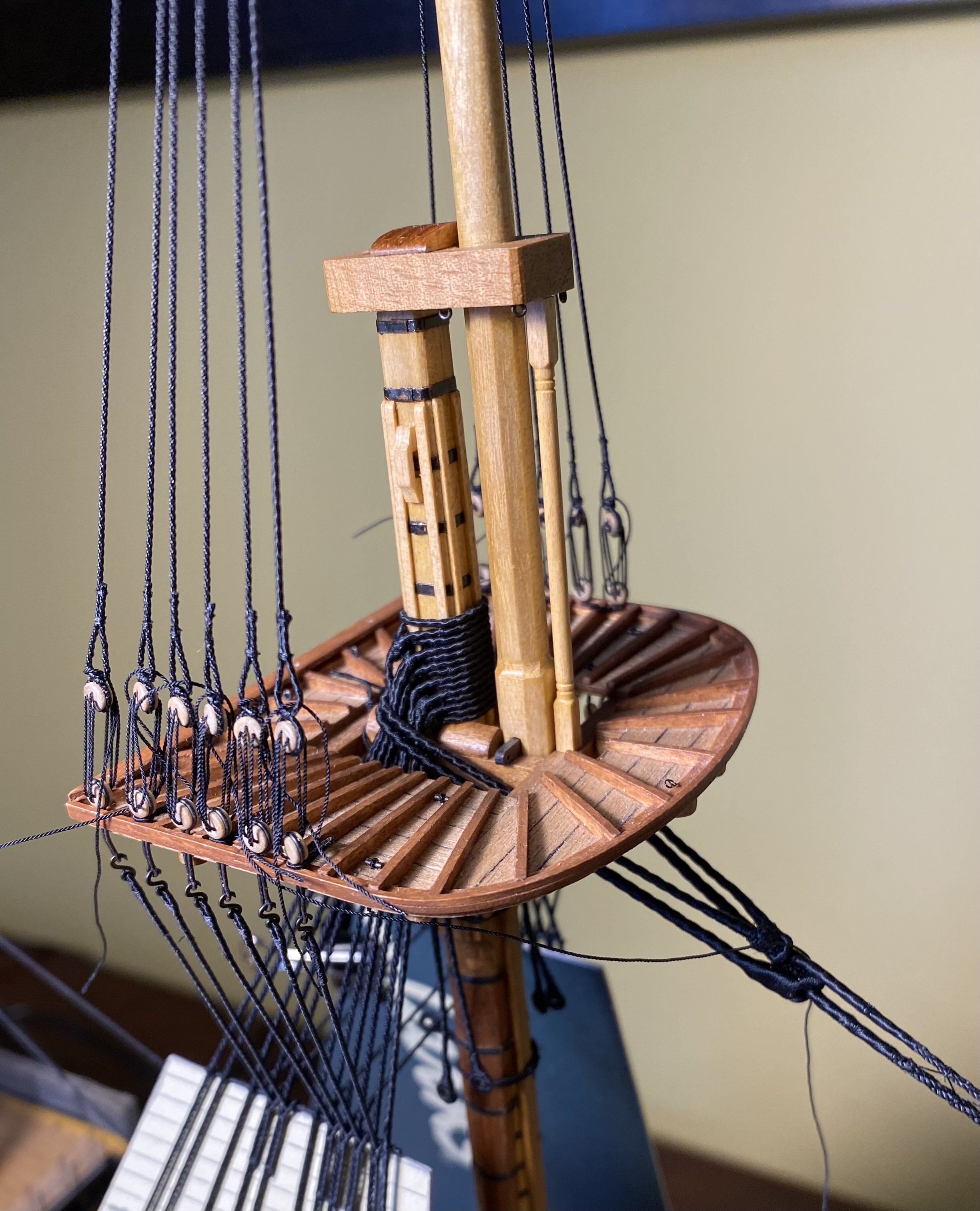

This photo is just a support of my advocacy for shiny ropes. At the end ship model is always an artistic representation of a real ship.

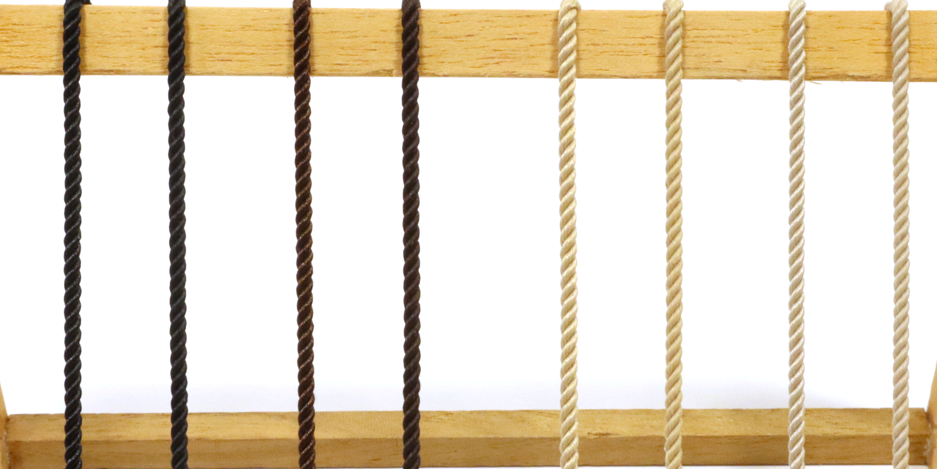

The polyester ropes I make at Ropes of Scale are a bit shiny. It's only really noticeable on the black and dark brown ropes. I've noticed that it helps make the details pop even in low lighting, so I'd personally leave them as is.
