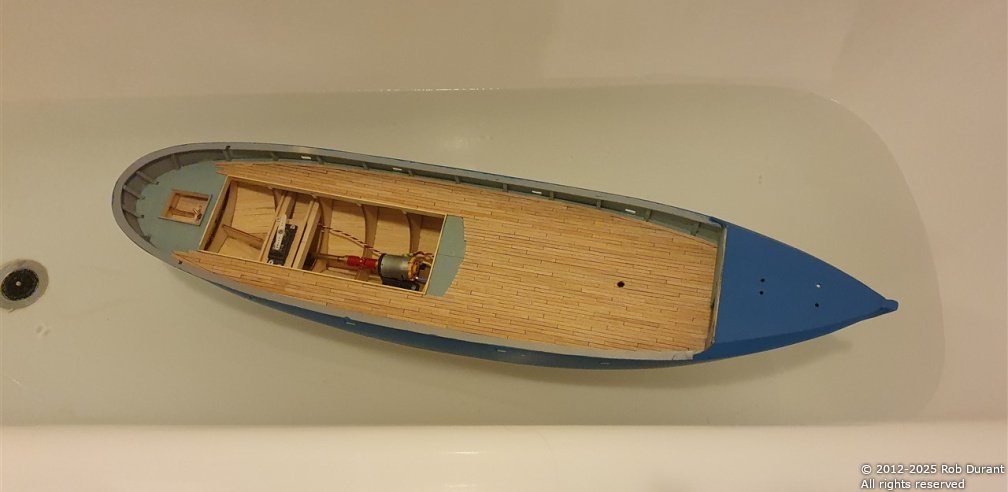

Great to see this log. All the best for your build :) nice hat, too. We live on top of a big hill, so in the middle of winter a hat like that can come in handy. I imagine on fishing grounds in the North Sea or Atlantic it would be essential wear.
@yvesvidal welcome aboard and thanks for following.
@robdurant welcome and thank you for all your help.

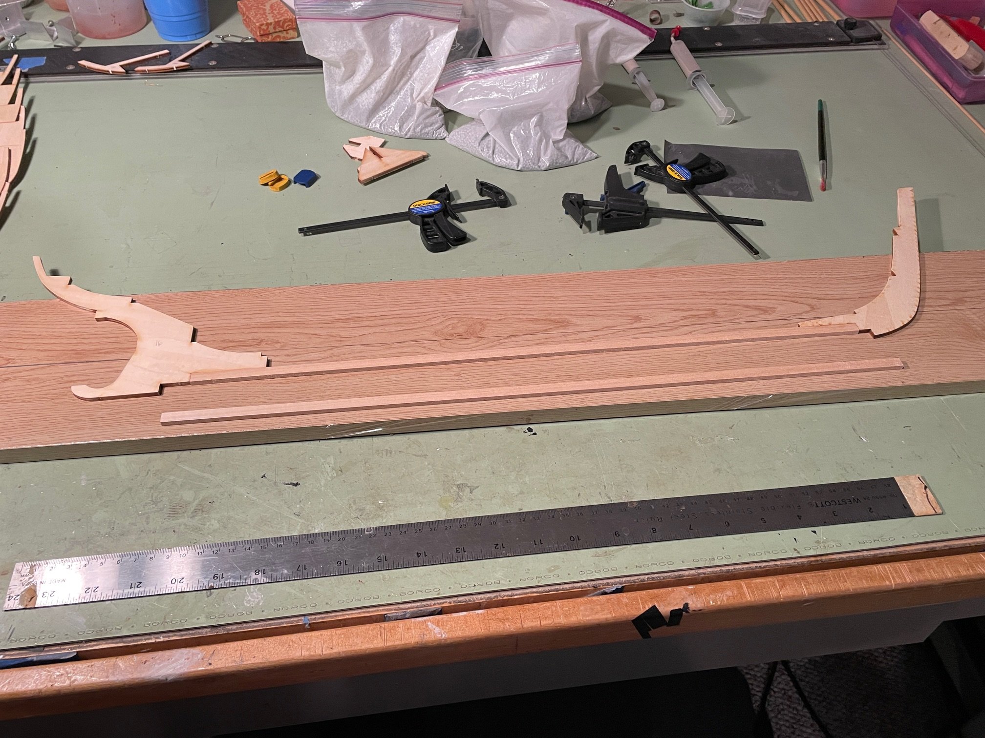

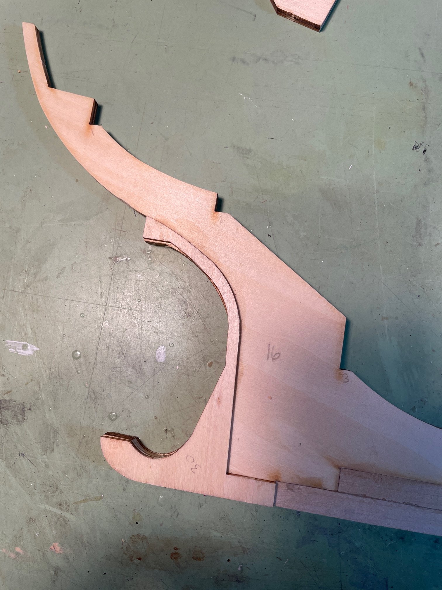

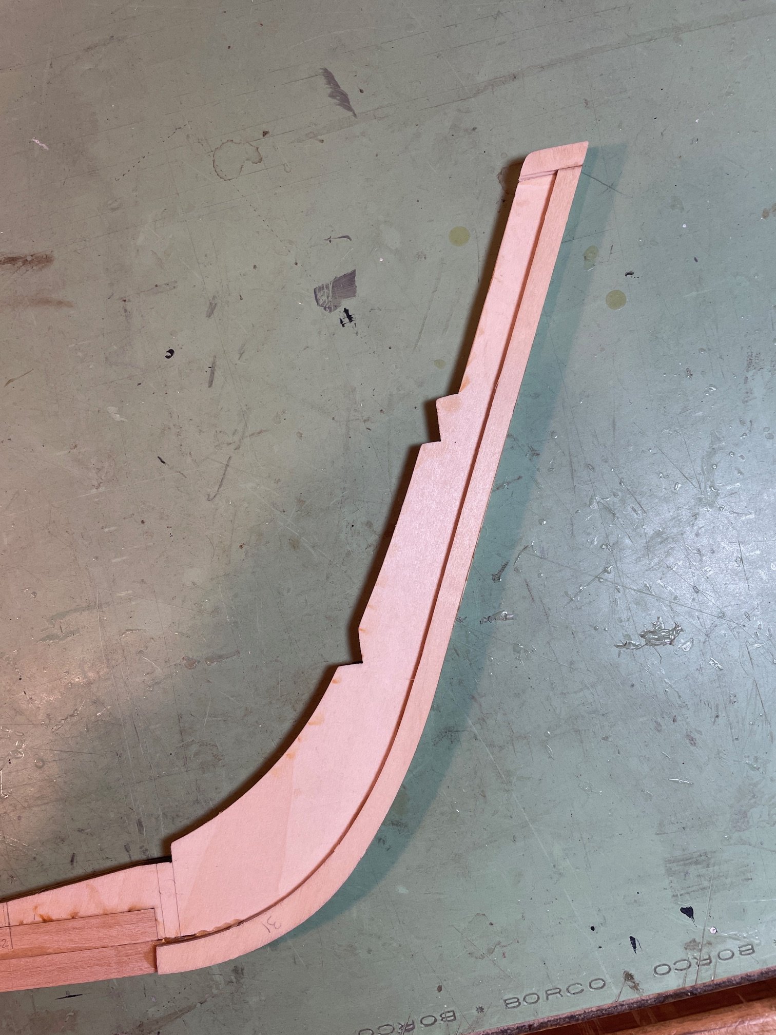

Stem, Stern, and Keel Construction
I began by gluing the two keel strips to the stem and stern post assemblies.
Once the glue had fully dried, I added the additional pieces to both the stern and stem. I believe these form the rabbet for the planking.  A quick note: the instructional diagram show two small parts (#31) meant to be attached to the top of the stem. I may have missed them—old eyes—but I couldn’t find these parts on any of the sheets. So, I simply fabricated them using leftover material from the sheet the other parts came from.

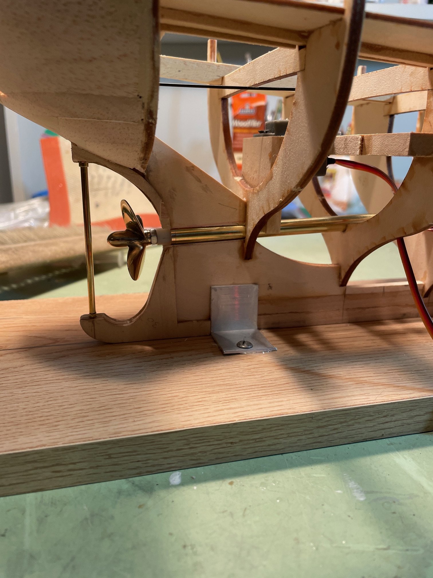

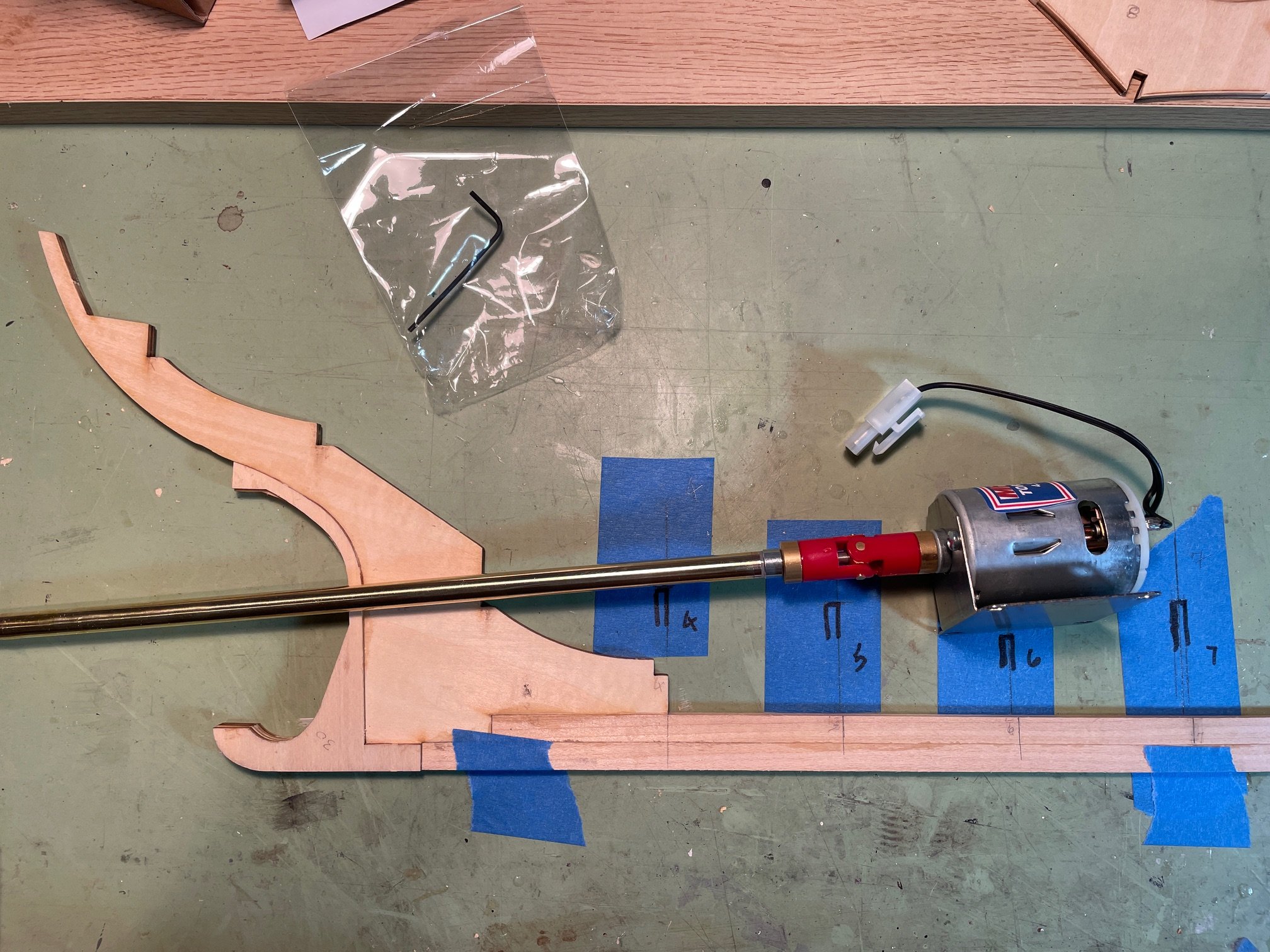

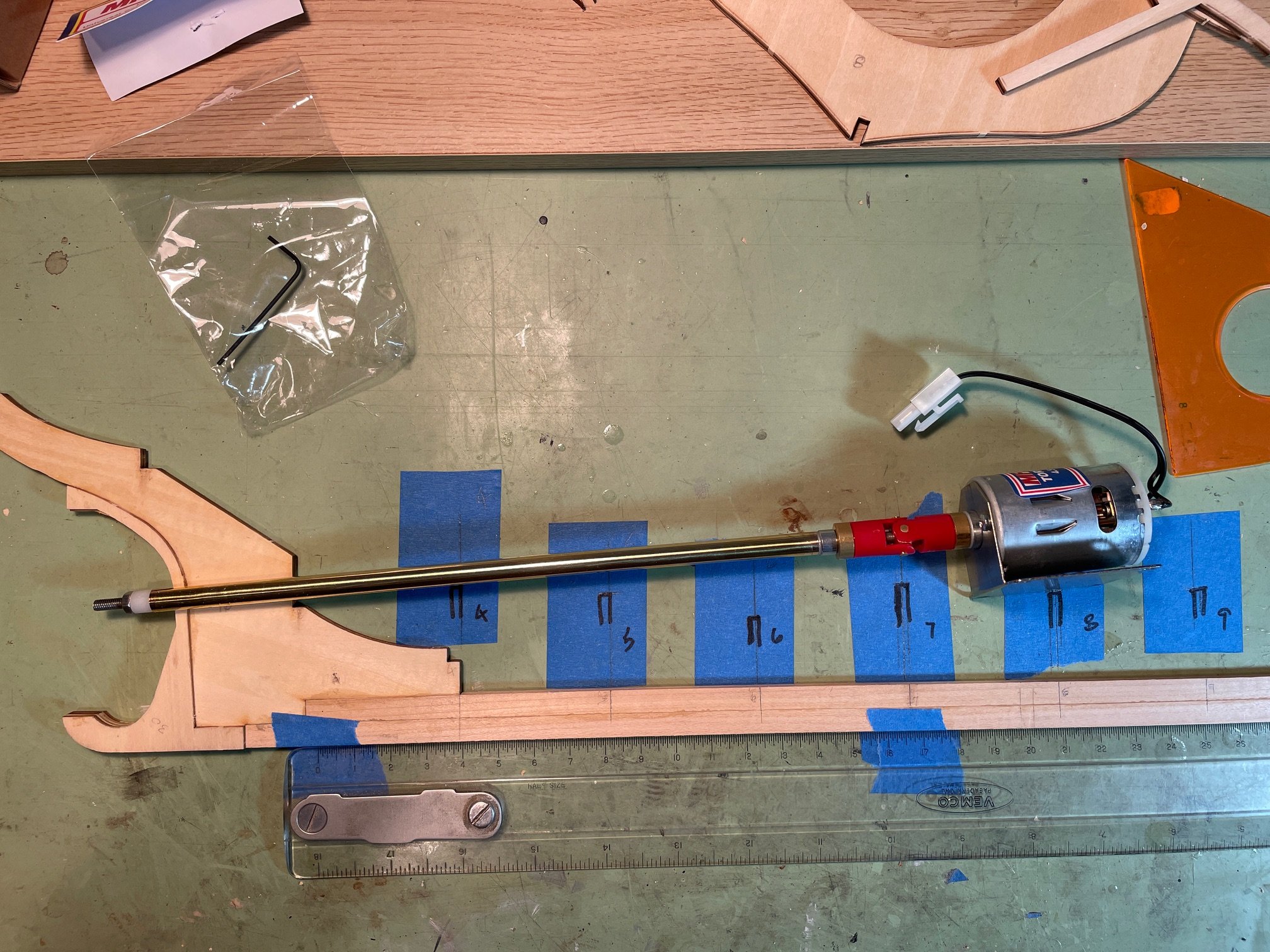

Now that the keel is laid, I decided to do some preliminary planning for the propeller shaft and motor layout. The stuffing tube is 8 mm in diameter and approximately 9 inches long, though it can be cut to any length as needed.
Initially, I was planning to shorten the shaft to about 5 inches, which would position the motor just above the #6 bulkhead. This configuration is shown in the first photo below. The black marks on the tape indicate the top edge of the bulkheads at the ship’s centerline.
However, I’m now considering using the full 9-inch shaft without cutting it. In that case, the motor would sit above the #8 bulkhead, as shown in the second photo. The only concern I have with the longer shaft is the potential for increased vibration.
I’d appreciate any advice or suggestions on which setup might be better—especially in terms of stability, performance, and vibration.  Or if there's another option I should consider.  Thanks and thanks for the likes.

A great start. You should be okay for vibration as the rpms should be farily low - it isn't a race boat - but if you want to be doubly cautious, making a part that sits inside bh6 that acts as a support for the prop tube could also damp any vibrations that might form?

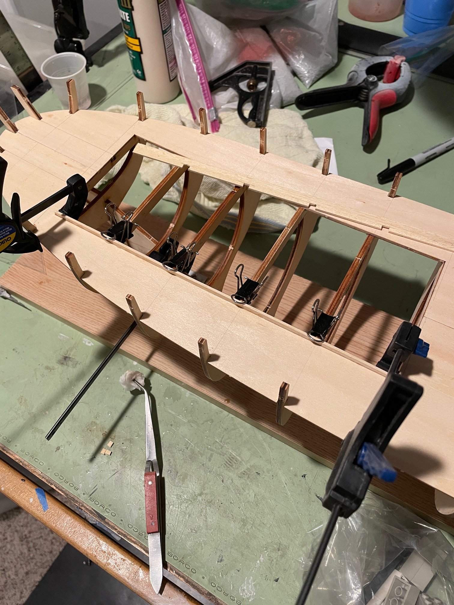

Bulkhead Frames
All the bulkhead frames and cross pieces were removed from the wooden sheets.
At this point, I deviated from the instructions by gluing the cross pieces to the bulkheads before installing the bulkheads onto the keel.
To help keep the keel straight and vertical during assembly, I built a support jig using aluminum angle pieces.

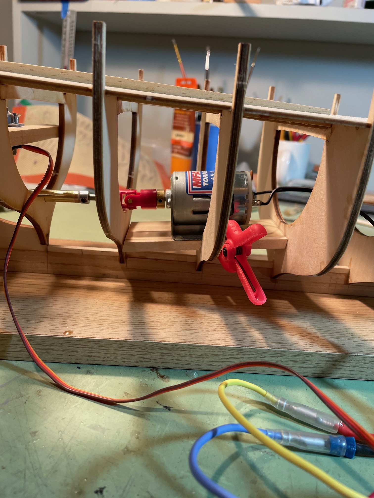

After reading numerous Nordkap build logs, I noticed a common issue: those who followed the dimensions provided in the instructions often struggled with bulkhead alignment at the deck level. To avoid this problem, I used the deck itself as a template when installing the bulkheads. This ensured proper spacing and alignment.
Once the bulkheads were in place, I found an answer to my earlier question about motor placement. The access cutout in the deck only extends as far back as bulkhead #7. Placing the motor at bulkhead #8 would make it inaccessible, so this confirmed that the motor needs to be positioned near the #6 bulkhead.

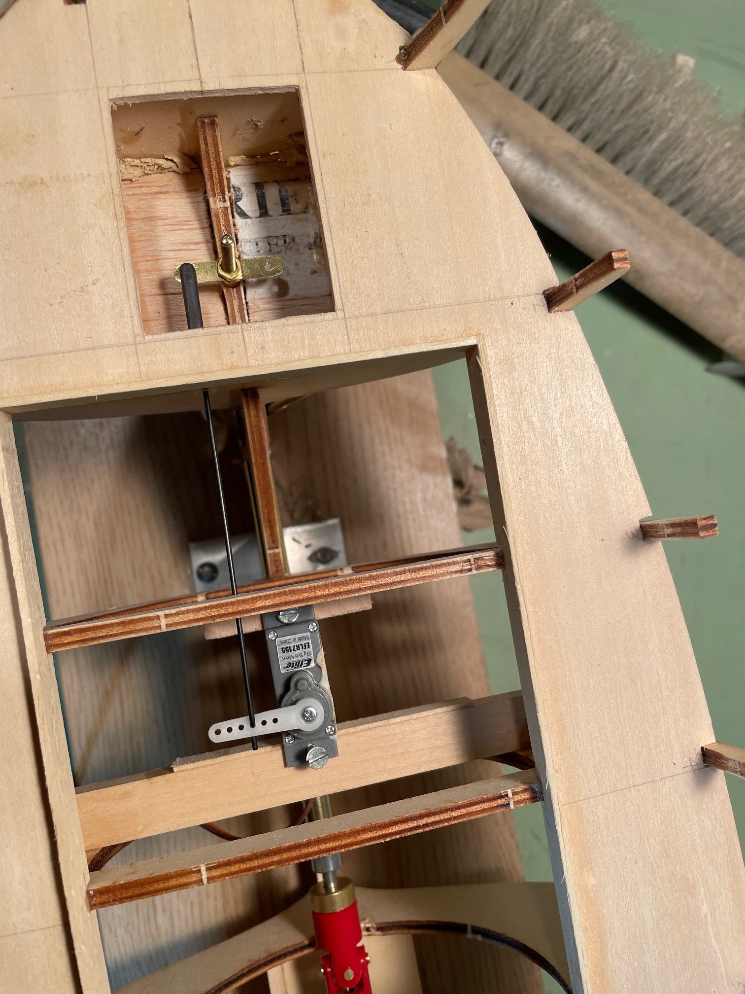

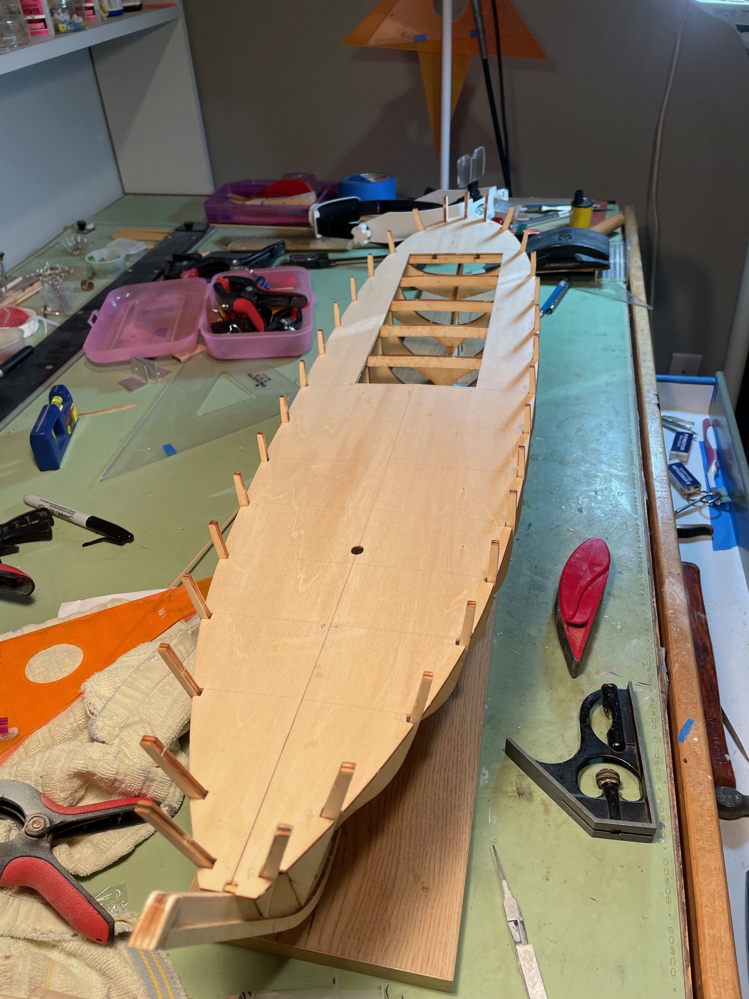

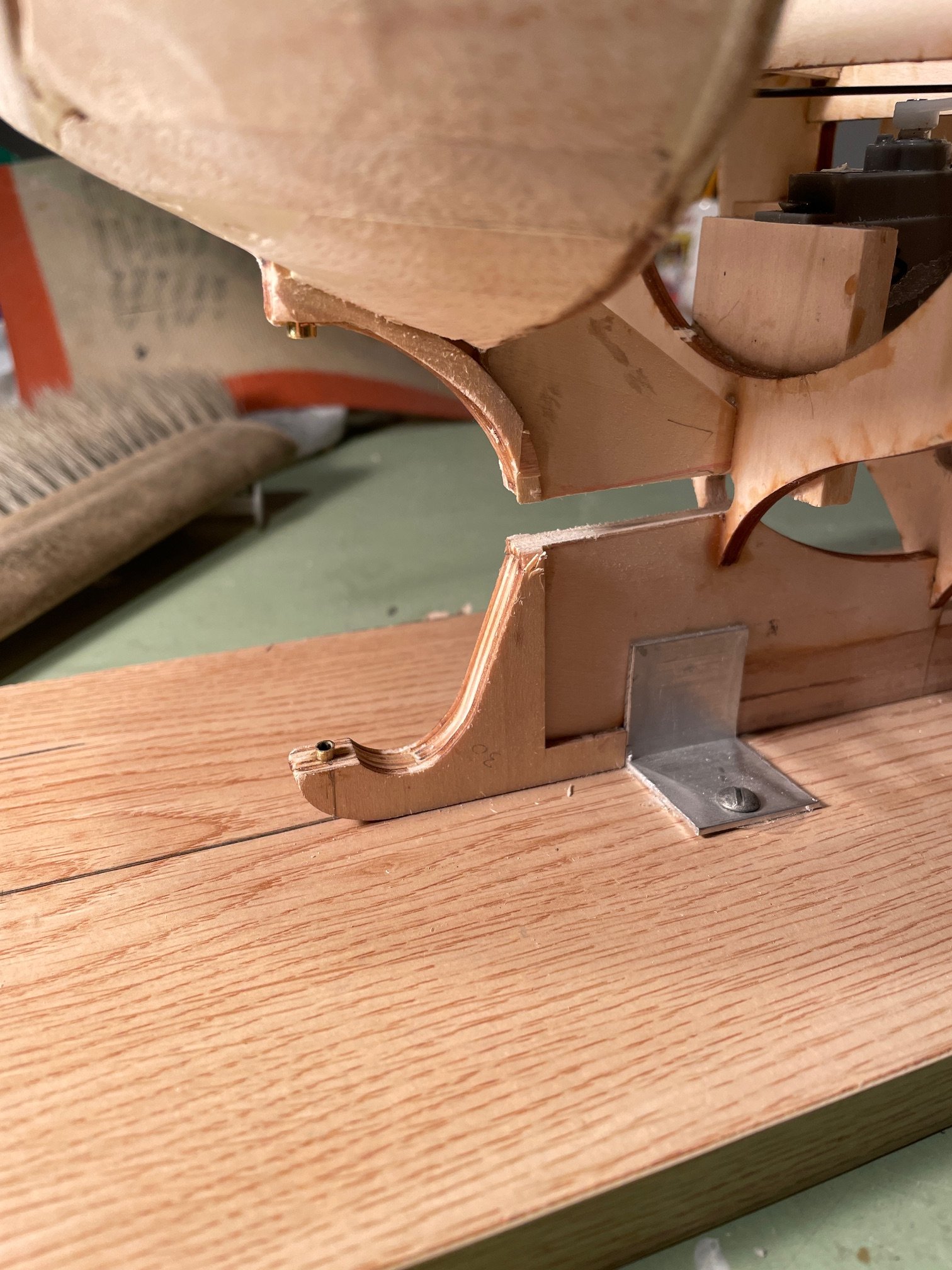

Deck, Tiller, and Drive Shaft

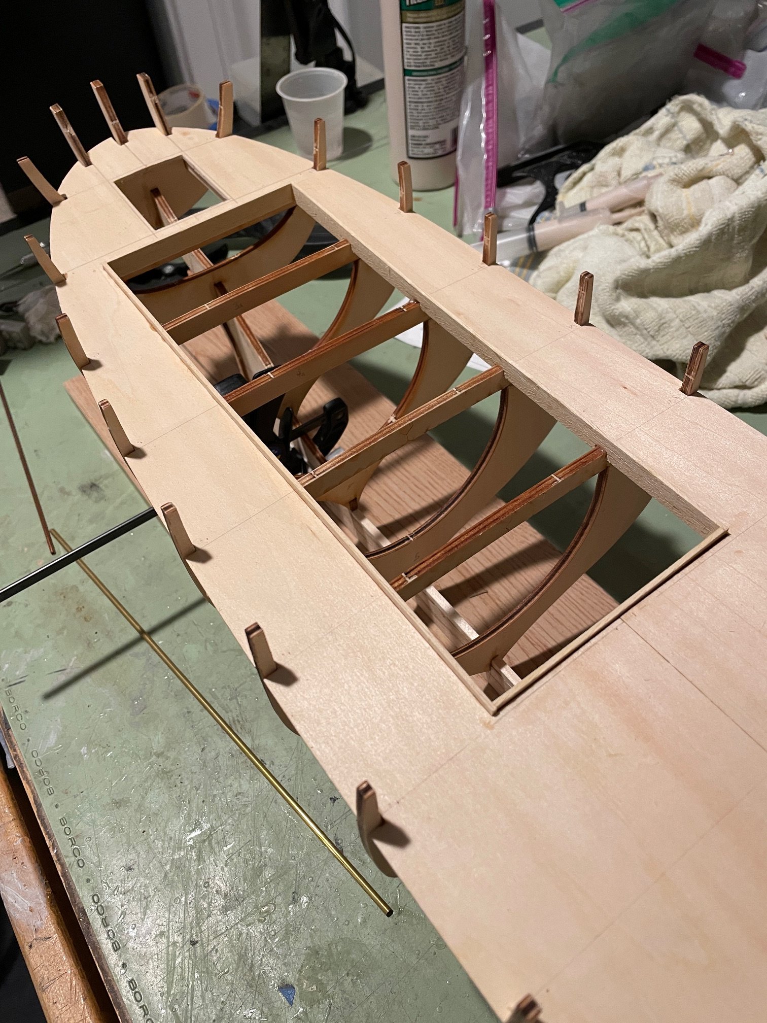

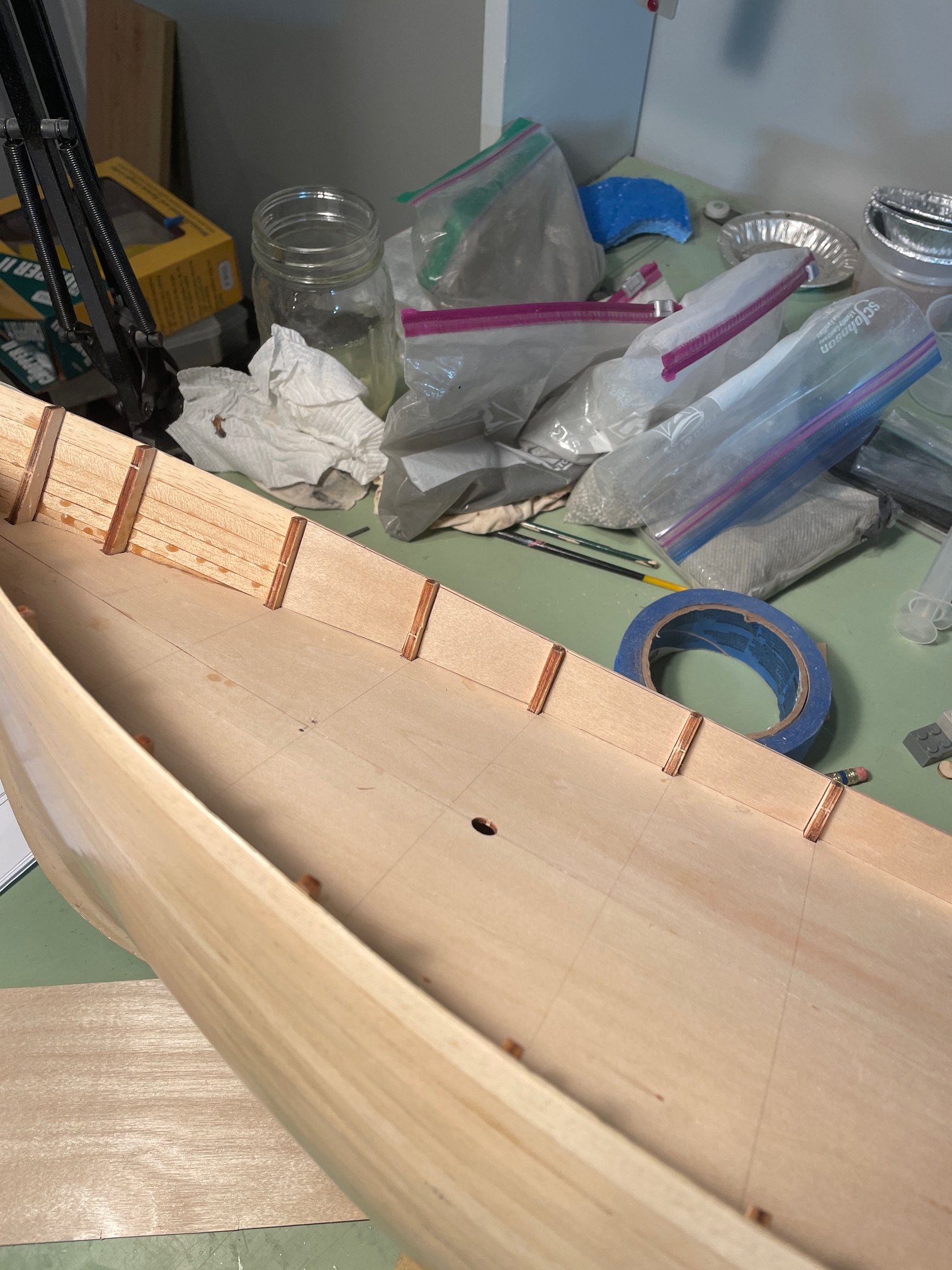

 After the glue had fully dried on the bulkheads, I proceeded to glue the deck into place. To secure it, I used clamps around the access hatch and planking nails for the rest of the deck. I got the idea for using nails from @robdurant’s build log—thanks for the tip!
Once the glue set, I installed the pieces framing the access hatch. I assume these parts are designed to help position the cabin above the hatch.  I also cut in the access hatch for the tiller.

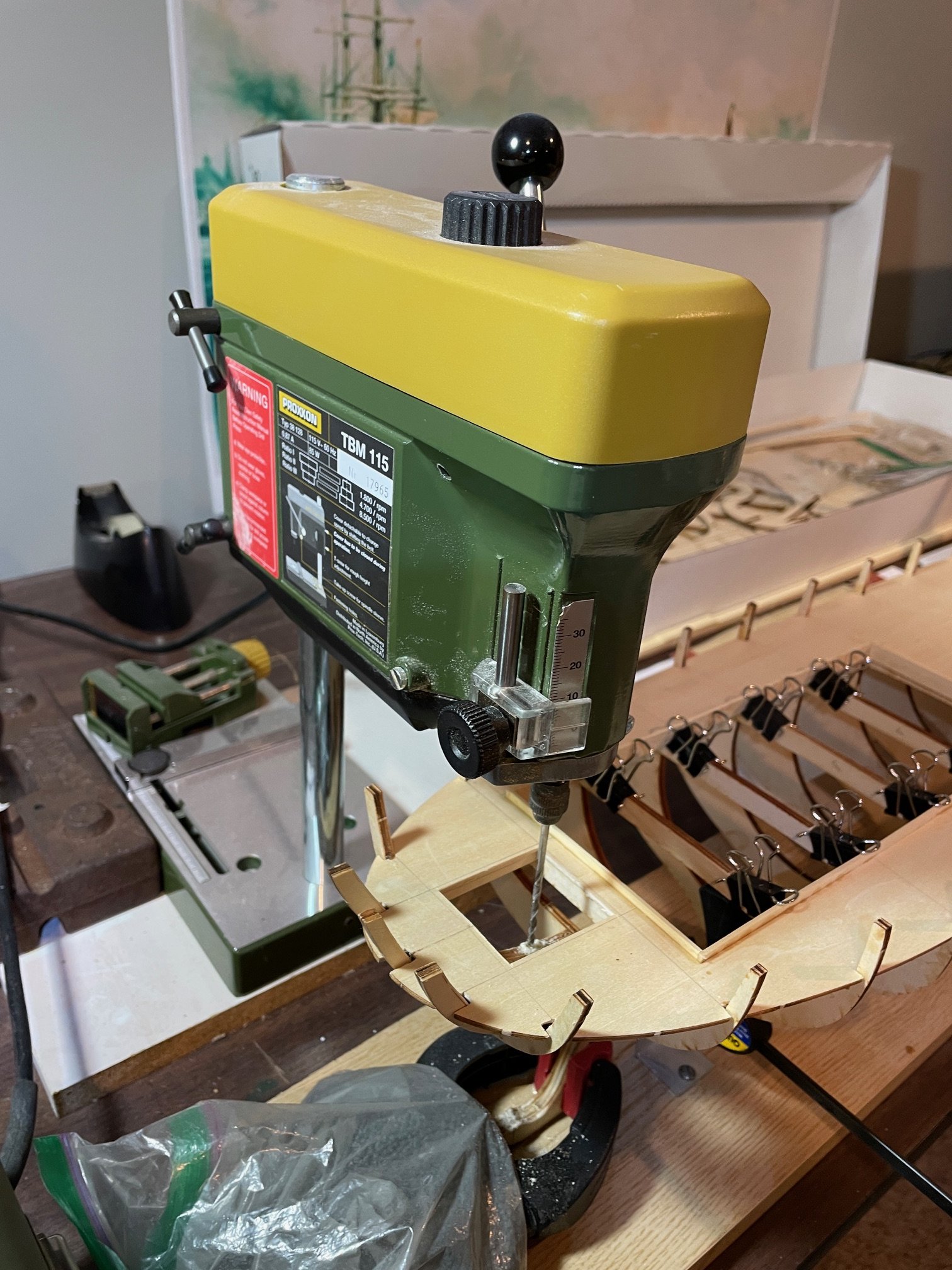

Next, I took a crack at drilling the hole in the keel frame for the tiller. It may have been a bit of overkill, but I used my mini drill press to ensure the hole was vertical and plumb.

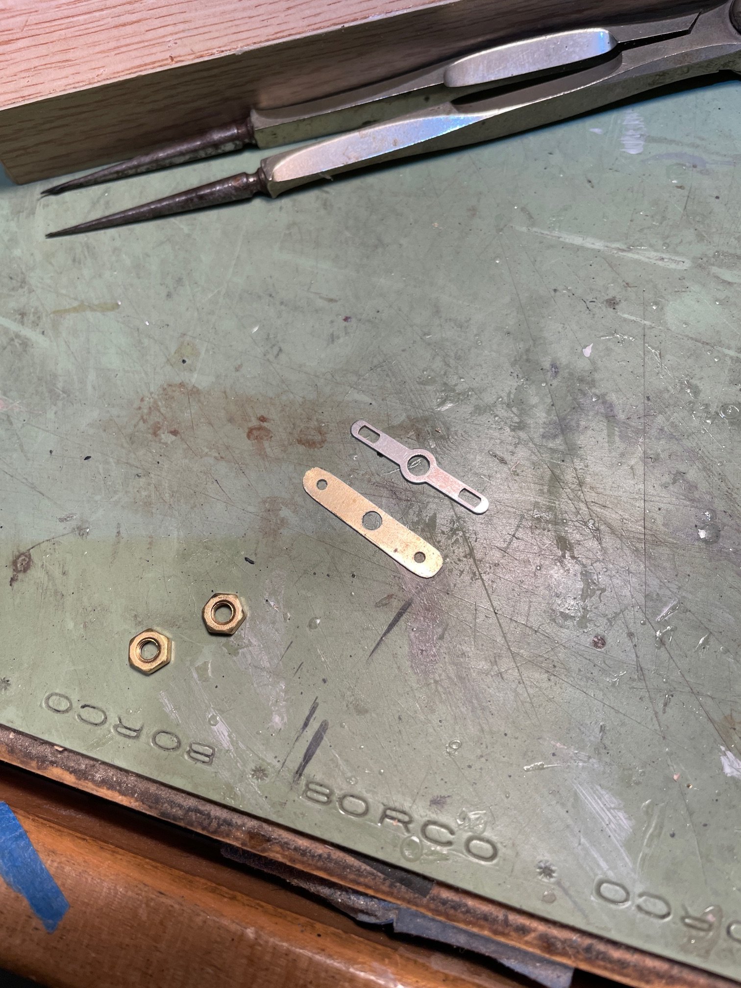

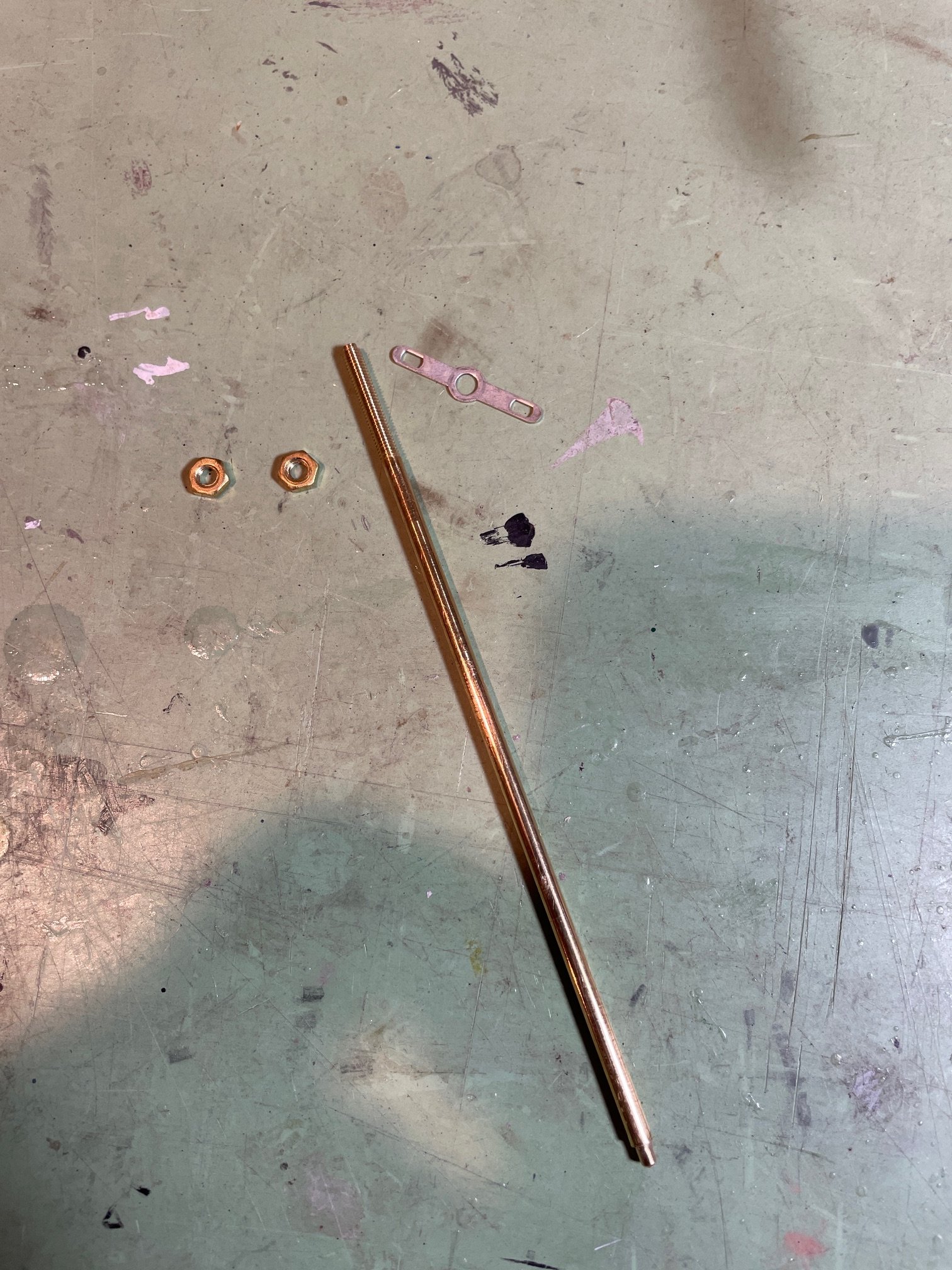

Now, one thing I’ve learned from Billing Boats is that they assume you know something about RC boats. They don’t provide any instructions on which parts to use for the tiller. After a bit of rummaging through the parts bag, I think I found the right pieces.
I wasn’t fond of the cross arm they provided due to the slotted holes—it just seemed like there’d be too much slop in the movement. So, I decided to make my own.
After that, I carefully cut out the keel for the propeller shaft. This part was a little nerve-wracking since it was the first time I'd had to cut the keel apart in one of my builds, but it all went smoothly.
With everything cut and fitted, the shaft and tiller fit very well.  Cutting the stuffing tube and shaft to the right length was pretty straight forward.
I also installed the tiller servo and temporarily set the motor in place to check for fit.
I wanted to do all of this before planking the hull, as I thought it would give me better control over getting the propeller shaft to fit correctly and ensure the motor was in the right spot.  I did a test run and everything worked well.

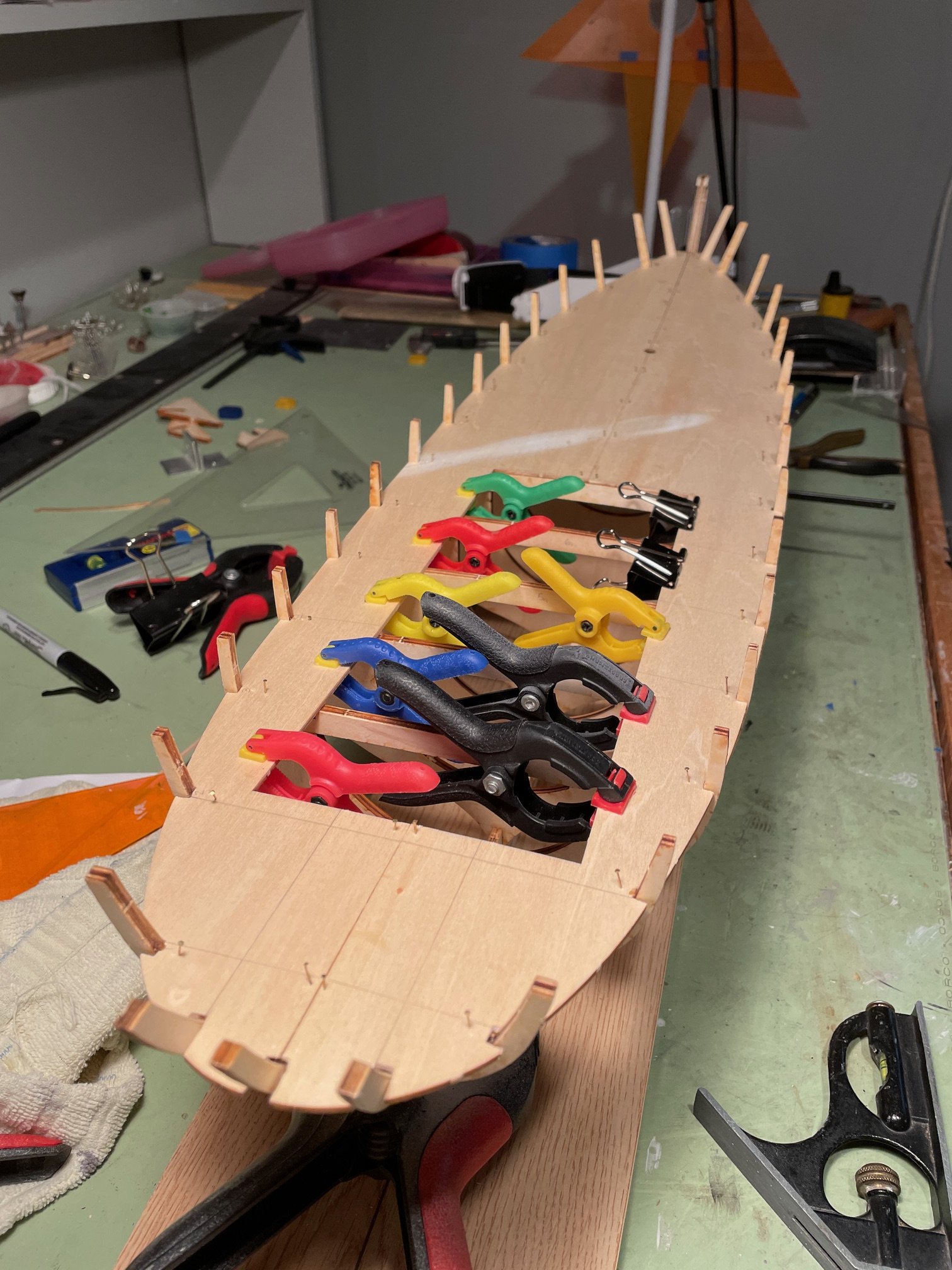

Planking the Hull

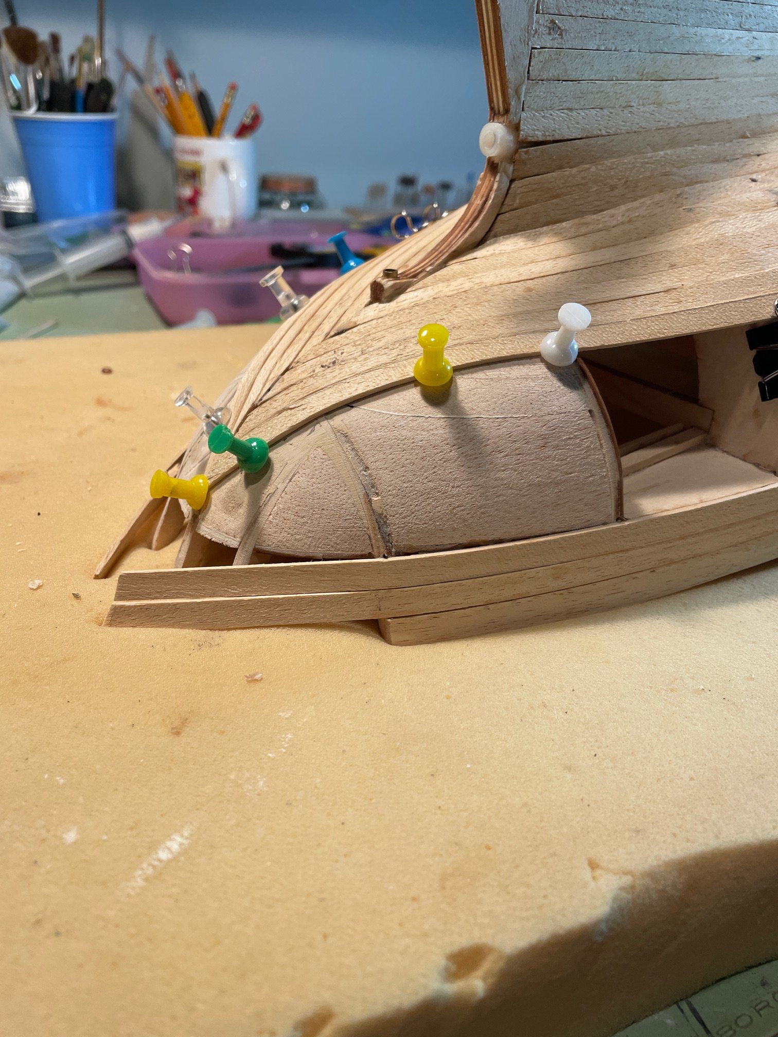

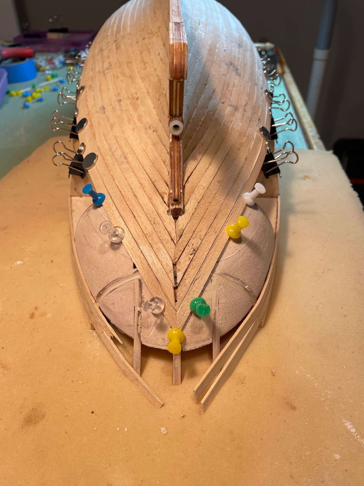

Just a quick update on progress. I’ve started planking the hull, beginning with the three planks above the deck line. The instructional diagram was a bit misleading—it suggests these three planks cover the entire hull area above the deck, but in reality, there's a large uncovered section at the bow.
After that, I began planking from the keel upward. I’m treating the planking process much like I would on any plank-on-bulkhead (POB) model, though I'm not too concerned with the precise plank layout. Since the hull will eventually be sealed to make it watertight, the planking won’t be visible in the final build.

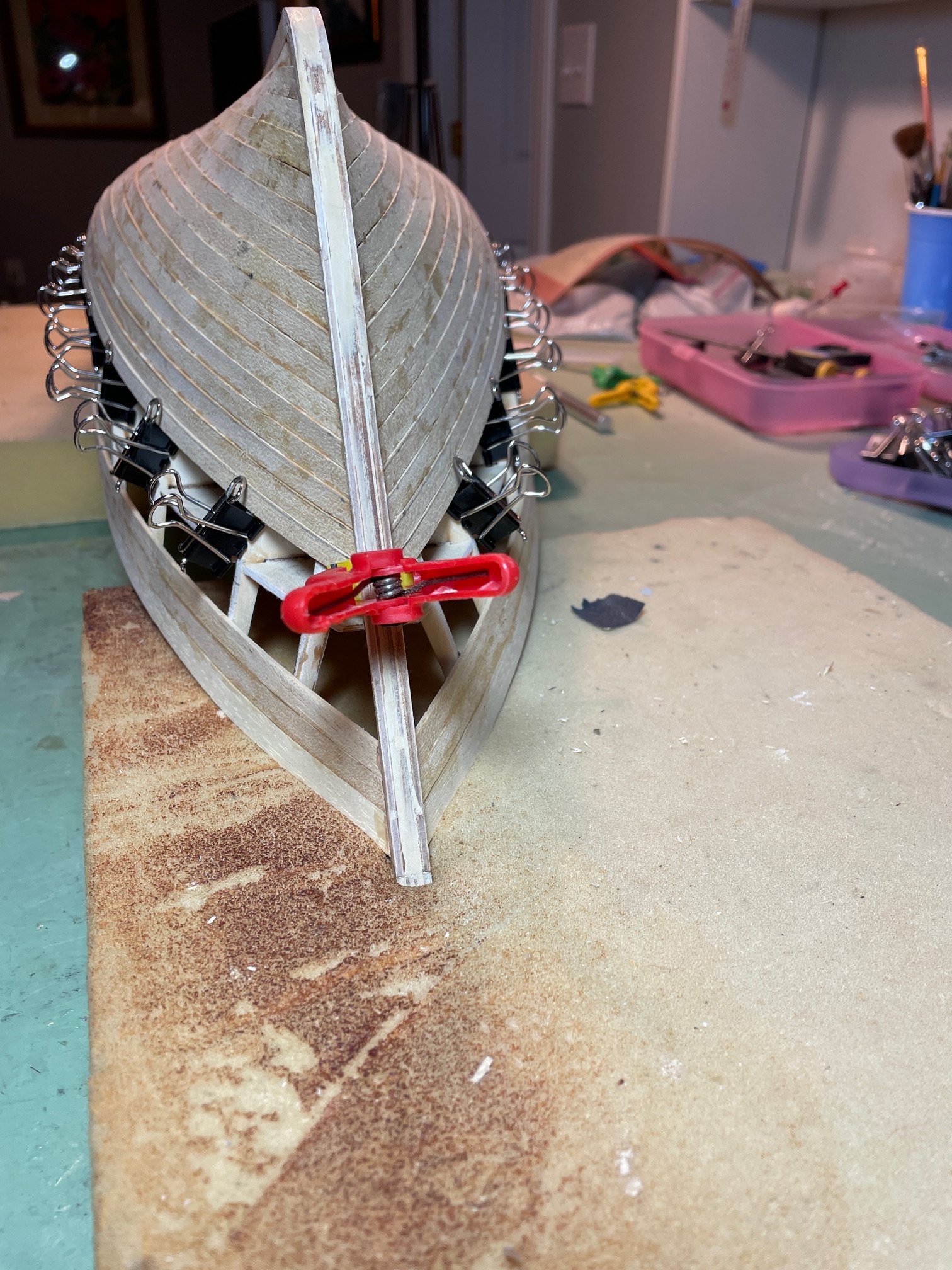

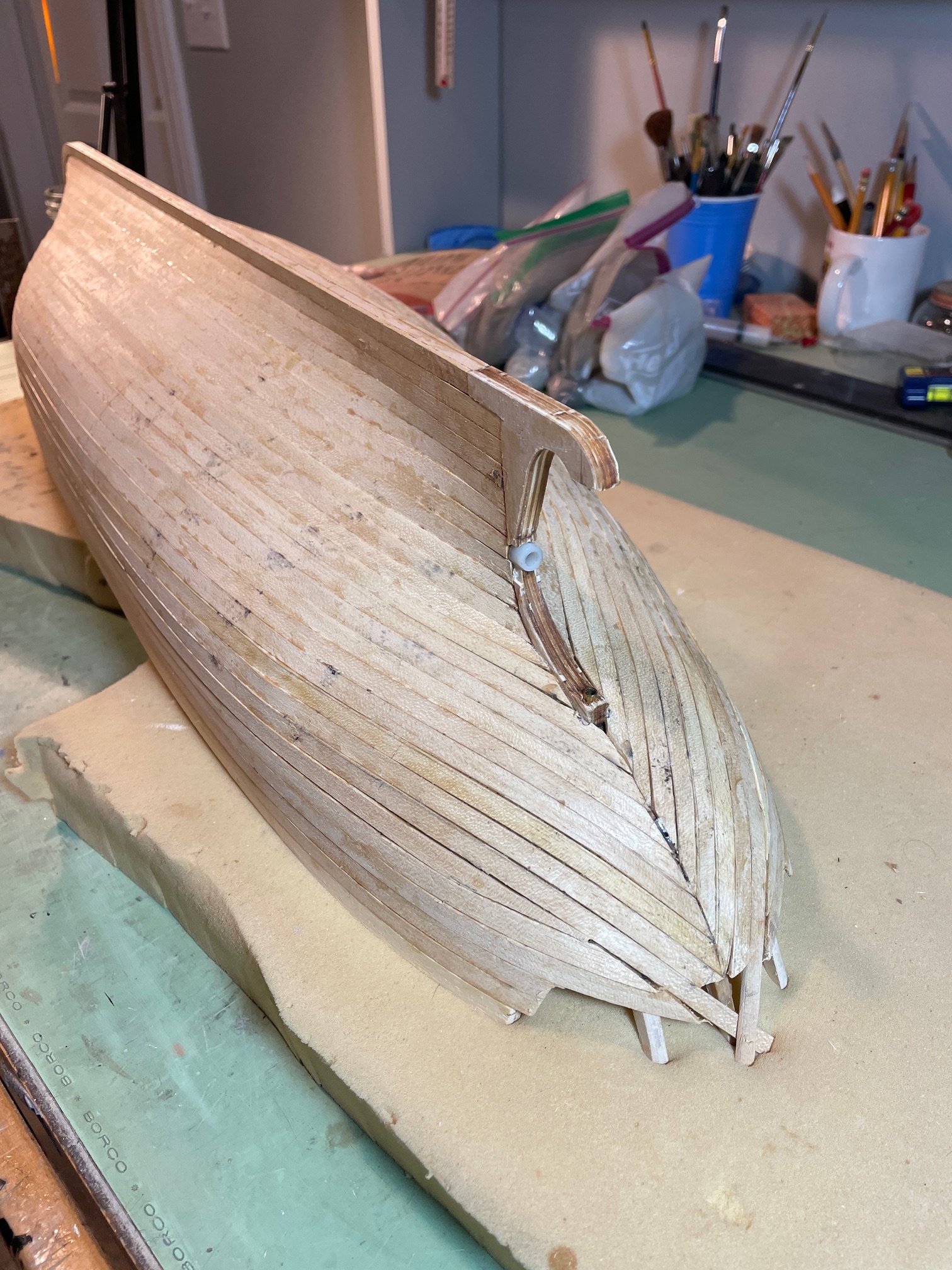

Planking the hull is ongoing—I'm a little more than halfway through.

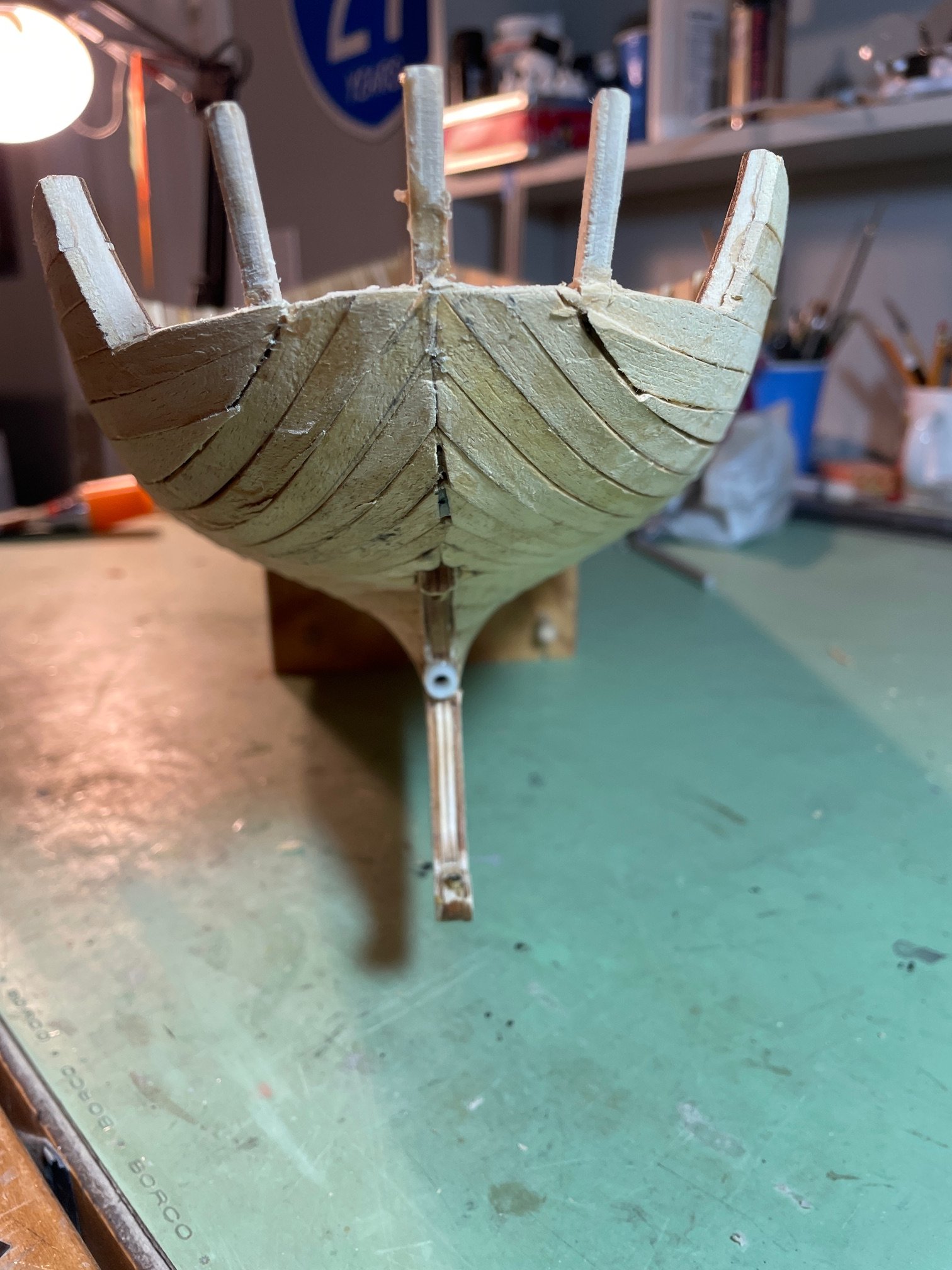

I'm approaching the stern planking a bit differently than shown in the instructions.
Instead of wrapping the planks around the stern as shown, I'm running them continuously from the keel up to the three bulwark planks I installed earlier. It seemed easier to shape the planks this way, and it feels like a cleaner fit overall—if that makes sense.

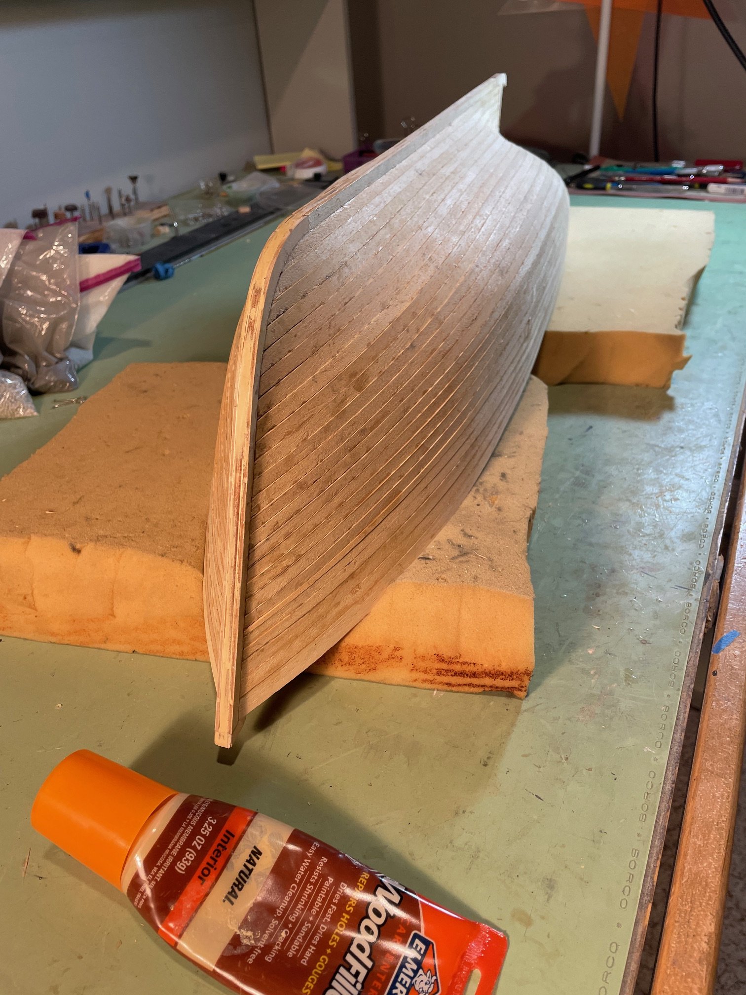

Sanding the Hull
I sanded the hull using my favorite palm sander with 220-grit sandpaper. I know that might seem a bit aggressive, but with a light touch, it works very well.
For the stern, I chose not to use the thin wooden veneer sheet provided in the kit to wrap around the aft bulwarks, as I couldn’t get it to form a smooth, even curve. Since the aft bulwarks will eventually be covered by the pilothouse structure, I decided instead to fill the space between them with balsa wood blocking, then sanded it down to match the shape of the stern.

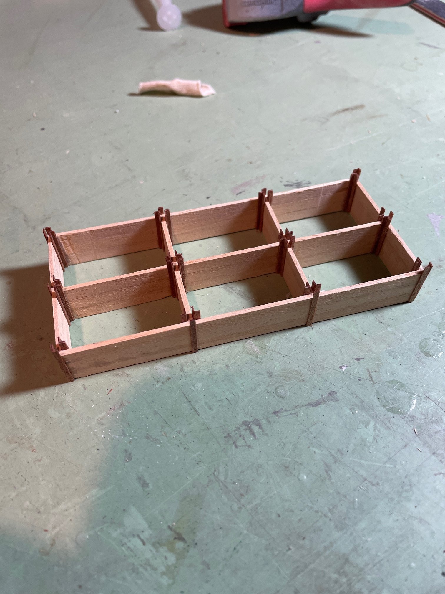

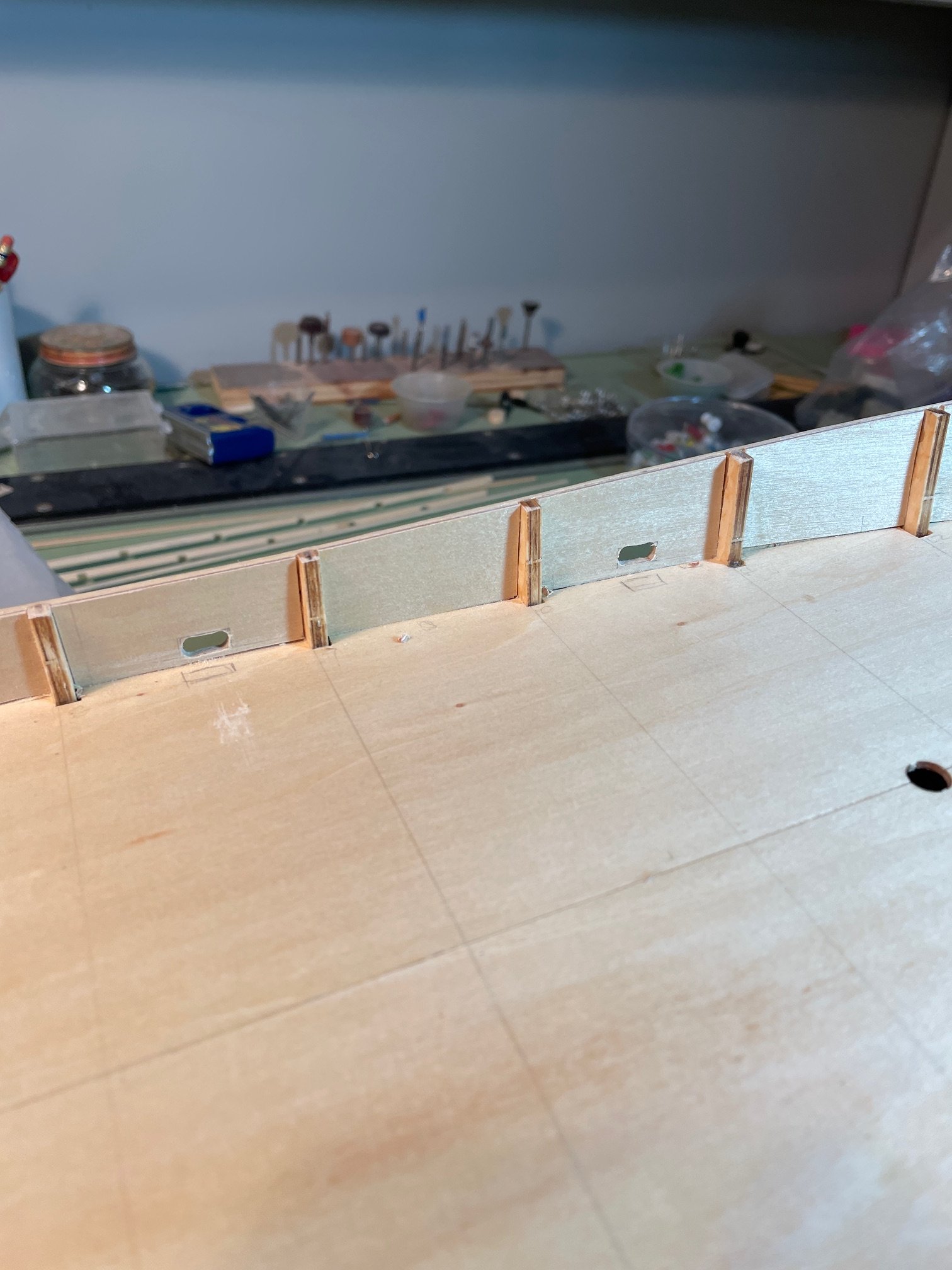

Deck-Top Fish Bin
This one was pretty straightforward. No major issues there.

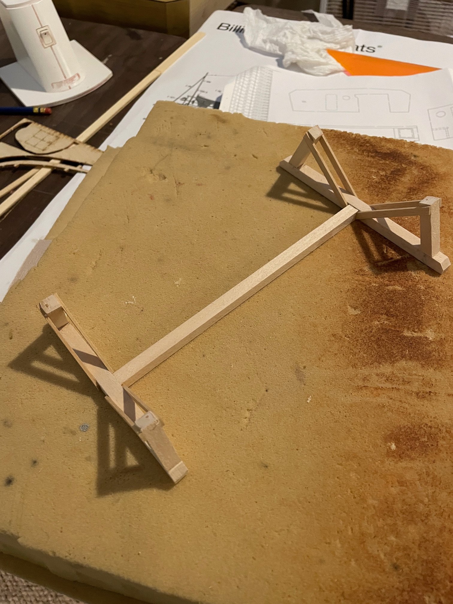

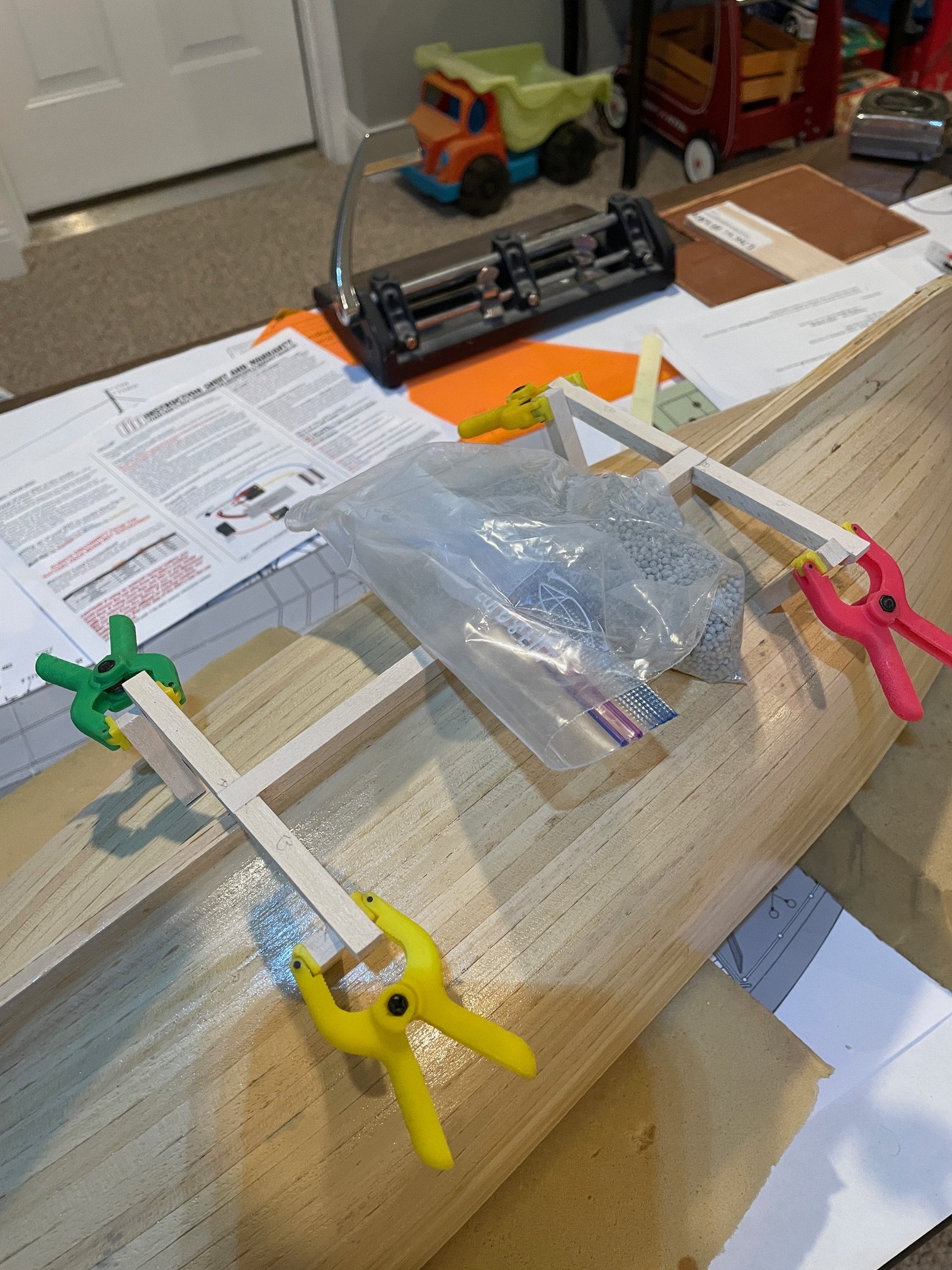

Ship’s Stand
The stand came next. The instructions provided a few basic dimensions, but not quite enough to properly place all the support members. I ended up building the base first, then positioning it directly over the hull to figure out the correct length for the uprights.
Anchorways

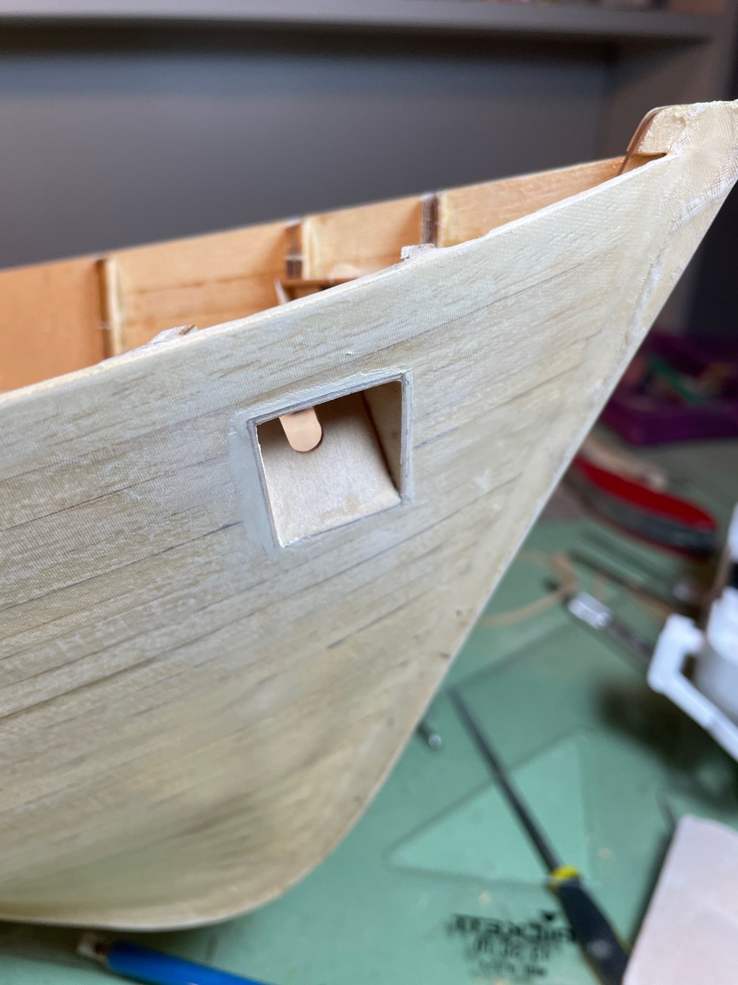

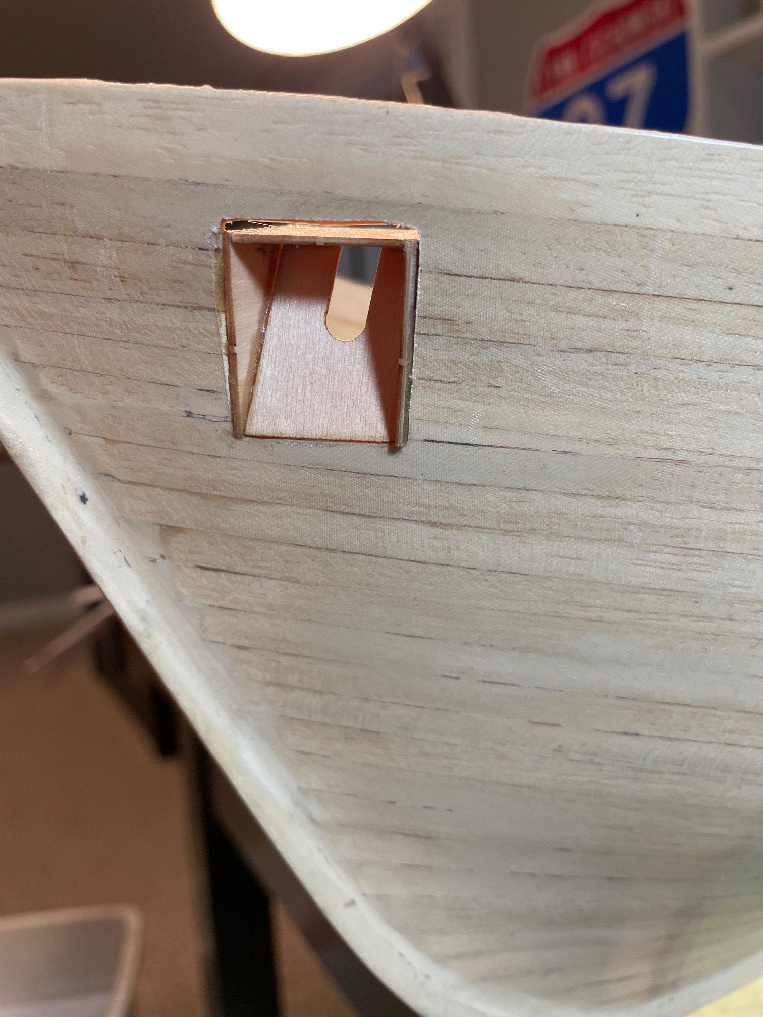

Now here’s where things got tricky. Don’t mix up the side pieces—they might look the same, but they’re not. One side is slightly larger than the other. I didn’t catch this until after assembling one of them, which caused a bit of backtracking and I’m still not 100% sure I have these right. After cutting them into the hull a little wood filler was used to fill the gaps.

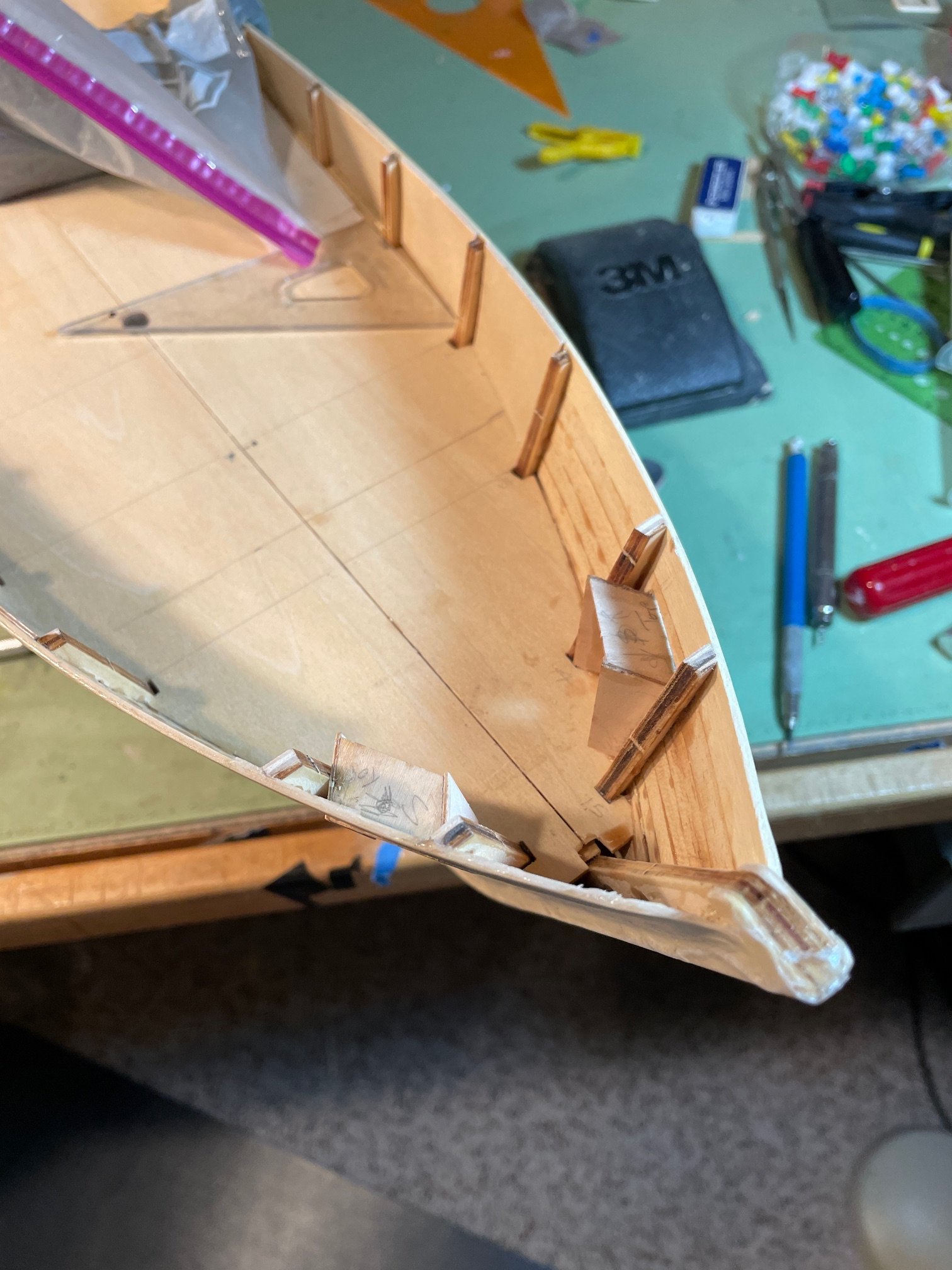

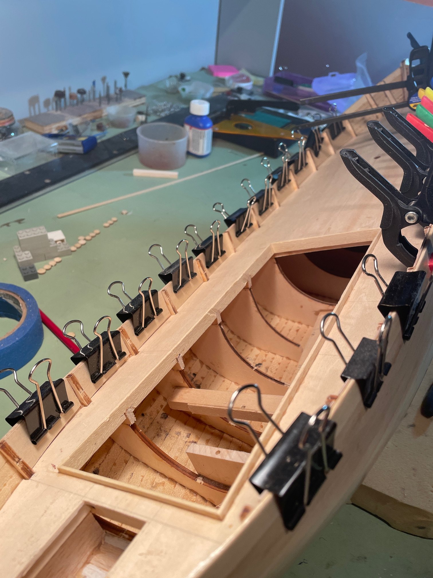

Interior Bulwarks
I wasn’t happy with the look of the interior bulwarks above the deck because of the exposed planking lines and glue marks.  It just didn’t resemble a steel-sided ship and I wasn't sure if just painting the sides would cover everything. To fix this, I cut and installed 1/16” thick birch sheets between the bulkheads to cover the planking.
Scrubbers and hull stiffening
After that, I moved on to cutting in the scrubbers and attaching what I assume is some kind of hull stiffing on the outside of the hull.

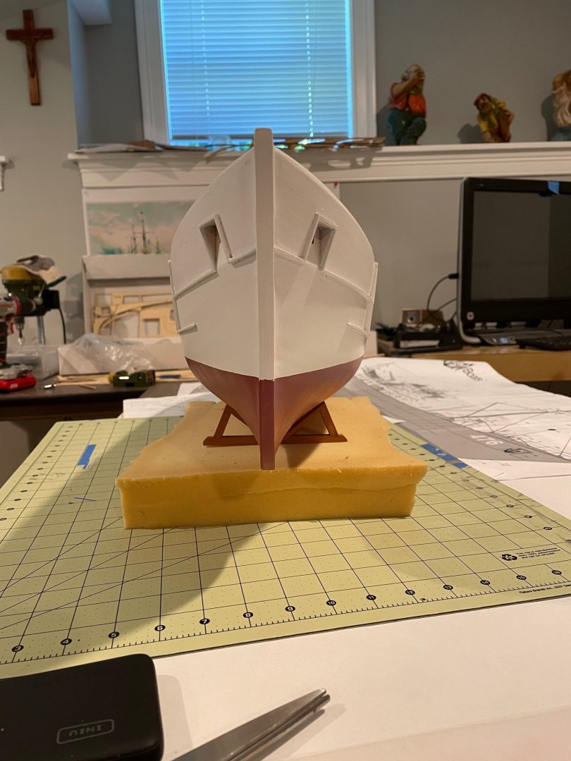

Rudder and prime coat
I permanently installed the rudder so I could begin painting the hull. To ensure the rudder straps stayed securely in place, I added some “rivets” through the straps before epoxying them to the rudder post.
The hull, superstructure, and stand were all primed. I chose to use white primer since the final color scheme includes a lot of white.

Painting the Hull and Sprucing Up the Pilot House

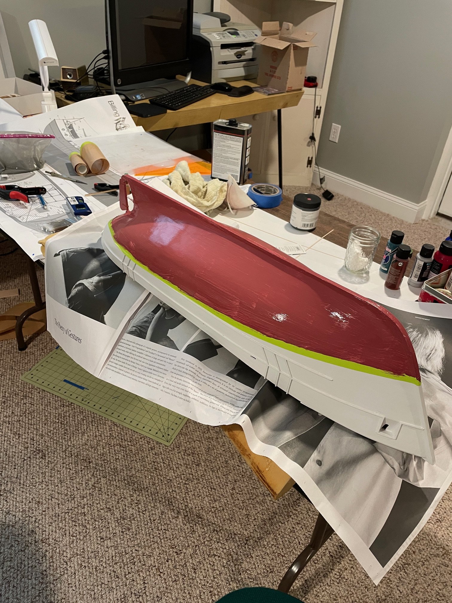

I started painting the hull after carefully taping off the waterline. The paint I’m using might be a bit unconventional for a model, but my wife had a coupon for free paint samples—so I figured, why not give it a try? For the area above the waterline, I’m using Benjamin Moore’s Palace Blue, and for below the waterline, Barret Brick.
I’m still not confident enough with my airbrush, so I’ve been applying the paint by hand with a brush.
Three coats later…

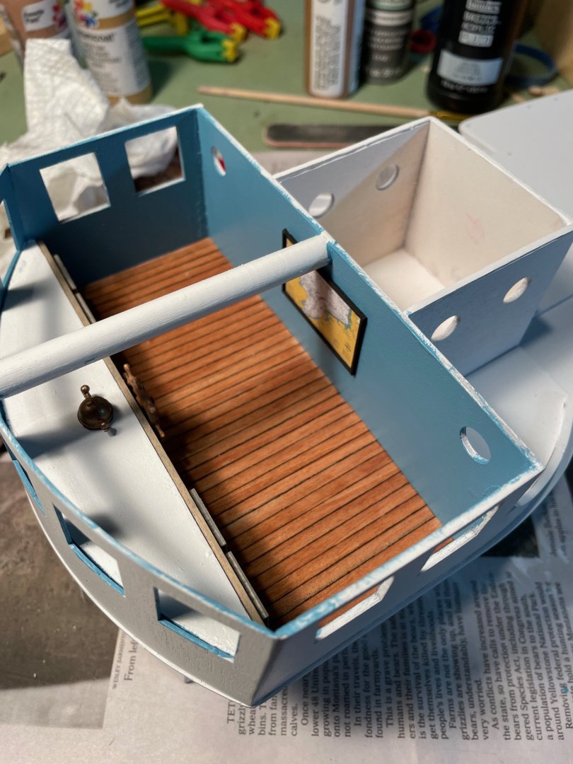

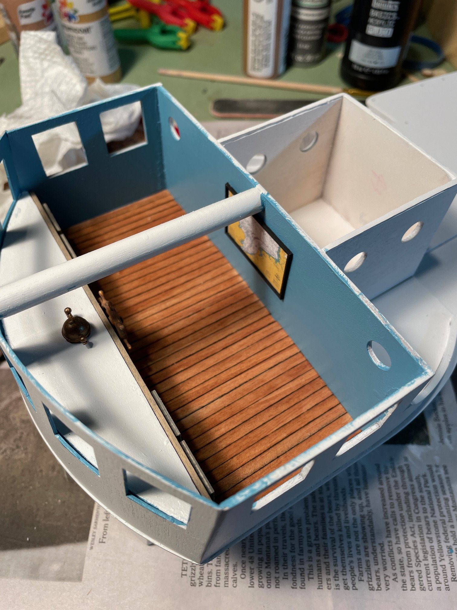

I went off on a bit of a tangent with the pilot house and decided to spruce up the interior a bit. I’m planning to use different planking for the main deck than what came with the kit, so after painting the interior walls, I repurposed that kit-supplied planking for the pilot house flooring.

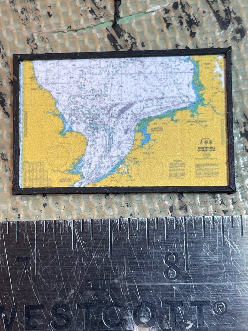

 Then I thought—if you’re sailing the North Sea, you definitely need a navigation chart. I printed out a reduced copy of a chart and made a small frame to mount it in.
The pilot house is now finished, complete with the ship’s wheel and compass. My only concern is that once I put the roof on, it might be too dark inside to see all the details.

On 9/23/2025 at 12:34 PM, robdurant said:
That blue colour. I searched and searched and was never really happy with my choice. Your pick looks just right.
Thanks, Rob! To be honest, I have to give all the credit to my wife—she asked ChatGPT what color would best match the Nordkap fishing vessel, and this is what it came up with.
