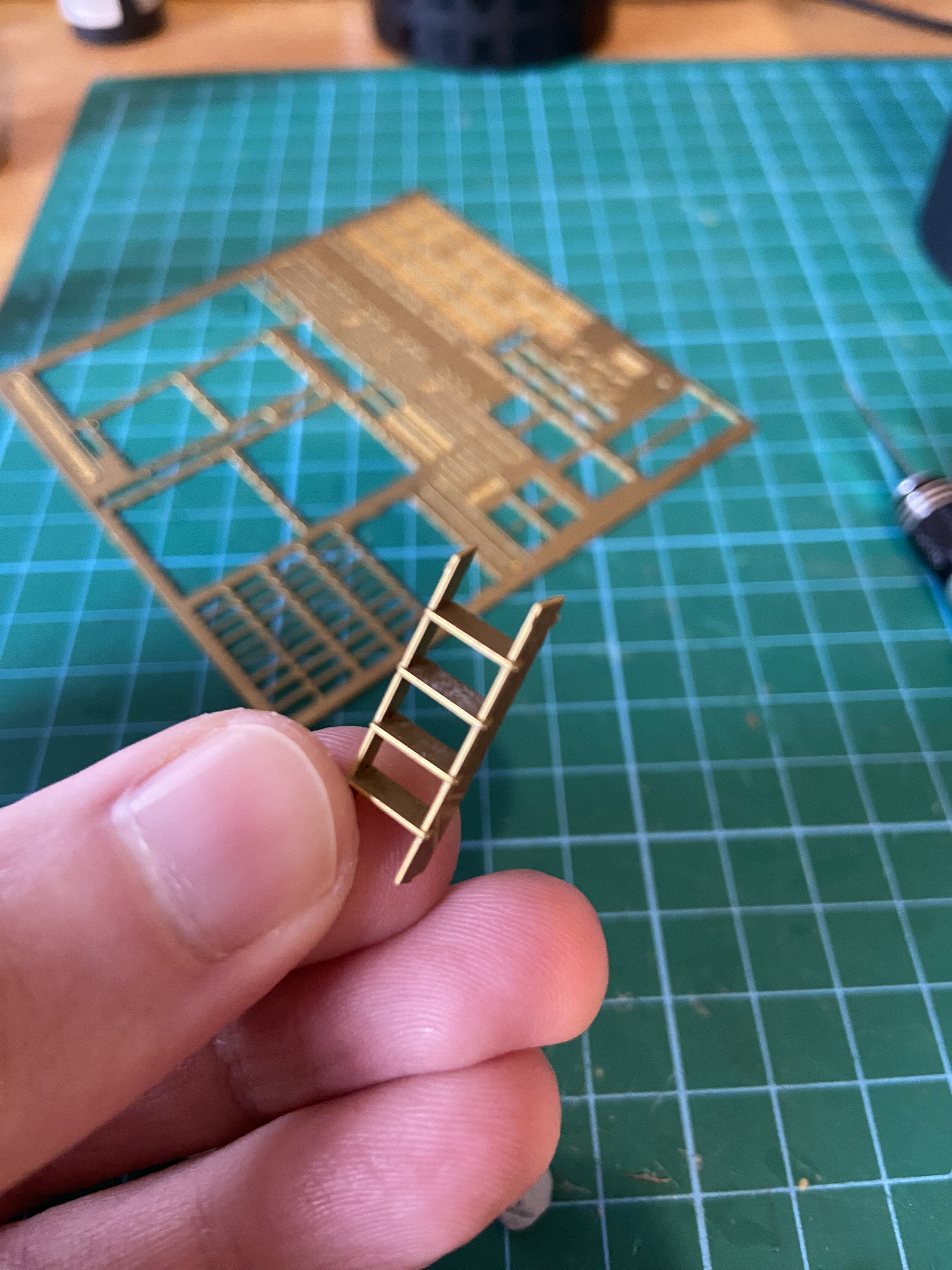

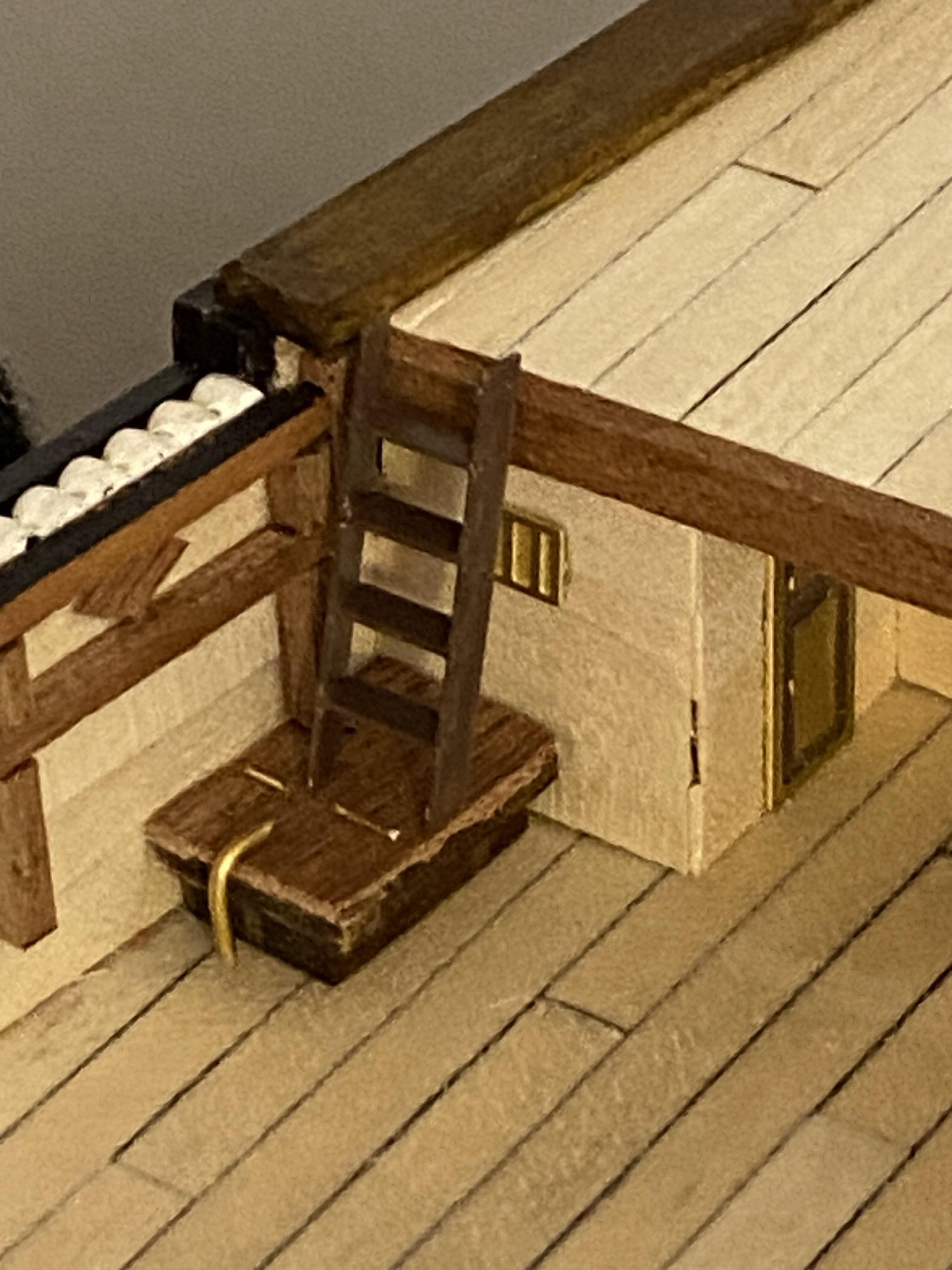

Chain plates are all finished now.  I've moved on to making tiny little ladders.
More experienced modellers seem to dislike that these parts are made of PE brass rather than wood, but I think they look good once painted with a bit of dark brown acrylic.  Nice clean edges.

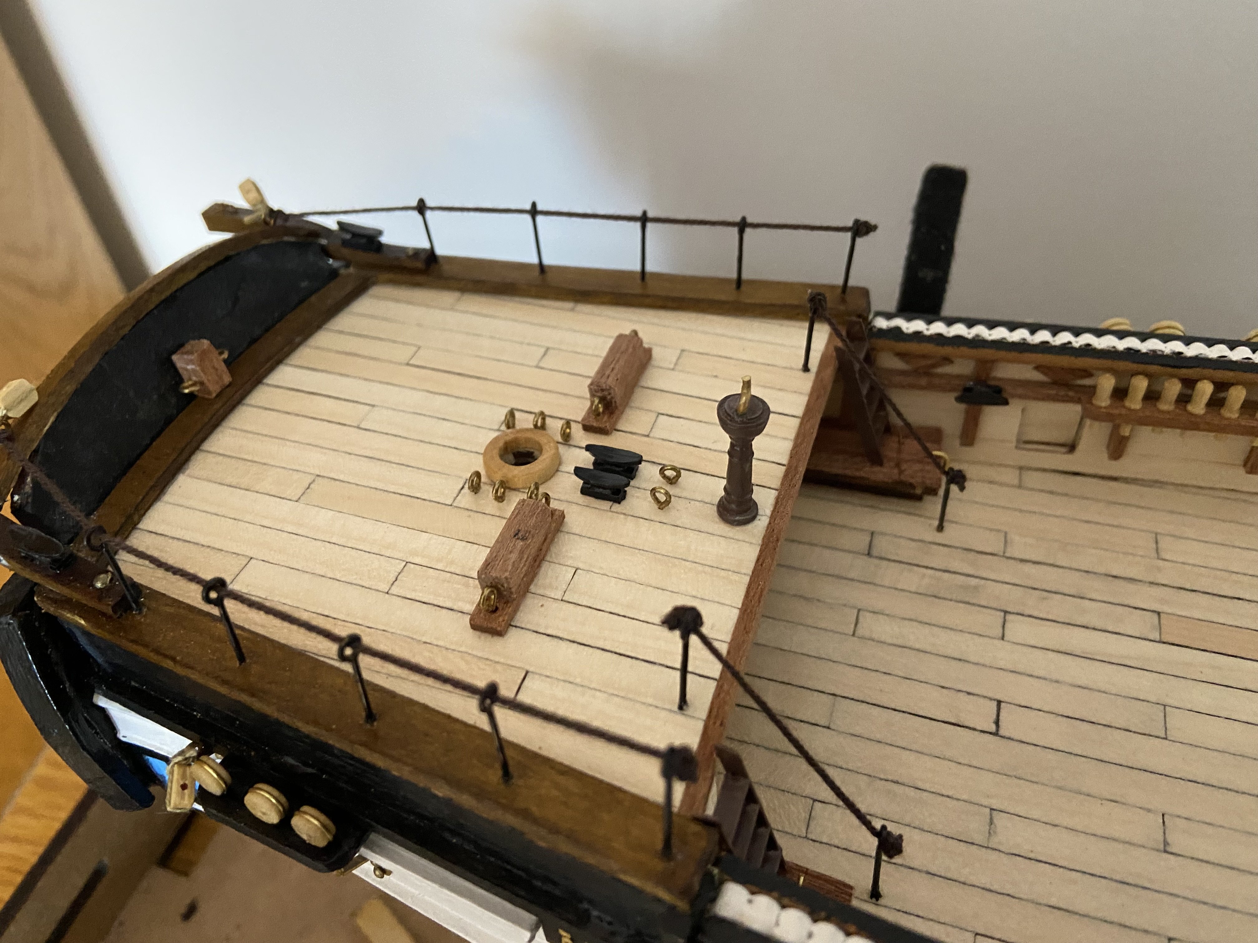

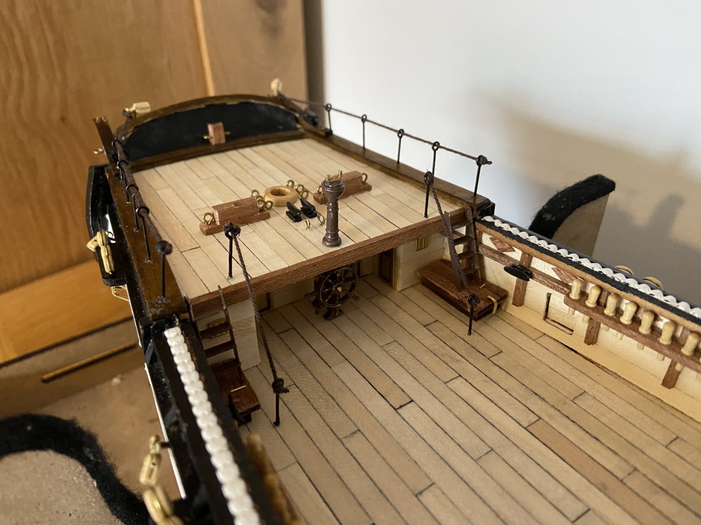

I spent quite a bit of time working on the quarterdeck this past week — all of it very enjoyable. The rudder wheel and binnacle are metal parts that turned out nicely with a coat of dark brown acrylic. I added a touch of gold dry brushing to the wheel to give it a subtle shine, as I imagine it might be the only part of the ship finished with a bit of gloss varnish. Gluing the wheel in place proved tricky, since it sits tucked beneath the quarterdeck and tends to tip forward due to its weight. It’s not perfectly centered, but I doubt the King needs to know his ship is being built by an inexperienced craftsman.
I also found the use of rope for the handrails quite interesting.  I wonder if that’s realistic? In any case, it probably doesn’t matter much, as there will be boats on either side of the quarterdeck once the kit is complete.

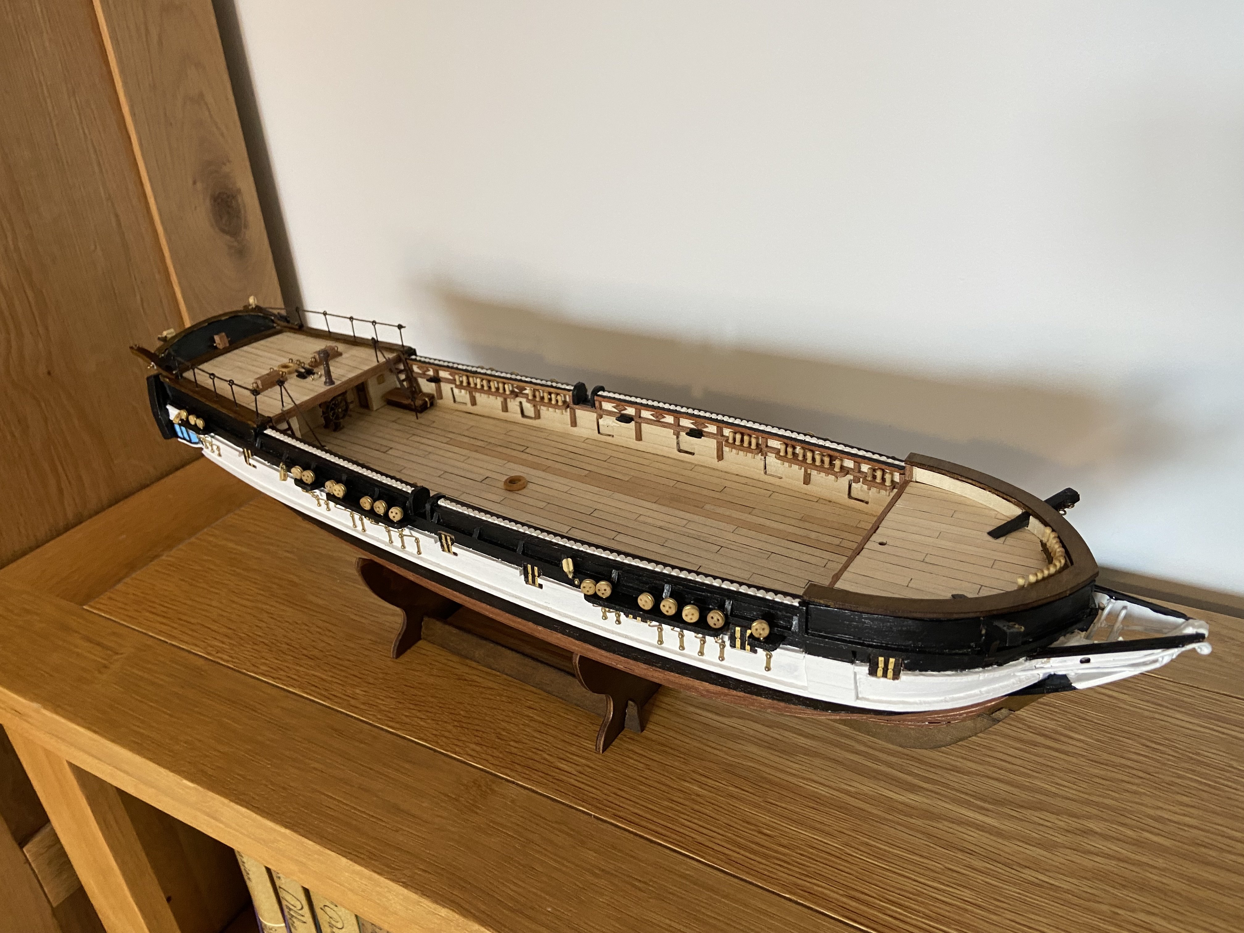

Current progress:
IMG_4097.thumb.jpg.ffcf116ddb25777b7e8eba98bebcbd7a.jpgIMG_4098.thumb.jpg.e0aa30e8b74cb2aefcdec3e1de5b2953.jpg

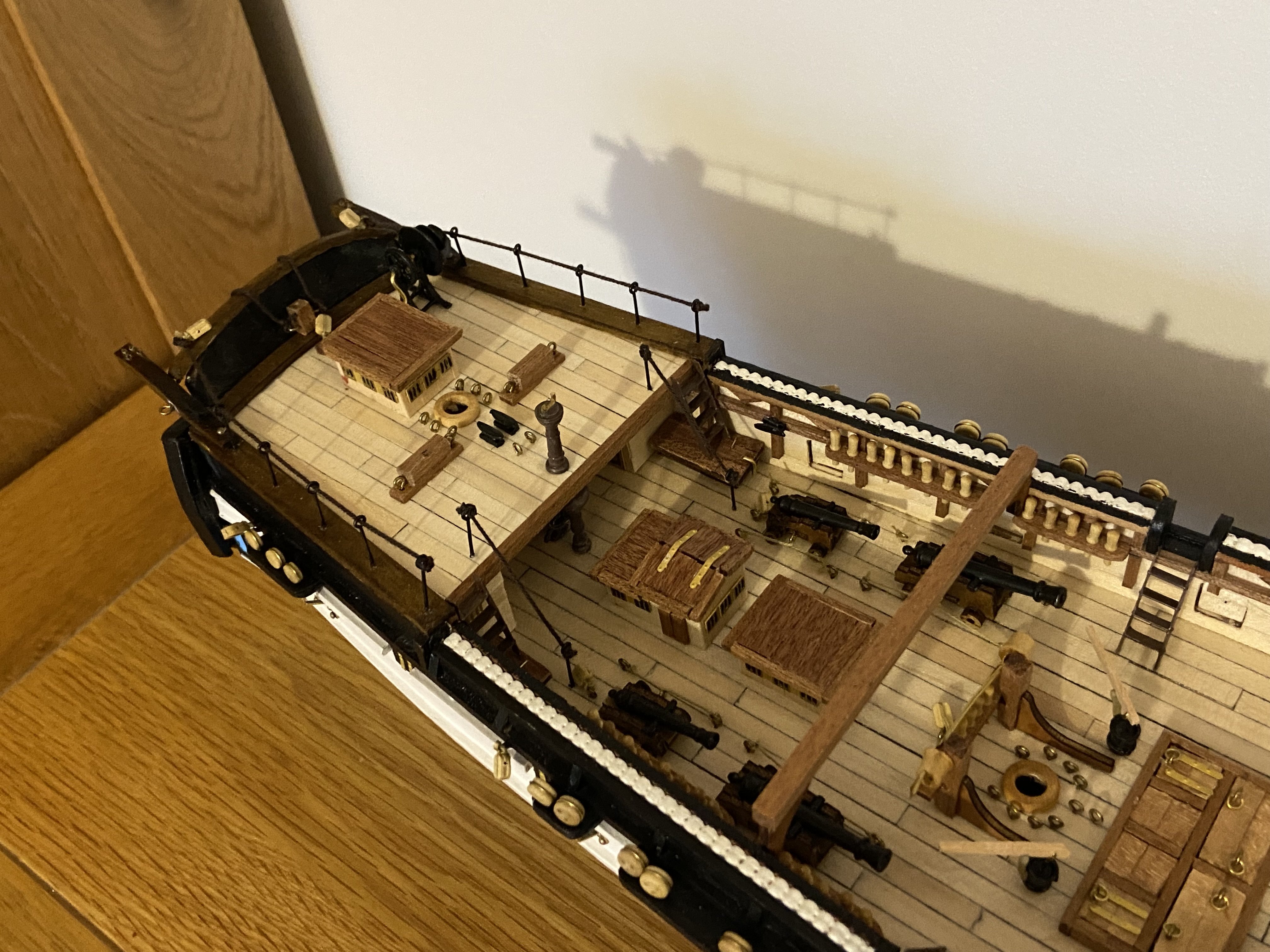

At the front of the ship, I put together the carronade, which went together quite easily. I went with lots of black paint and added a touch of walnut stain to the wood. As for the cannon itself, I decided to keep it simple and paint it entirely black. The official instructions suggest painting it black and then dry brushing with copper for a bit of shine, but I preferred the plain look, it feels cleaner.
IMG_4145.thumb.jpg.1637430b36beada7d79bdb503f0e18a7.jpgIMG_4144.thumb.jpg.72f8c27e3a0a9e328cc3b22a7f9ddb4e.jpg
Next up was the windlass.. This turned out to be a fairly intricate assembly, featuring a large metal piece that I painted with ochre, copper and black. It also involved some tricky wire bending, and the entire assembly had to be inserted and glued as one piece since it stretches from one side of the ship to the other. Aligning it correctly was a bit challenging, but I’m about 90% happy with the result. I really enjoyed wrapping the chain around the windlass, presumably simulating the anchor chain. Watching the chain weave through the deck is a surprisingly satisfying visual effect, and I think it looks really cool.
At the rear of the ship, I assembled the depth winch, mostly following the instructions. I left some parts as polished brass and painted the rest black. It was a fiddly little assembly, but I was happy with how it turned out and had no trouble gluing it in place.
And now for the part that almost every model ship builder loves: the cannons. Like the carronade, I painted the main cannons plain black, and for the gun carriages, I went with a simple walnut stain to give them a natural wood appearance.
I’m not entirely sure whether cannon carriages from this period would have been painted red, I suspect they probably were, but I’ve mostly been building this model for enjoyment rather than strict prototypical accuracy. If I were really focused on authenticity, a lot of the polished brass on the ship would have been painted black anyway, so leaving the carriages as stained wood feels fine to me. I did think about adding red for a bit of visual interest on the deck, but I worried it might look a little toy-like, so I stuck with the walnut stain for a more classic, realistic wood look.
IMG_4168.thumb.jpg.fe51d58e40ee33d35bf05a773de5ab07.jpgIMG_4167.thumb.jpg.b388a2aeab8016860f1746e3a187a89d.jpg

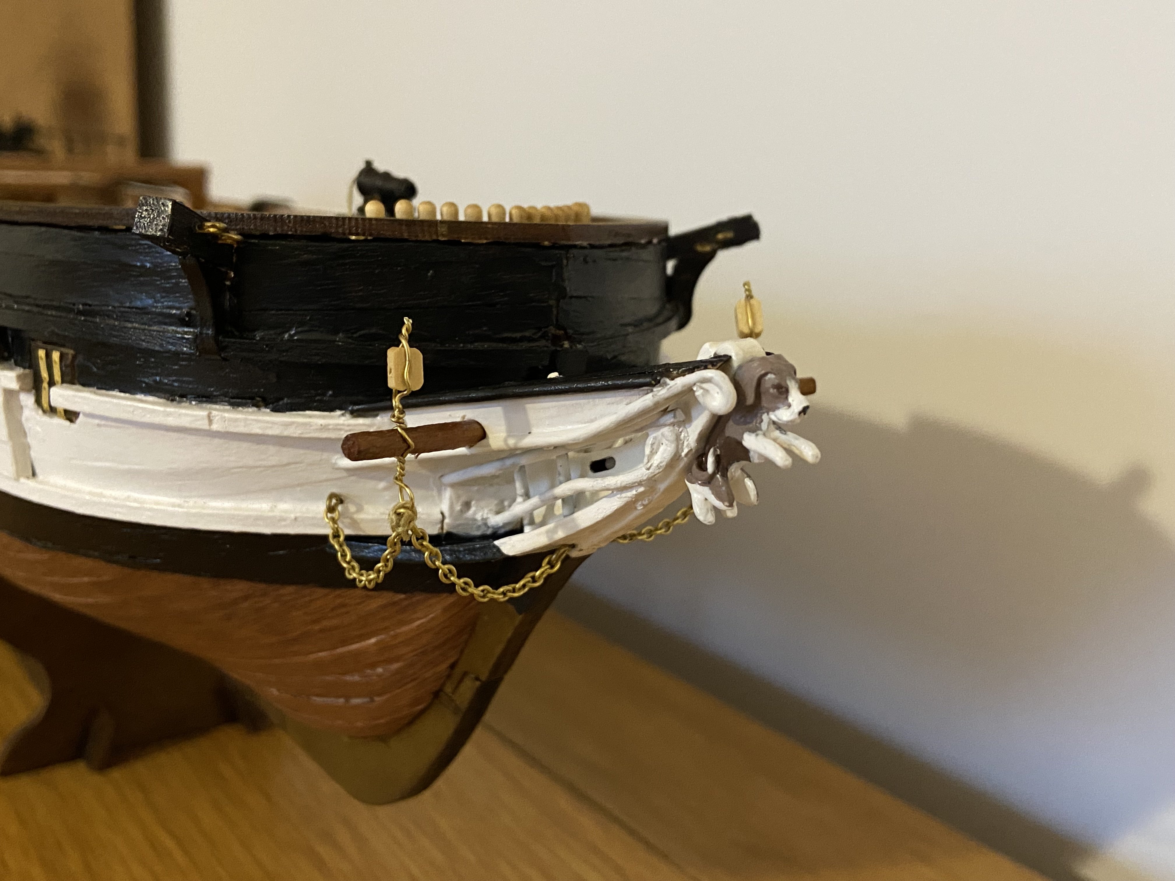

I've decided to skip ahead a few steps and tackle the figurehead, using this little chap as a reference photo.
There don’t seem to be any records of what the HMS Beagle’s figurehead actually looked like, but a bit of research helped guide my approach. By the time Beagle was built, the Royal Navy had moved away from the elaborate, gilded figureheads of earlier decades, opting instead for more realistic designs. I'm taking took my time painting a Beagle in tricolour style.
Edited by Maid of the Mist
Hello Maid of the Mist.
Hi Maid of the Mist.
I recently picked up a copy of Figureheads of the Royal Navy by David Pulvertaft published by Seaforth Publishing. I have looked for Beagle after seeing your latest post. I don't believe I can post a picture from the book, however I hope I can still be of some help with regards to the look of the figurehead as displayed in the book.
The book shows that Beagle was given the fore-part of a beagle as her figurehead. It also states as you have said above, that there is some debate as to whether Beagle had a figurehead after she was converted to survey work in 1825.
(Below, my poor rendition of what I can see in the book)
I don't know whether this helps you or not. I hope it does, however I apologise if I have taken unnecessary space from your build log.

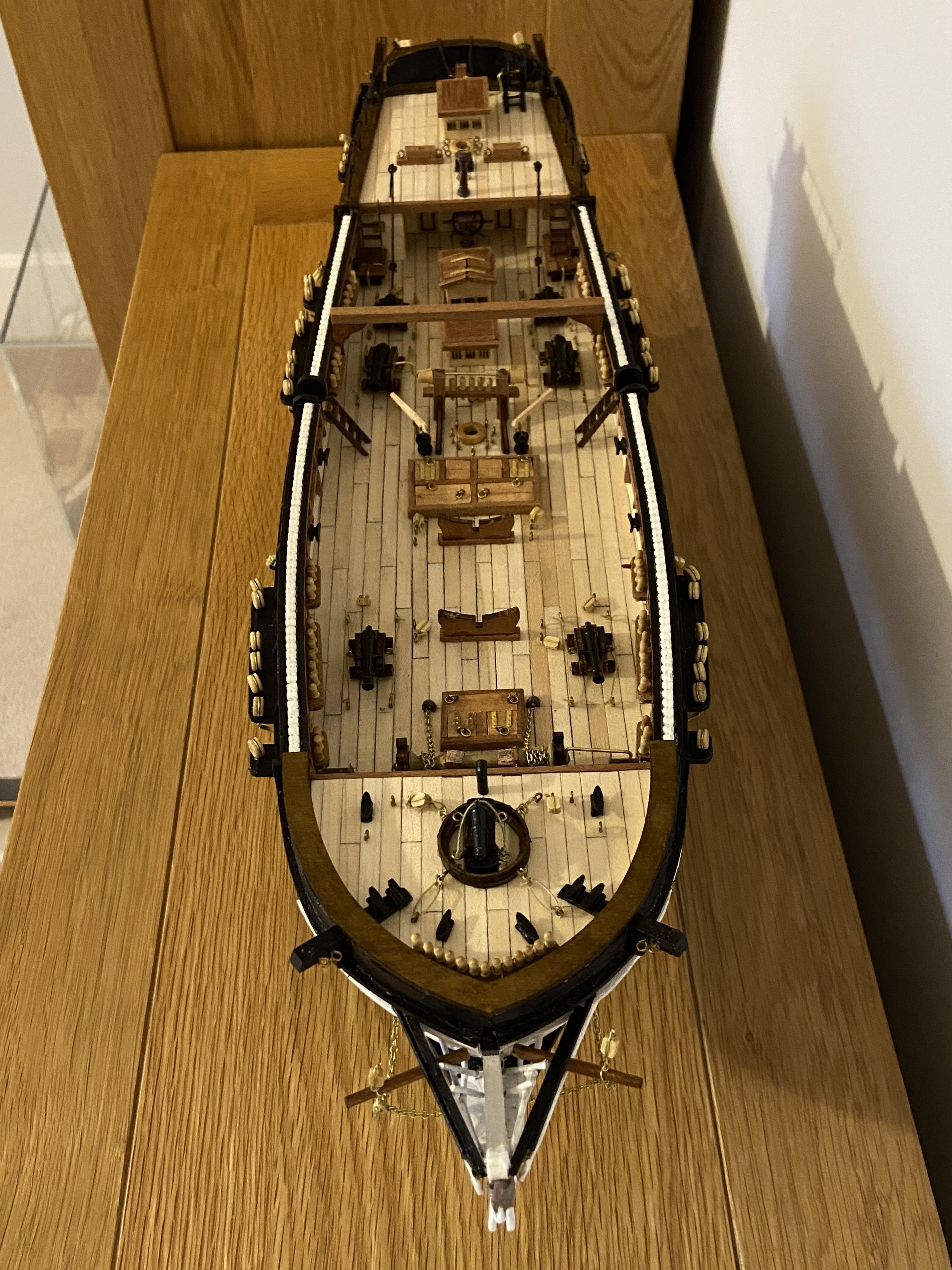

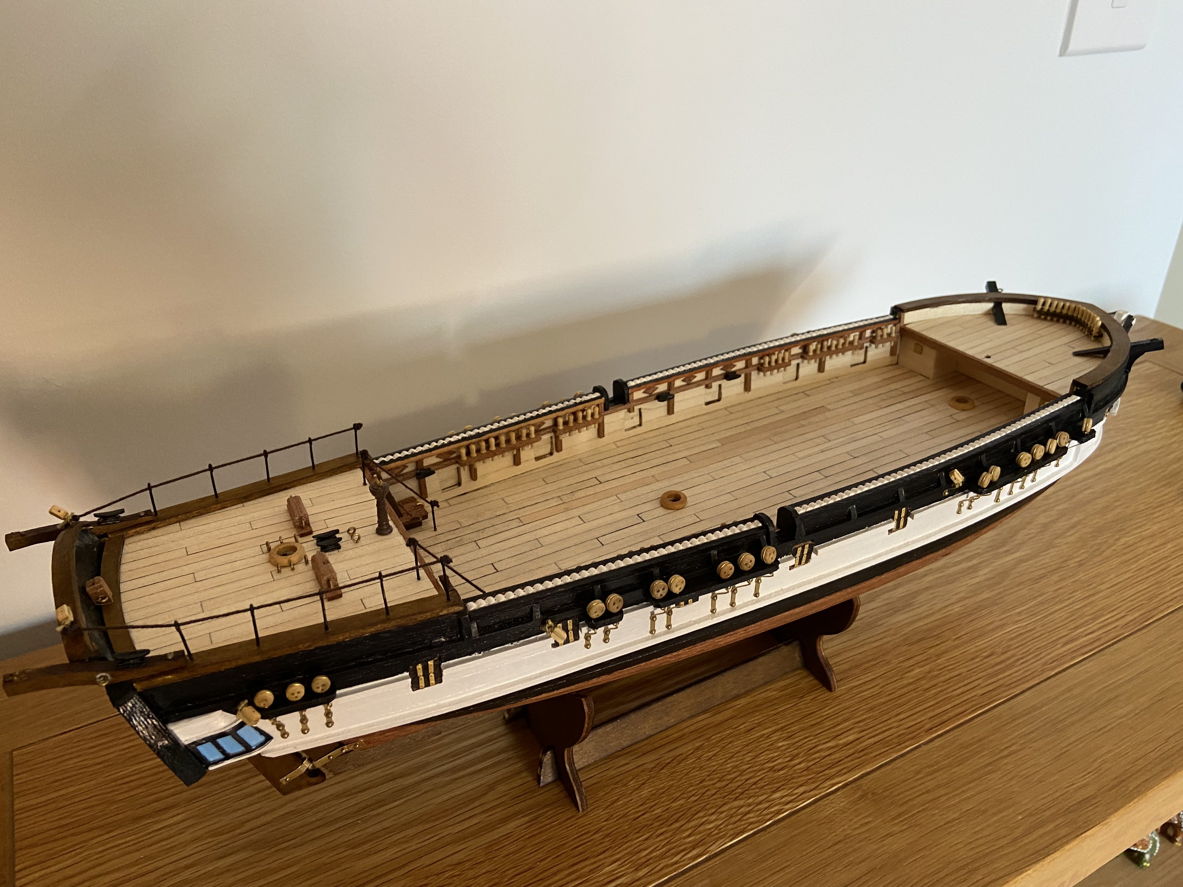

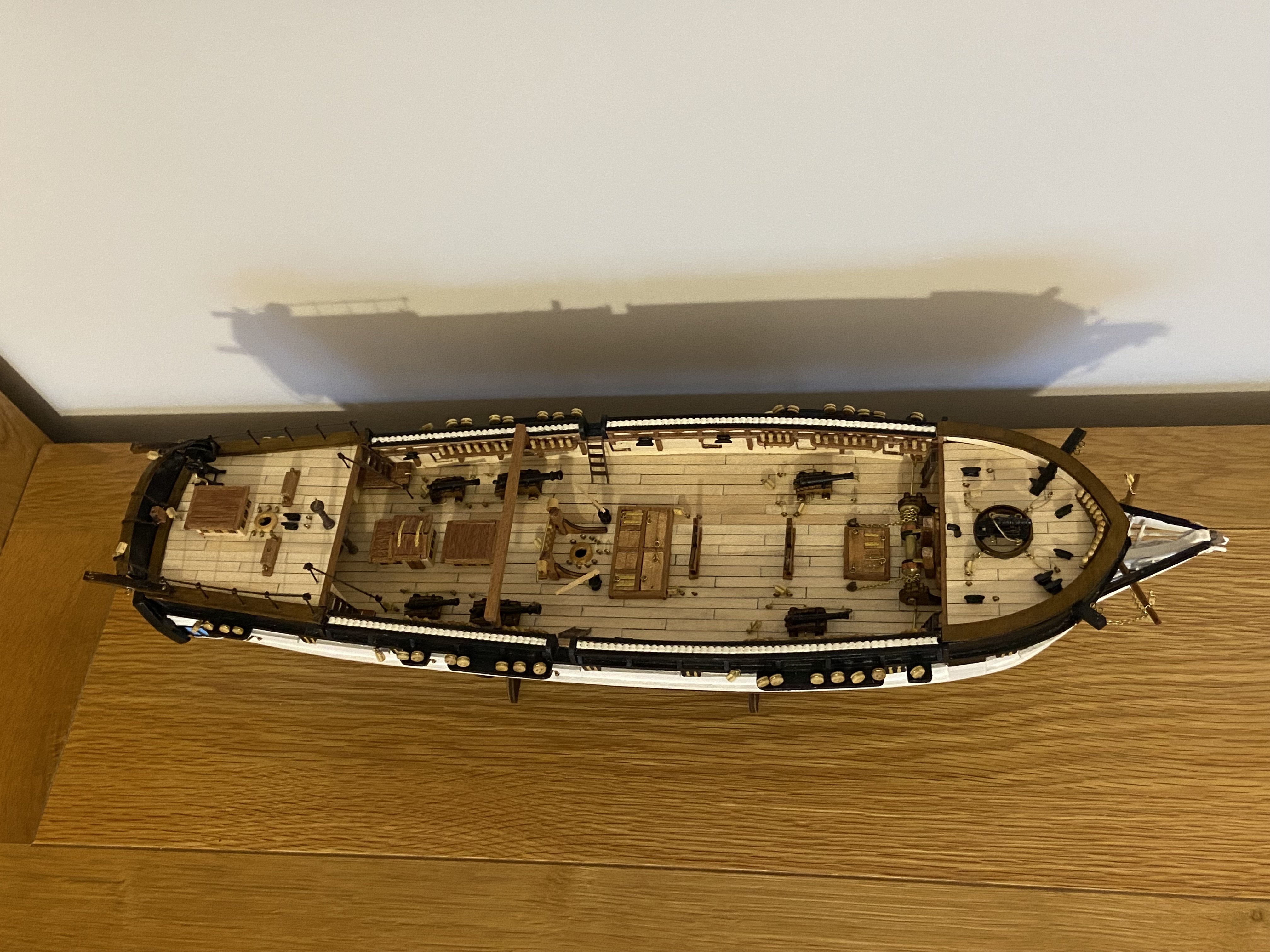

The deck and hull are now close to completion in terms of added details.
I have placed all of the cannons.  Each one was tied down following the kit instructions.  Nothing historically accurate of course, but the combination of simple knots and a bit of rope twisting gives them a convincing, tidy look for display.  They add a lot of character to the deck.  There is also the large stern support beam running across from one side of the ship to the other.
I also assembled the small deck huts.  These were surprisingly intriate little builds.  I'm still not entirely sure what the real structures were used for.  Certainly they're too small for a real person sit in.  I assume they served as storage for equipment and tools.
I also completed the boat supports towards the front of the ship.  This prepares the way for the upcoming task of assembling one of the four (!!) little boats that come with the kit.  They will be fiddling work, but they should look great.
At the bow, I installed the figurehead.  It sits nicely and I think the natural colours I used work well with the model overall.

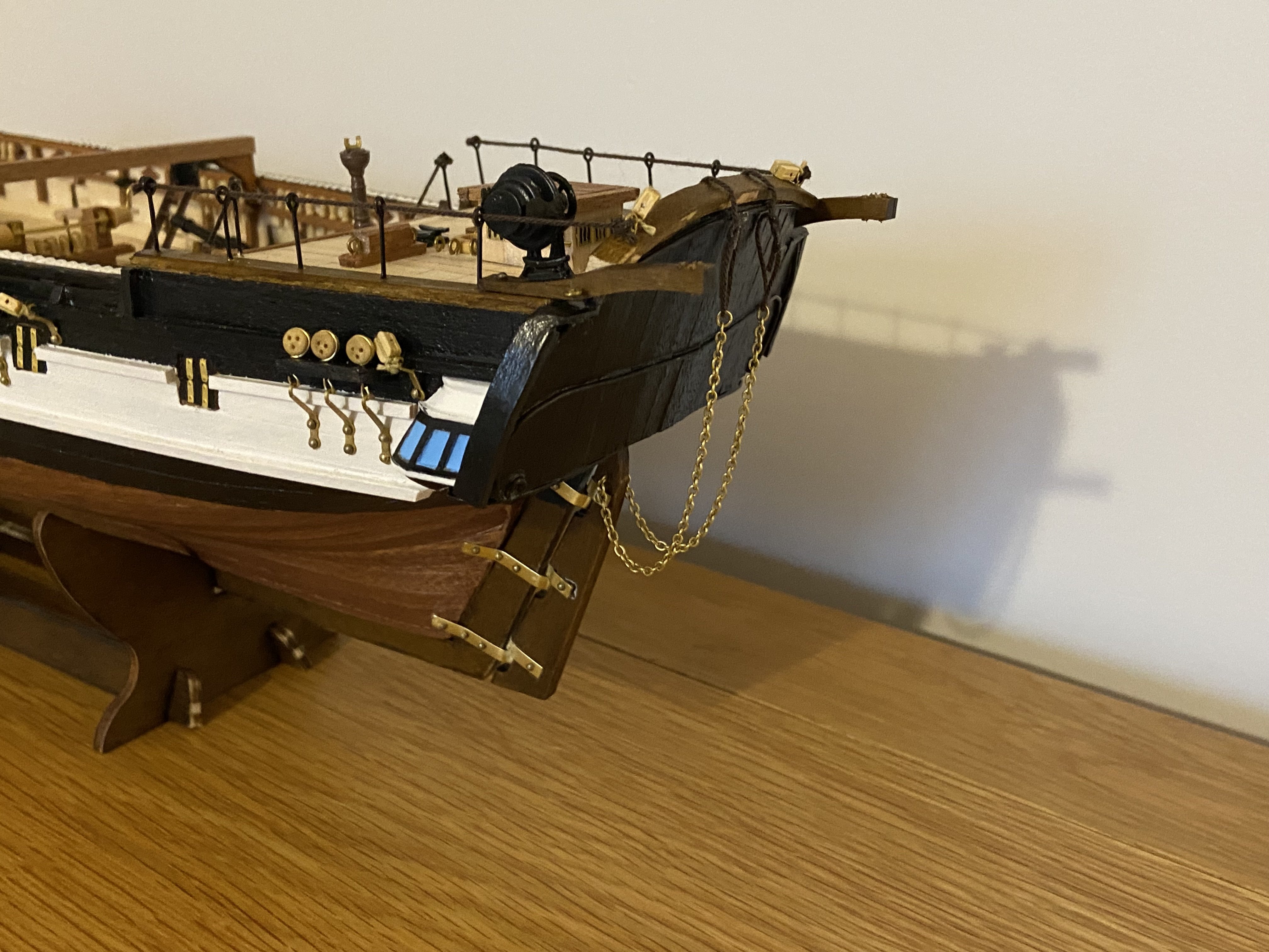

At the stern, the rudder chains are added:

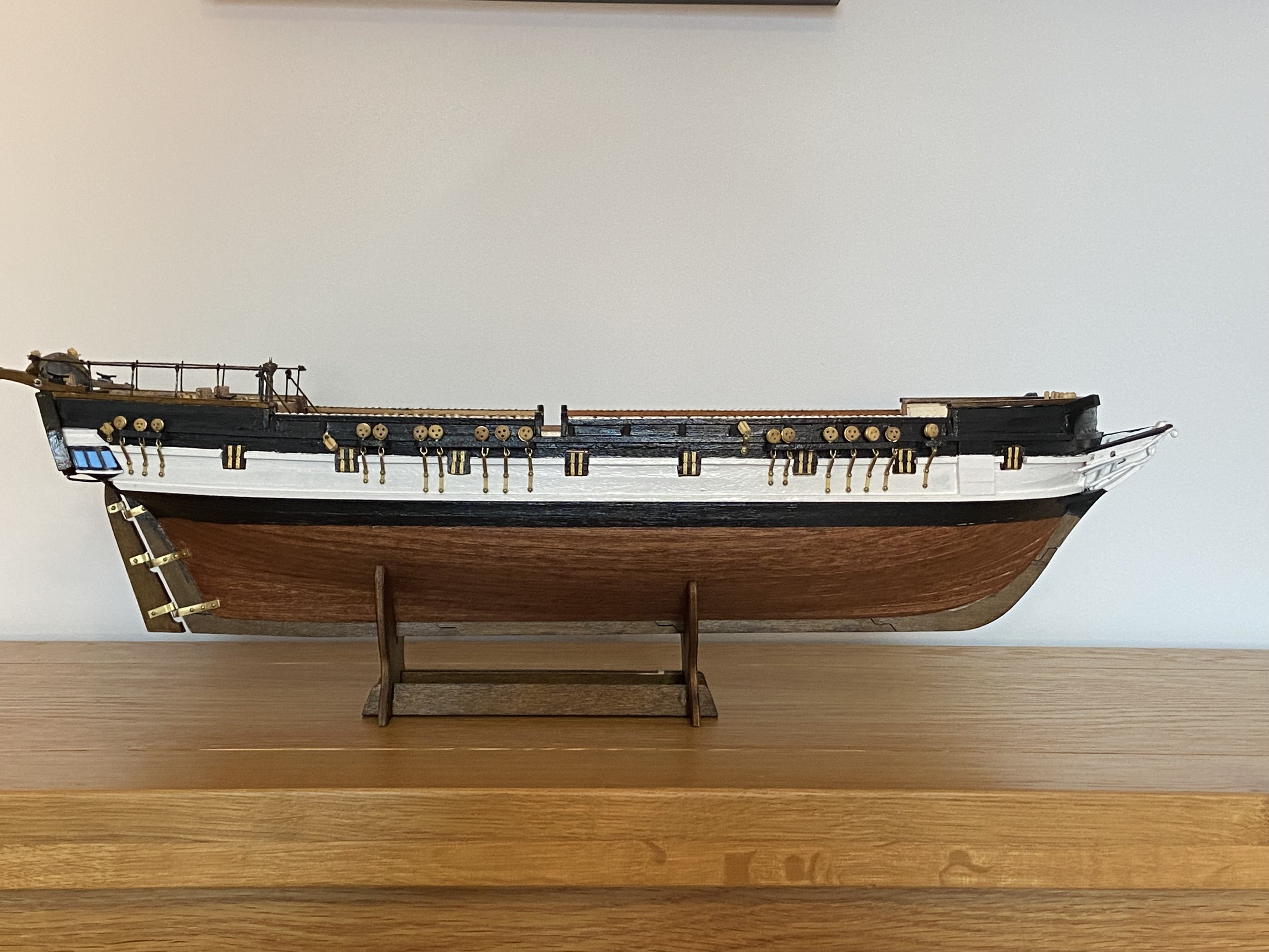

Aside from the small boats and the anchors, the main structure of the ship is essentially done:

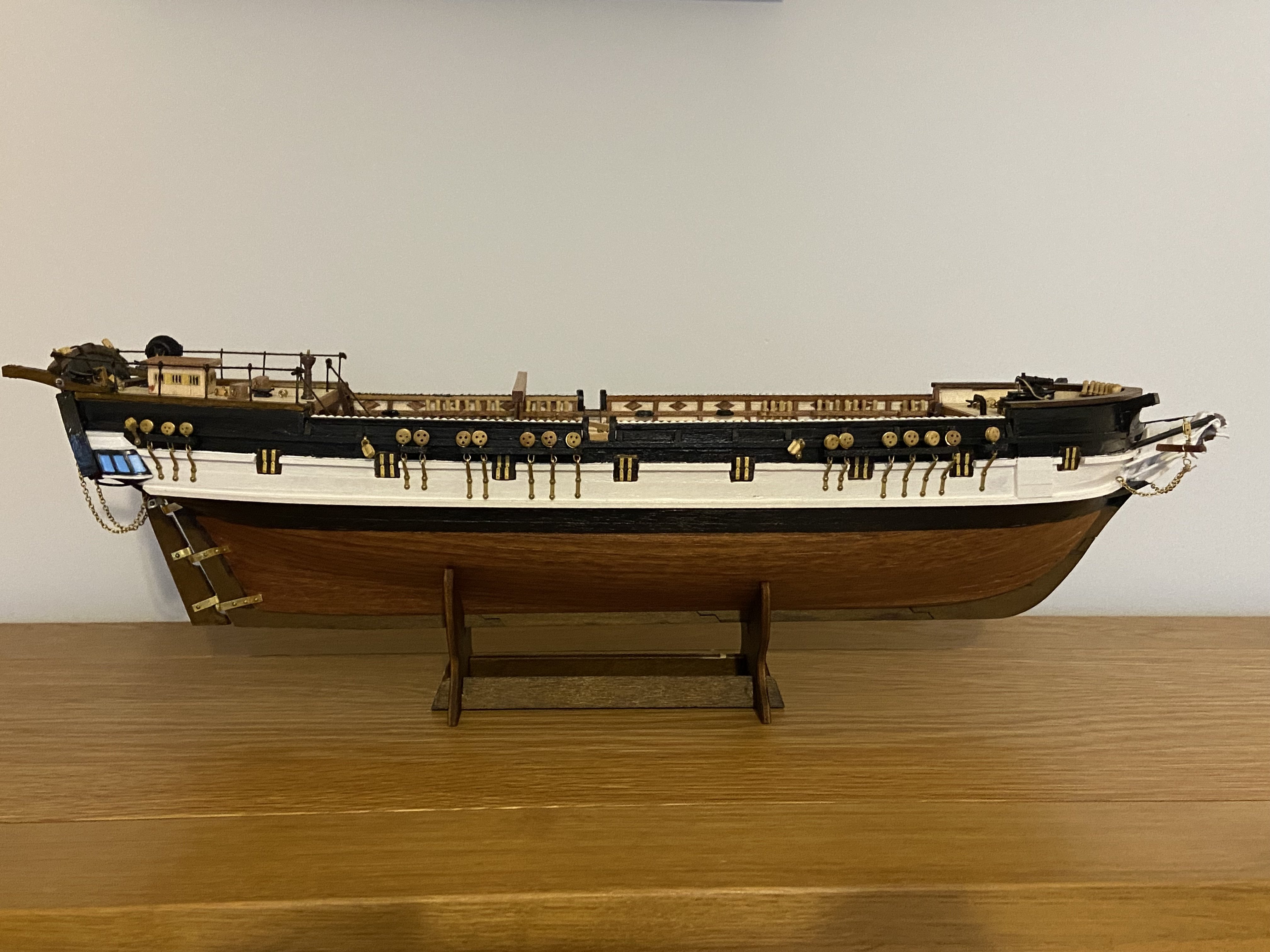

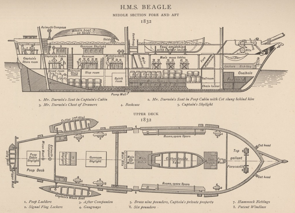

Took a short break from the jolly boat today and focused on finishing and fitting the anchors. The ship has four metal anchors, all of which had to be glued together, painted black and hung from the hull with different lengths of chain. Surprisingly, this ended up being one of the most frustrating parts of the build so far.
I’m reasonably happy with how they turned out but I can’t shake the feeling that the anchors hanging off the sides interrupt some of the sleekness of the hull. What I’m less sure about is the actual prototypical setup: the two bow anchors make sense, since their chains run forward, inside the ship and would attach to the windlass. But the two positioned closer to midships aren’t connected to anything. If they were untied, they’d just drop straight into the sea. Were these meant to be spare anchors that would only be rigged properly when needed, or is this just a bit of inaccuracy from the Occre?
Either way, the job is done. It took me about four hours to get all four anchors mounted.  Tiny chains, deadeye bolts, bits of rope and surprisingly heavy metal anchors are not the easiest things to wrangle at this scale. But they’re on!
Maybe I'm wrong, but that seems like a mistake by Occre. Yes, someone could bend a heavy line to that anchor before dropping it, but notice there's no cathead or other setup for launching or recovering that anchor without damaging the hull. And having it hanging there, not properly catted, also sounds like a recipe for damage. Finally, I don't think she would have carried four full-size anchors like that. But to be fair I'm not an expert on Beagle.
As a survey vessel, the Beagle carried more anchors than a normal ship of this size (see Anatomy of the ship). The additional anchors were just stowed there. This time it is no error form occre ;)

Carrying more anchors than usual as a survey ship makes sense. But is that really where they stowed them? Seems like asking for hull damage and anchor loss, as well as harder to handle. I guess it's not easy to maneuver a large anchor out of the hold or something, either?
