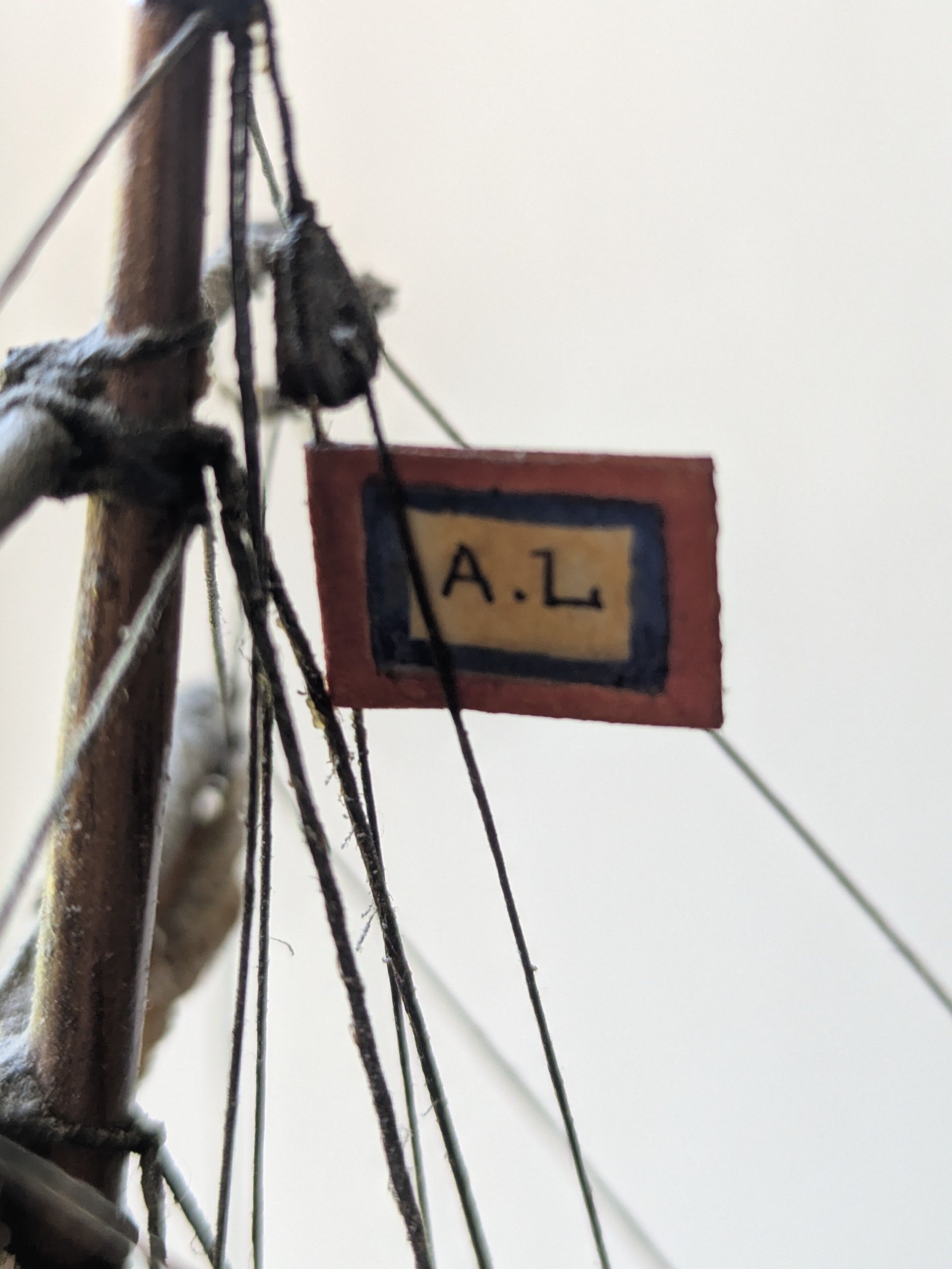

But perhaps you can make out something on the house flag (near the top of the mainmast)? I think I can see an A and an L but anything else is lost in your photos.

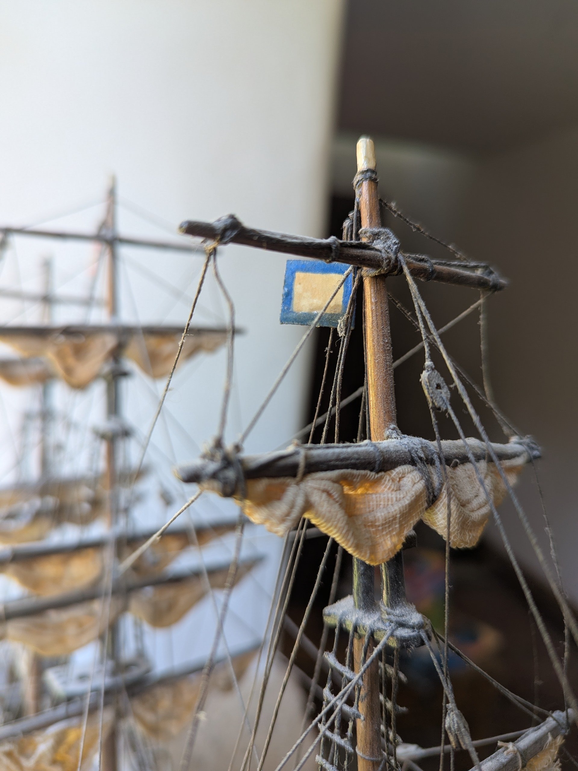

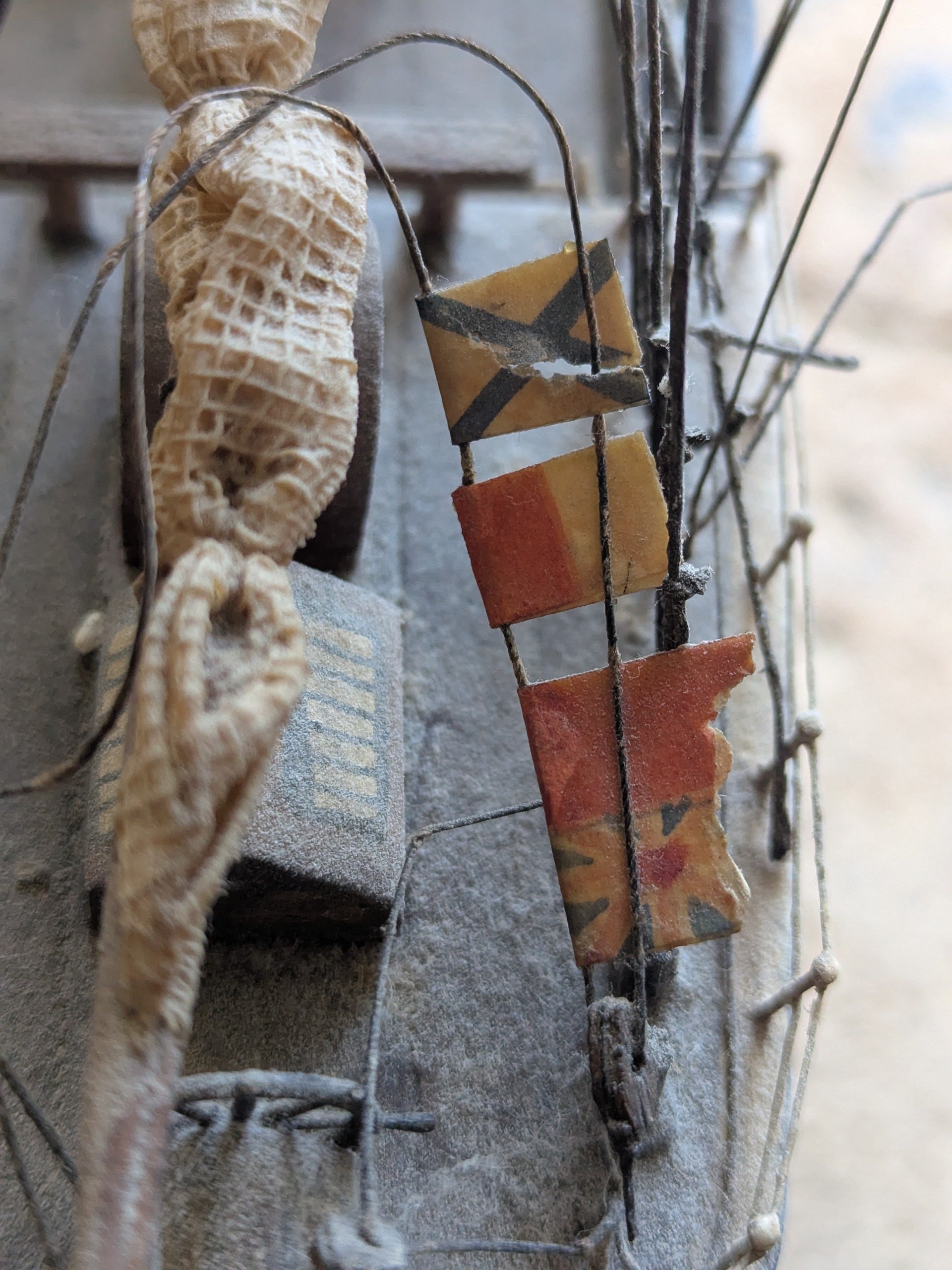

So grateful for your observations, insight and analysis. It's super interesting and very helpful. Here are some images of the flags, which I should have included in my original post, of course!

Top image is the Blue Peter at the foremast head -- traditional signal that a ship was ready to sail. (The same flag is now P, or "Papa" in the NATO phonetic alphabet, with much the same meaning.)
The bottom image probably began as an attempt to show the ship's own identification "Number" (actually a group of four letters -- nowadays far more often used as radio call sign), plus her ensign. As it has fallen from the rigging, the group of flags has become inverted. The bottom (originally top) is the (British) Red Ensign, with most of its length broken away but the Union still visible in the upper canton. Next is code flag H. The blue saltire on a white field is not a flag of the modern International Code but that has changed a bit over the decades, so I'll not say it was wrong for the era represented. There were probably two other flags (now lost) to complete the "Number".
The middle image is the owners House Flag. Someone may know whether any real-world owner used that design, though it could have been the model-builder's imagination (probably with L for "Line"). Alternatively, I wonder whether the builder "signed" his model by putting his initials there. He may have been A.L.
