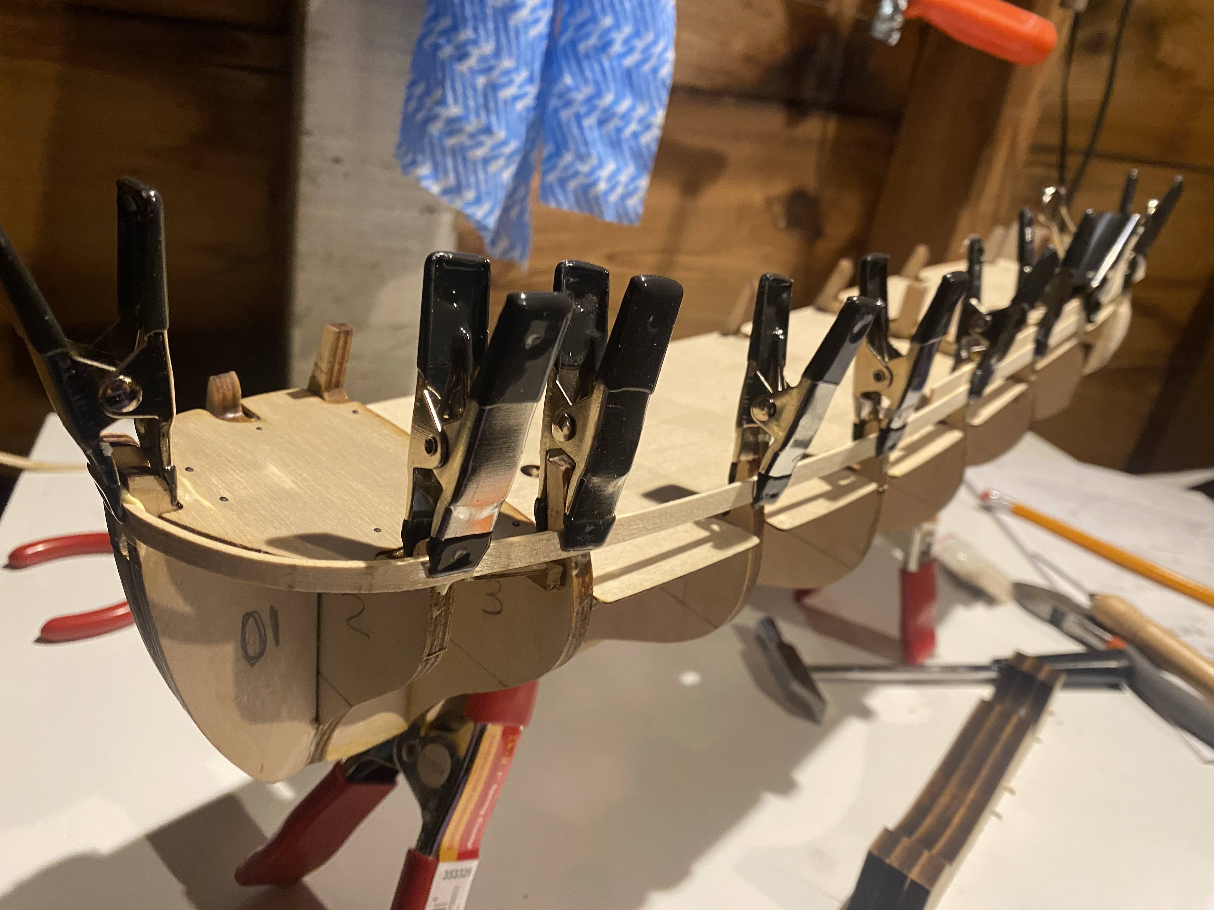

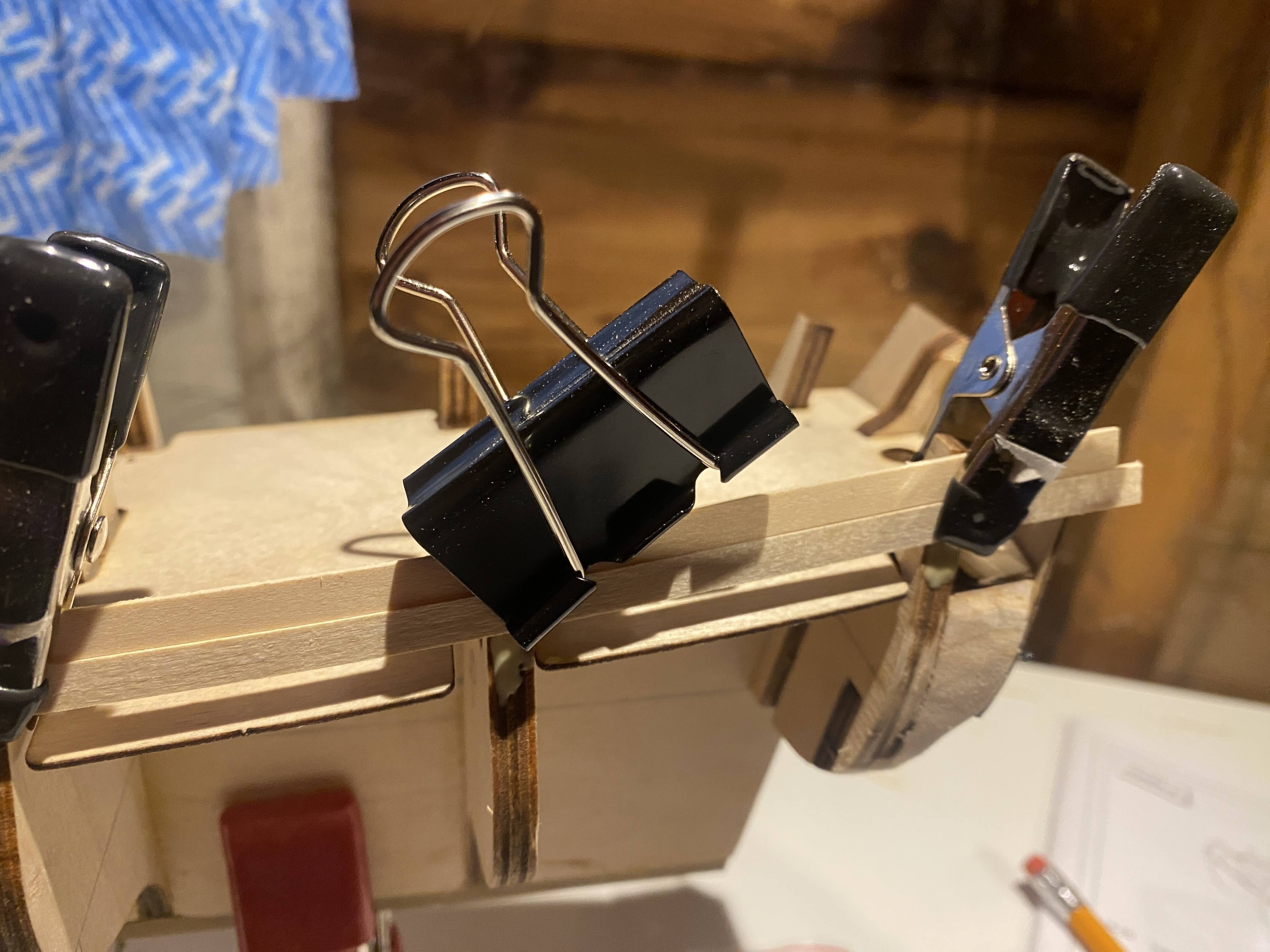

This is my first build so I rushed into gluing on the bulkheads before consulting my primary reference material, Ship Modeling Simplified by Frank Mastini.
The main and forecastle decks are flush with the keel but I can already see a gap between the keel and the quarter deck, but I was able to nail and glue it to the bulkheads.
The mast hole were misaligned, this was something that was noted in the YouTube video I'm following so I was expecting it. I filed the holes to properly align.
I was unclear what to do with the wooden pieces that support the aft (unclear if I'm using the right terminology here) seen in IMG_4591 from the instructions, which are sparse and in Italian. But I was eventually able to figure out that I needed to cut and taper them to align with the curve of the aft bulkhead. I used a round sanding bit on my dremel and eyeballed it. I'm pretty happy with the result.
The instructions tell me to plan the deck before the hull but based on what I've read in here I am going to proceed with the hull planking first.
I've only been able to find small bits of time to work on this but I've been watching a lot of videos on how to use planking fans.
I was able to add the first two planks to the port side and use my electric plank bender for the first time, which was a fun learning experience. Something about bending the wood to a nice curve is very satisfying. It's becoming more apparent that my bulkheads are not perfectly aligned and I'm regretting not waiting for my book to arrive before diving into that.
I'm a bit surprised that my longest bulkhead is #8, closest to the stern, I was expecting it to be one of the middle bulkheads.

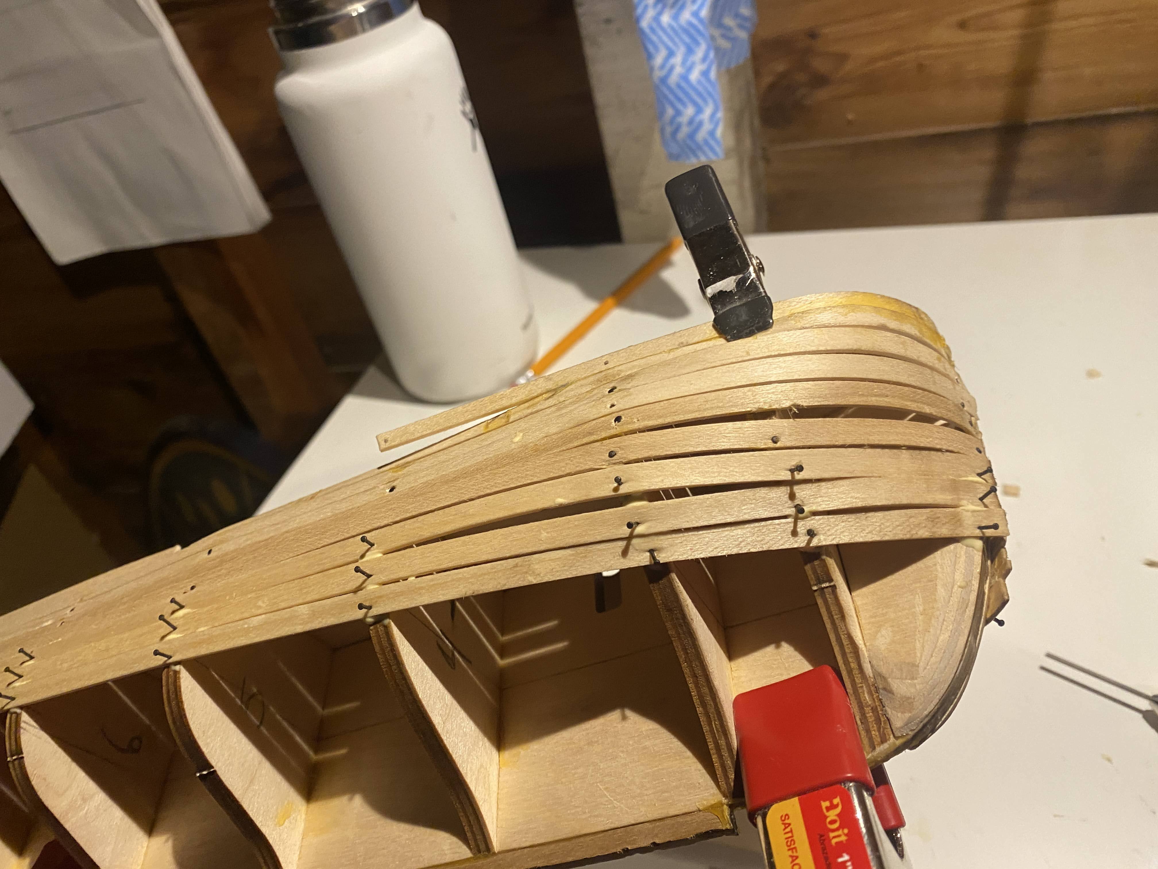

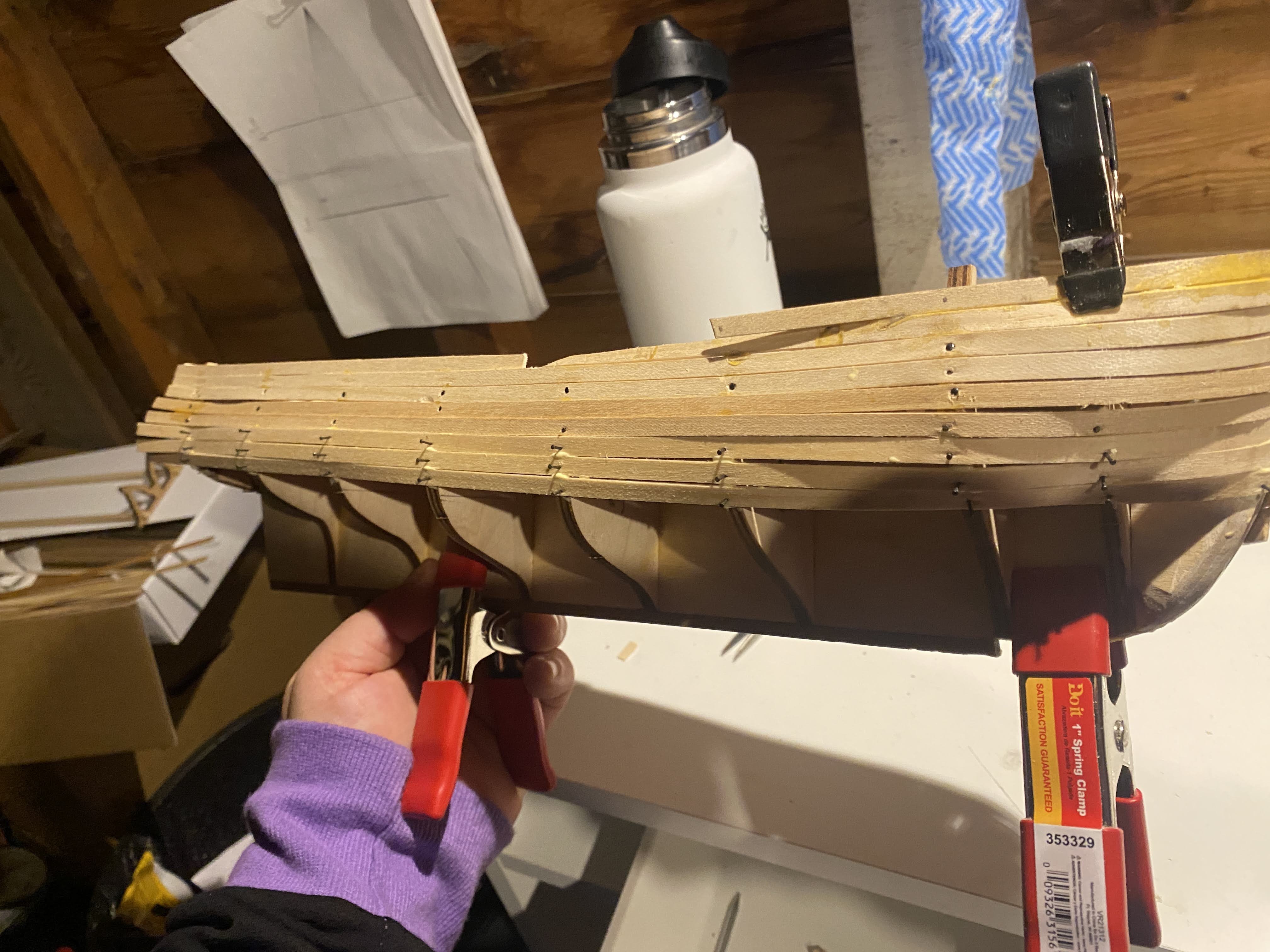

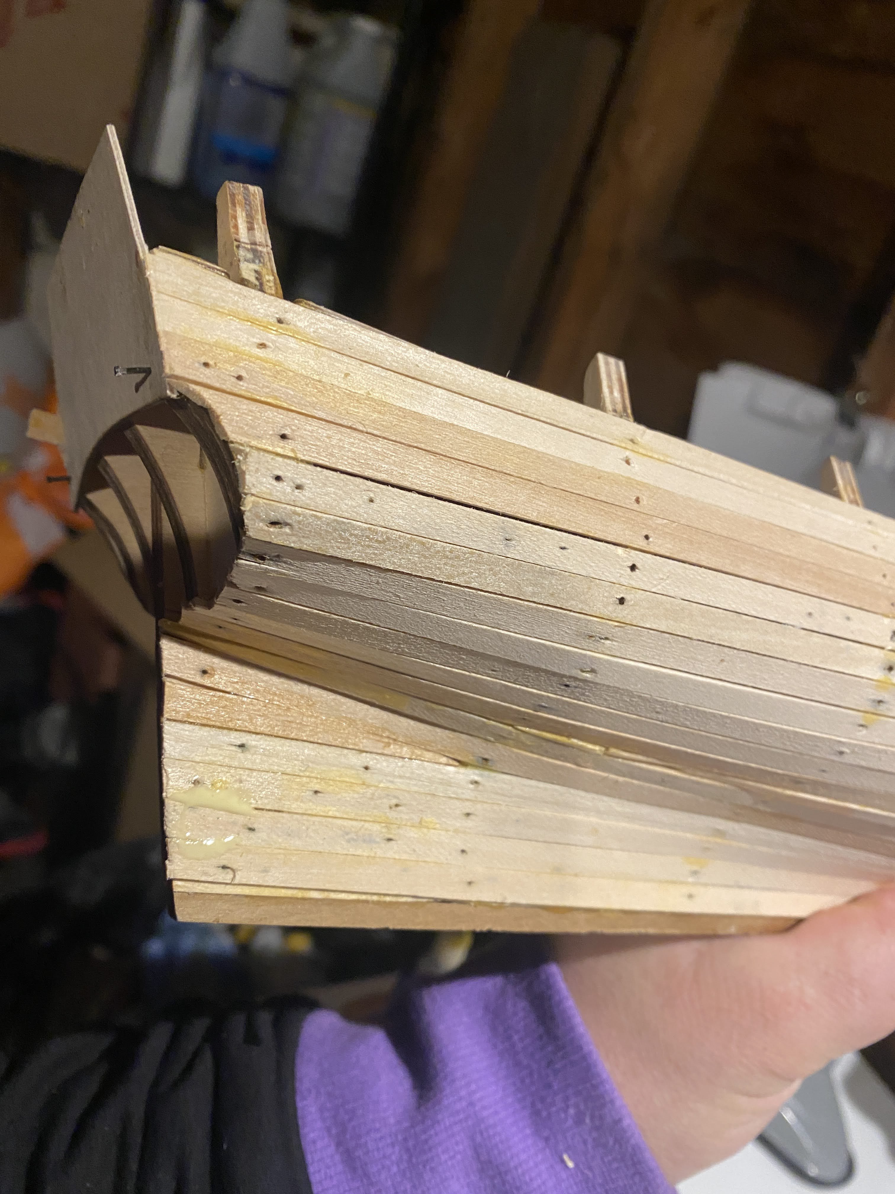

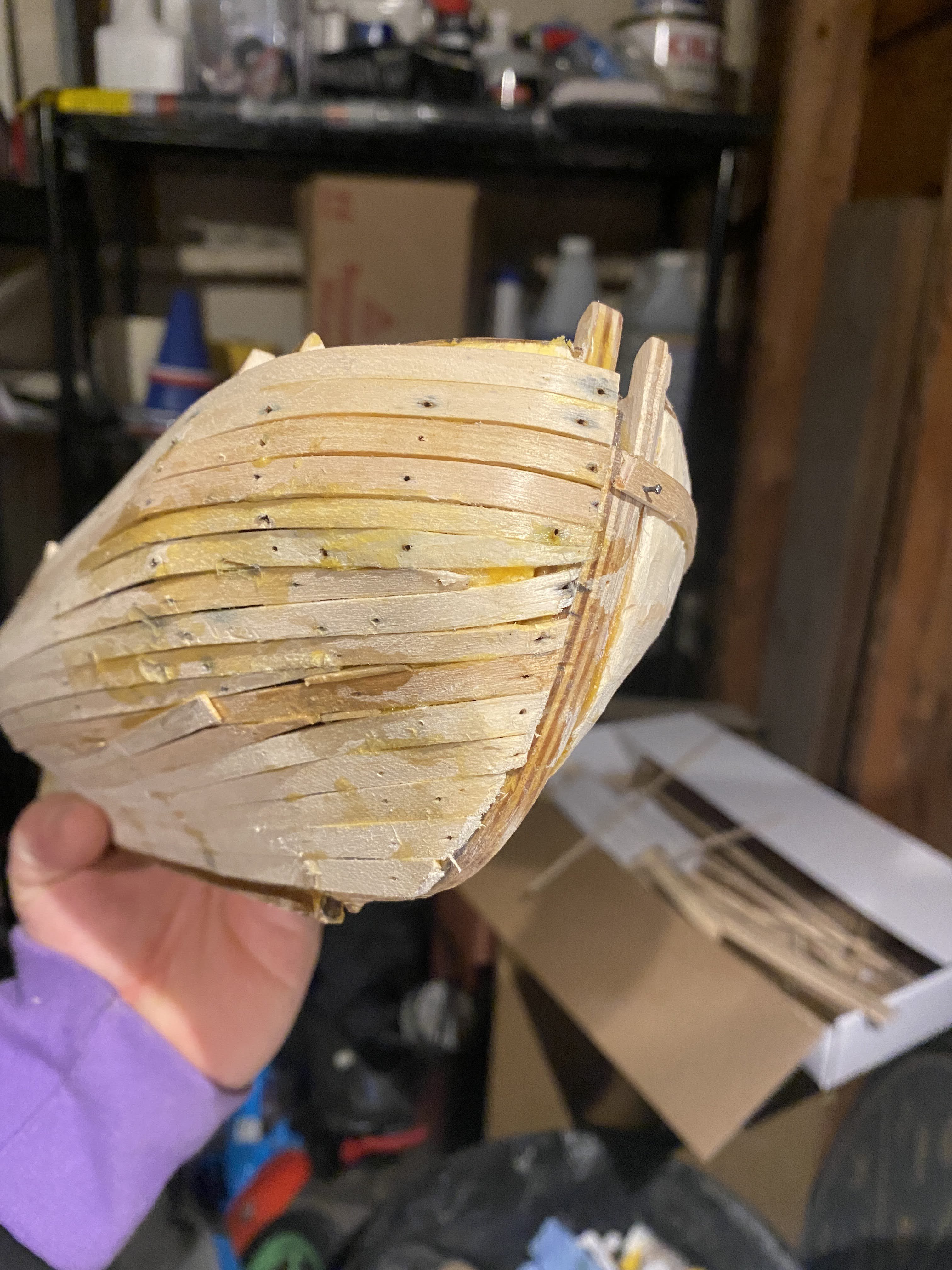

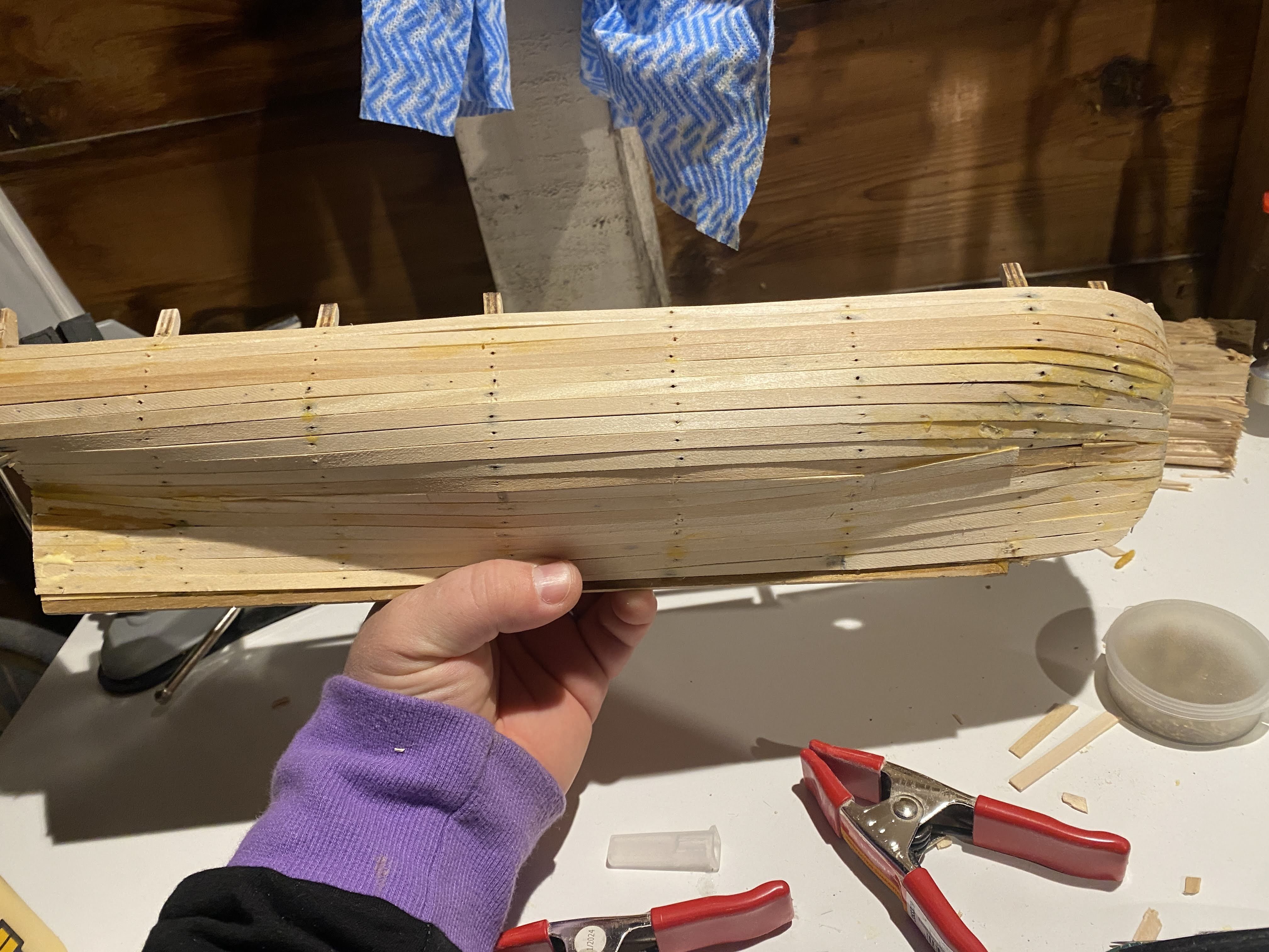

Planking is getting easier as I go but I've learned some key lessons:
  • Make a bow filler, it will help shape the curved planks. I'm struggling to find the right curve at the top of the bulkheads without it.
  • Soak your planks for an hour or so, they are so much more pliable and easier to insert pins into.
  • A pin pusher is an invaluable tool.
    • My current pins are 7.5mm and I find them to be a bit too small. I ordered some 10mm pins but I don't know if they will fit my current pusher.

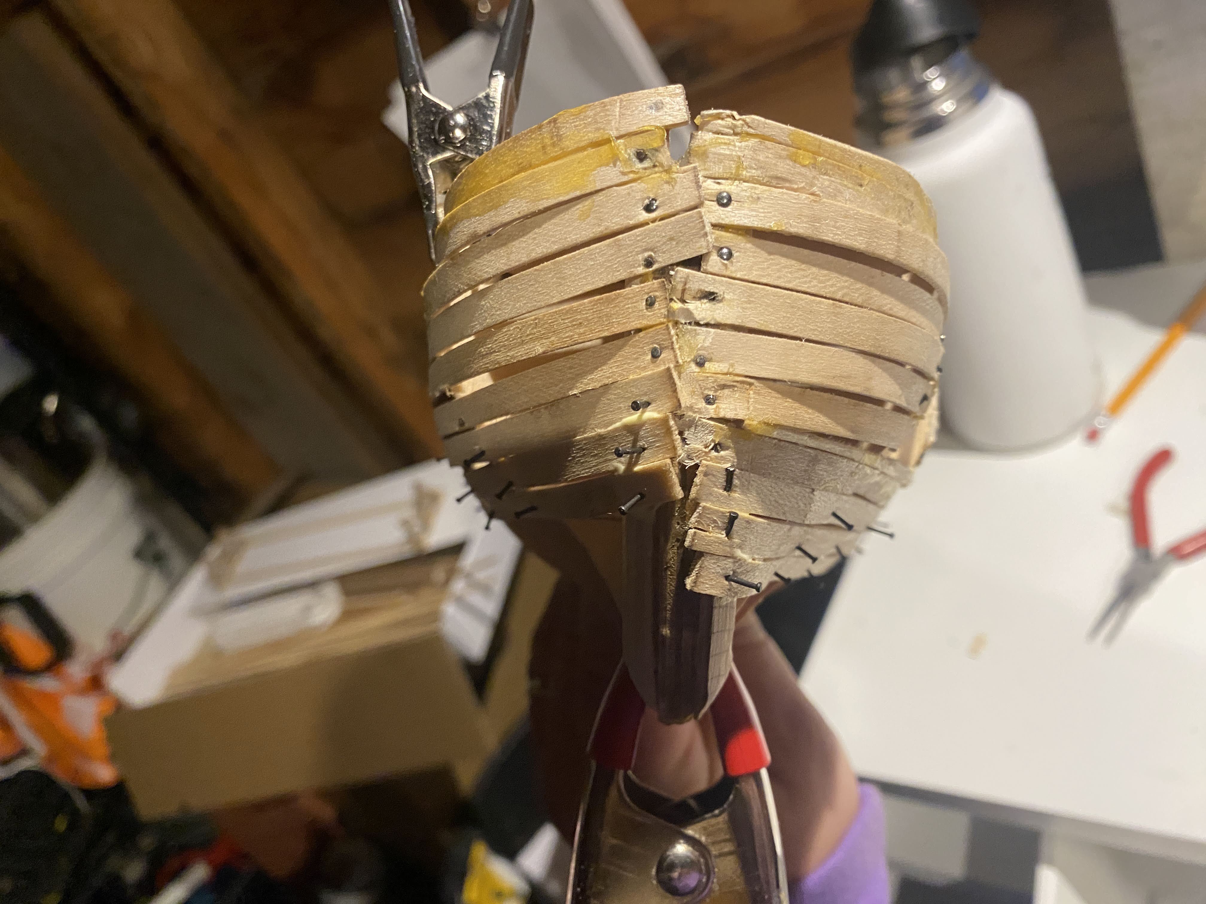

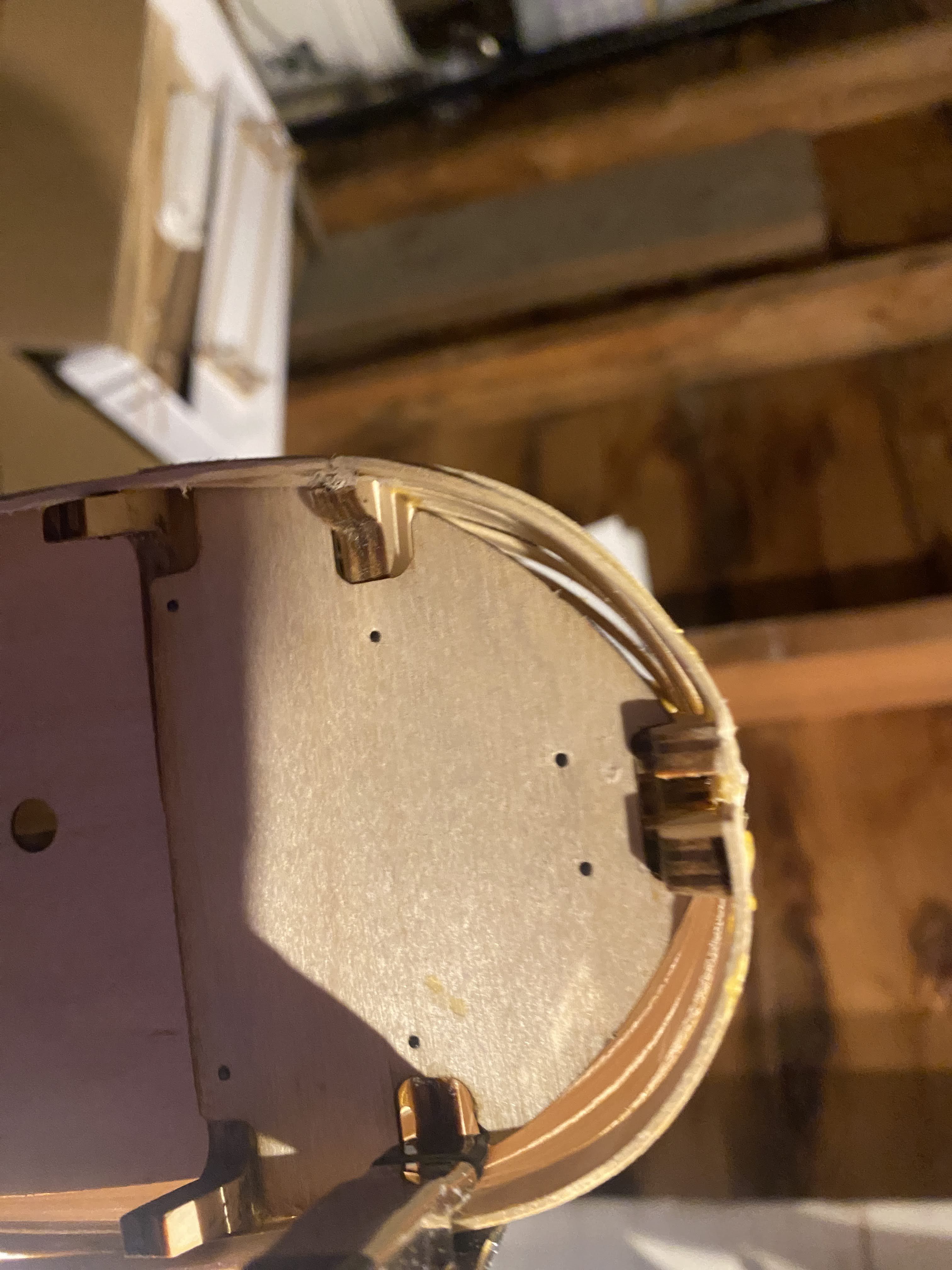

Some notable mistakes in my current build:
  • There's a big gap between the planks and the false deck at the bow. I don't think I'll be able to fix it so I'm planning to fill it when I plank the deck.
  • The planks were curving way to much on the port side by bulkhead #3, so I had to cut 4 of them to stretch them into position. I'll try and fill that gap later and cover it with the second planking.
  • I wasn't soaking my planks long enough at the beginning so I had to drive my pins all the way to secure them. I think this will cause issues when I'm sanding, but we'll see.
Questions for the group:
  • How are things looking? Any major flaws that I'm not seeing that will cause problems later?
  • Can I use wood filler + sanding to overcome a lot of the small gaps, especially at the bow, or should I taper some planks and wedge them in between?
    • Mastini really pushes for some precise tapering to fill all the little gaps but he is being a perfectionist and I think the few pages he wrote on hull planking assume are written for a single planking.
Thanks again for reading my log and any advice you might have.
To be honest, I think you're going to have a hard time getting a satisfactory second planking with the first layer like this. There are a lot of large gaps and general unevenness. Getting a decent second layer requires a smooth first layer. There would be a lot of very tedious filling and sanding required at the moment to get to that point, and it would be quite challenging. The area over the square cutout at bulkhead 3, for instance, will be very hard to plank over without having an incongruous flat spot there.
From the photos, it looks like the bulkheads weren't faired enough, which explains the gaps and probably the space between false deck and planking at the bow. You should be able to run a batten (a thin strip of flexible wood) over the bulkheads, at every point in the hull, such that it touches all of them evenly without bulges or spaces. Especially near the bow and stern, this usually means substantially beveling the bulkheads and taking off a surprising amount of material--usually there should only be a thin line of laser char left. There's an example of this in post #21 in my NRG Half-Hull build (and you can see the long slow process of fairing in the posts before that one):
All of which is to say, I think you'll have a much easier time down the line if you remove this planking, fair the bulkheads more, and redo it. Following Mastini's advice to taper the planks is also a good one. Planking a hull is one of the hardest parts of ship modeling, so I wouldn't feel discouraged, but I think it's worth it to try to get it right to avoid frustrations down the line.

Thanks again @JacquesCousteau for the comment on fairing. I can't believe I skipped that step entirely.
I spent the weekend creating a bow filler and it's make a huge difference. I have 6 planks, 3 on each side, pinned on right now to help me along with fairing and I'm still smoothing out a few bumps but I'm feeling so much more confident about the first planking.
I will post a proper update with photos of my progress once the fairing is done but just wanted to jump in and say thanks again for the help & advice.

First planking is all about getting a solid and smooth foundation to the hull. It will be hidden so you have an opportunity to PRACTICE and develop your skills at planking.  Your planking still needs a lot of work...  AND THAT OK!  Reading the methods and practicing them are keys.
My suggestion:  Wood model is a labor of love. You need to be gentle, accurate and rigorous in your approach. RULE NO 1:  If you have to force it, you are using the wrong approach.  Something is not right, and you will have difficulties.  I think you try to force the planks in place here.  This is your first mistake. There are methods to deal with this.

Thank you Loracs for the suggestions! I actually had a plank bending iron on hand for this but found that I wasn't soaking the wood nearly long enough. For some reason I thought 5-10 minutes would be good enough but after letting them sit for 1-2 hours I found it made all the difference.

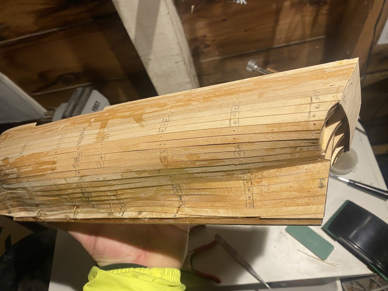

I was finally able to finish the first half of gluing the first planking. It's still quite rough but I feel like I've learned a lot from my first pass. There are still some gaps and bumps but I'm going to accept that and try to improve the second half. The main thing was adding bow fillers. It was a lot of work sanding them down into shape but it made a huge difference. I'm wondering if it's worth adding fillers for every bulkhead...
There's also a glaring mistake on the plank at the bottom that is very clearly overlapping. I don't have a good excuse for that...
Edited by Claudius_Rex

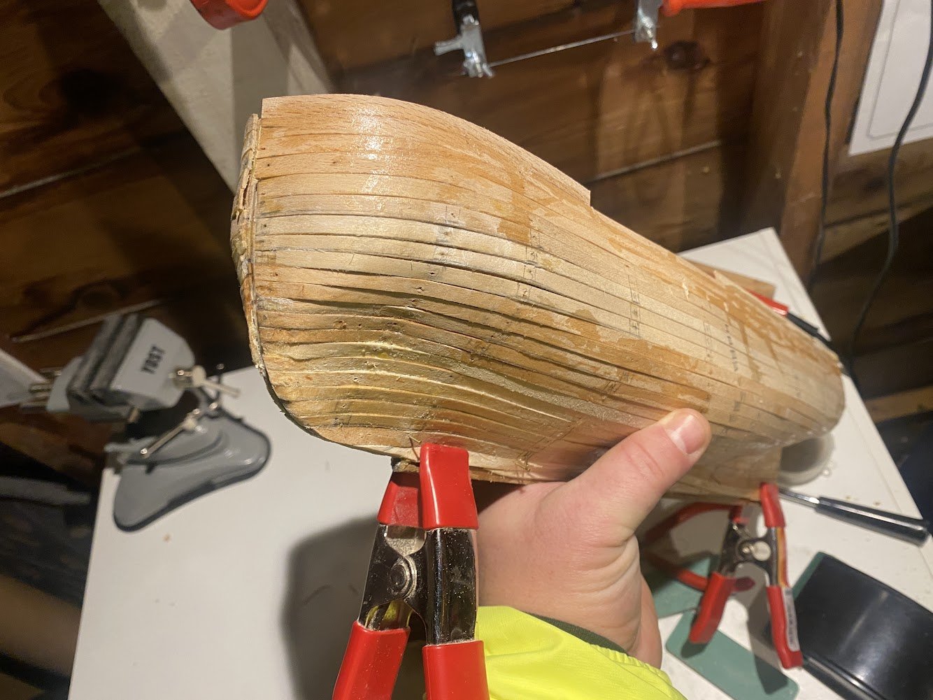

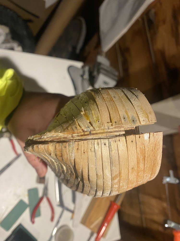

I finally go through the rest of the planking. For the second half I used my planking fan to sand down the planks at the bow section. I'm much happier with this section but realized after-the-fact that I hadn't properly sanded down my bow filler so the planks 12-15 were warping at the end bow portions.
Some difficulties I ran into that I could use advice on:
  • How do I get the curved planks to be flush with each other? As I'm going down the bulkhead? My solution was to be generous with super glue and hold them in place. It seemed to be a workable solution but I ended up using a lot of glue. You can see it in the photos with how shiny it all looks. I'm not sure how that will impact the sanding that comes next.
  • Using the planking fan correctly. I created strips of paper for each bulkhead and marked on that paper where each plank would be, and used those markings to transfer on to each bulkhead. But what I found was that mid-way through the markings it was beginning to look a bit off my 1mm or so and I think it was because of the thickness of the lines from my pencil. Any advice on how to get super precise here? Mechanical pencil? Use my exacto knife instead?
  • Advice on sanding. I'll be starting the sanding tonight and worried about sanding through these planks as they're quite thin.
Congratulations on finishing your first first planking! If those are 1/16-inch planks, I wouldn't be too concerned about sanding through them. You may want to put some wood filler over the low parts first, though--just a thin layer, you can always add more later but it's a pain to sand through if there's too much.

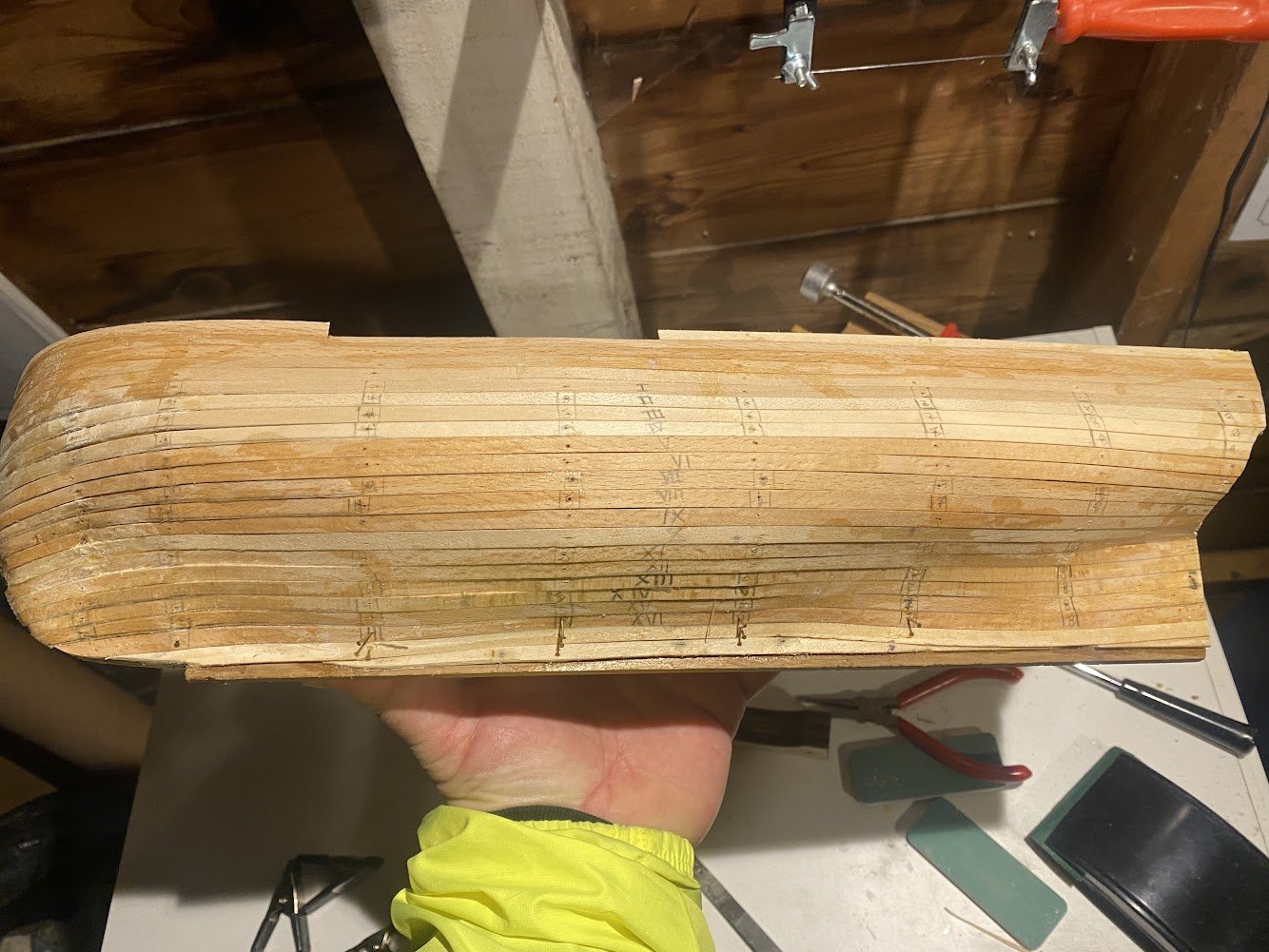

Following Frank Mastini's advice, I coated the hull using modeling paste and sanded it down. I ended up using a little bit too much paste so the layer was thick and required a lot of sanding. But it created a very nice and smooth layer for my second planking. I used a copper wire sponge to score the surface so that the glue would adhere nicely to it and started my second planking. I'm really happy with the progress here.
I also bought some Titebond Quick Set glue which is more viscous and dries quicker and I love it. Following Mastini again, I'm supergluing a plank at the stern to hold it in place, then brushing on wood glue a few inches at a time and using the plank bender to heat it up so the glue dries faster. I've gotten about 1/2 of on side done so far and very pleased with the results. I'll follow up when the second planking is done.
