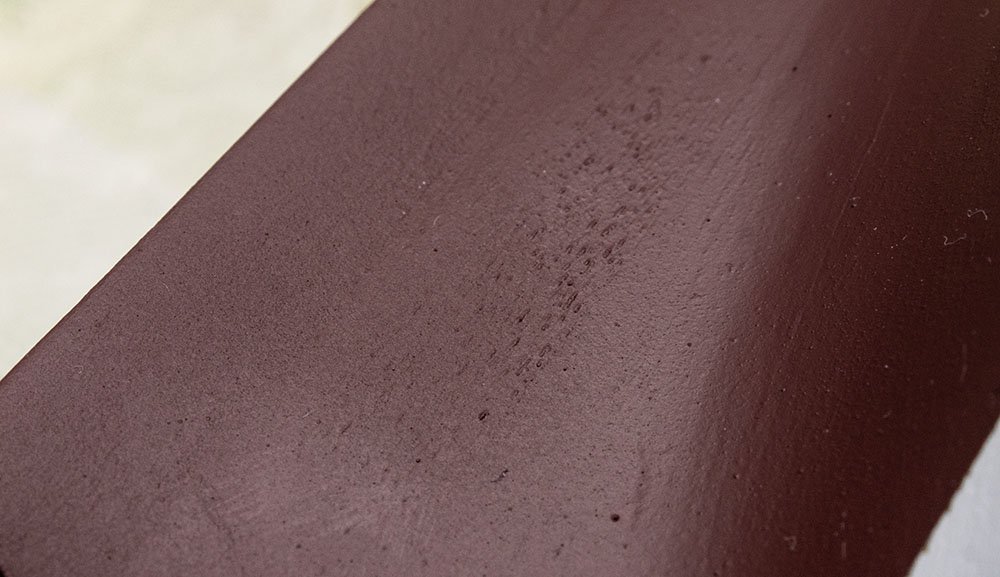

As Acrylic water based paints raise the grain on wood I am looking for recommendations to seal wood prior to painting with Acrylic paint.
I do raise the grain with water at least twice with water followed by light sanding but the initial painted surface still is not very smooth. I tried sealing with Shellac one time but the paint apparently used Alcohol as a solvent as does Shellac and I ended up with a mess of sludge. Any and all suggestions appreciated!
