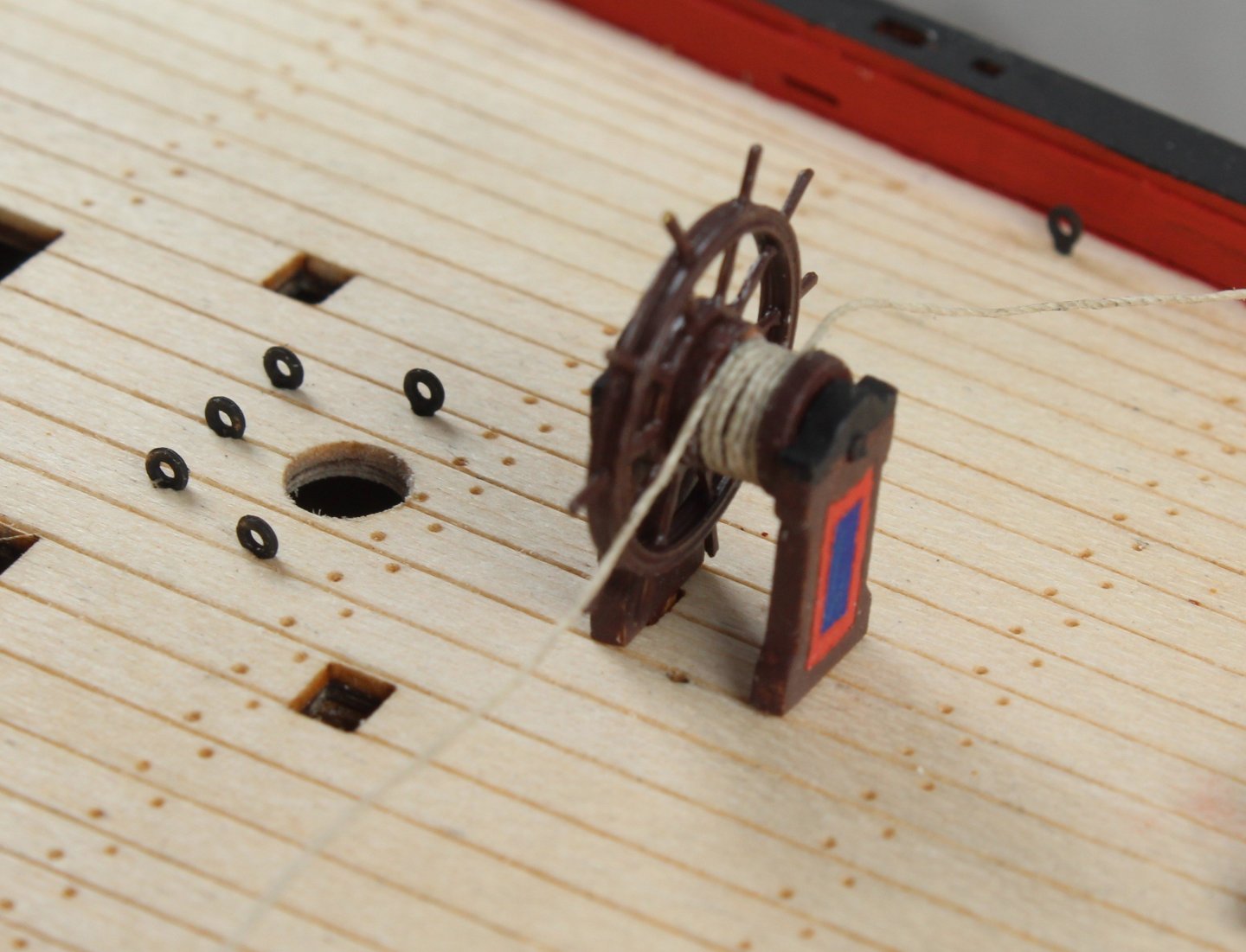

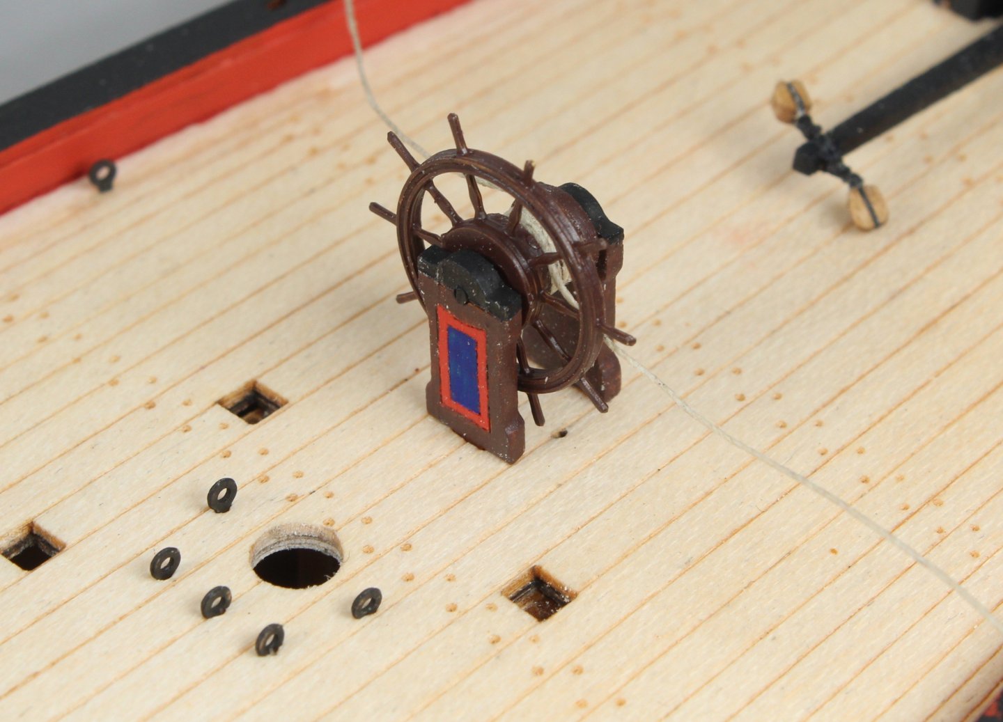

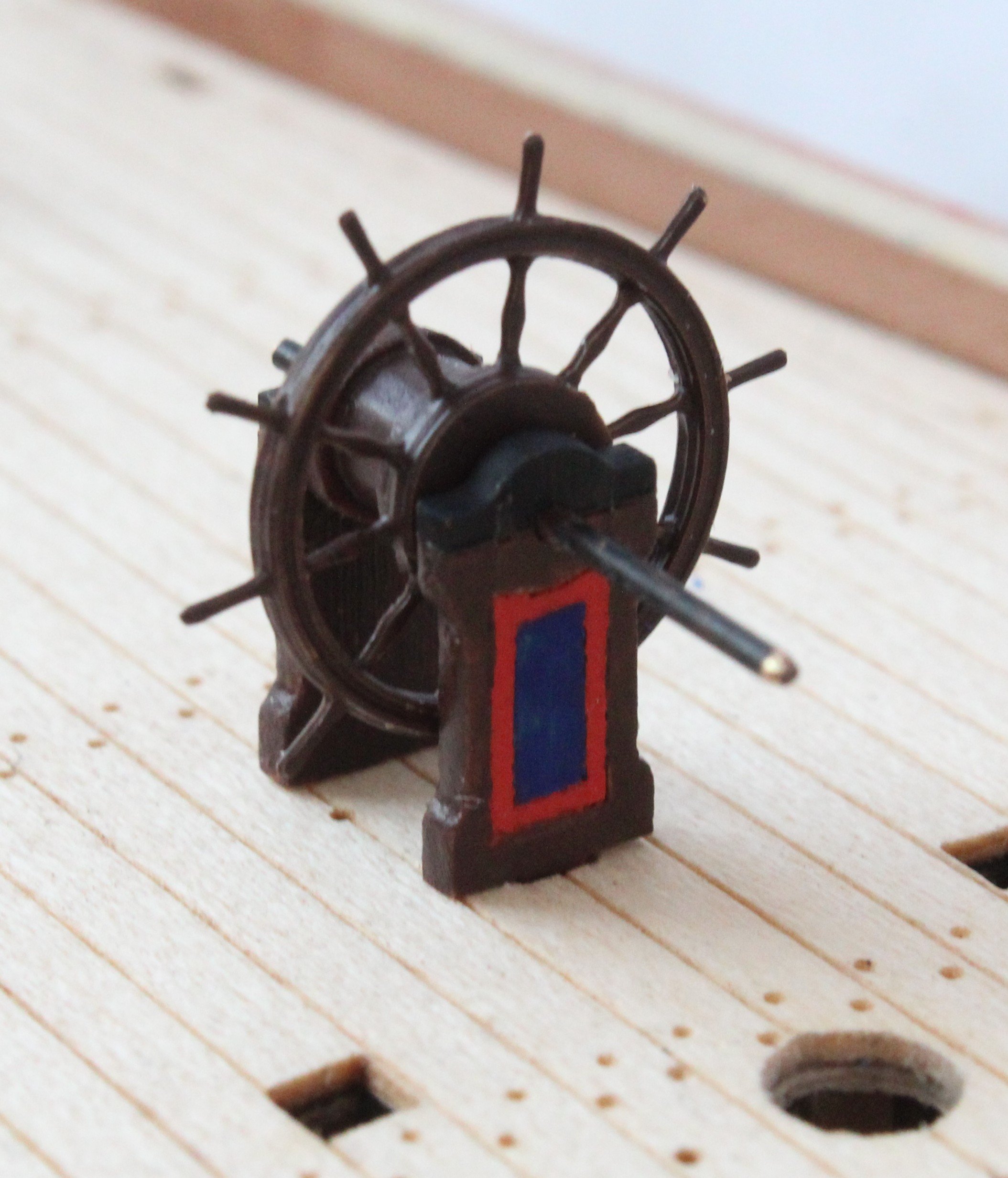

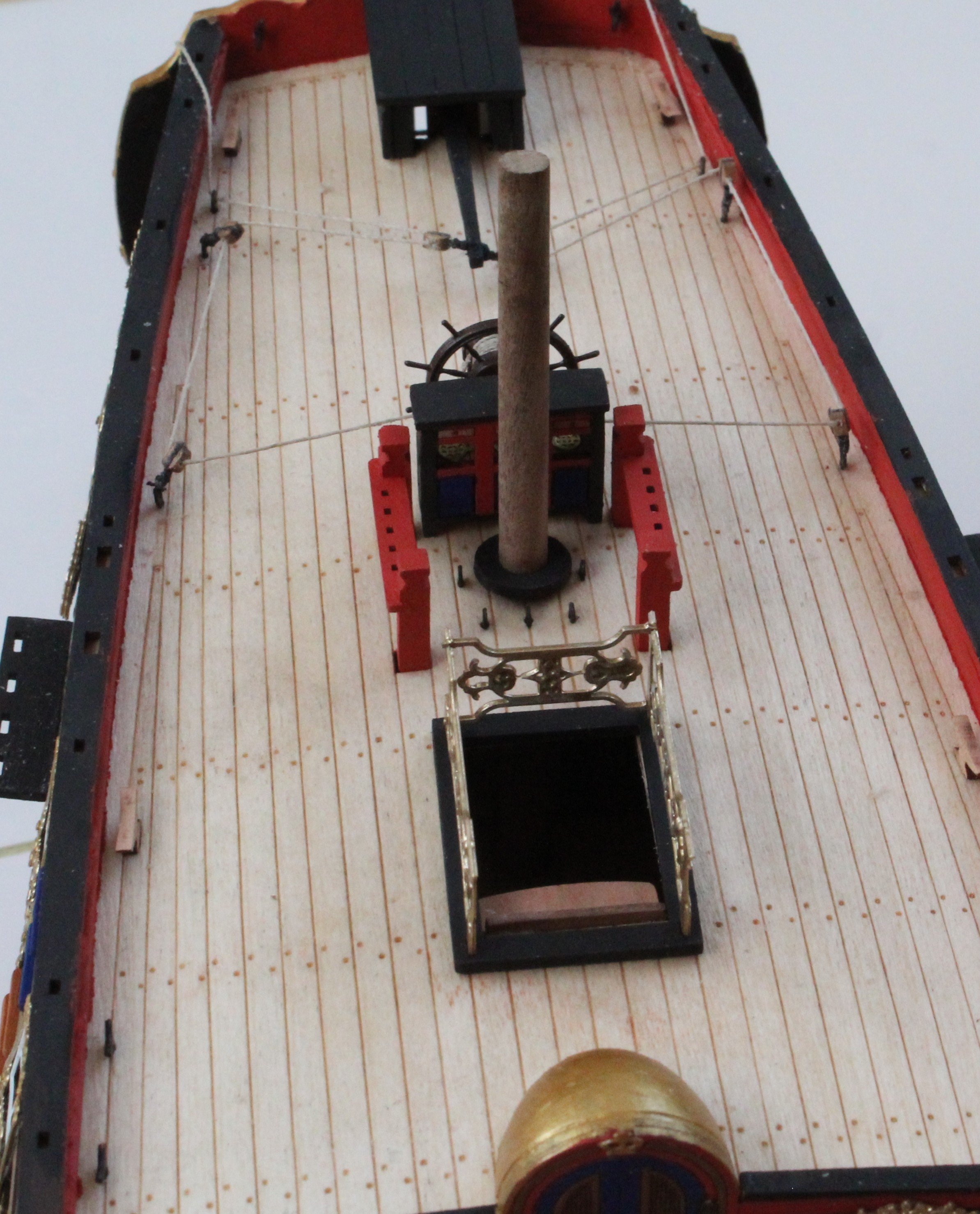

Task 46 – Ships Wheel
My time in the shipyard is very limited this week therefore I am tackling some small tasks such as the ships wheel assembly.

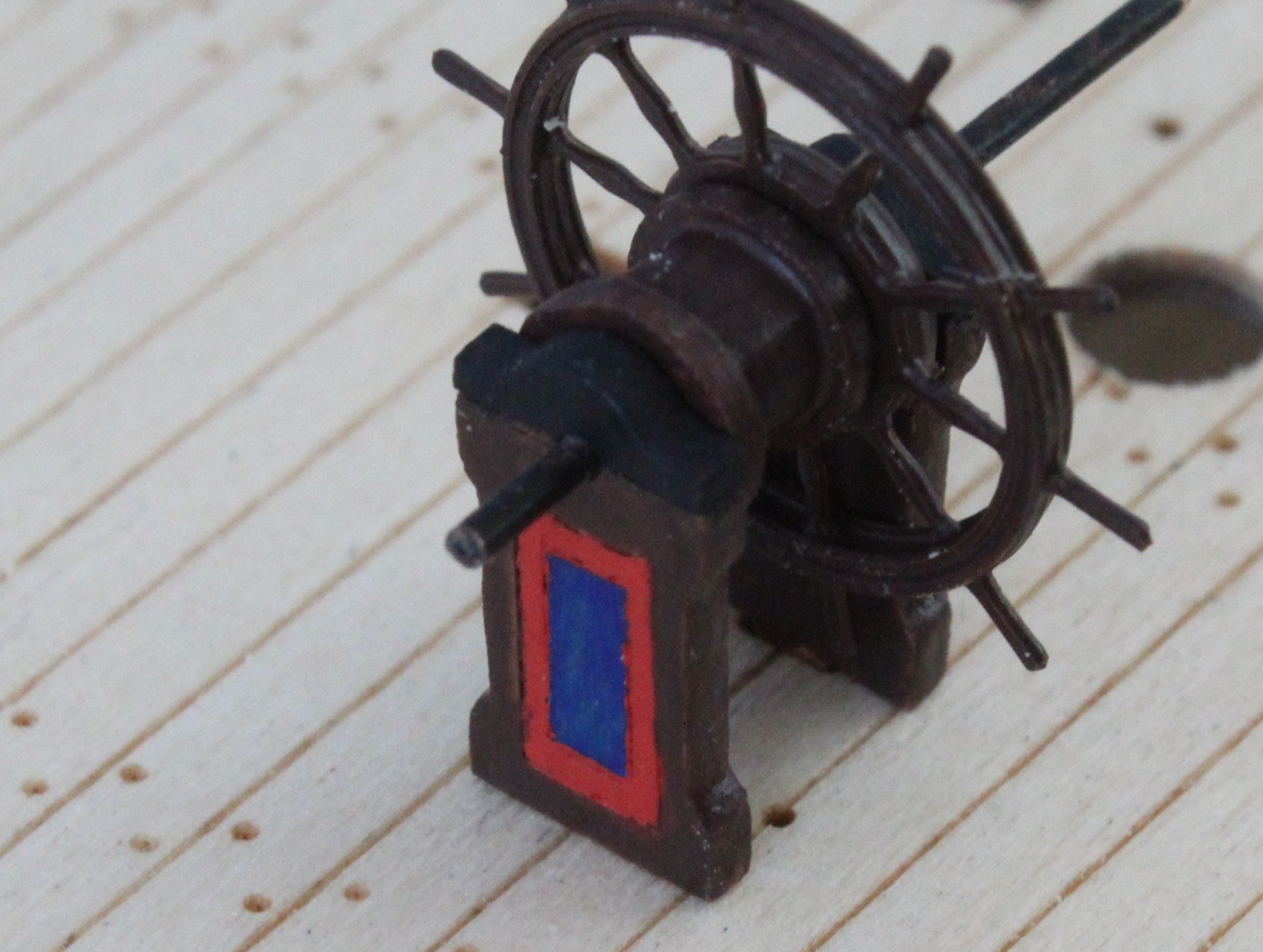

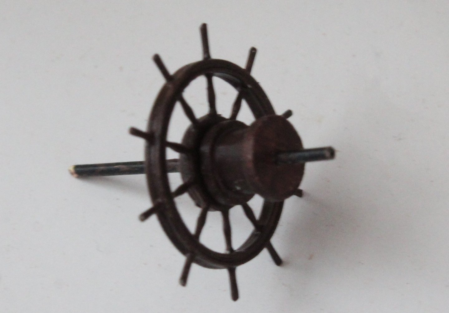

The ships wheel is made up from 5 PE parts which were glued together, using a 1mm rod to ensure everything was aligned.
Next the cable drum assembly, comprising three wooden parts were glued together, once again using a 1mm rod to ensure everything was aligned.
I then painted the drum and ship wheel a dark walnut colour, as can be seen below.

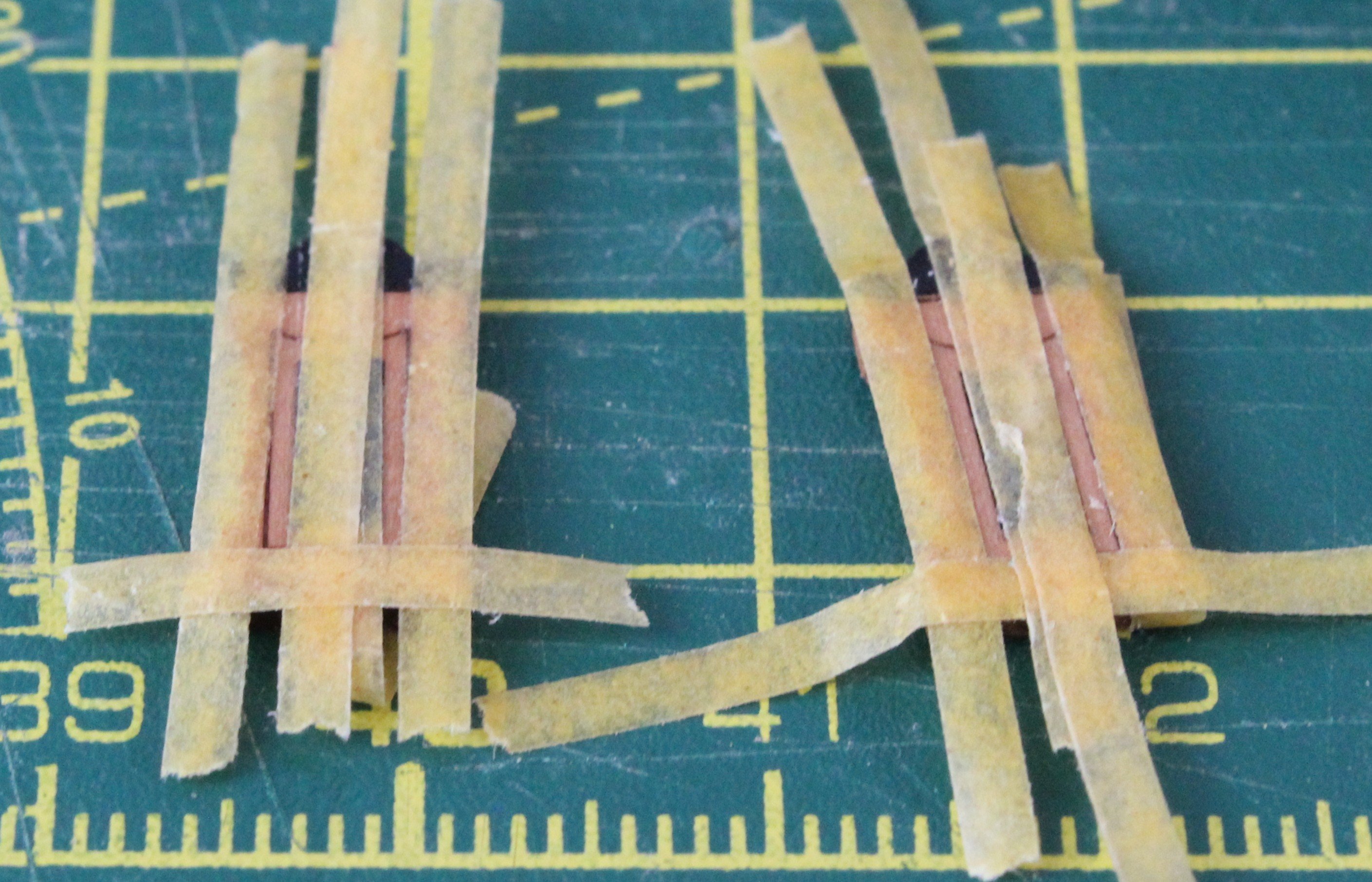

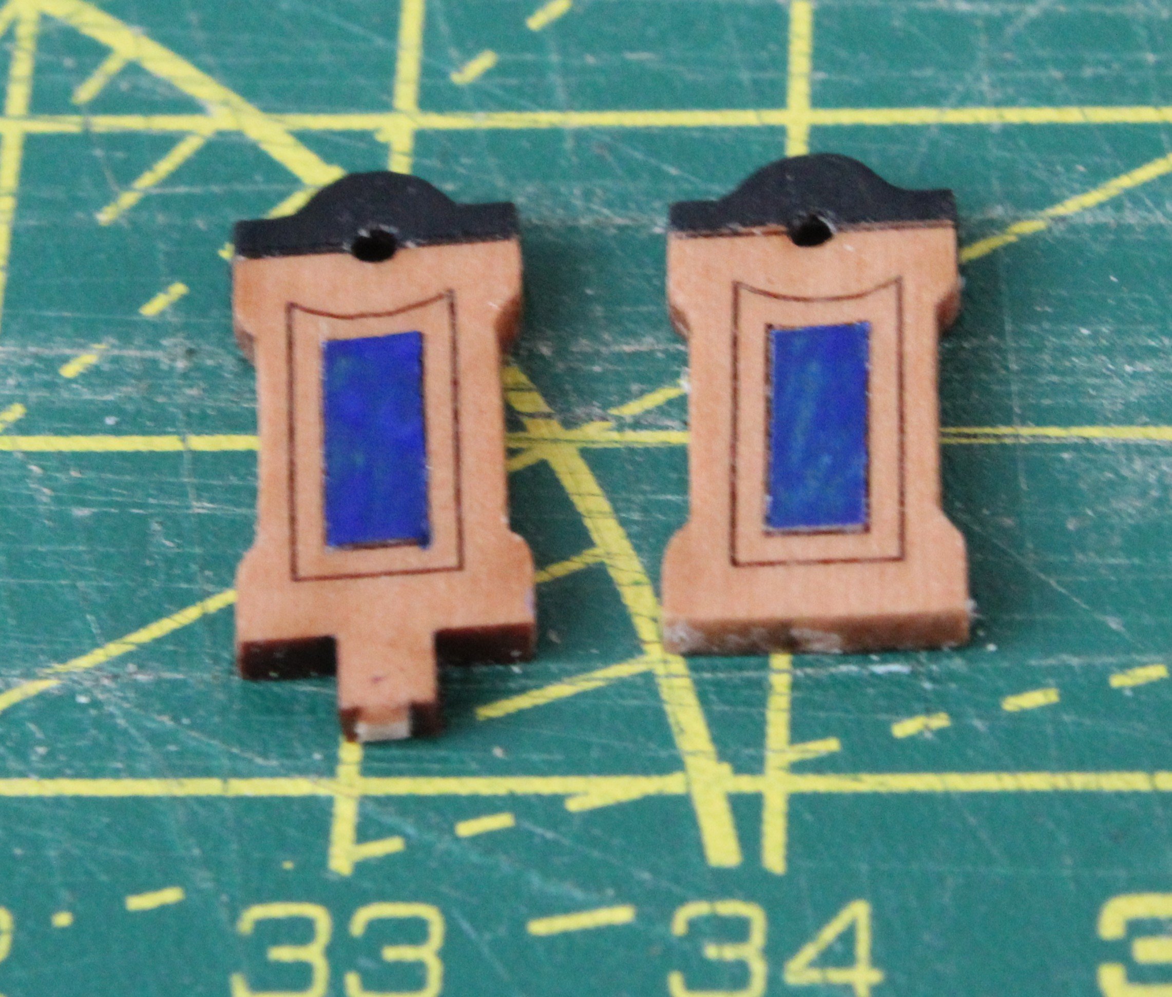

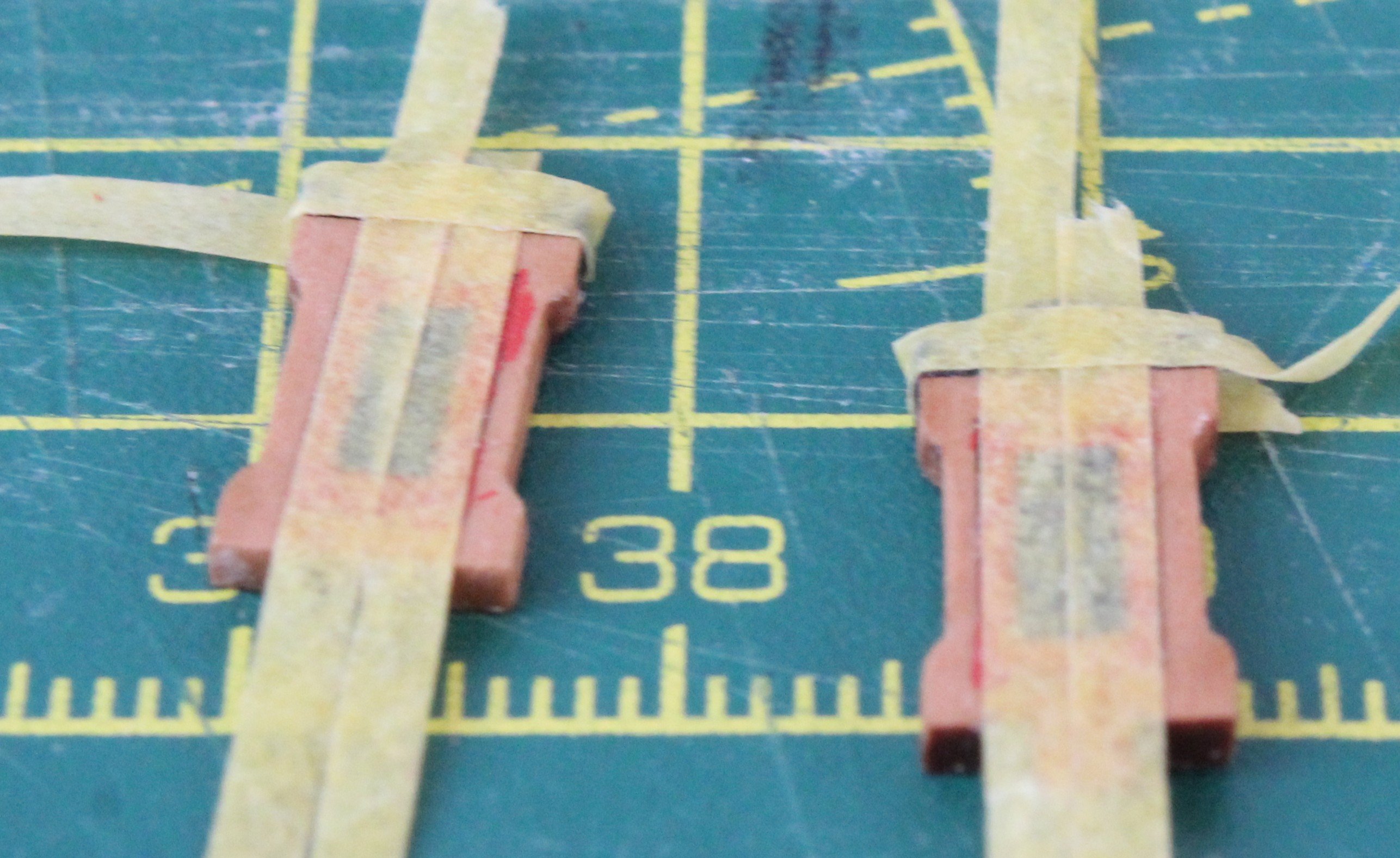

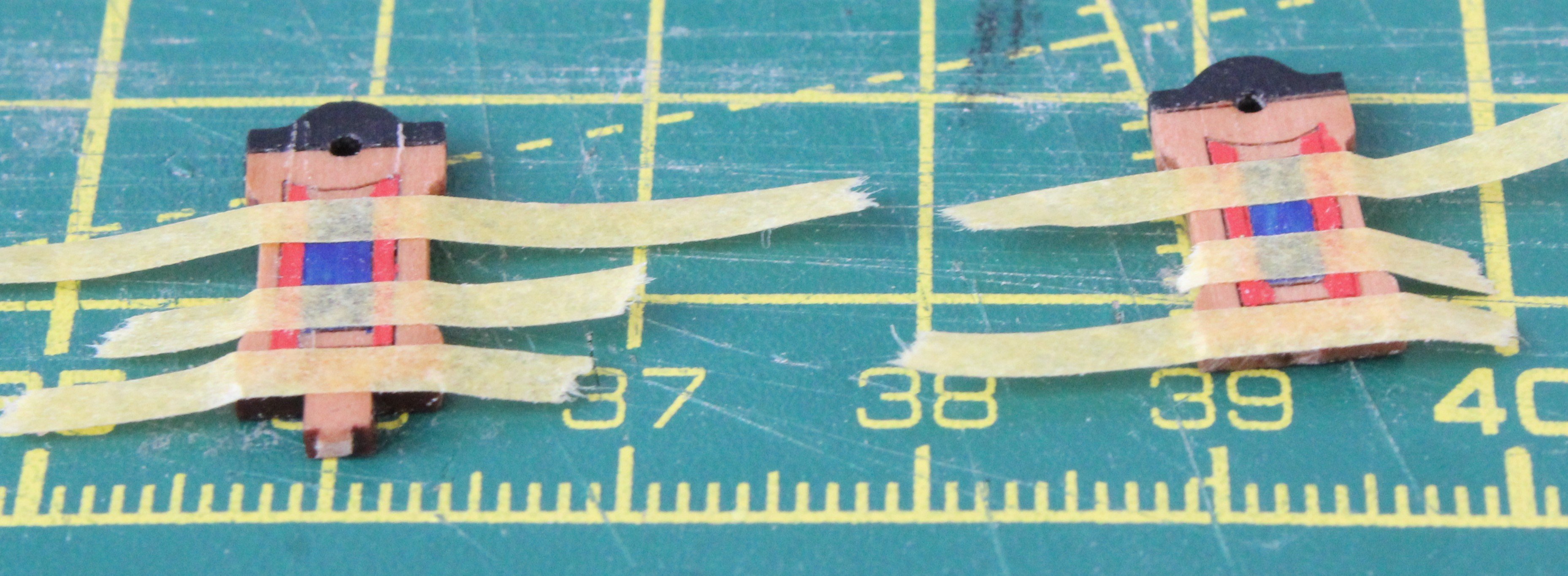

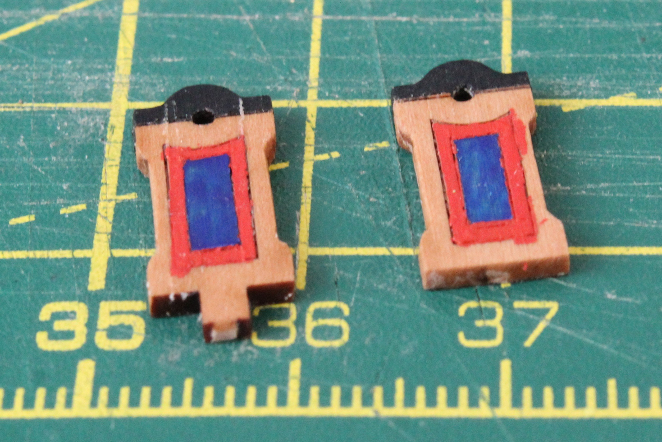

The two end panels have nice some laser-etch lines and I decided, as this is a royal yacht, to embellish these with some paint.
In the photo below I have taped the two panels so the centre section can be painted royal blue and the second photo shows the end result, noting I had already added black paint the top section.
002.thumb.JPG.8d52c2a58f88f45054cb09b48e3b7e63.JPG003.thumb.JPG.f30af134582603038b263e2d447bd423.JPG

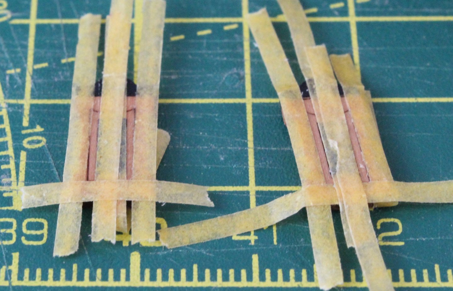

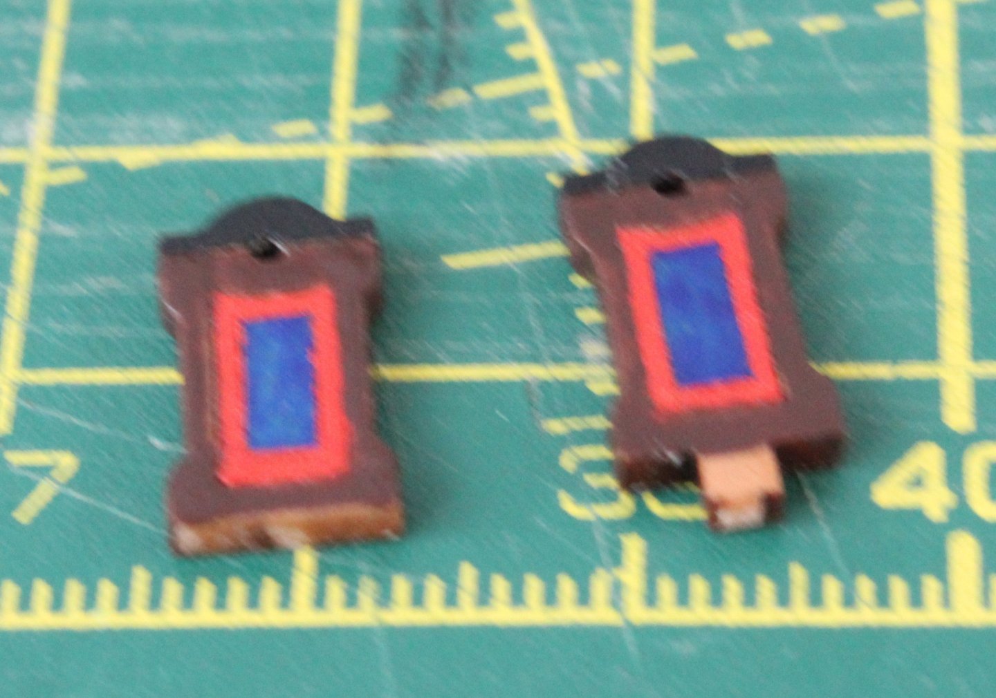

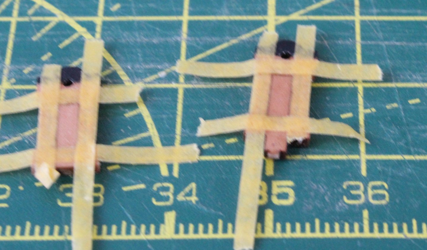

In the next set of photos more tape is used so I could add a red outline to the blue insert.
004.thumb.JPG.19cbb12433d1af379c6fa3fda59c6202.JPG005.thumb.JPG.fe56edb7abefe493ca0b2a78f52531f7.JPG006.thumb.JPG.2e2508c63cebe738ad83a3726961a22d.JPG
More tape was then added so the external edges of the panels could be painted dark walnut.
007.thumb.JPG.015a68bb4cde21b15bde69f6bee86f06.JPG008.thumb.JPG.701c7add27551837c804578587c20e33.JPG

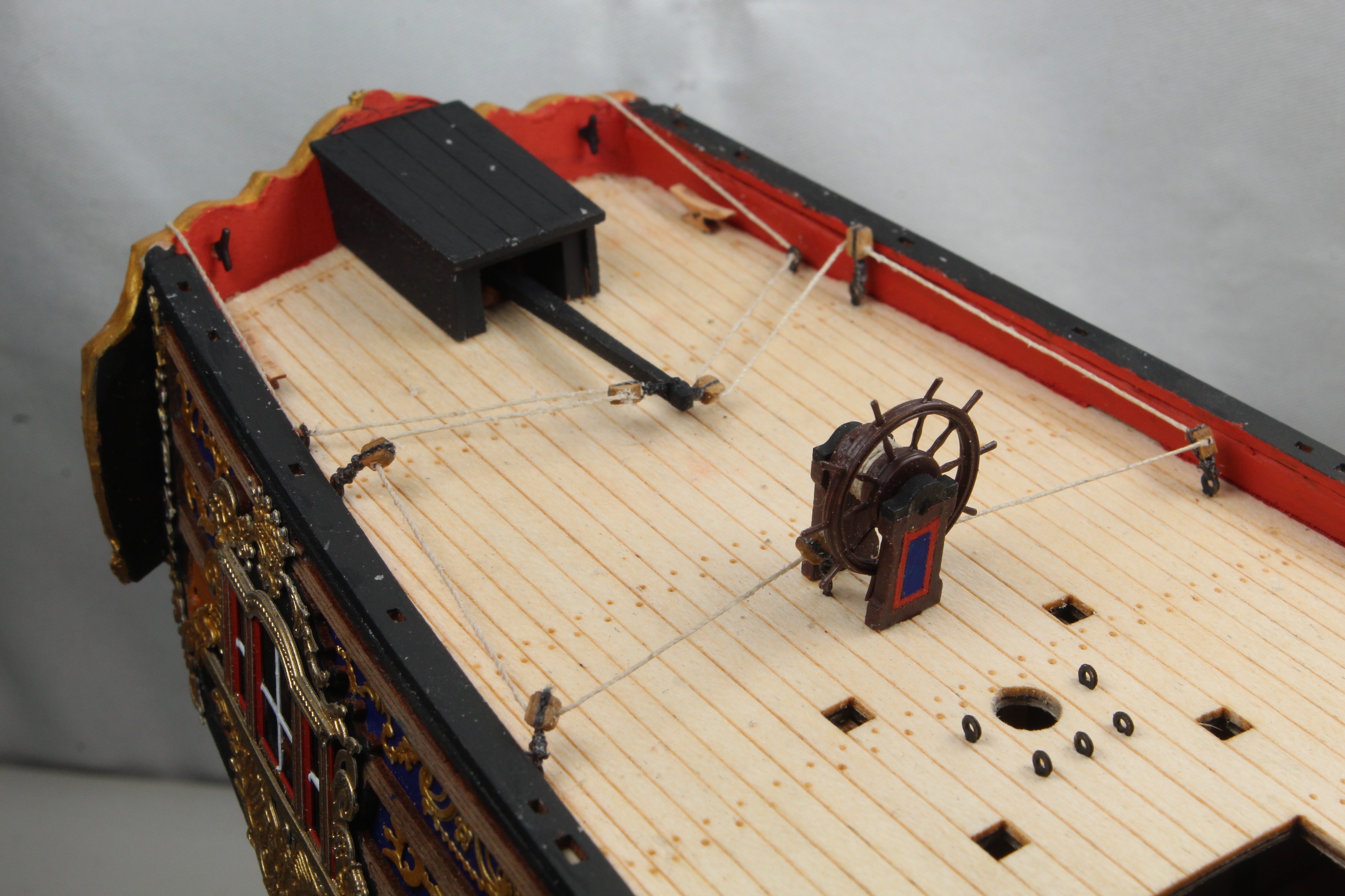

Test fit of the ship wheel assembly, noting the ship wheel assembly has not been glued together

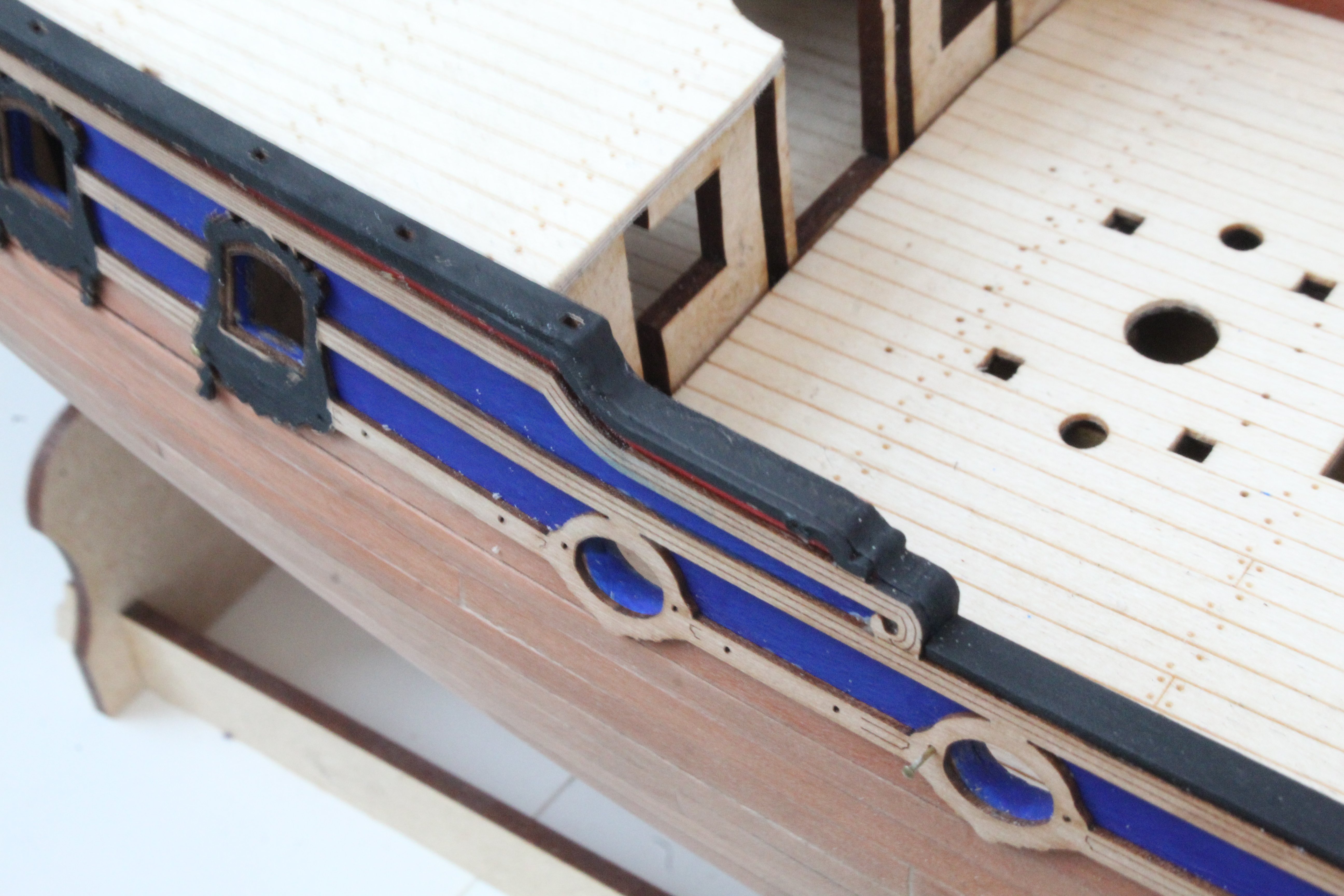

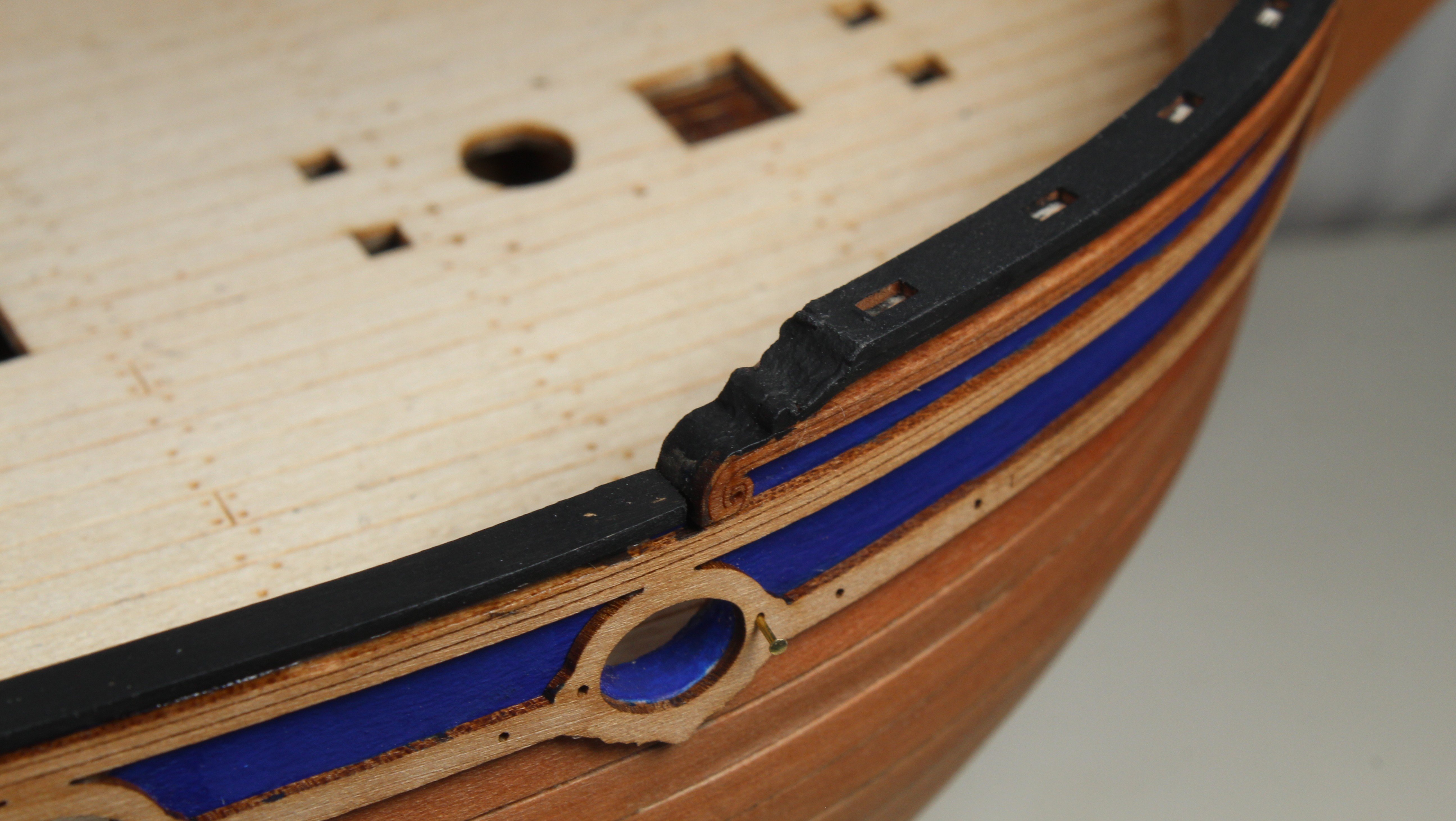

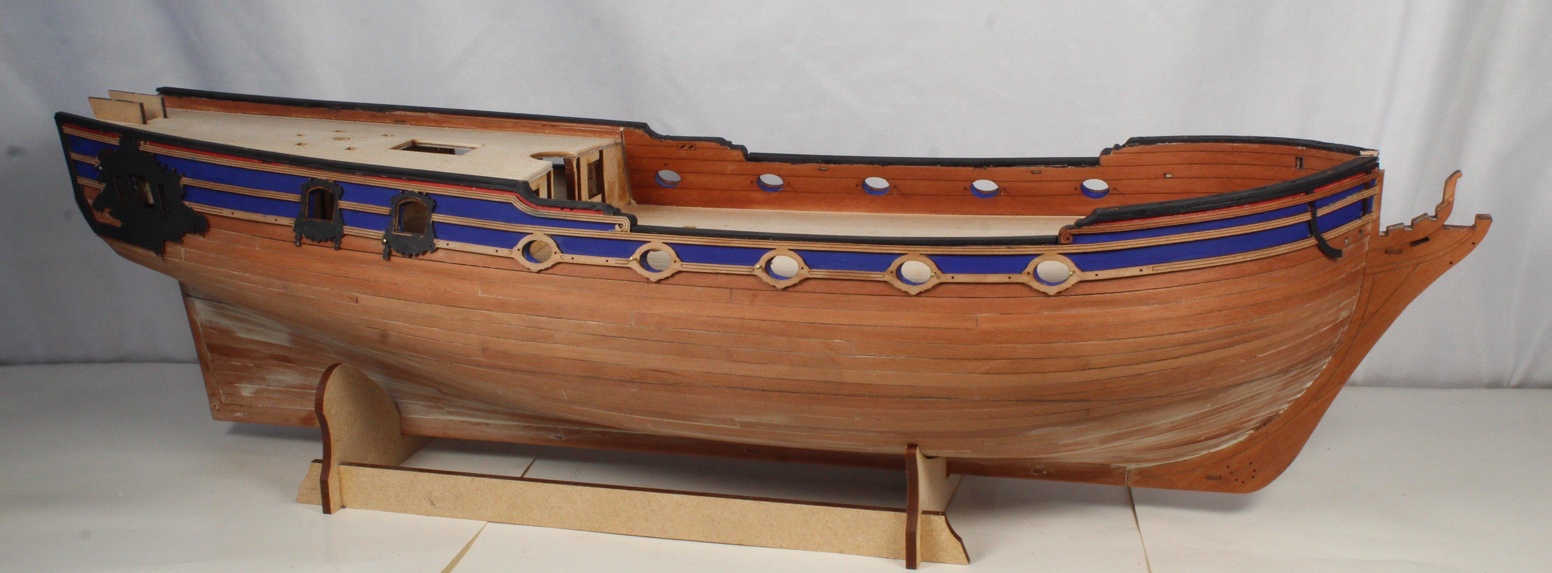

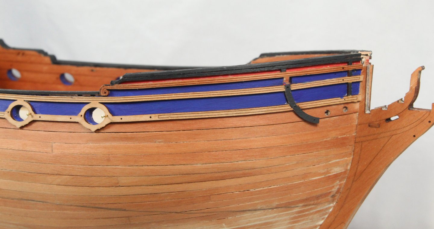

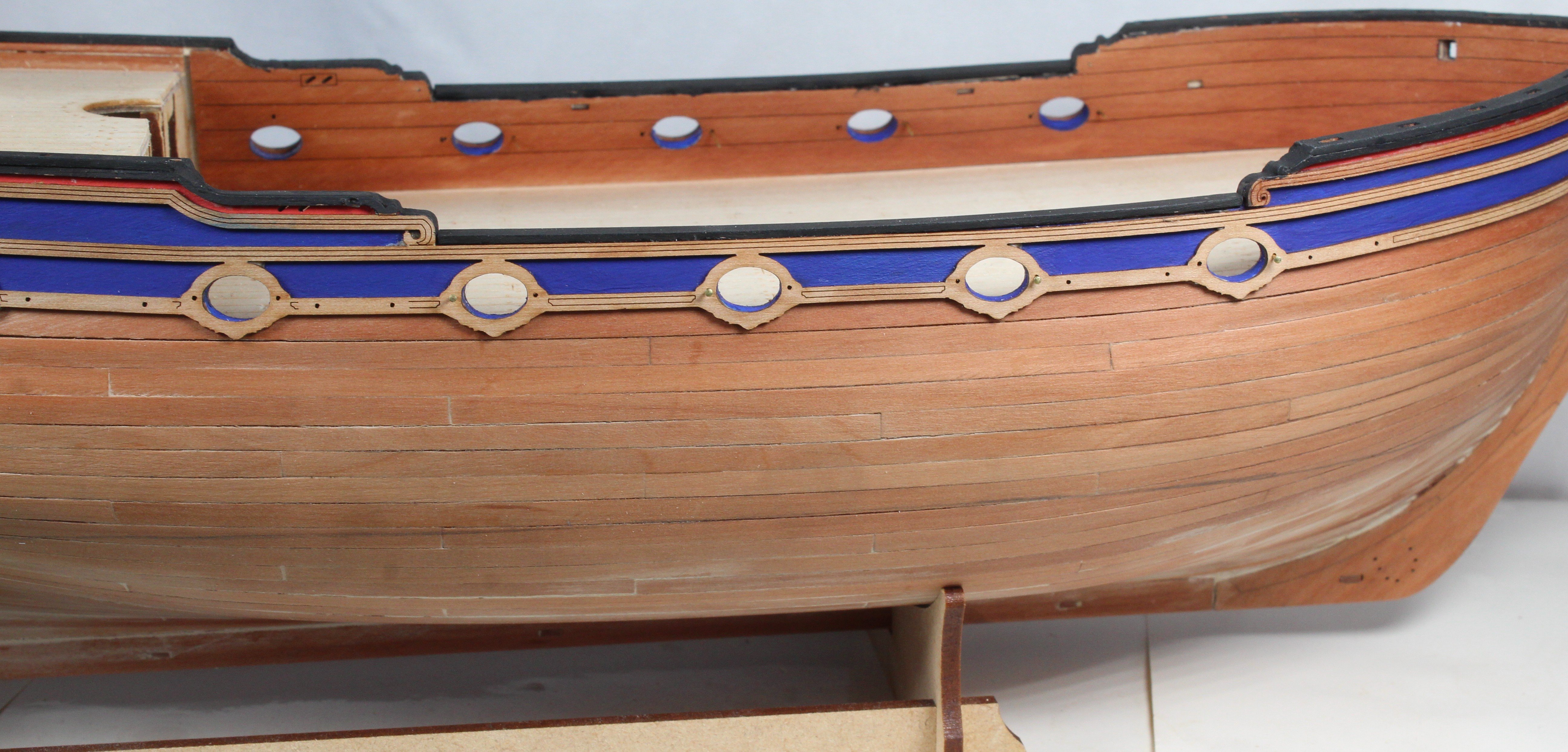

Task 48 – Main Rails and Gunwales
Adding the main rails has been a bit of nightmare as I made a schoolboy error by applying a coat of tung oil to the hull. This meant that when I was ready to add the main rails it was difficult to get the to hold, once dried. The rails are now in place and hopefully they will now stay in place.

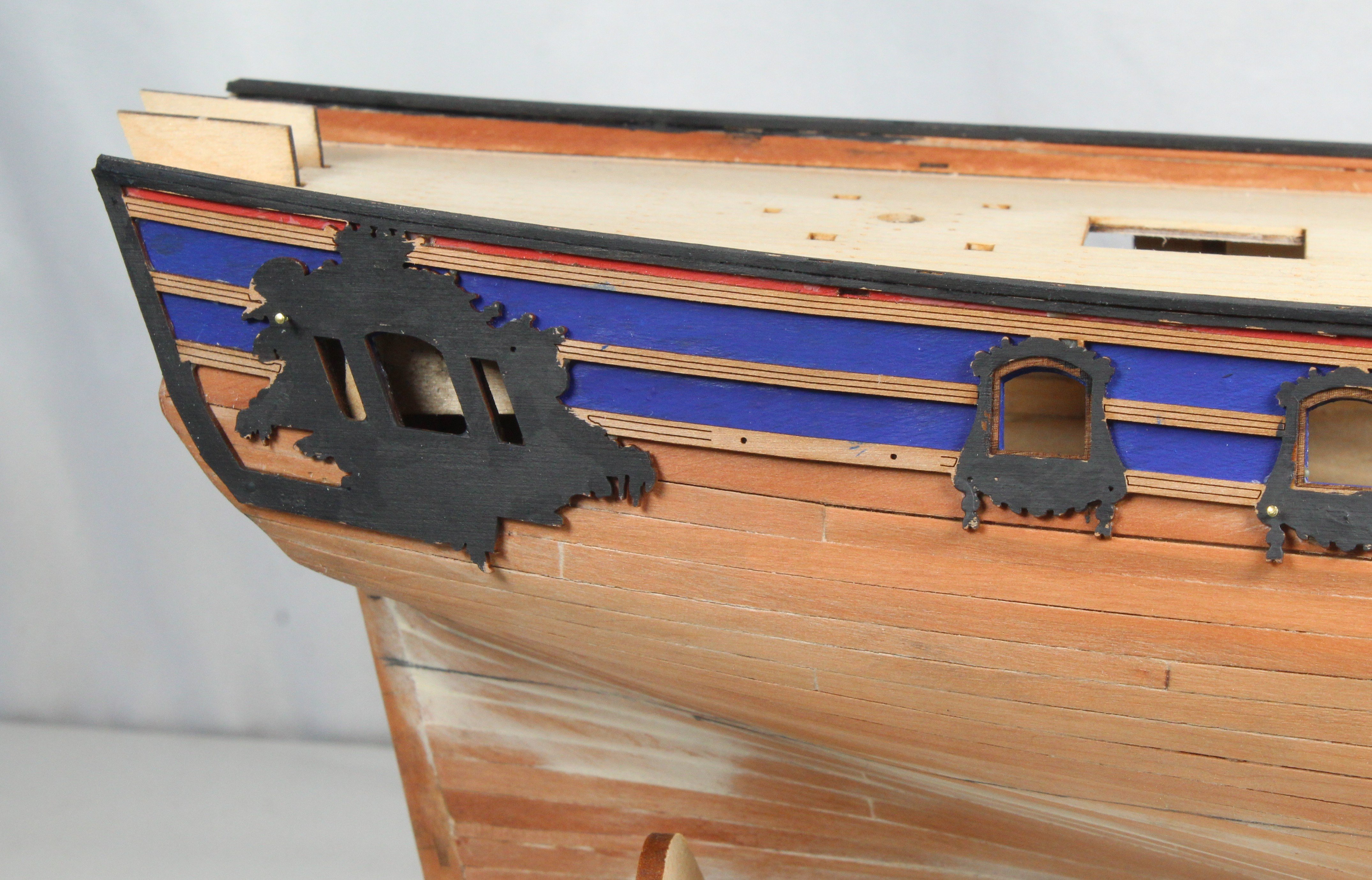

Next the gunwales were added. They were painted black before they were fitted. Once fitted I decided to paint the upper bow and stern rail black.
 Photos
Current status of the build
Bow area main rails
Midships main rail
Stern area
Gunwales

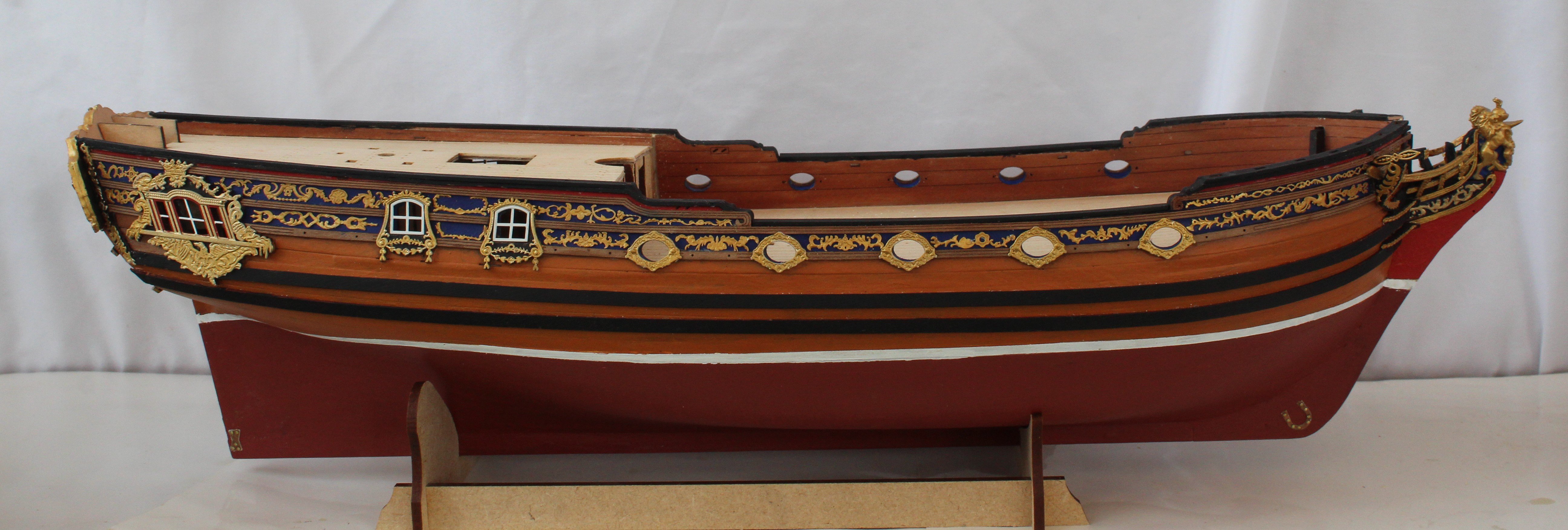

Build Log – Post 29 (17th - 18th Dec 2025)
Task 49 – Painting the Hull
I went off the reservation with this task *** the build instructions are to leave it a plain wood finish above the water line and a painted white hull below the waterline. This is exactly what I did with my previous DOK build and it does look great.
However, on this build I decided to experiment with a different paint finish. I really like the Plasti-kote Red Oxide finish I have used on some previous build. I also liked having a thin white band for the waterline.
With the waterline drawn I added some masking tape above and below the waterline and added a white band. After a couple of coats of white paint, the tape was removed. A new thin strip of tape was then placed oved the painted waterline. I then added three coats of red oxide paint below the water line. I opted to decant the paint from the spray can and apply with a paint brush. I also added a different paint finish above the water line (leather).
The finished paint scheme is shown below. Whilst it may not be in keeping with how ships of this period looked I quite the colour scheme, noting it may not be to everyone’s taste. This paint scheme is probably more common for fishing boats.

Task 51 – Test Fitting Hull PE Patterns
The main cabin decorative window comprises two PE parts. I had previously sprayed these parts with gold paint. The lower PE part window frame area then needed a red outline and window frames painted white.
Using the pin holes to correctly align these two parts (not glued for the time being) a test fit was undertaken. I was happy with how this looks.
I then glued the 4 off window frame PE parts to the side windows and test fitted the window surround patterns. Again, everything looks good. I will need to fill the gaps in the planking

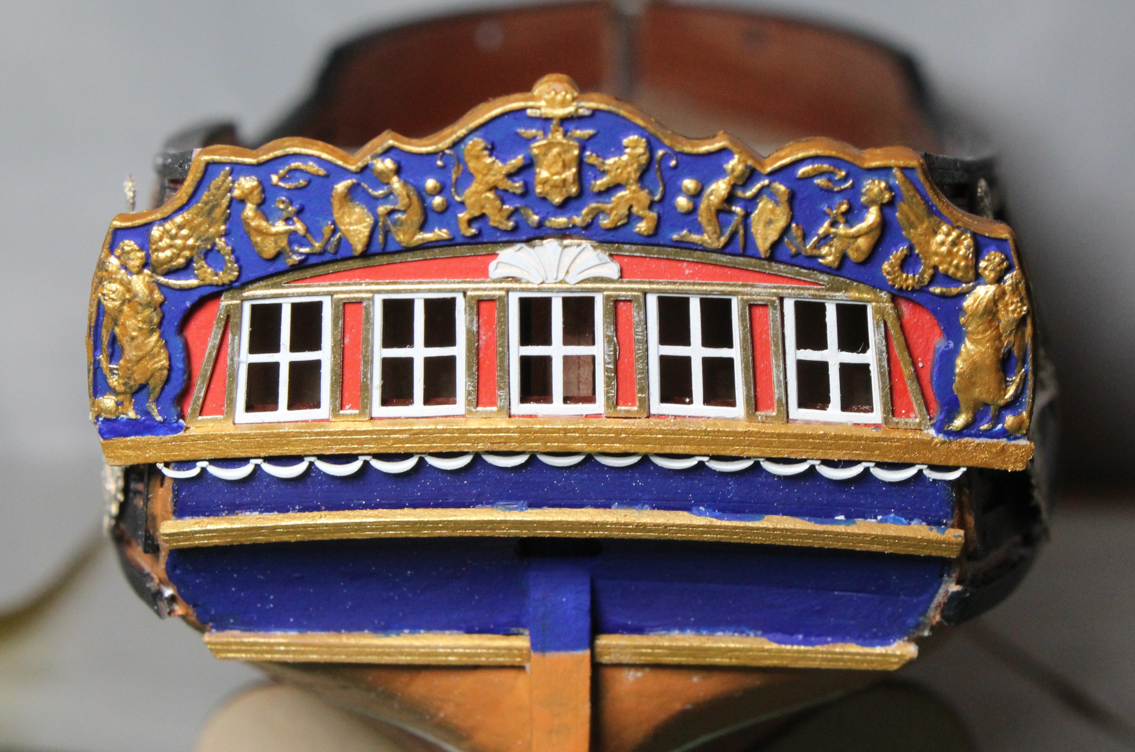

Over the last few days I have been adding the various items to the upper stern counter.
The first task was to add the white painted window frames. Next the window surround PE part was added. This had been painted gold with a white crest.
The next item to fit was the 3D printed surround. The part was soaked in hot water for 15 seconds and then clamped to the stern counter for 1 minute so the bend could be added. The bent part was then dropped in cold water to cool off. The part was then painted imperial blue. Once the paint had dried the various raised shaped were painted gold. Once I was happy with the painted part it was added to the upper stern counter.
Next I added the various rails, which had been painted gold.
Finally, the final PE pattern, which had been painted white was glued beneath the upper rail.
As can be seen in the photo below a little bit of paint touch up work is still required.

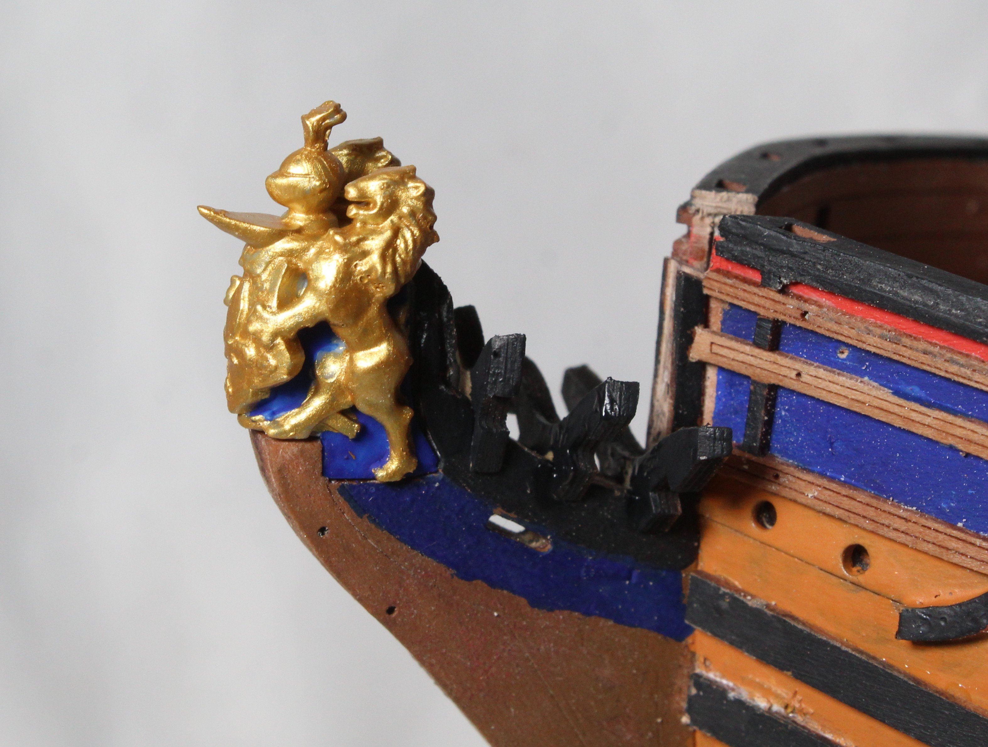

Task 52 – Figurehead
The figurehead has now been painted and test fitted.

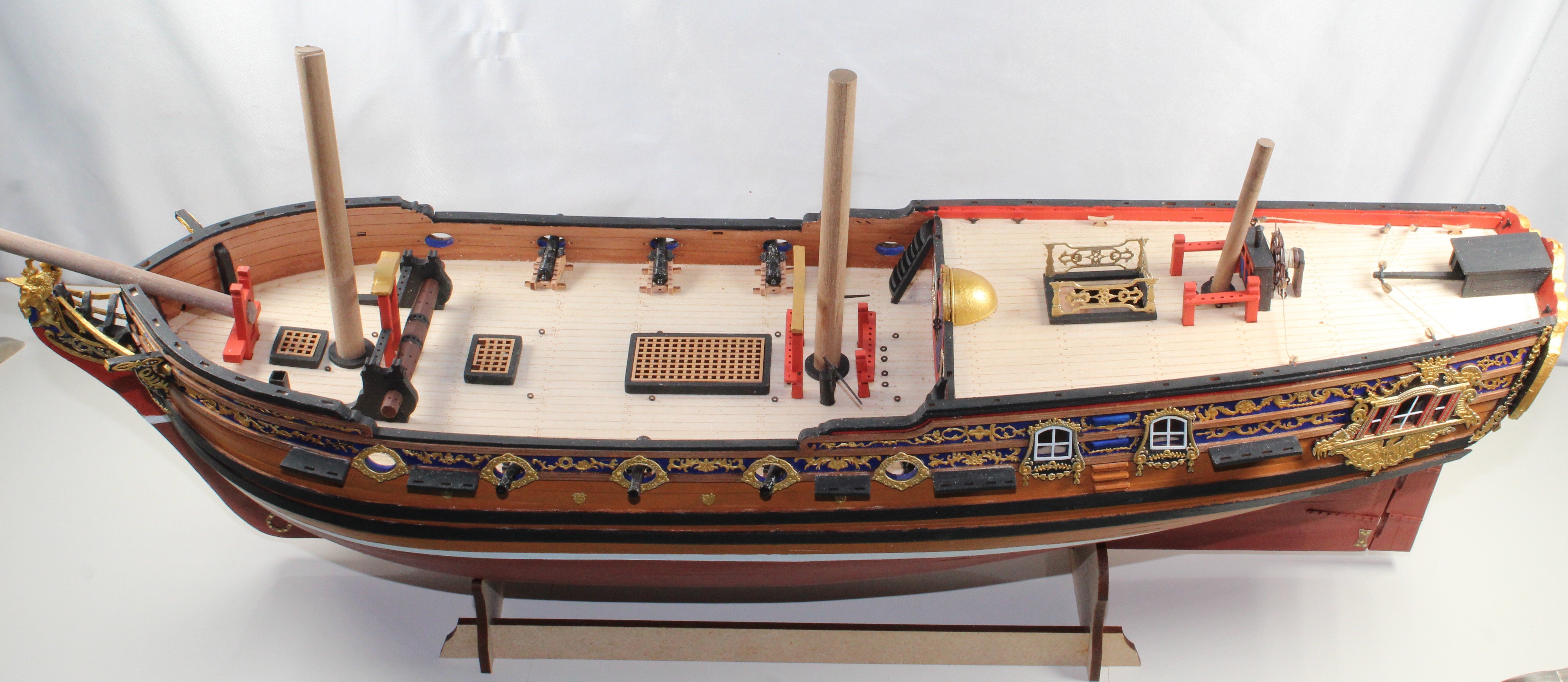

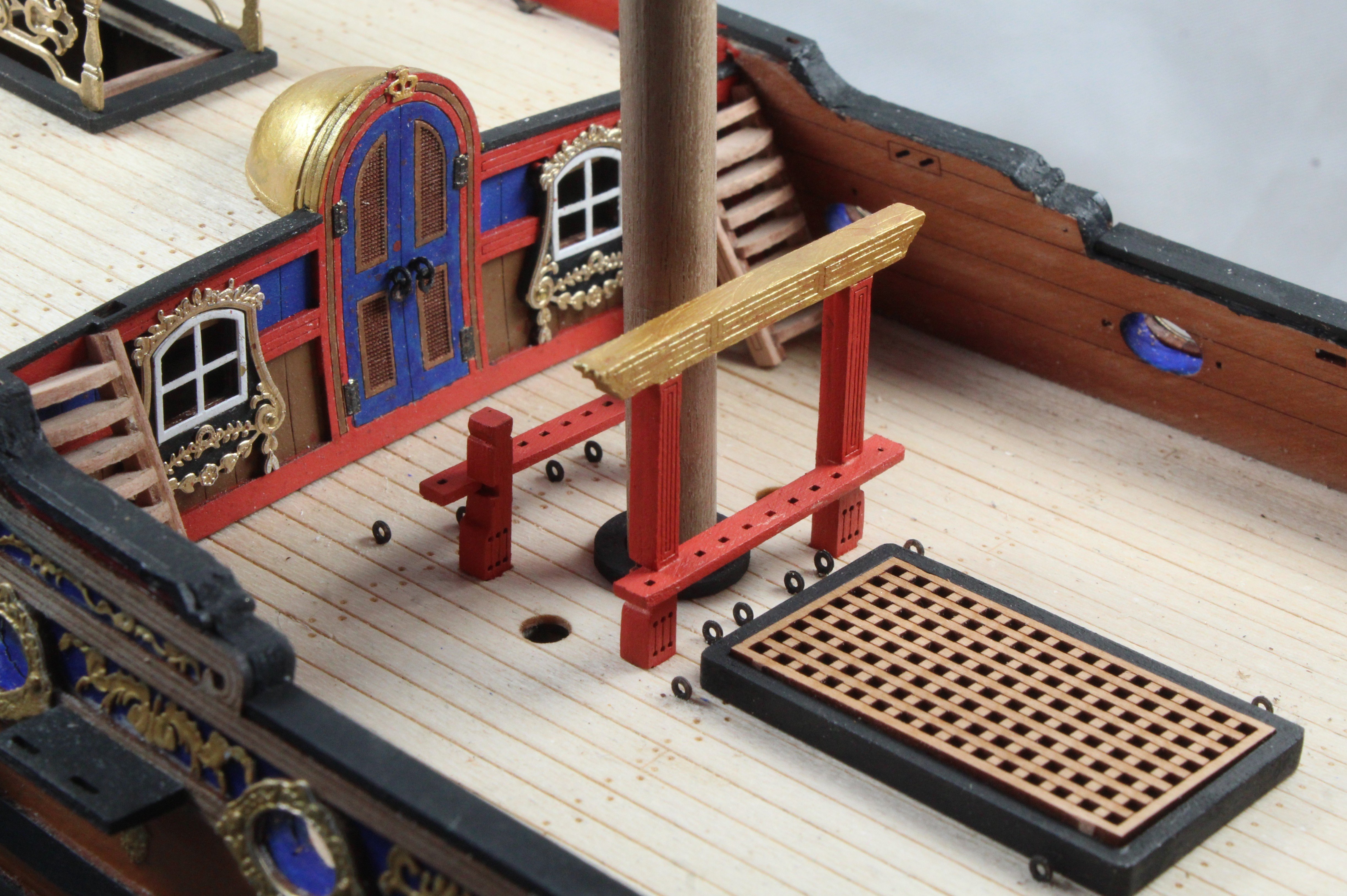

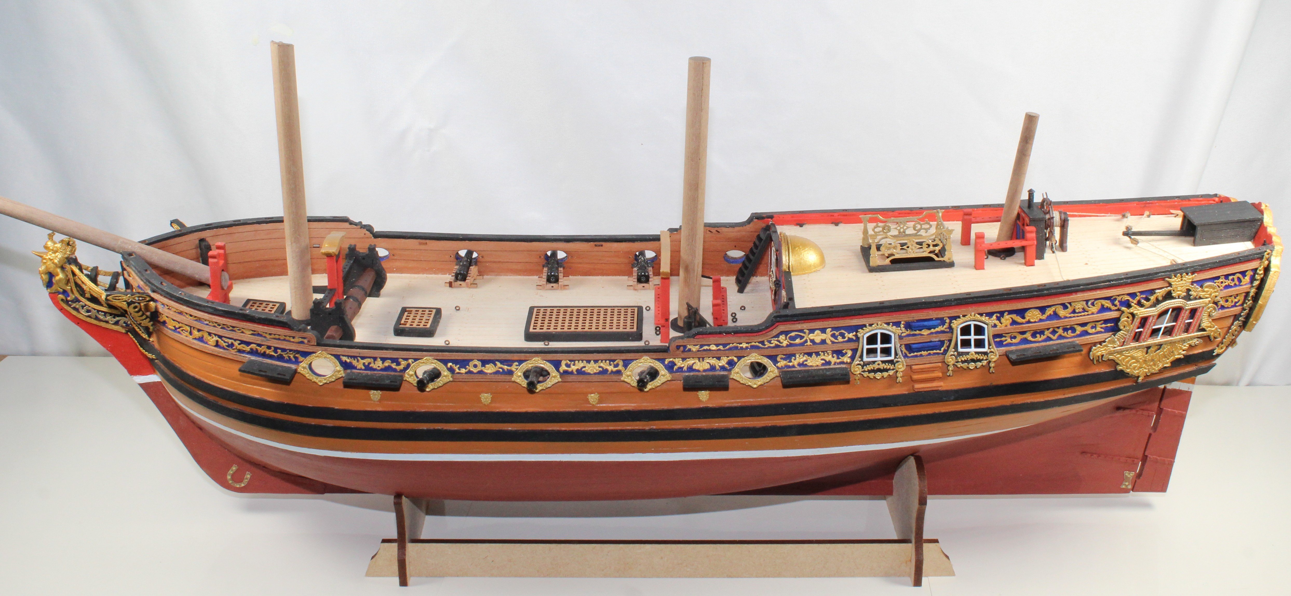

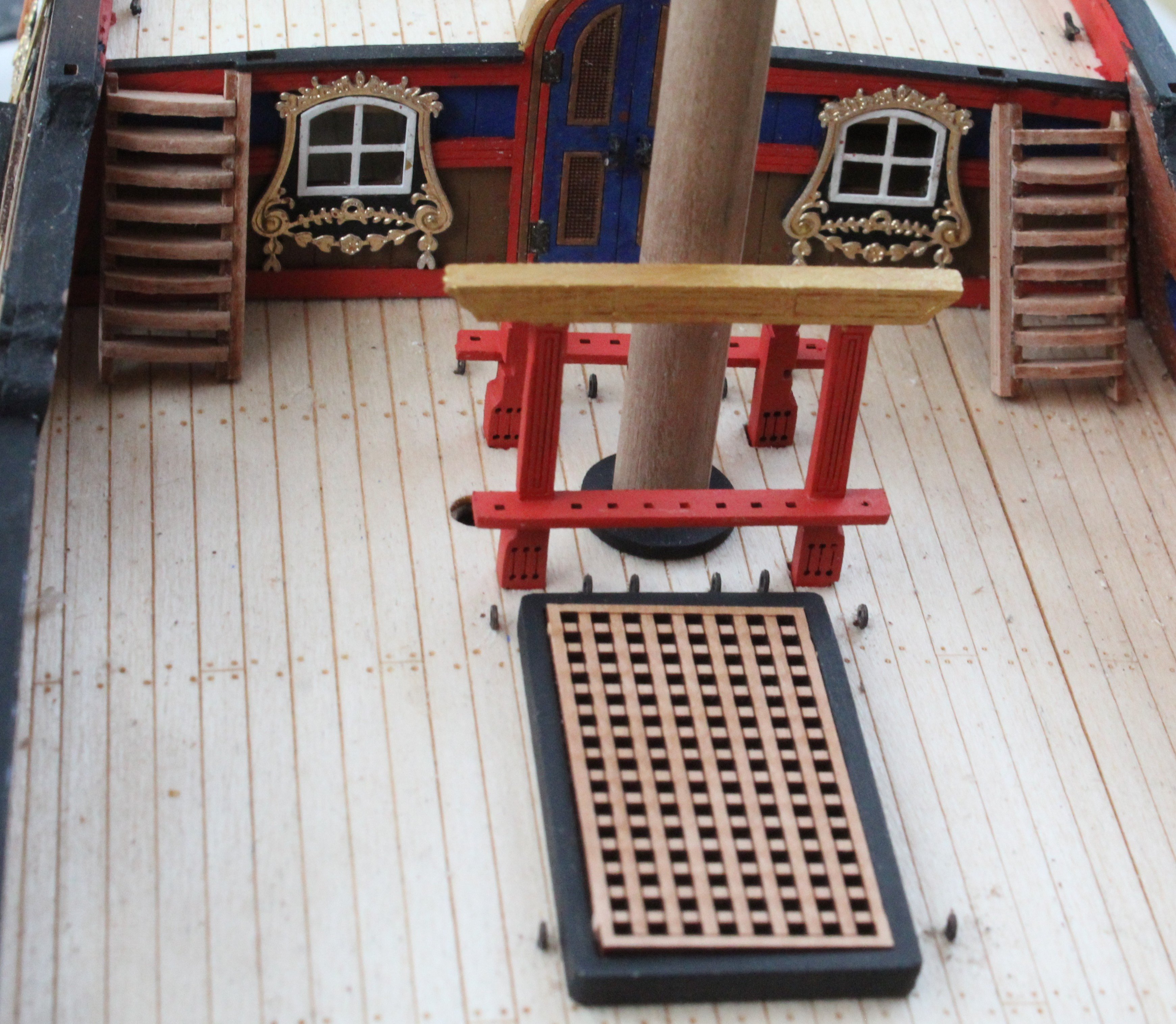

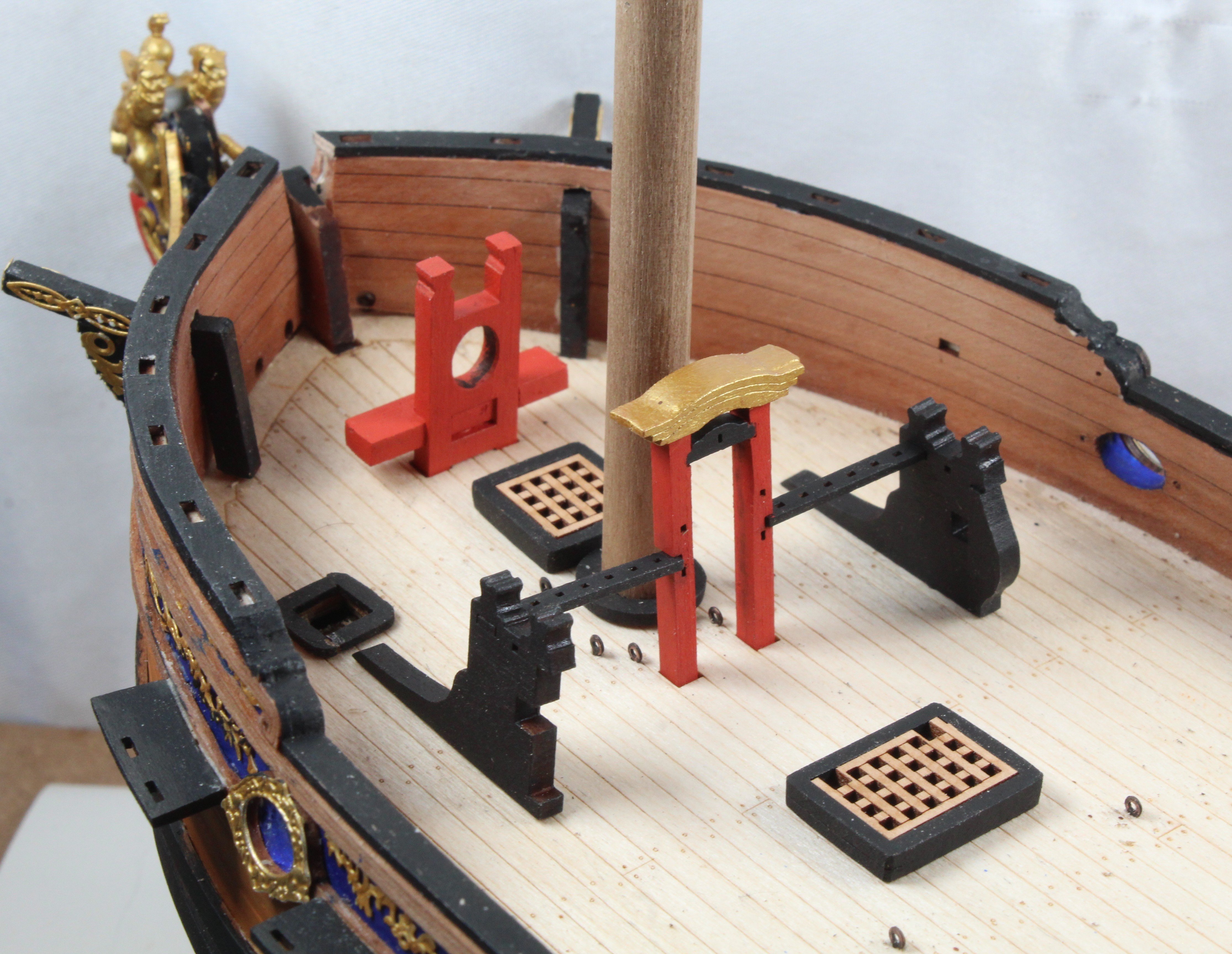

Build Log – Post 33 (07/01/26)

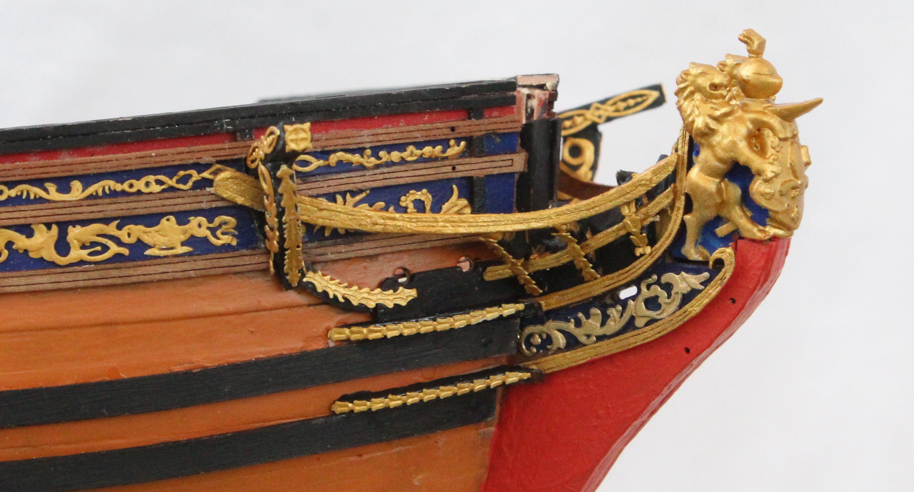

Task 54 – Bow Rails, Catheads and Decorations
Following on from my last post the remaining hull decorations were added successfully.

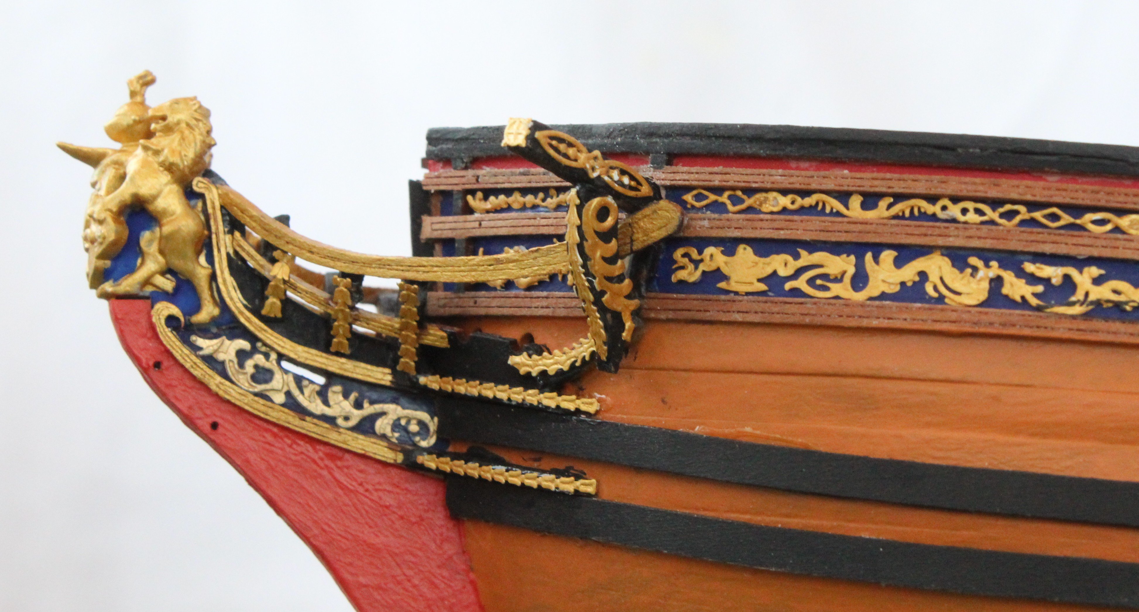

Once that was done it was time to add all remaining details to the bow area. The various rails were added along with the catheads, hawse hole bolsters & brackets and figurehead.
Once that was done the the various bow decorative patterns were added.
I then decided to add a bit more colour to the stem post by painting the area below bow rail and above the water line red.
Now that this work is complete, I can move on to adding the rudder.
Photos

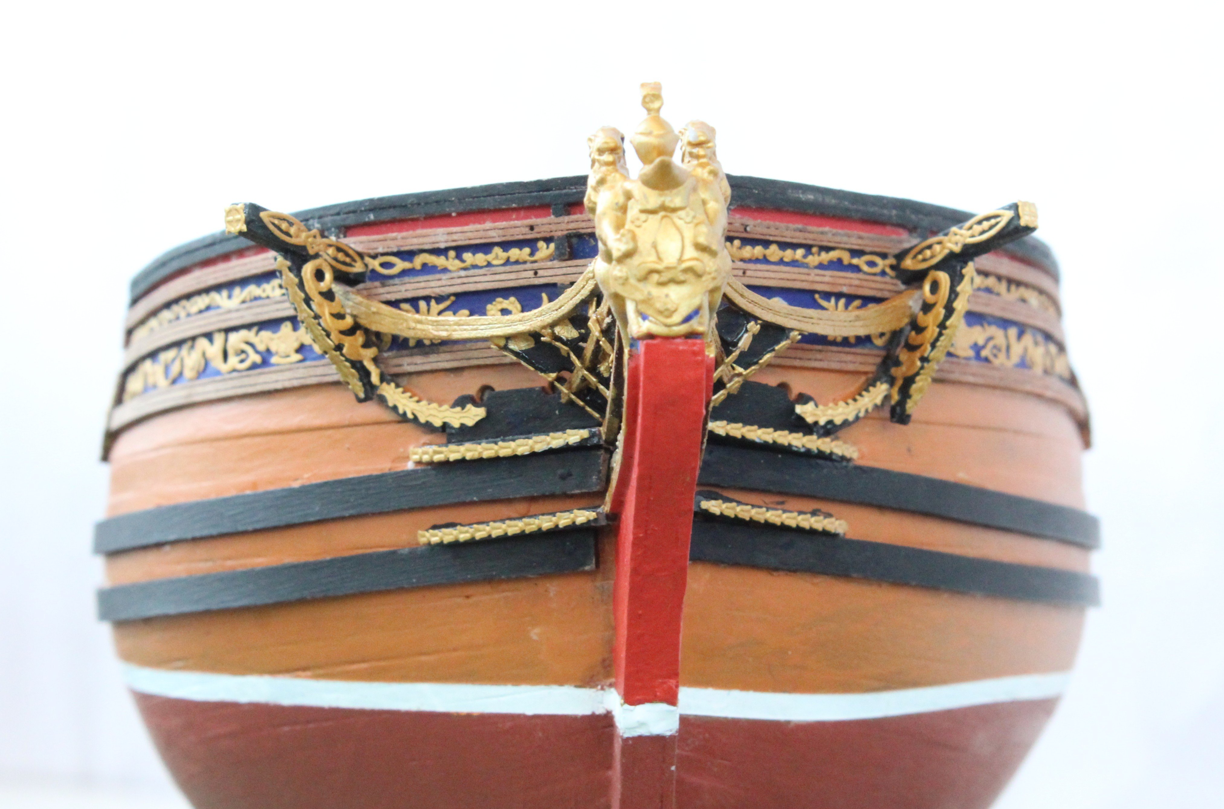

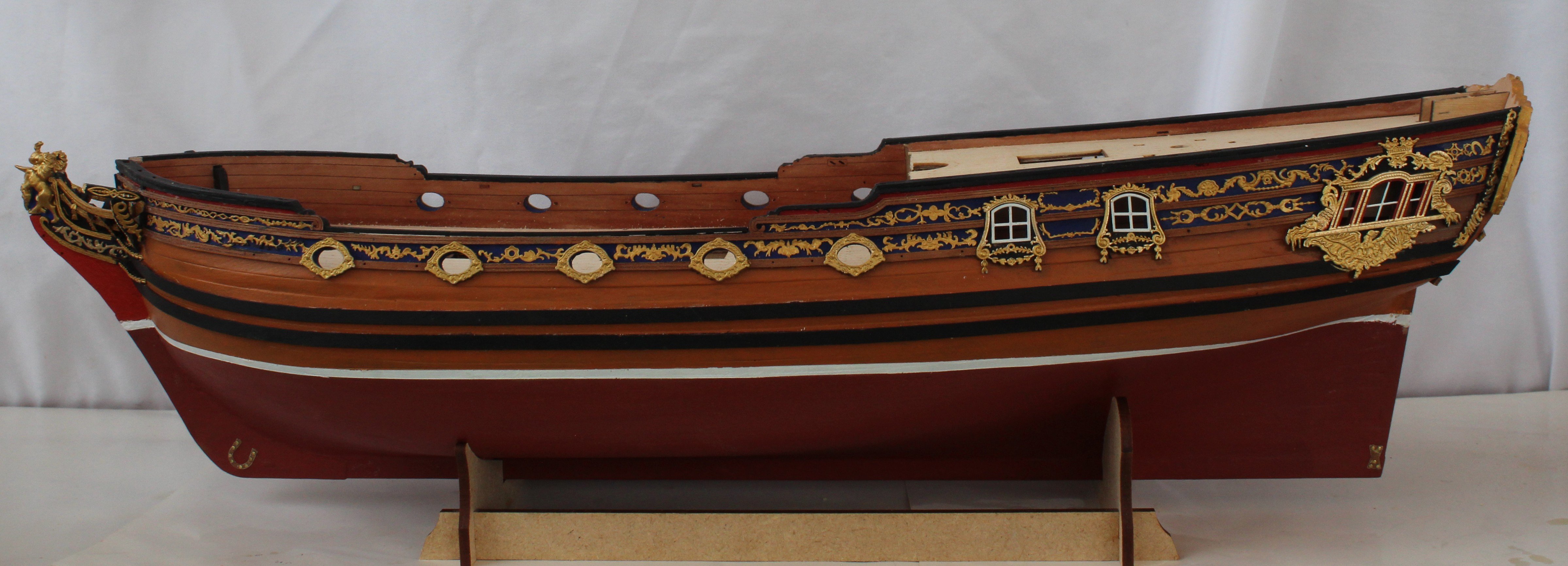

The first two photos show the current build status, the Duchess is stating to look more regal, noting I do have some PE decorative crowns to add between the upper wale and gun ports
Now a picture show the decorative bow area head on. The lower right-hand wale fit to the stem post is not very good
Finally two photos showing the right and left bow area. I opted to paint the bow rails gold.
