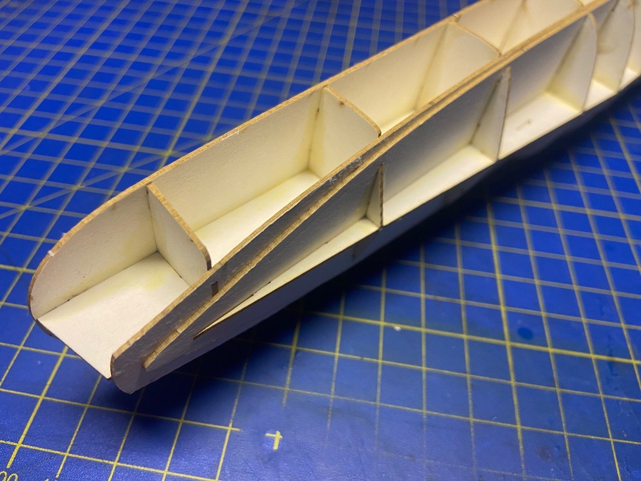

So far, I've really enjoyed doing the easy part. Started making the structures for the subassemblies using the laser-cut frames set.
Since most of the part labels were next to the parts themselves, I made sure to write the numbers on the faces of the parts, so I wouldn't screw things up... or at least reduce the chances of me screwing things up. I'm sure I can still do it...
And, here are the substructure of many of the subassemblies. IMG_2538.jpeg.3657b5dbfc16663574832399543f5289.jpeg

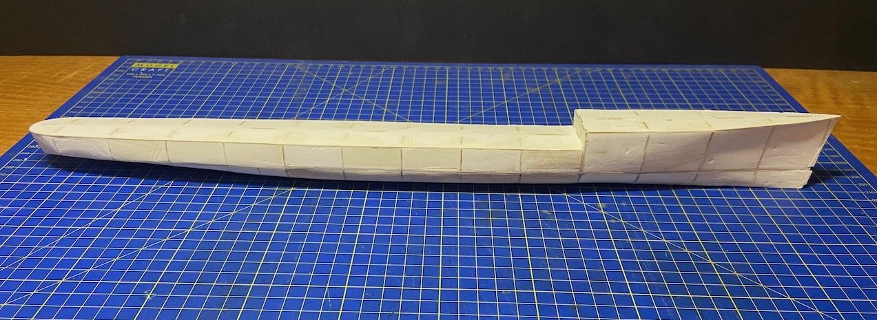

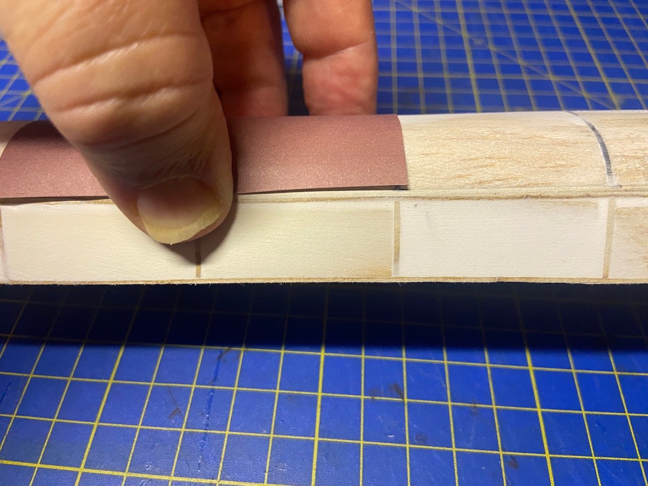

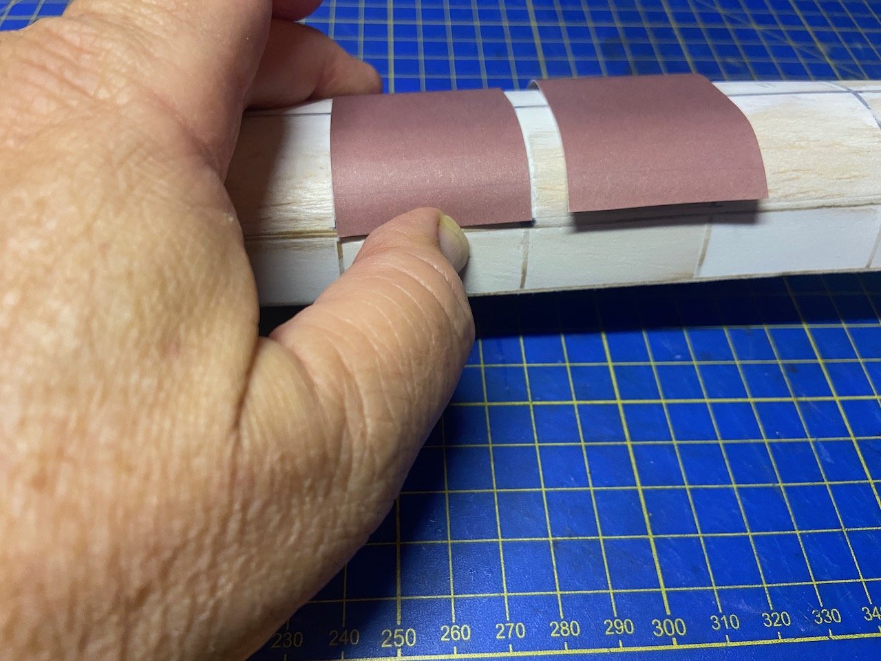

Meanwhile, I added some wooden blocks to help stiffen the hull framing. The larger filer blocks are balsa, but I started running out, so I just reinforced sections with some basswood pieces. This should also help to support mounting rods at a later stage. That's what I've done with other paper models, though they mostly been a lot smaller than this one.
IMG_2534.jpeg.dc37c411ce6b729ac3ecba270283cf1d.jpegIMG_2533.jpeg.1aca42ecbe222066de4b847efd63a950.jpegIMG_2532.jpeg.447ac338a049edae7300c08c735e3ddd.jpeg
I'm going to experiment with using some filler to fill and smooth out the hull shape. I've seen some models where the builder used styrofoam instead of the wood blocks or filler. Just never been keen working with that stuff.
Worst case with my model hull, I'll ruin it and I'll need another laser-cut frame set. Anyway, I'm considering getting a second kit, because I know I'm going to lose or mess up parts. I've scanned and printed the parts sheets, but the color is off from the original, and the color and part numbers printed on the deck pieces are pretty muddy in the original and hard to read, and even worse in the printed scan.

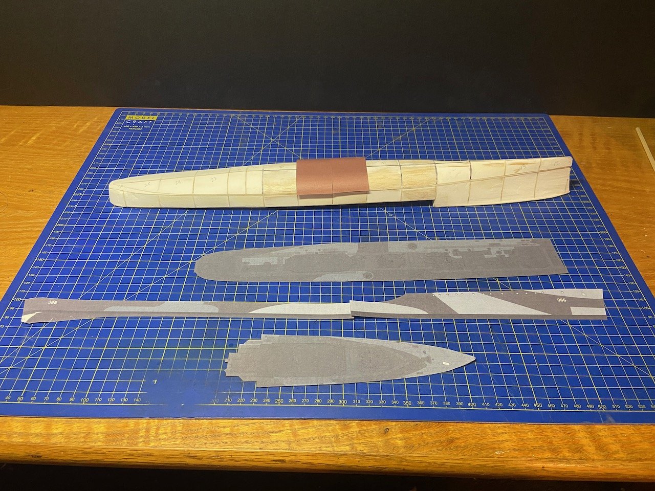

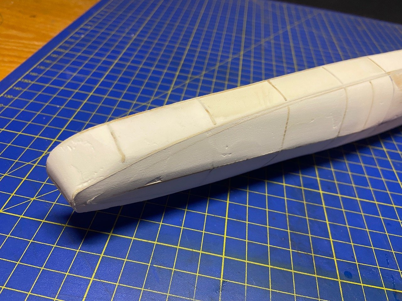

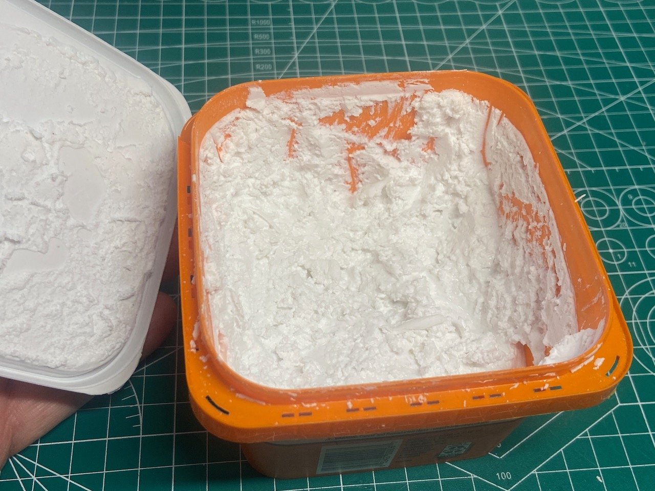

Good news, I don't think I've ruined my model yet!
I ended up using Gorilla brand wall repair spackling. The stuff is fairly soft and kind of fluffy going on, or 'in' as with the case of the framework of the paper model.

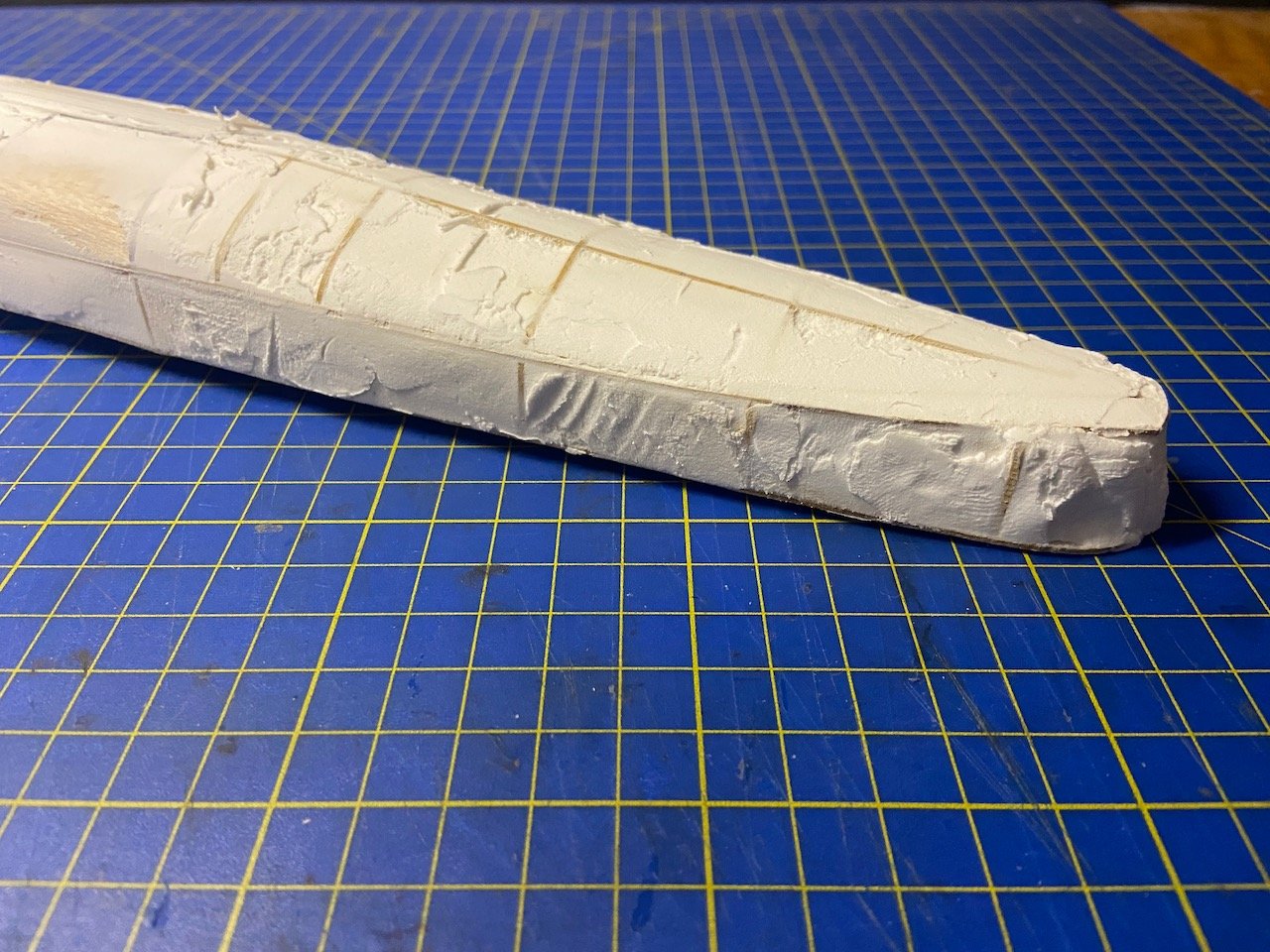

Doesn't look very good right after applying the stuff...
IMG_2558.jpeg.f09335519179f3f817c454f618699df1.jpegIMG_2557.jpeg.350fc1dd01fd97172d7344dfcdcf3823.jpeg
But, once dried, it was easy to sand it smooth, though I ended up having to re-apply it in a few spots. Eventually, got it as good as I think it needs to be.
There are still a couple gaps, but that really doesn't matter. The filler is mostly to give the hull more strength, and to provide even out the framing, so that the exterior hull pieces will lay nicely. A few small gaps won't make a difference.
IMG_2615.jpeg.0dfaade649cf2c58922ecb9505c2786e.jpegIMG_2614.jpeg.8a2179efa70daa8796dca46e75d7b2e9.jpeg

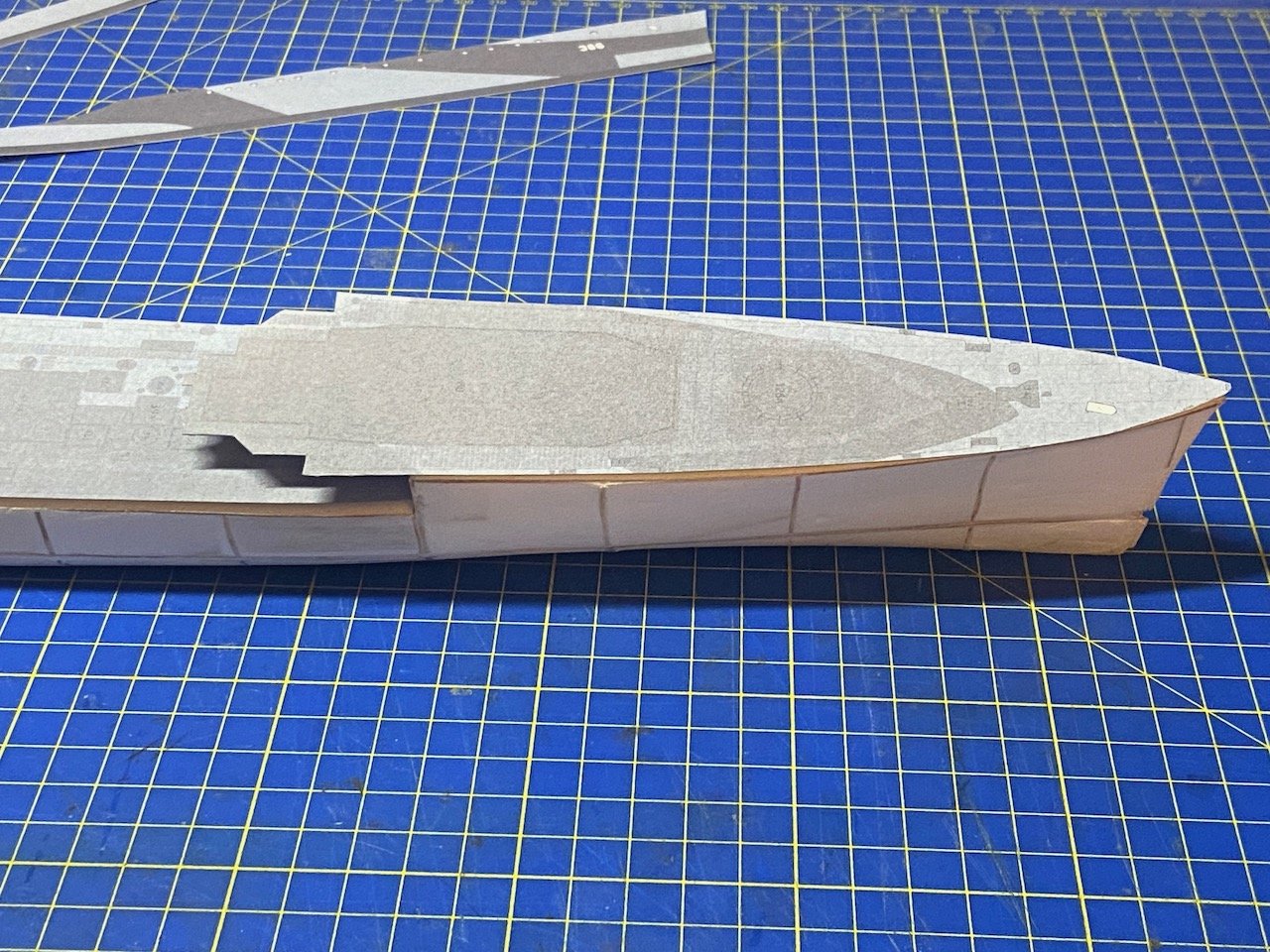

I did notice that the deck had a slight bulging in areas. Probably, when I pushed the spackling into the framing, the pressure caused a little unevenness in the deck in a few spots. The result was also that there might have been a very slight apparent twist int the hull.
I found I could actually sand the heavy cardstock deck, leveling out the bulges pretty well. I was surprised at how well the card took the sanding.
Next step will be to start adding the hull pieces, starting with the lower hull.

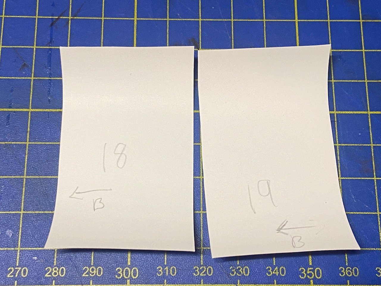

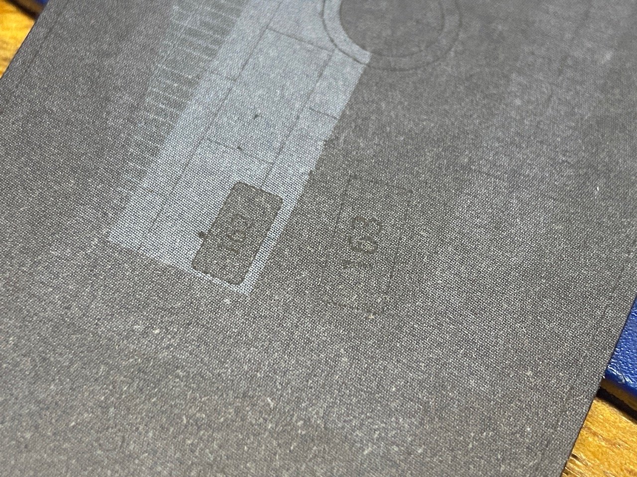

So, I took one of my early printed parts sheets to use to test fit parts on this hull I'm making (Printed parts sheets started as a scan of the kit parts pages, which I then printed out on my own printer). This turned out to be a very useful test, and gave me more confidence going forward.
The most important thing this showed me, was first, to make sure to write the part number number on the back side of the part, AND to indicate which way the part is supposed to go on. In this case, I simply added an arrow to show the direction of the ship's bow.
The next thing I discovered is that these hull "plates" extend over each the bulkheads. This means in order to use them, I'll have to trim them down or to overlap them. Neither solution seems ideal.
IMG_2625.jpeg.dd6a6112e0d95e341a62887c6ab0539f.jpegIMG_2626.jpeg.1ae1fddd91f544107d28e2f808894ff9.jpeg
Then, I got to thinking... I checked these pieces against the original parts sheets – I could do that now, since I had these parts cut out and could easily lay them on top of the originals. Sure enough, my printed parts are slightly oversized!
Now, I could try to figure out what percentage I would need to reprint these at... Or, I could just use the original kit parts, and maybe see about getting a second kit in case I mess up a part, a strong possibility. I could also just figure on reprinting a parts sheet when and if I actually end up needing it. I suppose I could also hold off purchasing a spare kit until I actually need it. Then again, I don't know if that will be possible when the time comes, so I might just look into it now.

Hi Chris, yes, that's what I was expecting, plates that butt up against one another, like they did with my V108 build.
I prefer a full-hull model myself, except if I'm maybe doing a waterline diorama, which I have to try sometime.
Anyway, I'm using the original kit parts now, and it looks like they'll work as expected. I'm now looking at either ordering paint markers for edging the red underwater hull, or I'll end up going back to what I originally did with the V108, which was to just carefully use paint.
Big advantage of using the original parts is that there's no color distortion or detail loss that comes from scanning and then re-printing. As I mentioned before, the colors on the deck in particular are a bit muddy, and with the light shining just right, I can just read the number labels on the deck. That's not possible with the scanned and reprinted parts.

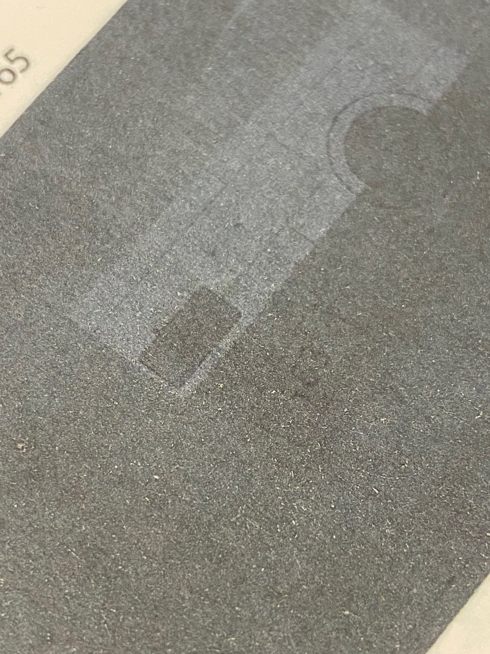

Here's the kit part...
And, here's the scanned and re-printed version...
Honestly, even with the kit part, the numbers are so hard to see that I didn't even know there were any. However, I'll make it work.
Anyway, I found the company had posted a jpeg on their Facebook page of this same parts sheet these came from, and the writing on it is nice and clear. And, yes, I thought about using that file, but it's only the one page, and I've had enough issues with sizing and color adjusting the printed output. So, I'm making due now with building the kit as it comes...

Anyway, I figured a test fit would be safe...
IMG_2667.jpeg.d8d6a83fb5e32b7997046b5f5b937e97.jpegIt was clear that the upper edges needed to be rounded, but getting this all to look clean is going to be a real challenge. I'm now recalling that exposed edges probably need to be hidden from a top view, so that back panel may be placed too high, and the turret top needs to mounted first... 🤔

After staring at the hull for a few day, I decided to jump in and start the lower hull plating process.
Hmmm... not excited by the results, but then, I've got a lot to learn. This is just a step on a path.
After all the filling and sanding, I'm kind of wondering how much different things would have turned out if I hadn't done that. Well, certainly in the future, it will be easier to handle the model without accidentally caving in the hull.
IMG_2672.jpeg.ee94ef7953c0eabe7766a8cf2cda0e33.jpegIMG_2673.jpeg.4711b76093b7ee064eca4d397802aaff.jpeg
However, in the process of sanding smooth the wood/filler, the hull may have narrowed a bit, meaning that the deck is now just a bit too narrow. Not sure how well this will work, considering the structure that has to fit across the deck, just under the forecastle. May need to do a little squeezing later...
IMG_2675.jpeg.4f0f6a365b6f8282eada52f870a218c9.jpegIMG_2674.jpeg.0f677cd3d3509870f3bd87ad5a0f6d25.jpeg
I'll probably be able to adjust. I think I need the cover the sides of the upper hull to continue, though I have more that needs to go on the underside of the hull, including skeg, propeller shafts, screws, rudder, and bilge keels. I also will need to work out how the model will be mounted.

And pressing on a little more to make progress while I have some time before Christmas, I decided to add some of the hull parts.
The only ones I can do at this point are the parts of the aft deck and hull.
I can't add the forward hull skin until after I get the forecastle deck mounted. And, I can't add the forecastle deck yet because it overhangs the main deck, and I need to fit some details underneath the overhang.

Still not really being used to how paper models are supposed to handle curves, I'm not really sure if the underside of the hull at the stern looks okay. Not sure, but I think it does.

I test fit the forecastle deck and forward hull skins. I think everything should fit okay.
