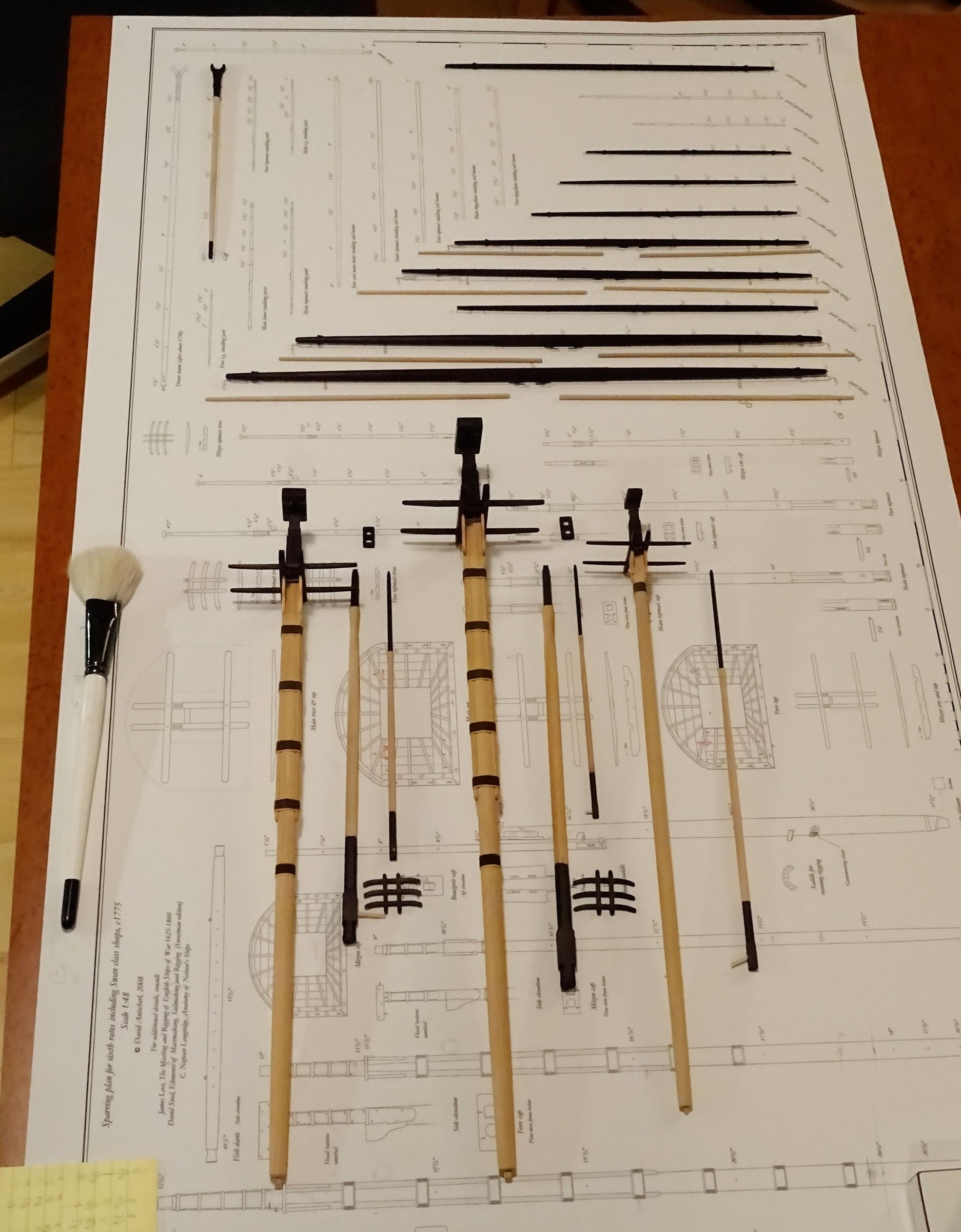

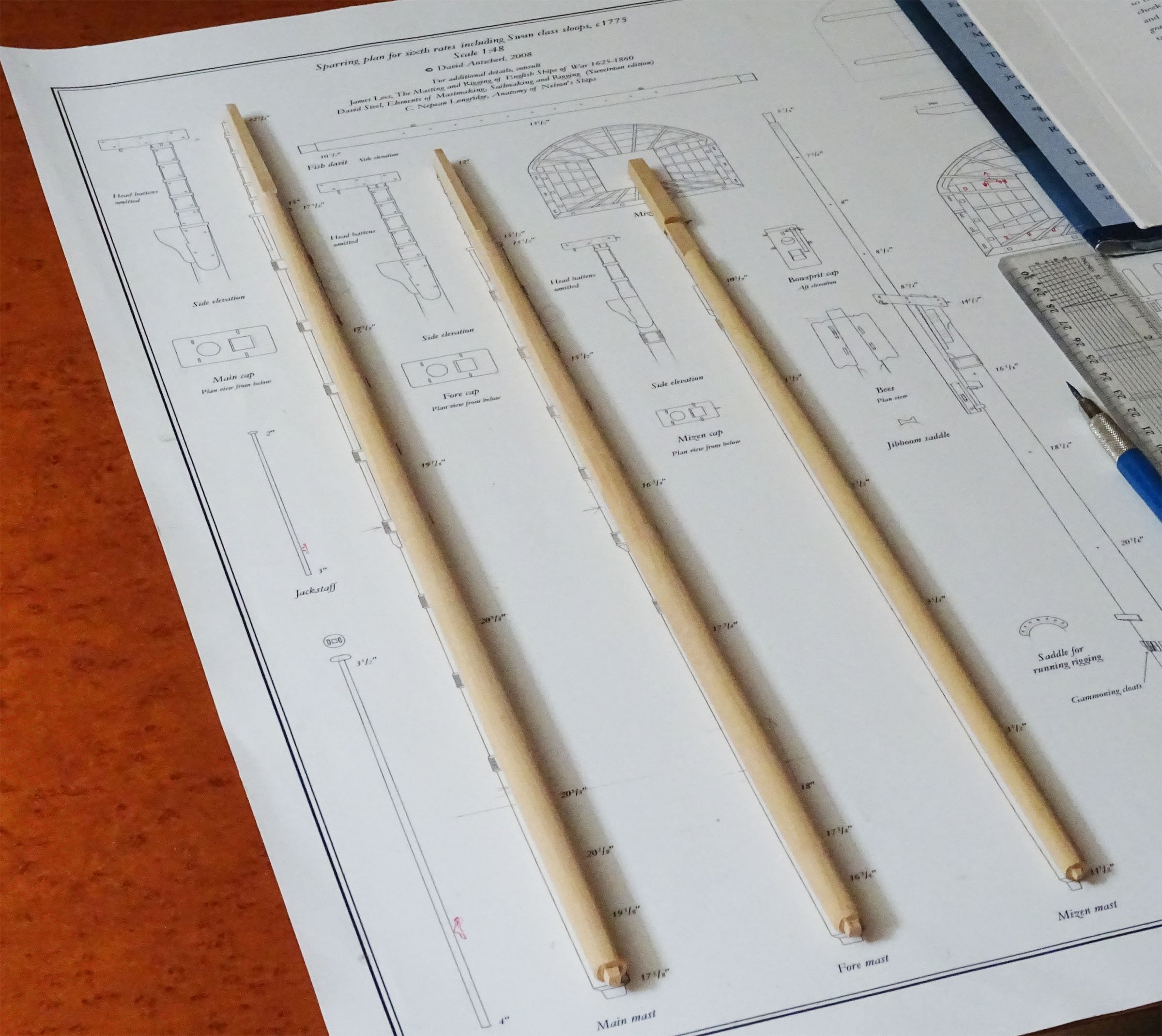

Some samples of spars at 1:48Clowermasts29.8.thumb.jpg.46ca4b733aeb5977ee038225c4ec4e9f.jpgCsparscomplete26.9.thumb.jpg.d09480f79c15076191d5b9bb91f30949.jpg made without a lathe in sight:
