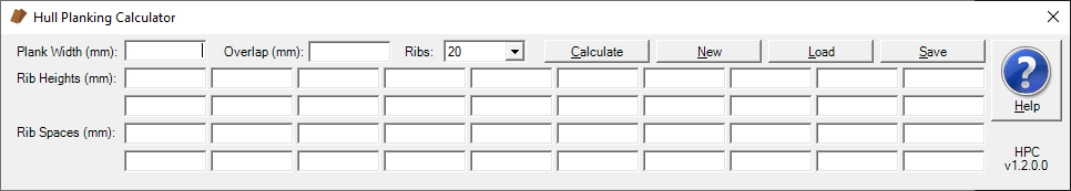

This is free (as in beer) desktop software for the Windows OS, created simply out of curiosity and research into model wooden ship hull planking.
If you are interested in checking it out or testing it please download the latest release from GitHub using the download link below.
There is no install just an .exe that can be placed where desired.  I usually keep it on my desktop.
Download and unzip to your desired location.  You may be asked by Windows to allow the .exe to run on your machine.
Repository: GitHub - mintgum/HullPlankingCalculator: A calculator to print tick strips and plank templates for wooden model ship hulls.
Download: https://github.com/mintgum/HullPlankingCalculator/releases/download/Release/HullPlankingCalculator.zip
Please read the included help text by clicking the large (?) icon on the right side of the form.
Any feedback is welcome and I will do my best to answer any questions.

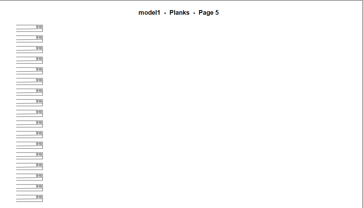

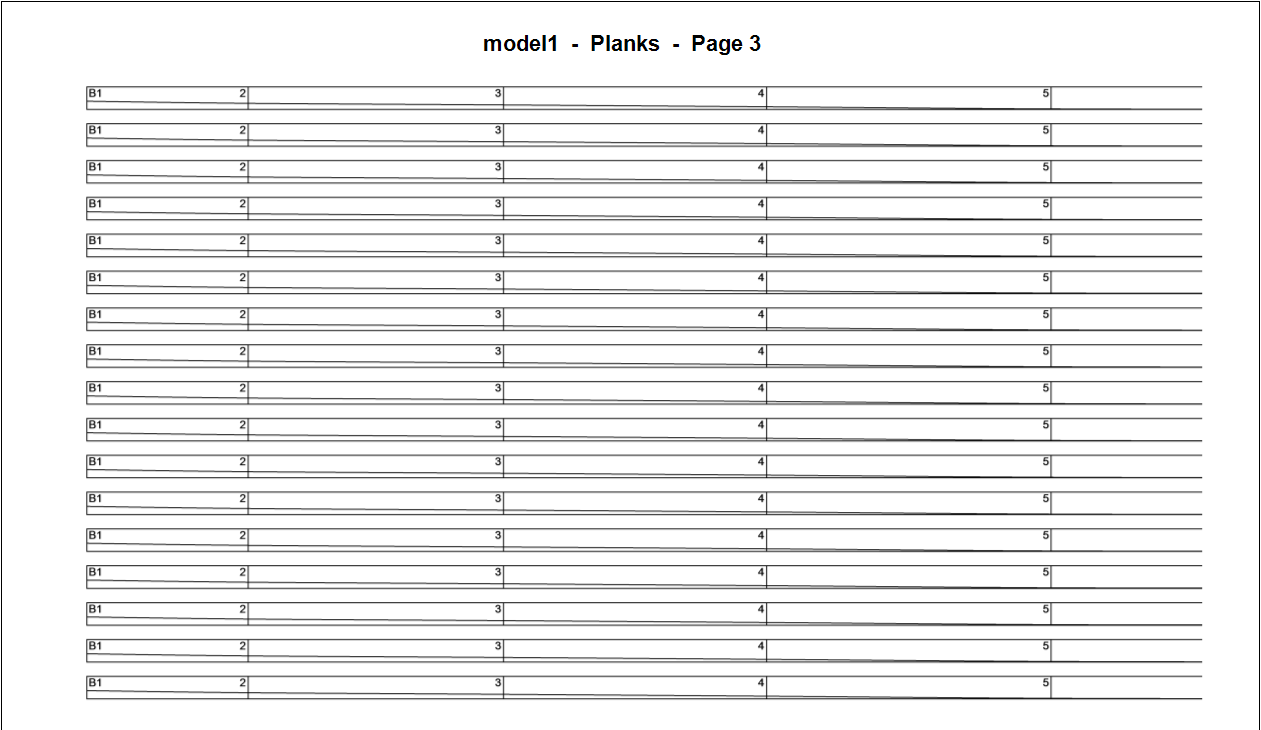

Here's an example hull and the generated tick strip and planking templates which can be printed on any standard home printer (Letter or A4 size paper):
Tick Strip Page:
First page of the plank template:
Second page of the plank template:
Third page of the plank template:
Edited by MintGum

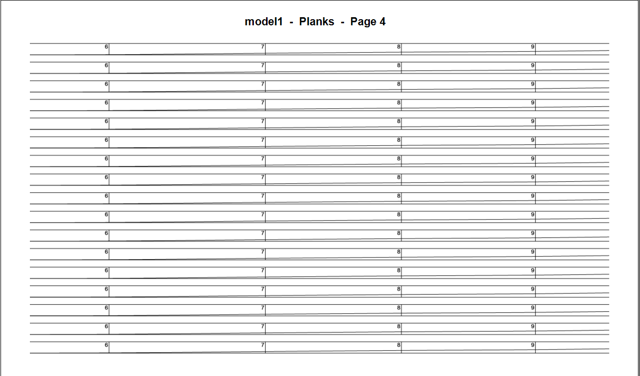

First page of plank template:
Second page of plank template:
Third page of plank template:
Edited by MintGum

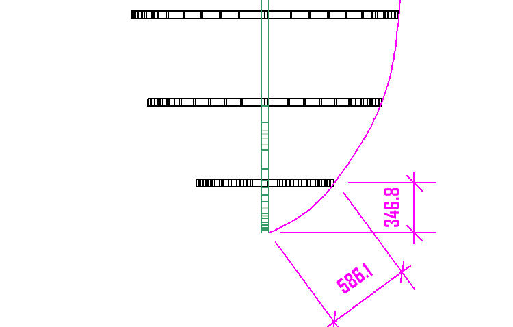

25 minutes ago, MintGum said:
It's intent was to elongate the plank for extreme curvatures at the bow or stern where the linear length from one rib to the next isn't enough to "make the curve".  How well that works in practice remains to be seen.
The 'rib spacing' must always be 'as the plank lays'. At the bow strakes tend to curve out as well as up (to the bow) so adding a millimetre or two (depending on scale) to the first spacing is probably the easiest.
It's never going to be perfect so we shouldn't be too pedantic.
If the hull is convex we need to add a little to the breadth of the strake to allow for bevelling, if it's straight or concave we don't. This would be difficult as it depends on the strakes location.

1 hour ago, MintGum said:
Ahh, that explains it.
Yes, in the example below I've only measured the diagonal whereas you actually need to measure the curve, but you can see the difference.
Craig.
I do know, that I don't know, a whole lot more, than I do know.
Current Build: 1:16 Bounty Launch Scratch build.   1:16 Kitty -18 Foot Racing Sloop   1:50 Le Renard   HM Cutter Lapwing 1816  Lapwing Drawings
Completed....: 1:16 16' Cutter Scratch build.
Discussion....: Bounty Boats Facts
That diagram represents the arc length of the 3D Spline or Bezier curve formed by the plank, that I had eluded to in #9.
Over the length of the hull, depending on the degree of curvature, true arc length could be several millimeters or more than the straight measure.
After initial rib spacing measurements (on the diagonal), an iterative process adjusting the rib spacing by using the plank templates should get close to the actual arc length.
This is best done per rib space as you mention in #12.  The extend function distributing this extra length (or space) over the length of the plank would not represent the same curve.

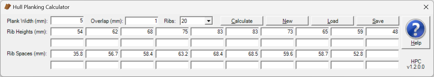

Version 1.2.0.0 is live and can be downloaded from the link in the first post.
12/26/2025
  • Added an overlap feature to support clinker/lapstrake planking.
  • Removed access to the extend function.  Extend values are retained for future use but set to 0 during hull calculations.
  • Updated documentation.
Comments:

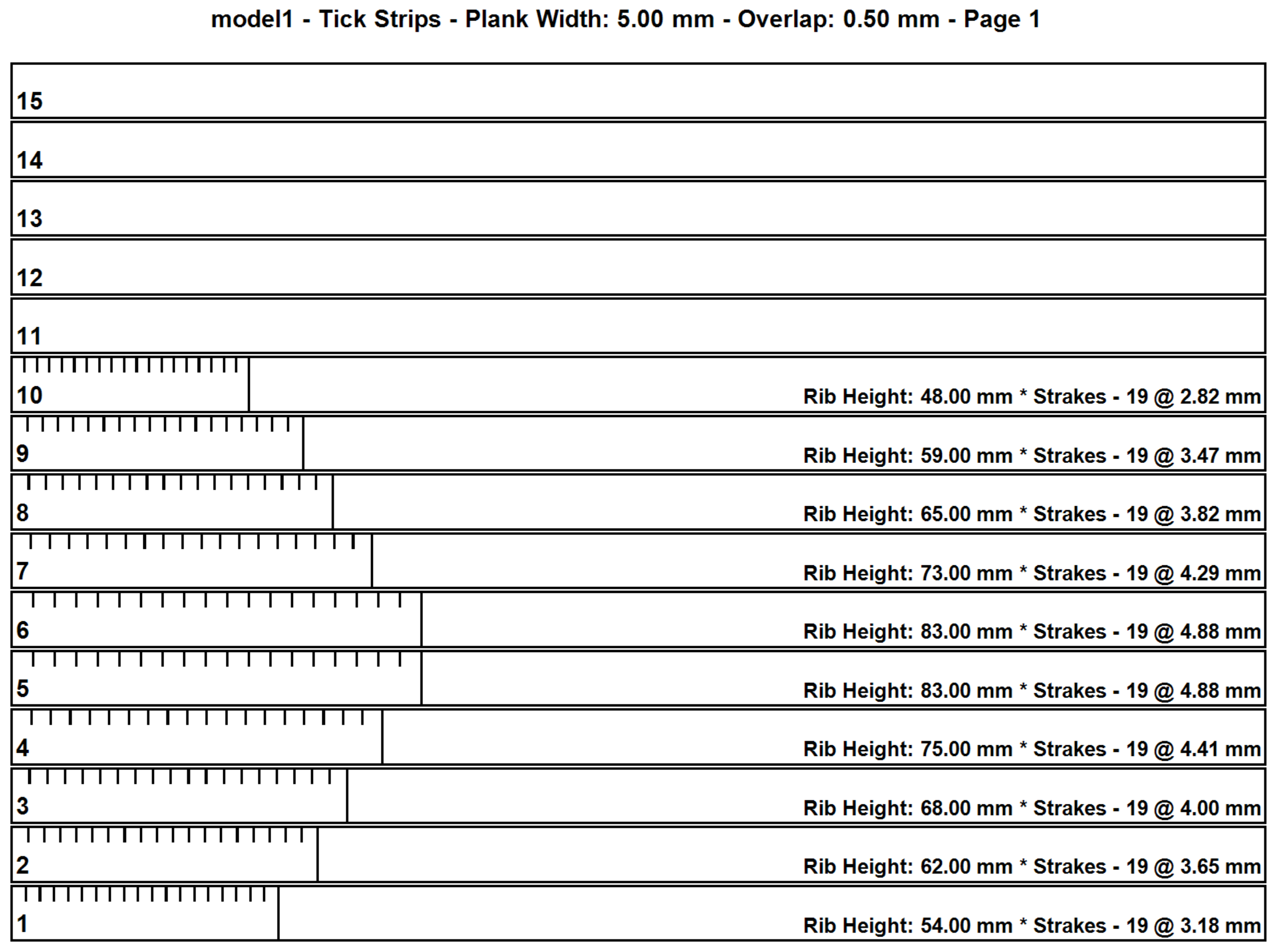

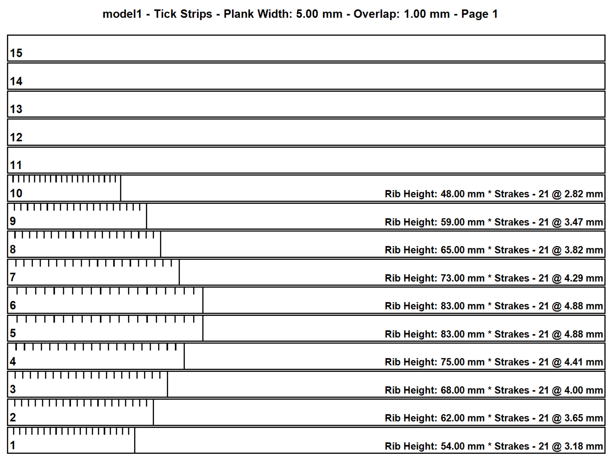

Note the difference in the tick strips below.  The number of strakes increases with larger overlaps but the plank templates remain the same.
Feedback is always welcome.
Tick Strip - 0.0 mm overlap:
Tick Strip - 0.5 mm overlap:
Tick Strip - 1.0 mm overlap:
Edited by MintGum
