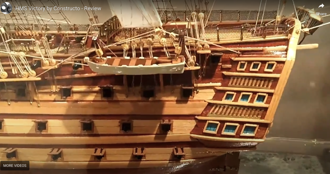

From the unboxing, there are some wood parts not laser cut, and you have to cut them yourselves.  Other wood parts are 'pressed' (diecut?) but may take care in getting loose.  The bulkheads appear to be laser cut.  There are a number of plastic fittings, but also brass ones.  There have been "simplifications" in the detail, so in the photo below from a reviewer (who said he found the kit difficult ... but persevered) it has the appearance of a better grade commercial pre-built model one can find for sale.
  But if the price is right, who knows what can be done with some effort.
