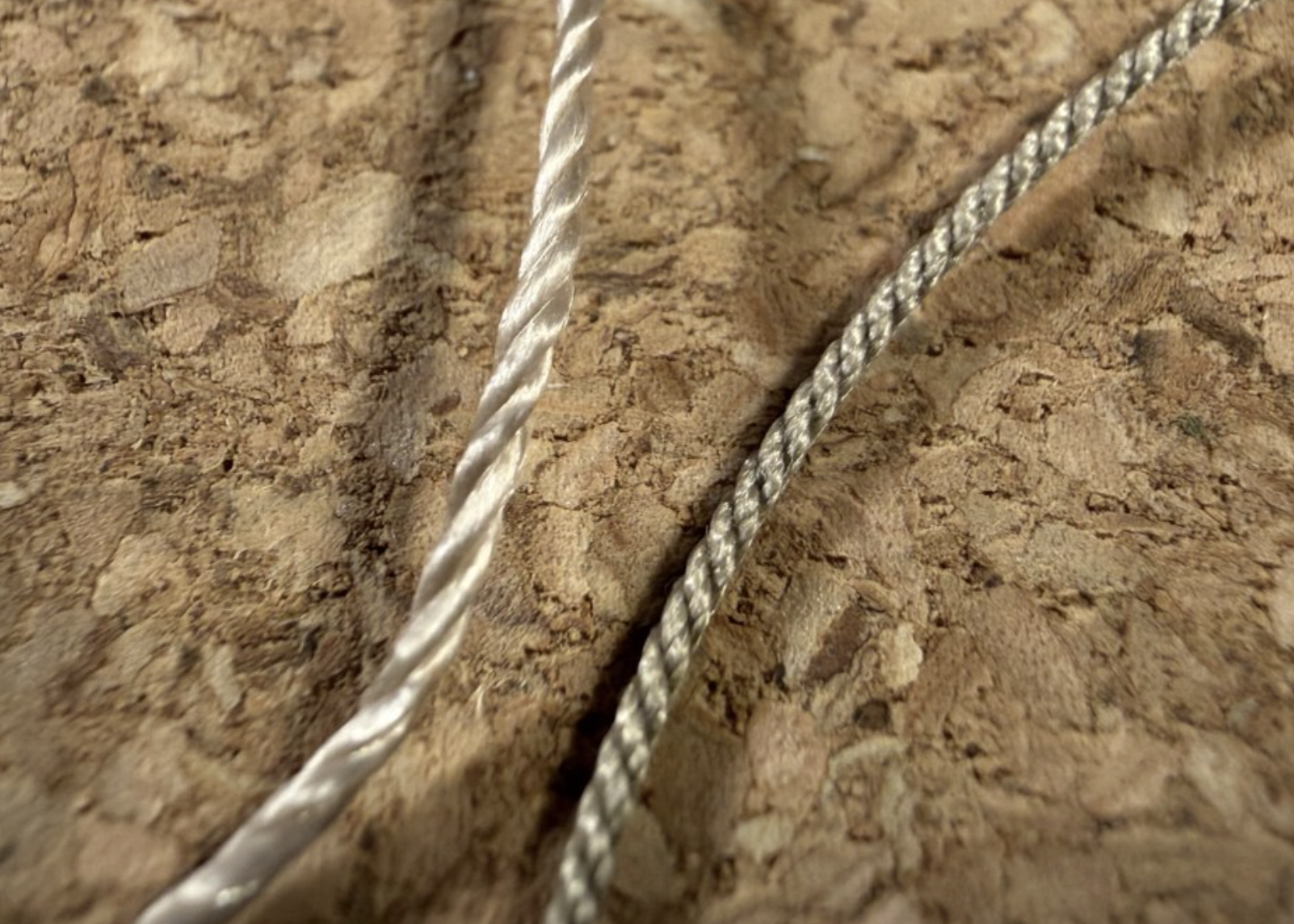

Assuming the kit does not tell you how thick their rope is: A trick I learned here is to wrap the original rope 10 times around a dowel, snugging the rope wrappings together, then measuring the thickness of the 10 wrappings with calipers and dividing by 10 (do it a few times and take the average). That gives you the diameter of the rope you need to order - you'll never find an exact match, so pick something close. There were times when I had two ropes with two different thicknesses that were closest to the same thickness of the rope to order and I just ordered two ropes one step in diameter apart.
Some people find other sources to replace the rigging. Some kits might come with 2-3 different thicknesses of rope - I remember seeing someone post that a kit of a fairly large ship inexplicably had only a single thickness of rope - where the actual ship might have had a dozen different thicknesses of rope or more. It definitely makes a difference in the final result having a variety of different thicknesses of rope. I recently saw some posts on a ship modeling Facebook group with someone doing ratlines from a kit that had one thickness of white rope with shrouds and ratlines the same thickness of fuzzy rope (they said they were going to dye the rope when they were done).
The rope from Syren is excellent. As are their blocks and thimbles and other pieces. So many kit-supplied ropes are fuzz monsters. Syren's is perfectly clean and lays naturally. Vanguard's ropes are nice, not nearly as nice as Syren. Model Shipways' and Midwest's ropes are okay but are not so great. I've seen posts from other kits that seem far worse than either.
It certainly adds to the cost, which is why kit manufacturers do not generally supply rope (or blocks etc.) of ultra-high quality. Easy to spend $100+ on a several packs of rope, blocks, deadeyes, thimbles, belaying pins to replace what's supplied in a kit (though you'll likely have left-overs for the next kit). I bought several plastic organizers to store (and organize) all the rope and blocks I have (that I bought and that were left over from other kits). Vanguard has sometimes had a Master Shipwright version of one of their models that is around $175 more than the regular kit that includes better blocks (I think the rope was the same).
