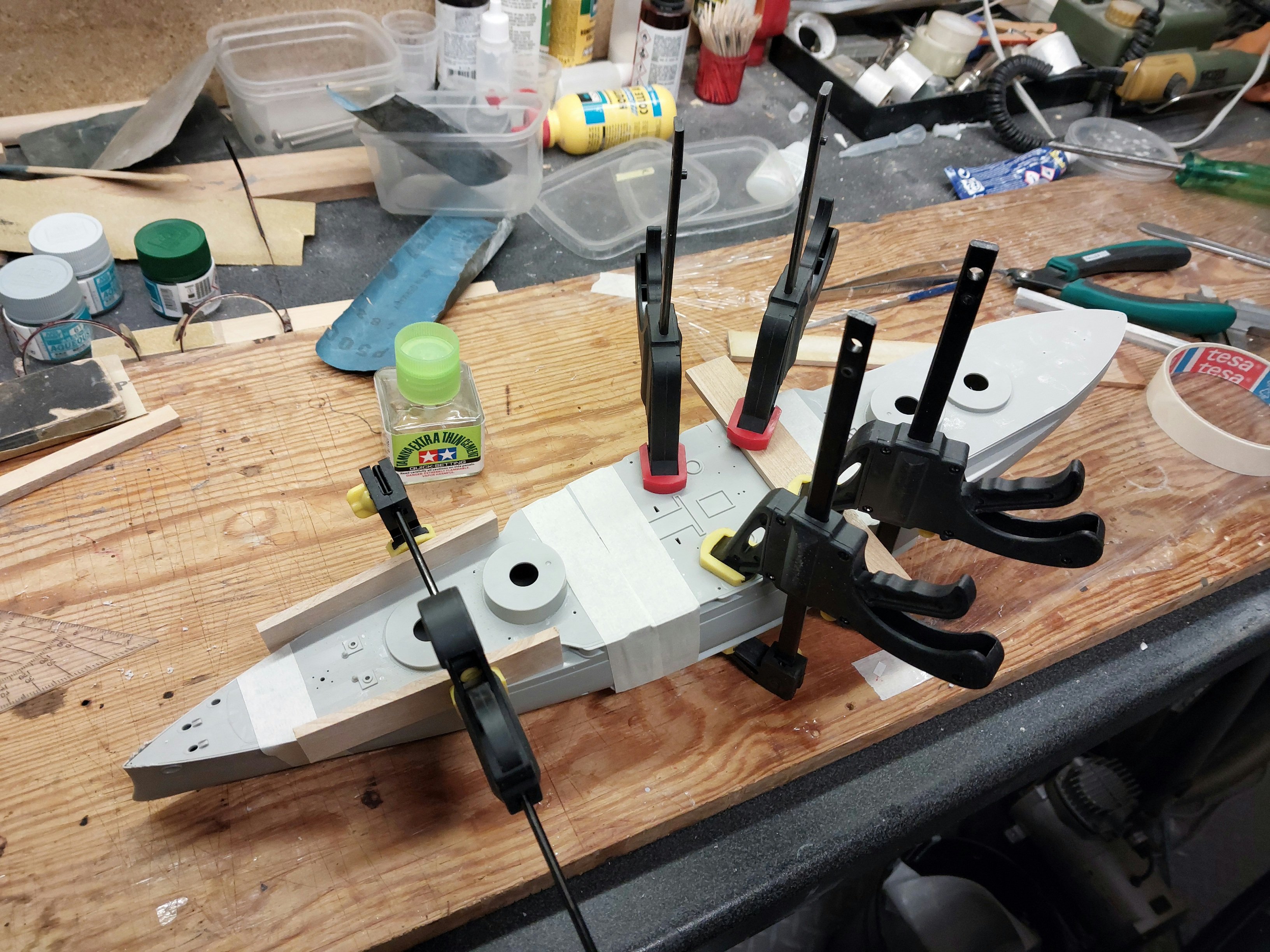

Maybe something for you as I think you did not do this ship

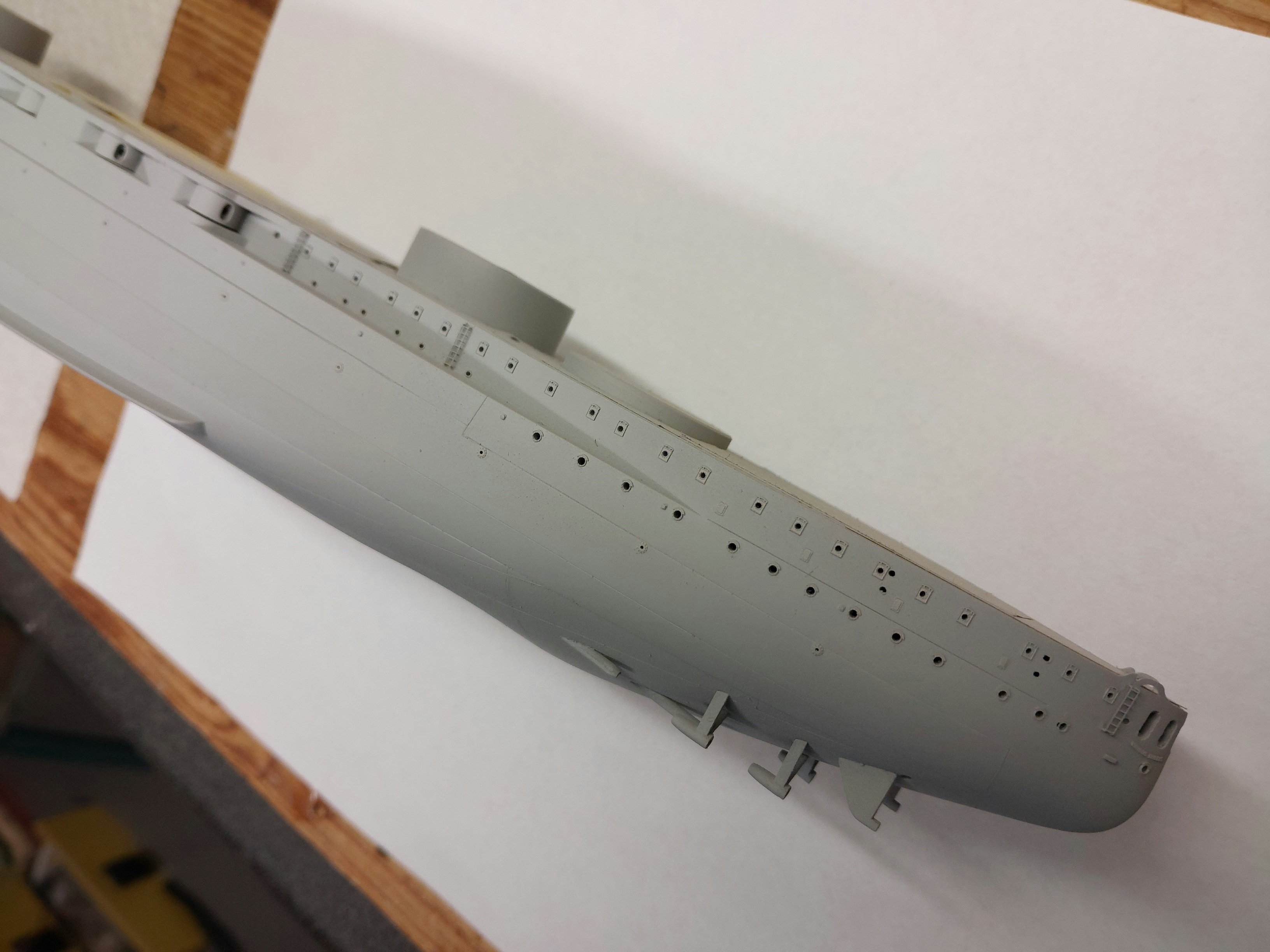

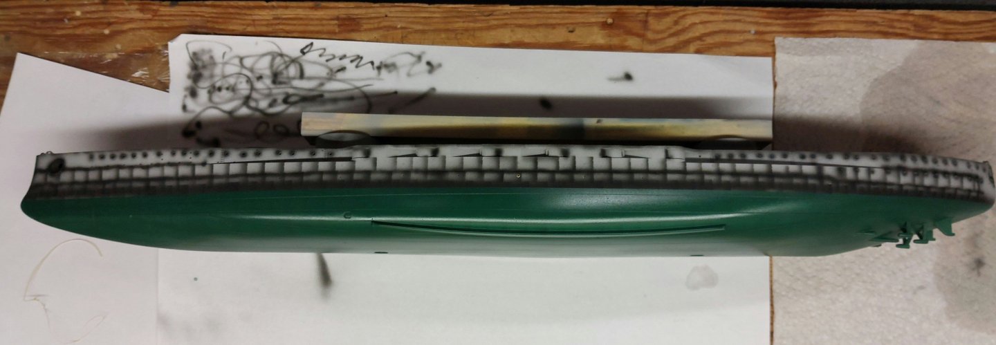

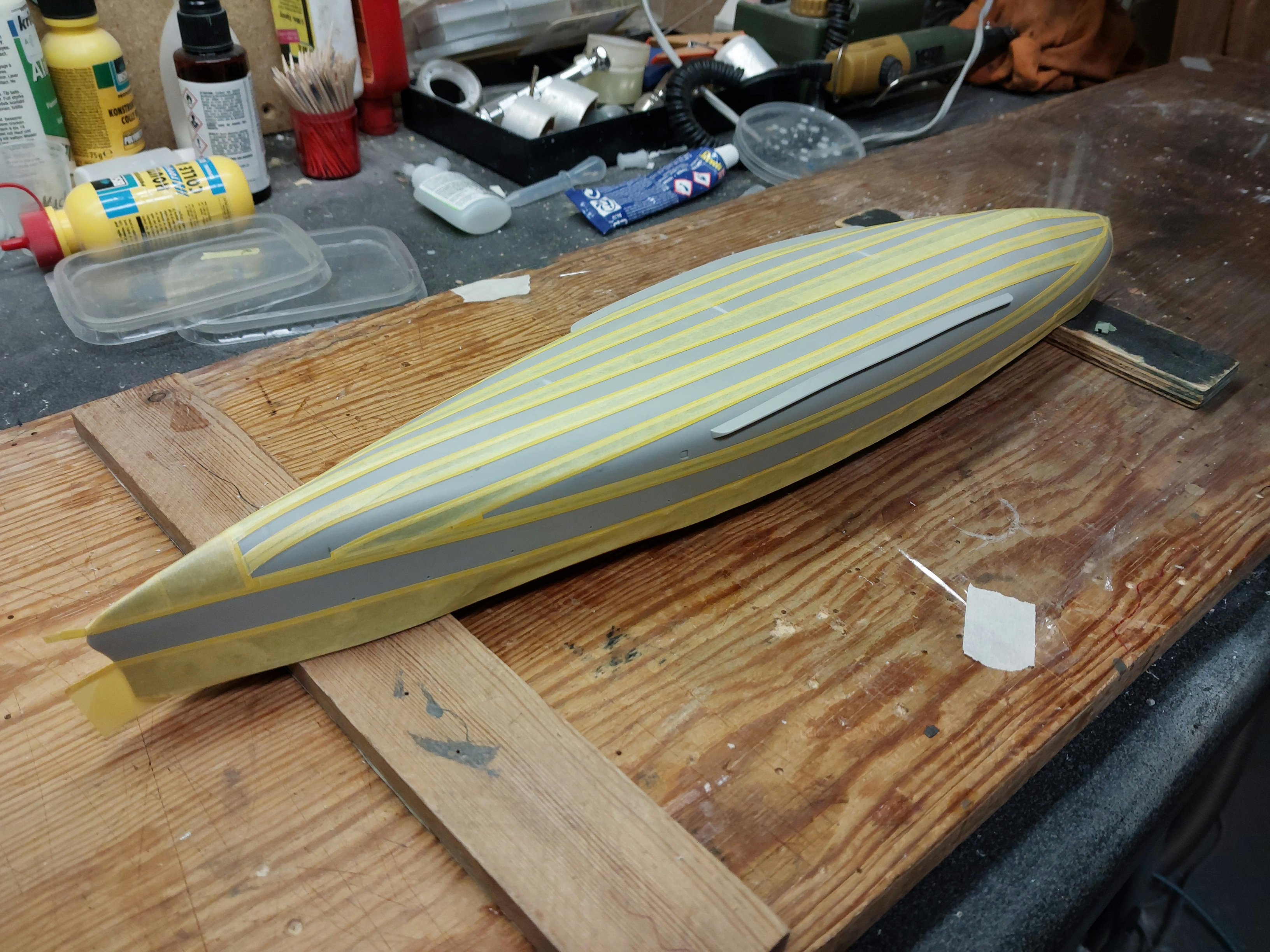

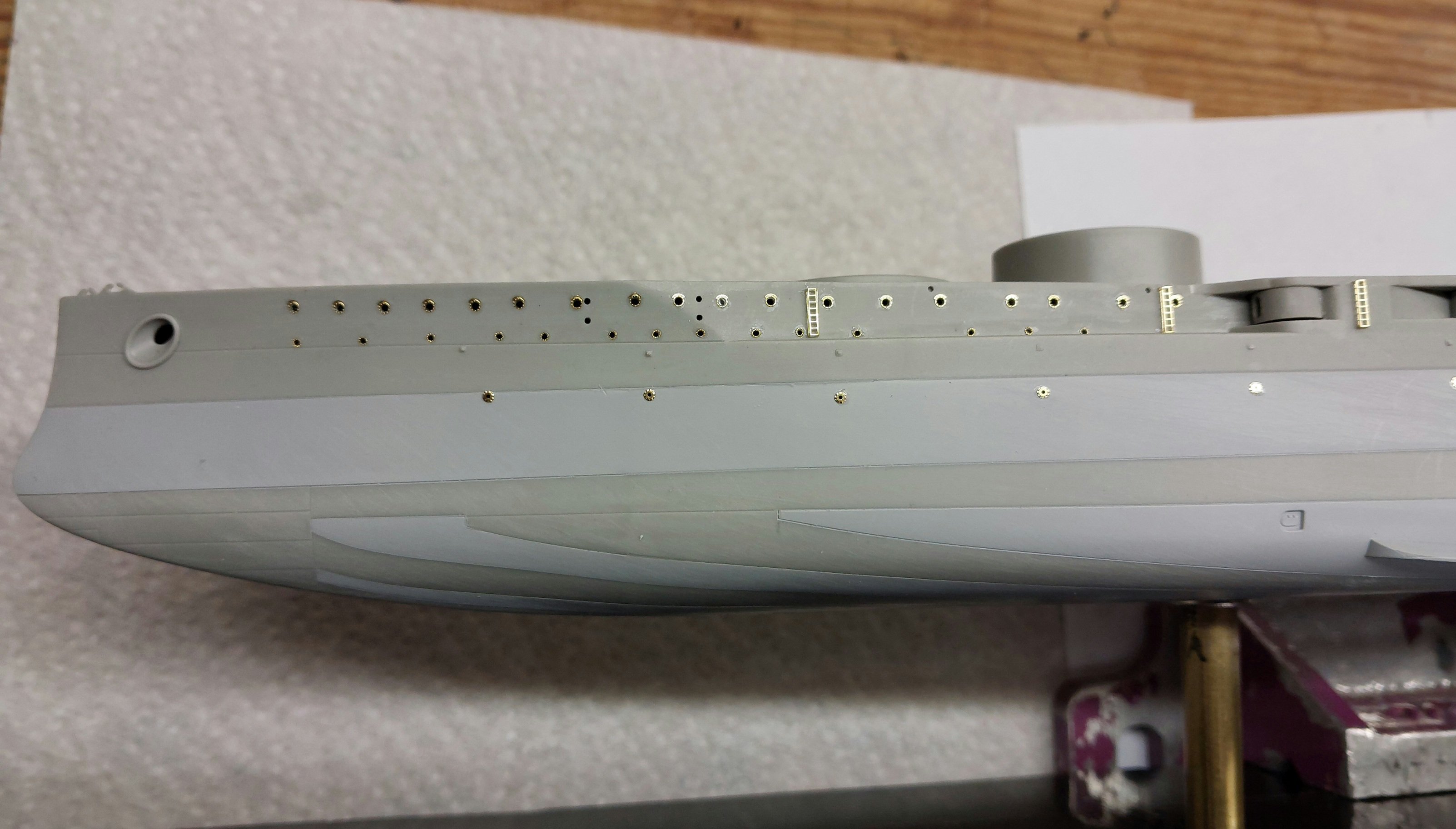

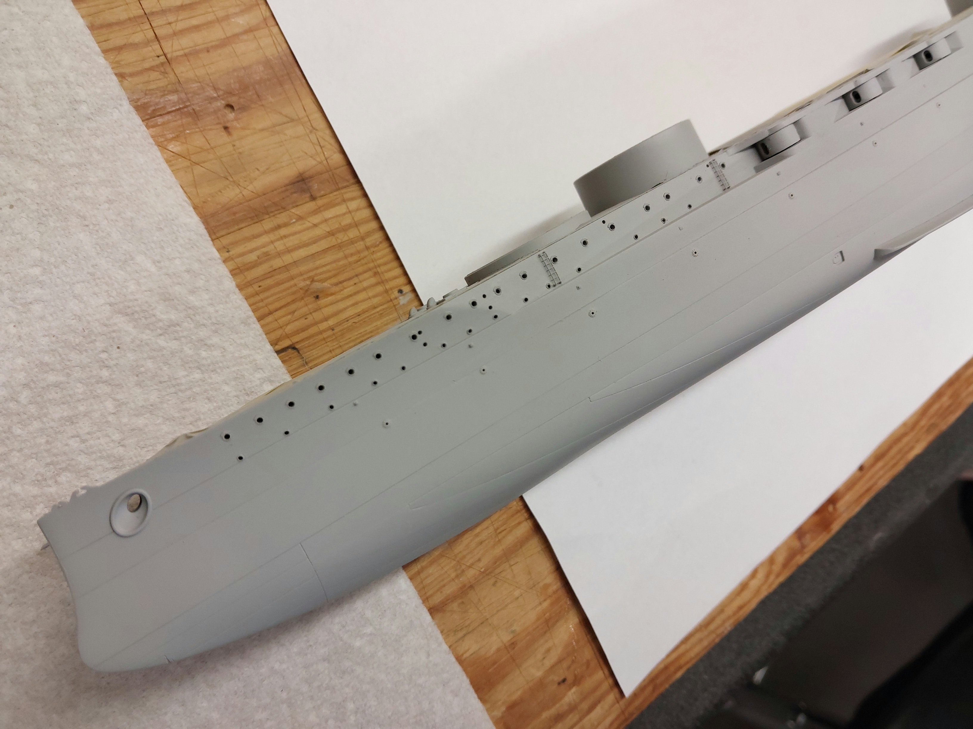

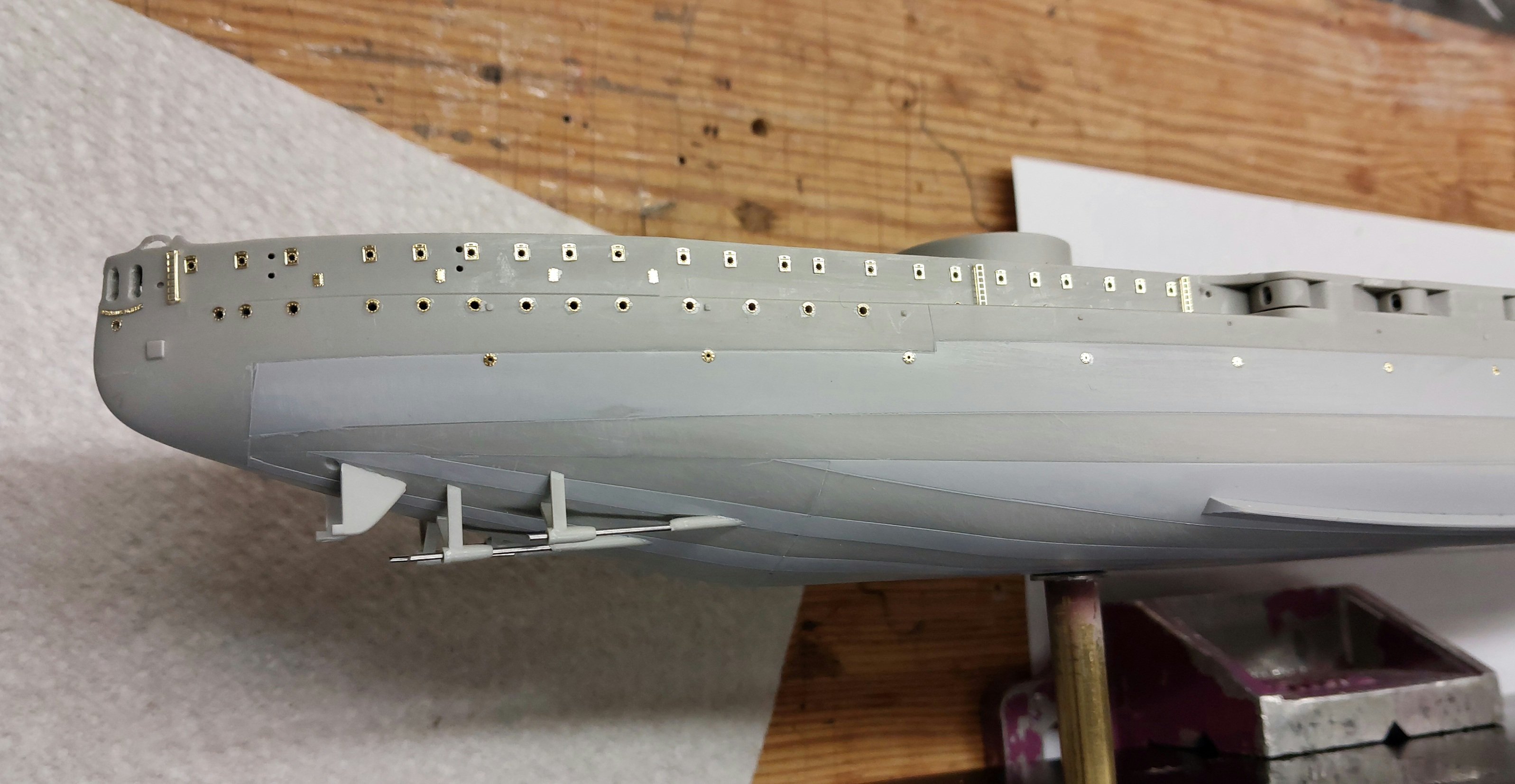

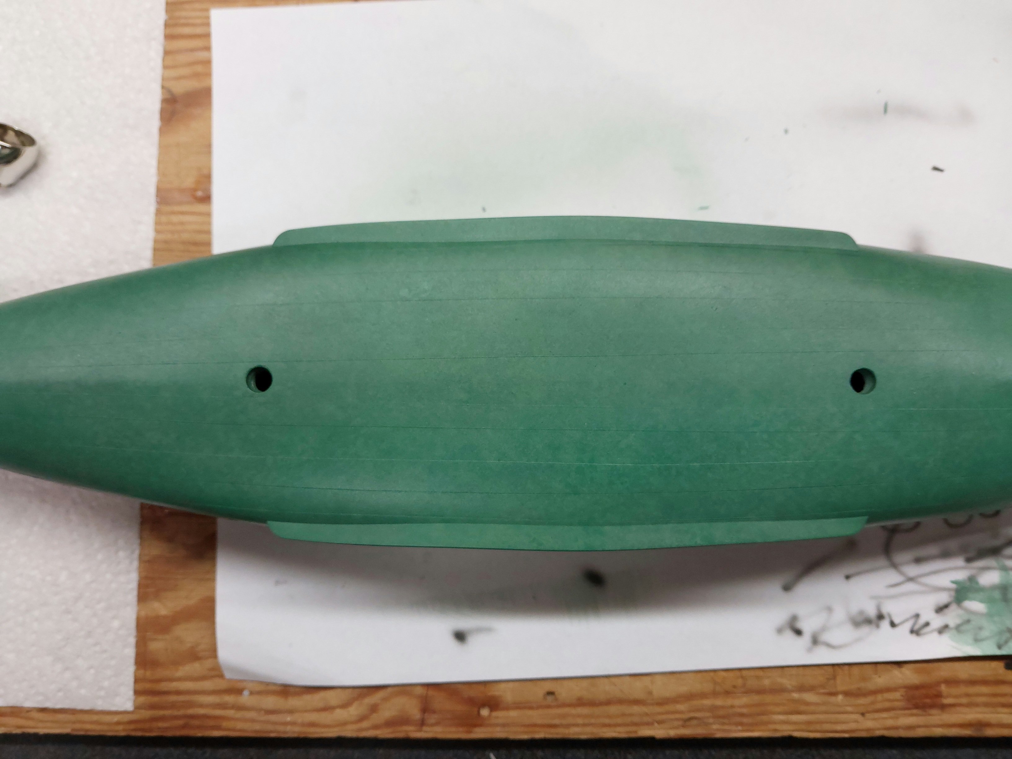

The drawings show lots of overlapping plates on the lower hull but the kit show only a few.20260112_212231.thumb.jpg.1fca272d41dd17c92c434ead5cff0fa0.jpgI added some plates but not the lot on the drawings. After masking I did 5 layers of Mr. Primer Surfacer 1000. After 1 hour removed the tape. Looks OK but hope its enough th see it later.20260112_192106.thumb.jpg.e451837a463cda54c0a8dd44a067b850.jpg20260112_212154.thumb.jpg.4244097c233f40f5d896de22882e54ea.jpg20260112_212132.thumb.jpg.1b8e3209264ae707fe230ae853e00c4a.jpg
I do think it's visible through the surface coating.
I had initially planned to do the same with my Mikasa, but then I solved it using styrene profiles.
Thats a challenge in scale 1/350. Quickly too thick
Edited by Arvaa
That's true.
It's easier for me at 1:200. And I wasn't sure at first if it would look good either. I only knew I liked it once the paint was on.
Take a look at post 20, you can see the result there.

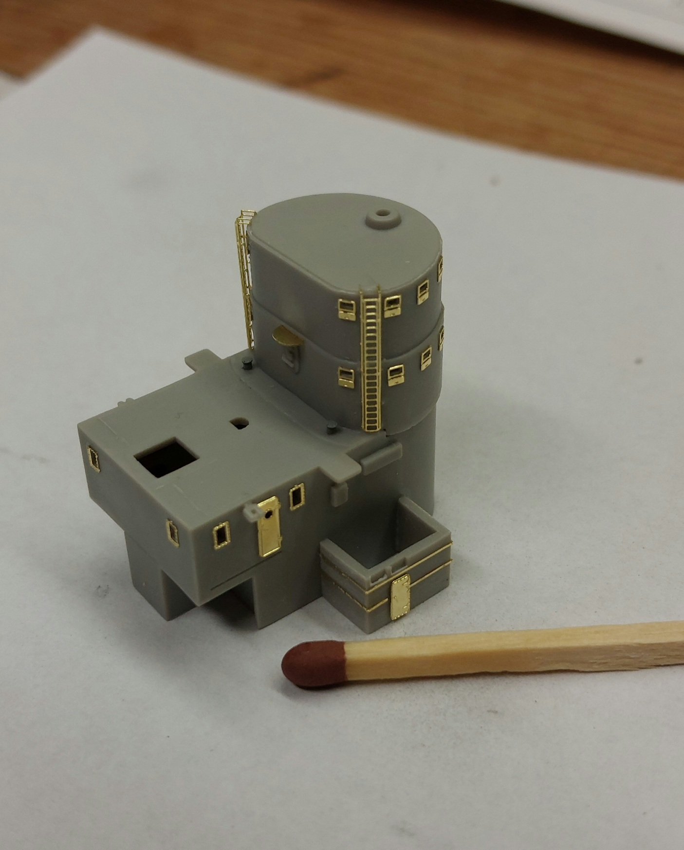

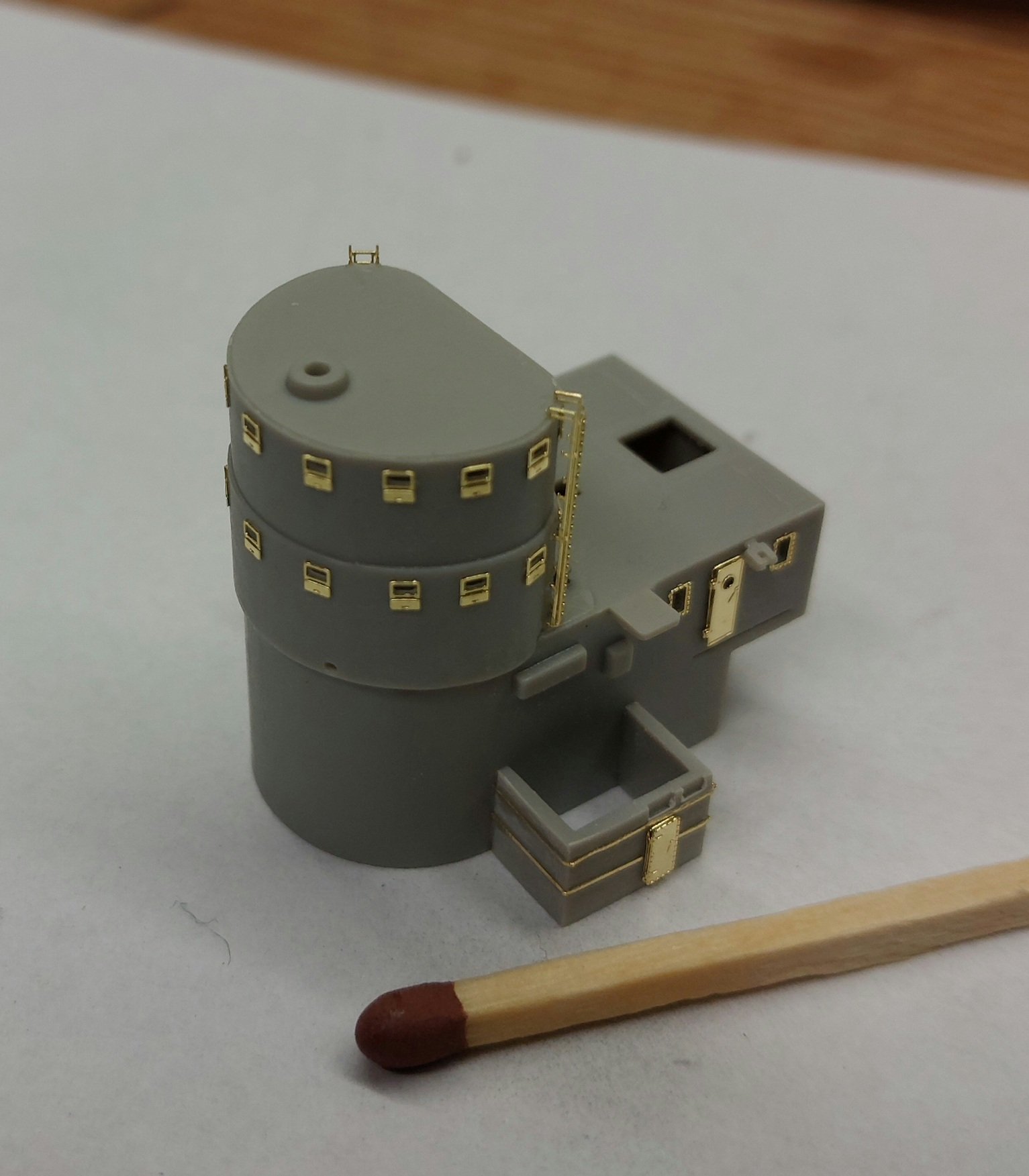

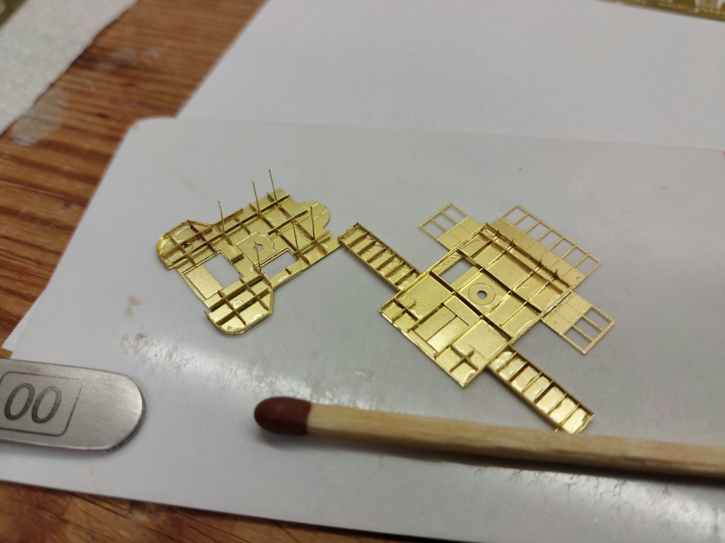

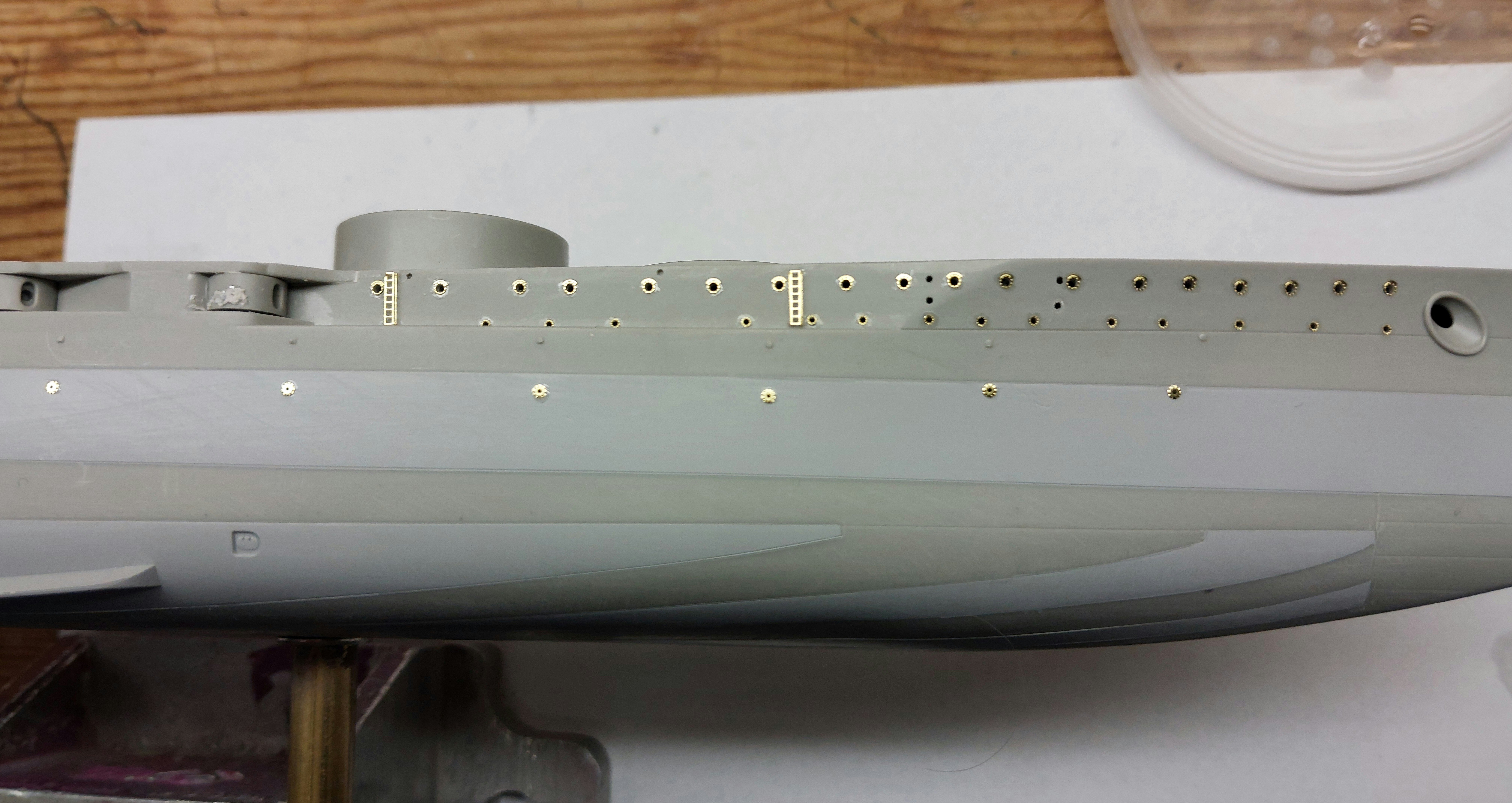

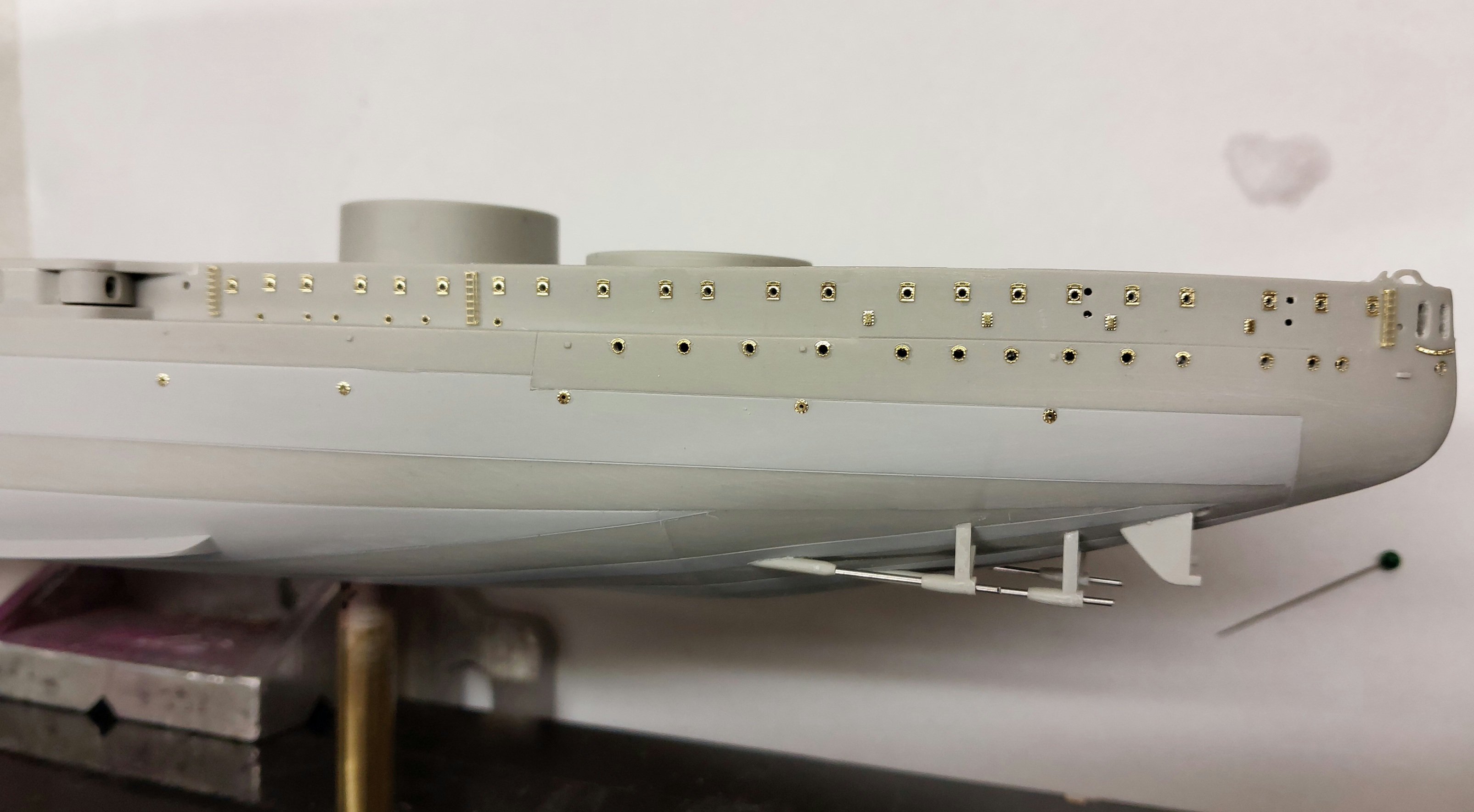

Slow progress. I am not a quick builder.
Did all the PE stuff on portside. Really small parts. I use to glue them with cyano but that leave to much residue. Now I use clear varnish which I apply with a sharp toothpick. Advantage is you have lots of time adjusting the right position. And after it dries it leaves hardly any residue. After drying the  parts stick on the surface surprisingly.
20260117_212931.thumb.jpg.b3fd12ee2cac2e9869354e8a22ec8a34.jpg20260117_213151.thumb.jpg.b502948000850f26cbf3a4664d16e453.jpg

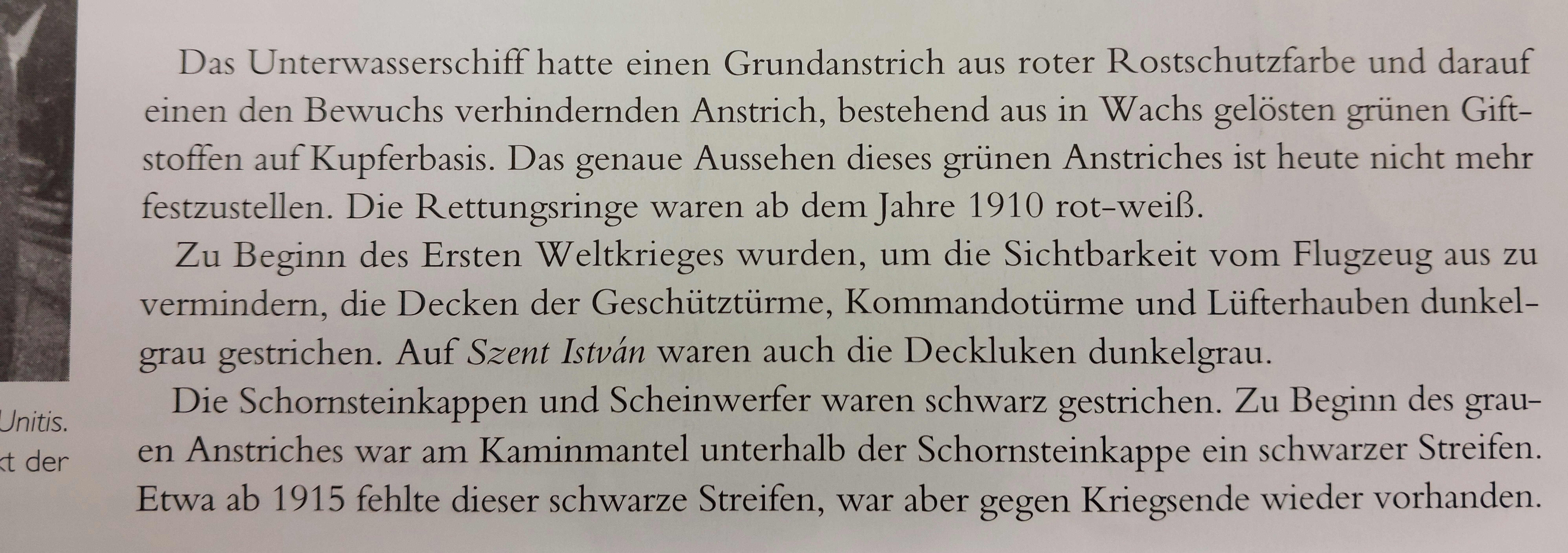

Now the colors to be use. Since there are no pictures in color it is a bit of a guess what it really was. There is some literature about the KuK colors used after 1914.
http://smmlonline.com/articles/austrohungarariancamo/ahcamo.html#:~:text=All Austro-Hungarian pre-dreadnought battleships had the dark,the TEGETTHOFF class were commissioned with this

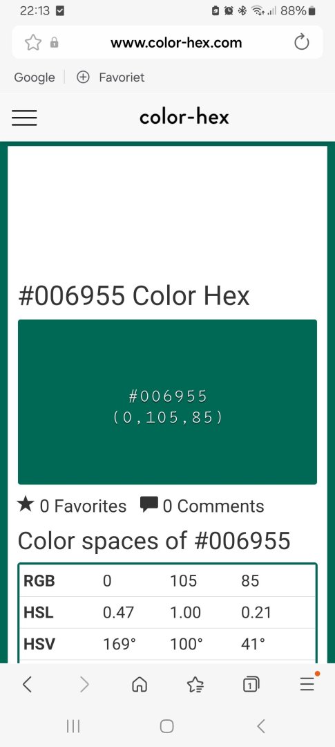

For the upper hull the folowing colors are suggested:
Screenshot_20251208_221442_SamsungInternet.thumb.jpg.c97214b60259ae2d00b2bfaf6da93a6a.jpg

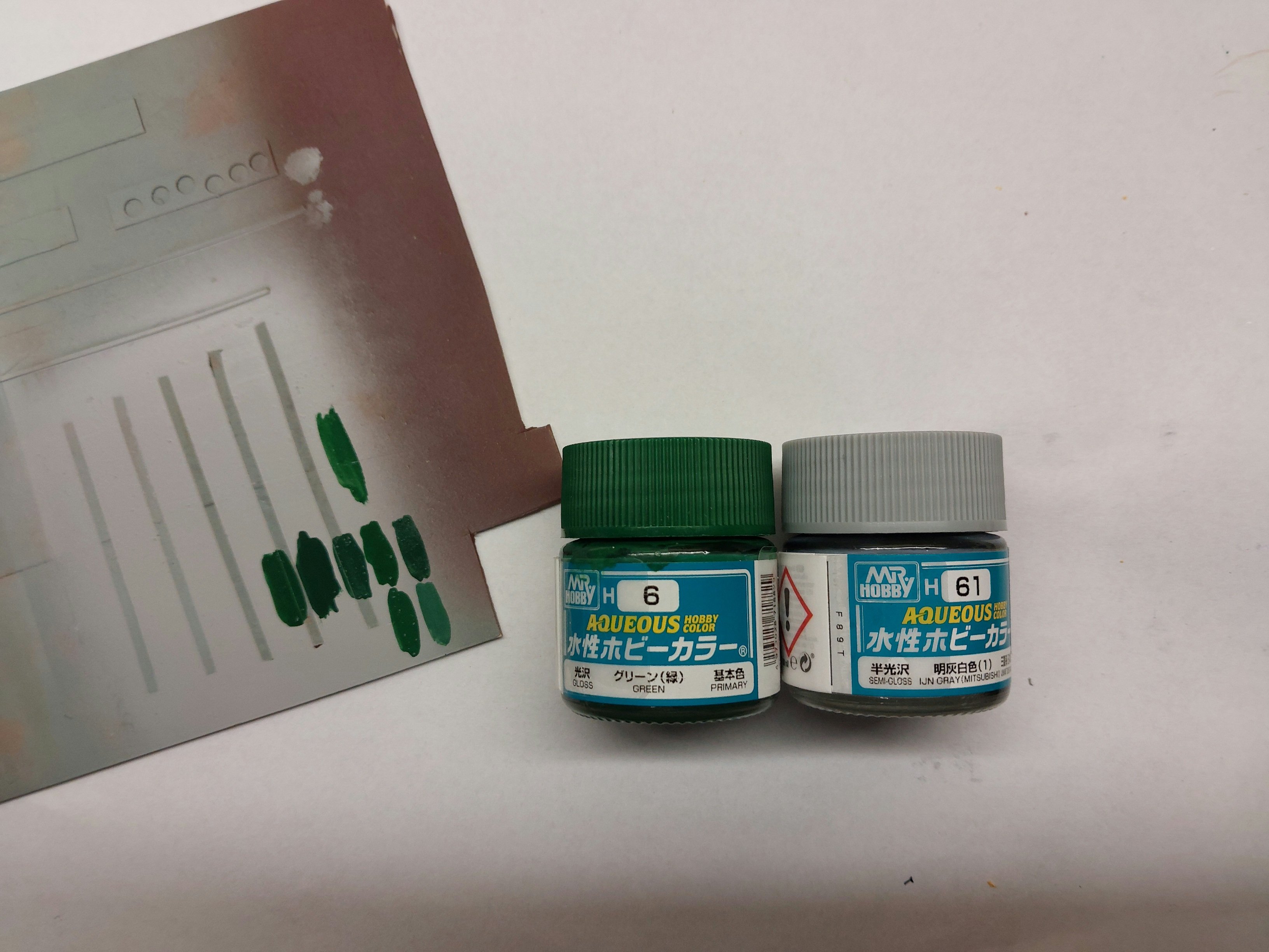

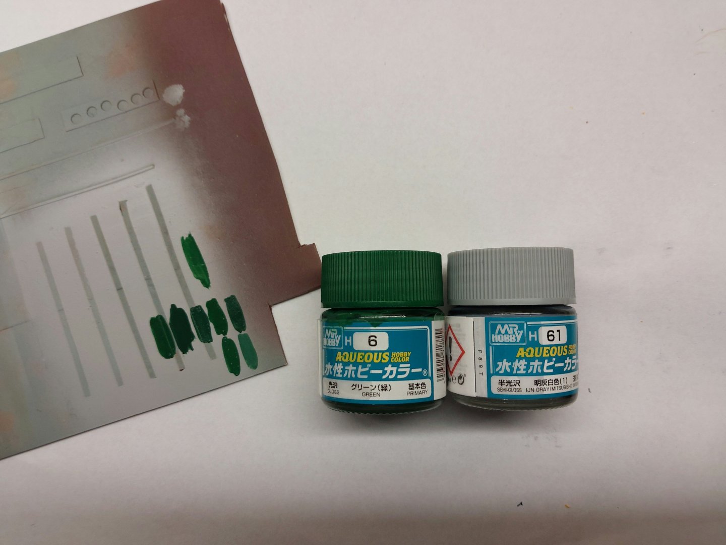

I will use Mr Hobby H 61 for this which is a bit too grey but this will alter when adding a grey-green wash.
Screenshot_20251208_221331_SamsungInternet.thumb.jpg.ef14725ad2424995a12be870ee930a21.jpg

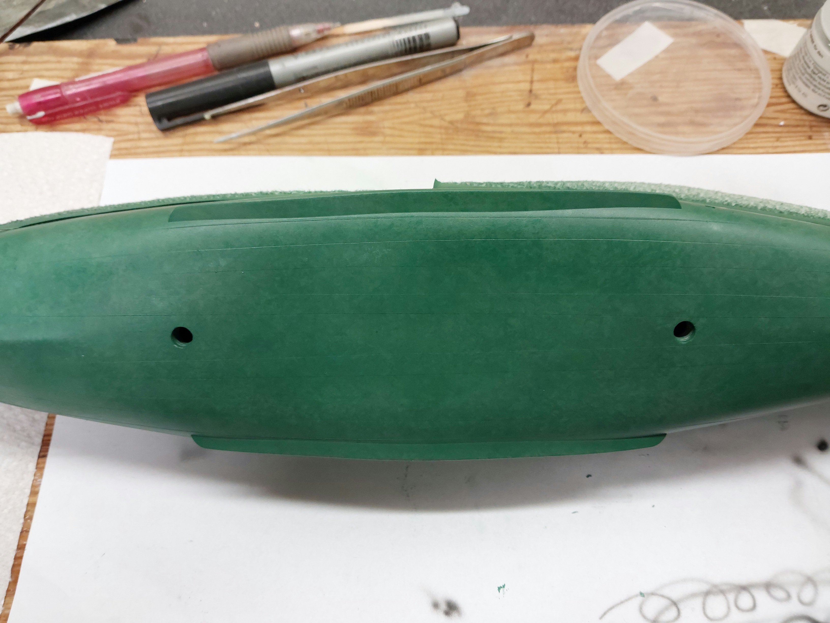

This is suggested for the under water part. Under the green paint there was a red anti rust paint. The green paint was a toxic paint to prevent growth to the hull. I had to make it adding a bit of blue and white to Mr Hobby H 6.

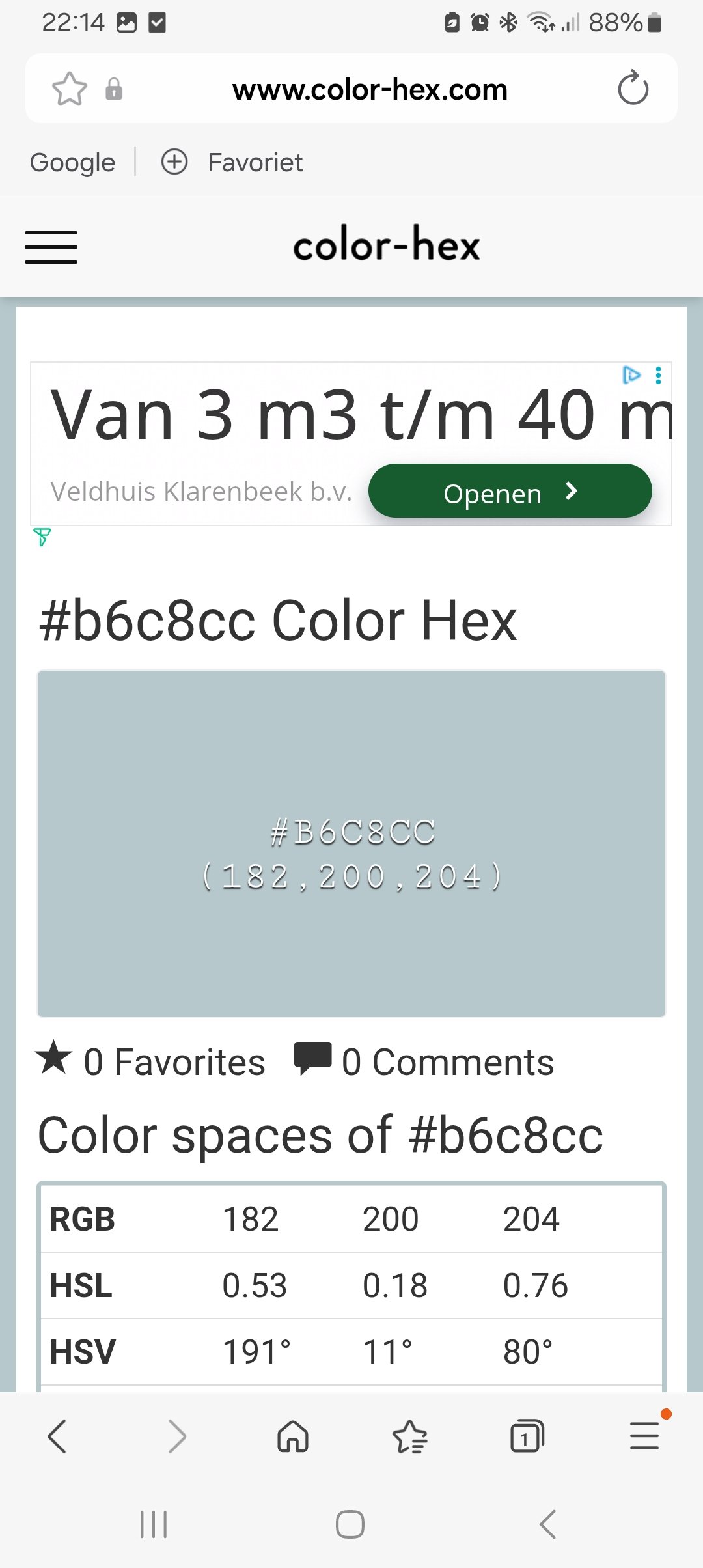

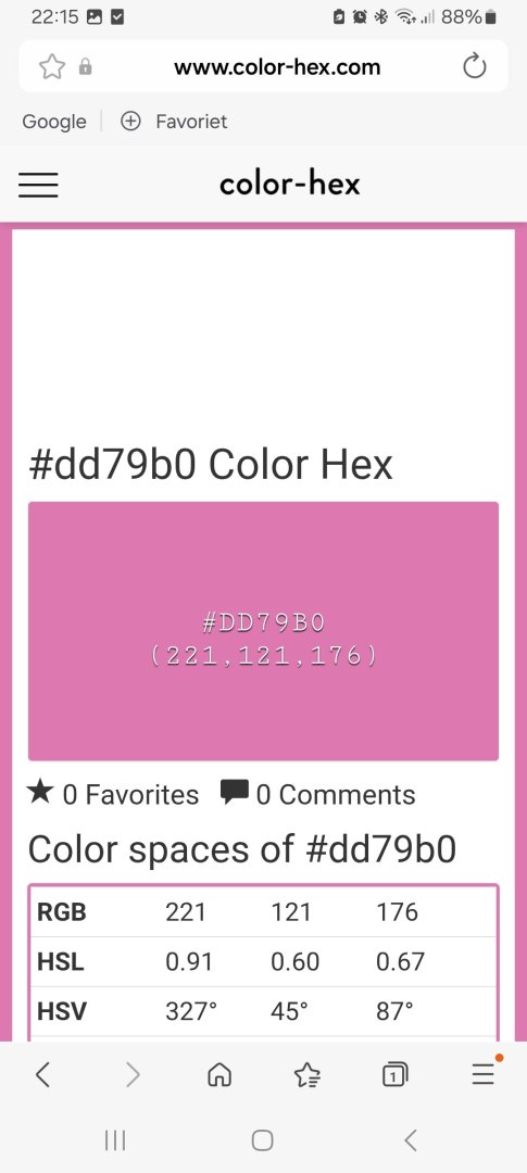

And than the waterline which supposed to be pink.
Screenshot_20251208_221514_SamsungInternet.thumb.jpg.7749a499e123116999dc87c89be4dd8f.jpg
I am trying to mix it since I can't find a suitable paint for this but have not succeeded mixing it from the colors below. Someone have a suggestion?

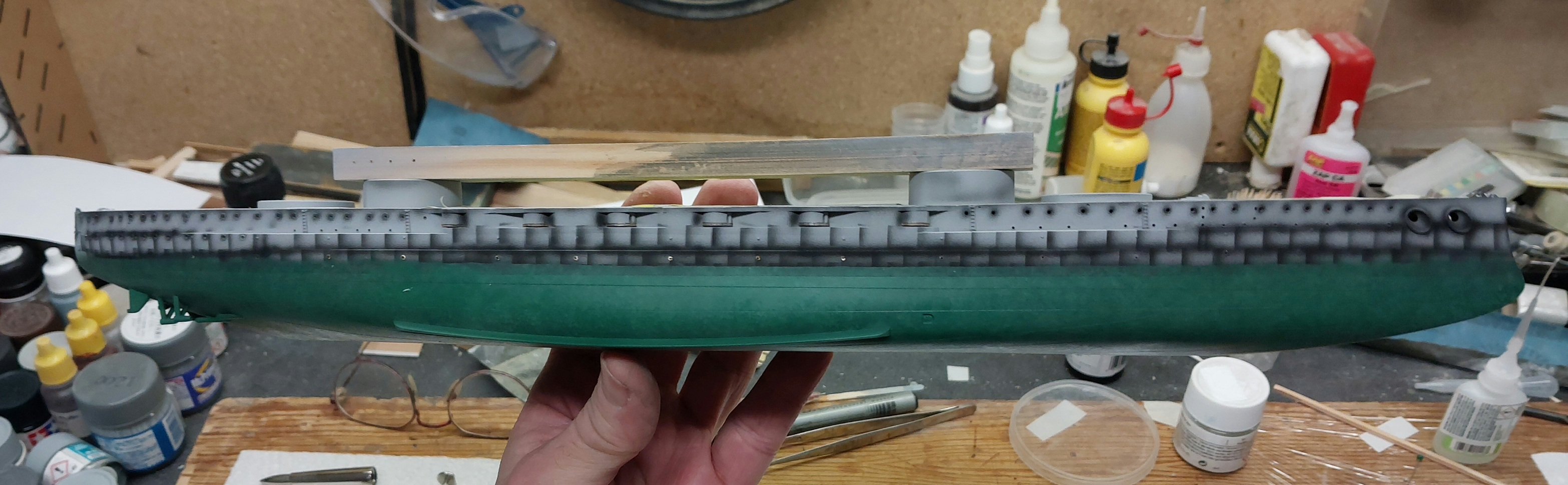

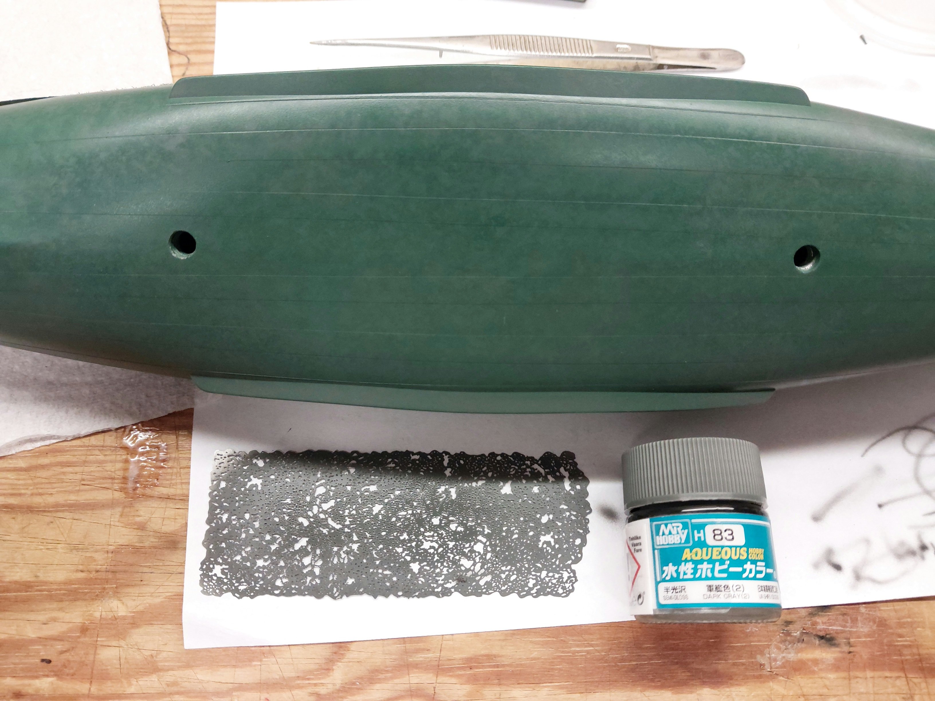

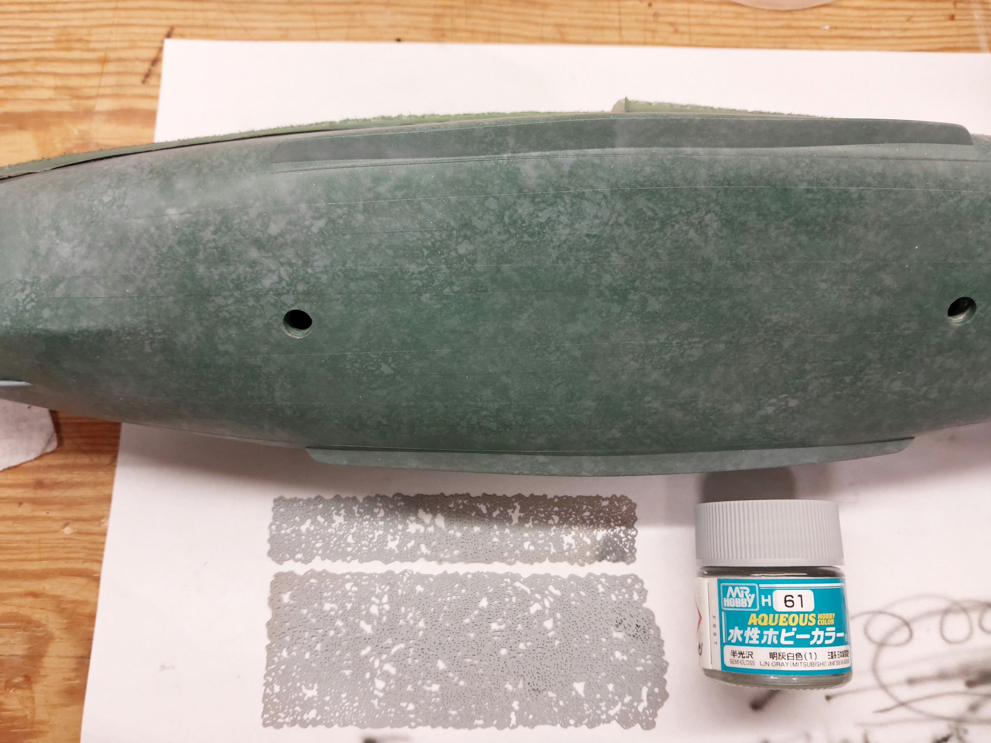

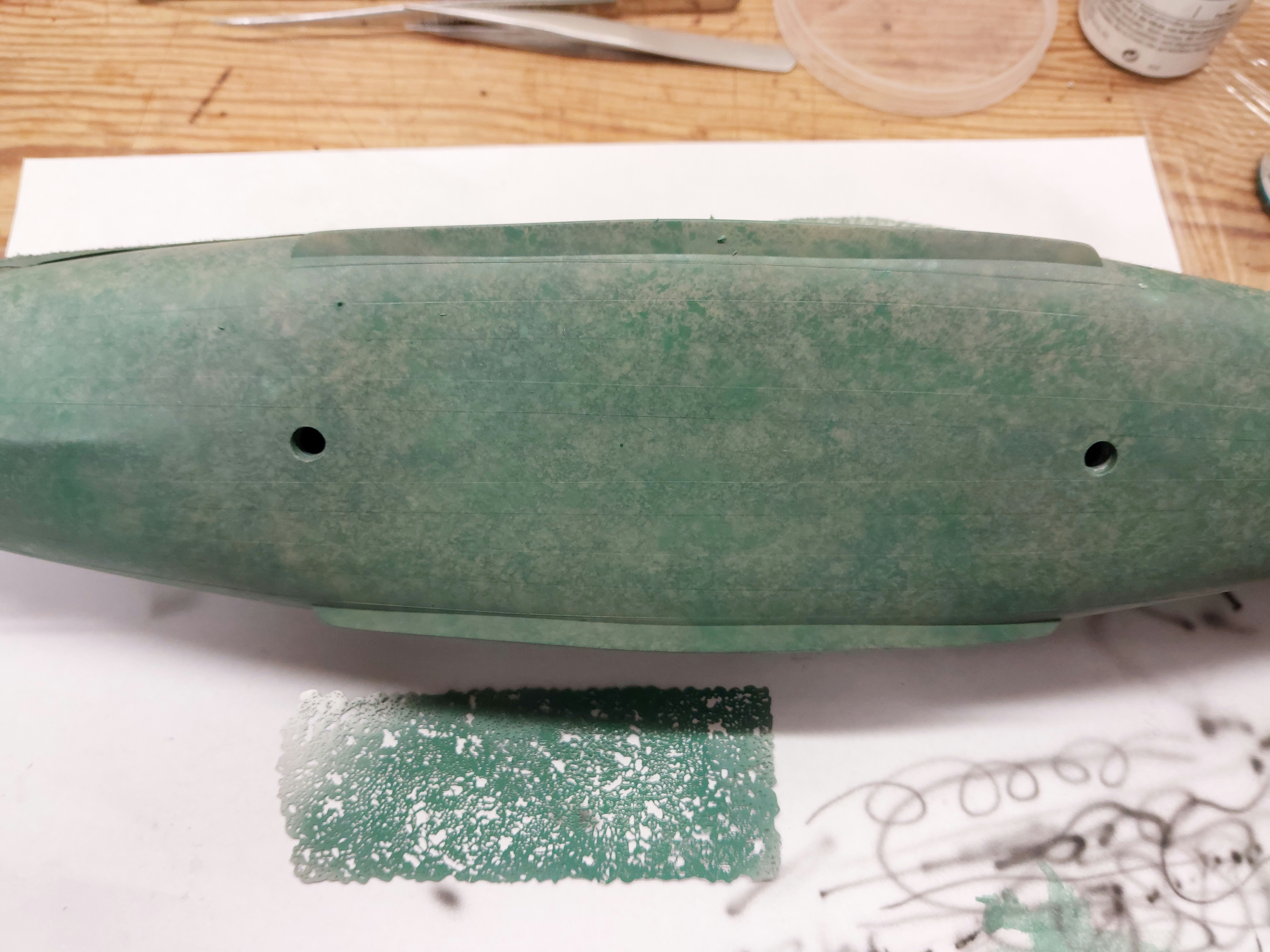

Time to ruin the green hulk.

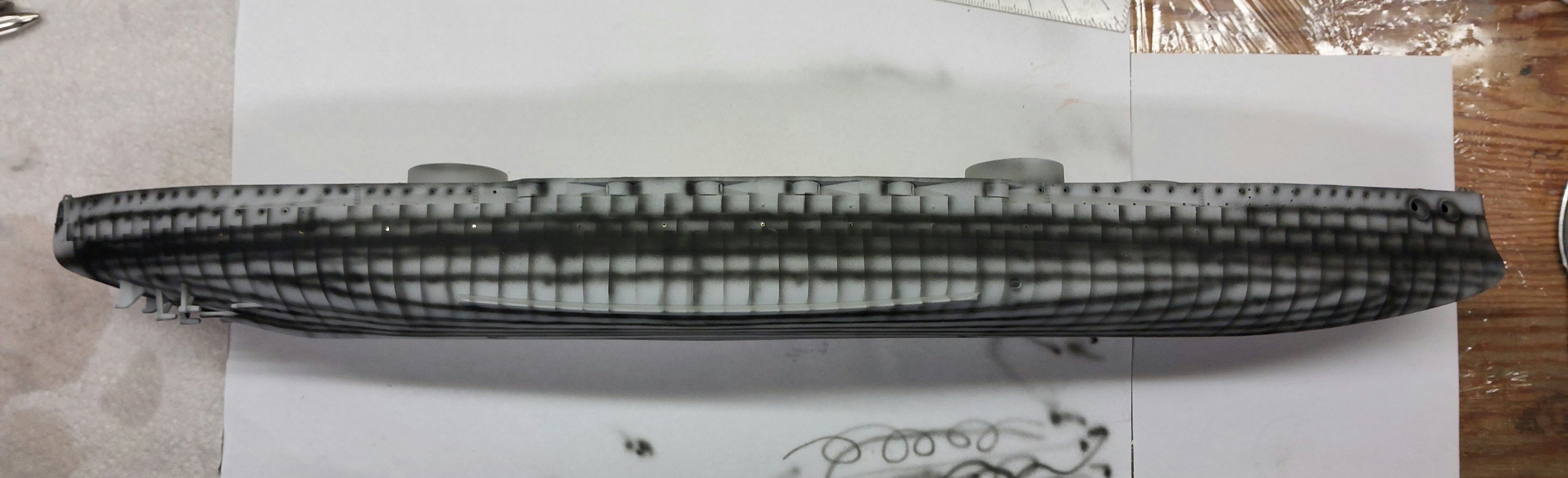

First dark grey applied with a camo stencil.
Than lighter grey.

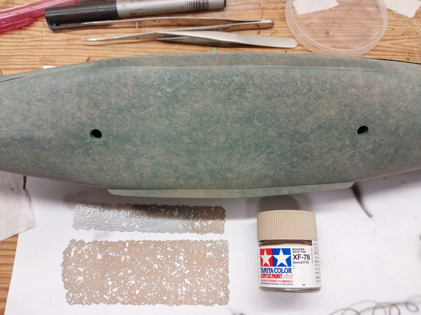

Than wood color.
Than a lighter green.
Than a filter of the original green to get the color back.
The green is now a bit spotted because mr hobby is semi gloss and tamiya matt. Therefor did a filter of 2/3 matt and 1/3 semi gloss varnish.
Took about 4 hours of spraying. Pffff.20260131_183444.thumb.jpg.5b2383cf75ea134cd3ded9d2a2b7a6a9.jpg
