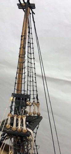

Main top stays in place. Couple of observations here: Making a mouse is an art beyond me. others have tried and they come out a little large. I decided to save time and just use the beads included in the kit: I was correct that the main top stay can be assembled off the model and installed. No problem there. Can't be done with the preventer stay as it has to pass down through the fore top and won't fit if the fiddle block is on the end of the stay. Found that out the hard way. Anyway, they are both ultimately secured to hooks and eyes at the foot of the foremast. Try and find them in this forest!

As to the main topmast stay and preventer, I'm going to try something different. The plan calls for a double block at the end of the stay where in goes to the deck. My muse (Delf), has substituted that fixture with a fiddle block. I don't know why, but I have about 15 fiddle blocks that I got from Chris way back when, so I don't remember why I bought them. Un any event I thought i would follow Delf's example and use a fiddle block there at the end as well. Also, I think I can assemble the main top stay off the boat and then attach. Maybe a little easier? Main top stay goes first because it runs through a block attached to the foremast below the hounds whereas the preventer stay goes through a block attached above at the doubling. Notice the block with the hook in the upper left. Its lanyard needs rigging through the fiddle block and then the whole assembly can be mounted on the ship.

Thanks for the "likes" and attention. Trying not to bore you! There are many Speedy logs far better than mine. As I mentioned previously, my big challenge was in reconfiguring the hull to accommodate the aft cabin and quarter deck. I think I've done that, and the rest of this is just building out Speedy. Except that in the book there are references to royal sails. Gotta do that too. Anyway, one of my mentors (muses) is Delf from his log back in 2020-2021. One of his concerns is how to load the serving machine without wasting line. He splices extra line onto the end of the stay/shroud he is serving to cut down on the waste. I sympathize, and do it this way: Just grab the end of the line with an alligator clip, no need to wrap line around the nails! Maybe Chuck designed it that way to sell more line? Next up, I've gotten the foretop stay and preventer in place: We're looking at the preventer stay side. It comes down through the bees and ends aft in a double block (see crude arrow!). Then the fun part starts. There's a single block in that forest that has to hook on an eye in the hull. Took a bunch of tries, but I got it. On both sides!

Been awhile since I've written anything. I think I mentioned that I hate doing ratlines. It's tedious and they never come out looking ship shape. But I finally ran out of excuses to putting them off and finally finished their installation. Also, put in the top mast backstays, and I'm now letting the glue dry on the serving for the forestay.
