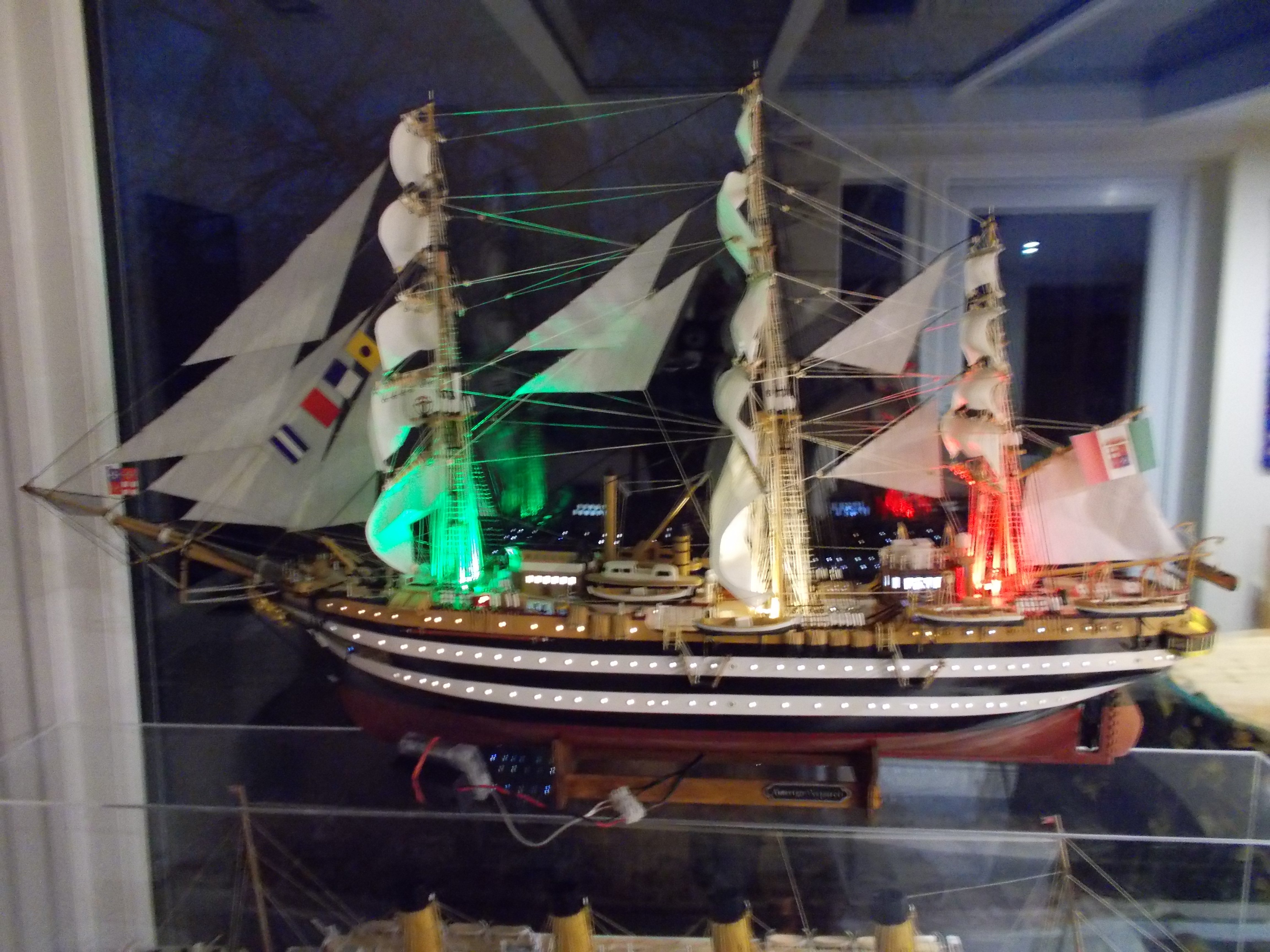

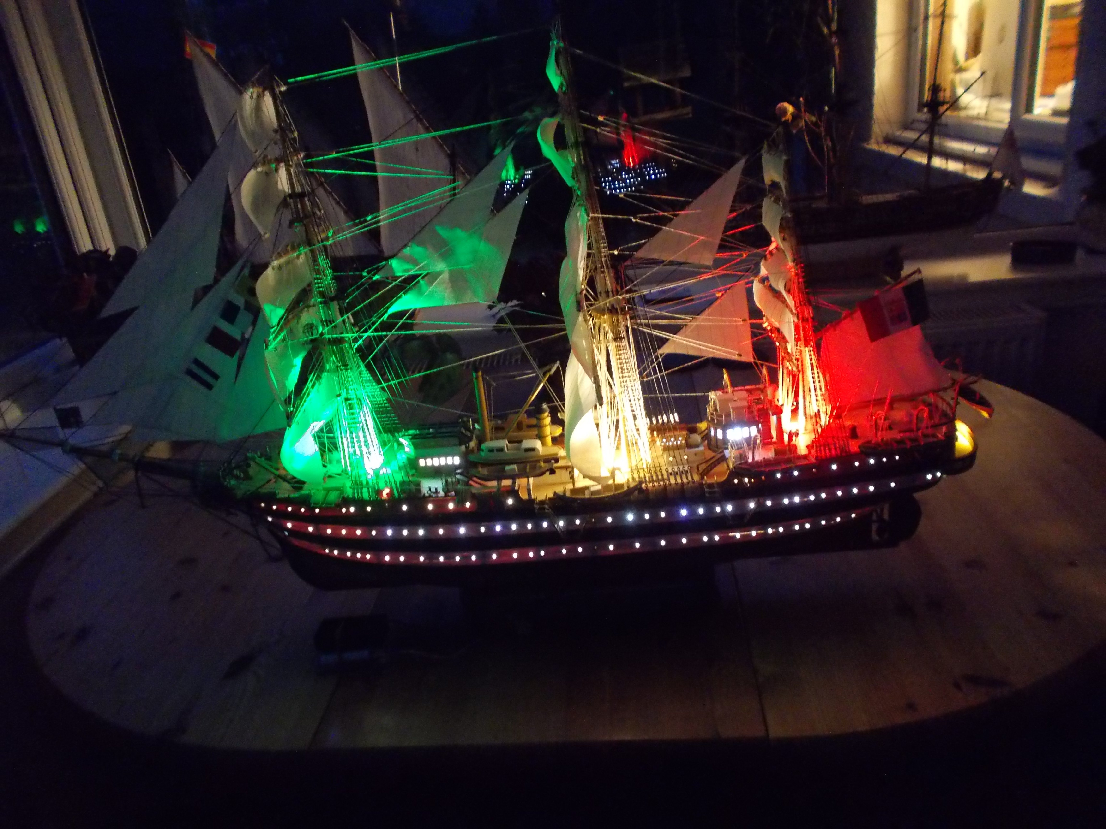

So,here she is in all her glory!! I am glad that I altered the bow to be sharp like the real vessel, for some reason Occre had it quite blunt. In the end my version of the ship is a mixture of her various incarnations over the years like various colours of the masts, placement of portholes, different pinstriping etc. I am quite pleased with the end result. For future builders the rear handrail on top of the stanchions is a real beast to put on. I love the beauty of tall ships and how elegant they are but the rigging is a nightmare, so many ropes and so little room but the perseverance is worth it.
