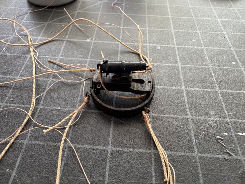

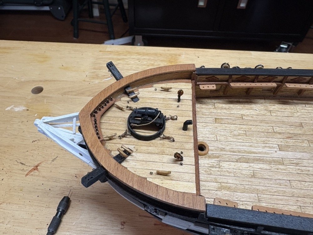

  1. I installed the gun on the fore deck by gluing the eyebolts into the deck and I put a few small dots of CV glue under the ring. I also added all the other eyebolts, cleats, and blocks to the fore deck.

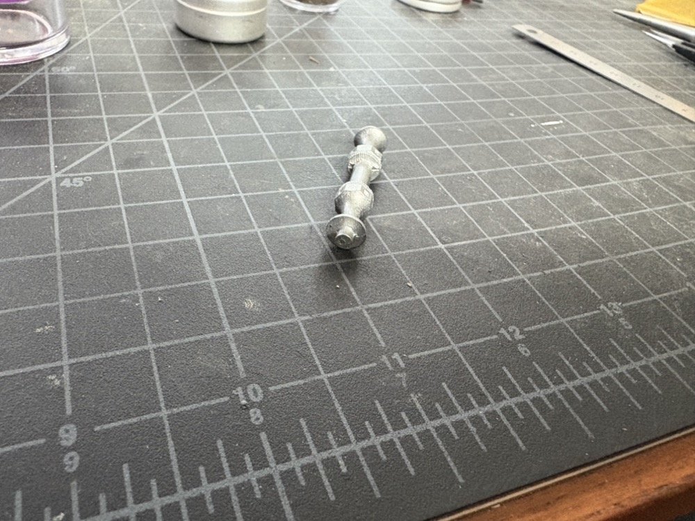

  2. I have been working on the gun for the fore deck using mostly the kit supplied pieces. I am using smaller eyebolts with the kit supplied rings to make the ringbolts that hold the gun down. I added a short length of a brass screw under the back of the gun for the elevation screw instead of the eyebolt the instructions called for. Here is the gun with four lengths of line seized to the ringbolts. These will be tied to four ringbolts in the deck when the gun is installed. I have also started building the windlass, again using mostly the kit supplied pieces. One change I made is that the instructions show a loop at the barrel ends of the handles that go around a nub that sticks out of the ends of the barrel. I instead filed off the nubs and drilled holes in the ends of the barrel so I can leave the ends of the handles straight and glue them into the holes. I am now priming and painting the barrel and assembling the upright support pieces for the windlass.
