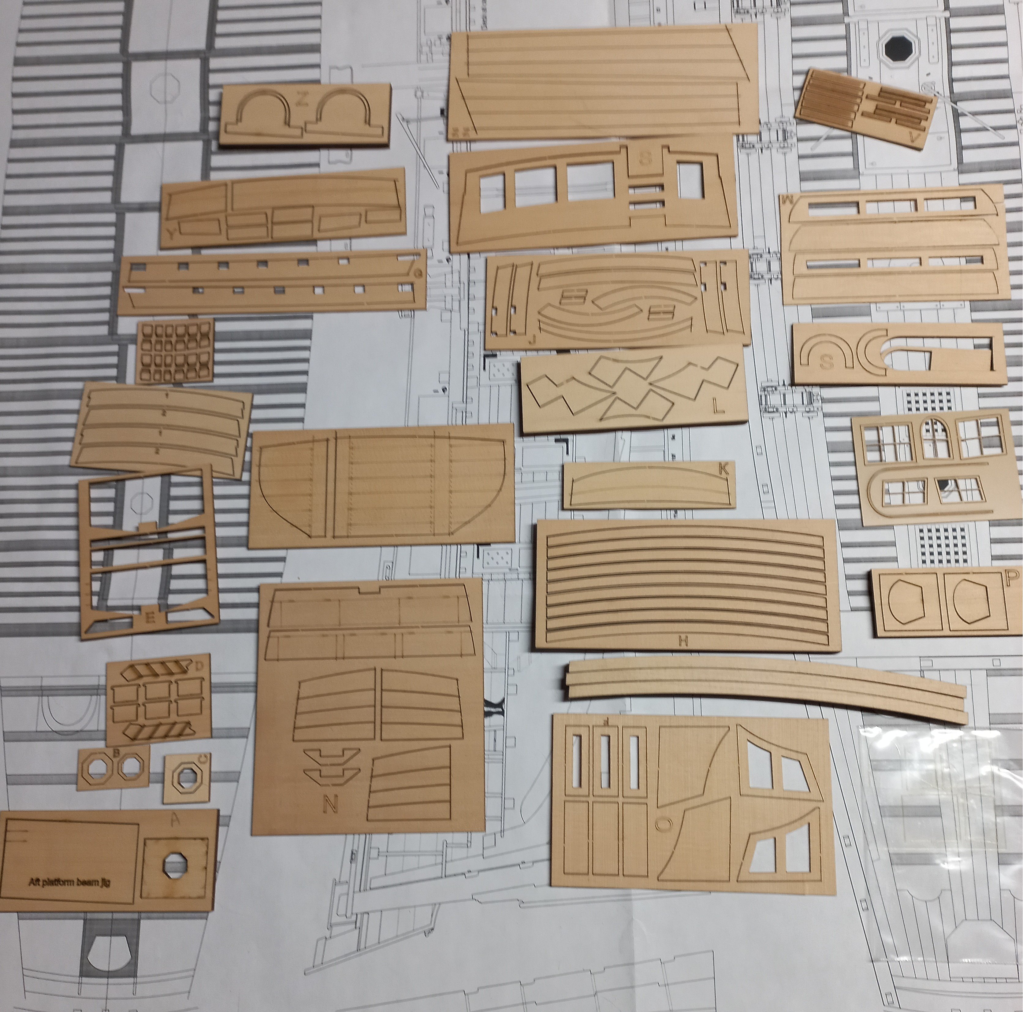

Chapter 5 I received Chapter 5 yesterday and started on it. I show below the parts received: I recognize most of the laser cut sheets as discussed in Chuck's log. Sheet Y seems to replace the second layer of the upper bulkhead S (the part with the column etched on it in Chuck's log). The monograph of Chapter 5 should clarify that. Anyway, a lot of precise work ahead of me.

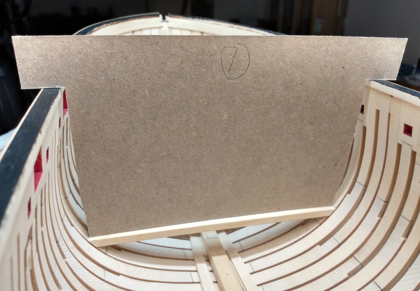

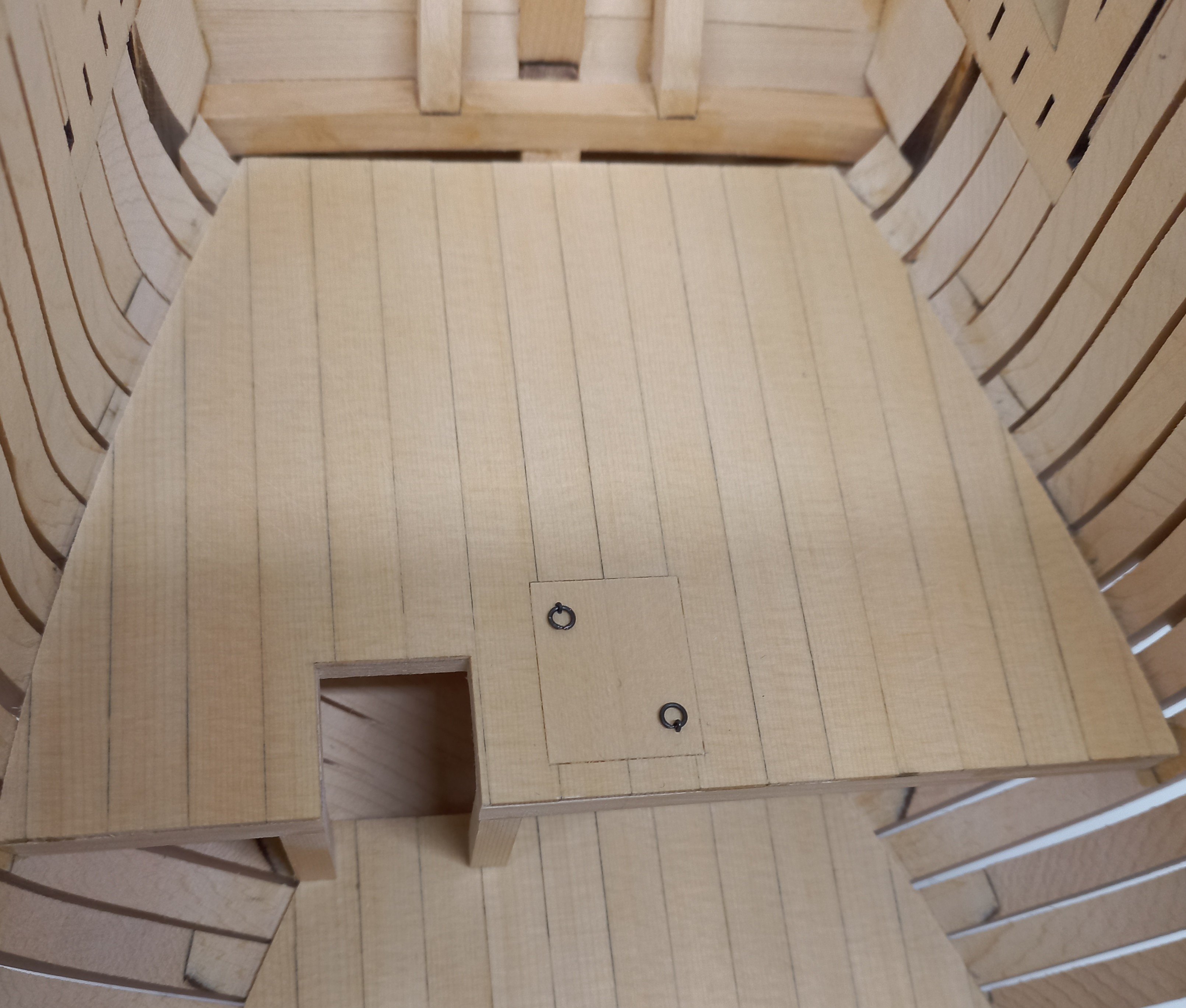

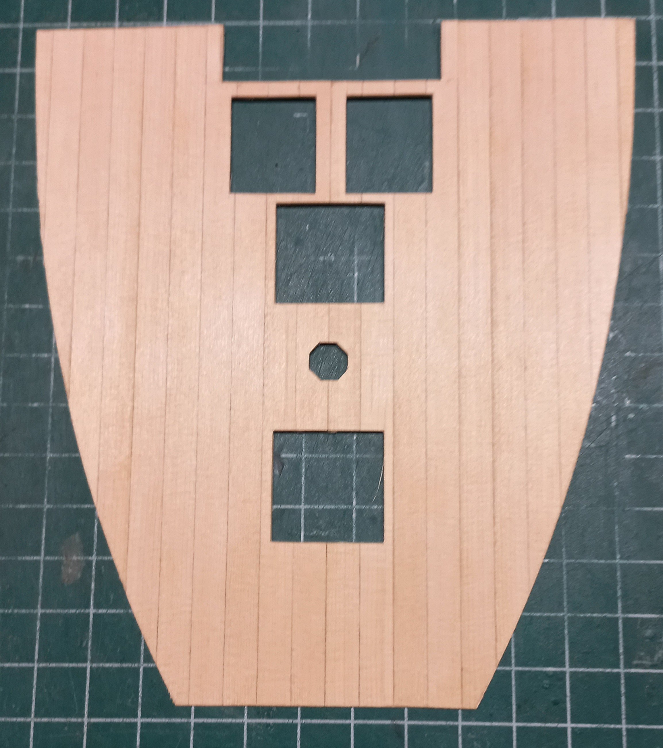

Cabin Planking I do not want to stay idle on this project and got on to do the cabin's planking. I first checked the aft platform height with the planking extension template. The fit is very good as seen below. For this I had to scratch the beam clamp. Thanks Chuck for providing the drawing. It is a relatively easy task, the main challenge being to make exact mirror copies port and starboard. I was happy with the outcome: I used the template to scratch the planks. Those are a bit tricky to glue on because of the subtle bends and the challenge to clamp those in place. Here I used modified clothespins to secure the planks in position: The next photo shows the finished work. A bit of a gap aft, but this will be hidden when more parts are added. Aft Lower Partition I decided to scratch the aft lower partition as well. I followed the plan carefully and made minor adjustments to fit my model. Very little adjustments were actually required, which is nice. Nothing is glued yet and a little more narrowing at the side is needed to account for the inboard planking. Notice here that the midship beam clamps are also installed and a beam was scratched to check the partition positioning. Everything seems in good agreement with the plans. The work on this section will resume when parts become available. Fore Partition I decided to scratch this section as well. It is a fun little project and there is to char to remove! The parts copied from the plans fit nicely. Again, nothing glued yet. I also started to work on the fore castle. I installed the beam clamps and scratched a few beams. More on this later.

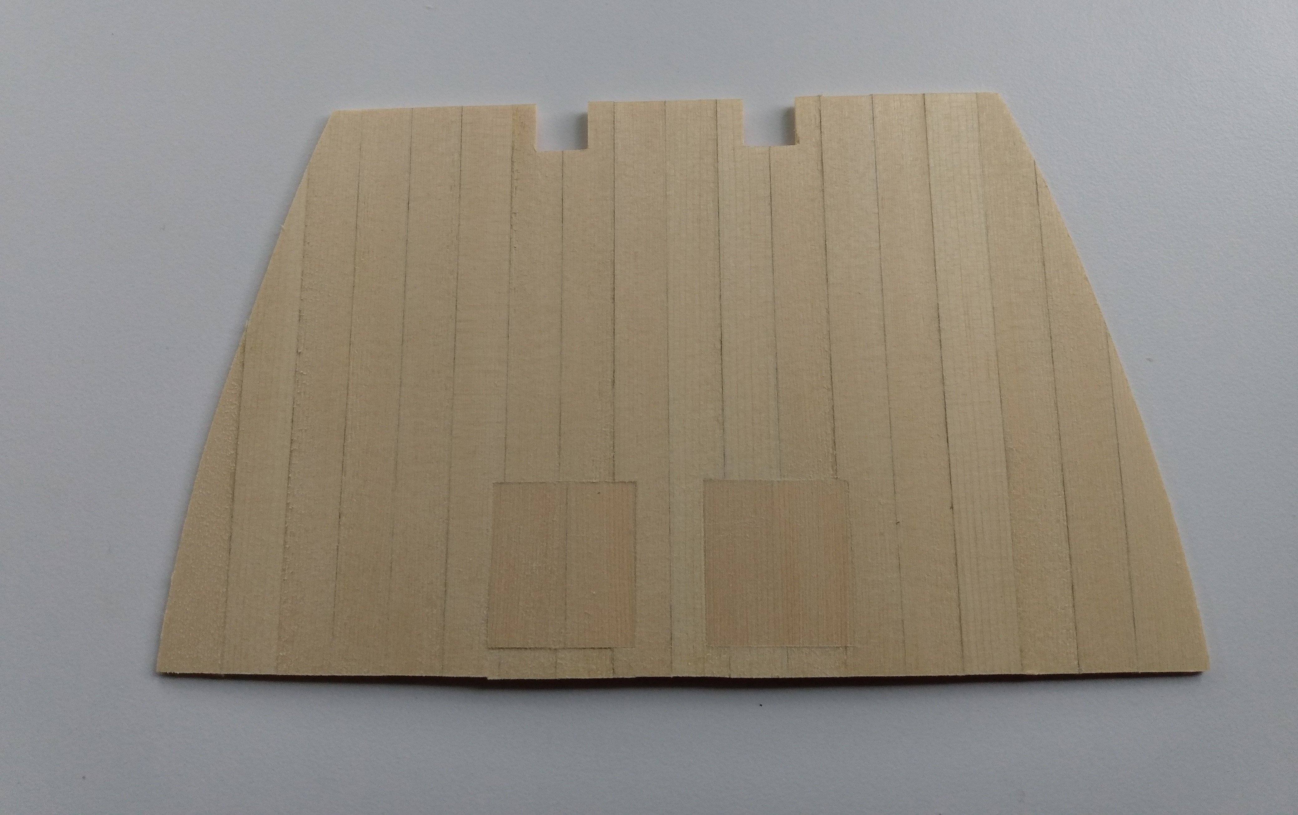

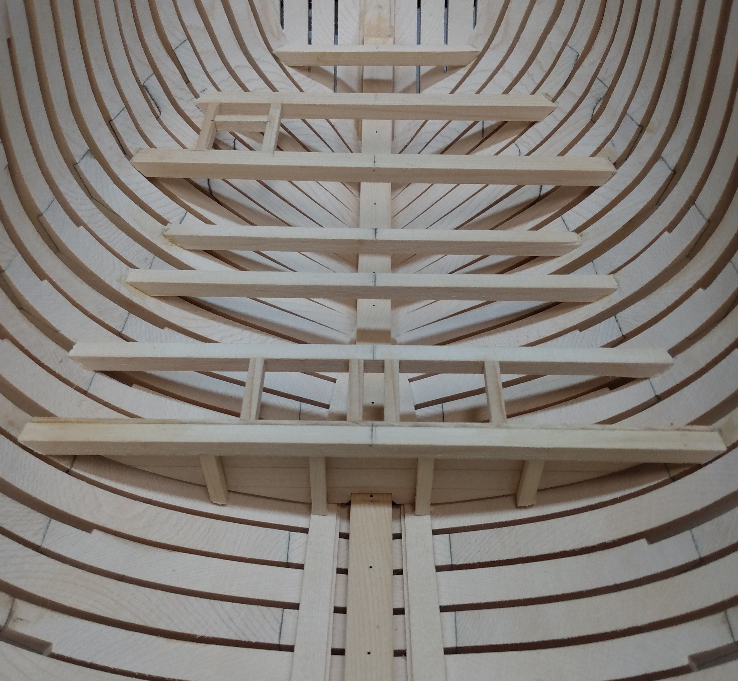

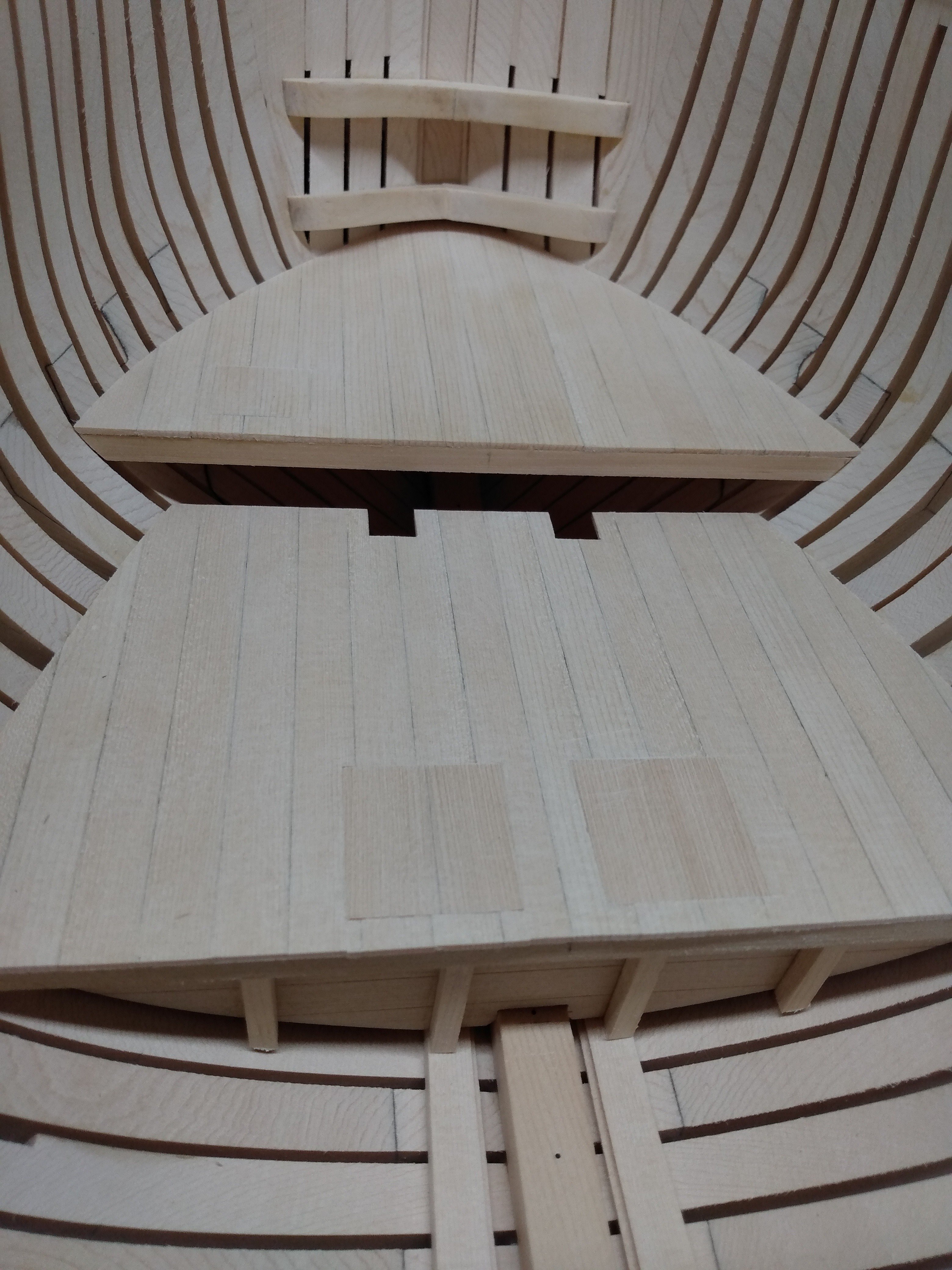

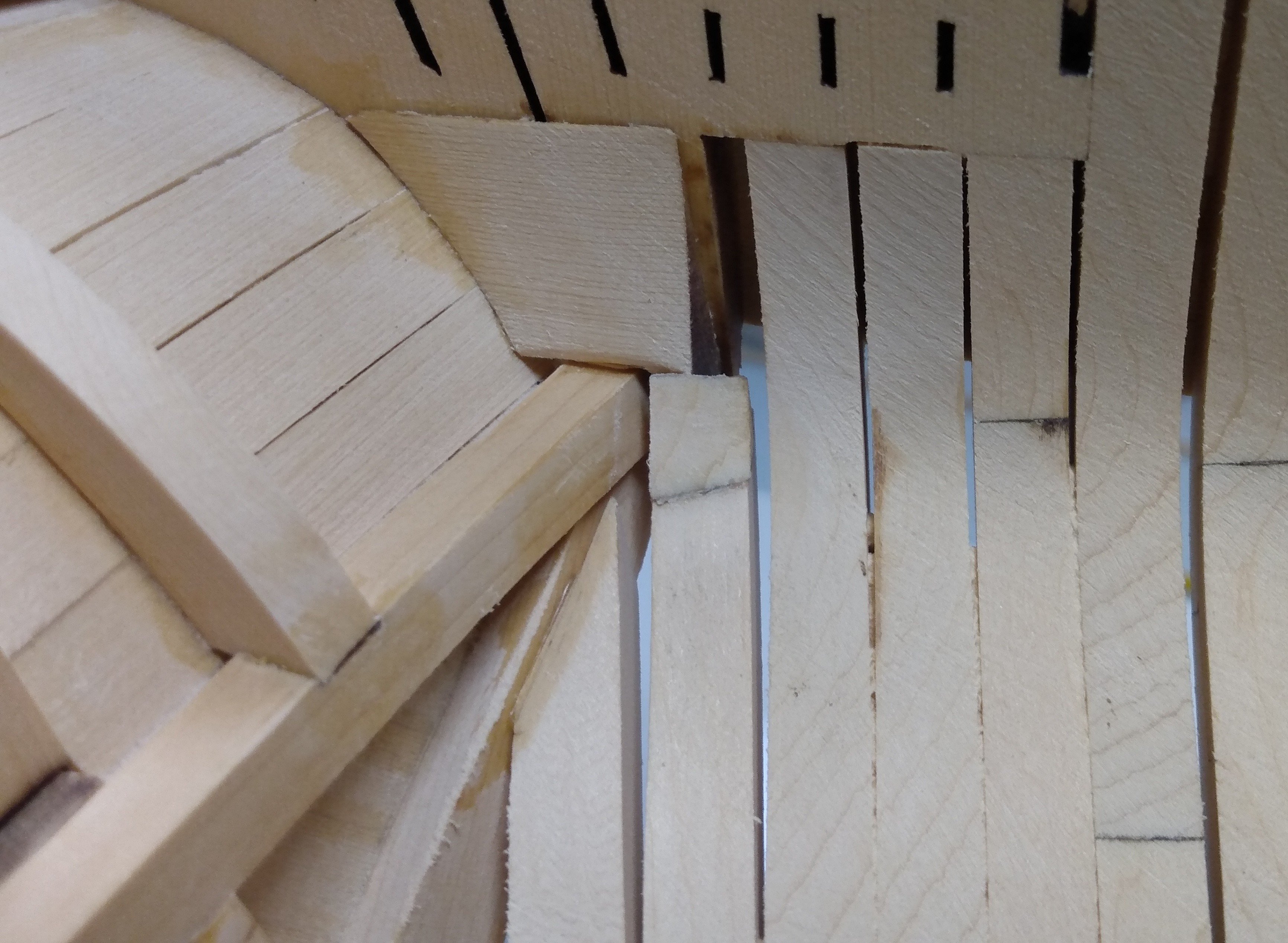

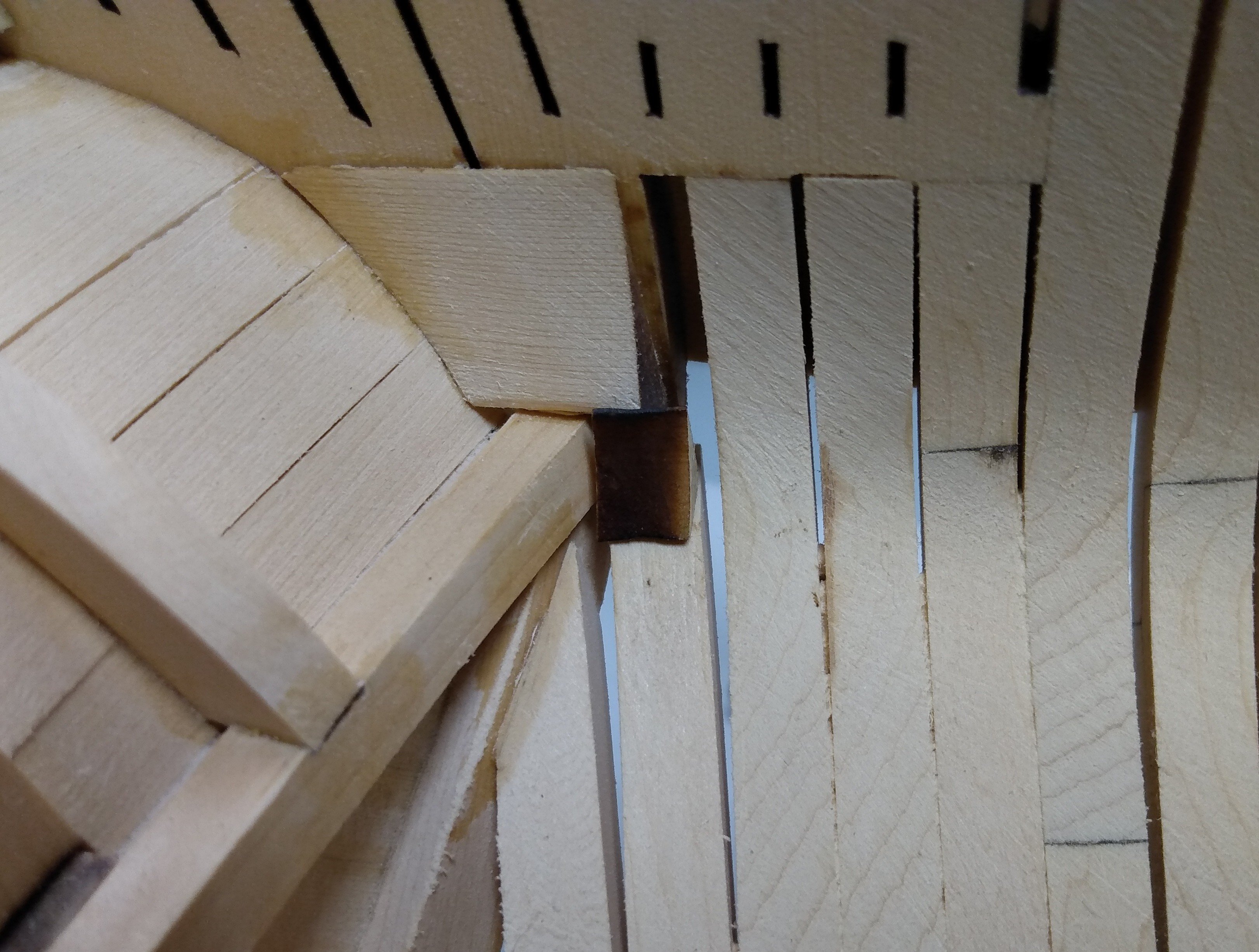

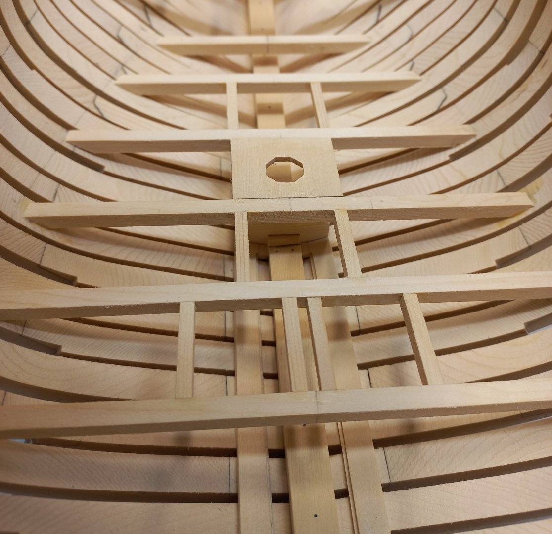

Aft Platform Time to report on my progress. This time it is the aft platforms. But before doing that, I need to mention that I finally discovered where the small triangular pieces of chapter 2 are going. These complete the last cant frame at the transom as shown in the photos below, before and after fairing. Yes they can be omitted, but they should help to secure the corner of the side plank that will be glued later. For the platform framing, I proceeded as before with cardboard height references. To get to the proper height I needed to do more fairing of the frames. It is a bit tricky to get all those beams a the right position with clean adjustment at the frame. Here it is very helpful to work with a card board template of the platforms. I found it easier to assemble the platforms separately. It easier to cut out the hatches and sand the planking. The upper platform was done the same way. Adjusting the upper platform height is easier as the bottom platform and the bottom of the transom can be used as reference for the fore and aft ends, respectively. The inboard great cabin planking expansion (plan sheet four) is also useful to check that the upper platform is at the correct height. Here are a few shots of the completed platforms. I can now probably do the cabin wall planking while waiting for the next chapters.

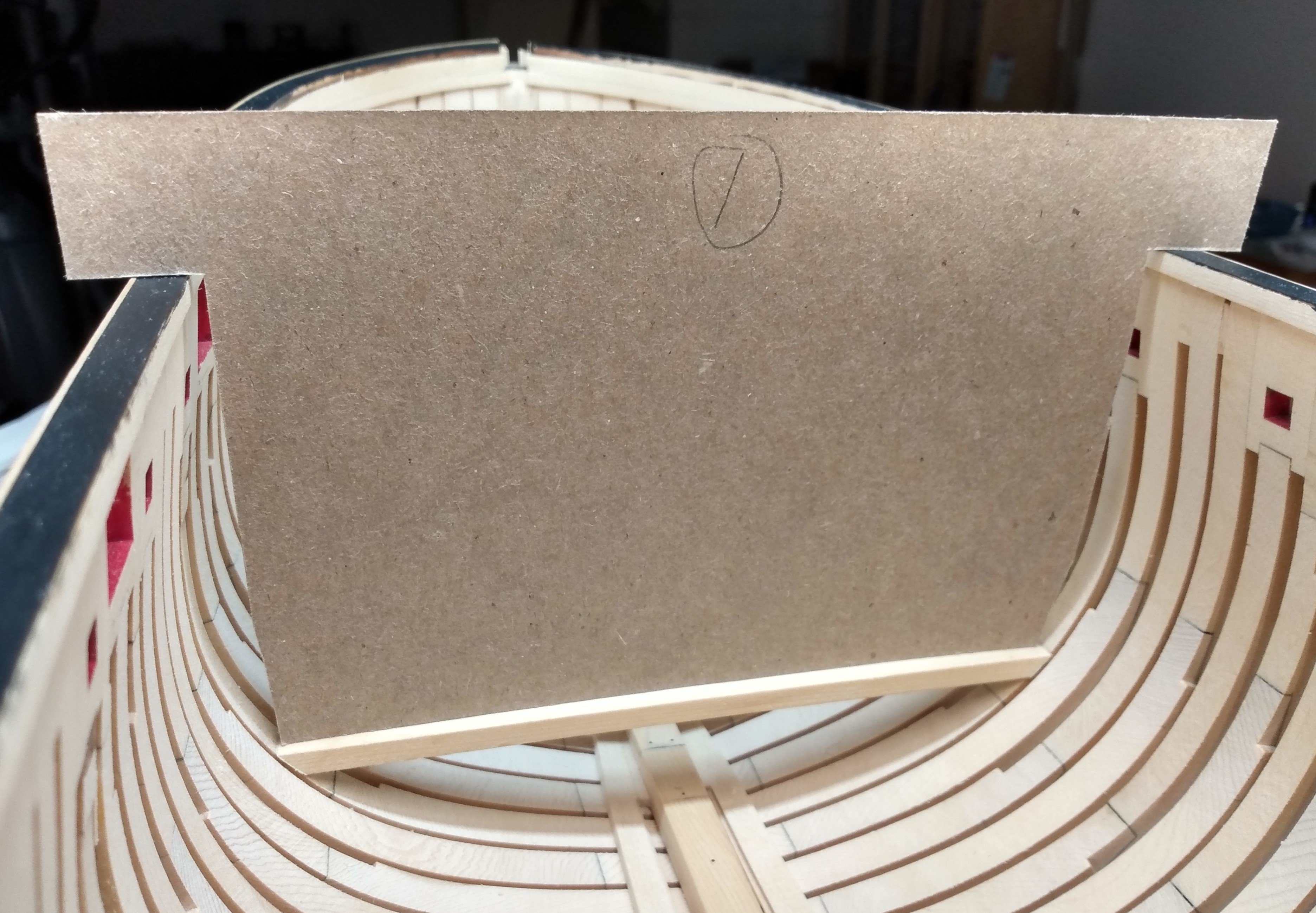

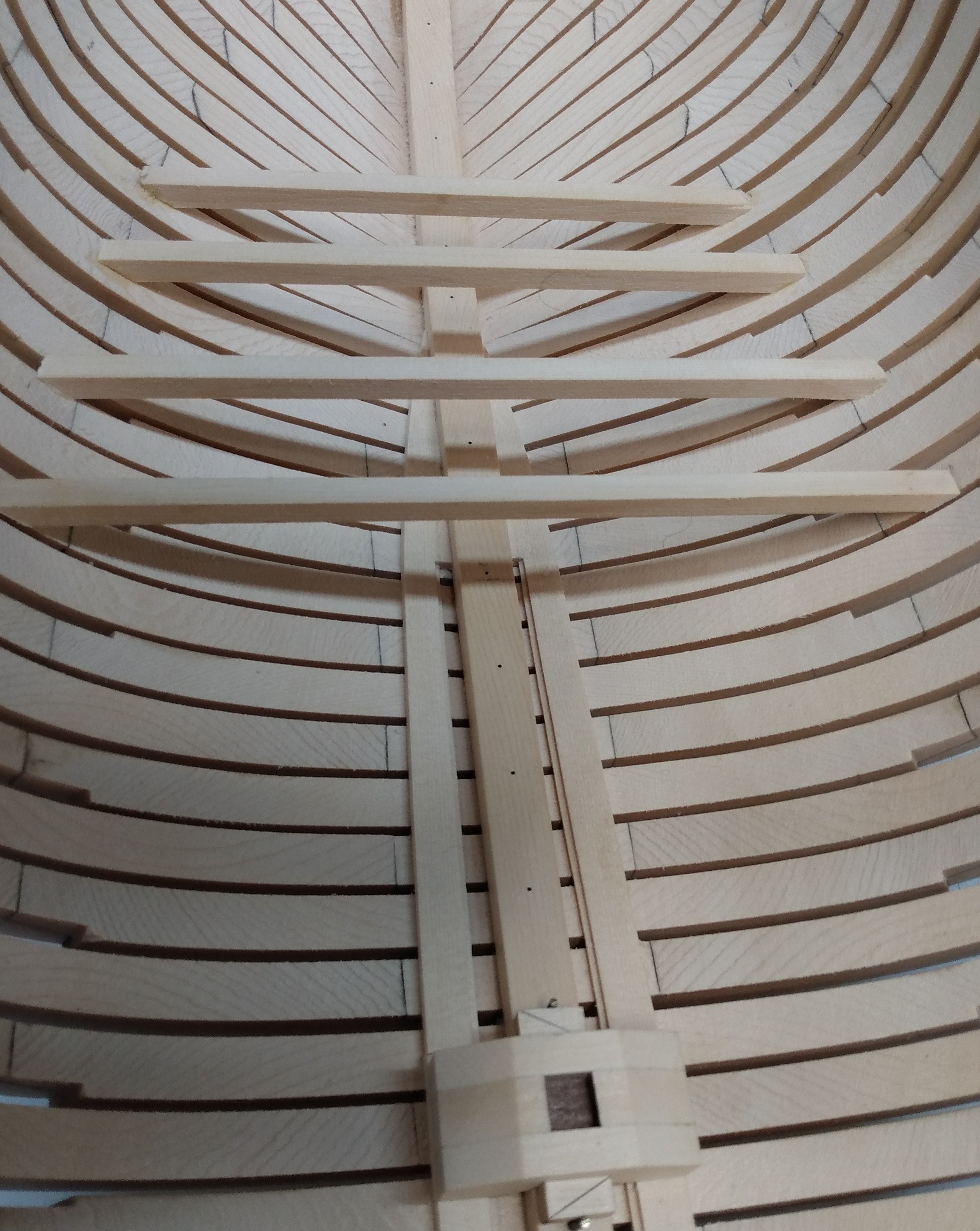

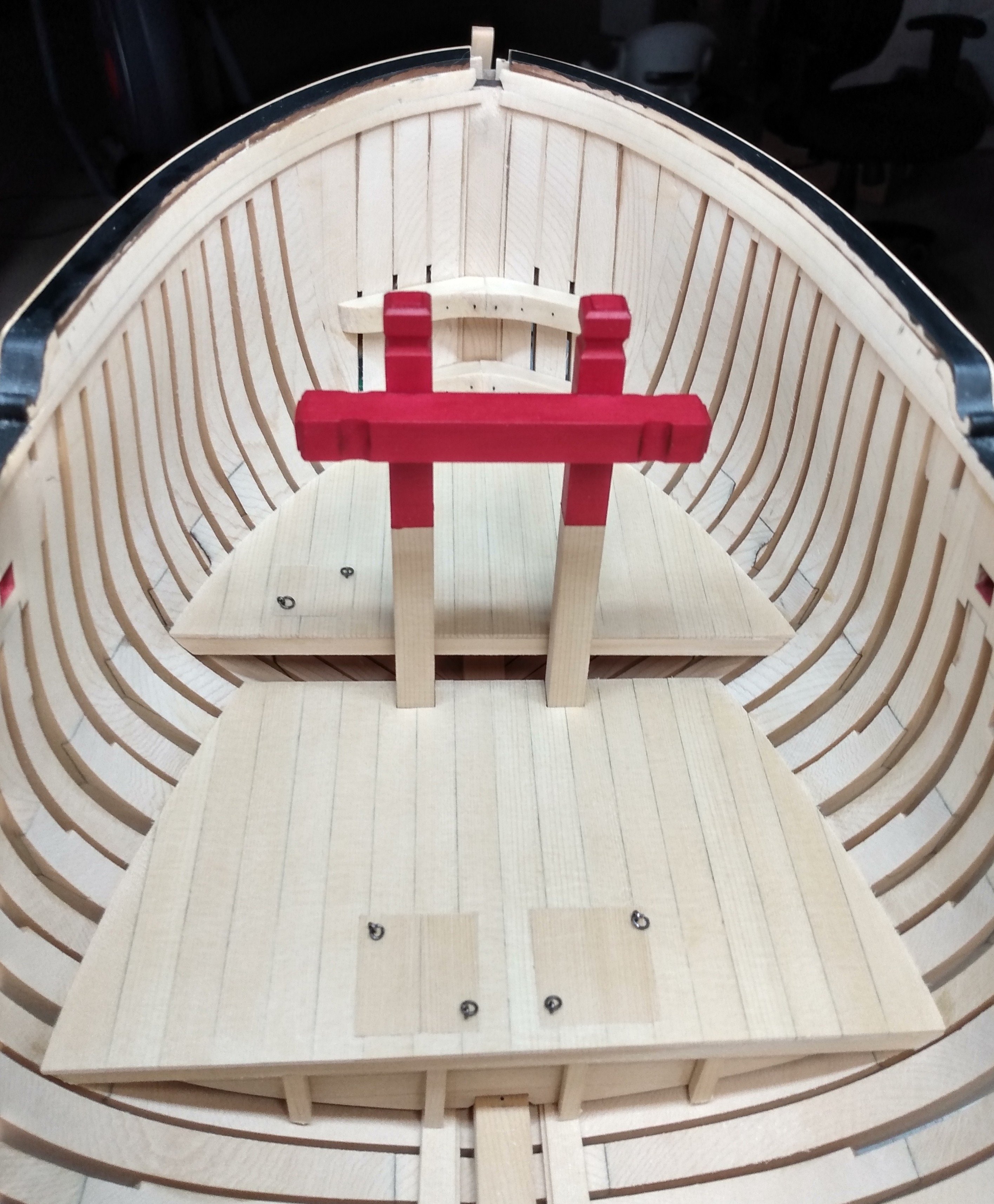

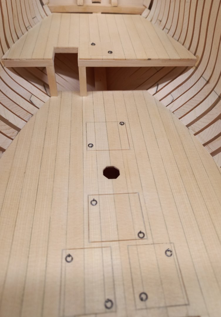

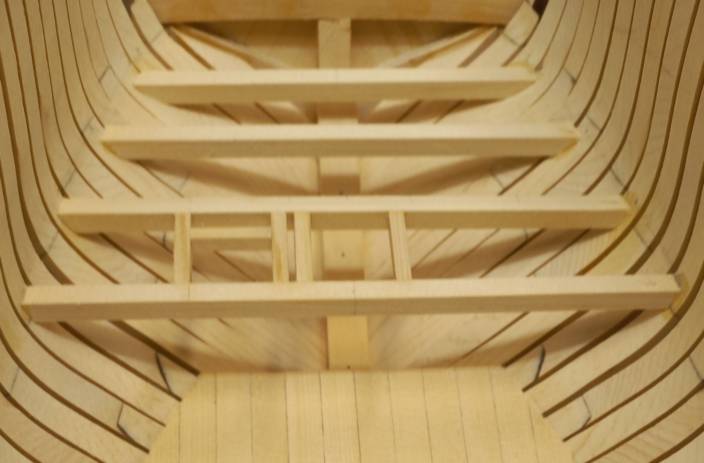

Fore Platforms I first prepared paper templates of the lower and upper fore platforms and tried to position them on the model. It revealed the I needed to do a bit more fairing at the bow for the platforms to sit at the proper height. Once the firing was completed, I started the beam construction. I tried to use Chuck's height gauge, but found it tricky to position. Instead, I use cardboard height guides for each beam as shown below. This approach worked well for me. Next photo shows the completed beam structure. The platforms were assembled on a flat surface and their contour adjusted to fit my model. Their shape is virtually identical to the plan. Proceeding this way makes it easier to sand the planking and to cut the scuttle lids accurately. The platforms were then glued on the beam structure. A light coat of WOP was applied to enhance the planking joints. I then completed the breast hooks and riding bitts. The next photo shows the completed fore platforms (riding bitts not glued). Hopefully every thing is sitting at the right height and positioned correctly. Next is the fire heart and then Chapter 5!

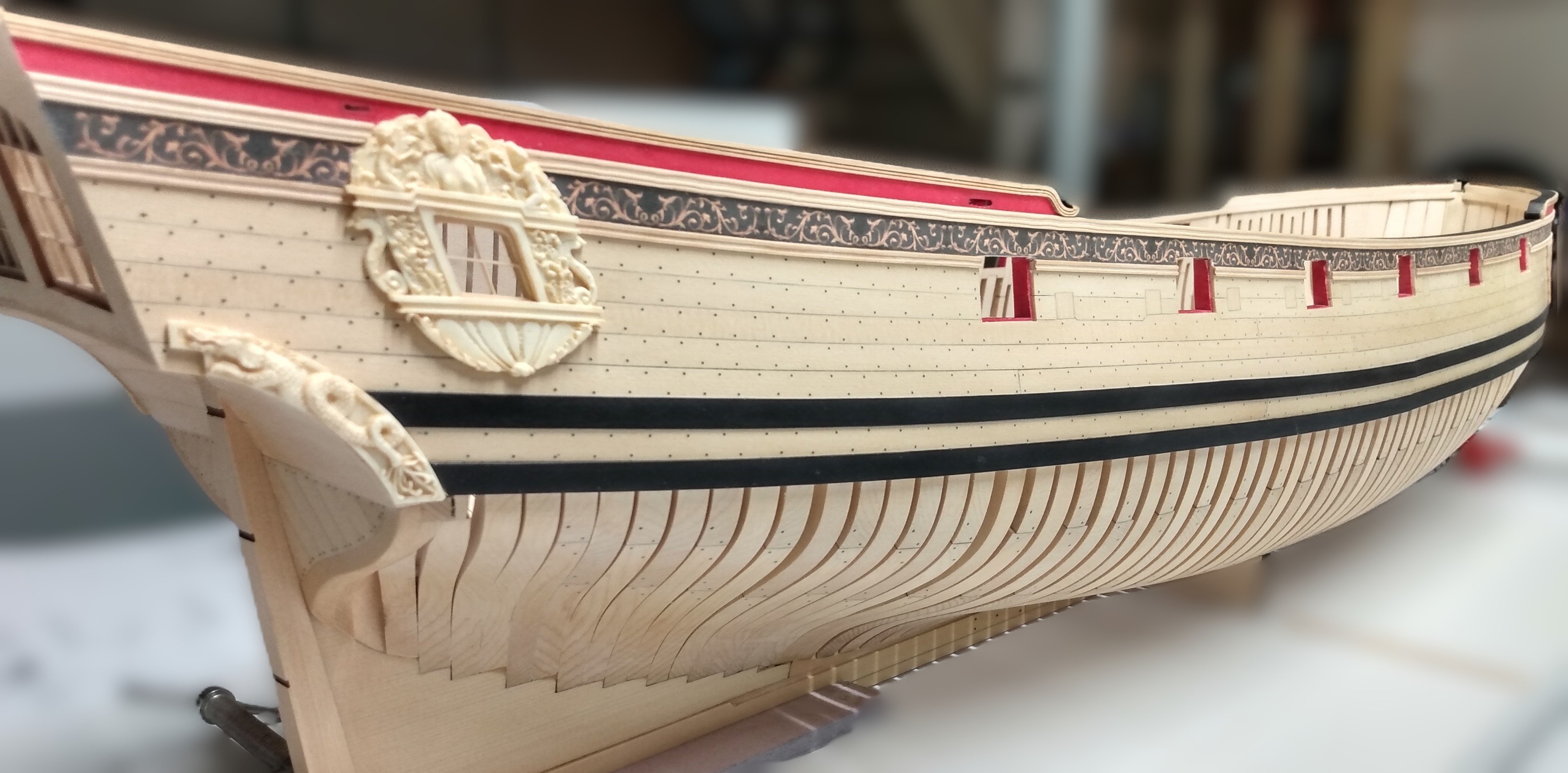

Fancy Molding and the Frieze - Starboard Side Work on the starboard side is completed. I tried to keep a good symmetry between port and starboard. Here are some pictures: Anchor Lining I found that using individual planks worked better for me. It allows more accurate positioning with respect to the hull planking and it is easier to conform with the hull curvature. Here use of CA glue helped a lot to maintain individual planks in position while being slightly bent to follow the hull curvature. This completes chapter 3. While waiting for future chapters, I plan to do a bit more work that requires no laser cut parts (transom and some framing) to keep the project going.

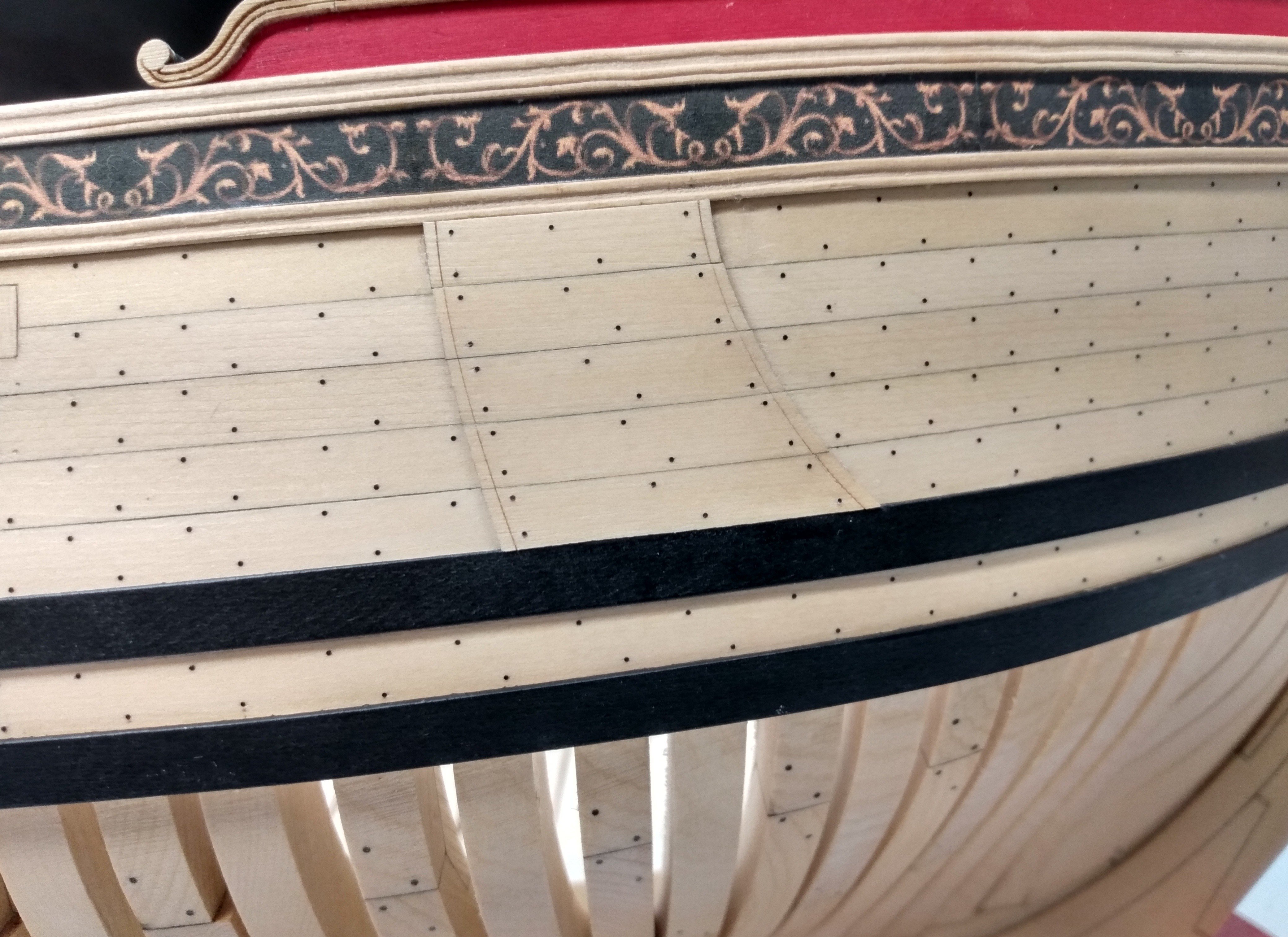

Treenailing This step was faster than anticipated. I used a no. 78 bit and 10 lb. monofilament. The fishing line used is burnt orange, which softens the contrast with the yellow cedar planking. I found that for this repetitive task it is better to work in short sessions. After a half hour of marking, drilling, etc. it easy to loose concentration and make mistakes. Better to stop and return to it later...I inserted the fishing line directly into the drilled hole. It was a tight fit and no glue needed. Completing the Planking The final two strakes and drifts were added next. This is again fairly straightforward. The only tricky step here is to cut holes in the planks where the sheaves are positioned. Shaping and gluing the drift at the bow is also a bit tricky since it is above the rabbet. Here are a couple of views. in these shots you can see that WOP was applied up to the 1/8" stakes and that the second layer of the wales was completed. I decided to paint the wales before gluing them on. I used Admiralty Matt (Metal) Black, which I always use for wales, spars, etc. Applied in several dilute coats it produces a superb finish. Finally, I dare to show a front view of the bow. The overall result is not too bad. The strakes are slightly pointing upwards at the bow, which suggests insufficient fairing close to the stem. There are small strake height variations from starboard to port. Fortunately, a lot of this will be hidden when additional elements are added at later stage of the build. Preparing the qbadges and fancy moldings For these, I used the fruitwood gel stain method. I am more or less happy with the result. The staining is not uniform and a showing too much orange shades and build up in some areas (stain too old?). I will experiment with IPA to see if the coloring and uniformity can be improved before I glue those on the model. I welcome suggestions here.

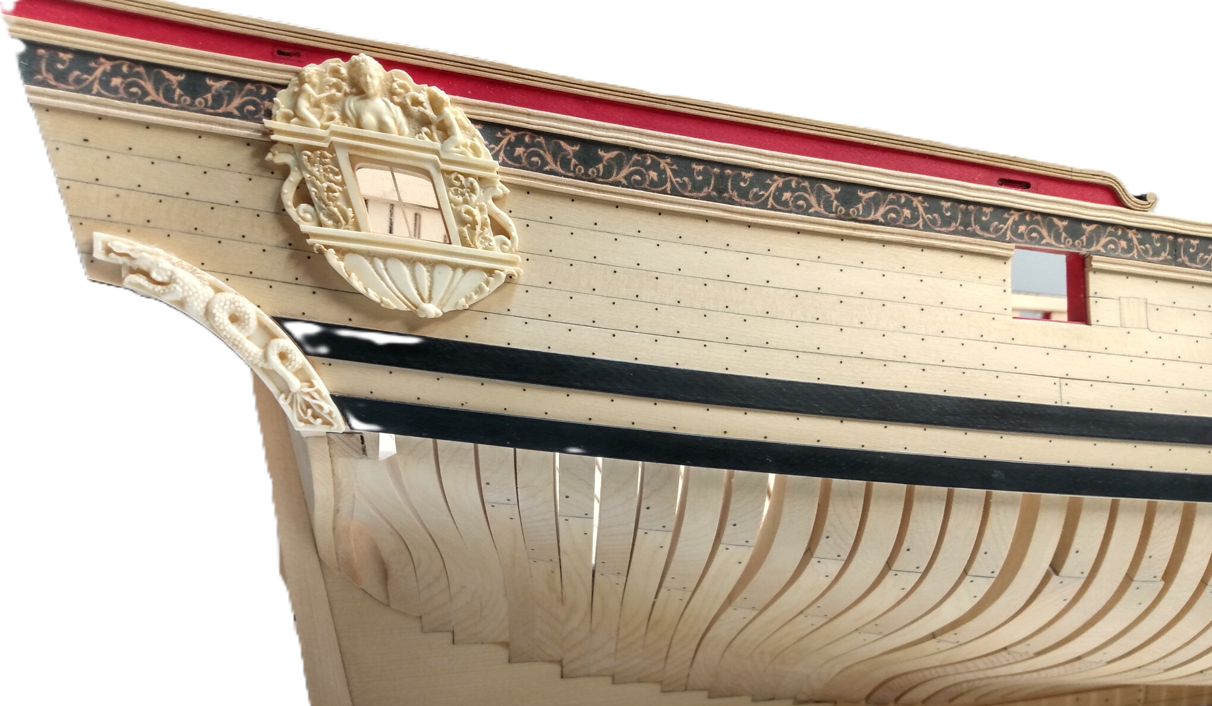

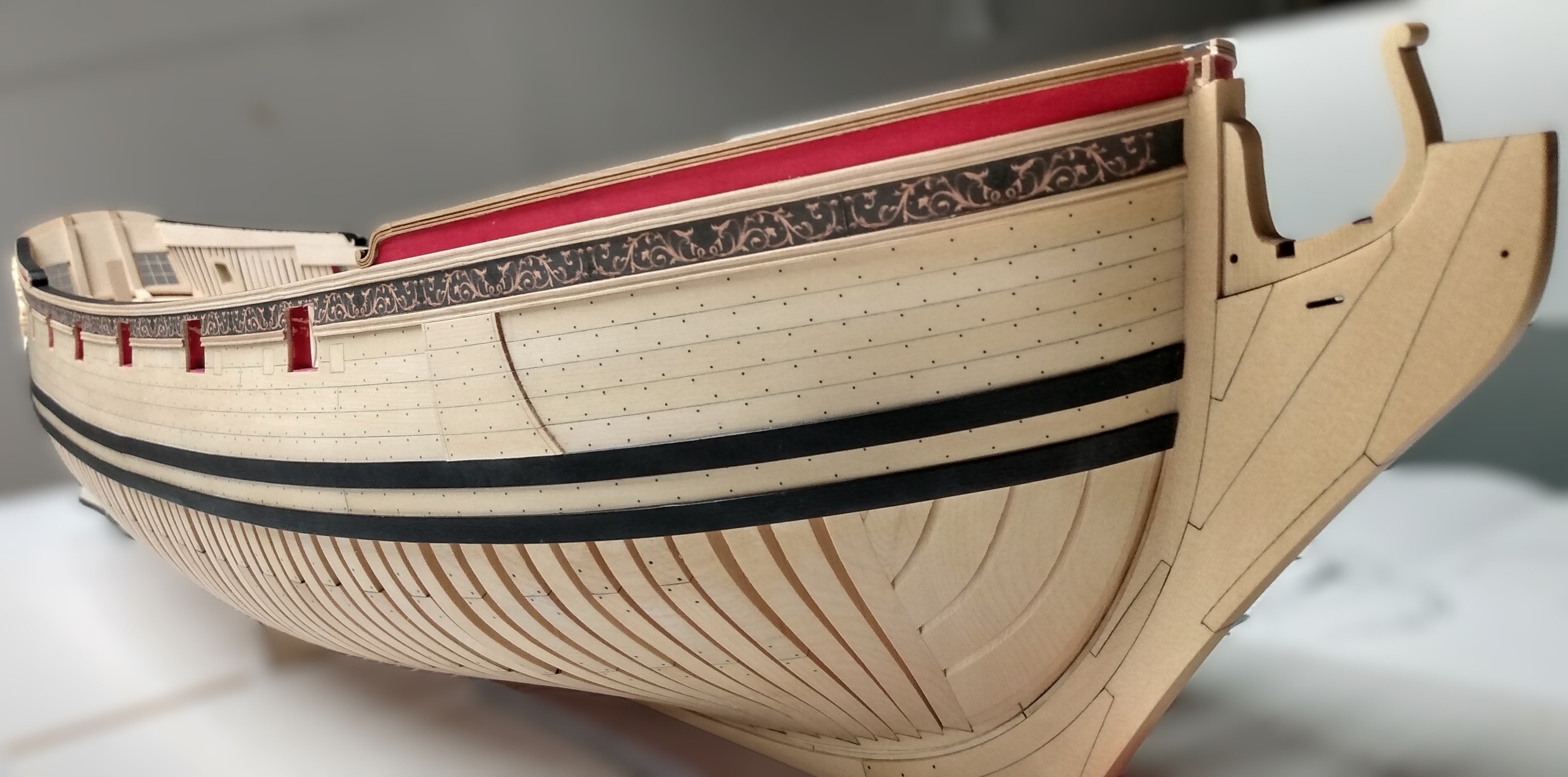

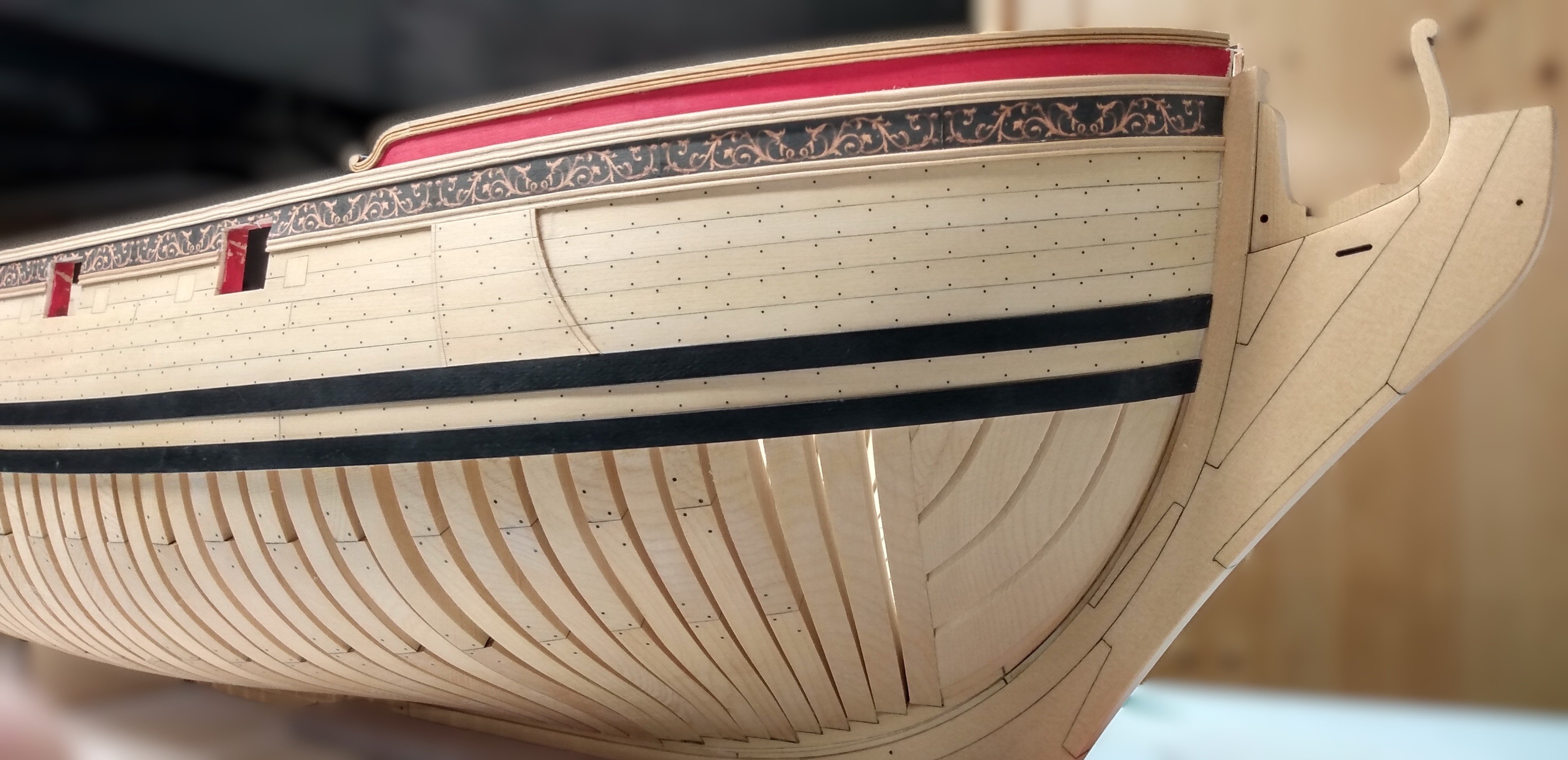

Hull Planking I proceeded with the hull planking as per the instructions. The paper template is crucial for adjusting the position of the sweep ports and gun ports. The height of a few gun ports sills had to be corrected (never more than 1/32") to conform to the template. Some sweep ports were a bit off and this could be taken care of by tracing their exact position using the template. I guess these slight adjustments are unavoidable given all the possible variations in frame construction and positioning. Adjusting the upper wale height at the bow is a bit tricky. For this I positioned a 1/8" guide as shown here. With the upper wale position established, I proceeded with the planking. For shaping the planks I used the travel iron and air dryer technique. I used a combination of CA and PVA for gluing. I typically would apply CA to 10 consecutive frames and ten PVA on the following 2-3 frames. The CA glued section is position carefully and once the glue is cured, the PVA glued buffer gives me easy access and time to apply CA glue to the next 10 frames. I found this approach insured that all frames were glued to the plank, avoided CA messes, and minimized the risk of opening gaps at the joints when CA is used at once over the whole length of the plank. Before planking above the wales, I checked the width of my 7/32" planks. My planks were a hair too thick (0.225" instead of 0.219"). I used my Varitas mini plane to narrow the planks down to the correct width. Slightly thicker planks would have led to complications when planking around the ports and shifted the position of the fancy molding. I completed the first three rows plus part of the fourth. A milestone has been reached. It is now time to remove the jig!
