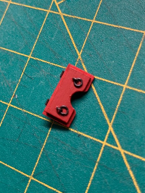

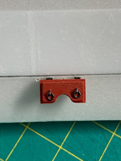

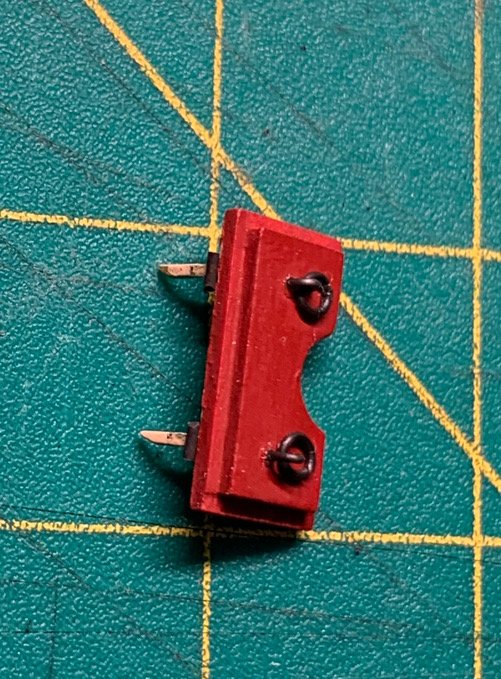

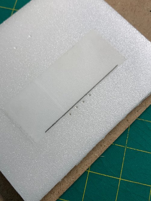

Sooooo…gun port doors. Chuck’s practicum has about 2 sentences on mounting these suckers. In short, I’ve been struggling on how to Mount them so they don’t look askew or show the hole you need to drill into the side of the ship to mount them. Also, the idea of trying to put those tiny 1.4mm hinges on AFTER I’ve mounted them terrifies me. I opted for putting on the tiny hinges first. Then made a faux window sill with a foam board to see where best to drill the holes and ensure they look clean. Theoretically, this means once I’ve got them drilled and prefit, I can store them until I need to mount them. I see myself ripping these off by accident multiple times in the future. Hey…in theory this should work. Looks ok with the practice piece. 🙏🏼 Gratuitous pics below.
