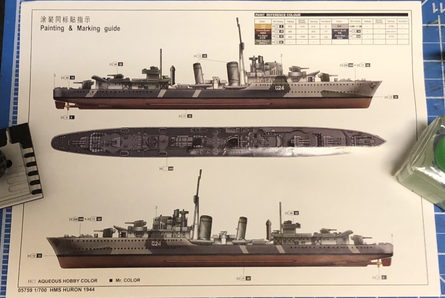

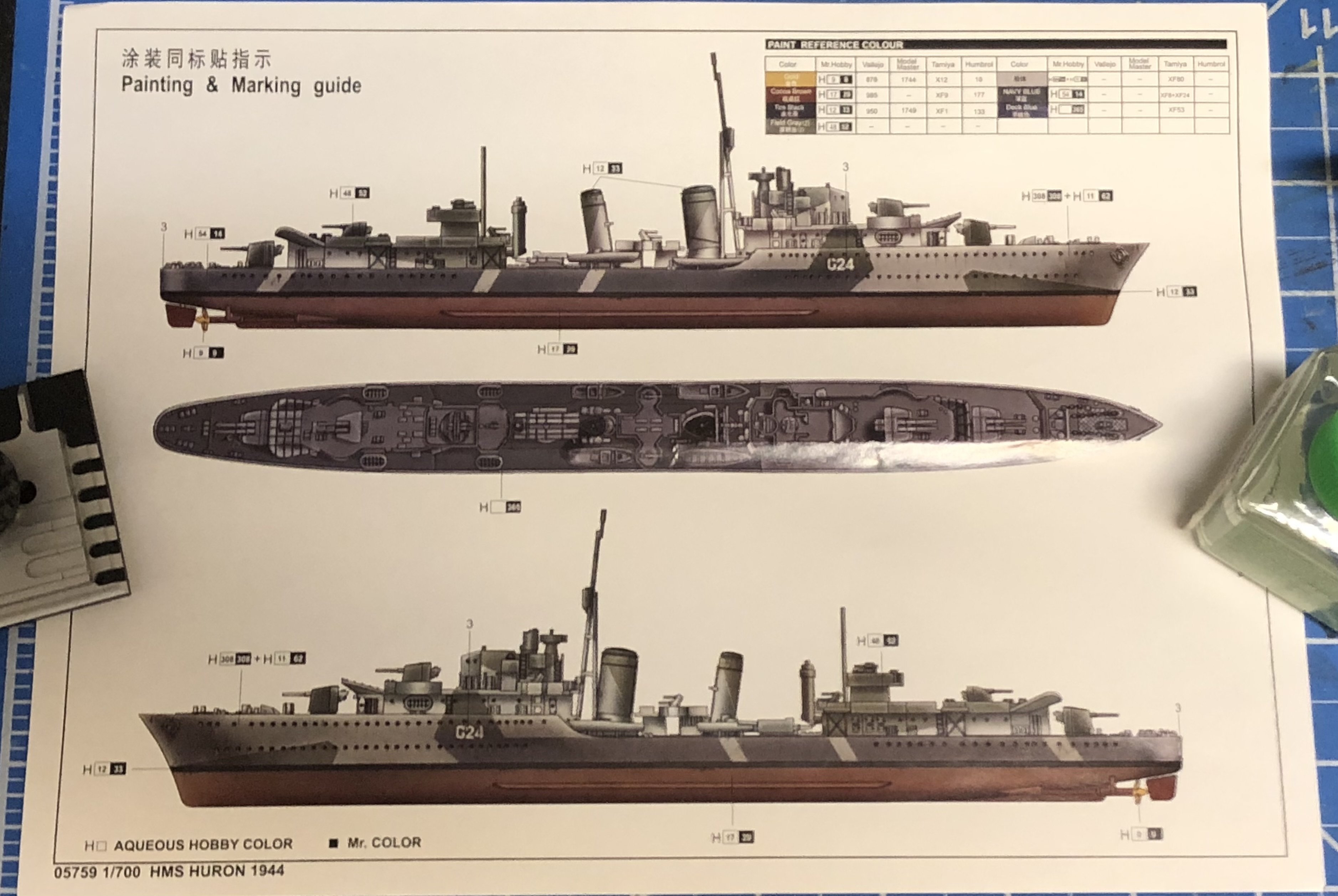

This is hardly a progress report today.
I sprayed the relevant sections of Zinnia with the AK MS3 paint and found it was hardly distinguishable from the light grey already in place and nothing like the colour chip I have for MS3. I mixed up a blend of IJN grey / green and dark green from Tamiya and used that. I liked the result a lot better so went ahead and added the dark grey.
Today, a day later, I stripped the masking and found that the light grey had bled all over the red lower hull and over the dark grey deck. The dark grey had bled all over the grey / green and the light green. Its far too extensive to touch up.
I haven't had anything as bad as this before.
The grey green didn't seep anywhere. i think the problem was the AK acrylics which are water based and had to be diluted with water. They sprayed on very wet and I think that resulted in the seeping. The grey / green is Tamiya which I think has an alcohol base and dried fast.
Sorry no pictures I was too disgusted. Its going to need to be stripped down and redone. I need to see if I can use something other than water with the AK paints - or dump them and use all Tamiya ones.
Another day, another lesson learnt
Alan
