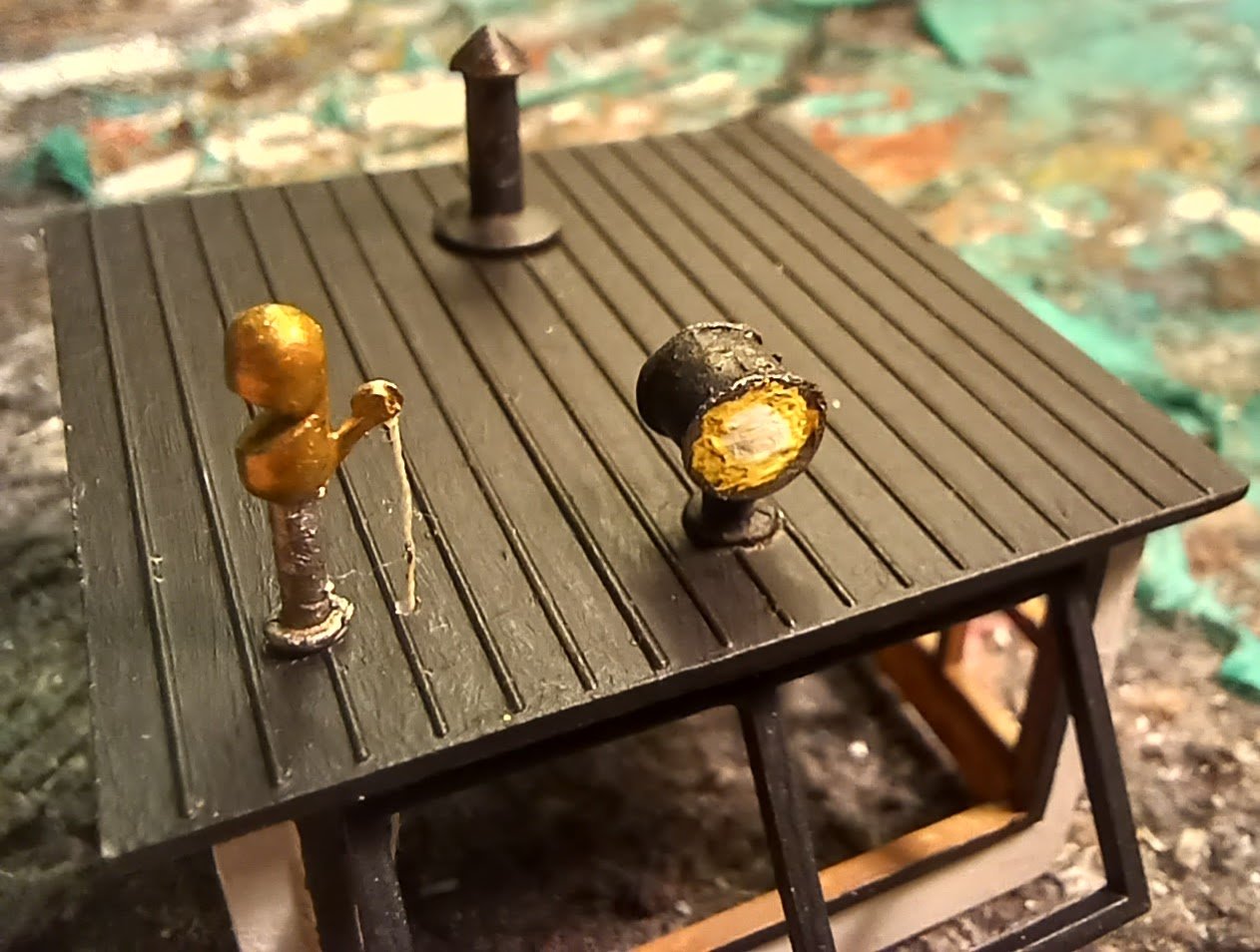

    The ship's stern lantern, sterncastle hatch mouldings, stern shade structure and fore boom crutch have been painted and put onto the ship. The fore shade structure and the fore and mizzen masts are currently dry-fitted in place. After we are finished with the masts, we will do some scratch-building to facilitate easier rigging.
    The paintwork looks much more flat in flash photos than it does in real life.

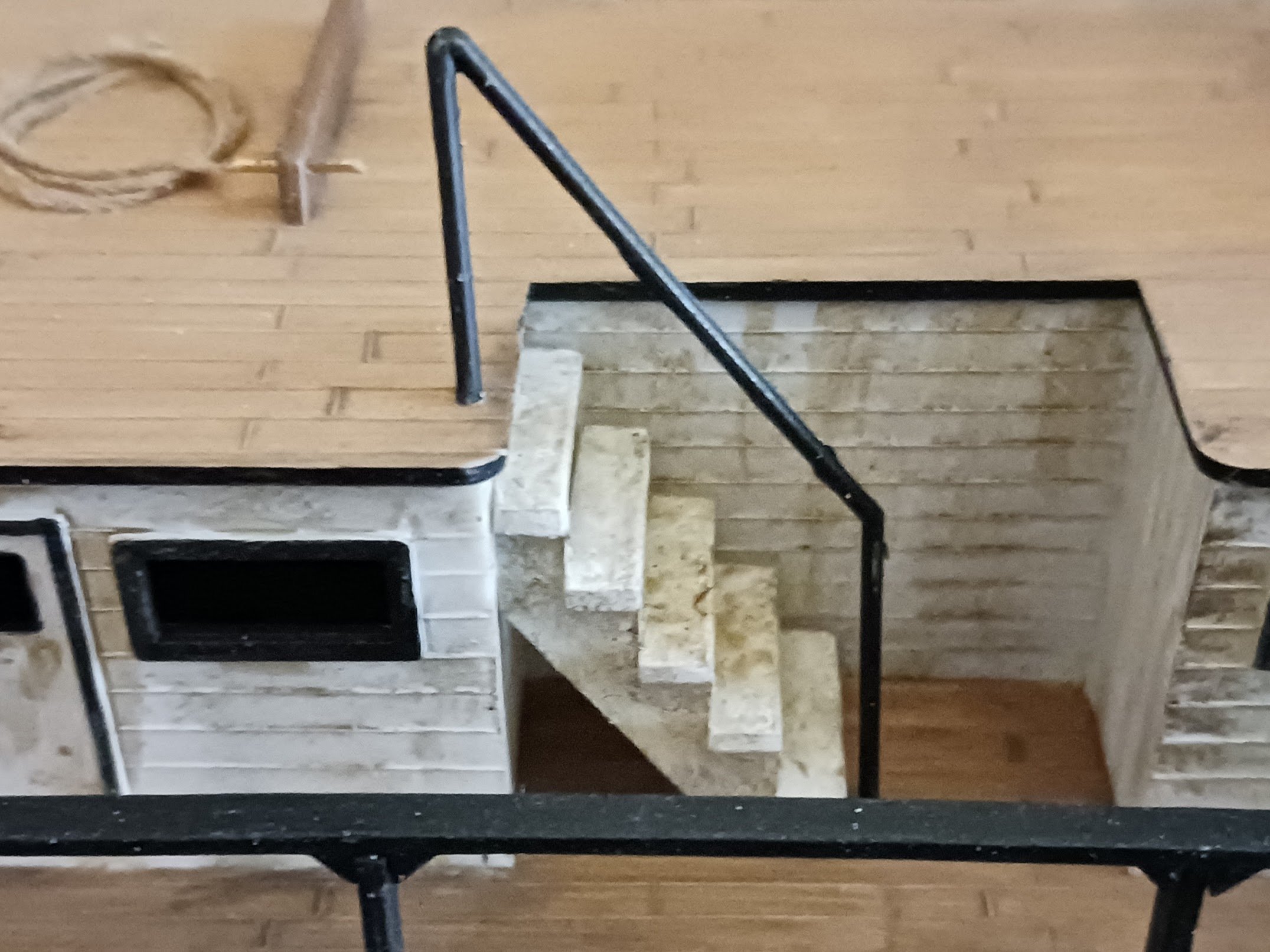

  15. The parts that we dry-fitted on the deck have all been painted according to previously laid-out principles, and installed. It is wise to dry-fit every part prior to painting and installation. What I like to do is grab and prepare a few different parts in the order I want to install them, and proceed from there.
    image.thumb.jpeg.53c0640d54bcc5c9218f6ae474c3e72d.jpegimage.thumb.jpeg.ca3384f5c72366a5e42ad27006ef2c27.jpegimage.thumb.jpeg.54f0f0a3e74e7329905b4570ba786875.jpeg
    The next assembly will probably be some of the interior railings, hatch covers, and some other miscellaneous pieces.

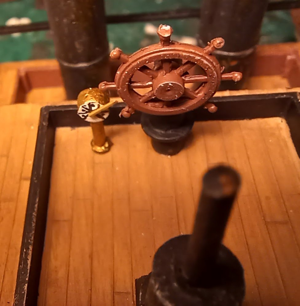

  16. The fore, aft, and deck of the ship were all painted similarly to how I painted the hull. The deck is slightly lighter as I went easier on the weathering, but the technique is functionally the same.
    image.thumb.jpeg.05d415c0b96f10ba35a328ebfc8a120e.jpegimage.thumb.jpeg.46bb8d76c00848c78e9a6f8f820bacf2.jpegimage.thumb.jpeg.efd473c69ad500c8cef6f7808968d3e9.jpeg
    The boat winch housings, pinrails, main rails, and mast are currently dry-fitted into the hull. I rectified the aforementioned issue with the mast rake by doing some strategic sanding of the base of the mast. These will probably all be painted some shade of brown.

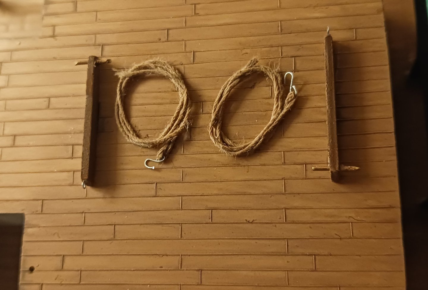

  17. I've now completed the rudder assembly. There is a rope that wraps around the rudder post to prevent it from tilting aft, as well as the rudder lift. Here's what they look like from outside:
    image.thumb.jpeg.073b664e7416aa56978a9403c01ba8db.jpegimage.thumb.jpeg.ccf2f2327a1ef0c4bfa07578a24fbb05.jpeg
    And the rat's nest inside the ship, which will not be seen once the deck goes onto the ship: image.thumb.jpeg.025d7dad05a9b96a27d03950487765a3.jpeg
    Two of the ship's guns will go into the interior section at the aft, which will further obscure this mess.
