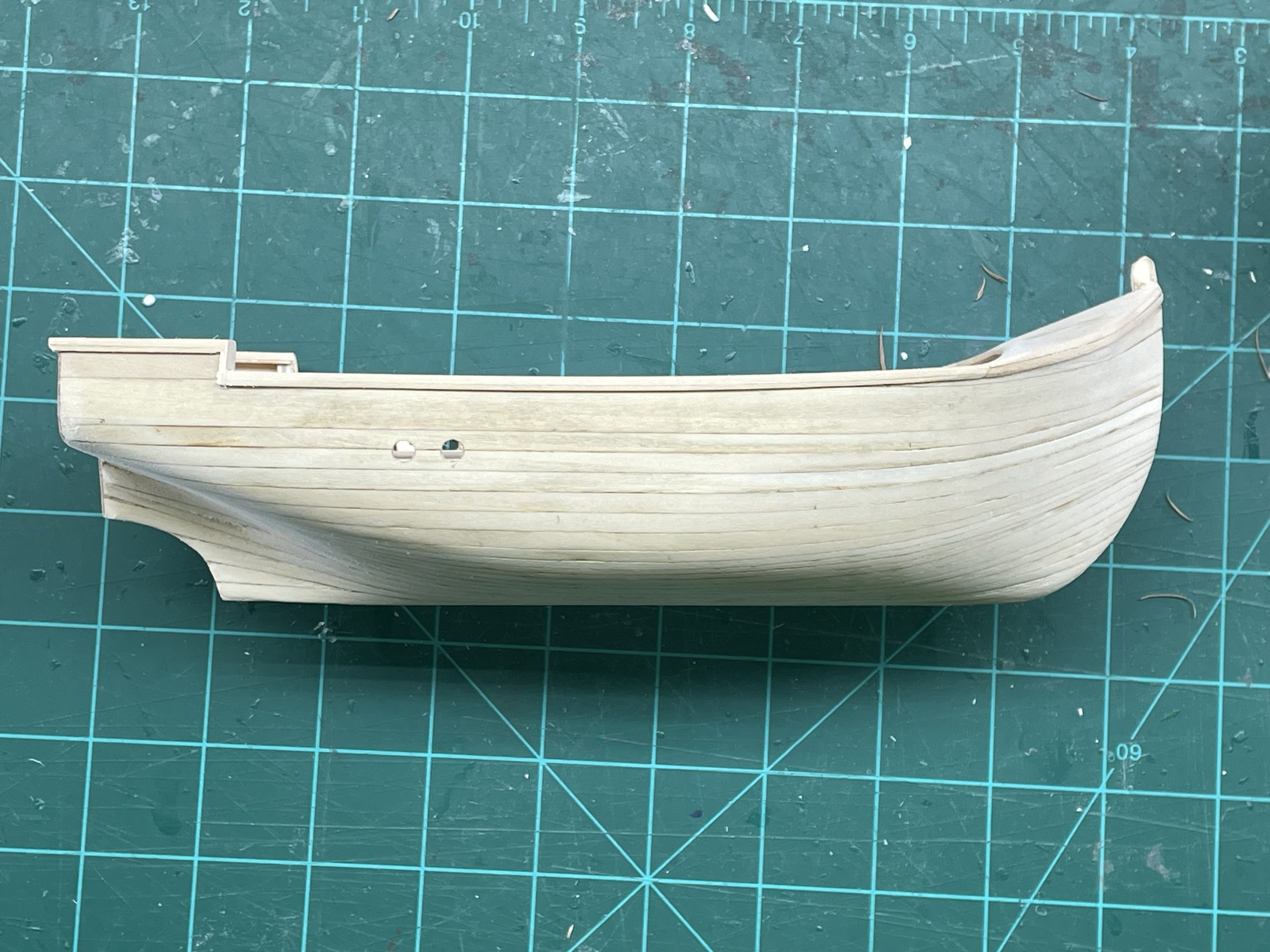

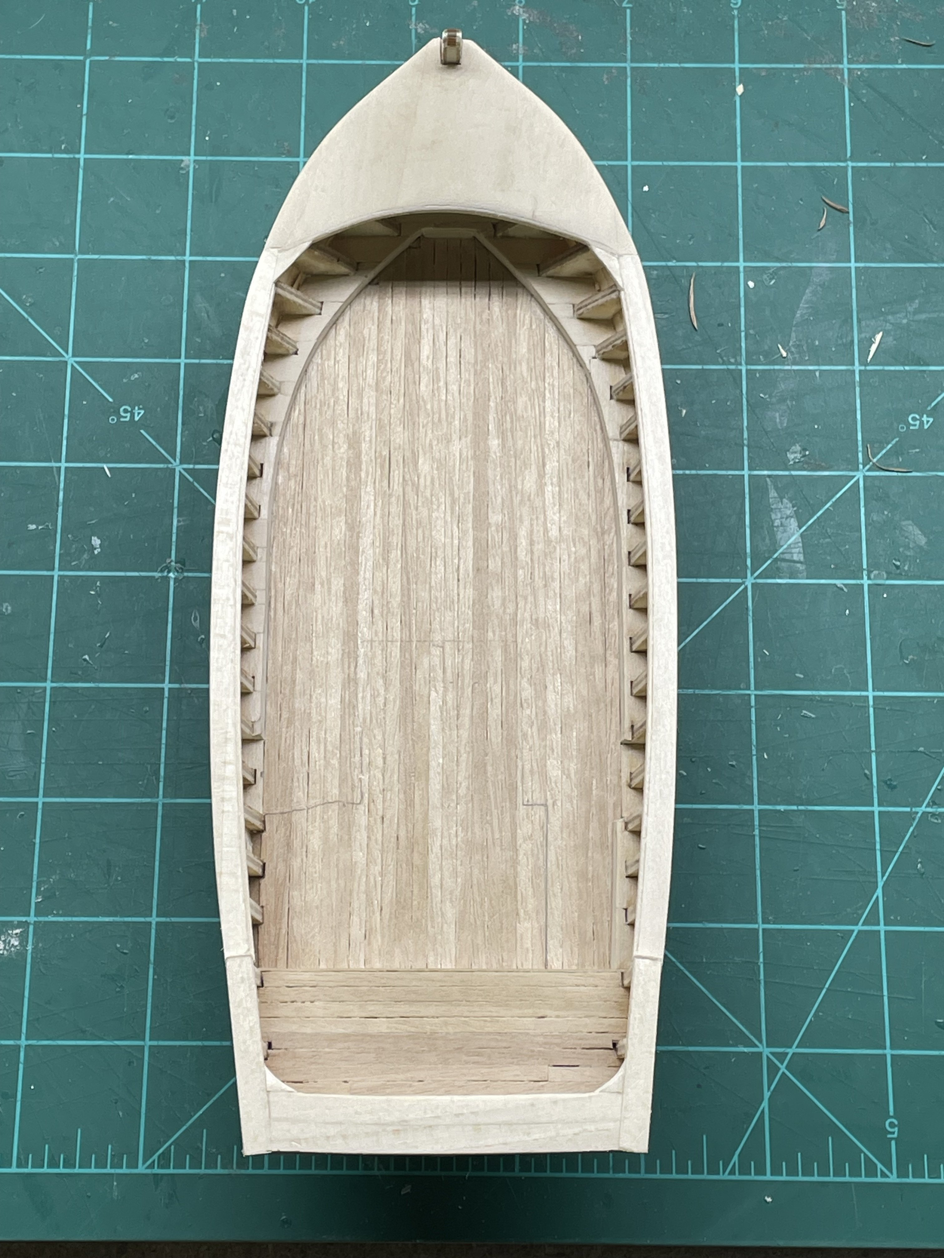

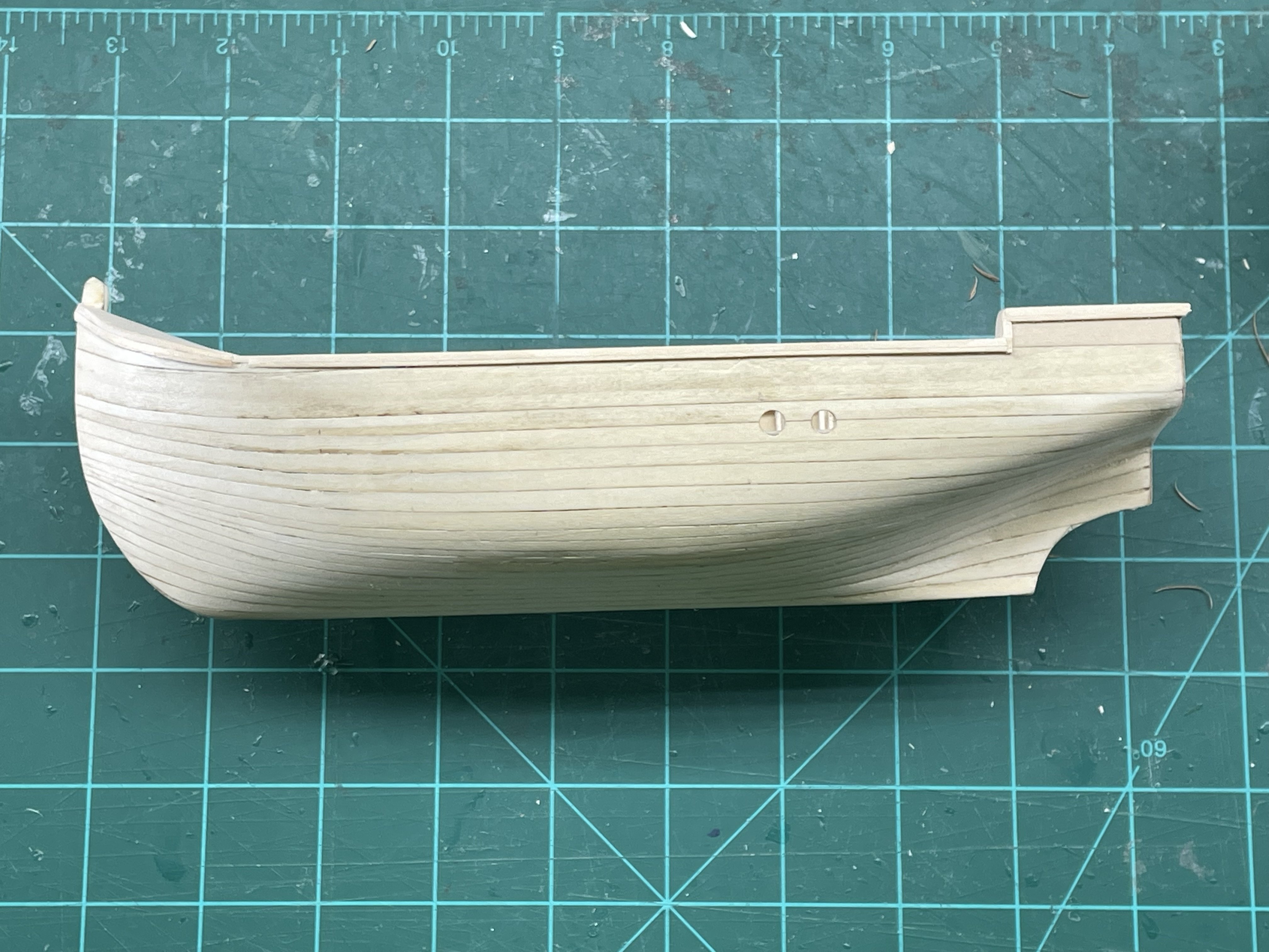

I got the hull sanded. The thin planks prevented me from sanding it all the way smooth. Since my original idea was to look weathered, I’m not going to use any wood filler. Hopefully no holes will appear. I worked on a toe board just to add some detail. This build is turning out to be more of a scratch build than a kit build. I’ve used all the material except for the pilot’s cabin. I have to purchase some wood to cover the bow. No top rail even shown. I’m trying to bend a piece to fit, the results are unknown. Here’s my jig I’m bending with. Here’s some shots of the up to date hull. The kit came with a 3D printed rudder but I’m not sure it fits this hull. Since I have no knowledge of these things. It makes the build much slower than if I had a plan to do as it says. Now another question. The rudder. I’m hoping one of these types exists on a boat like this. comments and advice are extremely welcome:-) thank you!

As planking continued, I realized I should have been paying closer attention to the stern and not just the bow. I started tapering both ends and made a simple jig to edge bend the fragile planks. Clamping wasn’t even an option. I glued about 4 bulkheads at a time while applying heat. It went as easy as using CA. I’m down to just one space to fill. It’s 3mm wide. I’m going to fit two small strips in so it doesn’t edge up on me so bad. Next I’ll sand it down a bit, put the false keel on. I’m thinking I’m going to put a toe board around the inside.

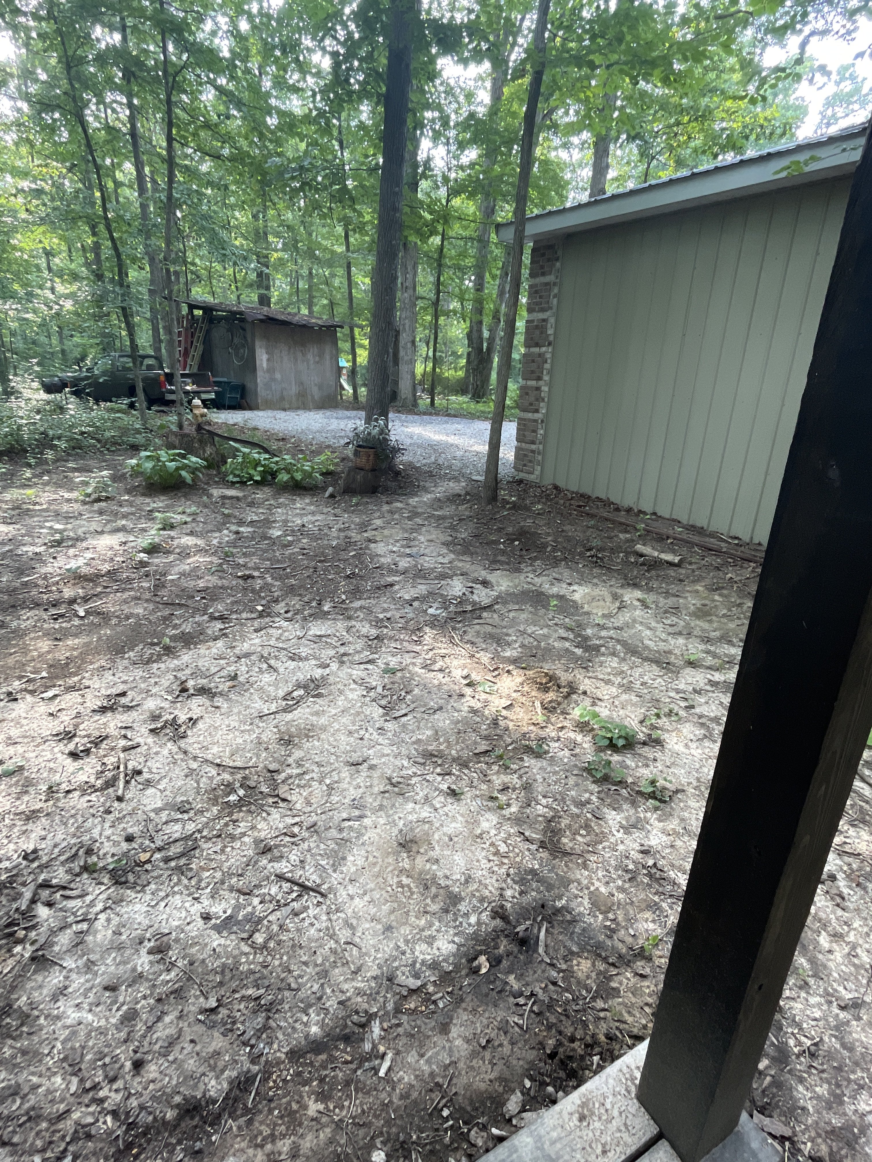

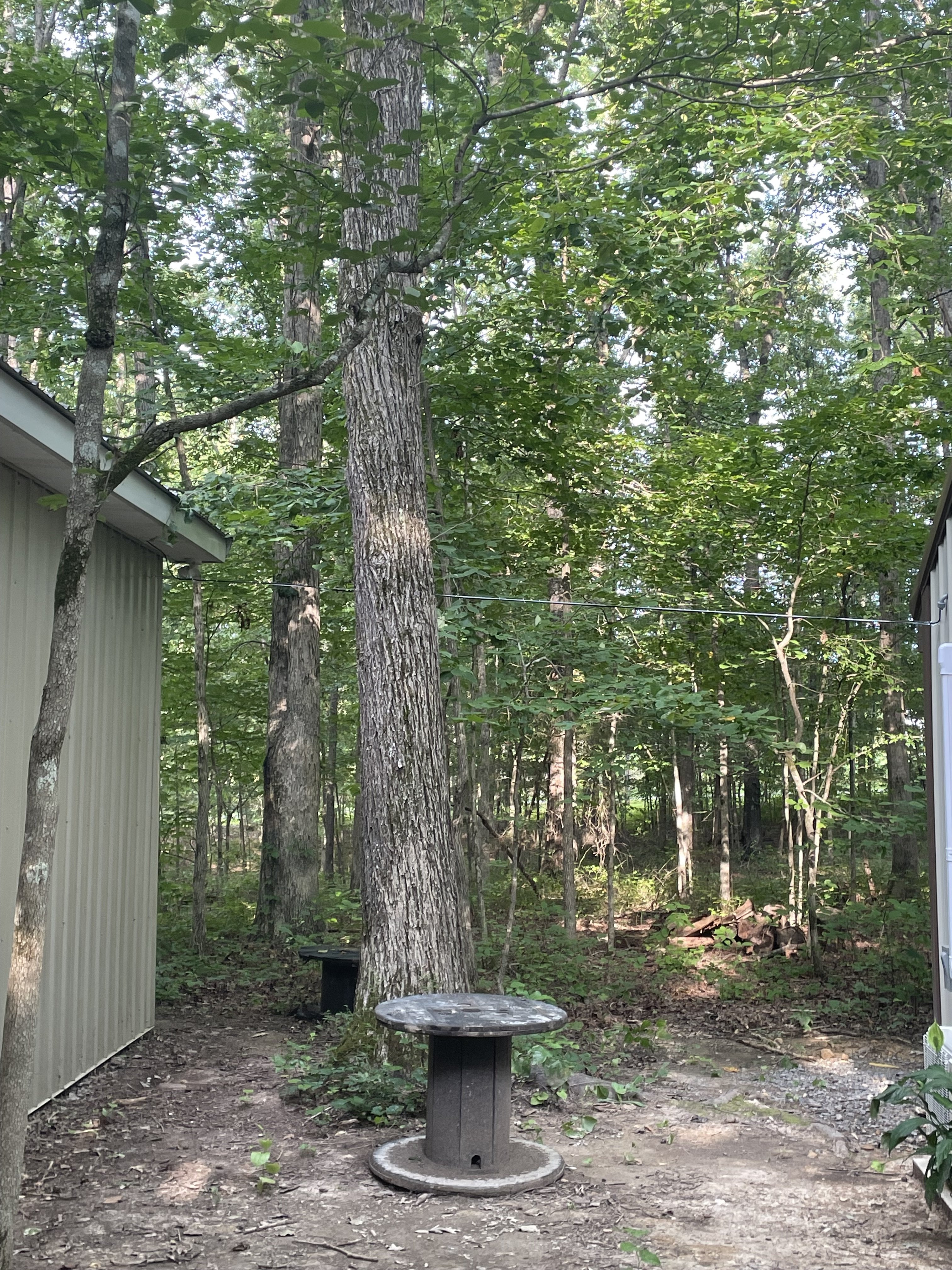

Work area pictures only
Bryan Woods replied to Johnny Mike's topic in Modeling tools and Workshop Equipment
I call this the Mossy Shipyard. It’s a 12’ x 16’ salt box pole barn. The right side is my wife’s scrapbook area, if I haven’t got is so messy she can’t sit down. -
