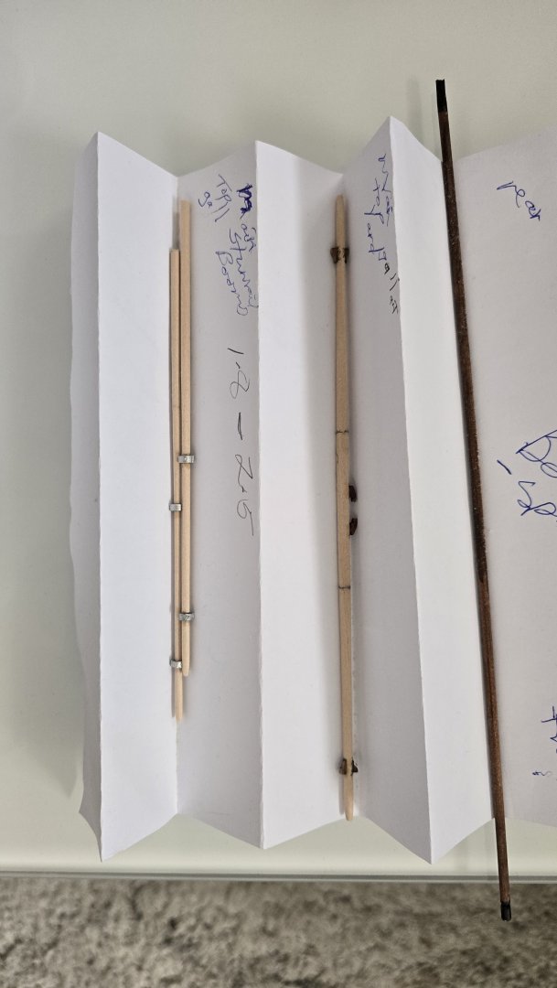

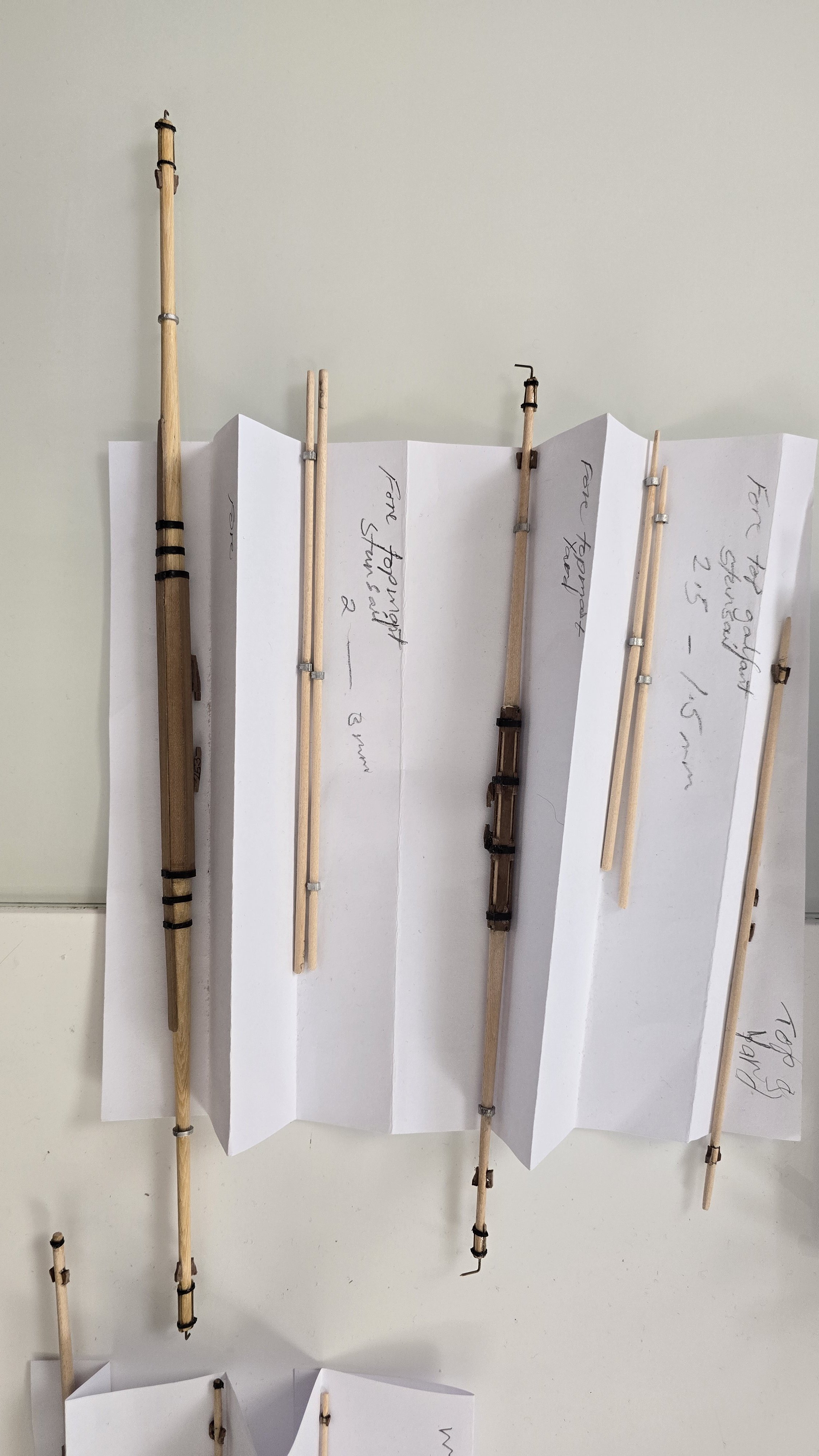

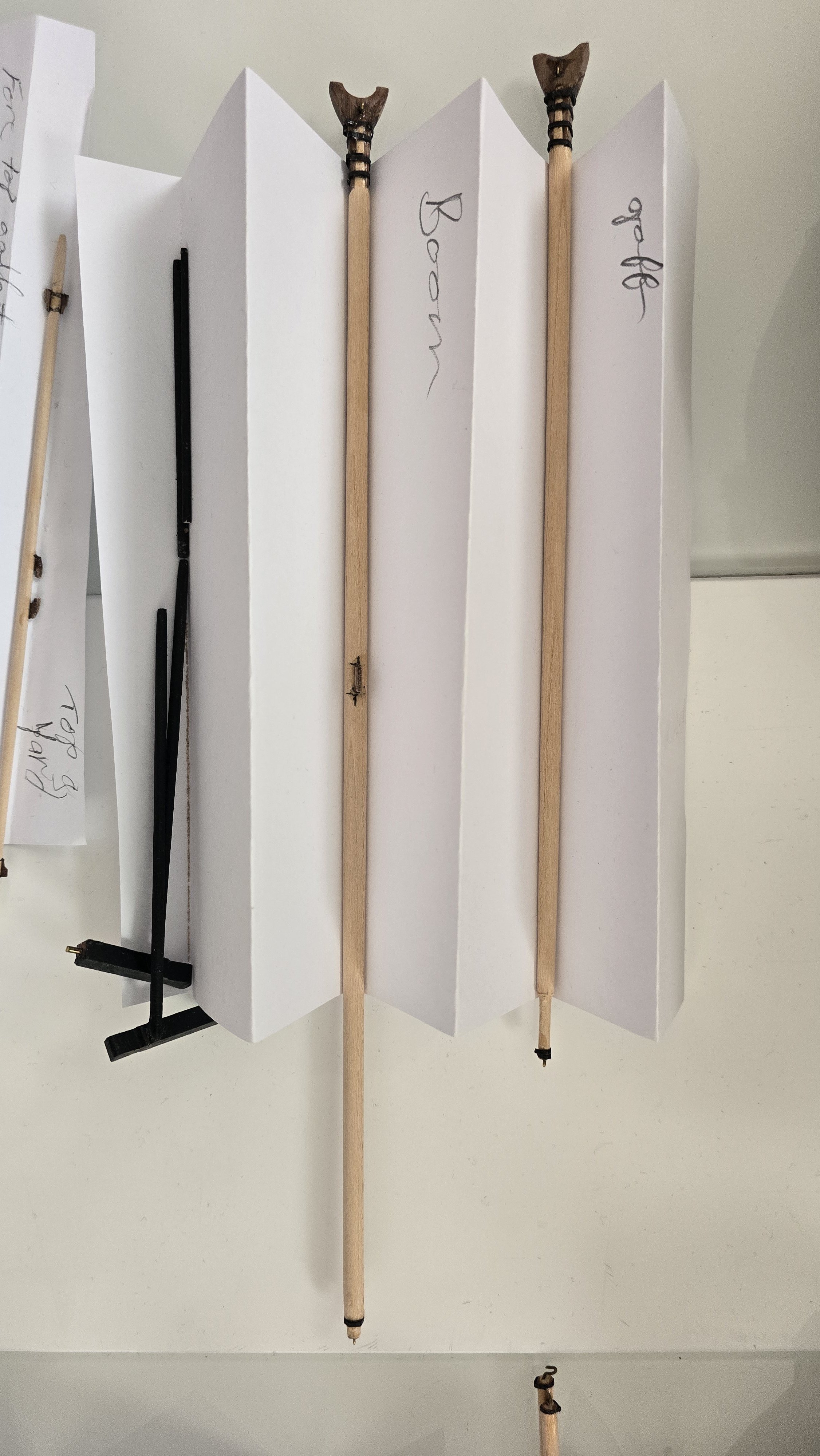

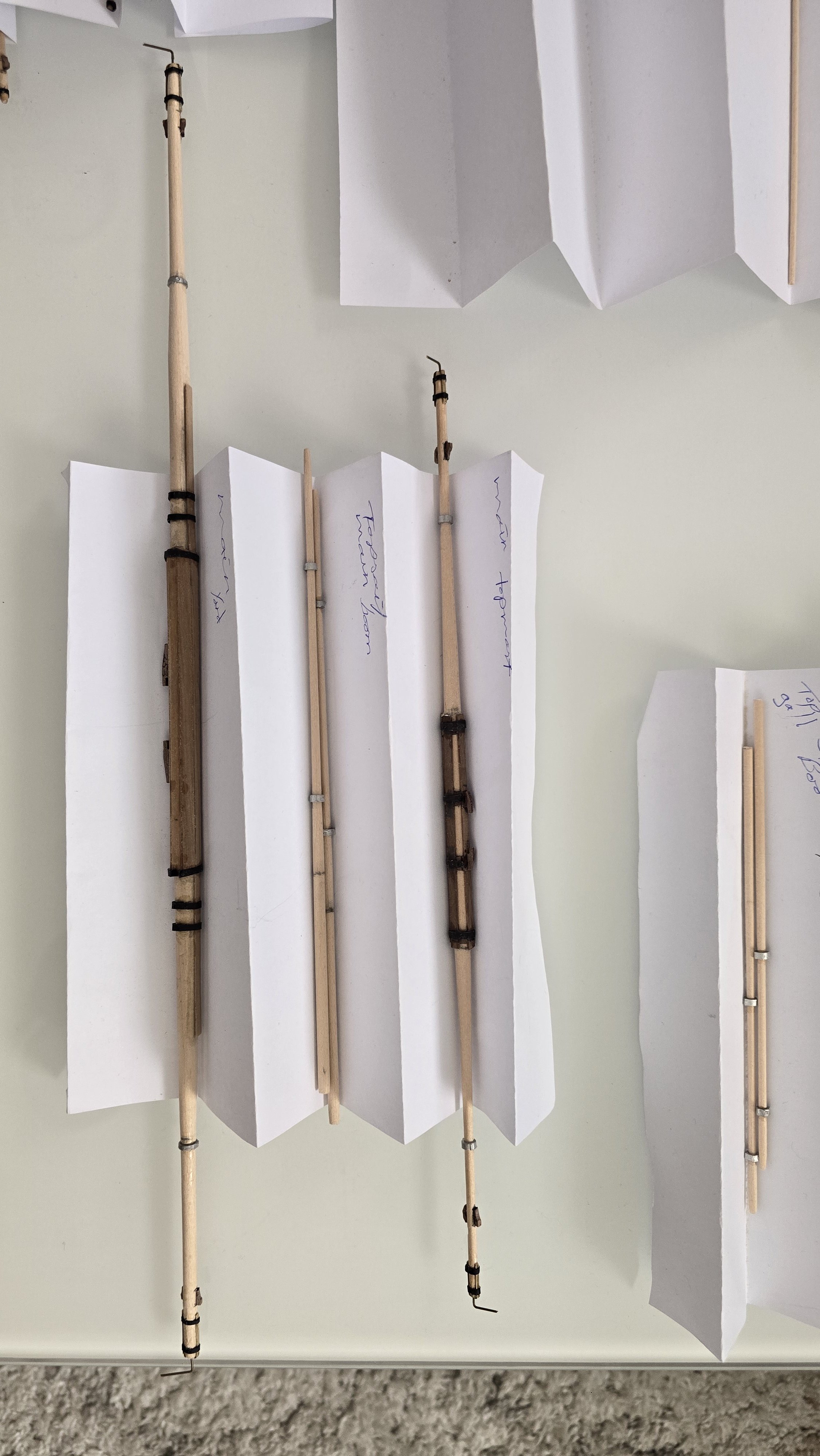

  8. Happy New Year everyone, I hope it's a great year with good health. Time to do a bit more after a 12 month break. Yards, booms etc sanded . I found it was easier with the bigger yards with a lot of material to remove to use a hobby knife to whittle away until close to the required size then sand to size. When fitting the rings I will do the final sanding to get the correct size to get them to fit properly.

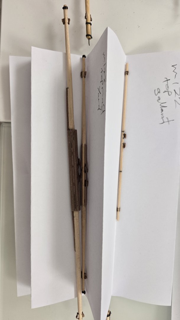

  12. Masts done, now for the yards and booms. Just one mistake I managed to get around. Make sure you match the mast tops to the correct masts and lower or upper position.
  13. Much easier using pin striping tape for the bands. Just wrapped fully around cheeks and mast twice then just trim tape so it looks like the band goes under the cheeks.
  14. Things I learnt on the foremast. When trimming the mast for the Cheeks to fit make sure you trim for them in line with the 8mm square above vertically. I will try pin striping tape for the bands after the styrene kept breaking. Add blocks to the Platform after painting black. I did'nt so got some black paint on the blocks so had to paint the blocks black. For the mast top cut a small v under it to allow for thread to fit between that and Top Gallant mast. Fit the boarding pikes last, easy to damage. I used styrene for the battens instead of trying to cut 0.5 x 3mm walnut into 0.5 x 1.5mm. Hope that makes some sense.
