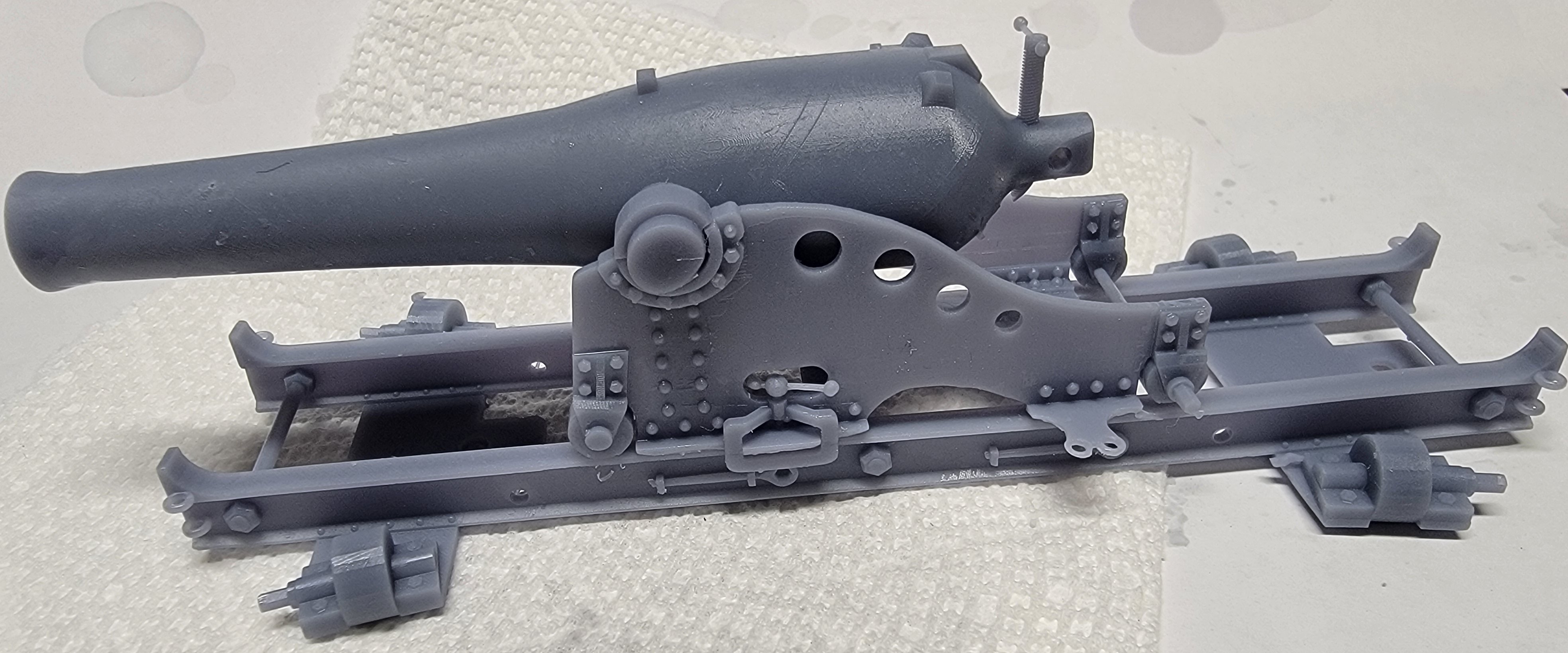

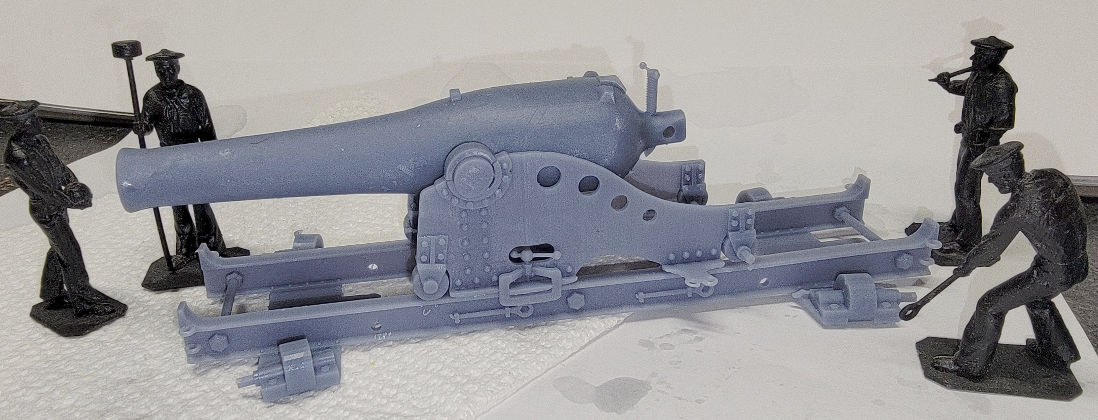

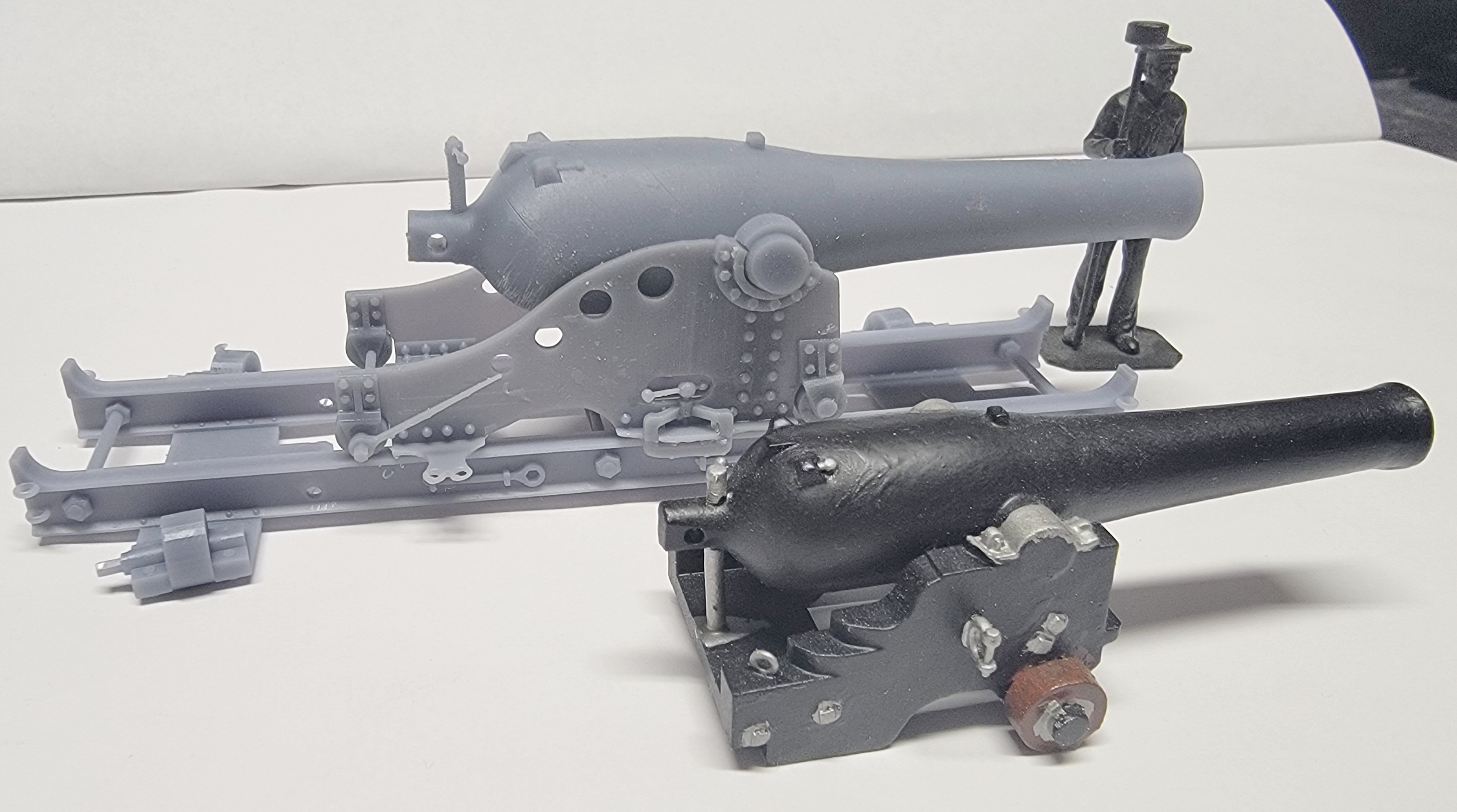

Took three tries before the guns printed well in 1:100. Using thicker supports seemed to do the trick. I went back to the first version I started of this gun, with the taller carriage, to finish it. I used plate #7 of LaFay's, which had measurements, rather than the model plans I had used. Both are modeled in 1:36 scale and posted on Thingiverse. Two of the delivered guns sitting on the model -

I got this far on it before I had to do other things today and tomorrow. Comparing the tube height to the sailor figure, this carriage is definitely a better match for the model it will be living on. I'm modeling it in 1:36 scale, but I'm printing them in 1:100. Besides what I print for my friend building the model, it'll get posted on Thingiverse when it's done -

As usual, I have very few clues what the carriage for this gun would look like, so I have to conjecture it. This image is part of a set of drawings of the L'Agile (I think) which was a later ship. The drawing is 1:100 scale but there's no reference on the portion I got, so who knows what "scale" it might be. I modeled the carriage to this drawing and wound up with the tube six feet in the air; that couldn't be right, so I scaled the carriage down to the height of my 8 inch shell-gun. This is still top-heavy to my eye, but I don't think it would have been the low-slung Marsilly the IX Dahlgren had 10+ years later. I'm gonna dig around some more before I call this one done. -
