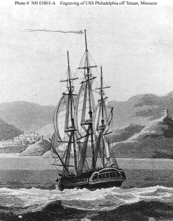

On the original picture I have there isn't anything between  the figures, there is a round hole not centered, looks like a shot hole(?).  It seems the fit the arch over the windows on the stern, at least by the wood cut of the Philadelphia entering Tetuan,Morocco.  I need to learn how to post pictures, this old dog needs to learn new tricks.

I really like that transom! Reminds me a lot of the USS President's after capture, and it has clean lines despite all the carvings. Were you inspired by this engraving?
https://www.ibiblio.org/hyperwar/OnlineLibrary/photos/images/h65000/h65865a.jpg

Charlie, looks at the wood-cut that Capt Armstrong was kind enough to post above. At first, I saw six windows, but on further study, I see seven, with the starboard-most window being kind of small, because the engraver ran out of room, working from left to right, and so had to smush it.
Edited by uss frolick
7 makes sense I am assuming all or most of the subscription frigates had 7 windows which those who survived long enough had the outer two planked over to 5. That said the arrangement on that stern makes sense I imagine she looked more or less in that fashion. :)

Going by the woodcut, I still think the Philadelphia had six windows on the stern.  The line of the rudder seems to center between the middle windows.  Could be my old eyes ,but that's my opinion.  The style of its stern seems very British, Fox design.
No, seven real windows, not counting the fake ones on the back of the quarter galleries. Seven windows and eight transom timbers. There is an unidentified gun deck framing plan in the Fox Papers showing the top-down view of eight counter timbers, which may be either the Chesapeake or the Philadelphia, (both of which he designed). Contemporary stern views of the USF United States (built in Philadelphia as well) also show seven real windows.
But is the stern engraving of the Phillie accurate?
