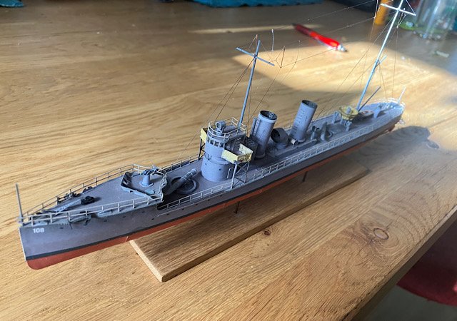

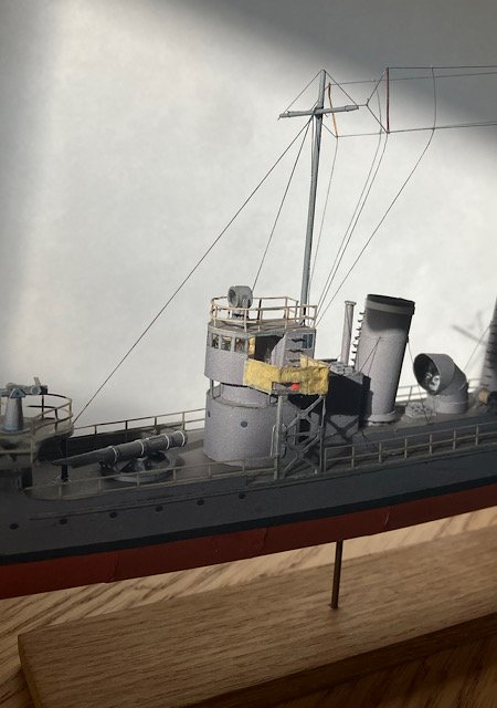

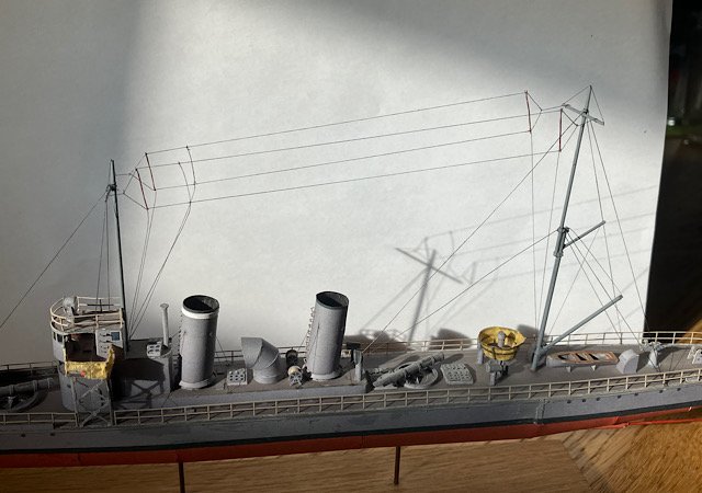

And today, I finally finished the V108 (apart from the flag, that should be there, but was not included in the download).
The antennae were a bit of a struggle, but they meet my standards.
Hindsight: I did not take the model completely serious in the beginning, so the hull is a bit sloppy, with painted patches. Apart from that: I’m content with how it turned out.
IMG_1420.jpeg.a5571a7483035956461a4c7e61eef257.jpegIMG_1418.jpeg.4a813e923a55b34098f4305a775a21cb.jpeg
Rigging was a bit difficult. The thread  is flytying thread (mostly 8/0), wich is almost thinner than my eues can see :). Also, it’s glued using CA, and CA and I are no friends :) Both antennae were done twice. Took me a whole afternoon. But it was worth the additional work: adding the antennae ‘explain’ the relatively long masts.
