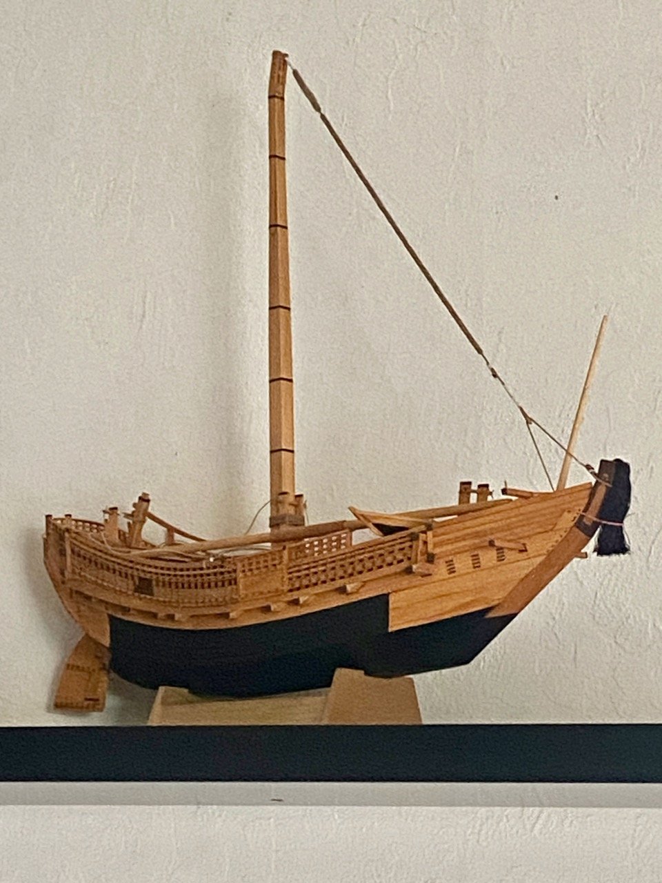

You know, when I put aside a project, I'm often amazed when I look at it later and realize how long it's been since I'd worked on it last. Kitamaebune... nearly 4 years!
Fortunately, with some opportunities to display a few ship models this year, I was reminded of my past displays in San Francisco's Japan Center. So, a couple weeks ago, I contacted the bank that owns the room with its display window, and asked about the possibility of setting up my Japanese watercraft display again. About a week later, I got a positive response, and am now on schedule to set up my model display from October 21 through October 27. That gives me some time to clean-up and rebuild my display materials.
So, I took my Kitamaebune model to the most recent local ship model meeting to get me thinking about it again, with the hope that I'll have it ready for the Janpantown display, and maybe another model display about a week before that.

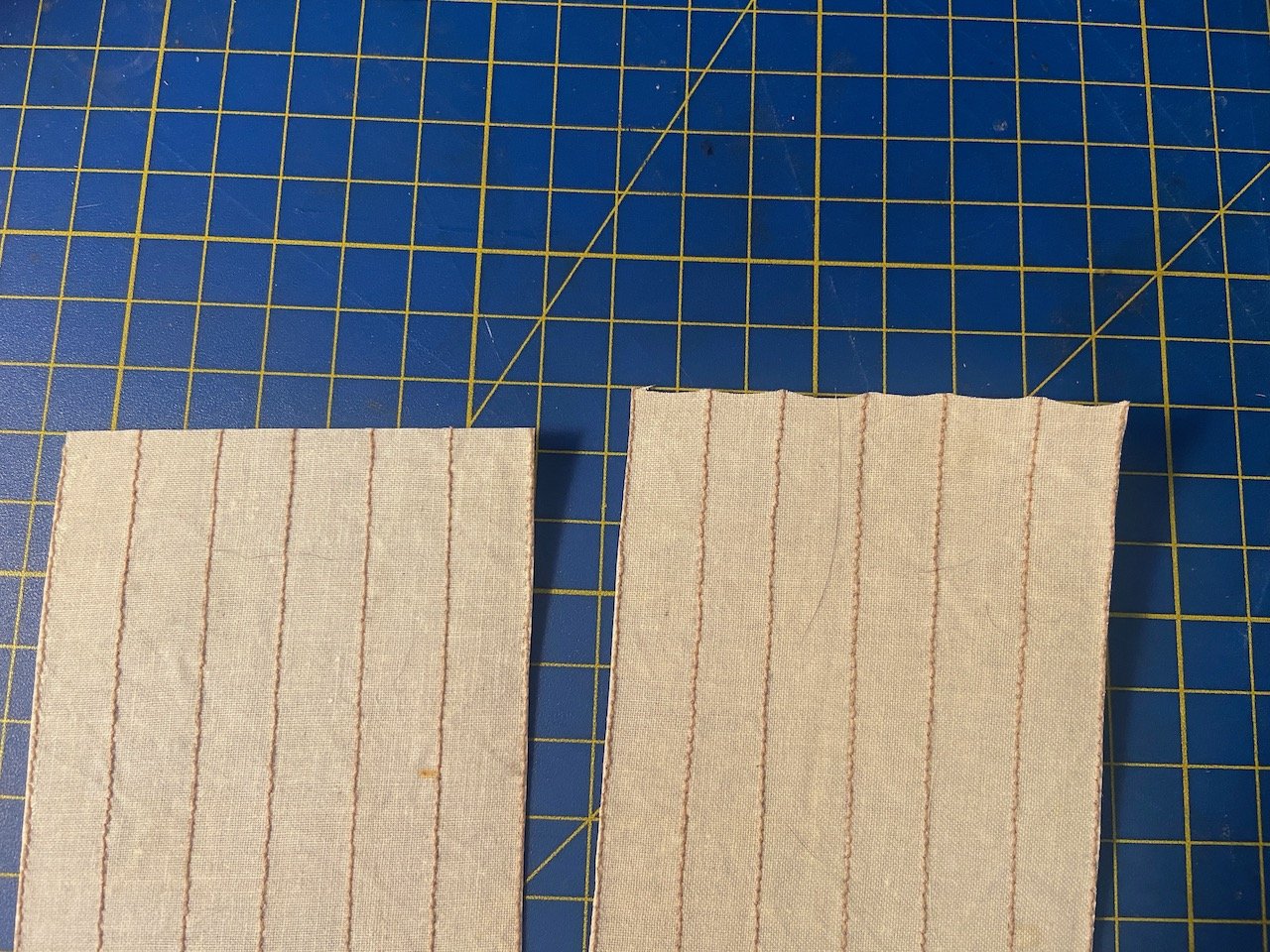

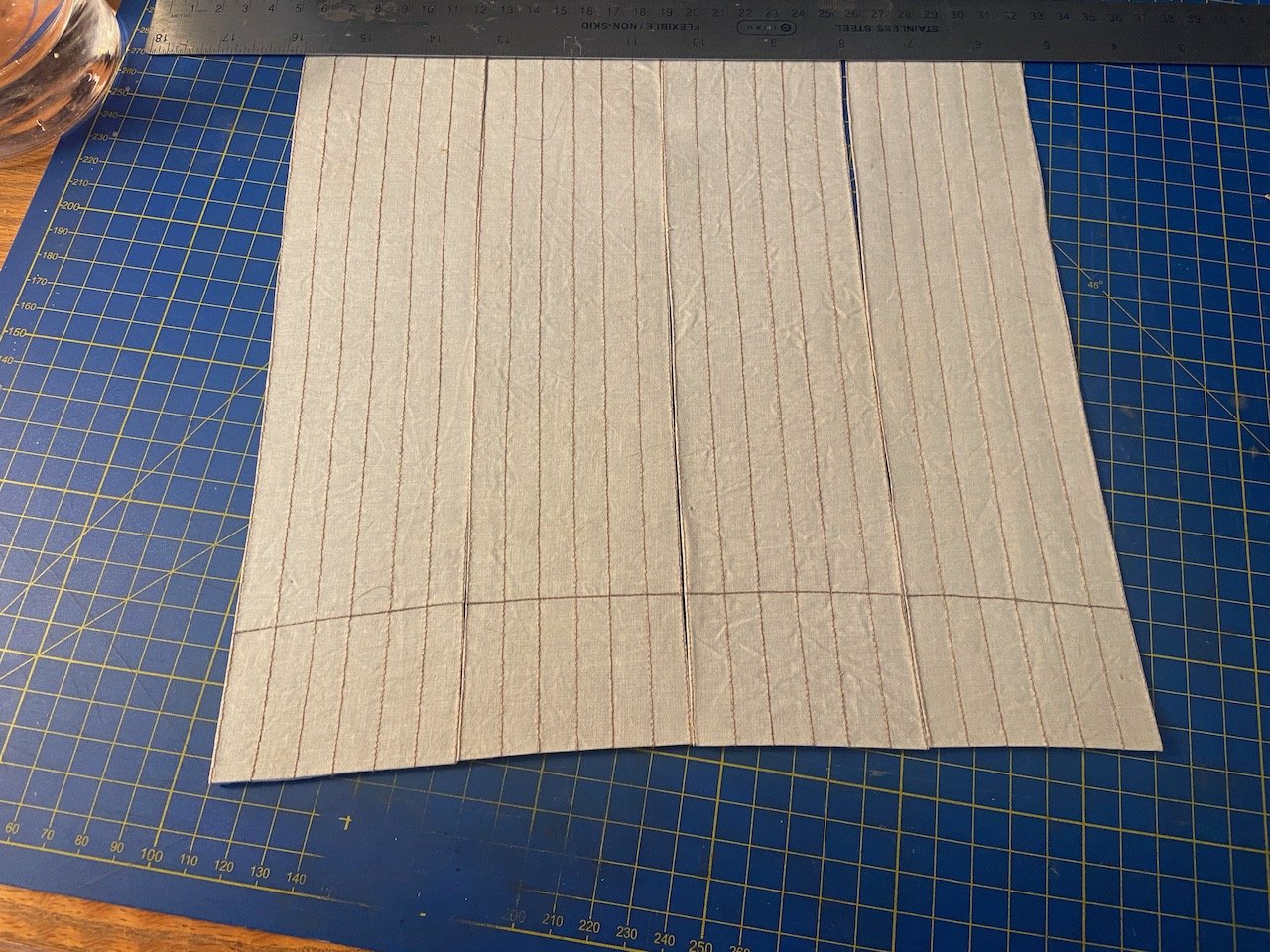

Realizing that I really just need to try SOMETHING, even if I'm not thrilled with the results, I found some sail sections I'd made before. I don't even remember when I did this. As the work pretty well fit my current line of thinking, I decided to start with these. I broke out the ironing board and iron and flattened out the sail work. The cloth is stiff, so clearly stuff I treated with Terial Magic. Also, the outer-most stitching I'd glued with Aleene's Tacky Glue to hold the stitches. Having found a test sail panel I'd worked with before, I figured I could cut the cloth very close to the glued stitching, and you can see how this worked below.
The bottoms of the panels are cut and folded over now, so I should be able to insert some wire in the foot to help give is some shape. As you can see in the photo below, I used an idea from the Takasebune's sail, creating the appearance of the sail hanging a bit loosely between the seams, where the sail will be tied to the yard arm. The sail panel on the right has been trimmed, the panel on the left is yet to be done.

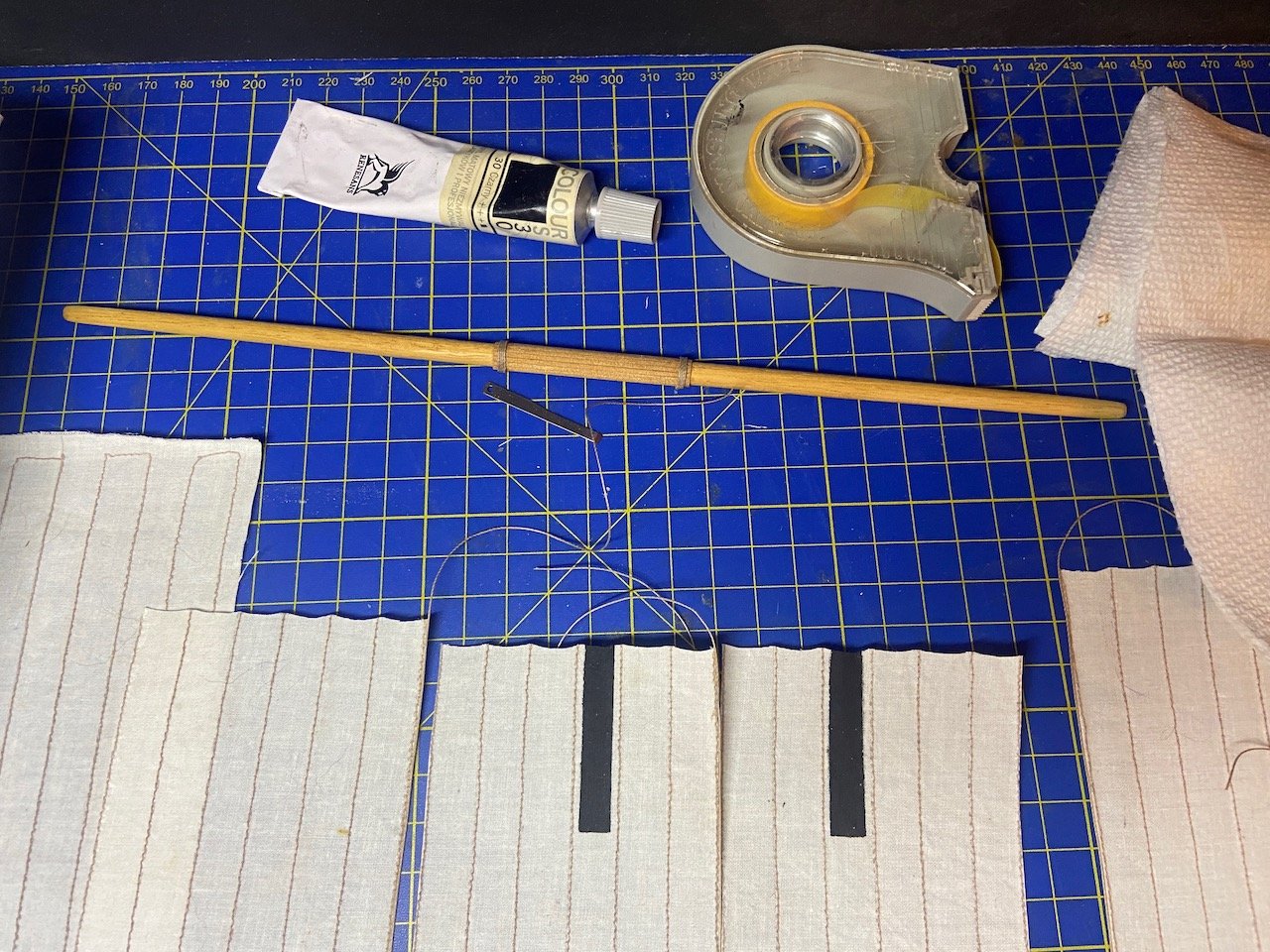

There is a feature on kitamaebune that I didn’t is used on my previous higaki kaisen model. This is a marking on the main sail that identifies the owner of the ship. There are probably some known markings of famous Kitamaebune owners, but I just made up something that’s very simple, just black rectangles on the third cloth out from the centerline of the sail. I painted these using some artist’s acrylic that I use mostly for paper models.

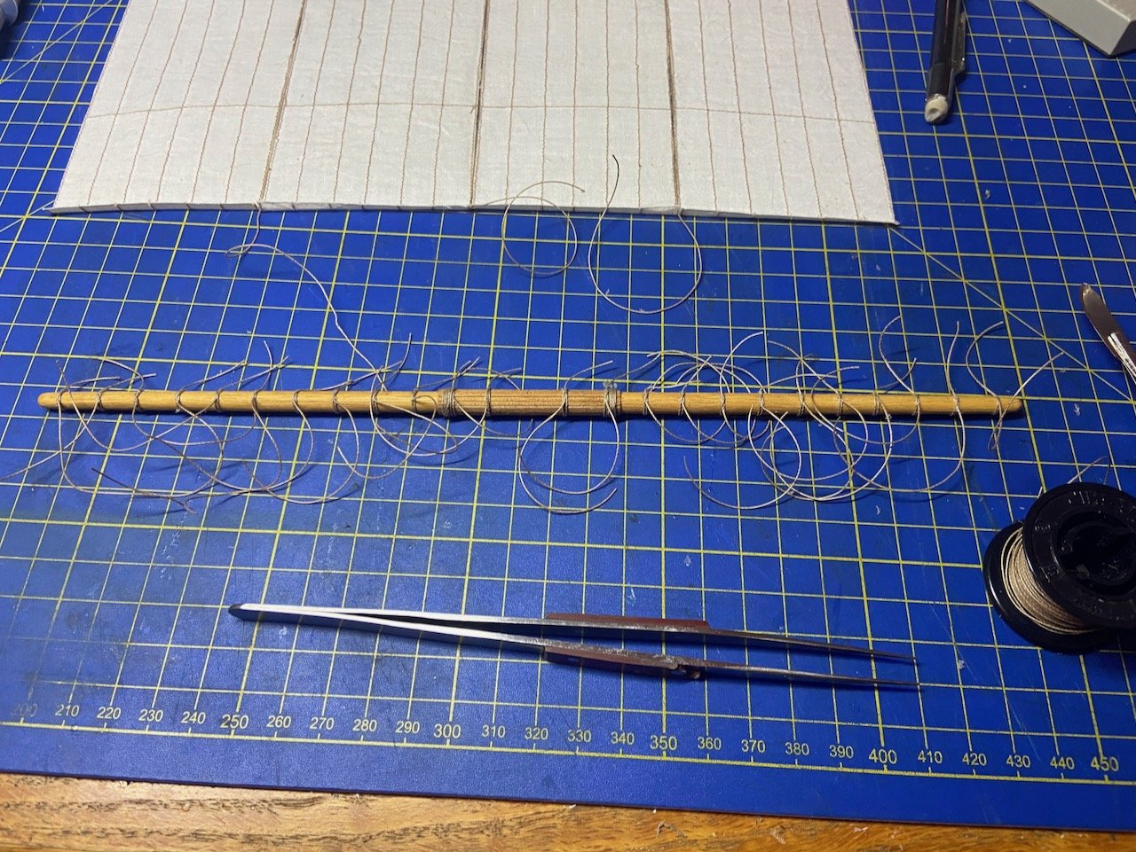

While paint and glue were drying on the sail, I decided to do the pre-rigging of the lines on the yard. For this, I simply followed the kit instructions and used the kit sail to get the proper spacing. The seams on my sails are actually slightly wider apart, but when attached to these lines, it should only work toward my attempt to make the sails look like Japanese-style sails. The knots on the lines on the yard are really just clove hitches. I'm used to tying these on ratlines, but on a thick yard, I had a hard time. The first 1/4 of them took me a long time, as I was using my fat fingers and also had a hard time seeing the ends of the lines. I finally got smart (or less stupid?) and broke out the headband magnifiers and rigging tweezers. The second quarter went better, but I needed a break. After that, the second half took me no time at all!

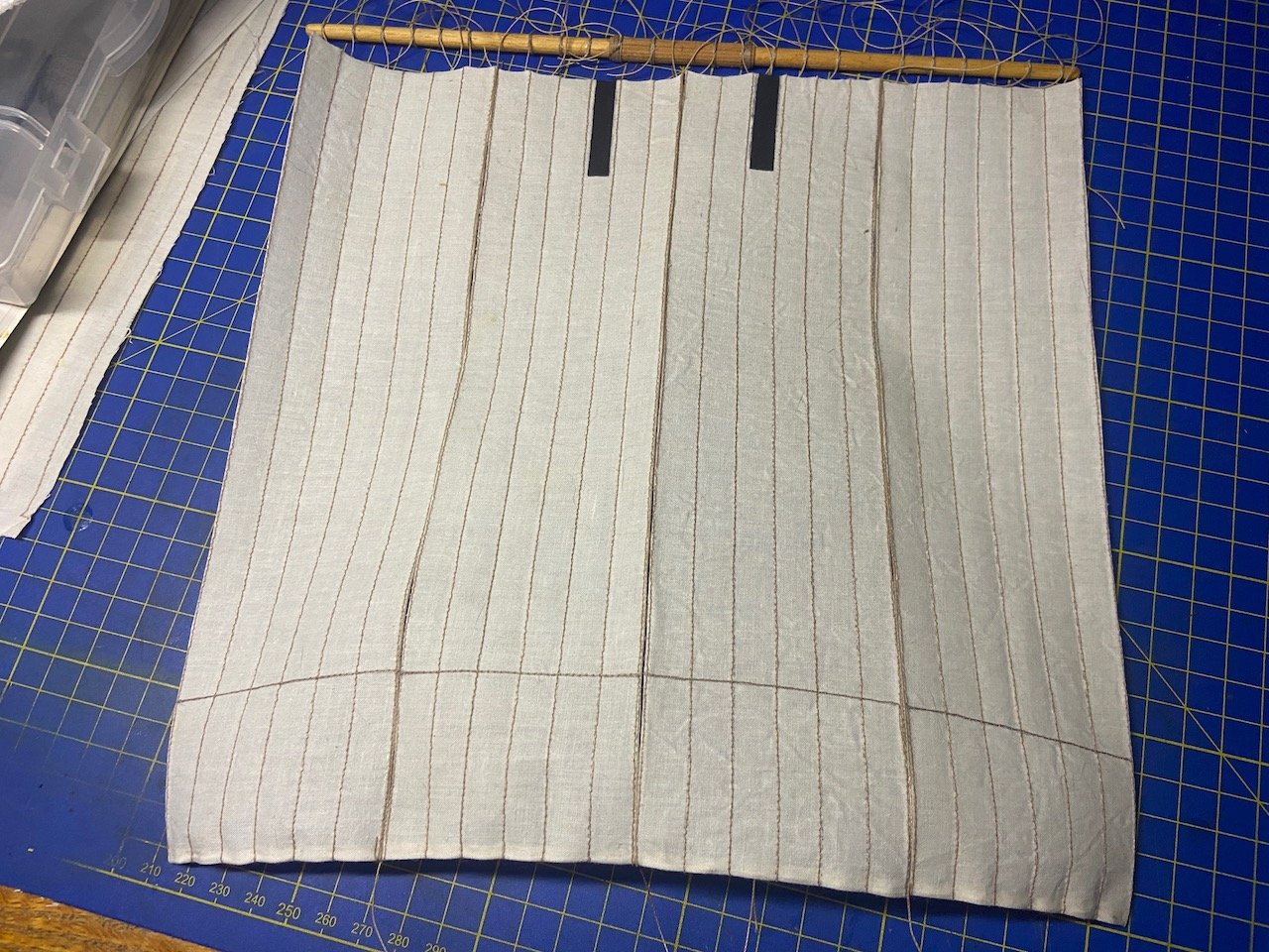

The sail panels were all glued together here, and a length of coated wire was glued into the seam I made at the foot of the sail. In the photo below, you can see how it's giving some shape to the sail.
Next, I need to attach the sail to the yard, then I'll need to cut small lengths of line to simulate ties that hold the panels together. I don't know that this will really have an accurate look, but I've seen a lot of Japanese museum models that have a similar look, so I think I'll be satisfied enough with it.
