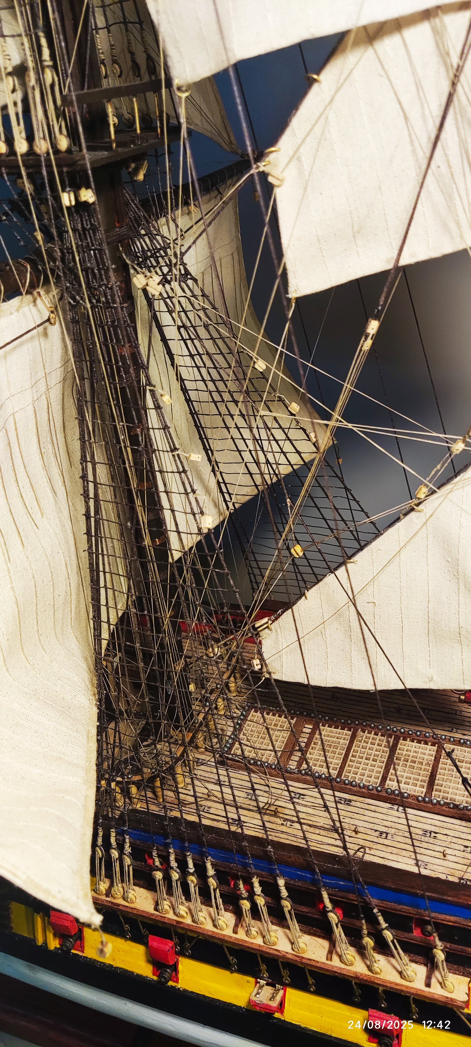

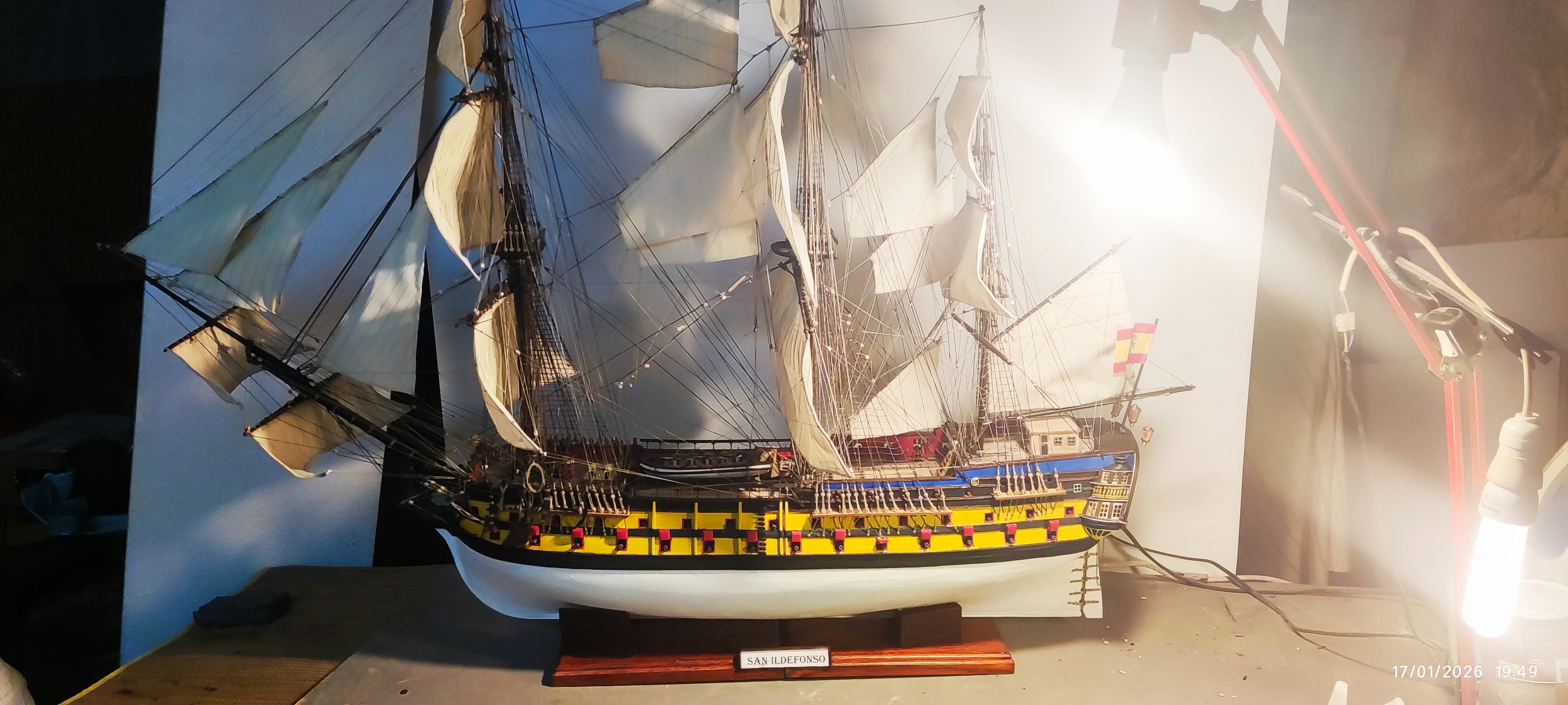

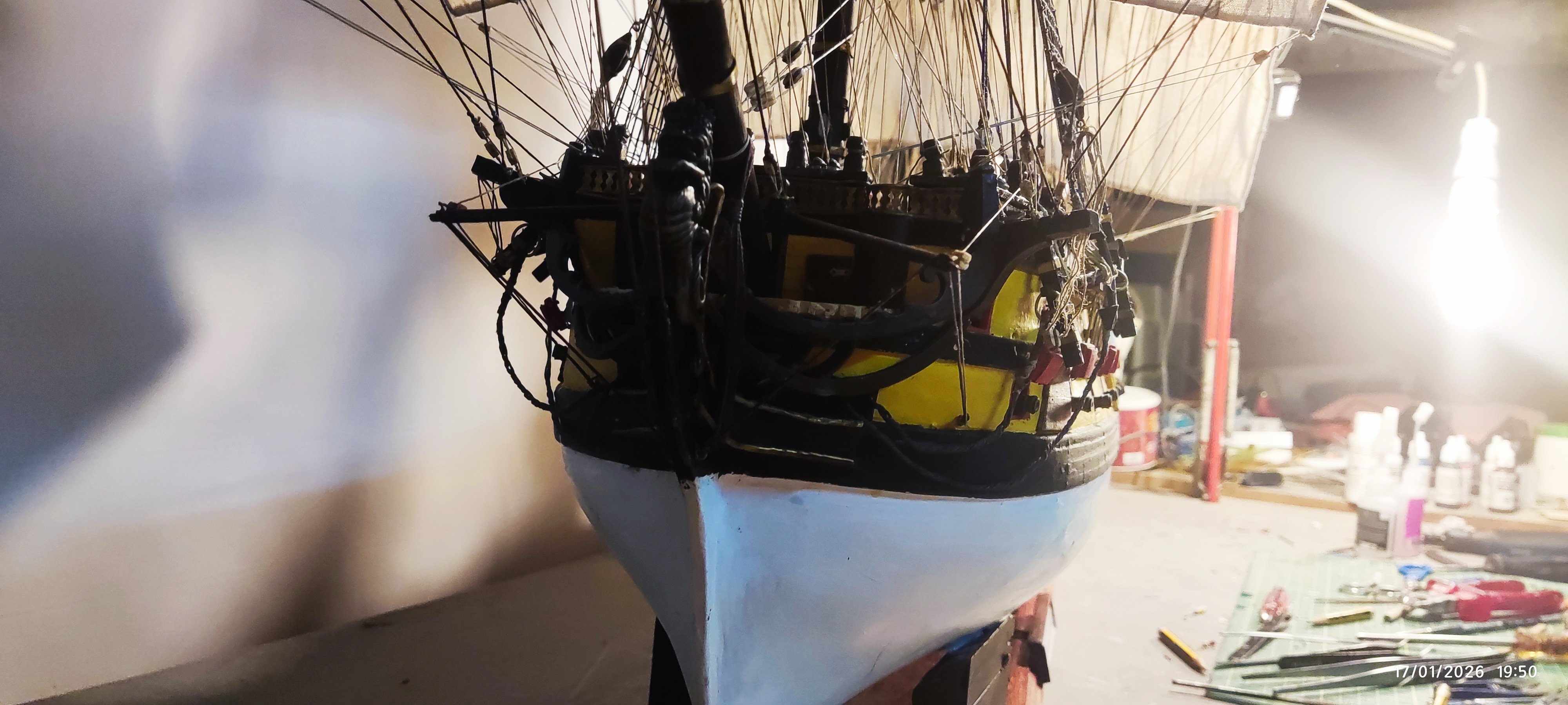

Now i have put in place the stays,long threads from top of the mast to the free deadeyes, after i use most of them with the shrouds. There are 11 threads for the three masts for left side and another 11 threads for right side. I use thread 0.50 mm brown. Now all deadeyes are occupied.Is time now to put in place the yards that i have allready finish. Starting with the lower yard of foremast, put in place for each one, all the threads 0.15mm that the manual show.
All the yards from the fore mast are in place permanent with all threads that they need. Now the work around the model is more difficult, because  i can damage the yards working with other threads. I must be carefull with my arms. Now we proceed to make the same job in the main mast

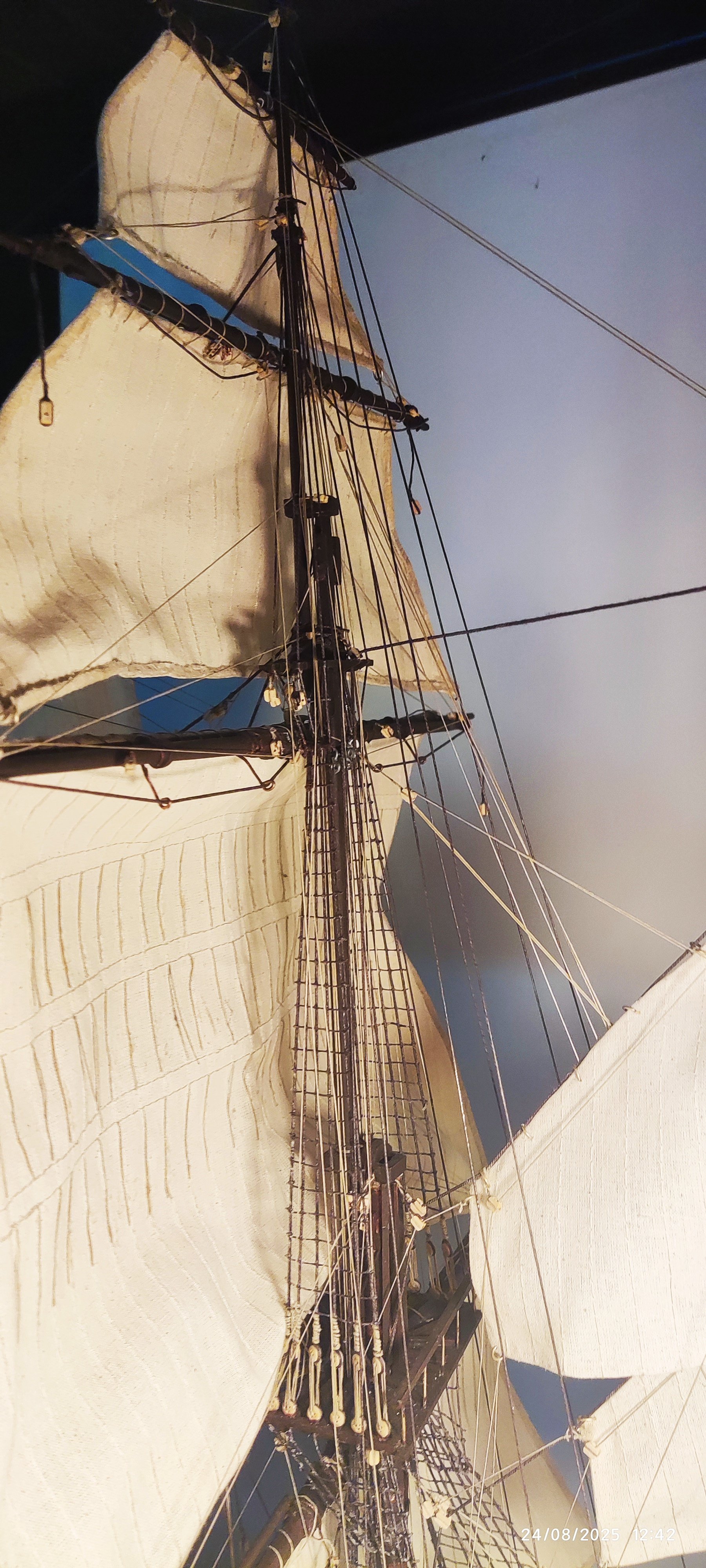

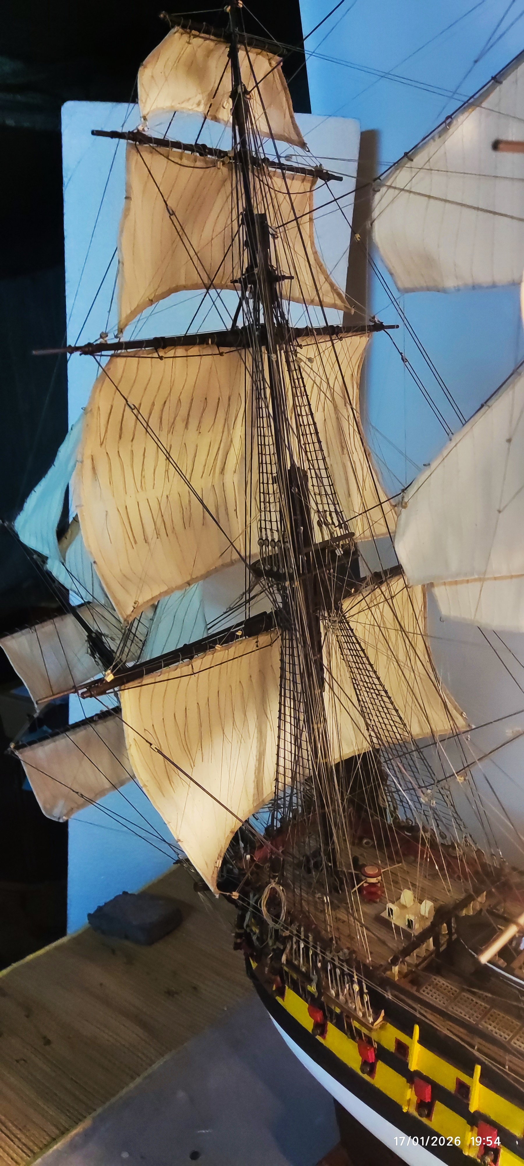

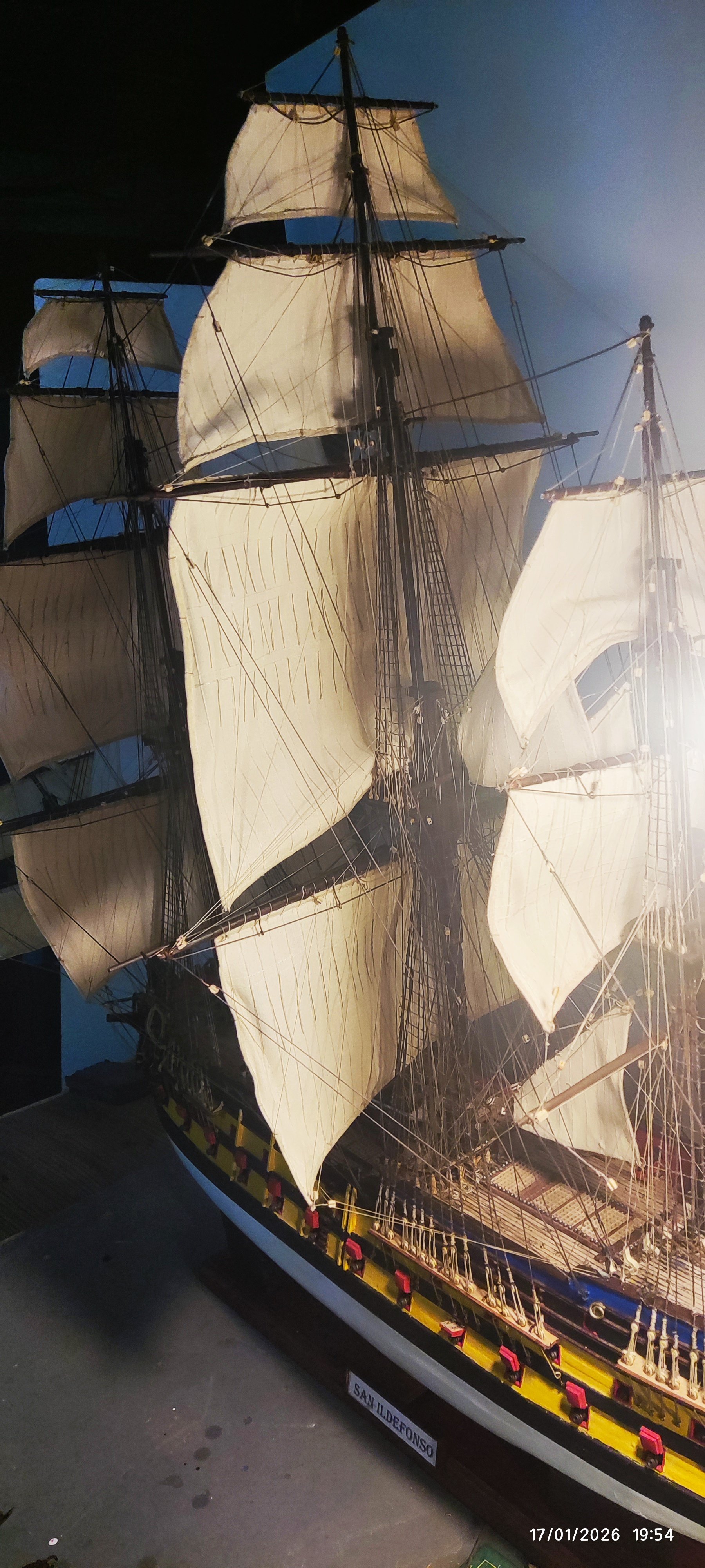

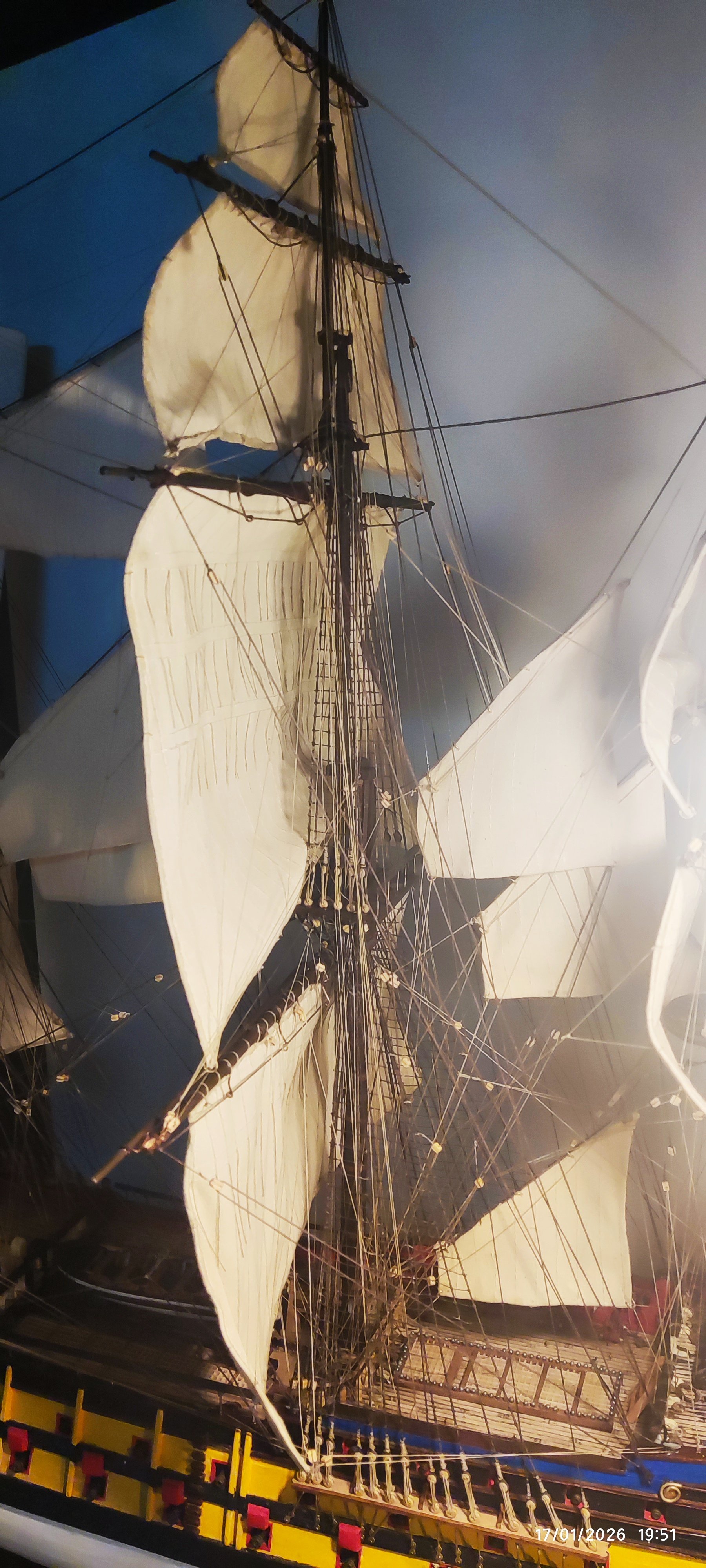

Start of the sails. Here are the two sails of the bow. To give the shape of the blowing sails, i put small wire at the four edges of the sail. All threads all put in place and tident to the specific place as shown in the instructions.Spare thread are placed on the deck
Edited by gsxdent59

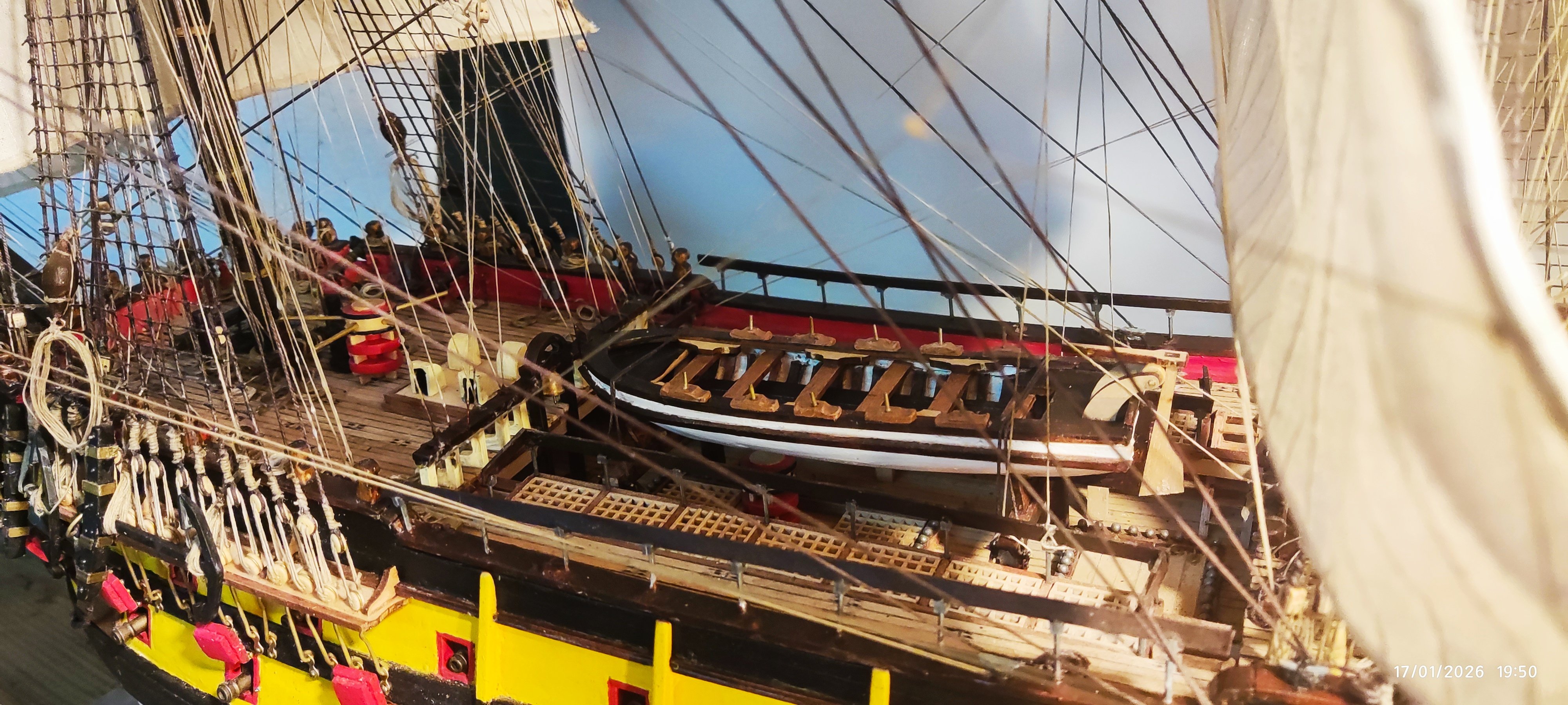

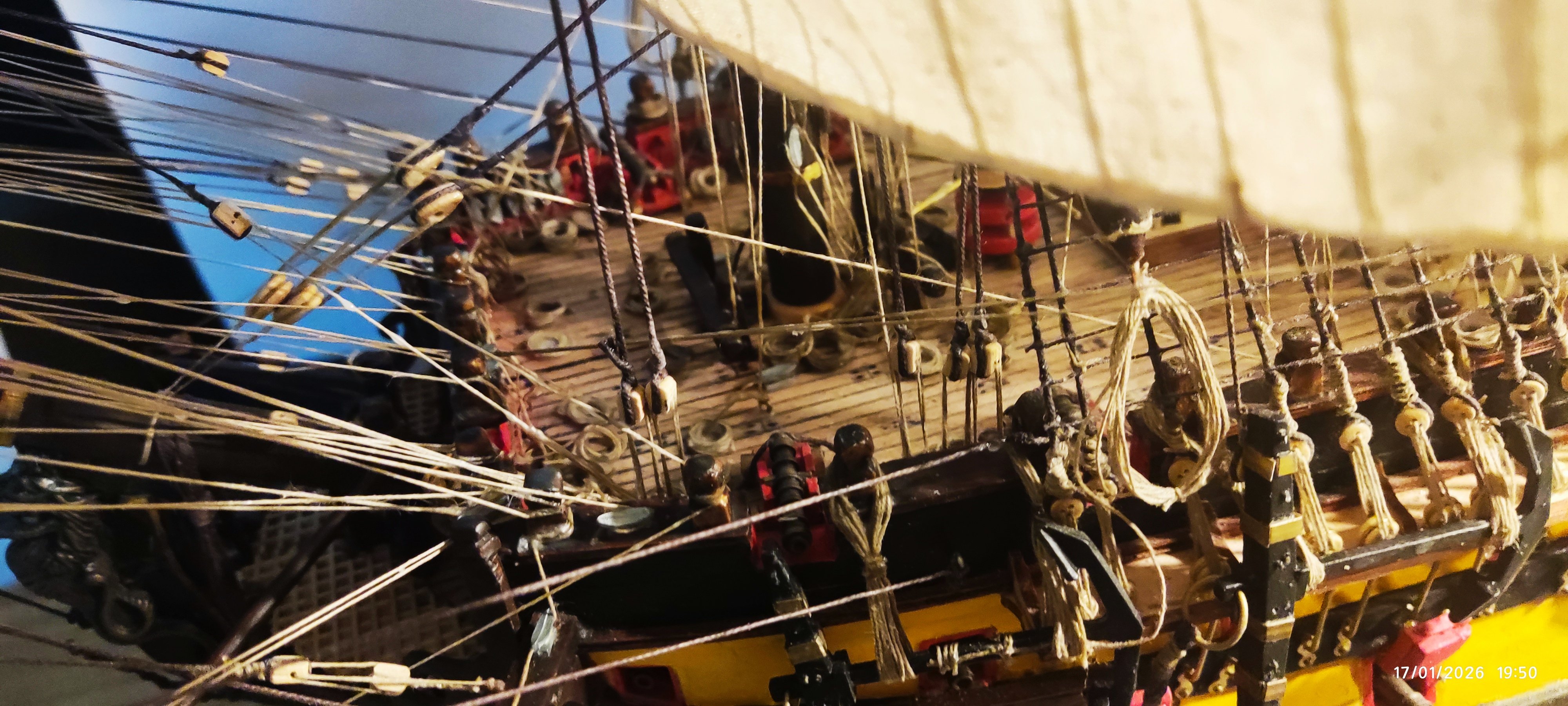

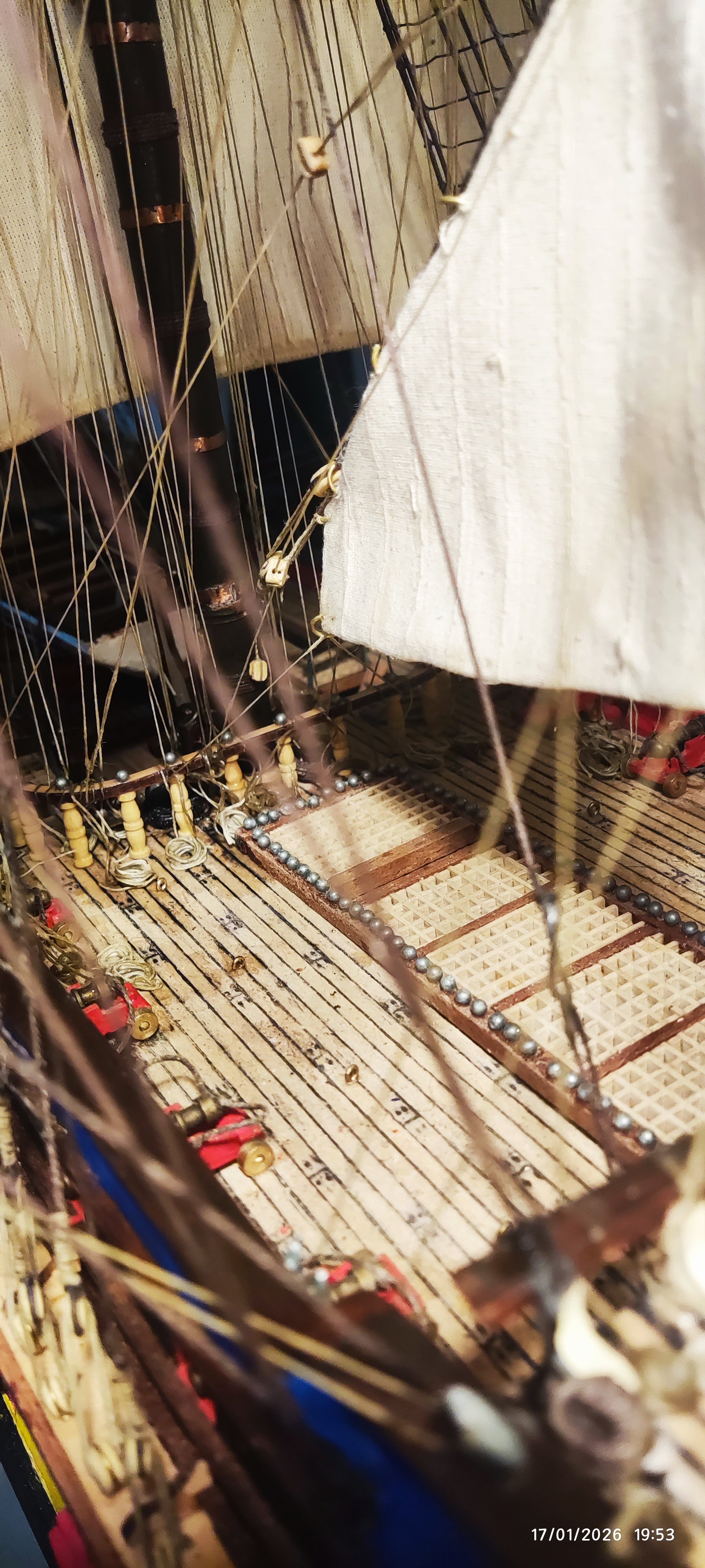

Now is time for the lifts of the yards,that raise and turn the yards to right positon,according the wind. All of them must secure in specific place on deck, according the insturctions. A lot of threads, and the space for the hands limited. Extra carefull movements, not ot brake or damage other things of the ship.

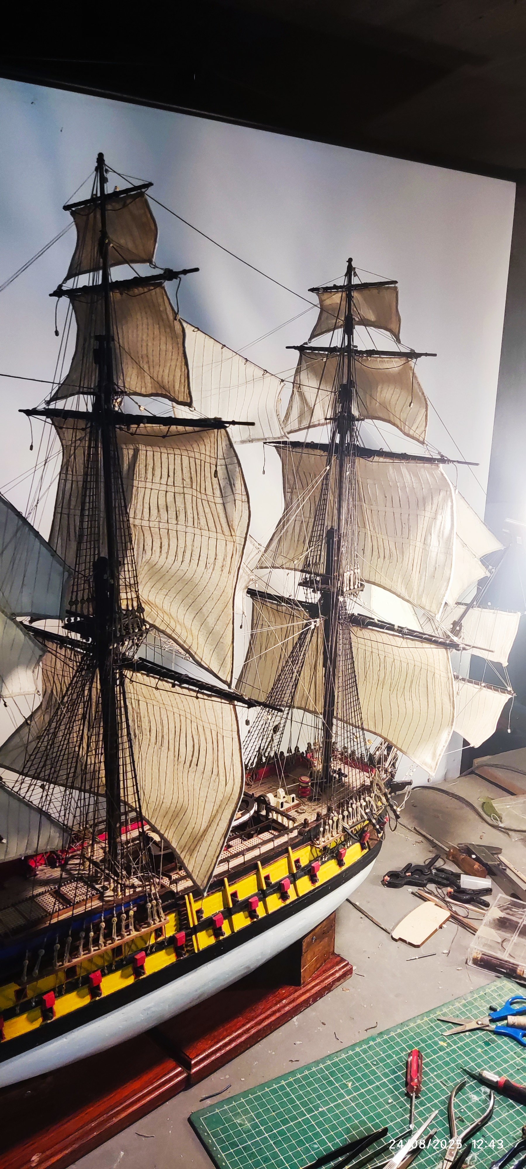

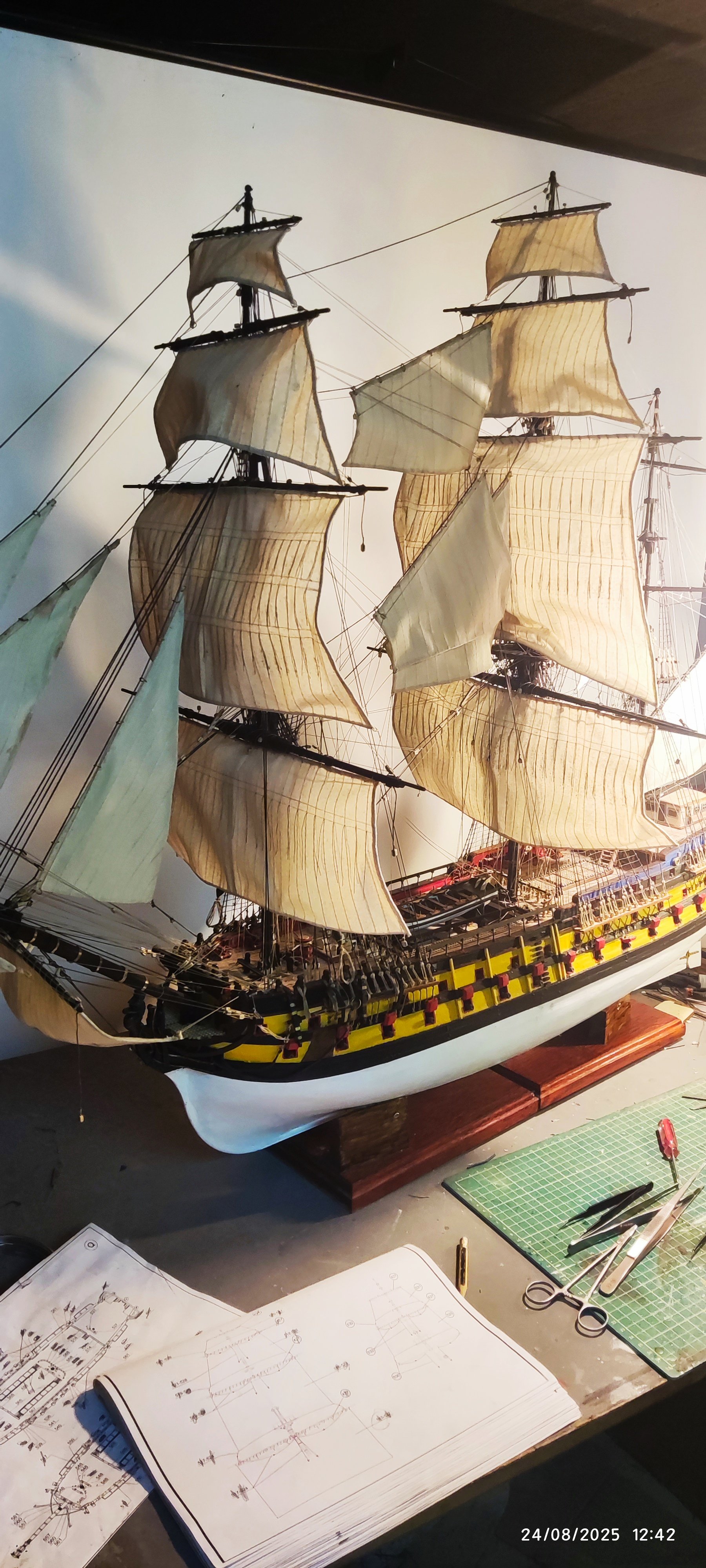

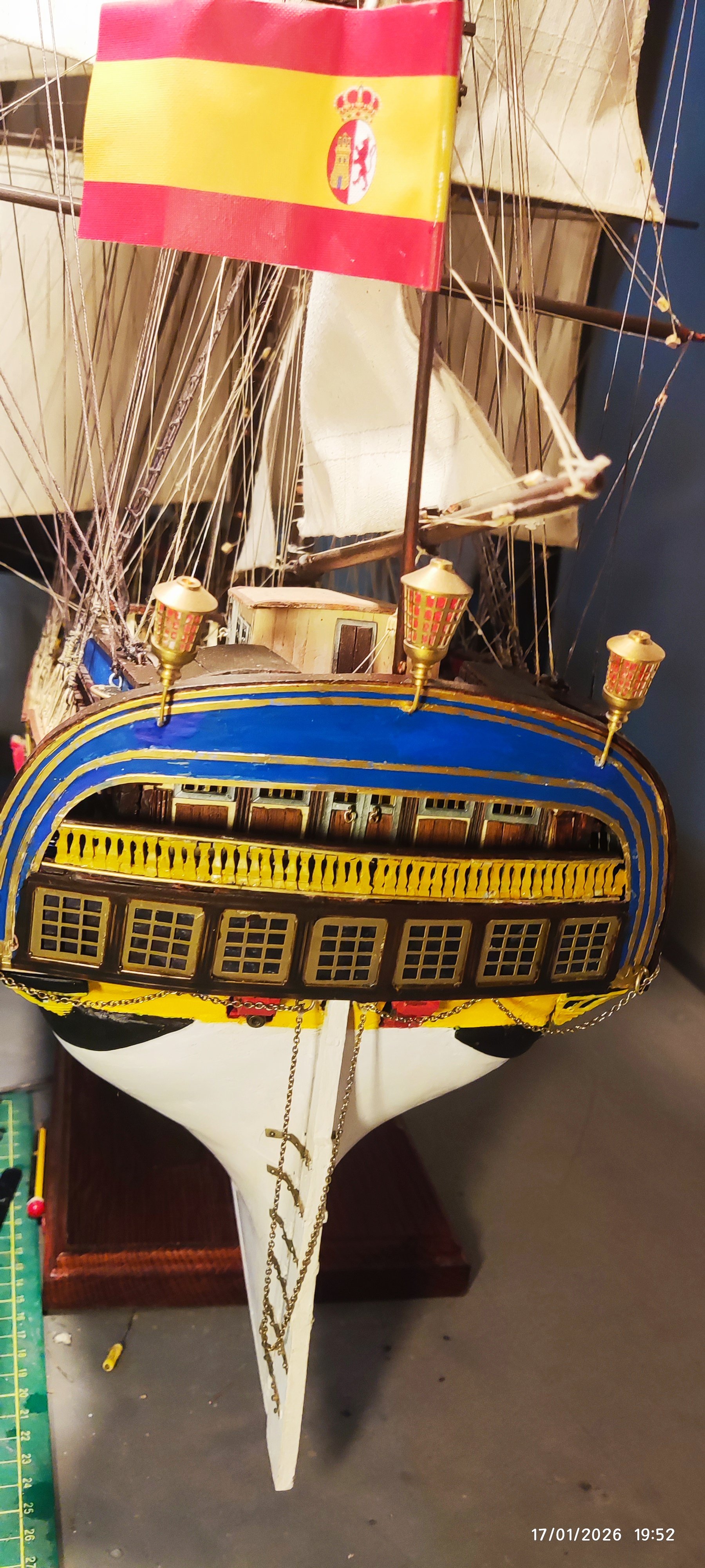

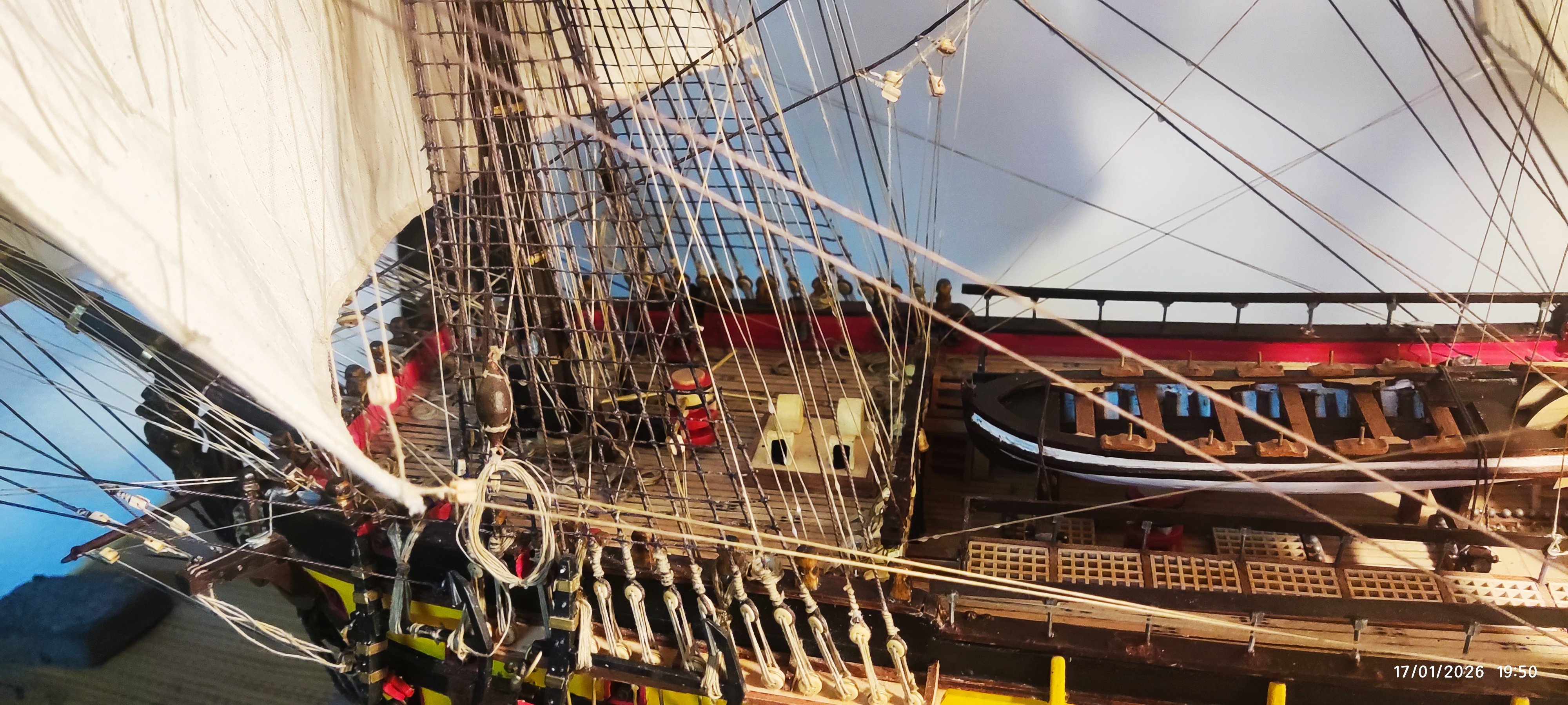

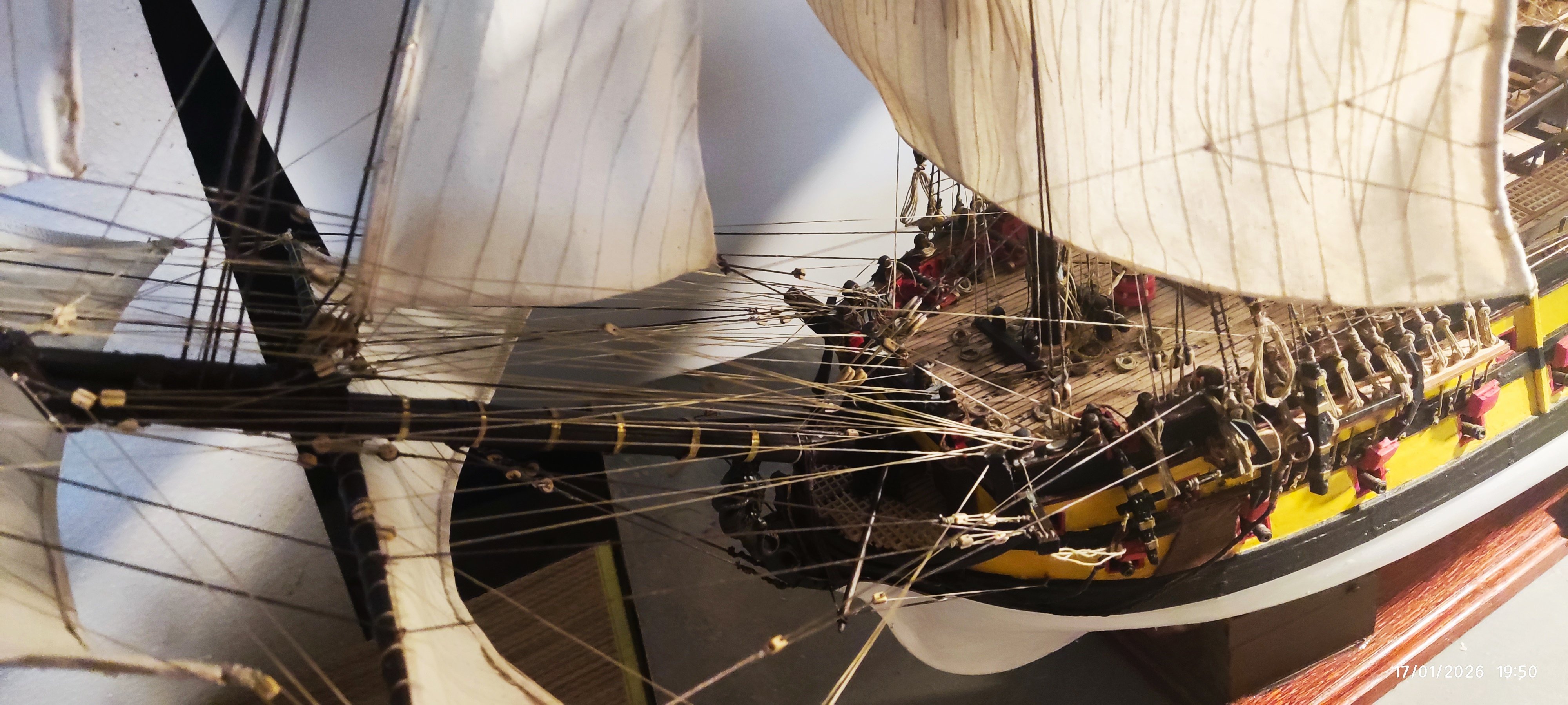

Continue to put in place the sails. The first jibsail, the middle saty sails and the throat on the stern. I use o-rings for this sails and put all the threads for each sail ending them where the manual indicate. Using scissors is necessery for working,because now a lot of theads are present on the ship. And more will come....
