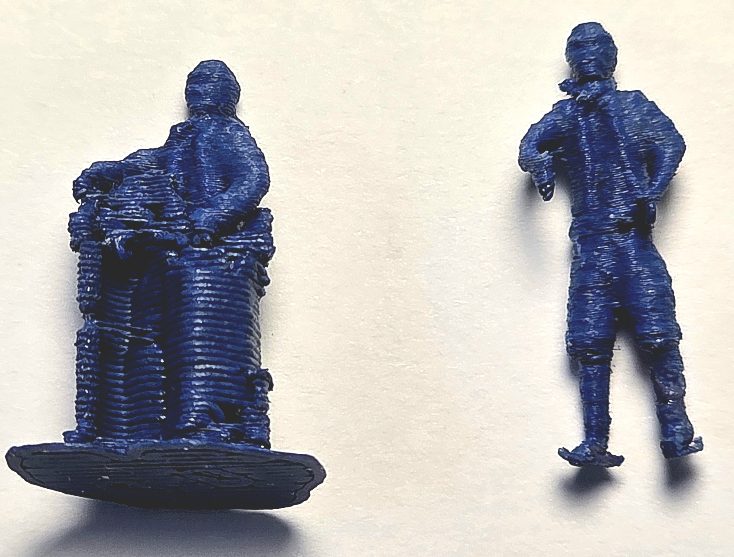

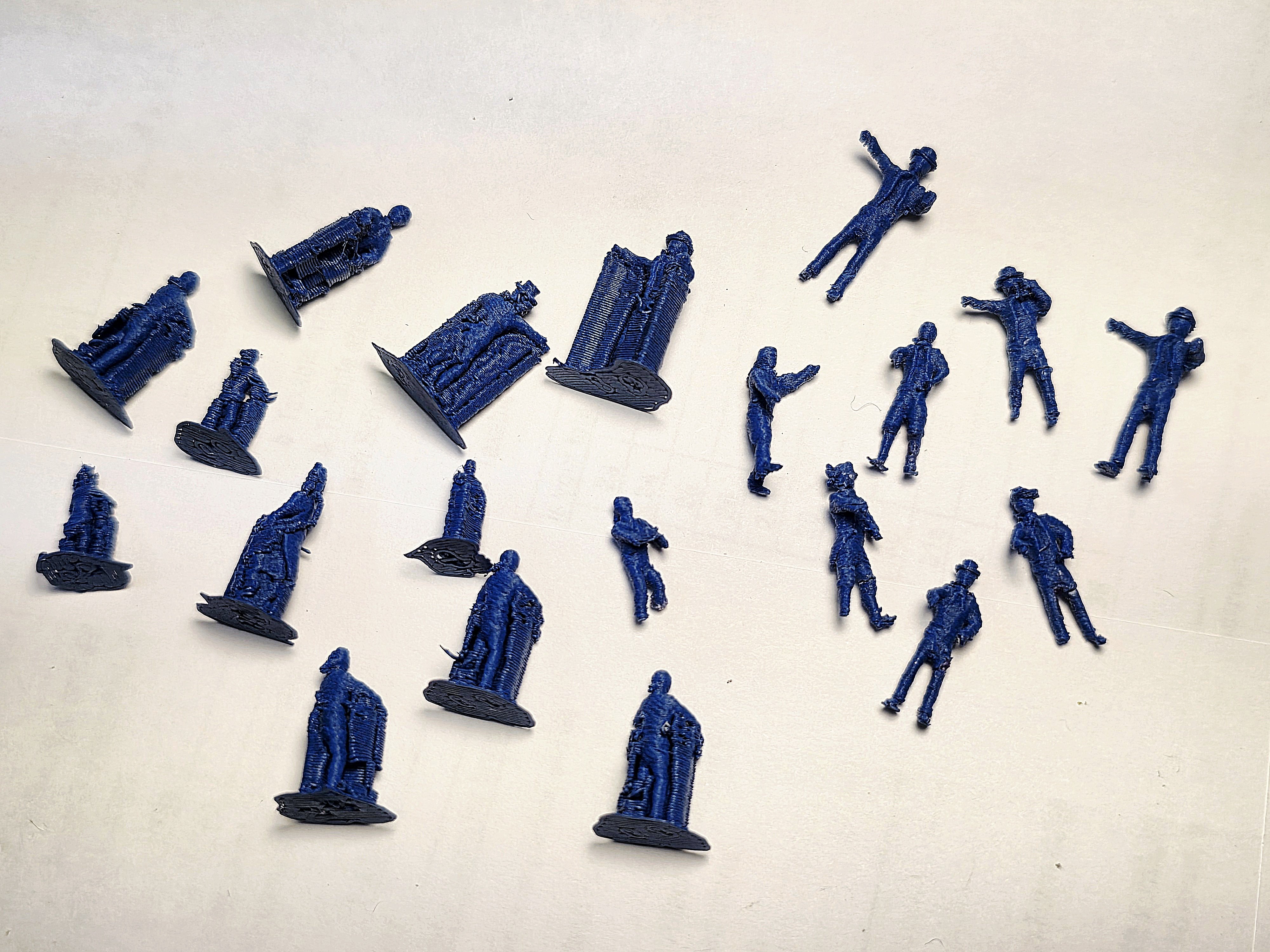

As a diversion to the seemingly endless yard building and rigging, I have been experimenting with making 3D printed figures for adding to the final model to give the model a better sense of scale and interest.  With the help of my son-in-law who has a 3D filament printer and a free 3D file I found on the internet, we were easily able to produce a number of figures.
The biggest challenge is  separating the figures from the  surrounding support plastic.  This has been rather difficult as the plastic is so brittle.  I broke off many of the tiny arms and legs in the process which fortunately  I was able to reattach with super glue.
The printer is not a high resolution resin printer so really fine detail is not possible.  However at 1/96 scale I don't think this will be a concern.  The printer had problems printing out hands and feet so I expect I will be adding these to the figures later using autobody filler material (a trick I learned from scratch-building model RR figures).
The images below show some of the printed figures with the surrounding support plastic and other figures I separated from the supports.

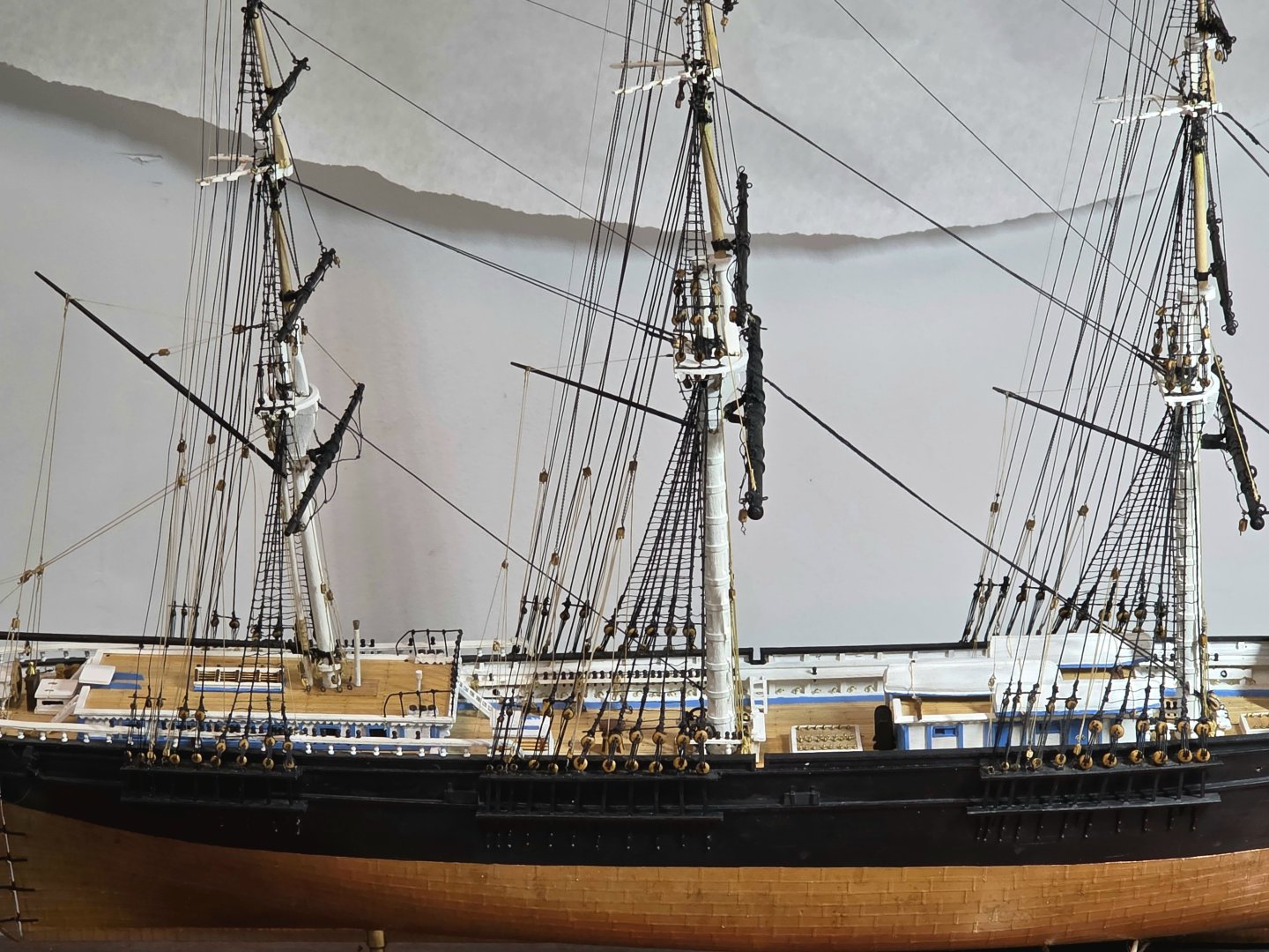

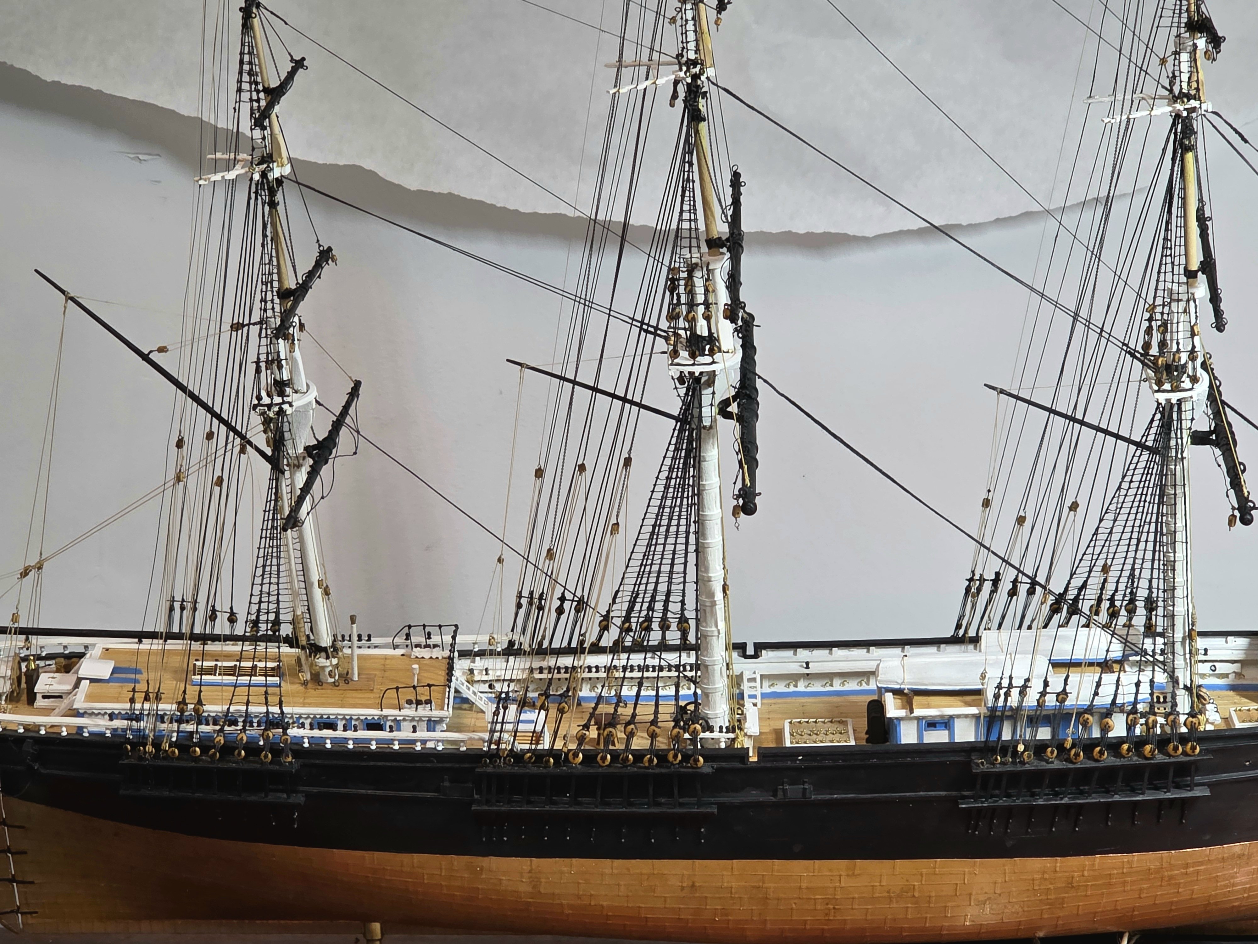

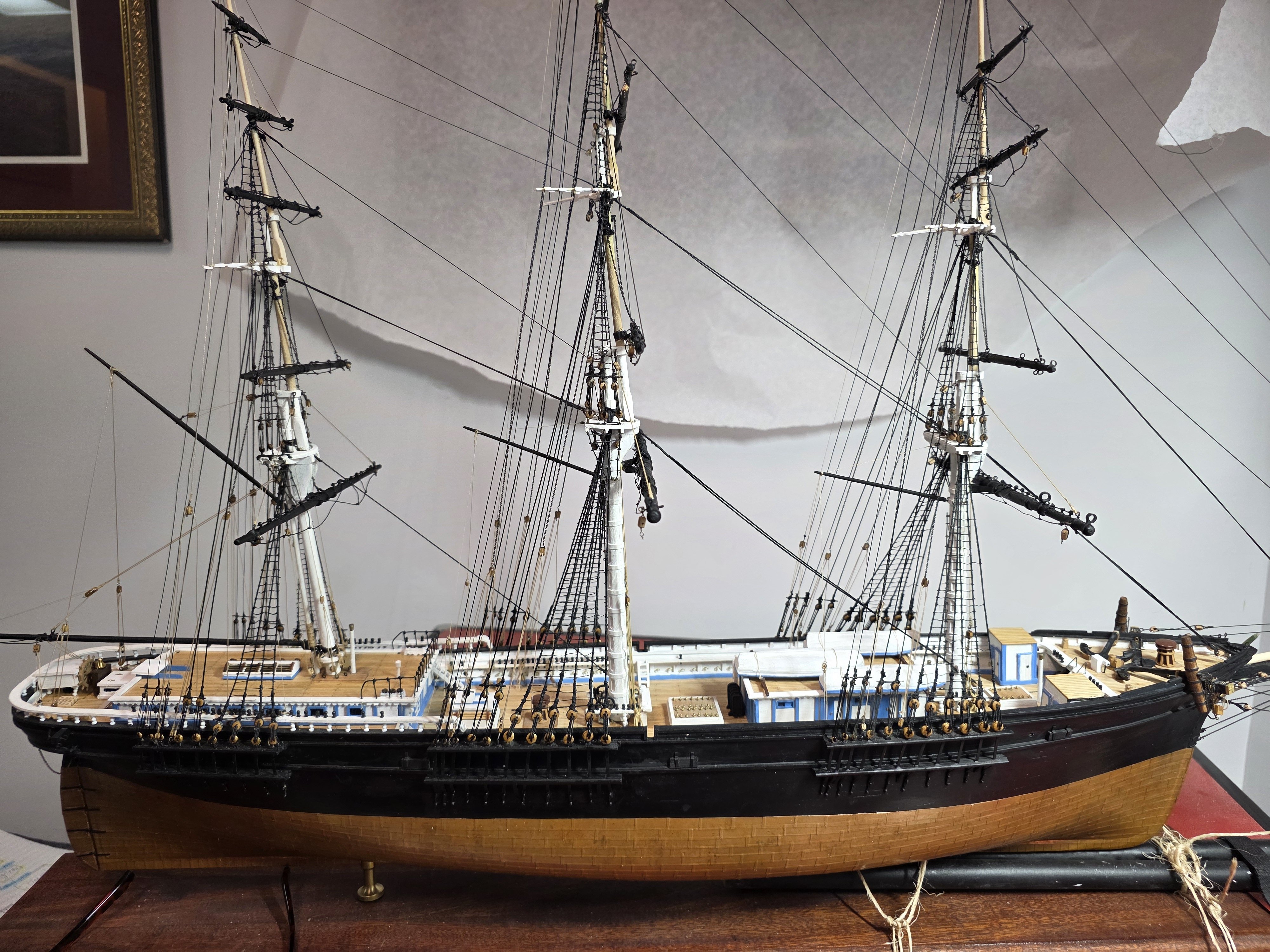

After a lot of fiddling and tight work, I managed to make, mount and rig the gaffs on the main and fore masts.   My only potential concern is that the angle of the fore gaff may be a bit low.  Any thoughts?  Unless this is a gross error, i am inclined to leave it as is.

@Jared technically fore and main gaff are at the same inclination. I doubt anyone will fault you for leaving it alone if you're concerned that it's too hard to fix. You could also add some sailors working on it to show activity to adjust the boom's position as well.
Thanks Rich.  I think I can fix it.  Will have to replace 2 of the lines. Easy to remove with water as used carpenters glue on rigging.

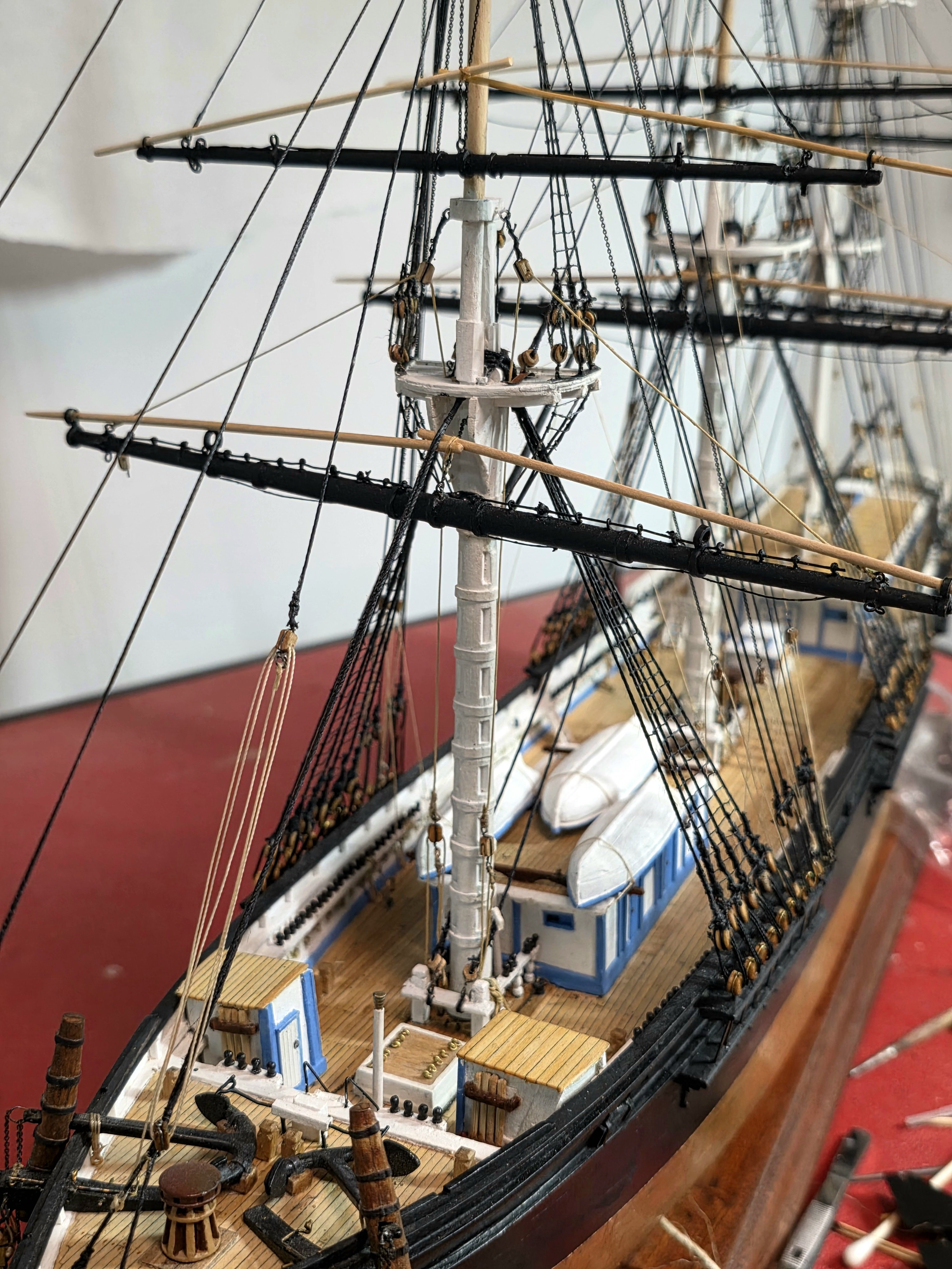

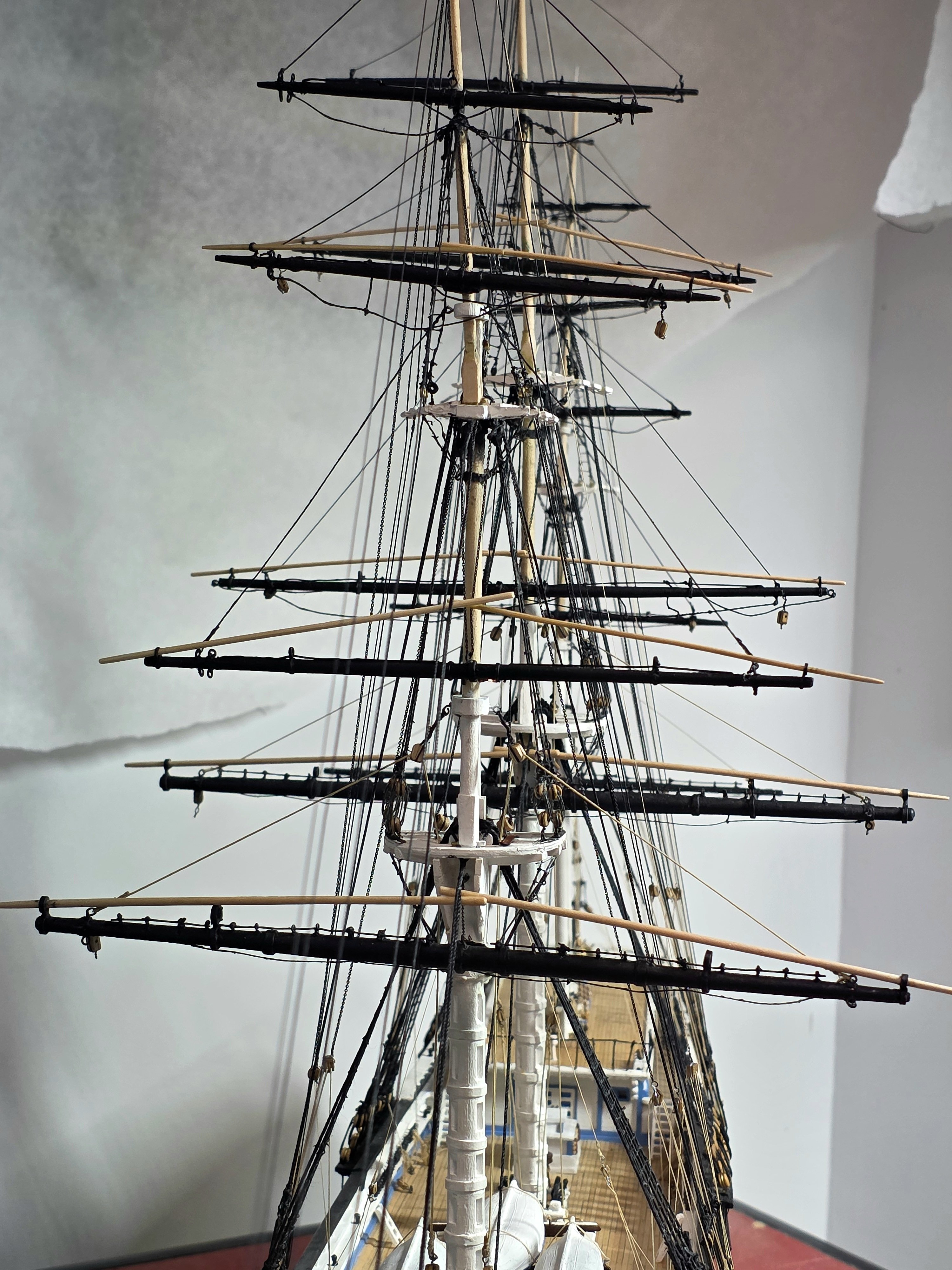

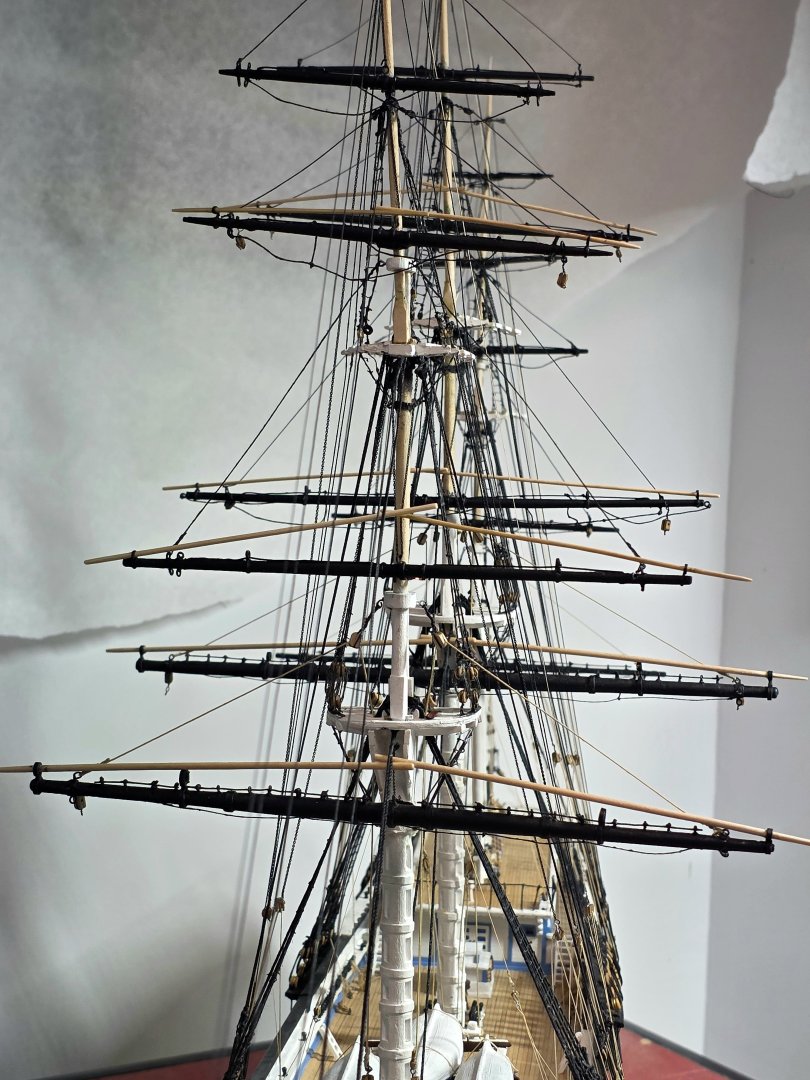

Today went very well.  I made the 6 stunsl yards and glued into place on the fore and main masts.  Tomorrow I will add the securing ropes to tie them to the slings.
Good Job and progress.  I never understood why these kit manufacturers always store the stun-sl booms in this fashion?  They remove the boom from the inside ironwork and elevate and cross them.  I've not seen this in any images of any clippers I have ever modeled...or seen, just models..  You would have to push the boom out pretty far, to remove it from the inside iron......then pull it back in and then elevate and cross it, with the opposing boom...then tie them off.    Possibly this was some captain's method of *trimming* his ship, while in port for some long stay.   A lot of man hours for an unnecessary practice.  Forgive the rant.
You're nearing the finish line.......😁
Rob
Current build:
Finished build:
Current build(On hold):
You bring up a good point that I do not know the answer too.  I have gone through several clipper books I have and can only find 2 examples of the stuns'ls stored in the angular position.  One is a drawing on page 7 of the China Tea Clippers by George F. CAMPBELL and the other is a photo of the Great Republic in 1860 (page 71 in Clipper Ships by David R. MacGregor.  In most photos I have seen where stuns'ls are present they were lashed to the spar and/or slung beneath the yard.  The photo of the Great Republic shows the lower yard  stuns'ls slung below the yard while those on the higher yards look like they were lashed the way the Flying Fish plans show.
Indeed....Like I said....the captain must have *trimmed* his vessel with this boom configuration while in port for some time....note; the jib boom is also retracted.  Done when up against a pier or in port for an extended stay.
Stowing the booms in this fashion does not permit an expeditious retraction of the boom when underway...to catch the slightest breeze.   I still don't understand why the boom would be pushed nearly all the way out of its inner iron, then pulled all the way back to meet the opposite boom, tied up in this fashion.:default_wallbash:   Unless you are *dressing* her rig.
Thanks for the pic Jared.
Rob
Current build:
Finished build:
@Jared I hope you don't mind but I realigned both images and took some of the graininess out of your enlargement. No surprise, I agree with Rob. Stowing stuns'l booms in a traiangular criss-cross setup must have only been employed while a clipper was docked for an extended period of time. At sea, it would make sense that these same booms would be rigged for most immediate deployment as circumstances demanded.
Thanks Rich.  Thanks for improving the photos.  My model will be in dry dock for a long time so this works 😀   but I do agree this would not have been the way it would have been most times
One other thing we might be overlooking is.......The GR has her sails furled in the military fashion...where they group up in the middle of the yard, with the clew lines exiting there.  With this furled arrangement...the fully retracted booms would rest atop the furled sail....and since the sail is bundled up mid yard...this would cause the booms to flex up atop of them.  Giving the impression they are simply being tied off at the yard halliard.
Looking at this close-up image you can see the boom atop the furled sail. The fore upper topsail yard exhibits the same condition.  No free space between the boom and the yard.  Furled Sail is between them.
Many stunnsail booms were made from flexible, (but strong), bamboo.

Jared, I read that the stuns’l booms were tied off to the chain slings to get them out of the way when the sails were furled, just as Rob suggested.  At sea, sails would not be furled, but they would be reefed. What then?  Can’t imagine man handling those booms at sea so the sails could be reefed.

One thing I noticed when I installed the stuns'ls on my model is that it gave the model a huge step upwards in the visual appeal and perceived complexity of the model.   The "bright" natural colour of the wood provided a nice balance against the black yards, making the latter stad out more.  I was quite pleasantly shocked.
On tip I forgot to mention was that I used narrow diameter wood dowels from incence sticks to make the smallest diameter stuns'ls, which worked out rather nicely and saved me hours of sanding down wood dowels.
Rick
@Rick310 perhaps that's why the stuns'l booms were hung below yards as well. That way the booms wouldn't interfere with crew working the sails.
@Jared Stuns'l booms definitely add color contrast and interest to your yards. Mentioning incense sticks, besides being an innovative idea brings me right back to the 70's when everyone who was anyone had sandalwood punks burning in their homes....;-)
That's it Rick. The booms are triced up like that to allow access to furl the sail beneath it. The difference between furling to the bunt or not plays a part as well of course but the main reason they're triced up is to furl the sail beneath it. They're then stowed back down on top of the sail when it's furled. And your guess about hanging them below the yard such as in Cutty Sark was for that reason as well.

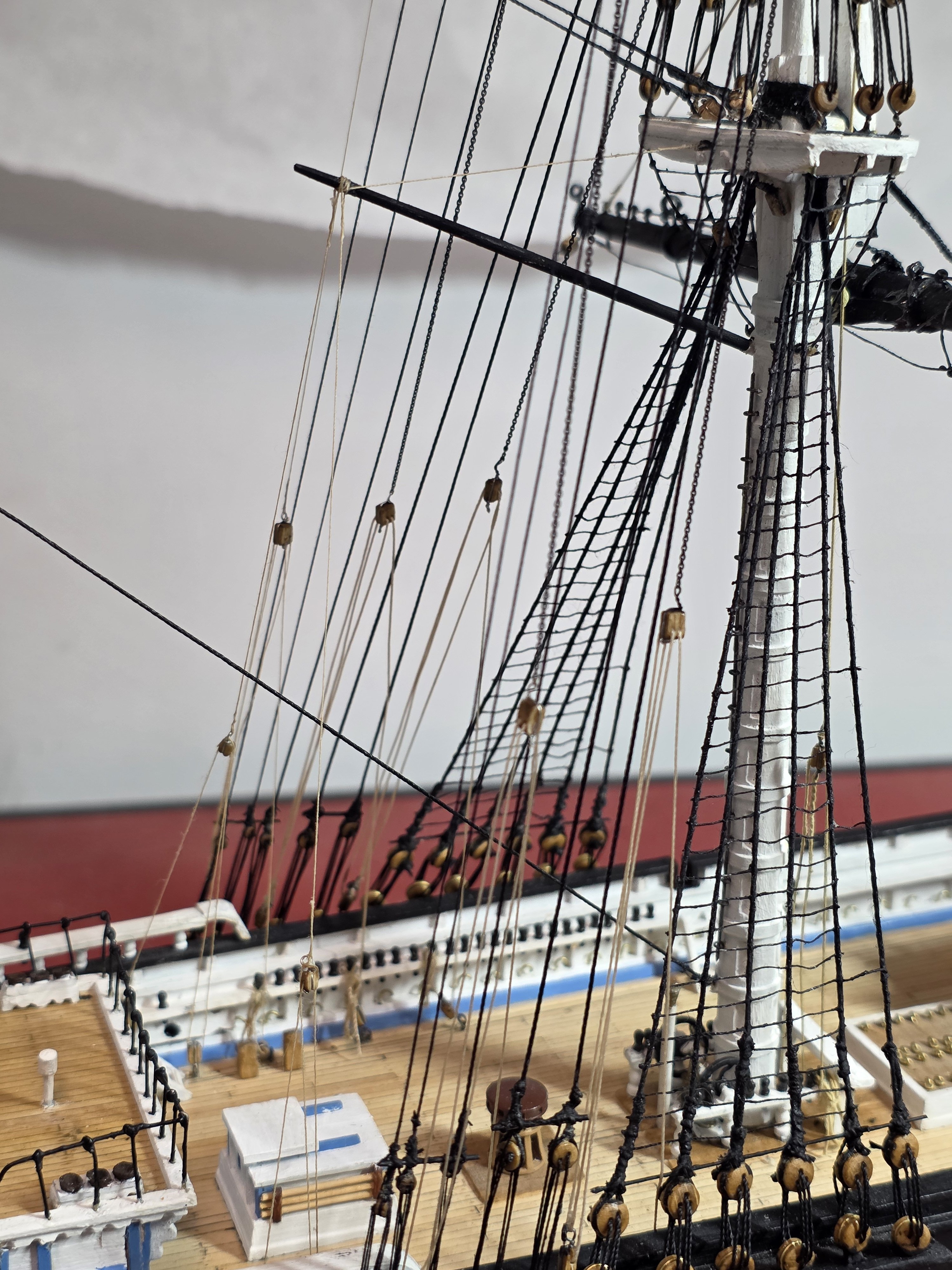

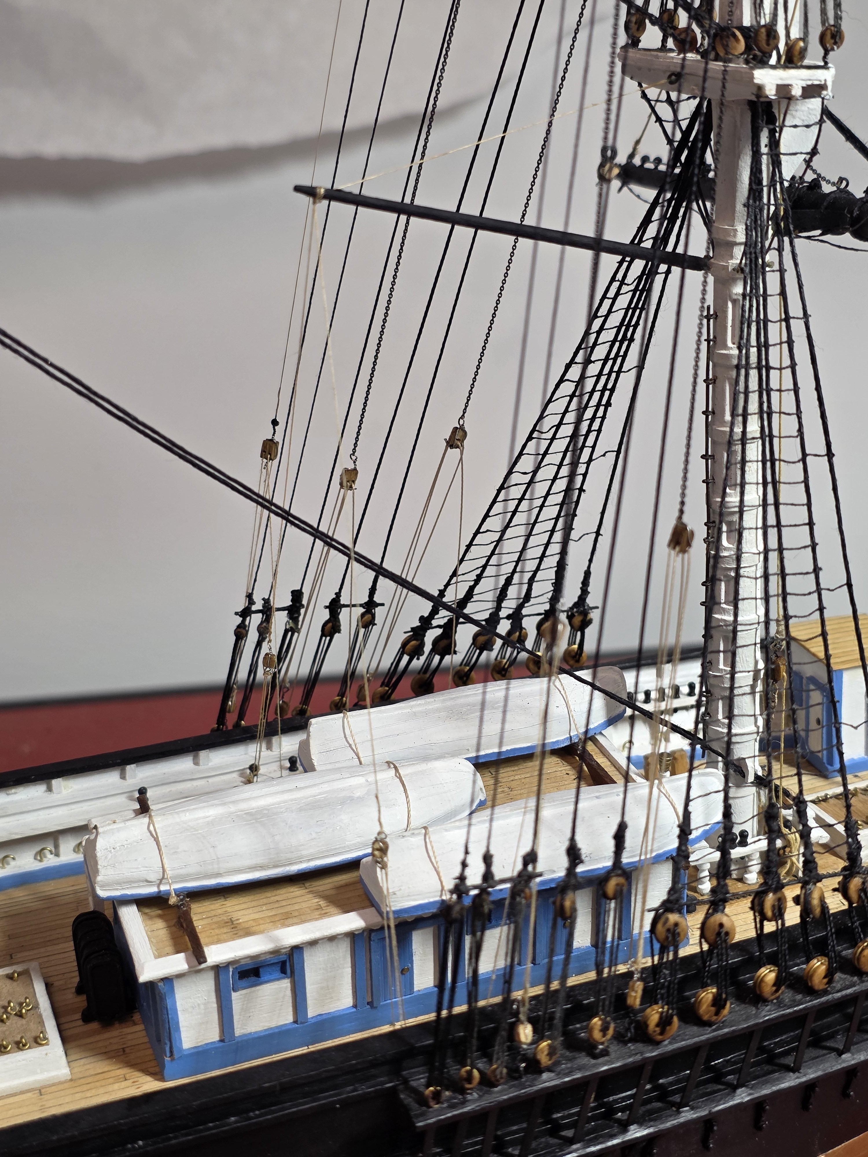

Over the last day I lashed the stunsls to the chain slings then rigged the 6" anchor fish tackle on the model (please see photo below):
No way of discerning from the images but my understanding of those tried up booms is that the inner boom iron is simply hinged to allow it to pop out when required. Once the boom is inboard, the outer ring will be quite loose of course so plenty of play once you hinge open the inboard iron.

So from what is understood, if sails are removed from the yards for a long stay in port...the booms would NOT be slung as depicted....they would be stored, again, within their prospective irons.....freeing the yards slings and ties to be used if needed.   I suppose depicting your model as if she was in port or at sea, has a great impact on how you rig her.  Mixing and matching standards of practice for a particular rigging scenario can be tricky to decipher.  Especially so, if you want accuracy.  Not so much if you are looking for what makes you happy, and looks good to you.

Thanks to all of you for your valuable insights on the stunsls.  I would be very interested to know why  the kit designer chose to show the stunsls the way they did, as, if I understand all the discussion correctly, the stunsls would have only been raised in this manner for a short period while the sails were being furled.  My model will not have any sails furled or otherwise.  As my stunsls are now set in place I am not really up to the task of removing them.  I do like the look the way they are now as it adds complexity and colour contrast to the upper part of the model.  I also think it adds strength to the fragile yards on the model.
