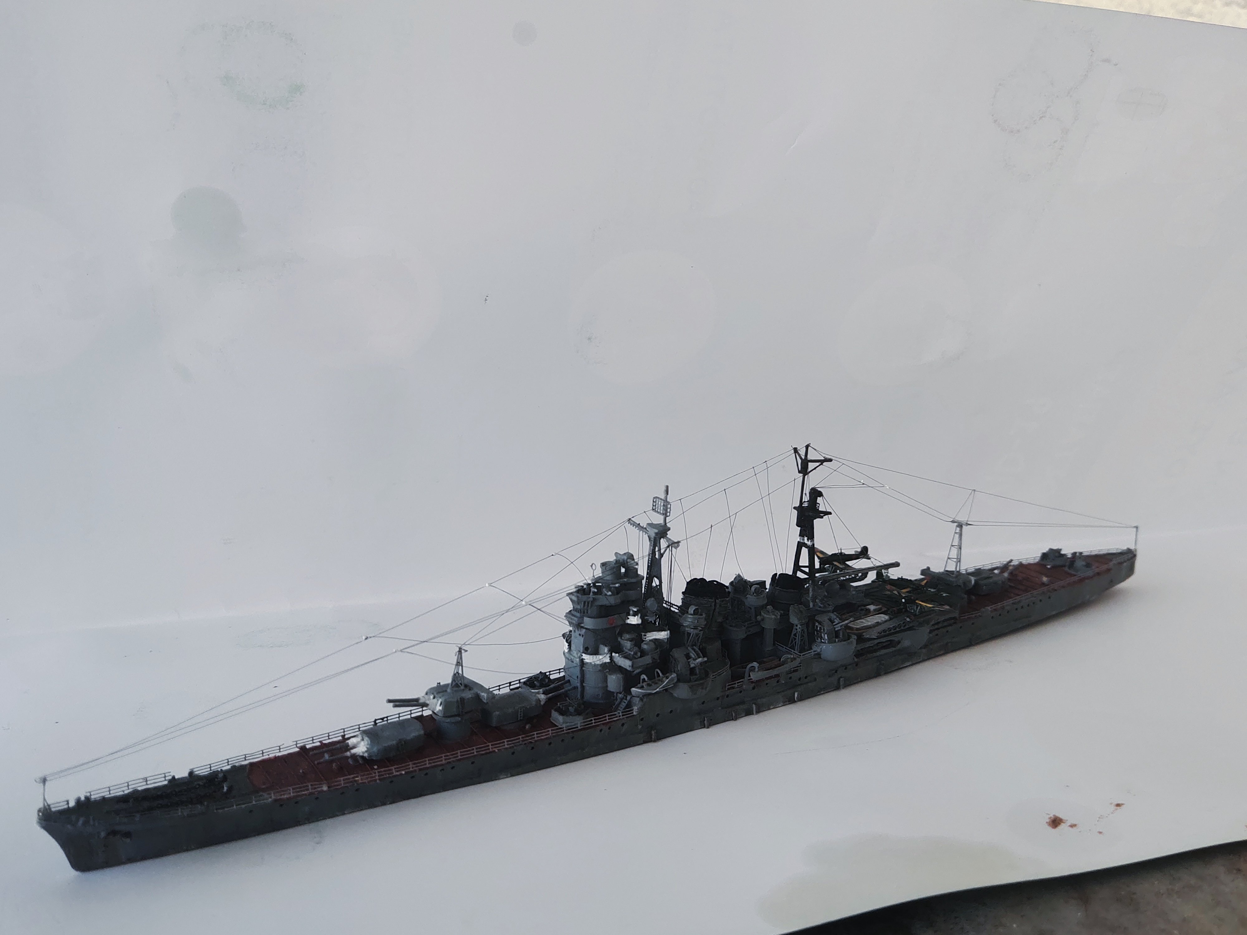

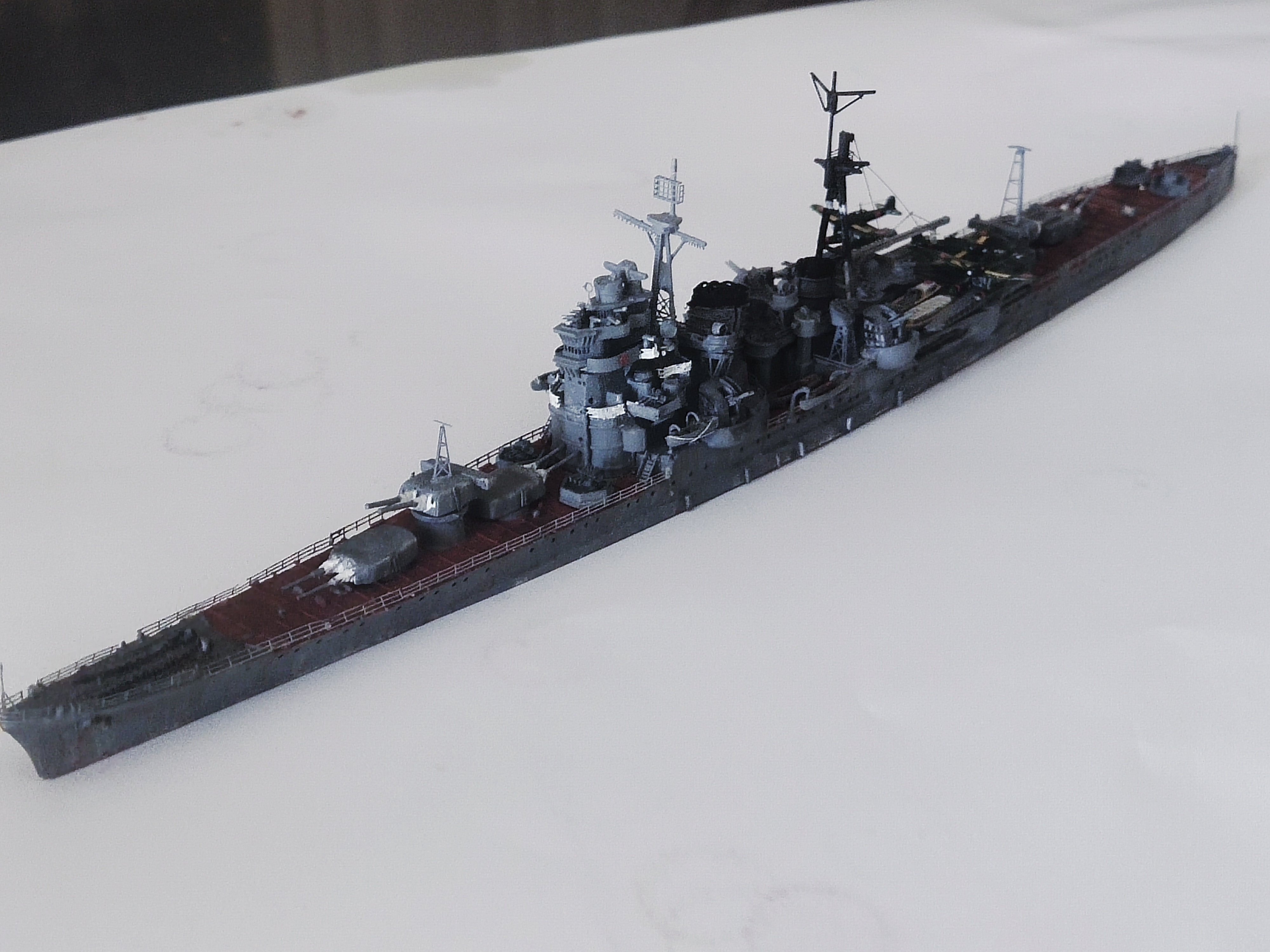

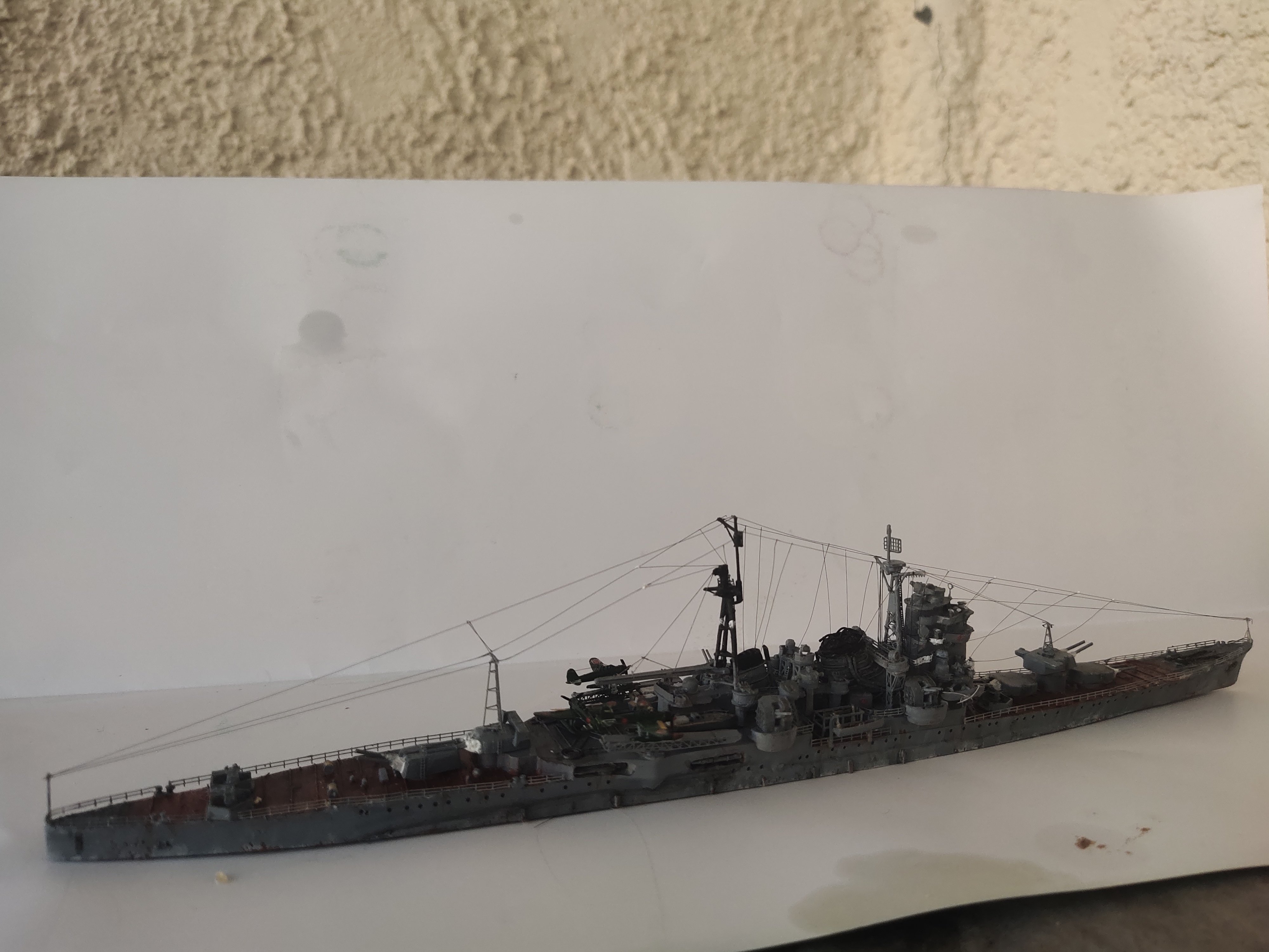

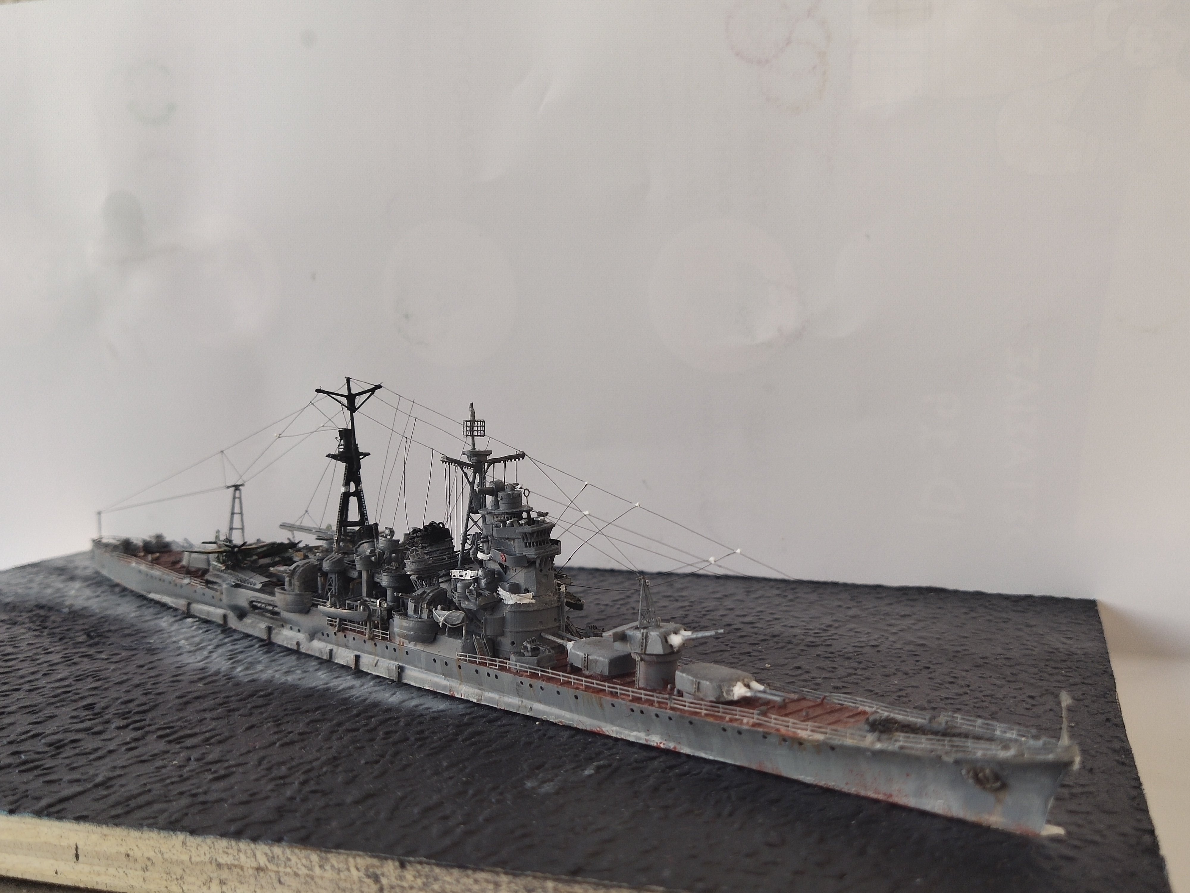

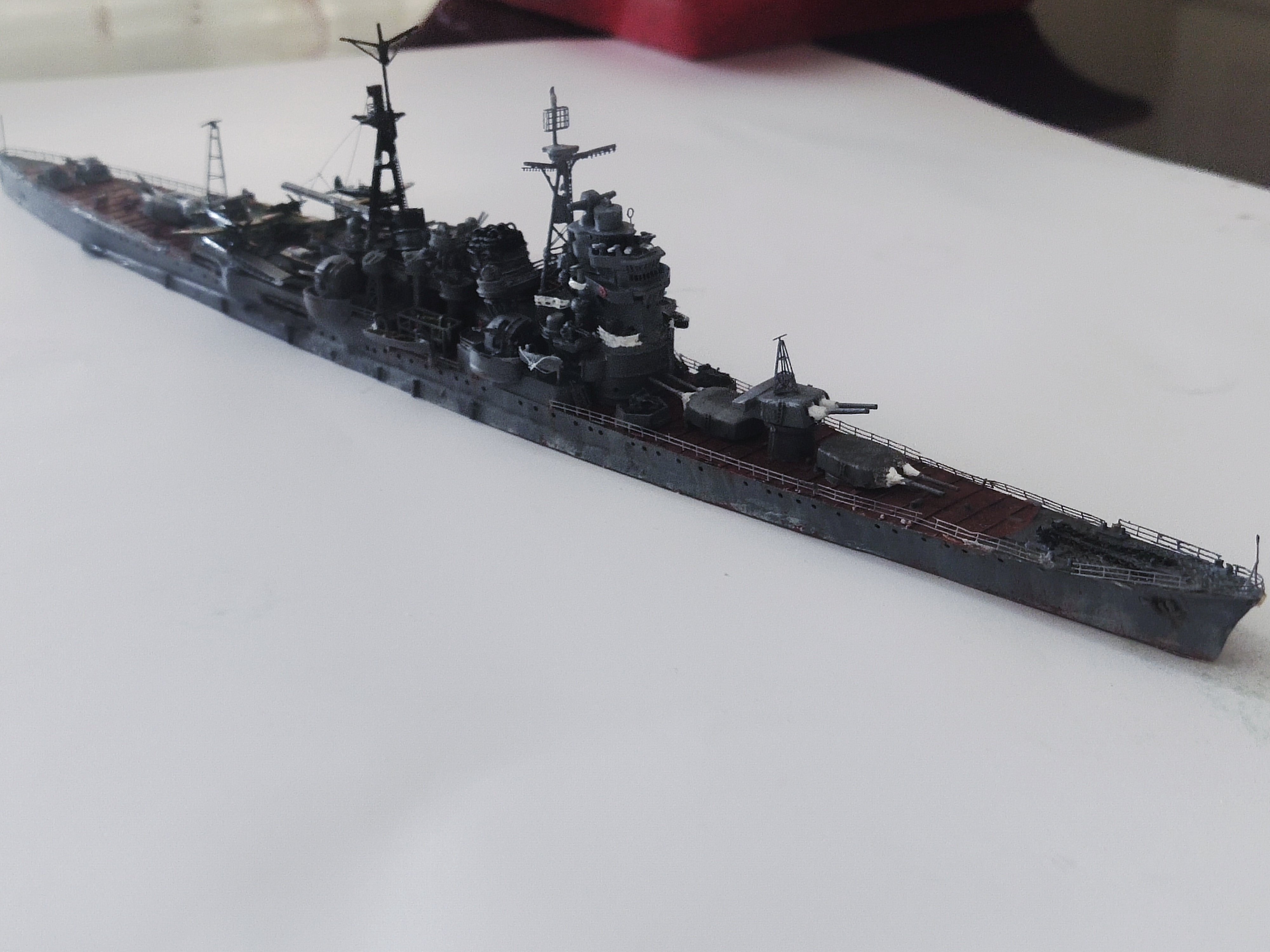

For the rigging material I used fake hair extension. Very good thickness, easy to work with and it causes less tension to the masts.
I took me 3 evenings about 2 hours each evening. First I did the forward section, next the middle and lastly the stern section. Even not elastic, it causes some stress to the plastic parts. To cut the excess material I used hot needle. This has to be done with caution not the damage the rest rigging or the plastic parts. Another advantage for the brass masts. I wish they weren't SK difficult to make. Maybe one day I will be able to make it better
So I took my time to learn how to make it closer to the real thing. I used Takao's hull to  avoid  mess on the model.
IMG_20250531_132331.thumb.jpg.c50b8d56e2c67309f6608208b2e9e7e4.jpgIMG_20250531_164905.thumb.jpg.46aa57336c31035dd7114317e231dd61.jpgIMG_20250531_192957.thumb.jpg.e538a31896e71cb84f5e84261048688e.jpgIMG_20250531_193010.thumb.jpg.5aad99aee3cbf9a55eceef83626f81a8.jpgIMG_20250531_193025.thumb.jpg.9dd759c9d4e967658f37798e4e68a07a.jpgIMG_20250531_193034.thumb.jpg.b2765e6299fbb15d4c60b1f163bb3f79.jpgIMG_20250531_193050.thumb.jpg.14fbbeaa9c39055deabd2402ecb89fb0.jpgIMG_20250531_193152.thumb.jpg.2f7cd4f1a217db626cecb03ab5f824fd.jpgIMG_20250531_193219.thumb.jpg.9a8b1e24f9f2ba429558761f4b99fef2.jpgIMG_20250531_193254.thumb.jpg.70fd742da4eb9d40c2c7989f3296ed7f.jpg

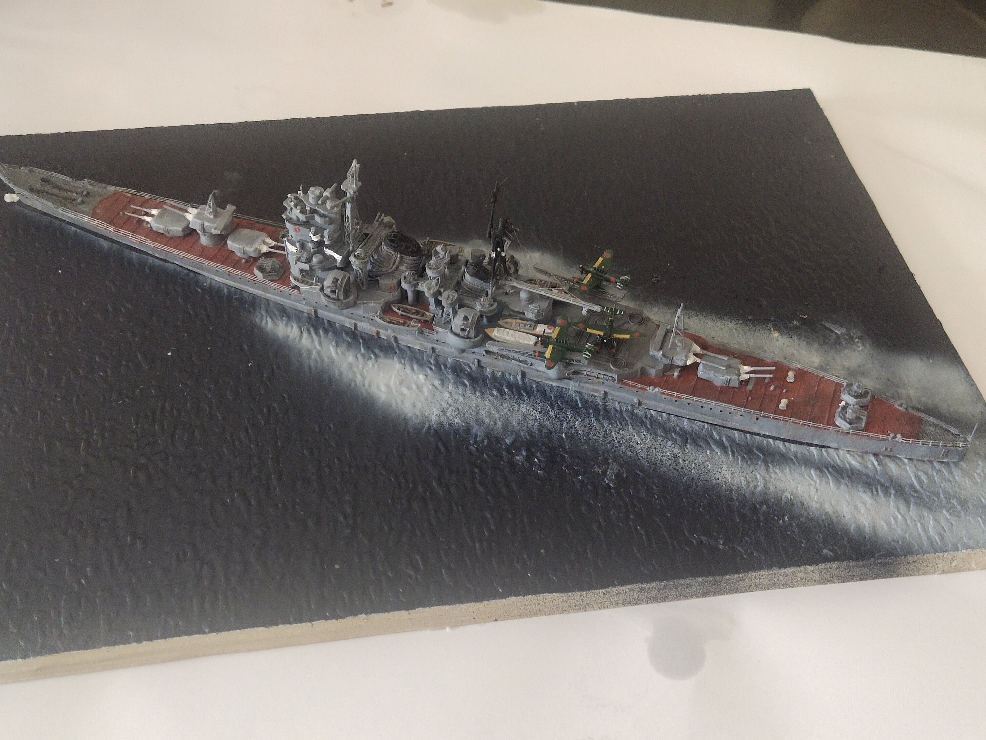

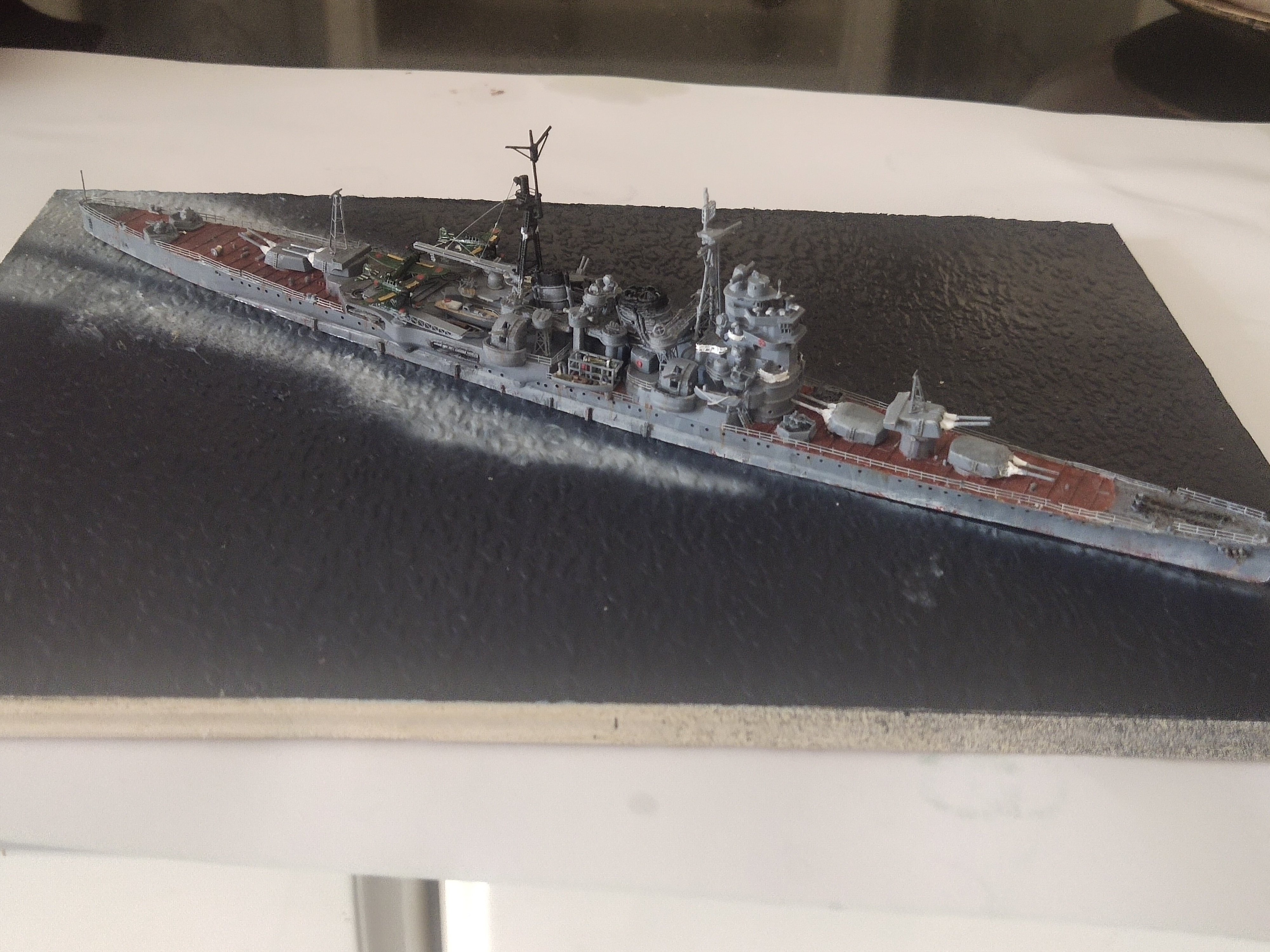

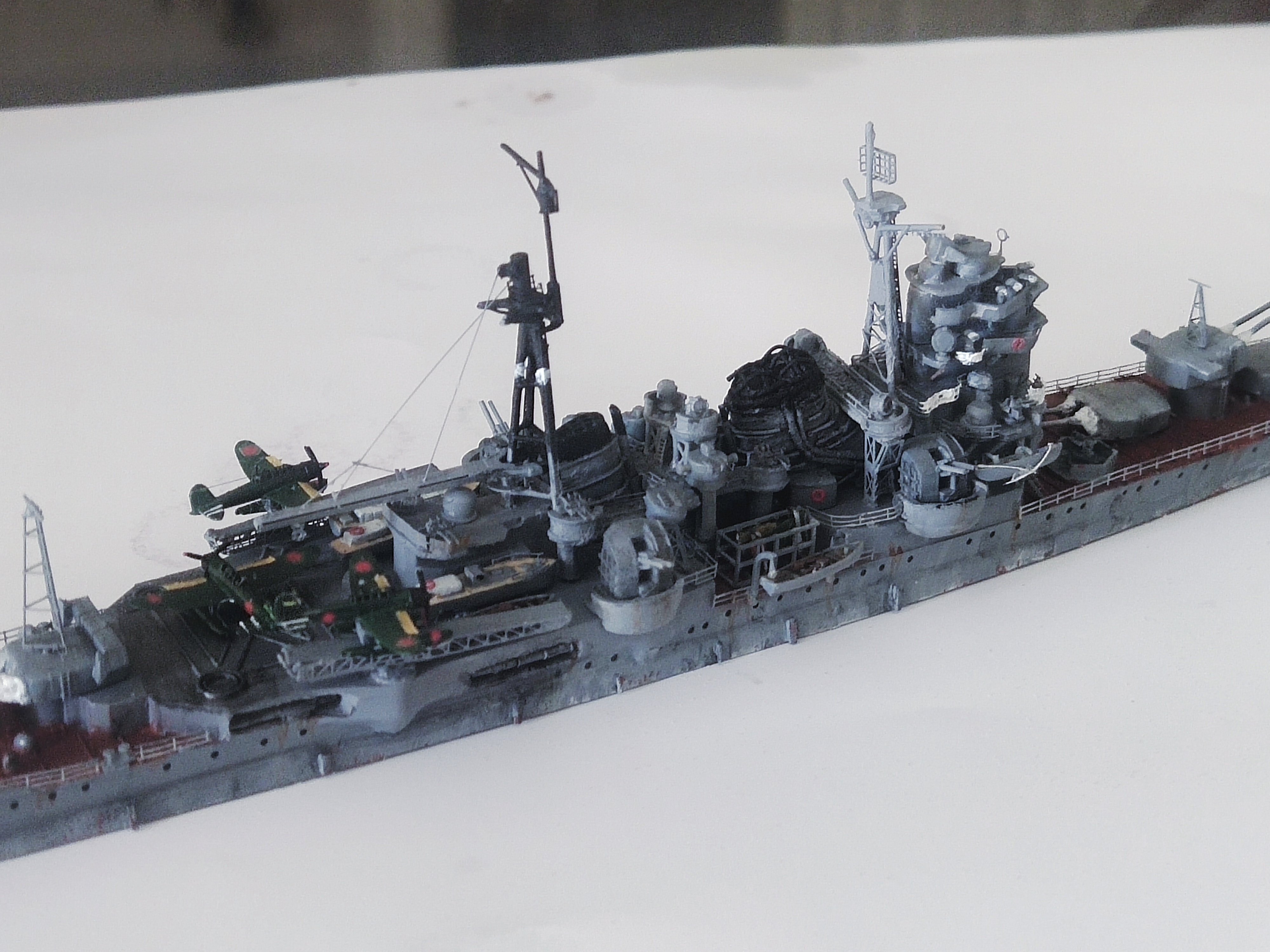

The real thing
Suzuya_trials-1.jpg.eee395d40c90268ebd580d05f41cd0c4.jpgPi7_IMG_20250531_193219.thumb.jpg.0af2db1b7b3af92718502a03c97129fa.jpg
Comparing to the previous project I feel far more satisfied. Because this is not a repeat of my usual work. It is a step forward as at last learned how to create waves and wakes the way I wanted. There is more space for improvement, for example the wave at bow should  be more sharp and thinner. I will repeat the scene with Takao in the future and compare.
The model also has some imperfections especially on railings and detail can be improved. But I dont mind, the scene overall is ok.

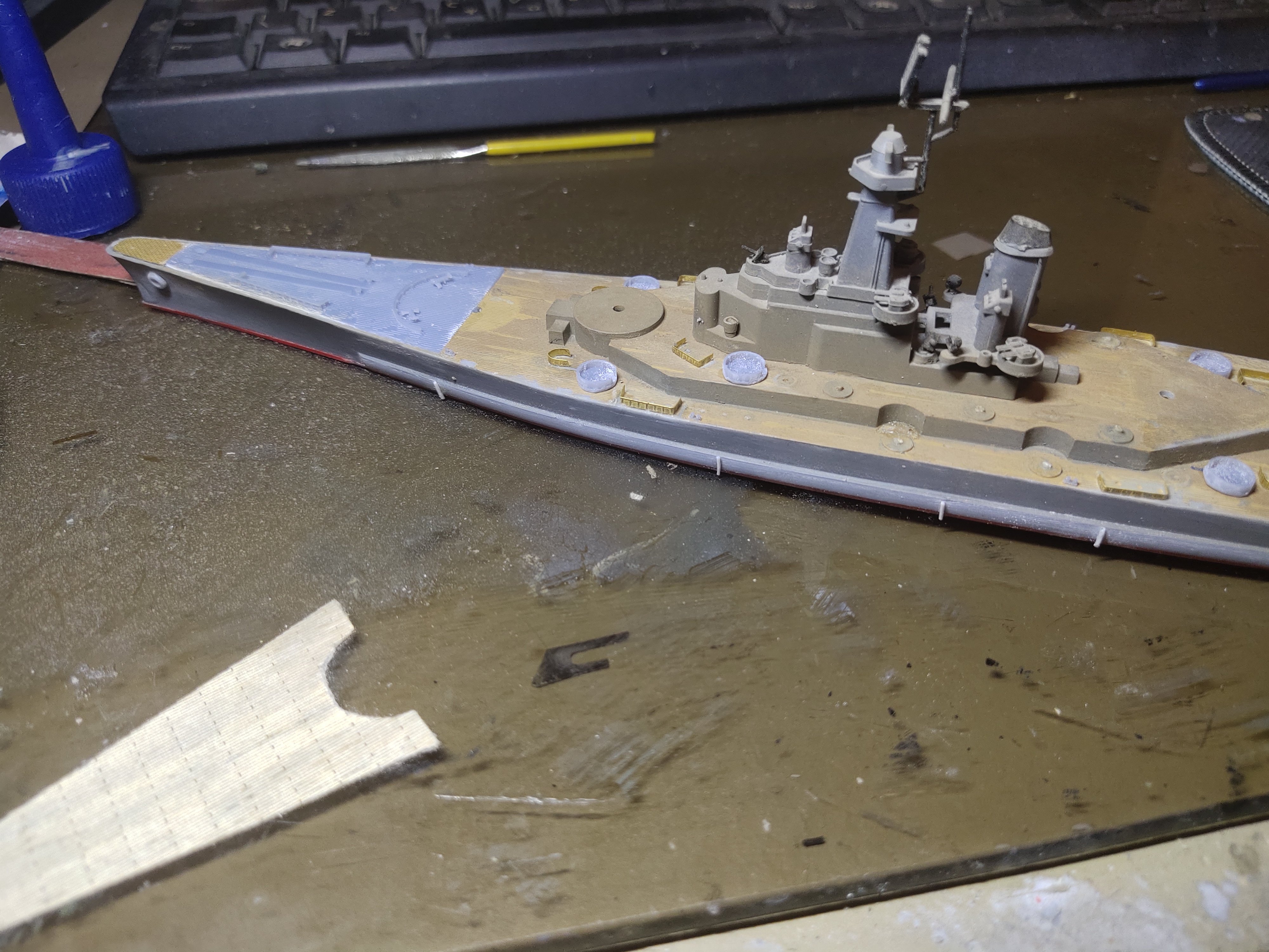

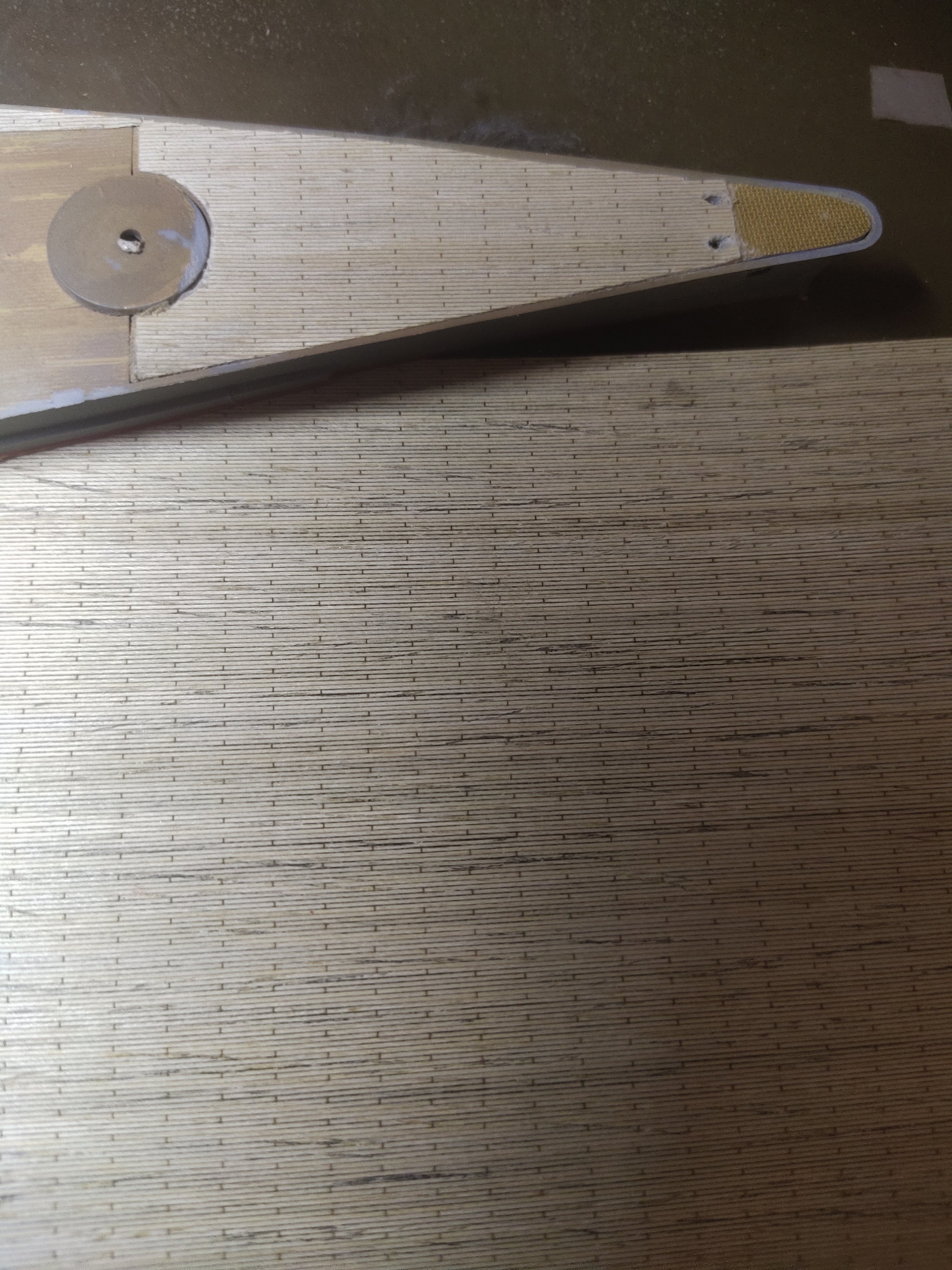

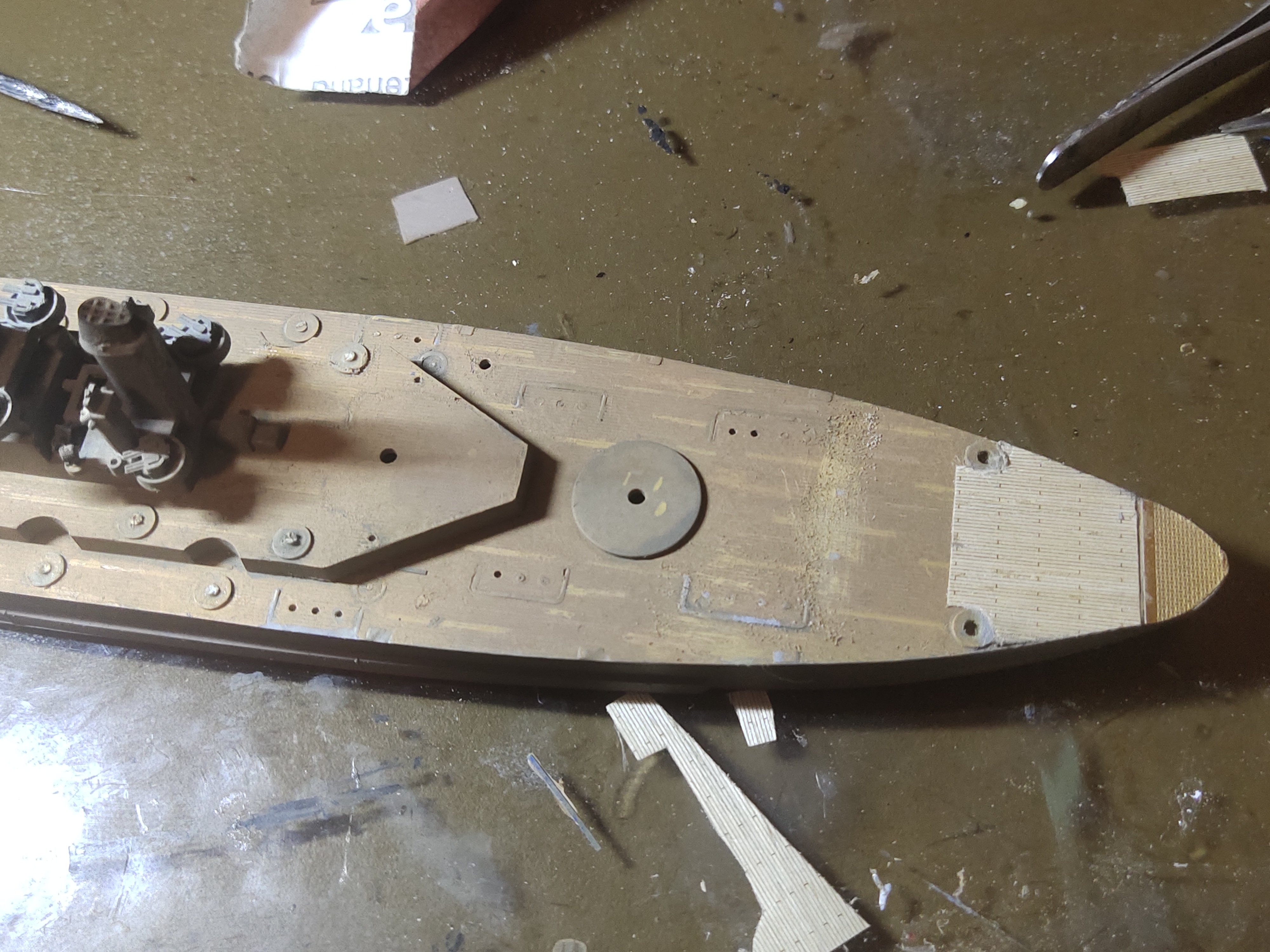

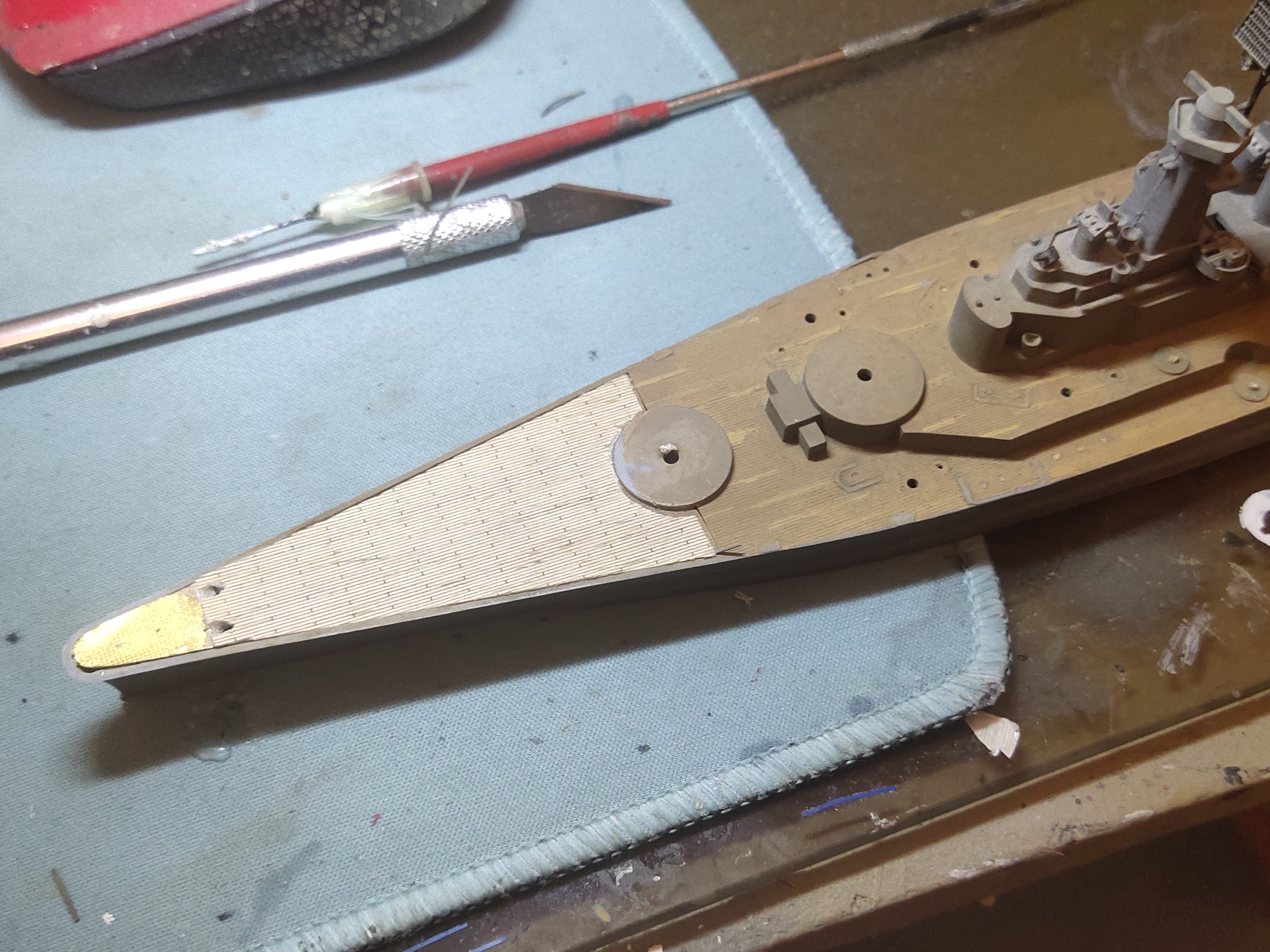

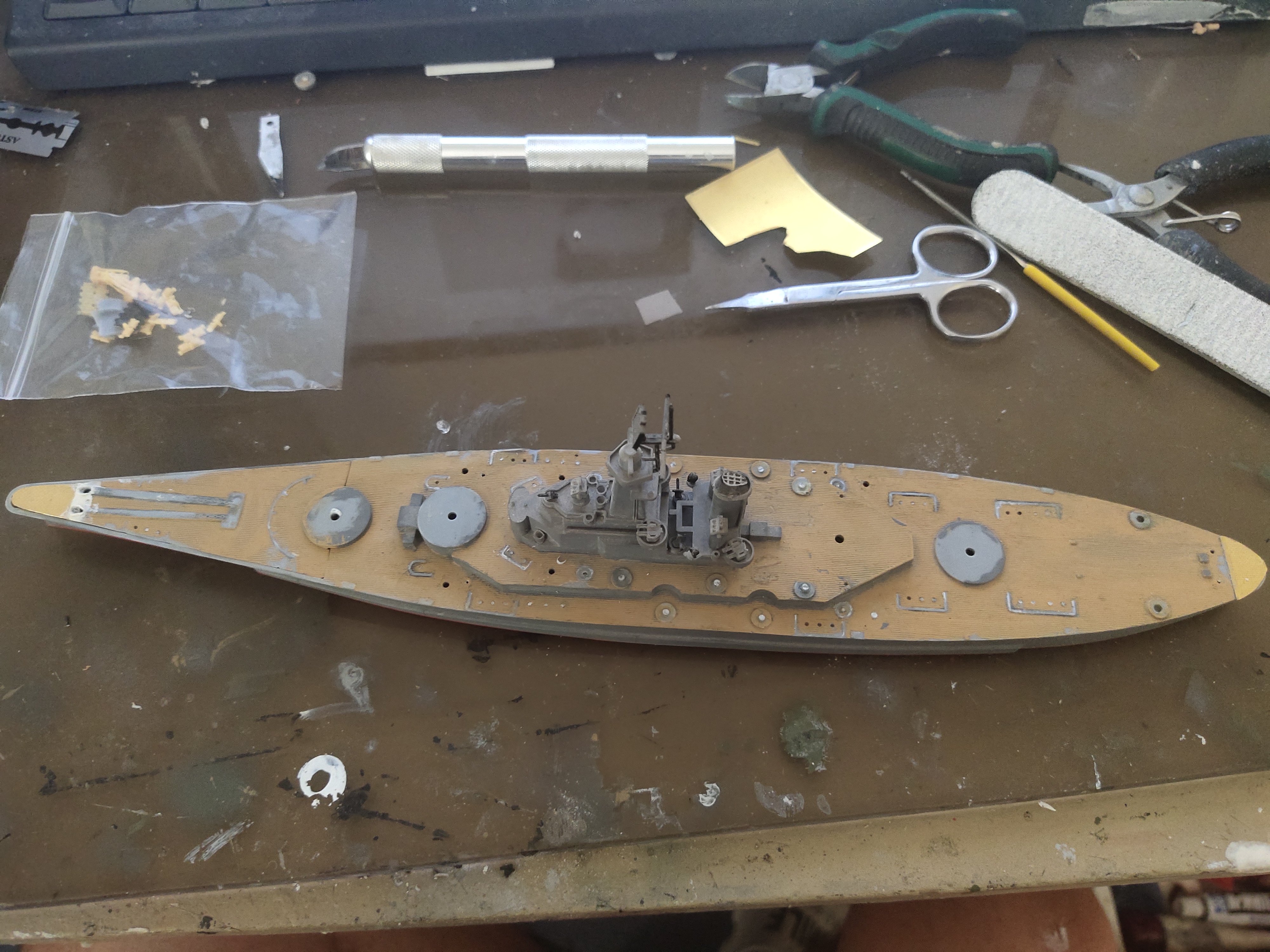

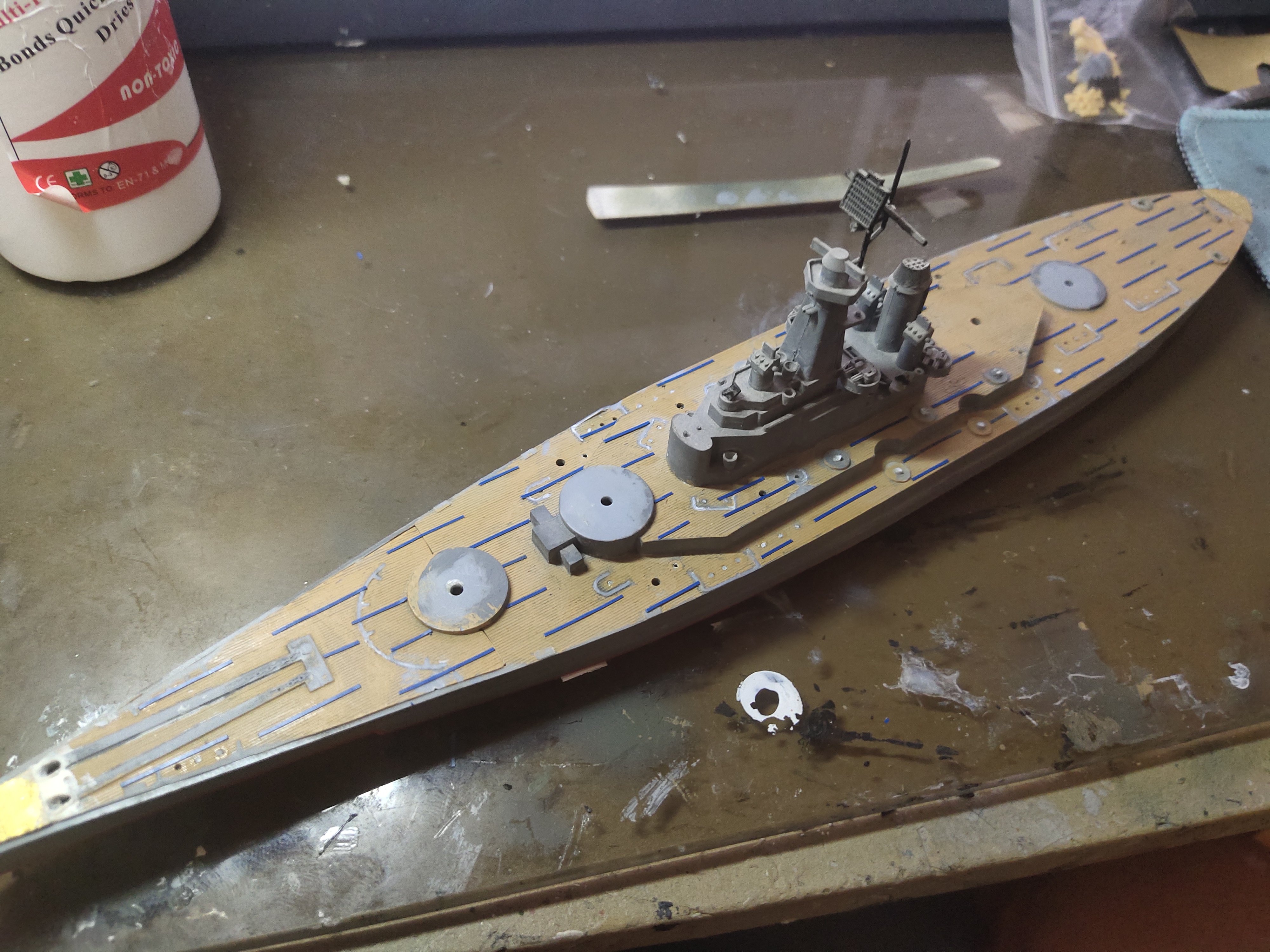

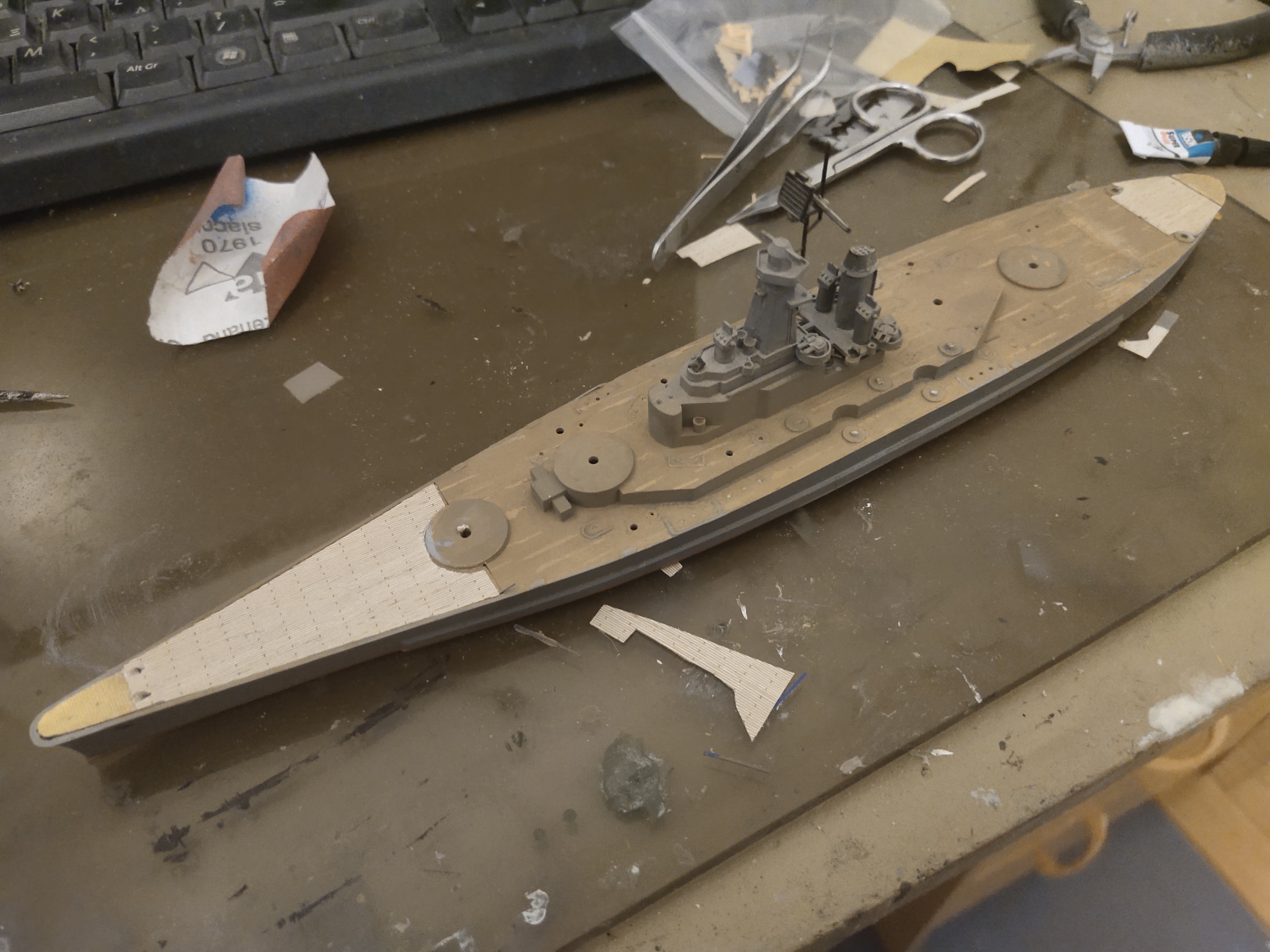

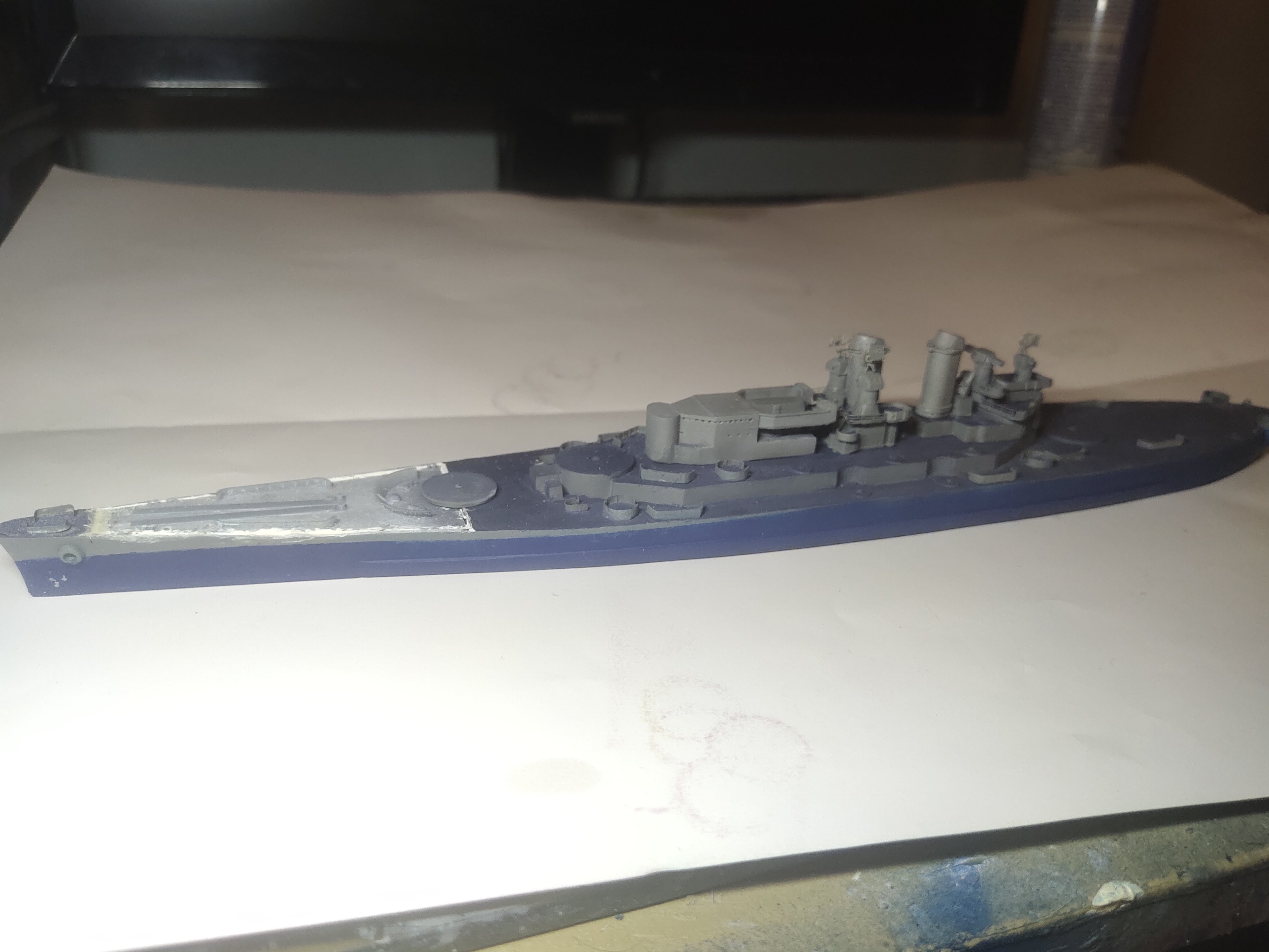

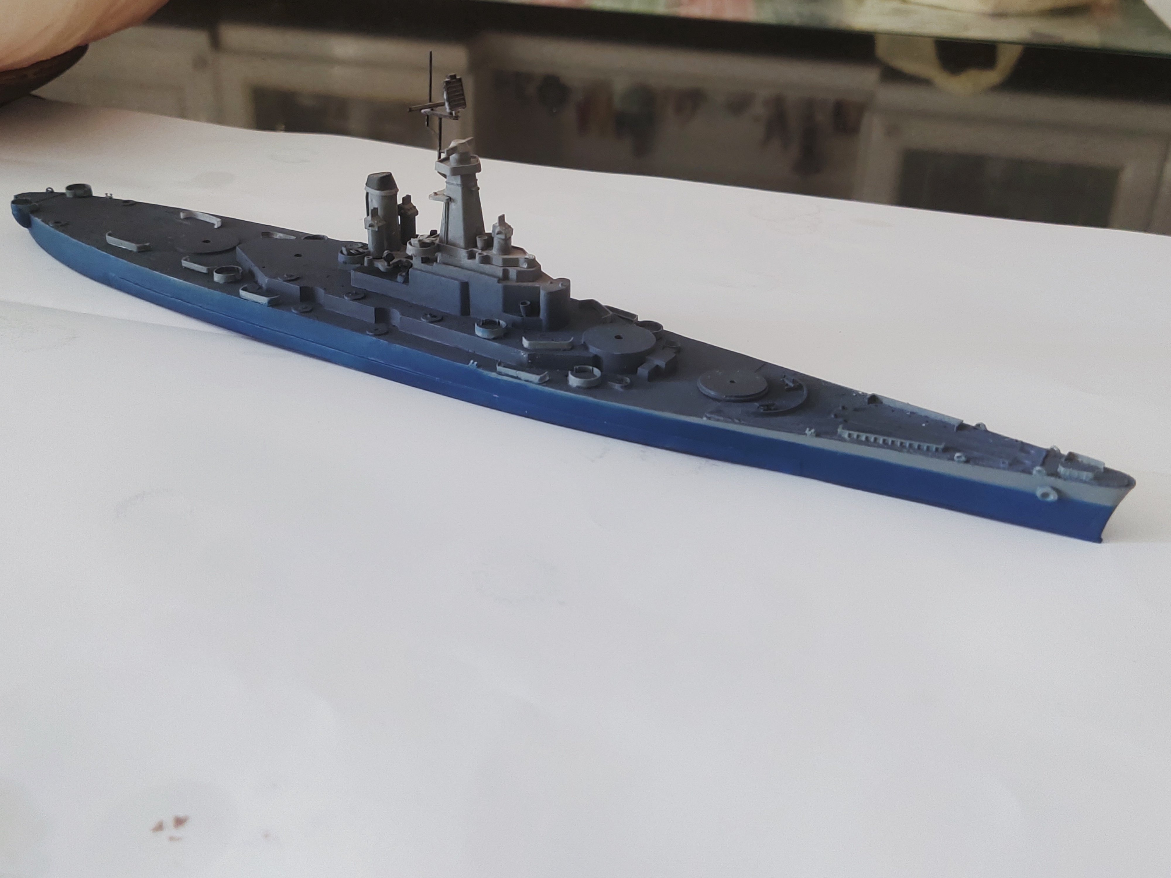

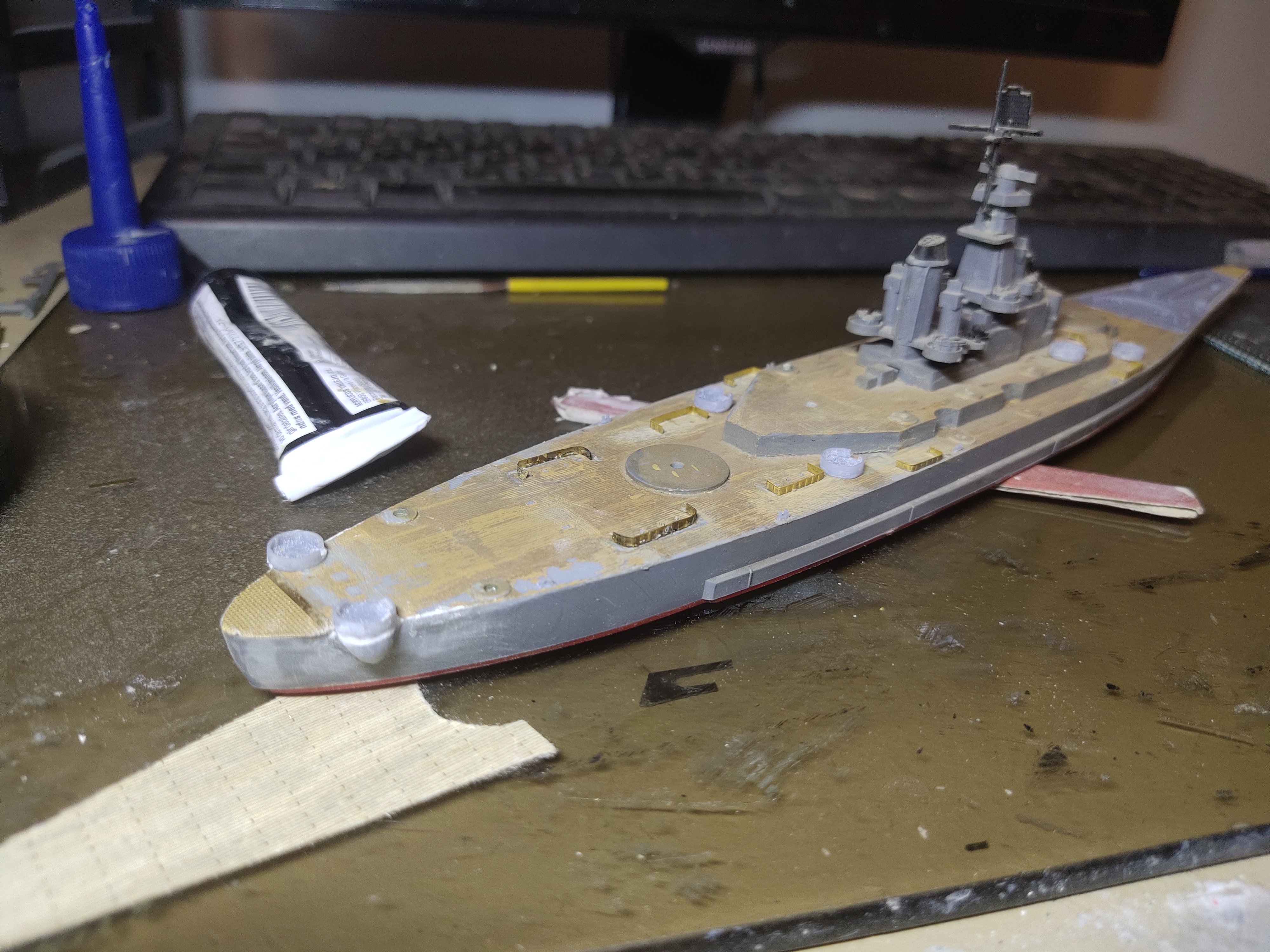

I wash and remove the unwanted parts. Deck was covered by dozens of tape pieces 0.6 x 10mm before spray. That would give a planking effect. The result wasn't the desirable. Some corrections by hand didn't make the situation better.  I decided to use sticker wooden deck which I usually keep for carrier decks. So much time wasted today on painting. Enough for today. Time to study some books
Unfortunately the wood deck I bought from the same manufacturer was of lower quality this time, somehow deteriorated.
Studying about the painting schemes I found out that the deck could be painted with Navy Blue under Measure 22 system or something like this.That would be easier to do.However because of the sanding the lines on forward part of the deck had been gone. So designed one and printed it out . some PE details were added, bollards and a few other soon.

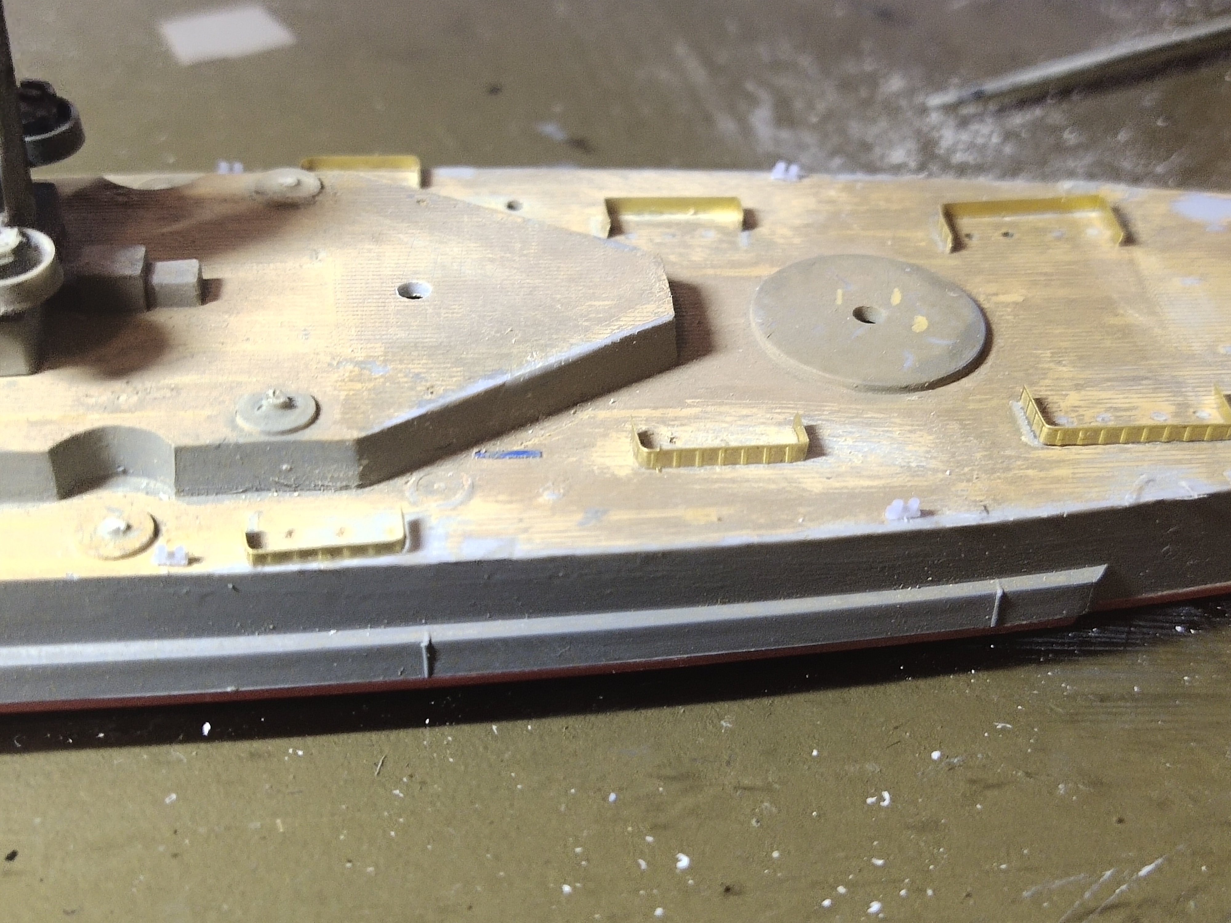

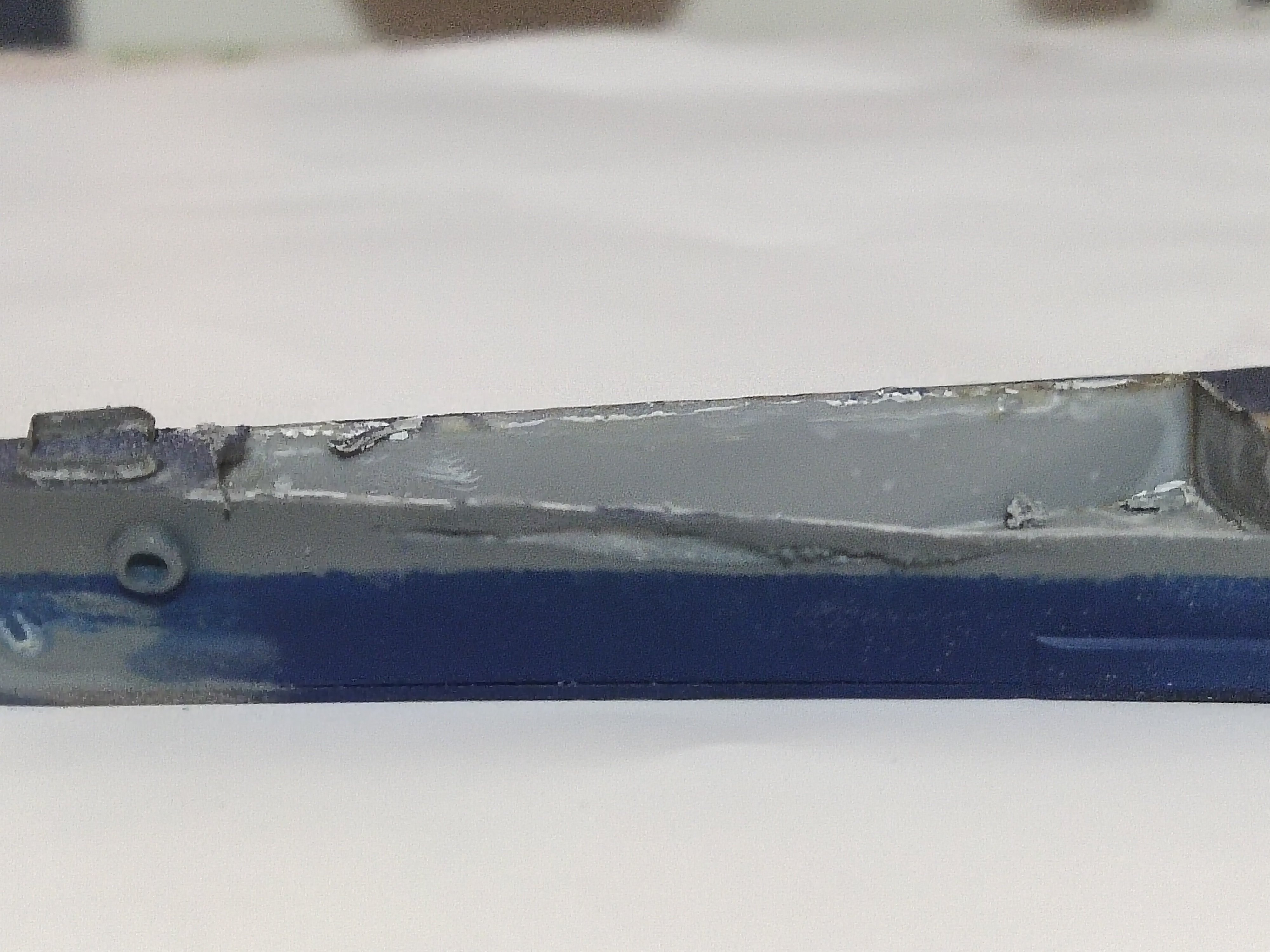

Finally I sanded the side belt, it looked too thick perhaps one meter in real scale

what time period of the war for NC?
armor belt thickness for that class would be 12" so at 1/700 scale it would be .435mm thick, do you have a dremel tool or similar to remove that belt & replace with 2 layers of .2mm or 1 layer of .5mm thick styrene sheet?

These old kits doesn't refer the time period but I expect to put  40 Oerlikons which means 1944?
So you mean in 1/700 the ideal belt thickness is 0.5mm? That means I need to remove more material

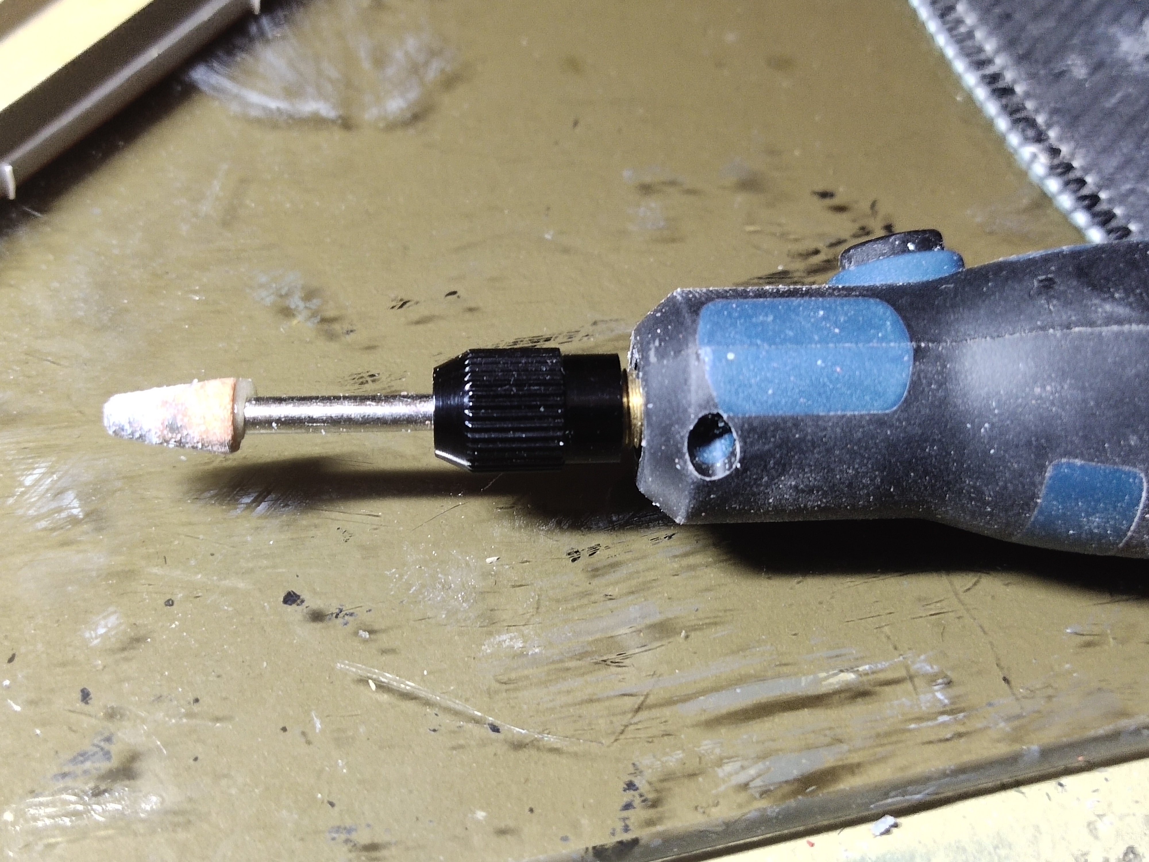

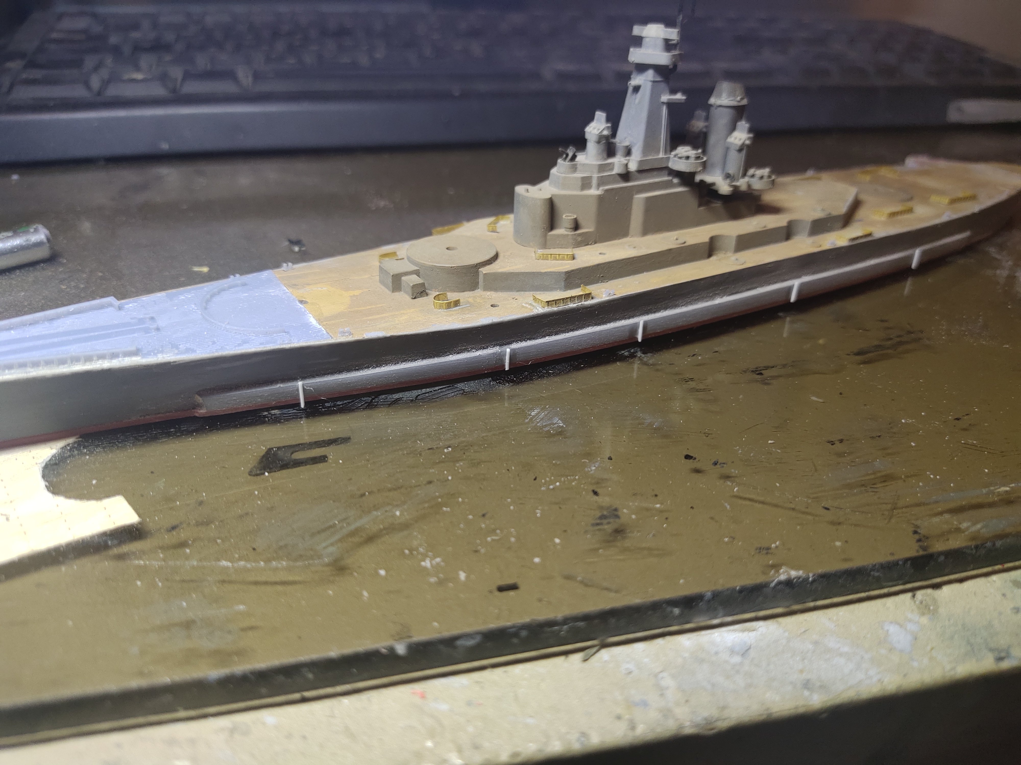

I trimmed down the belt at an angle. Using a proper tool I created  a slopping effect which is only visible only at close distance. Left side, done need to work at the right. Then I added new bases for the 40mm guns. Those at the bow did not exist at the original model so I added myself
Edited by mikegr
With 39°C impossible to airbrush. Paint would get dry instantly. Therefore I finished the job on the right antitorpedo belt this using a more powerful tool. Result with some had work came pretty nice, much better that the original

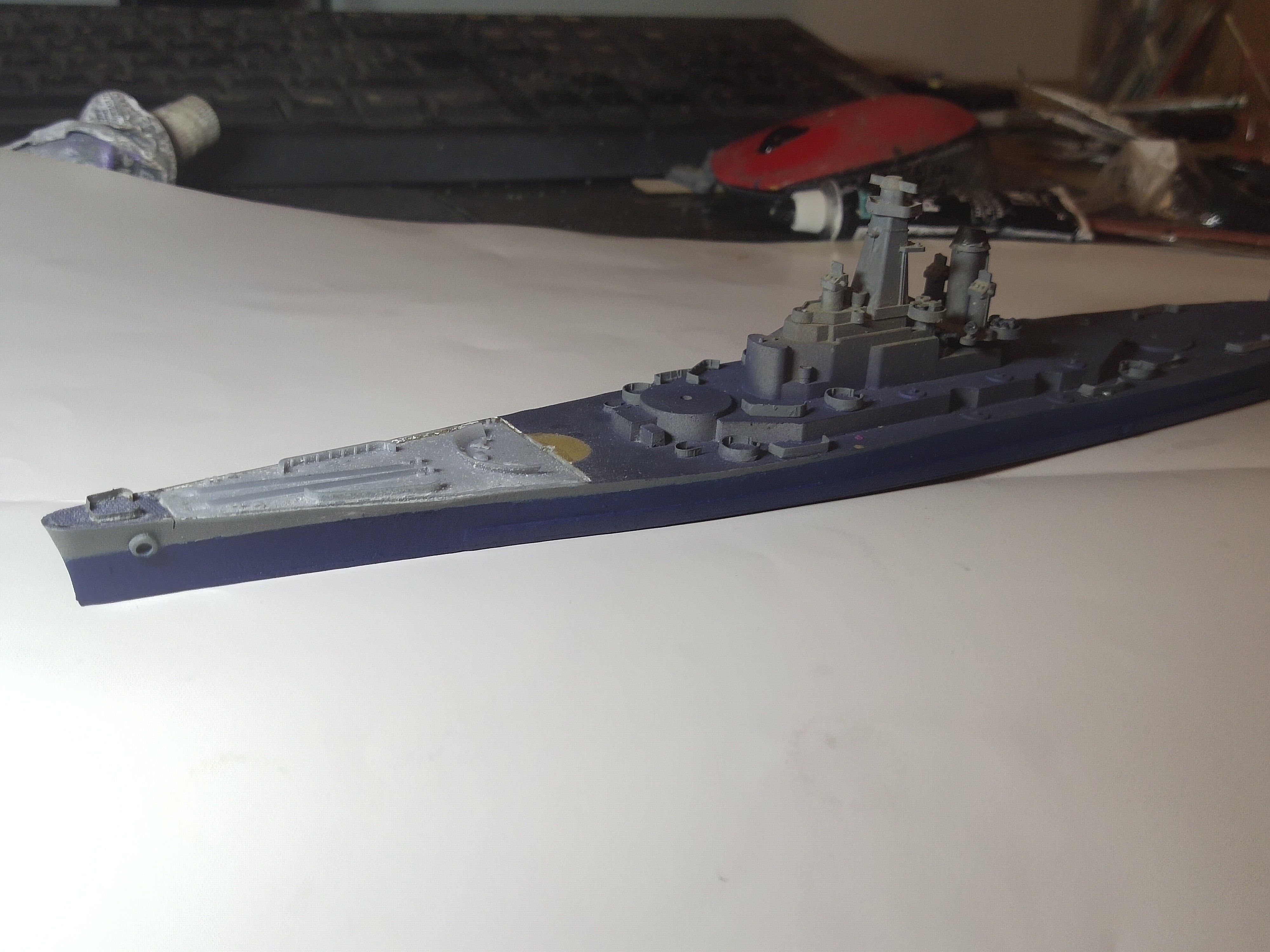

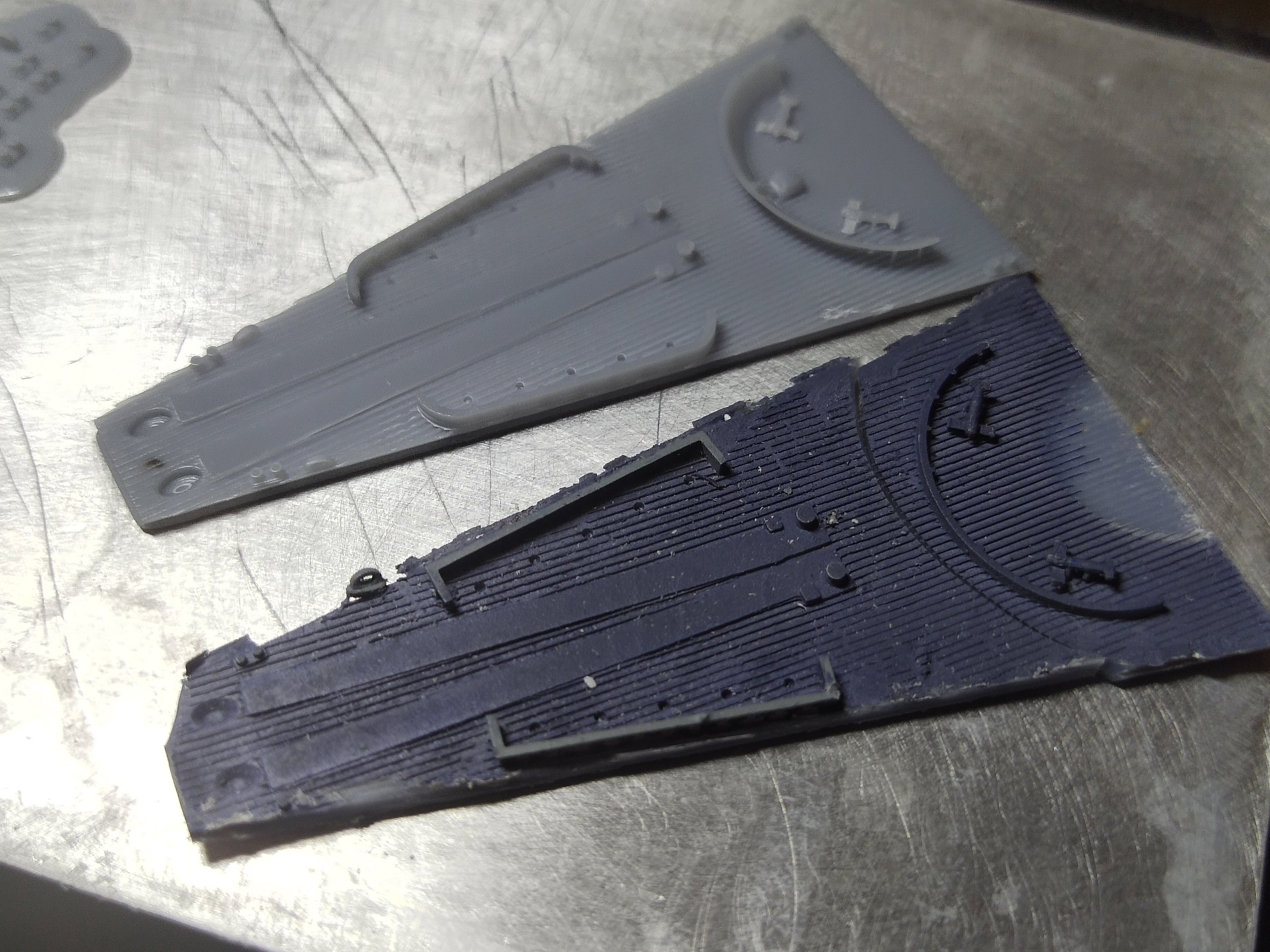

Today painting was possible. The PE guns shields proved too fragile and hard to be glued on deck. I removed them and replaced them with 3d ones I made, bit thicker with reasonable detail. Unfortunately some glue spots and scratches on deck are visible. Some can be covered but few will remain visible on close looking

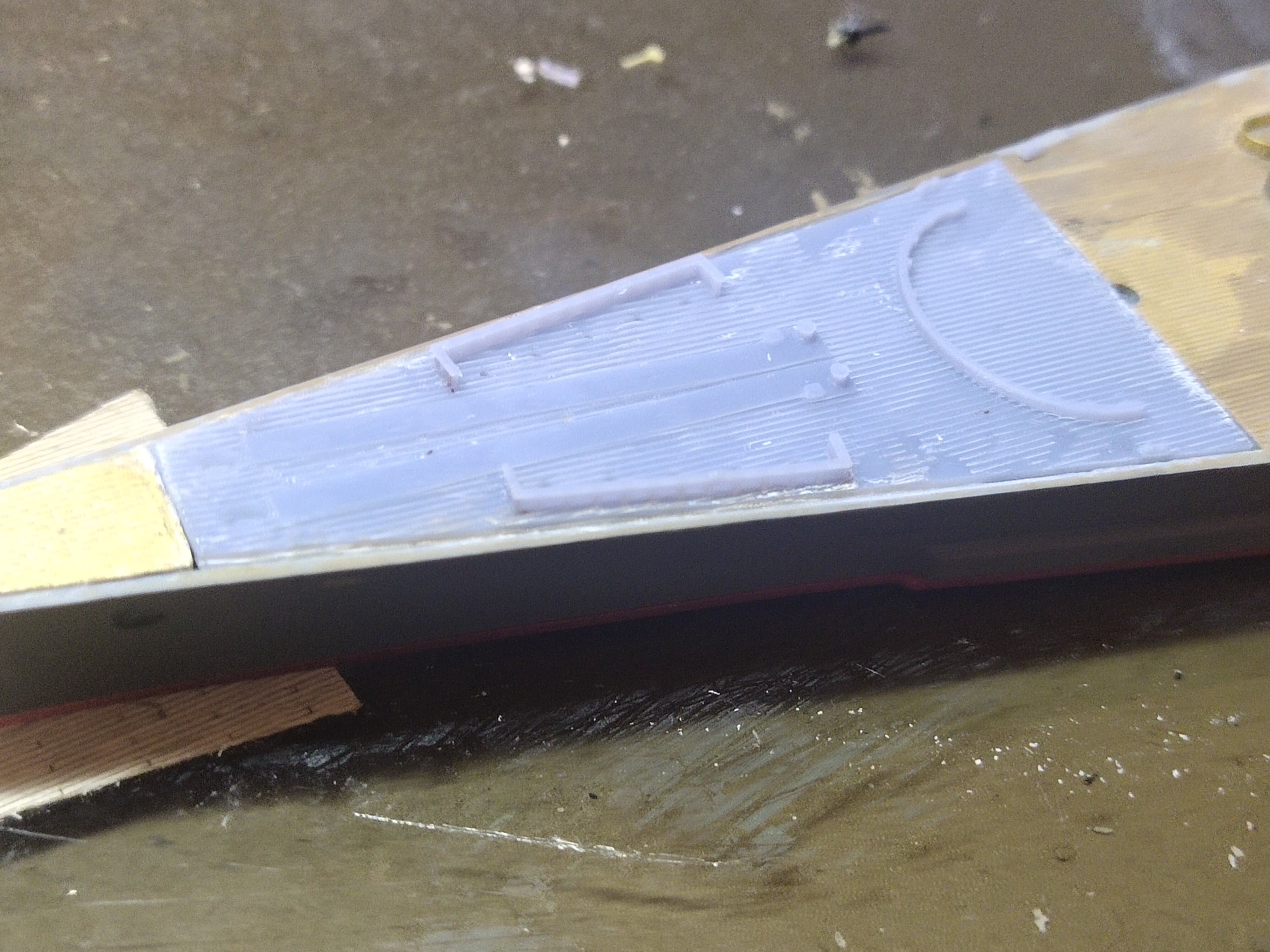

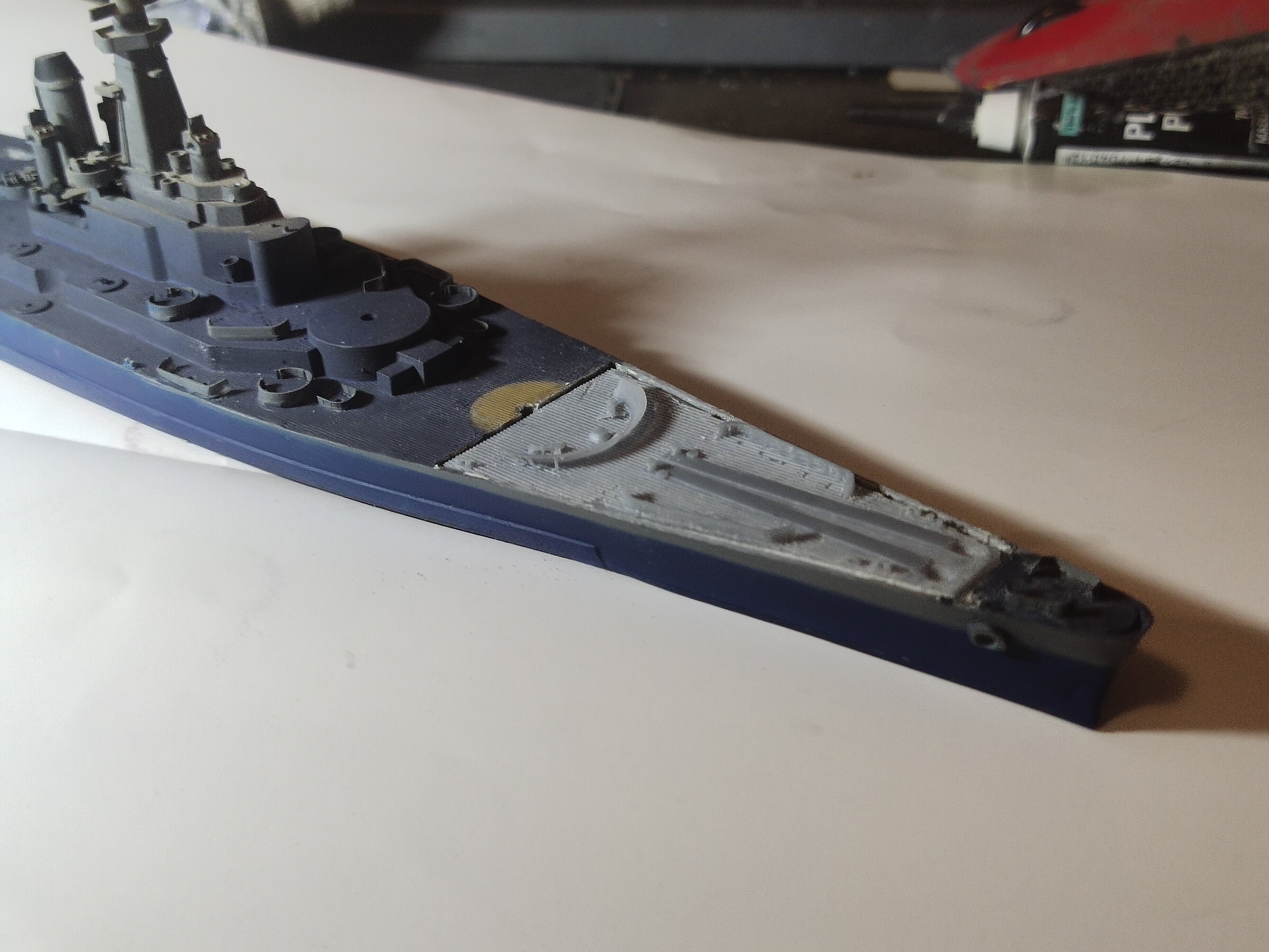

Another day with lot of work but zero progress. The resin foredeck got warped. Not much, but I decided to replace it with another one made from less flexible resin, also got the chance to work on the gun shields, giving them a more realistic shape. Of course this didn't came with out damage. But I'm good on such kind of surgeries.
The foredeck is glued on a 1mm plastic to improve stiffness, left overnight under pressure. It will be installed permanently on a later stage, want to make sure that it won't warp again.

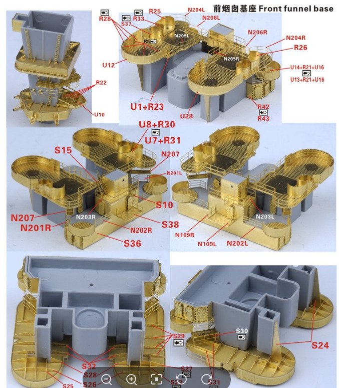

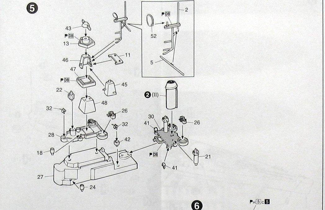

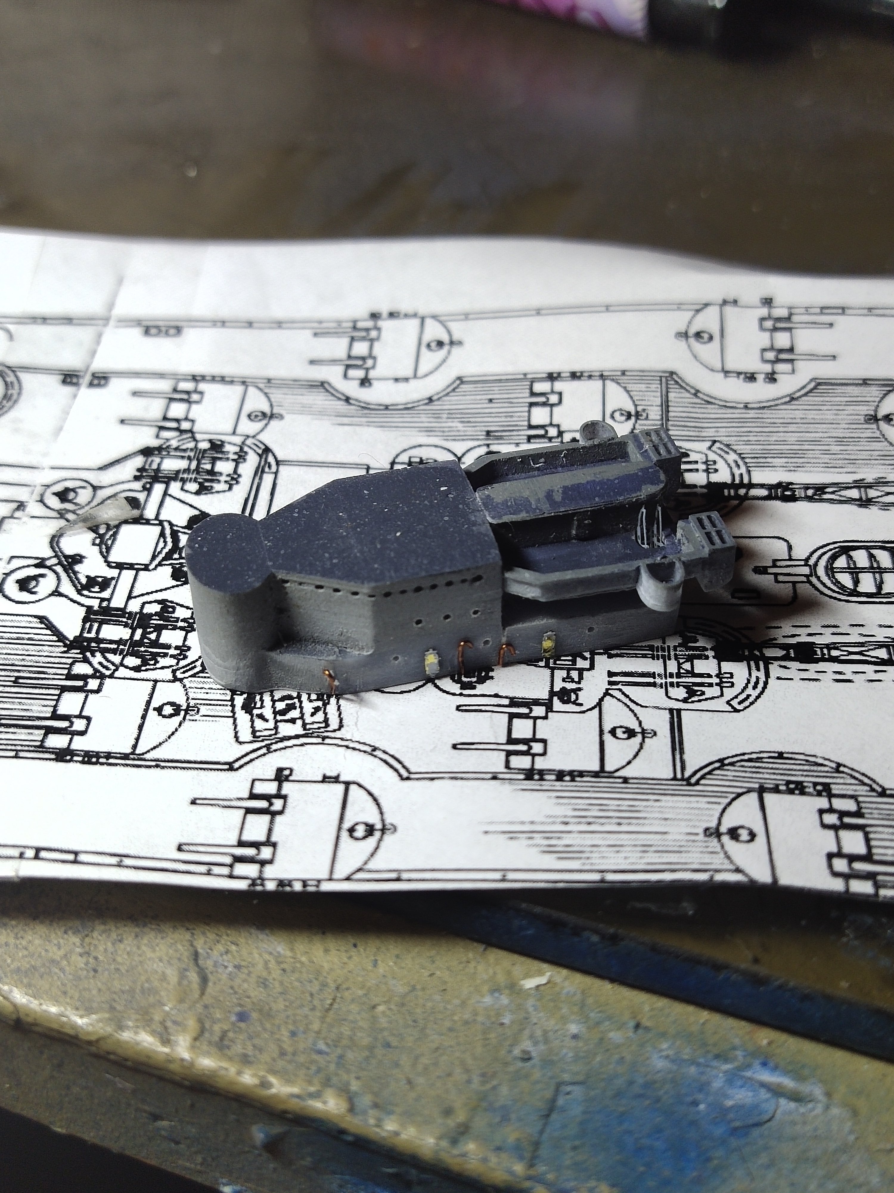

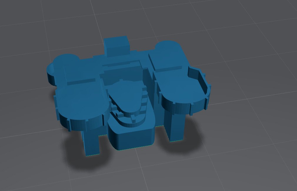

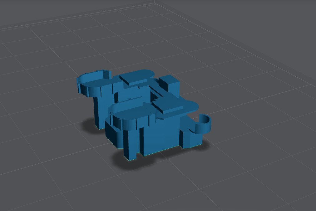

So my next work is on the middle platform. Maybe the worst part of the kit. The funnel seats on the platform but in reality its base is quite lower.
The kit
This is what I need to make. A separate from the superstructure base and a Π shaped gun platform, on the top.
On the lower side there is another gun platform for 2 Oerlikons I think, at the corners.Note this is in 1/350 thus of so much detail.

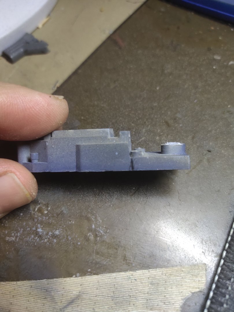

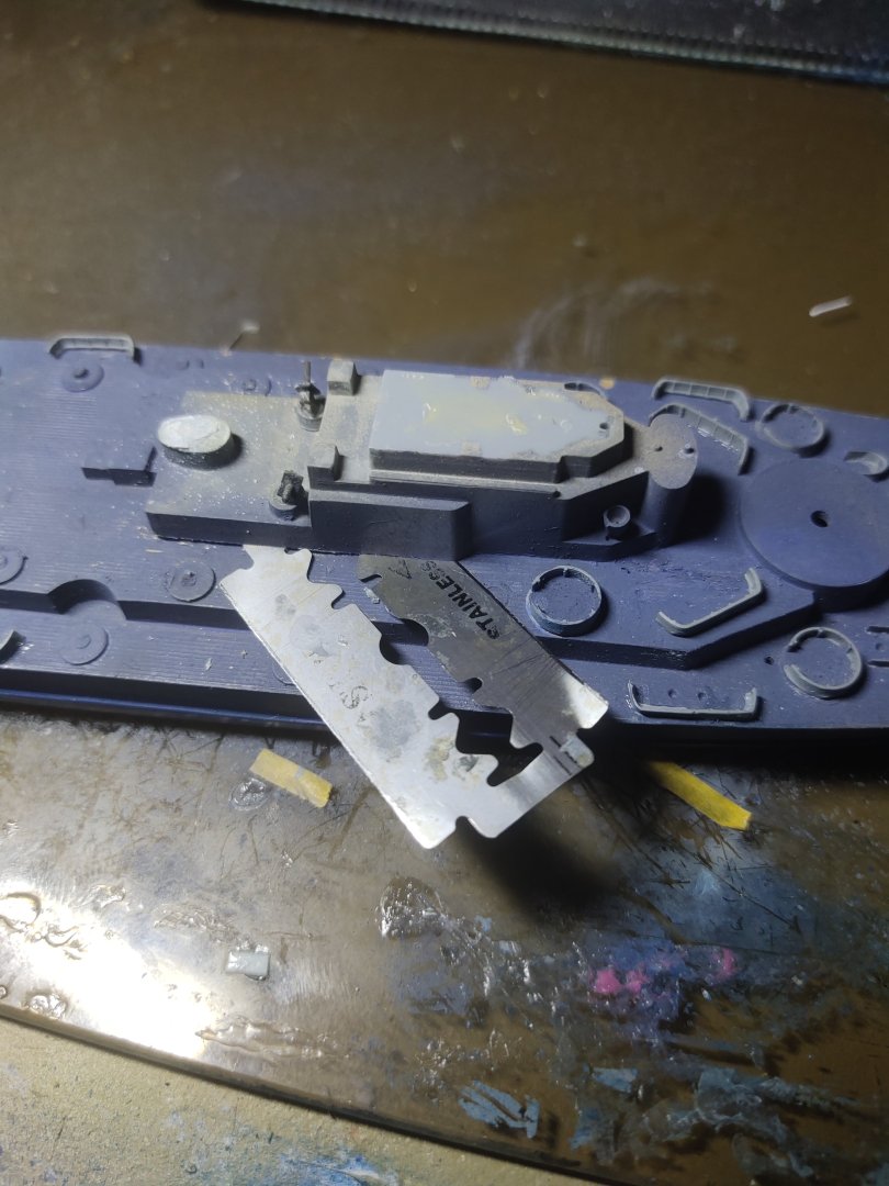

I moved on to remove carefully the main piece without causing damage
And mark the area where needs to be cut but not before I make the central platform and see how will it fit in the middle
I used the above pics as a reference and designed a piece what it looks precise and definitely more accurate than the standard one. Its not huge just 20mm wide.

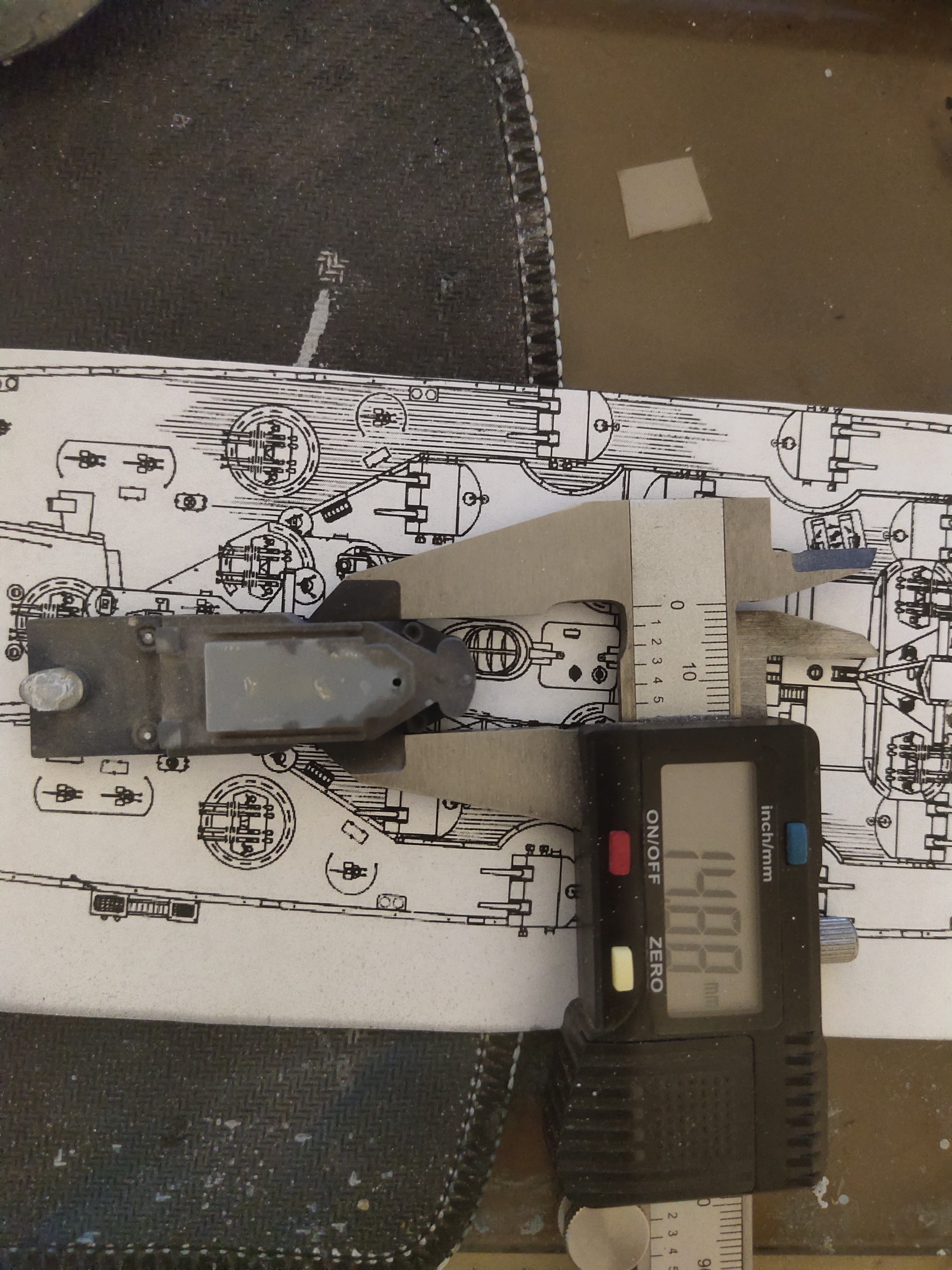

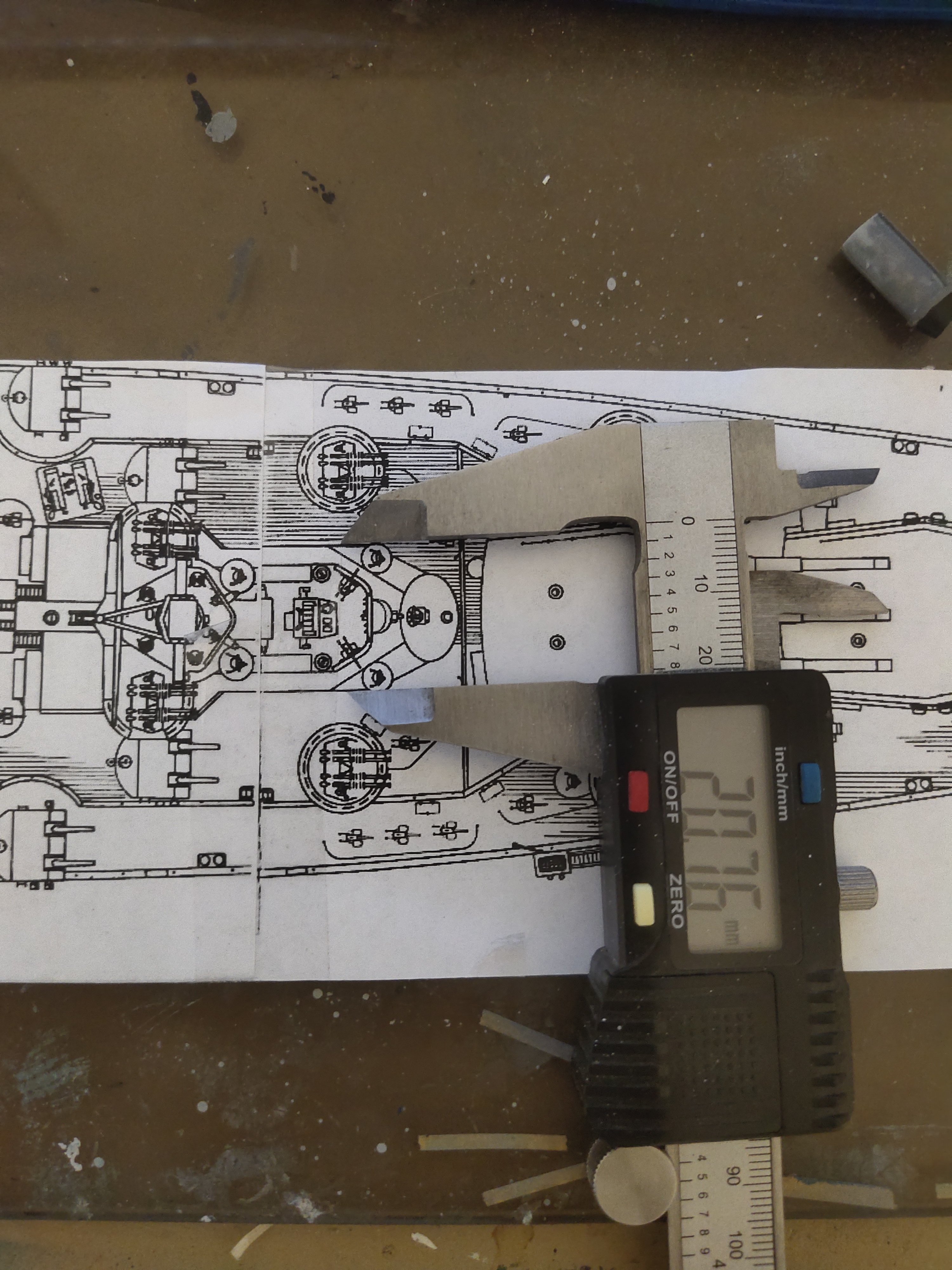

Looking at the main superstructure part. There are some side bulges that are not appear in the real ship. Looks like all parts are faulty on this kitIMG_20250708_213252.thumb.jpg.365330c5ce4b6404c0daf566ee87a57b.jpg.4a7368d0f91a6276faf067d9ee8a54f1.jpg

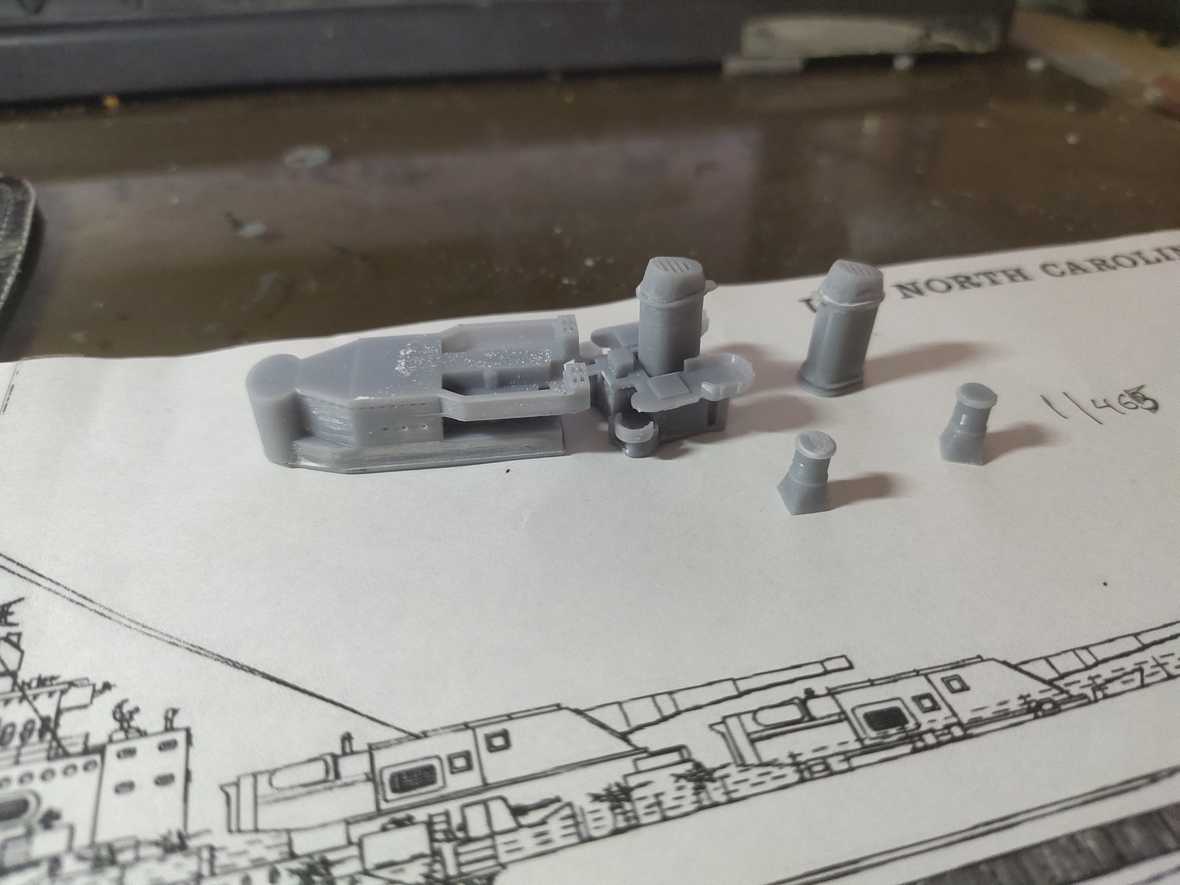

I have a layout in 1/435. I  measured ther part width there at 20.76mm,
That means 20.76 X 0.62 = 12.87 in 1/700. At its narrow point the width is 2 mm already thicker. However if I make it more narrow there will be left a large empty space on the deck with markings and glue leftovers, not easy to delete without damaging the deck lines. I'm thinking of making a part again at 12.8mm wide but without the side bulges
This method seems accurate and easy but its not. Making your own parts and fit them together requires a lot of tests and evaluation. In this scale every mm is crucial

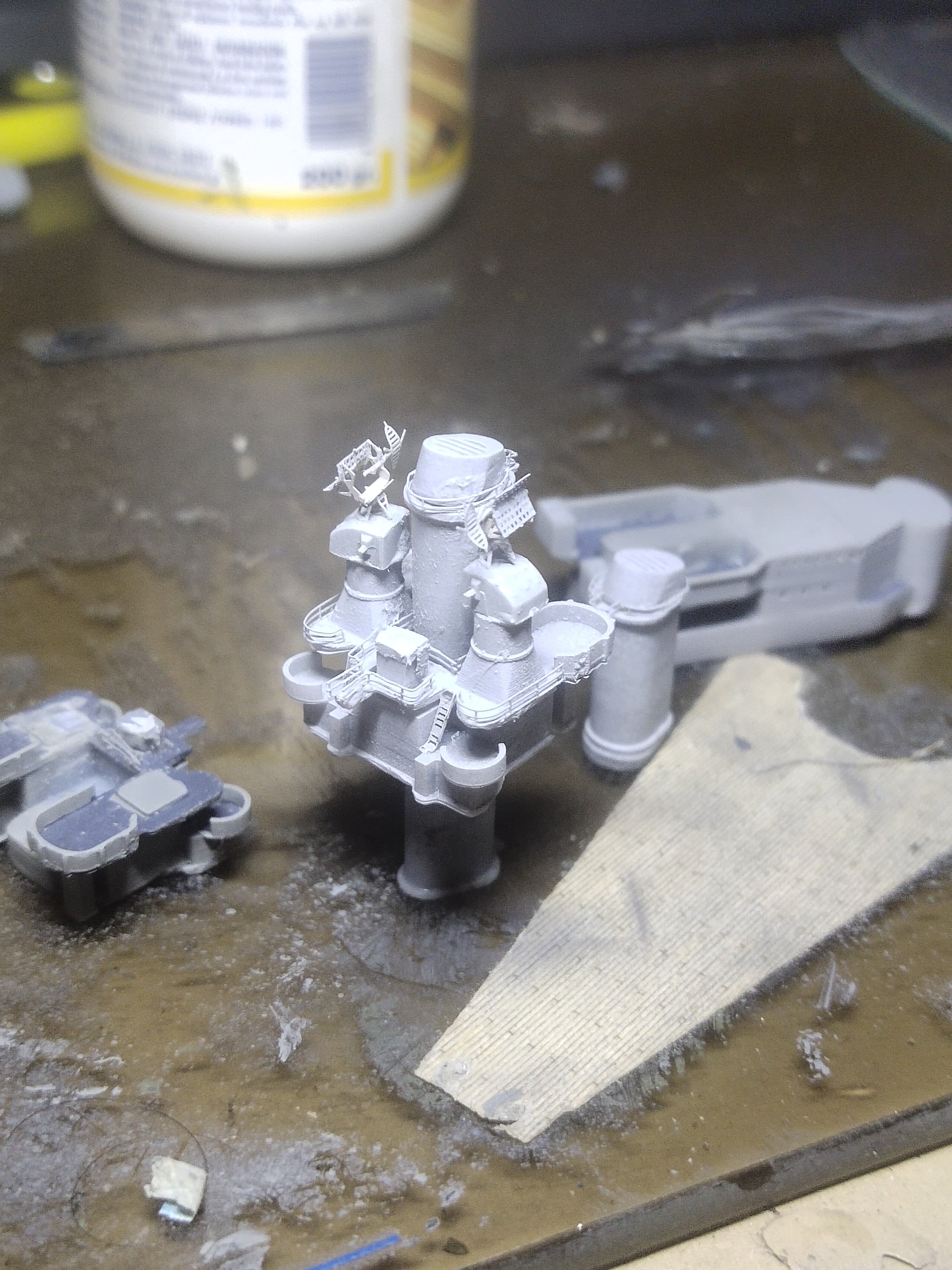

In my case though funnel height was calculated precisely they turned out somewhat sort. So I made new ones taller but shorter than the plastic ones. My reference point is the Mk 37 towers, they need at  lower level than the funnel. I measured again and they proved to be 2mm longer, so I sanded them down. However after installing PE on them, they gained considerable height. Instead of making new funnels and wasting some hours I put an additional  base made of 1mm thick plastic. Both parts were glued I only left the forward section unglued

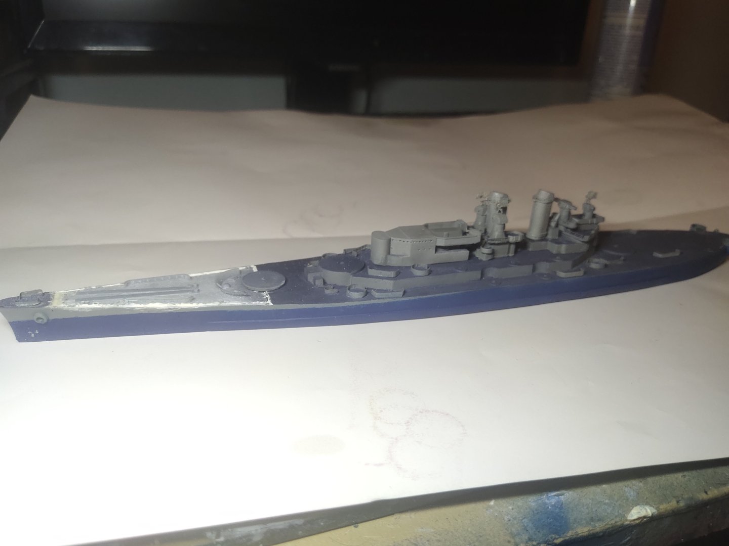

Lot of work, lot of study, little progress.

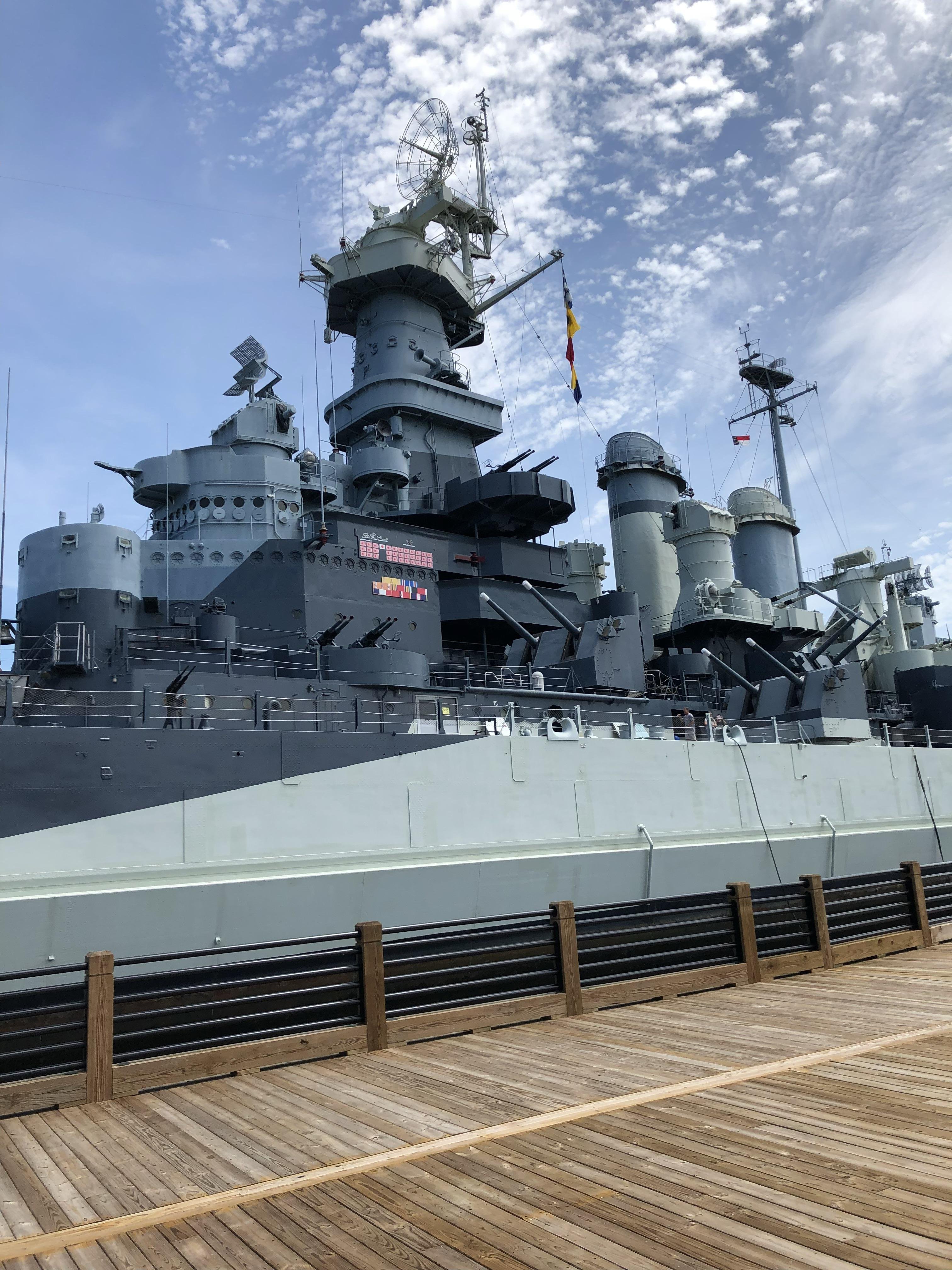

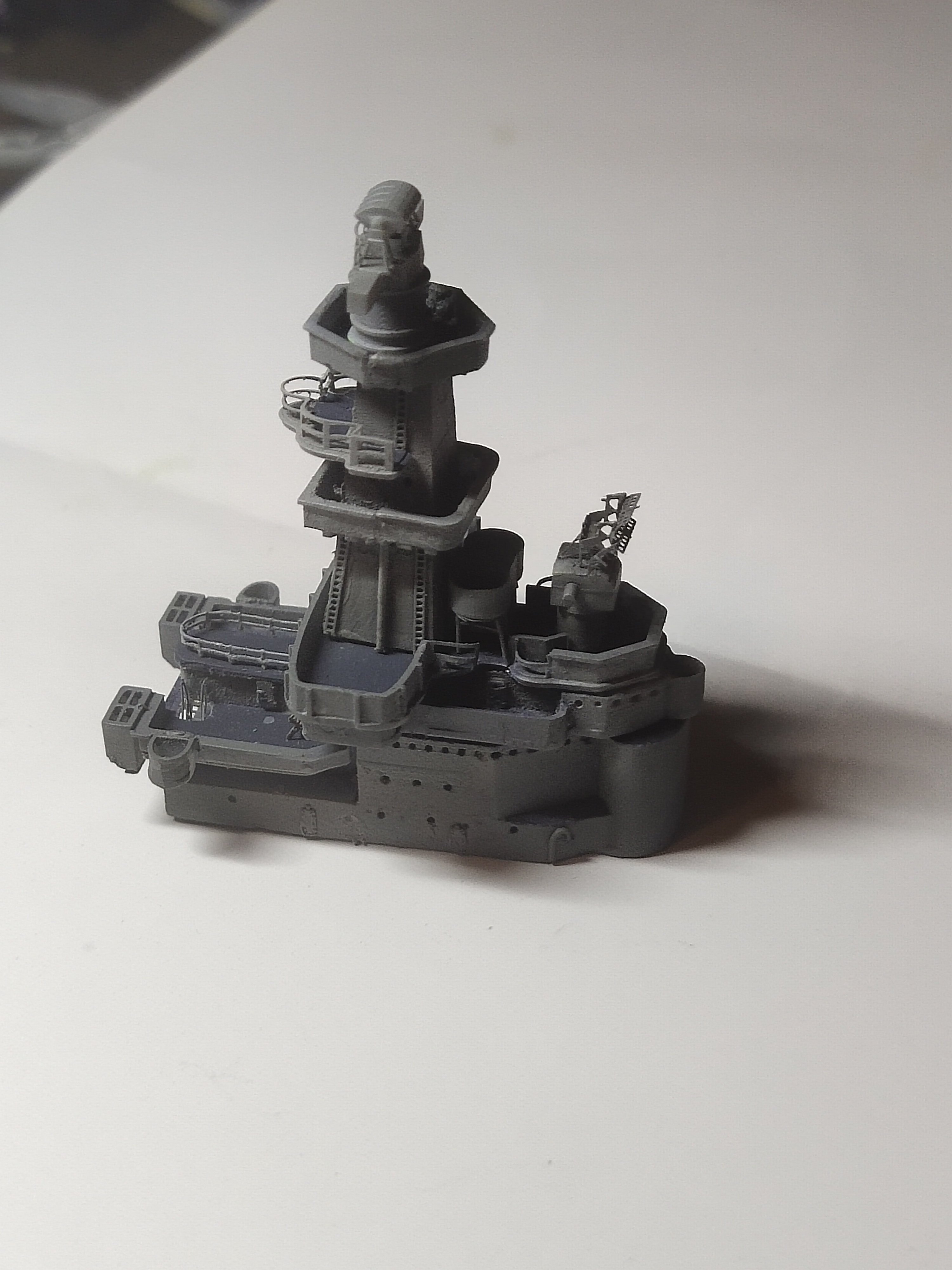

Good thing I found a picture of deck layout on X and along with some drone footage of the real ship I managed to make the superstructure quite close to the real one or at least far better than the original part
For the lower piece I cut the rear half, reprinted it modified  and attached it to the front. I'm good on such operations.
The other pieces designed separately and prepared to be fitted all together. Some details like ladders, hoses and door hatches were added at lower part. Will add on more on the way.
Edited by mikegr

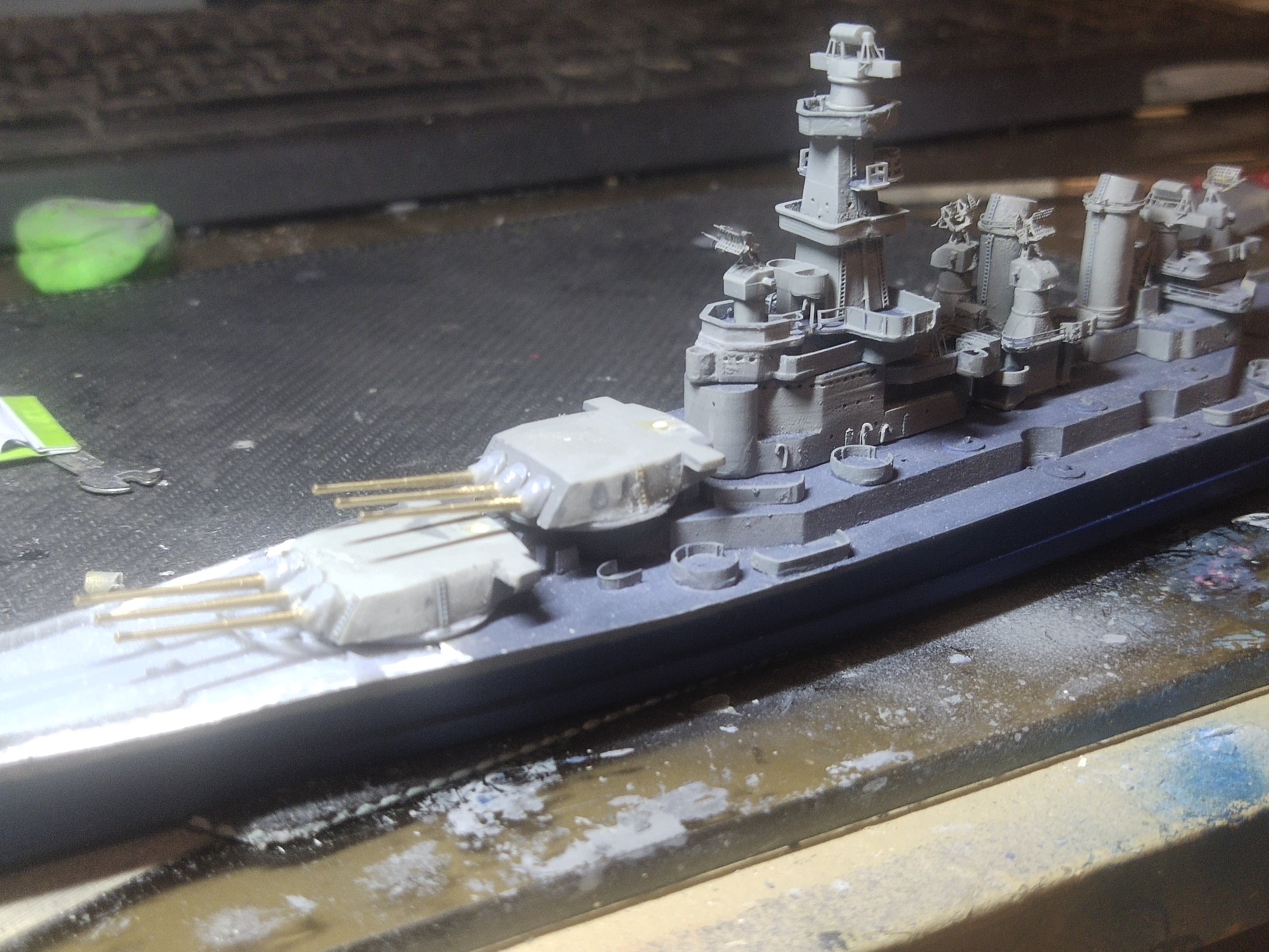

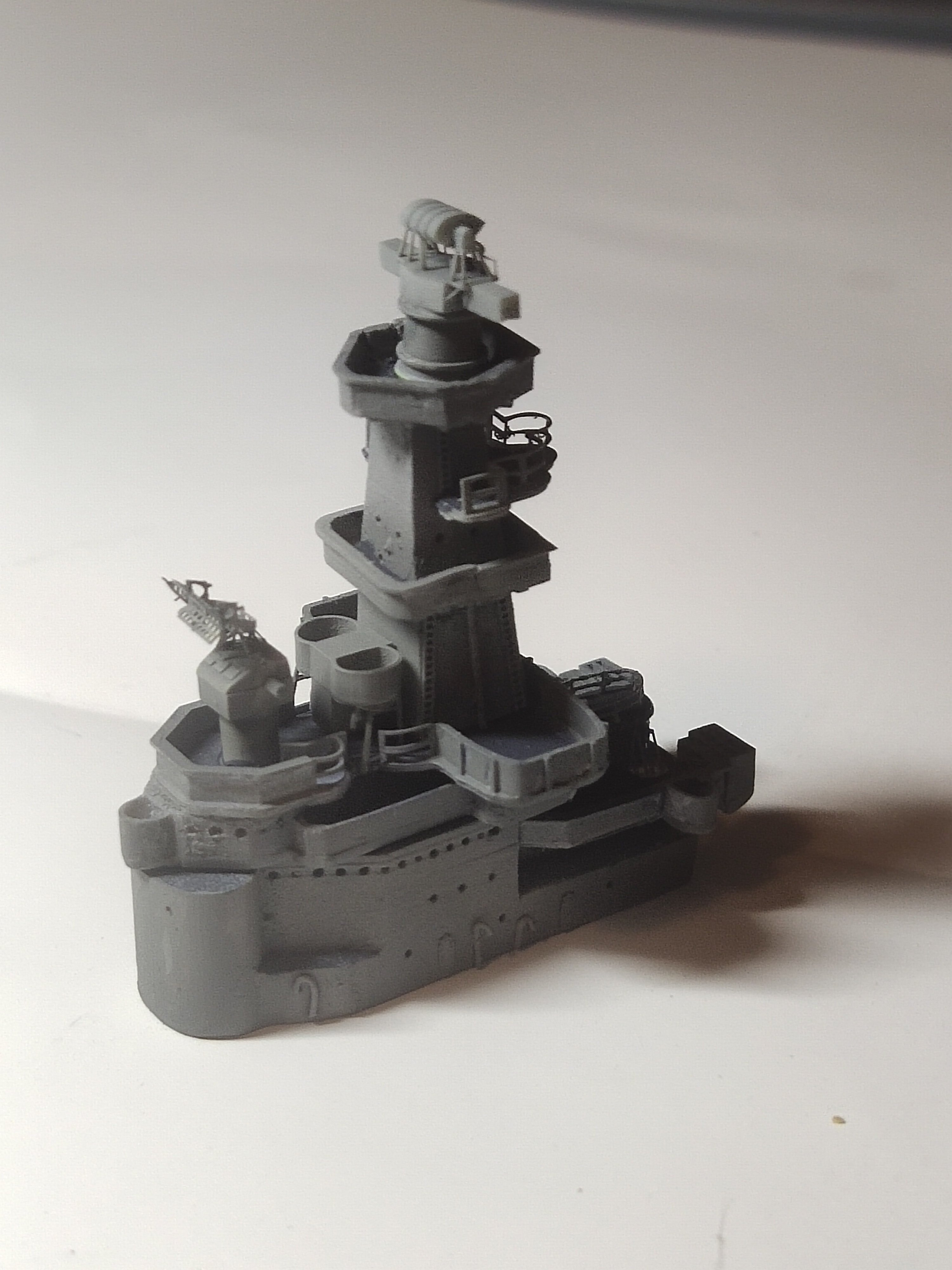

The tower was a bit higher and had to be aligned with the funnels so I sand it carefully reducing it by 2 mm.

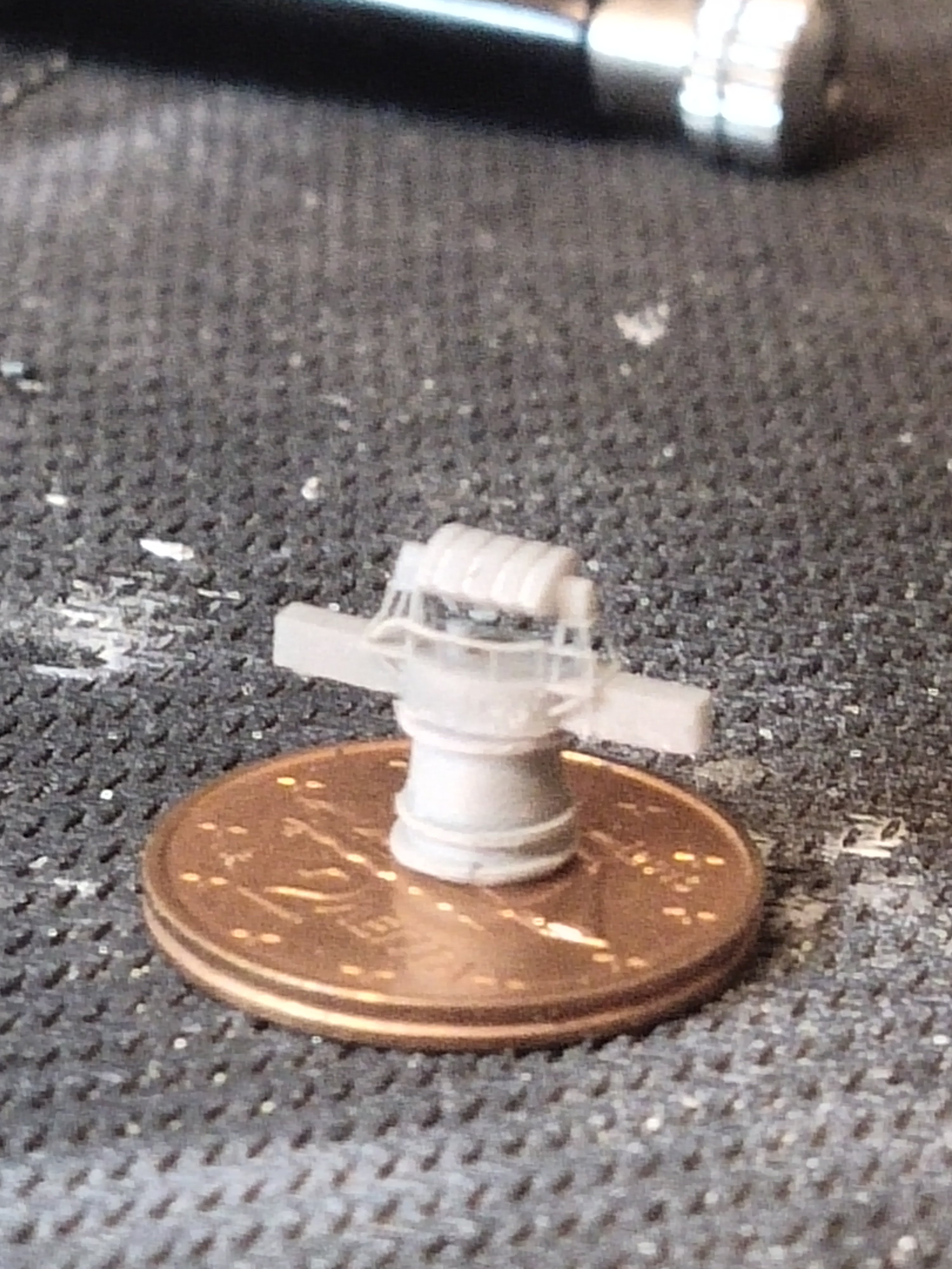

There is a radar called Mk 8 at the top of the Mk 38 director. The instructions for this PE are horrible, can't understand anything. Instead, I designed and printed my own Mk13 radar for them like those installed on Iowa class. Not sure if NC had them in 1944 but its better than a wrongly made PE part.
Anyway after a couple of test printings it turned very satisfactory in detail regarding the scale.

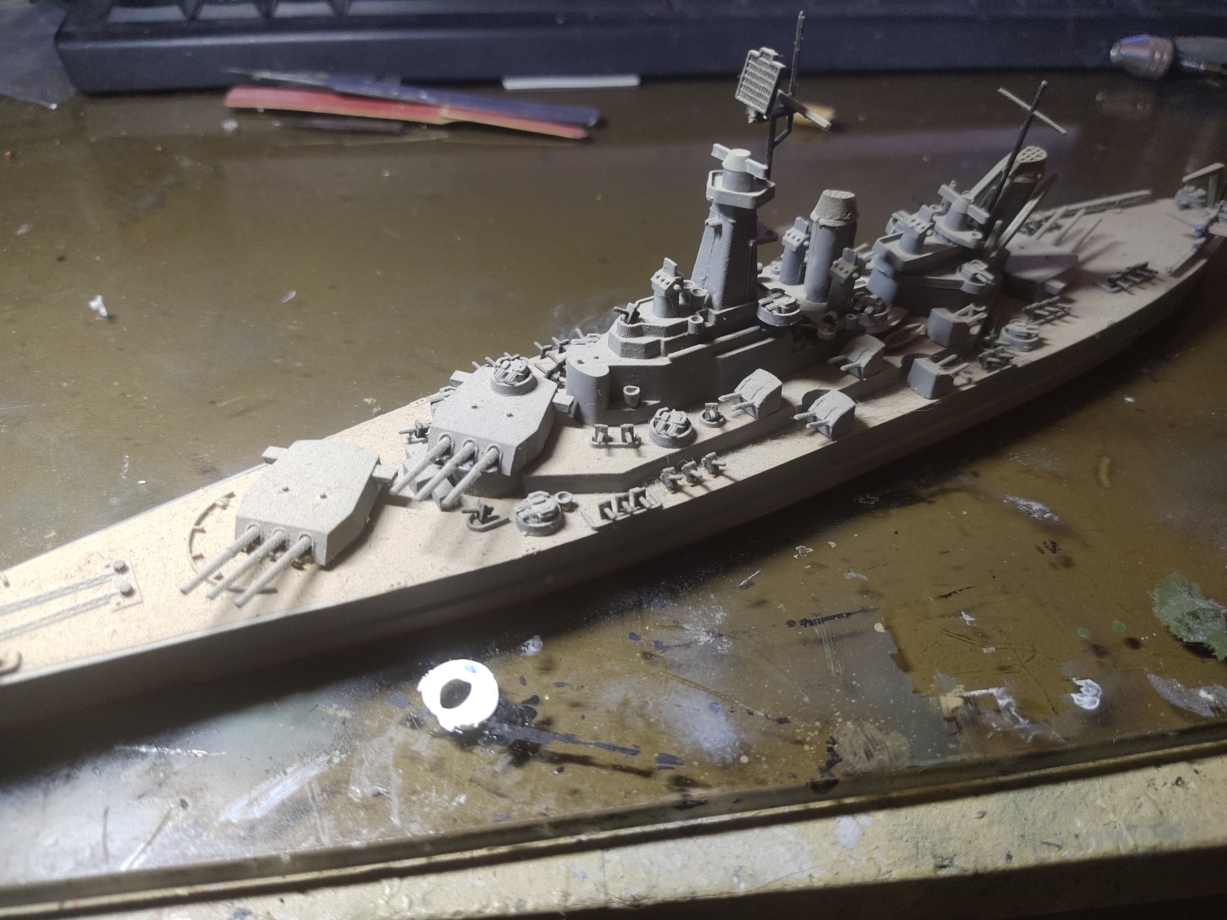

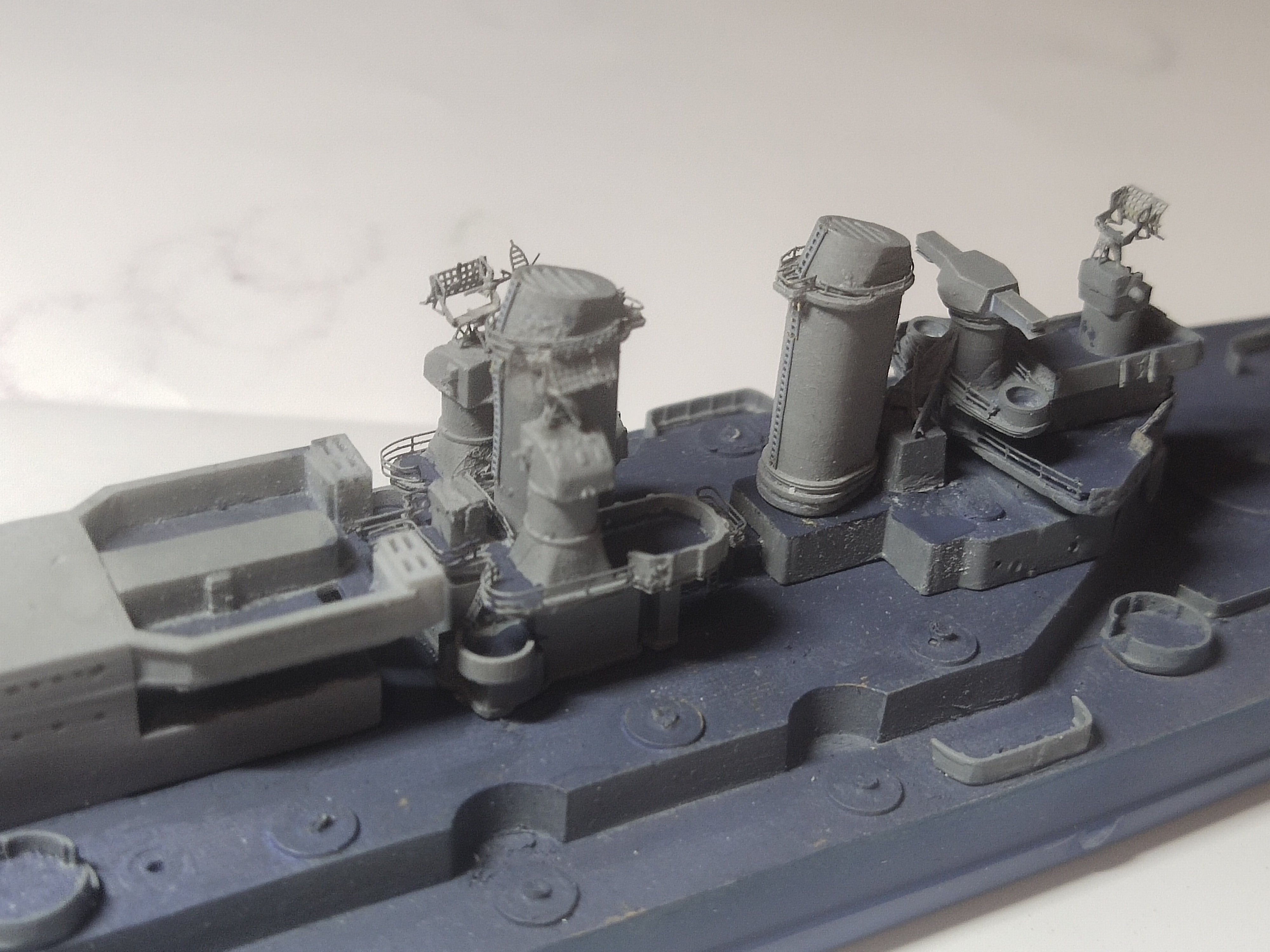

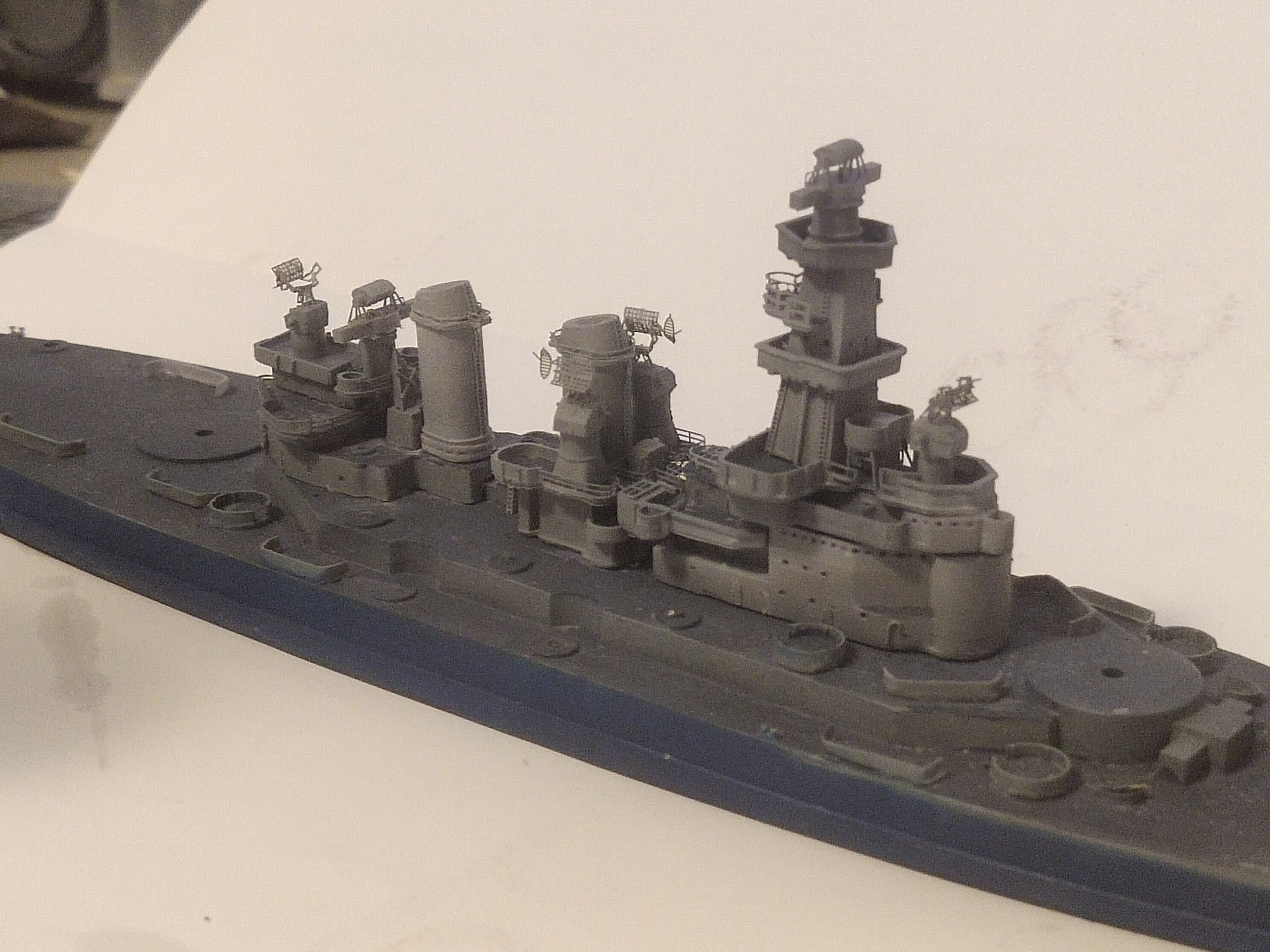

Some details added on tower, platforms, cases for Mk51 directors, doors etc. The whole superstructure piece is ready. It fitted perfectly on deck, some check tomorrow before I glue it. A hard two evenings works with two steps forward and one and half step back. But I got the desired result.

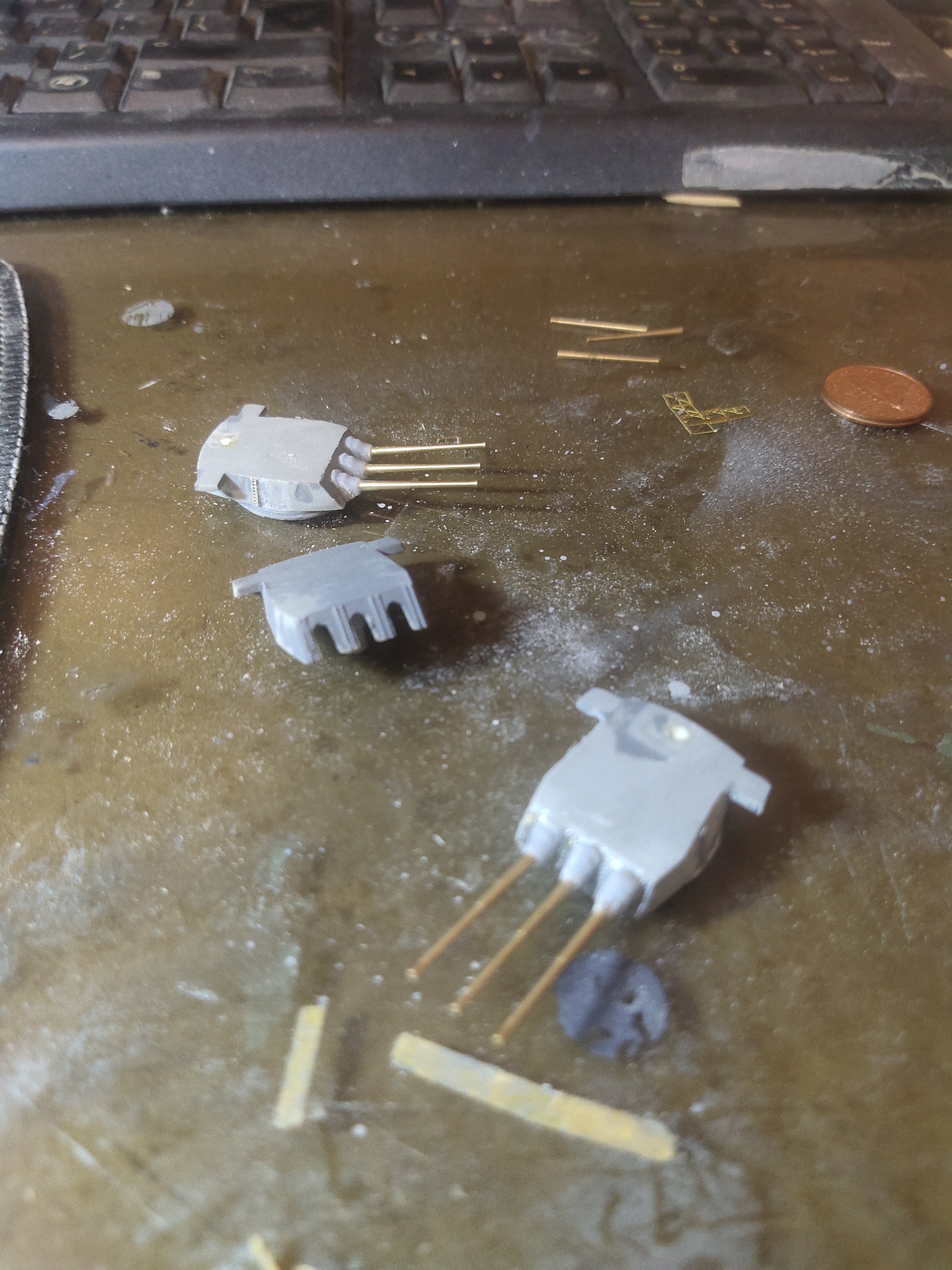

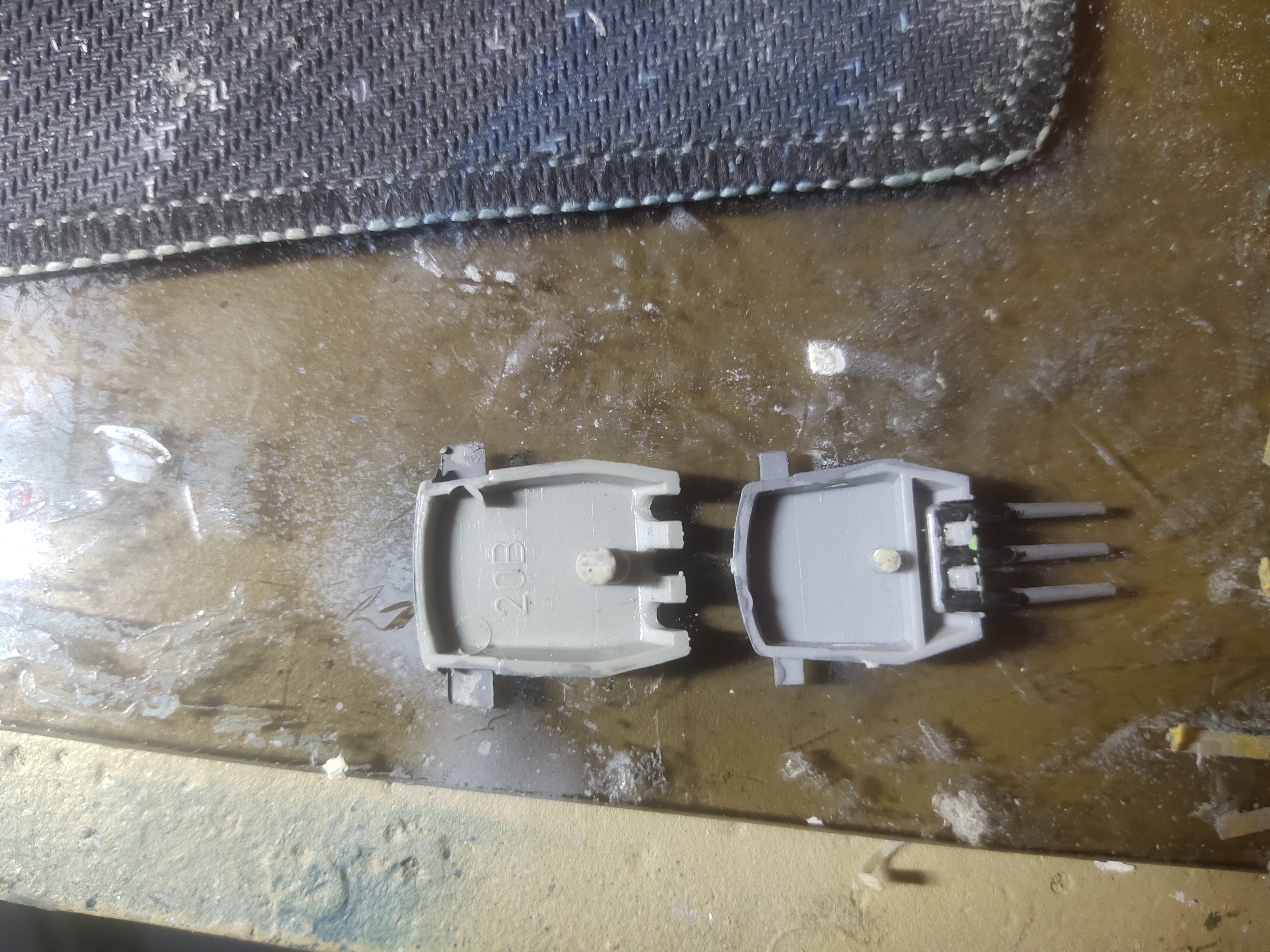

Today's work is at the 16" guns. Not much to do just add blast bags, brass barrels and hand ladders. As usual problem occurred. The blast bags were too big to fit along with ladders. At my stash I found replacement gun houses a bit wider. They looked great. However there were also bit longer. Like they are in 1/600 scale but I haven't built anything like this in 1/600 scale. Maybe these are from an Iowa class model, their 50 caliber guns needed  bigger turrets. At test fitting they look slightly cramped. Maybe keep maybe replace, will decide tomorrow

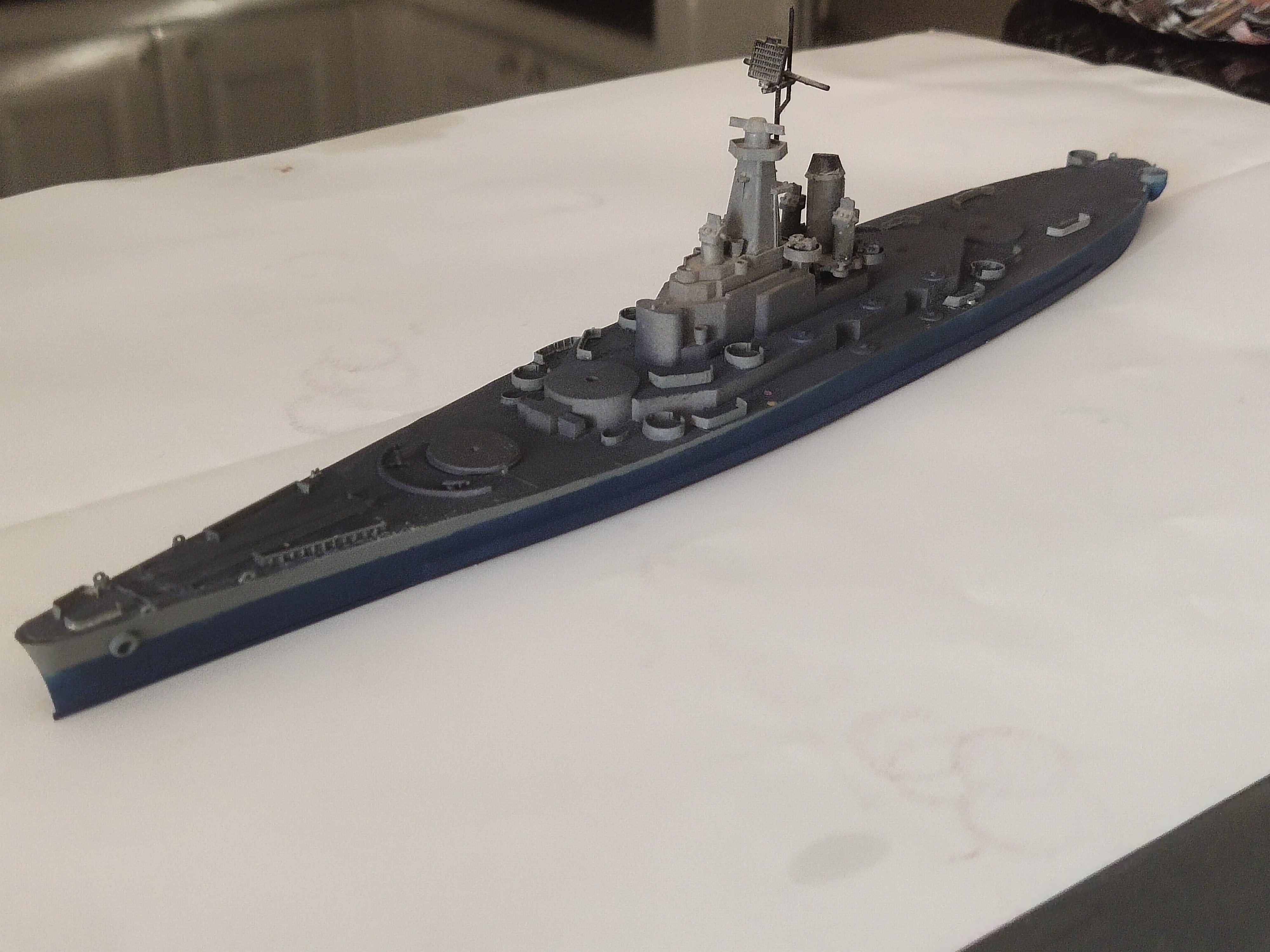

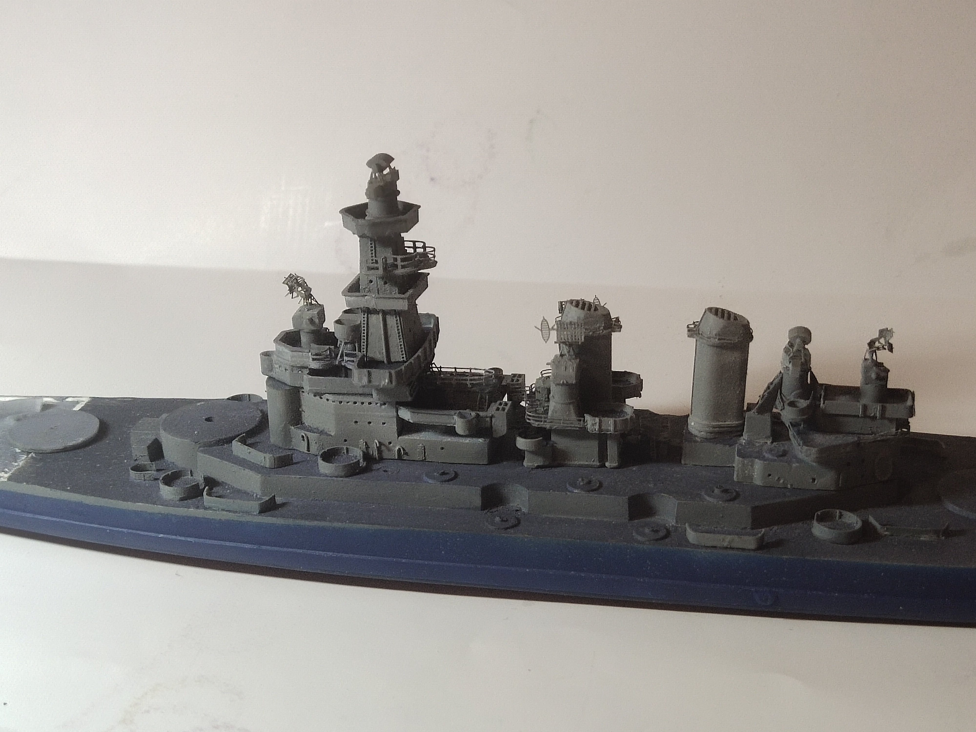

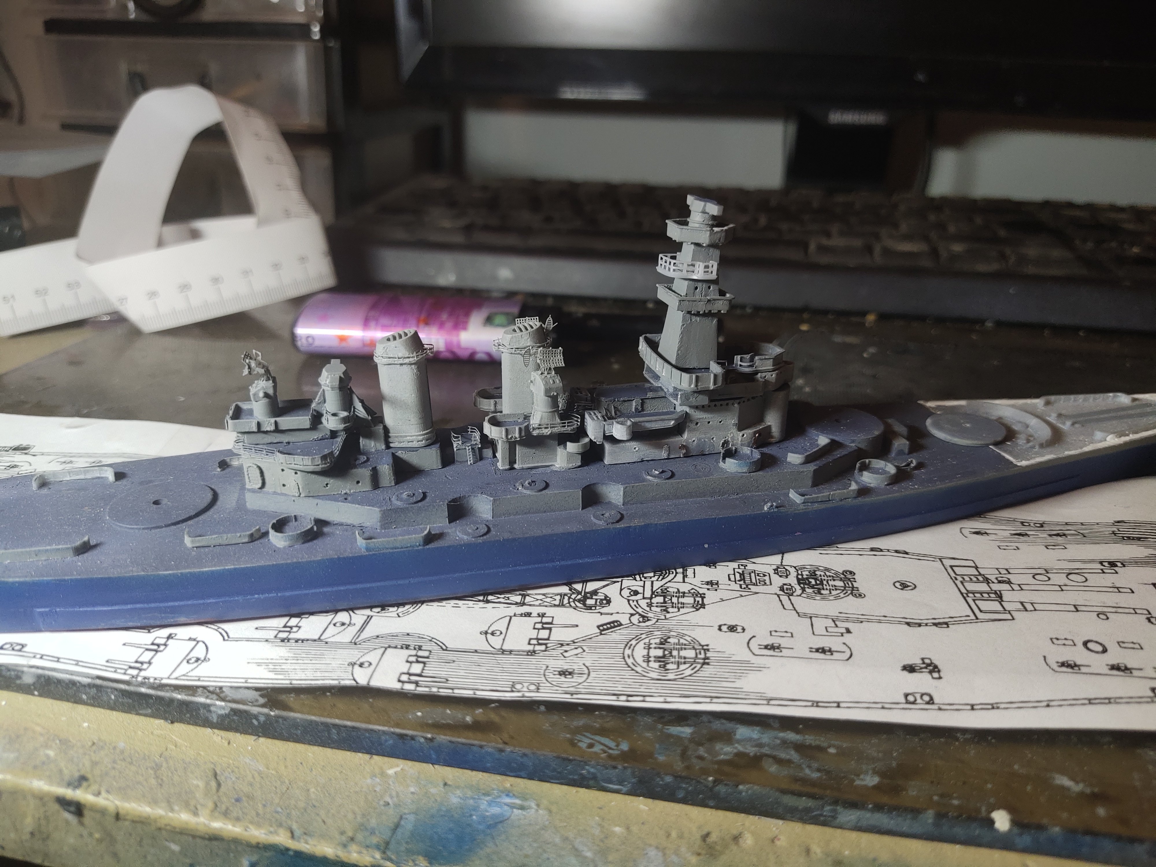

On 7/22/2025 at 10:09 PM, ddp said:

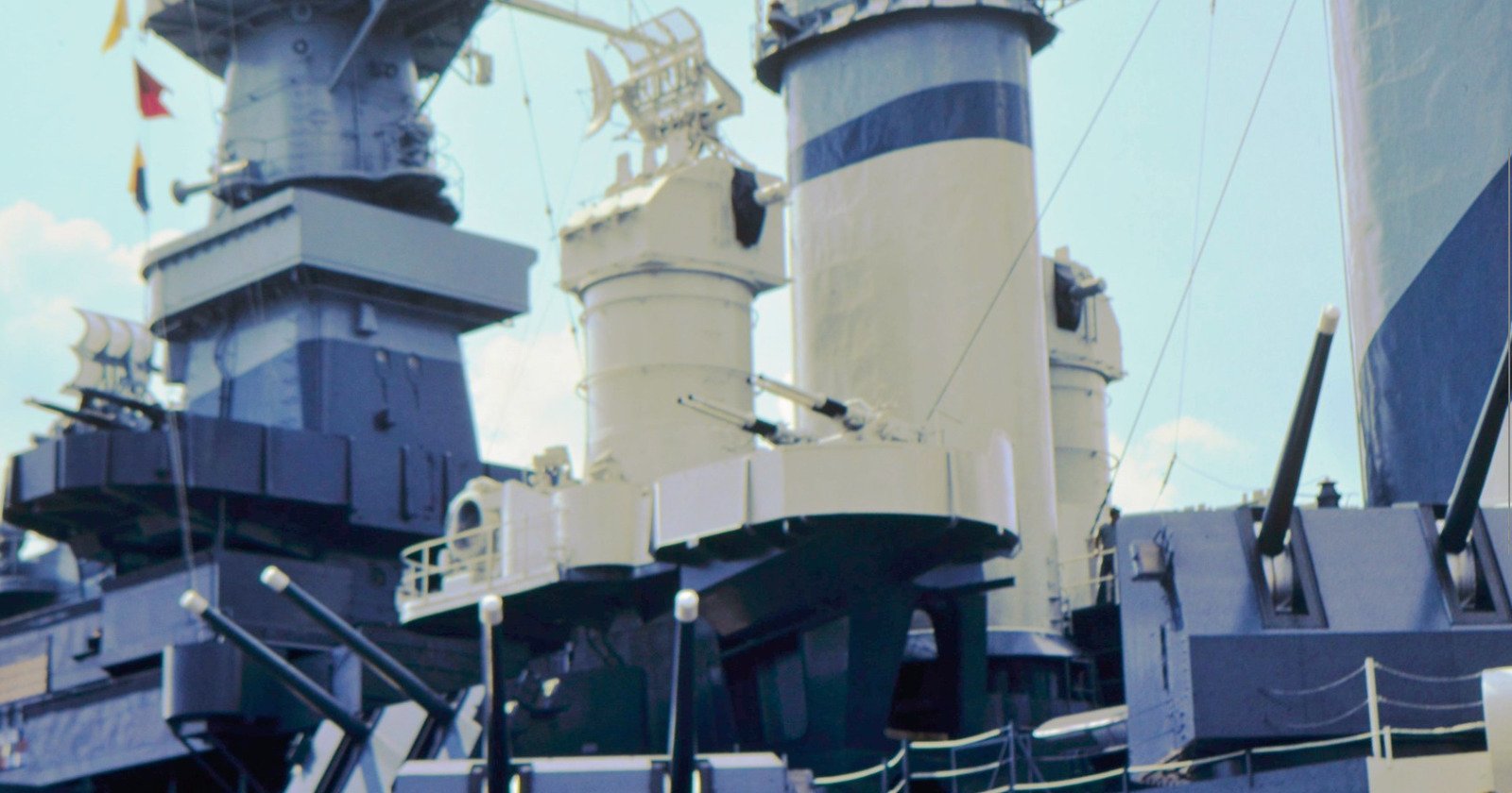

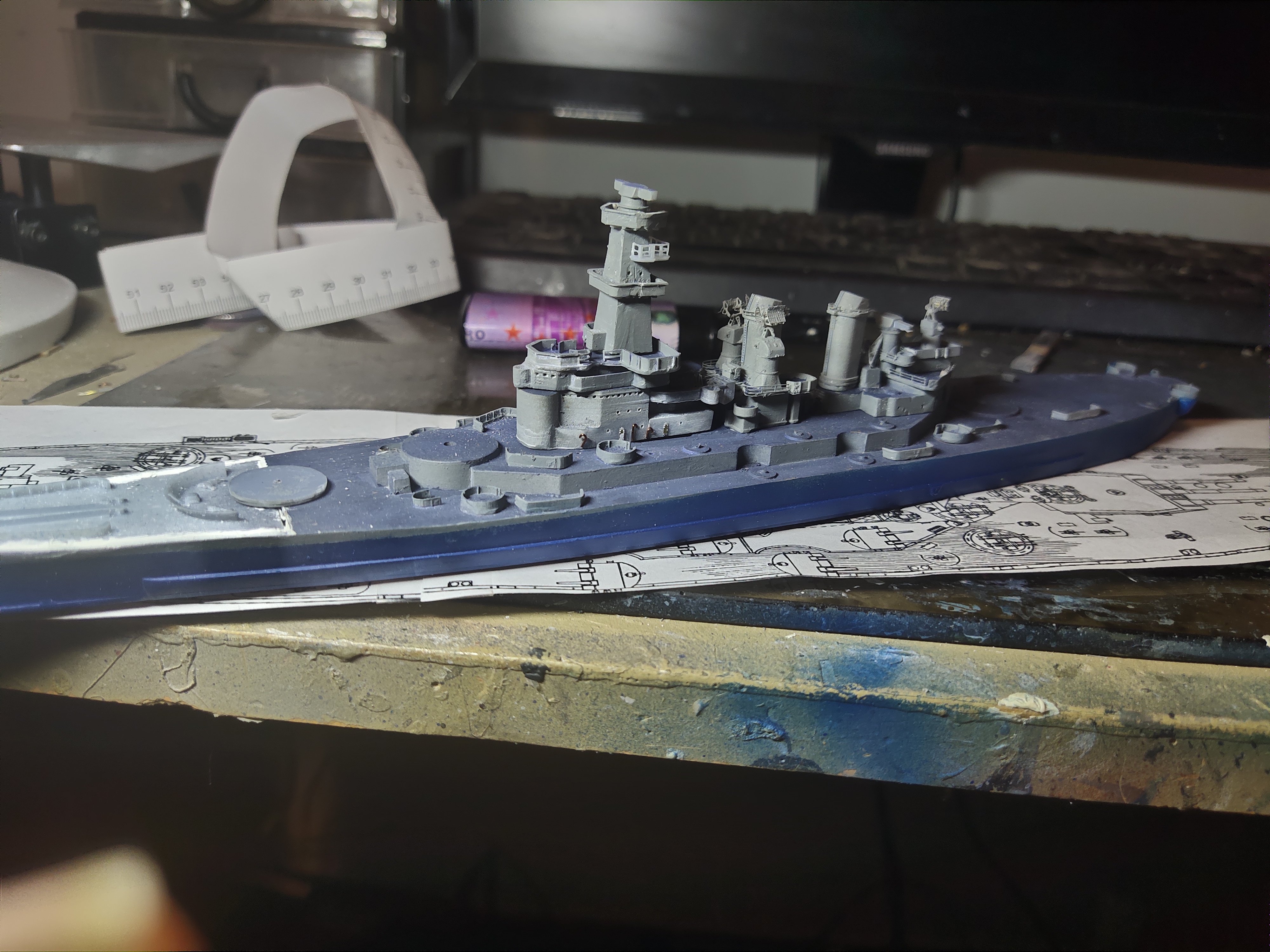

the model's tower of the forward superstructure appears to be to tall in relation to the heights of the 2 smoke stacks. the ship's profile drawing in the bottom picture backs that up that the tower is too tall.
This i noticed after uploading the picture few days ago
Upon inspection I found out that there was an error on the diagram which lead me to faulty measurement

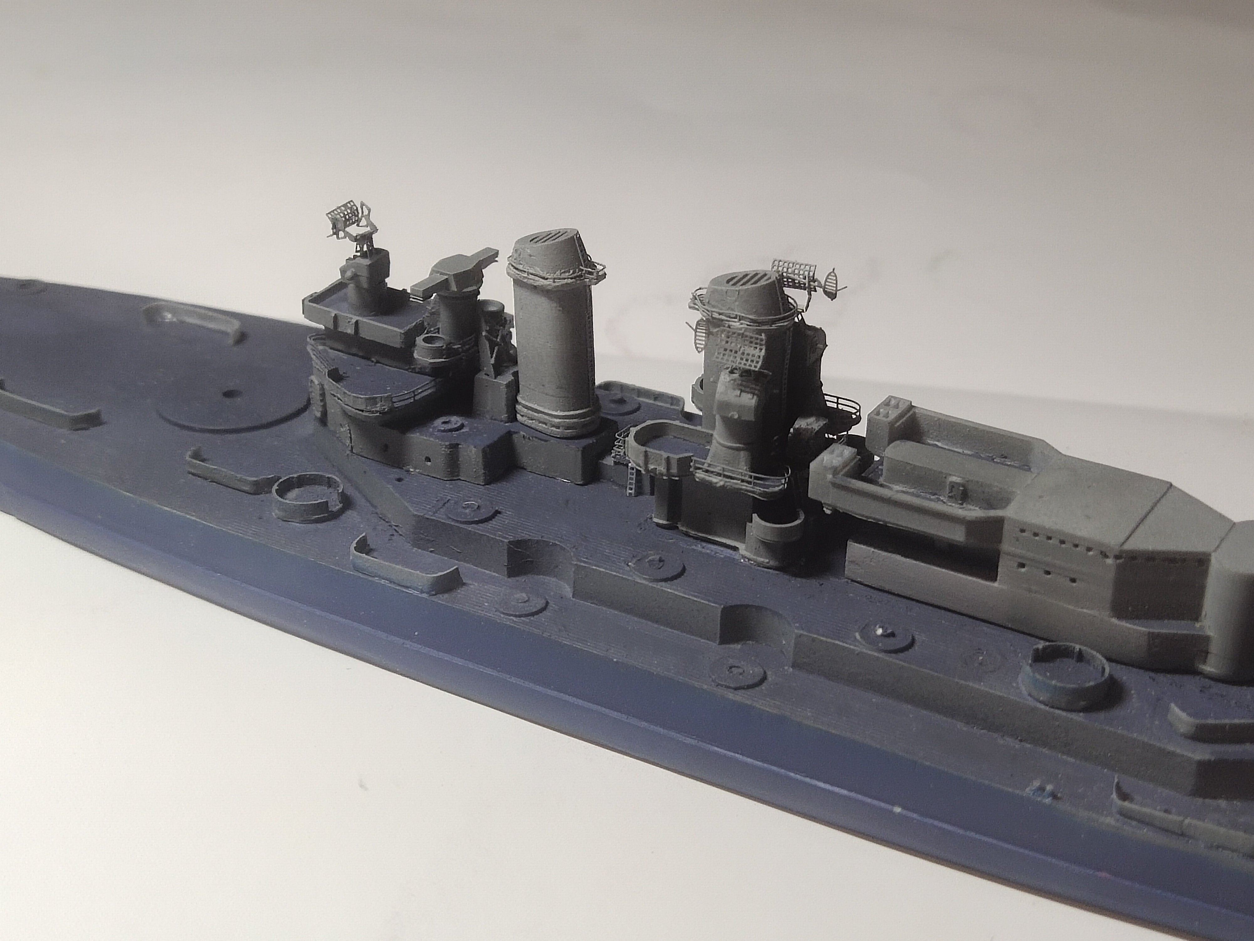

The base of the funnel is actually at the same level of the 5" gun. This is the correct one
Under the new circumstances and as I didn't want my model to look like a Japanese battleshiip with a unusual high superstructure, I had to replace the funnel. However these were glued with CA as it was considered a "finished" job and no corrections needed. Especially the front funnel was very hard to remove without damaging the  AA gun platform.
Therefore I used a rotary tool to "detele" the upper part of the funnel and add a 5mm section, a quite risky business. Somehow the vibrations caused the part to be detached. Then I removed the rear one, relatively easy and made the correct replacement parts
So I got rid of the "ISE" effect of my model, without casualties.
Final step for today, 16" gun turrets, painted ready to be fitted
