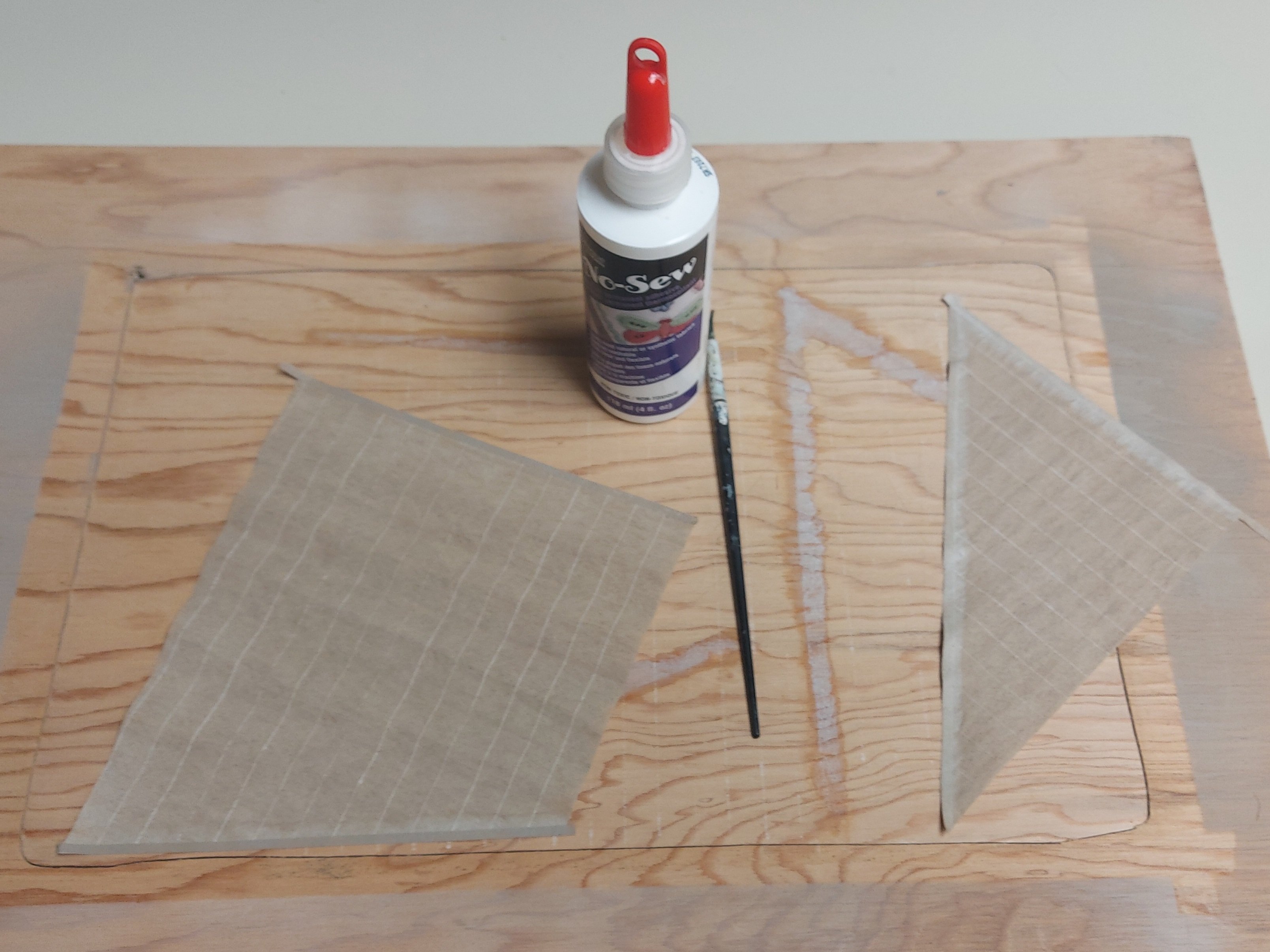

I have studied David Antsherl's appendix on sail making, and I previously made the recommended frame to hold the silkspan and practiced using it by making St. Roch's boat covers.
First I taped the silkspan to the frame using medicinal tape from my first aid kit. This is waterproof and holds nicely. Then I thoroughly wetted the silkspan using a water spray through my air brush. After it had dried I airbrushed on flat white, followed by buff.

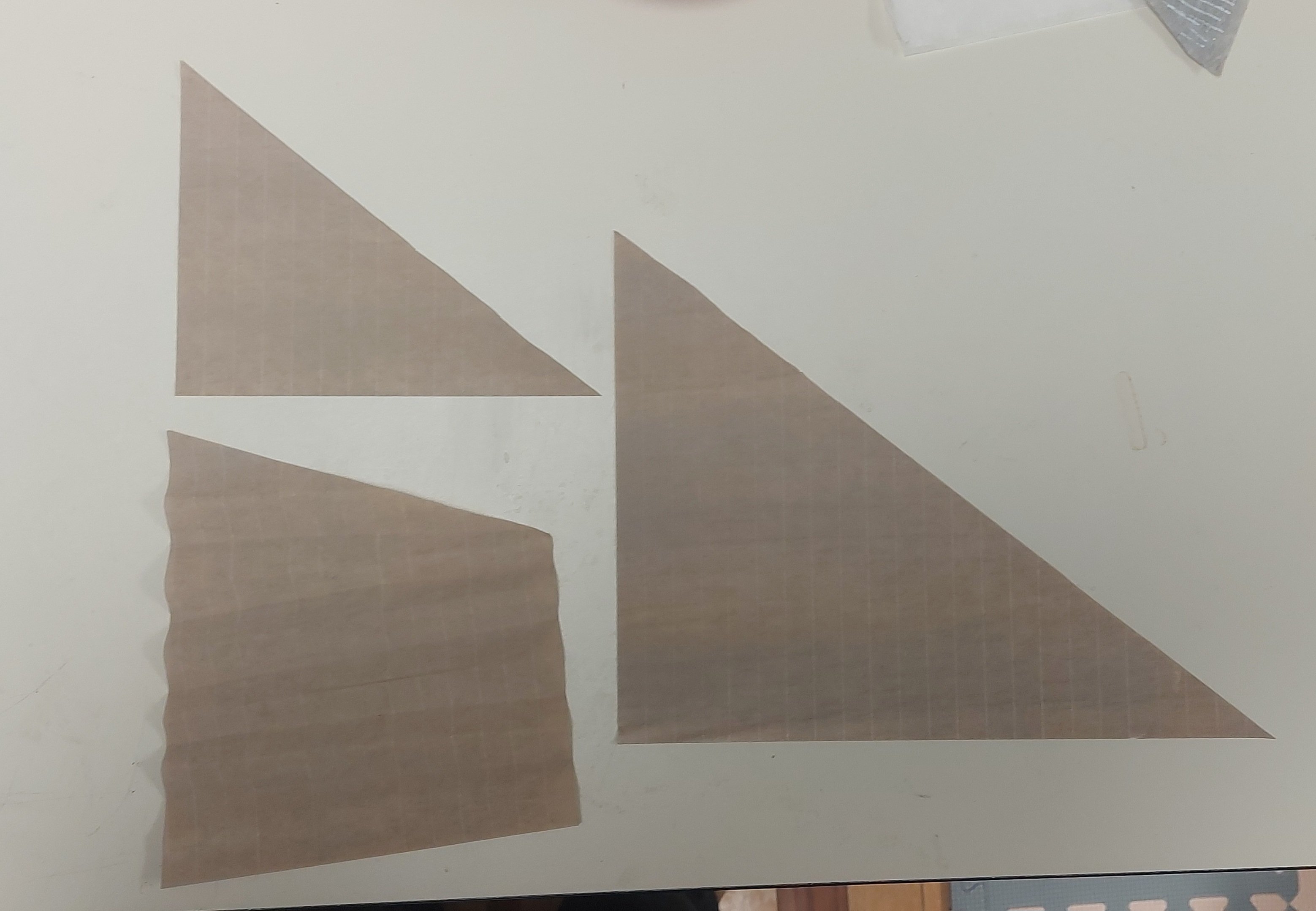

While the paint dried I made paper templates of each of the three sails: jib, foresail, and main sail. They are about 30% reduced in height because I intend to furl them and I did not want them to be too bulky.
Then I laid the templates onto the dried silkspan, trying to maximize the unused border areas as these will be used to make the tablatures and reinforcing panels.
I aligned the foot of each sail so that when I drew the seams on I could use a single seam line that would cross each sail. Then I used a pencil to draw the outline of each sail onto the painted silkspan.

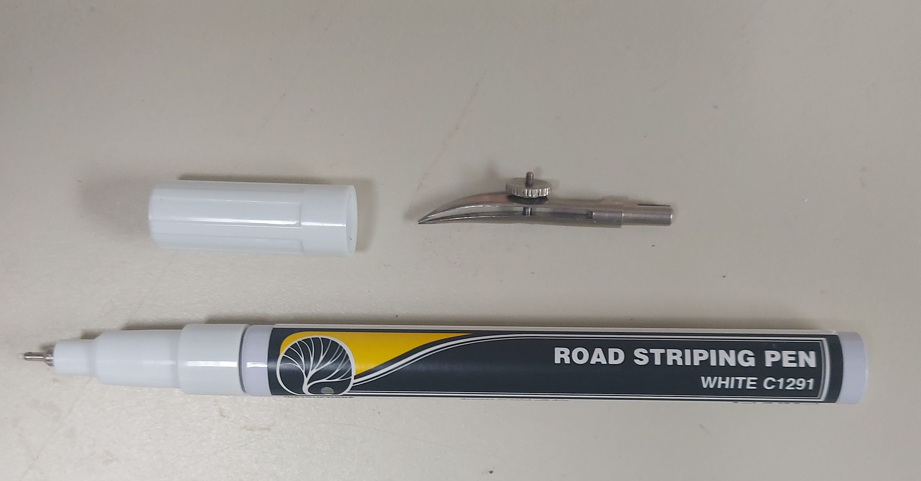

At this point I deviated from Mr. Antsherl's process. For drawing the seam lines onto the sails he recommends a device called a 'Bow Pen' which is an old drafting implement. I actually have one in my Staedler 'Techmatic' drafting set that I used in my Electronic Technology course back in 1972! However, it is a very fussy device and even after practice drawing a straight line of consistent width and free of skips and blots is hard to do.
I used a 'Road Striping Pen' made by Woodland Scenics. This is part of their system for making asphalt roads on model railroad layouts, and I also happen to have one of these! They are available in most decent hobby shops or on line for about $18 in either white or yellow ink.
I made witness marks a scale 21 inches apart (the width of each sail cloth) along the top and bottom of my frame, lined up with the vertical side of my sails (the sides that will go up the masts). My template alignment worked out and I was able to draw seam lines from top to bottom across the three sails.
Next up I may add another light spray of buff to tone down the seam lines and colour match them to the sail cloths.
Mr. Antsherl says to add the tablatures and reinforcements at this point, but I will probably cut the sails from the silkspan first.
My experience tells me it I will have an easier time adding these items off the frame, and besides, the material for these parts is coming from the extra silkspan at the side and bottom of the frame.
So far so good... we'll see how I get on tomorrow...

3 hours ago, druxey said:
How does a road striping pen differ from a bow pen, Bruce?
Hello Druxey and thanks for your question!
Here is a picture of my drafting set next to its' bow pen and with the striping pen. The second picture is a closeup of the two.
Essentially the striping pen works like a Sharpie fine point marker except it is loaded with white or yellow ink, the colours of highway lane markings.
The bow pen is designed to be loaded with ink or paint, and if you load too much or too little it will either blot or run out partway along a seam line on your sail. It takes practice to make this work, and I know others have had success using it.
I find the Road Striping Pen an easier proposition. In my 1:48 scale it lays down a line a scale 2" wide. Lighter pressure makes a narrower line.

Thank you, Bruce. With a little practice, one can get the consistency of paint right (rather like airbrushing!) and a ruling or bow pen will lay down a consistent line. I can see the advantage of the striping pen, except that you are limited to white and yellow.
I think we had discussions on drafting implements in another thread quite a while ago. There is also an intermediate option, but I am not sure of the correct technical term in English. The translation from German would be something like 'funnel pen', which is quite descriptive. It is essentially a thin tube (the outside diameter determines the line width) with a funnel-shaped reservoir on top. A thin wire in the tube allows to declog it, when needed. It's the low-tech predecessor of the 'modern' drafting pen. They are designed for use with inks, rather than paints. However, I know from my mother that they are also used with gold suspensions in porcelain decoration.
A while ago we discussed druxey's technique of making sails and I understood that drawing those lines with a bowpen also aims to add volume to the line to simulate the doubling of the seams. How much volume do those road-lining pens add ?
Bruce

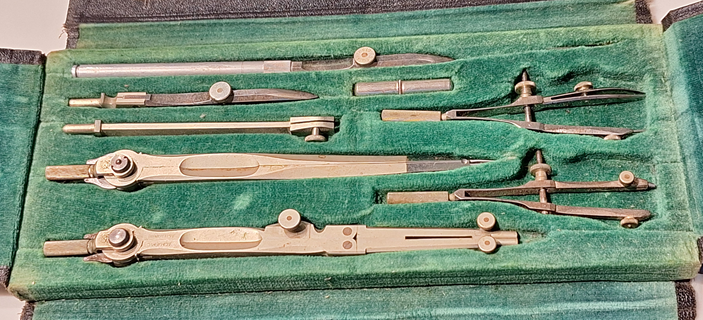

was there no handle for the bow nib?
Alan
Alan O'Neill
Very interesting, I had not heard of this device before... your comment jogged my memory, I had forgotten about my Dad's old drafting pens that are now stashed in one of my drawers somewhere, and they could be loaded up with inks of any colour and used like the striping pen... I could see drawing water lines or other fine details with these as well.
The striping pen does not add a measurable amount of volume, but how much do you really need, especially at smaller scales
3 hours ago, AON said:
Bruce
Alan
Yes, you remove the pencil holder from one of the compasses and substitute the bow pen. This is not as awkward as one might think when drawing straight lines as opposed to circles.
Edited by Lecrenb
You can see in the two photos below that to draw straight line the set has a straight handle for one nib. This nib threads onto the handle making it pen like.
The other nib options have slots to fit and clamp onto the compasses.
The newer set is mine, about 60 years old now.
The older set was my grandfather's, circa 1900.

Alan O'Neill

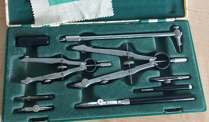

It seems that the Staedtler MARS QuickBow set does not have the straight handle, there is no slot for it. I have various sets, from my father/mother and perhaps older ones, plus my own, which is from 1966 - they all have this straight handle.
my newer old one is ALPHA Precision (Germany) the older old one is TESCO (Technical Supply Co., Montreal).
Alan O'Neill

Those are nice sets! Obviously lasting several lifetimes and something to pass down! Yours is more versatile that mine, having the pen handle. You have to come to grips with mine, then you can draw straight lines. I did well on the course so I guess I figured it out, but it took me some practice!

Moving on with the sails, I did give them an extra shot of buff to tone down the seam lines and give them a colour match. Once everything was fully dried I cut the silkspan from the frame then cut out the sails along my earlier drawn pencil lines... the seam lines are subtle but visible, which I think is how they should be...
I couldn't resist scrunching up the foresail and setting it in place between the boom and gaff. Just to check the fit and see how it might look...
Next I cut 1/8" (scale 6 inch) strips from the waste silkspan for the tabling. Using the waste means I get an exact colour match to the sails. Per advice received here on the forum and from the Maritime Museum I am setting them onto the port side of the sails. I brushed on water first, then diluted No Sew, which set down nicely with the tabling right along the sail edges.
I did not want the glued sails to stick to the frame, so once the tabling was set in place I carefully lifted the sails up off the frame and set them a bit to one side. You can see the No Sew left behind in the picture. They will now not stick to the frame, and once they are dry I can add the remaining tablatures.
Once the tabling is complete I will move in to the reinforcings. These are my first sails and so far, so good!

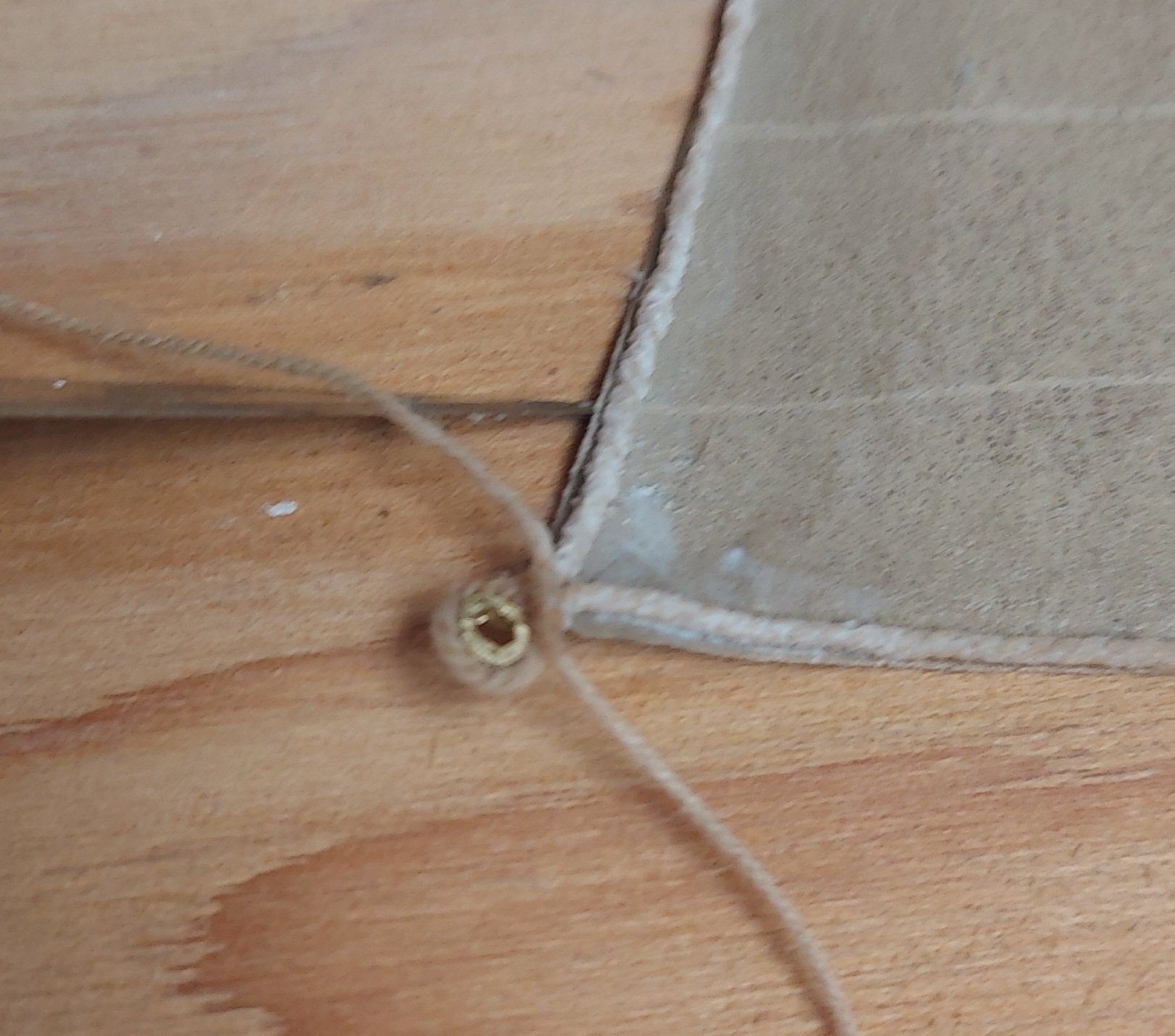

The tablings are all on my sails, and after studying photos and talking with my contact at the Vancouver Maritime Museum I realized that the reinforcing patches are on both sides of each corner and wrap around the bolt rope...
Therefore I have to set the bolt ropes and then add the patches on each side as I come to a corner. Each cringle is lined with an iron ring for strength and to prevent chafing, and I will model these with thin slices of brass tubing. Brass looks much better than styrene in this application.
The first photo shows my first corner...
A little fit of trimming is needed, otherwise I think this will pass muster...
The No Sew is still setting, the rope will look better once it is fully dry. The next picture is the second corner, the cringle has just been tied in and the No Sew applied. After drying the patches will go on.
I will continue working my way around the foresail, and then sew on the mast hoops... baby steps; this won't be rushed so it may be a little while before I post again.

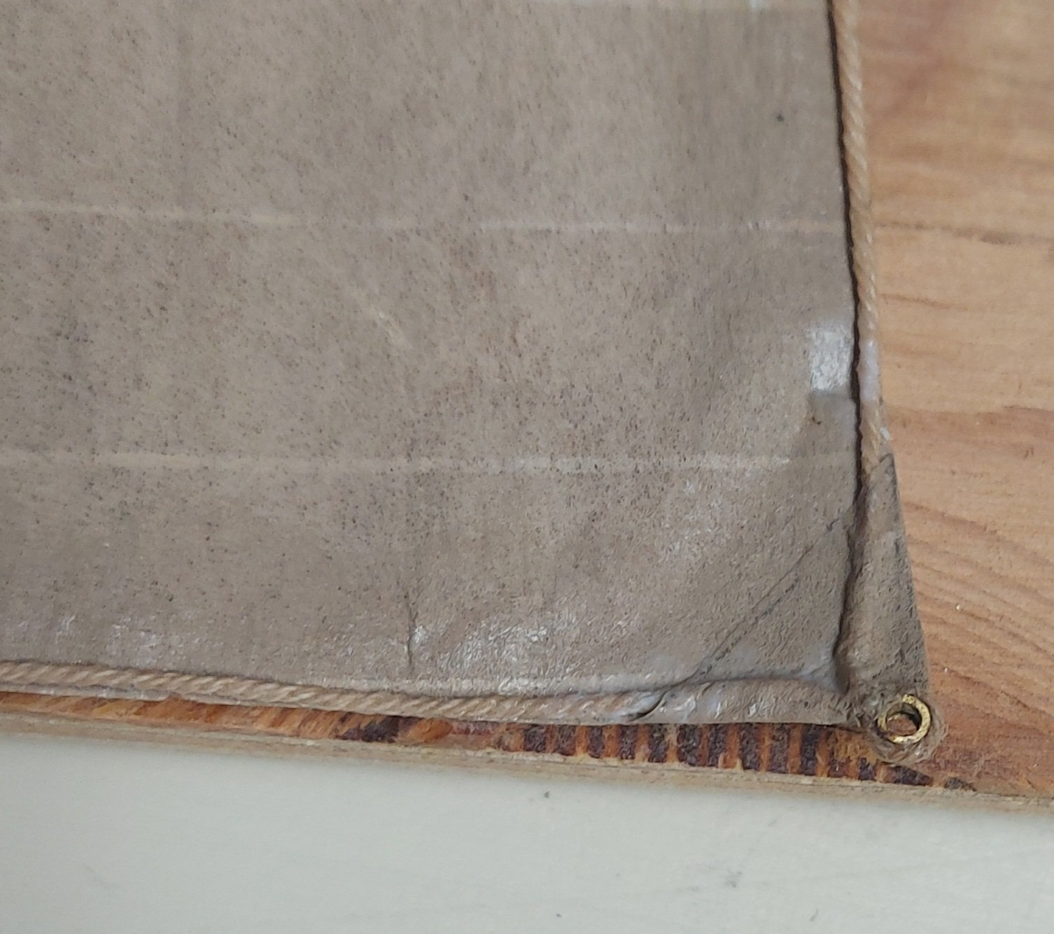

In the past I used cored solder to represent such cringles. The bore was widened to a flare with a punch. The colour is close to zinc-plated hardware.
I anneal brass tube, cut off slices and put them in a thickness jig to file both cut edges flat. I then place the ring on a steel block and flare both sides using a centerpunch.
3 hours ago, wefalck said:
Coming along nicely!
Not a bad idea! The picture is the foot of St. Roch's foresail today... the sail is modern material but the restorers have replicated the corner reinforcing and used the original iron hoop cringle...

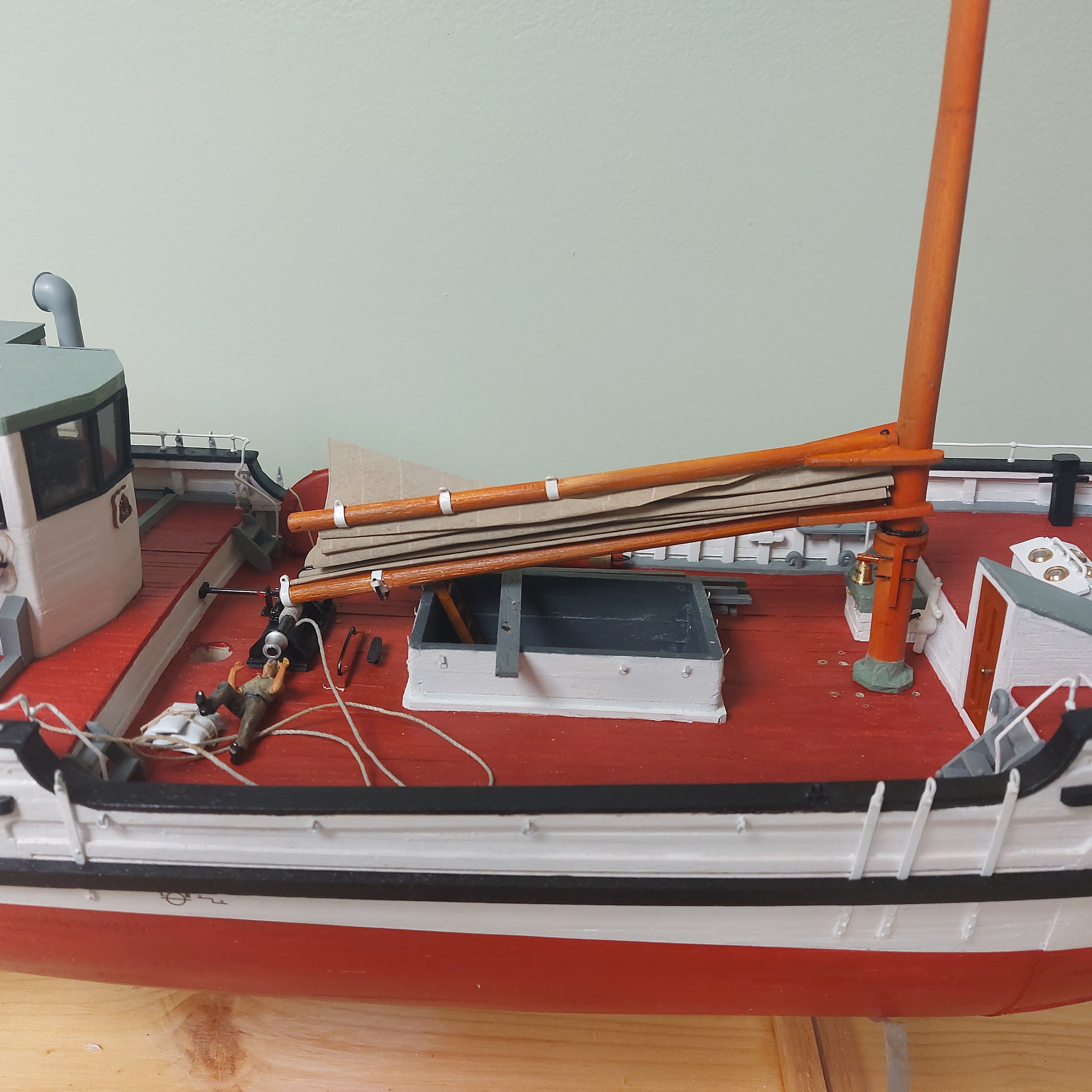

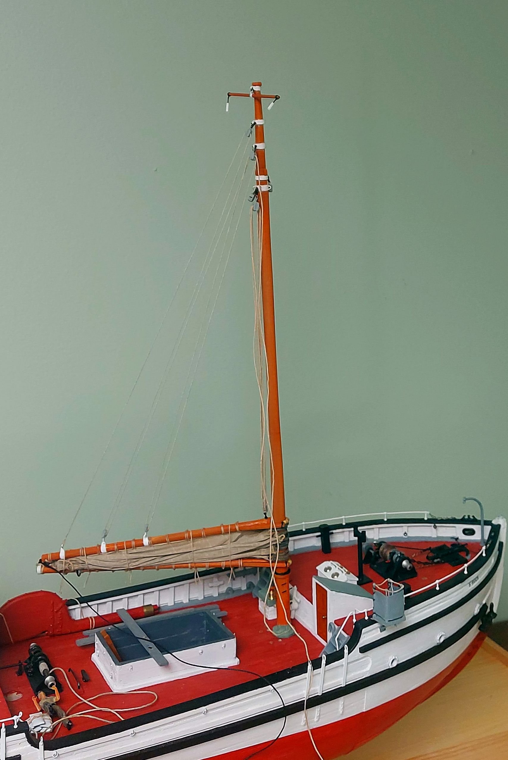

The foresail is complete, and I have attached it to the boom with its' robands. I am completing tying on the hoops, after which I will attach the gaff, prepare the parrels, and install the sail onto the mast.
Then it will get furled...
I actually made the sail about 1/8" too long, so I crinkled the foot a bit to get the corner hoop aligned, as I was not going to remake it at this point!
Furling the sail hides a multitude of sins!
The sail height is about 2/3 of what it would be if it was set... this is to reduce the bulk to be more in scale when furled.
Next picture should see it on the mast!
Bruce
Edited by Lecrenb
Here is the sail mounted onto the foremast, the hoops slipped over the mast bands easily...
Now I can install the parrels and furl the sail, as well as attach the blocks and shackles to the mast top.
Once that is done I will pre-rig the running rigging. I know this is opposite convention where the standing rigging goes on first, however on St. Roch almost all the running rigging belays on pin rails at the foot of the mast, and the stays and shrouds will get in the way.

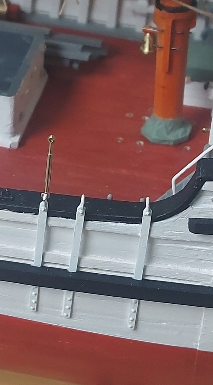

In the meantime I can start making stays... first thing is to test fit a bottle screw to a chain plate...
Should work ok...
The standing rigging is all fswr, and I need four back stays for the two masts, and I'll make them all at once, then move onto the shrouds.
