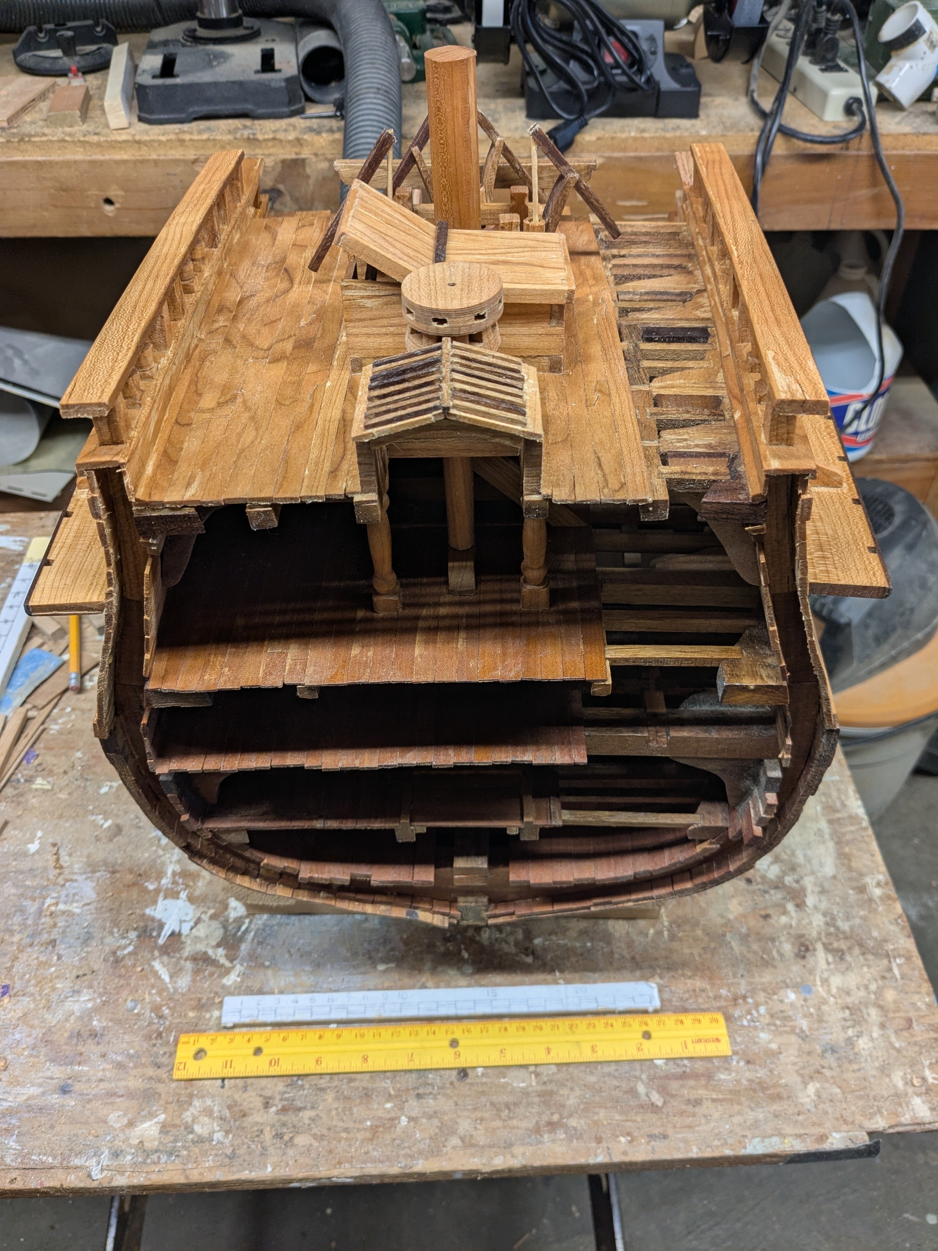

Here is my 1:30 mid-ship cross-section of HMB Endeavor. My original resources for construction were the books and plans by Harold Underhill and Charles Davis. Lately, Waldemar was kind enough to give me access to the detailed diagrams of Endeavour by Karl Marquardt. These revealed several mistakes in my framing (too few, room and space), which I decided to accept and to follow Marquart's diagrams in building the interior decks. The upper frames will be rebuilt more accurately as I move upward. Wood is cherry and walnut. Walnut sheathing will be applied to the bottom up to the wales, omitting several strakes of sheathing and planking as though under repair.
Your fine model showing the internal structure of the ship, particularly at a large scale, is a pleasure to look at. And for me, it is equally true for those without more or less distracting details like all kinds of ornaments, colours etc. Artistry in pure structure...
Very nice, showing the internal structure is a great idea, especially in this relatively large scale.
Cheers Rob

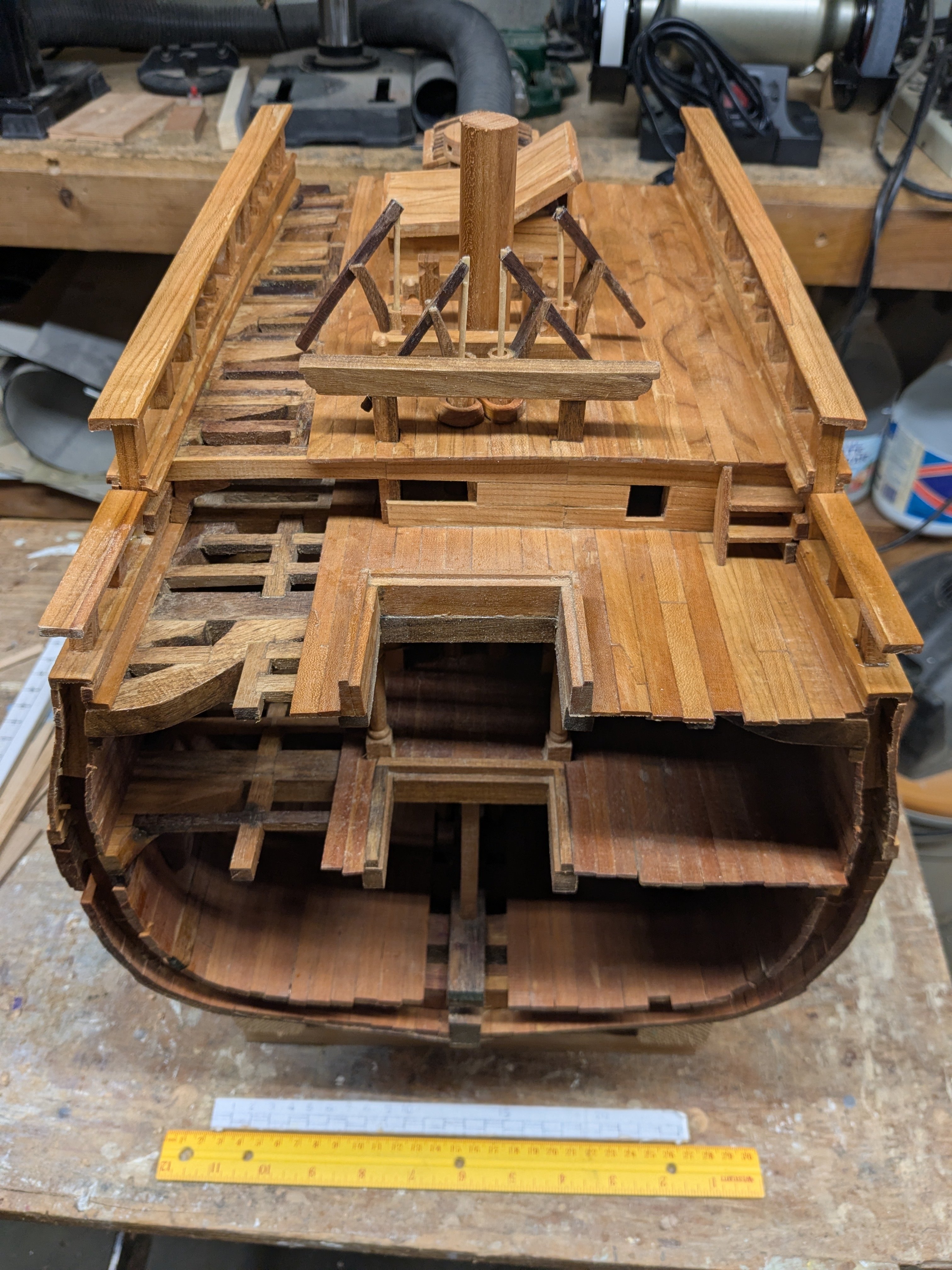

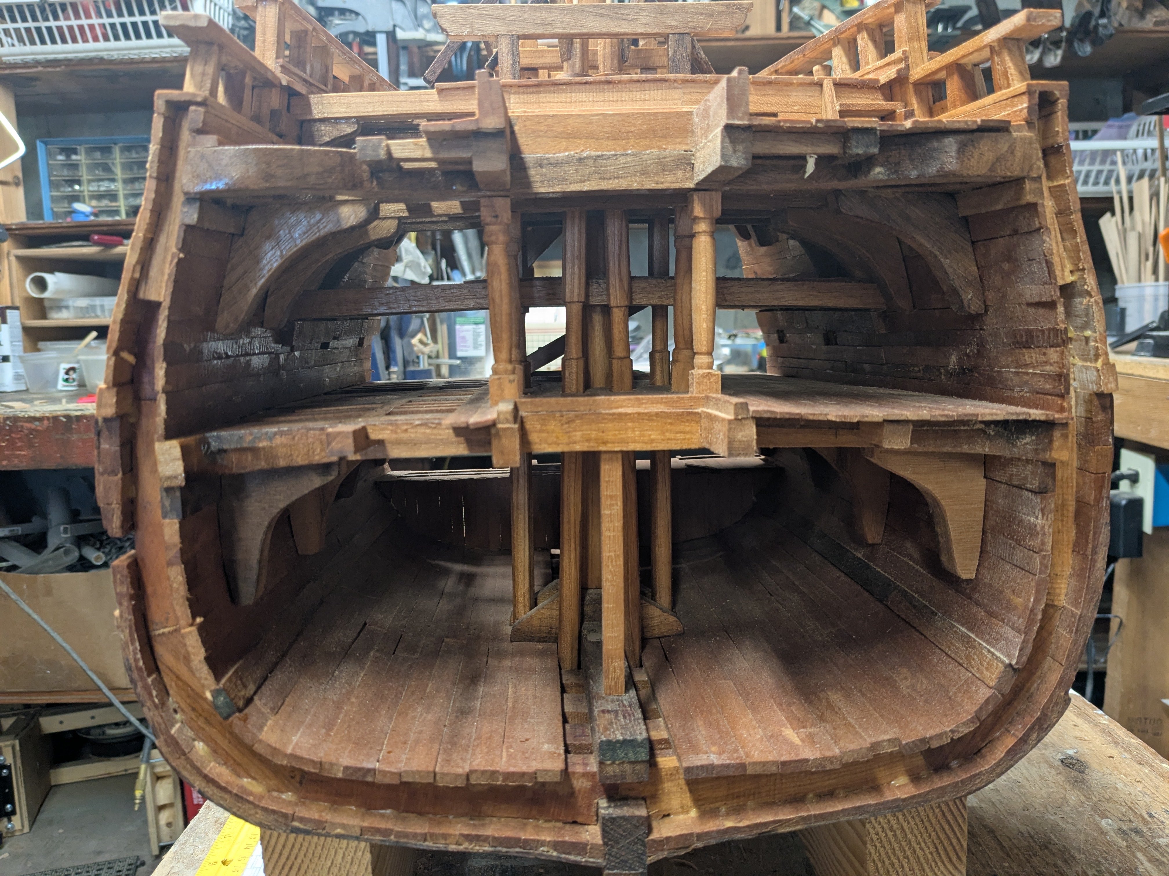

Cross-section of HMB Endeavour - lower deck beams, carlins, knees and stringers done. Looking aft. Planking will be omitted on the starboard side. Second view under the lower deck shows the main mast step and fish room wall below the steward's platform.
  • 4 months later...
Nice work and good to see a different view of the Endeavour and her internal structure and at a larger scale. Keep up the excellent work and I look forward to your future progress.

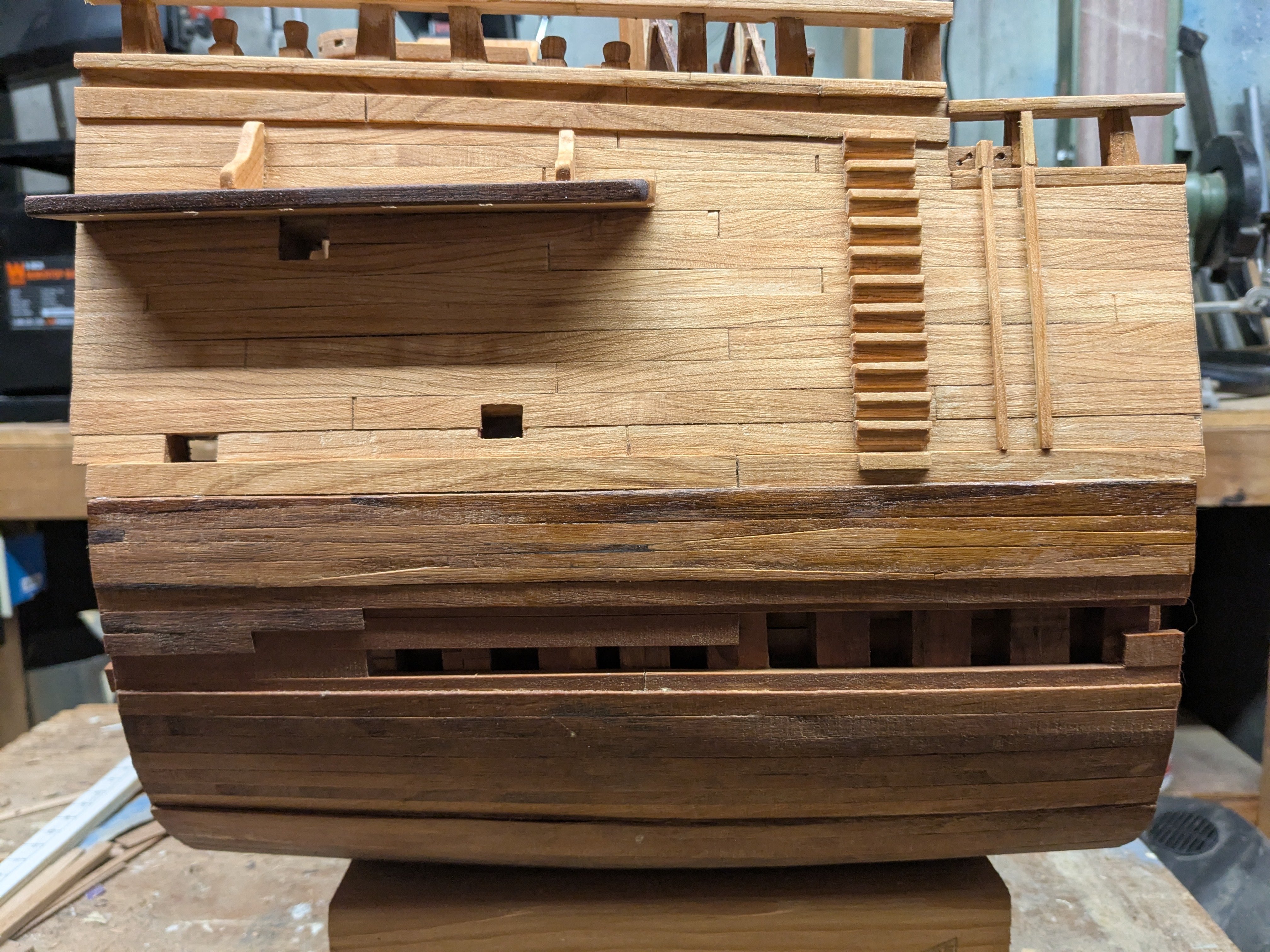

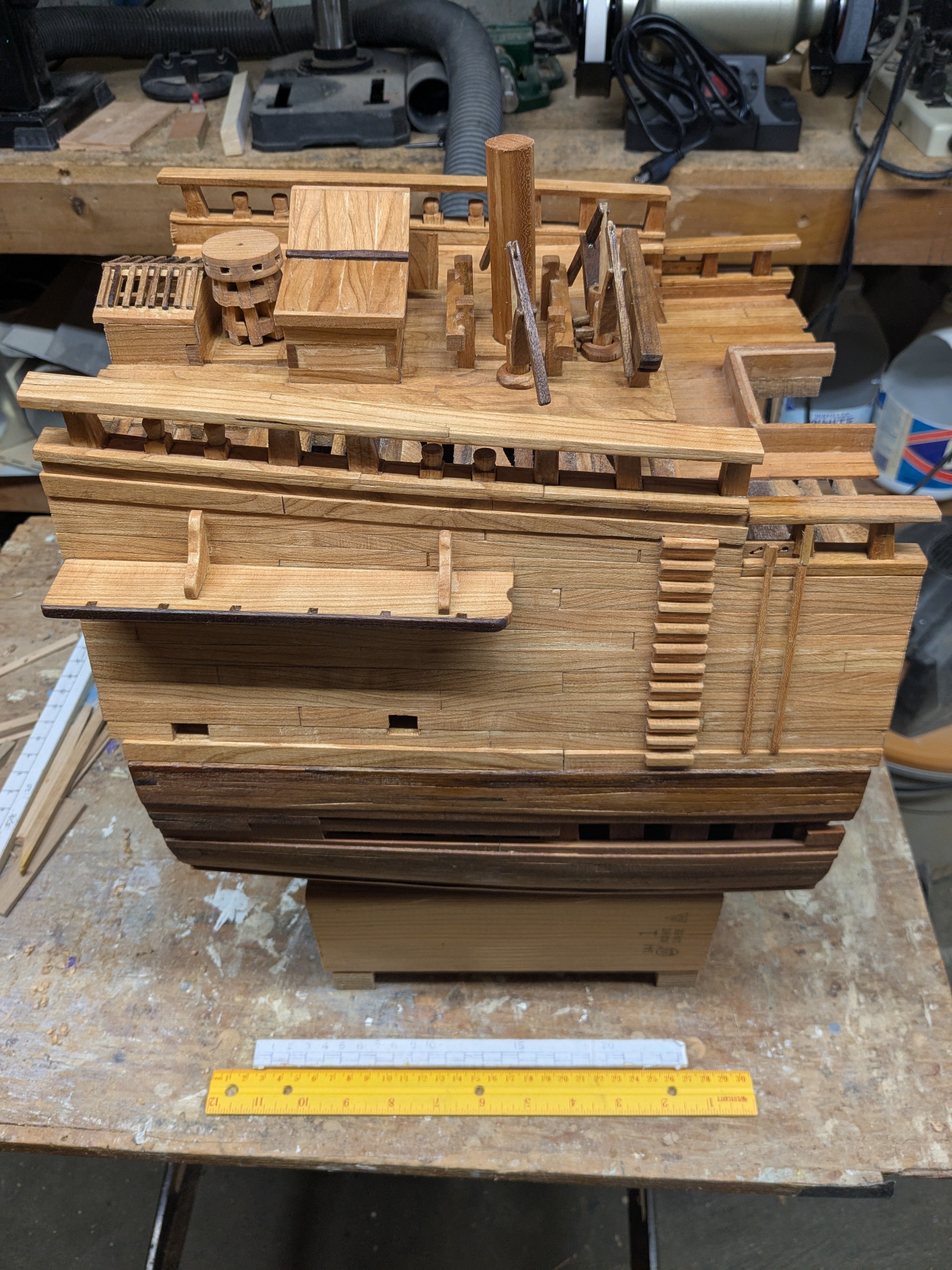

Here is an update of my cross-section of HMB Endeavour, finally finished in 2025. Many mistakes, recoveries, and compromises, but trying to follow Marquadt's drawings for the most part and regret not having his book at the beginning.
The model is now at the BC Maritime Museum in Victoria, British Columbia, though it will not likely be viewable by the public until the museum gets new larger quarters.
