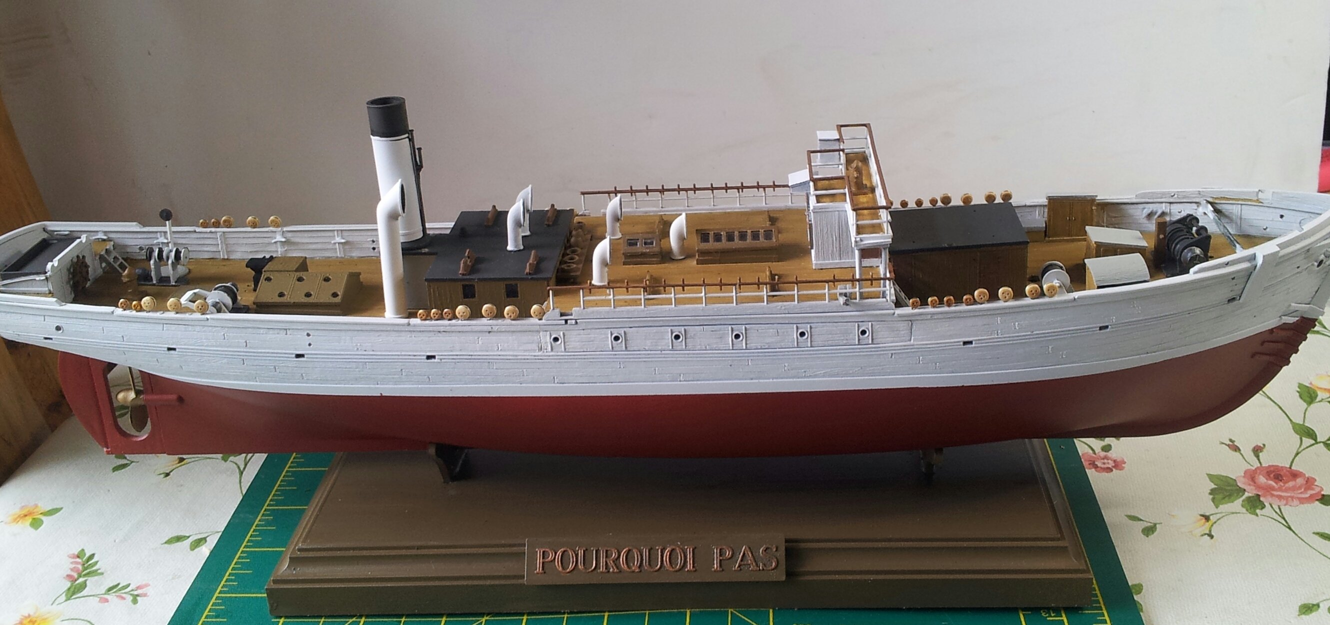

Thanks for the likes and comments - always appreciated. Work continues on painting and adding deck furniture and glazing added to deckhouses/ wheelhouse. Also below the waterline has had the red paint added- used Tamiya dull red from a spray can (note how the red paint doesn't completely cover the metal protective hull plating).

Thanks for looking in- a little more progress with the painting and deck fittings along with the decorative board behind the bridge deckhouse. Also the decks have had an extra couple of washes using humbrol matt 26 khaki.
soon will have to start thinking about deadeyes and chainplates.

Thanks for looking in- after putting it off for ages i tackled the deadeyes- used thin tinned copper wire wrapped and twisted then trimmed off and gel c/a glue was used to glue them into the holes for the plastic kit supplied deadeye assemblies. The 3mm ones were o.k. but oh boy them 2mm deadeyes are soooo small!
i will add the chainplates once the angle of the shrouds / backstays has been worked out.
