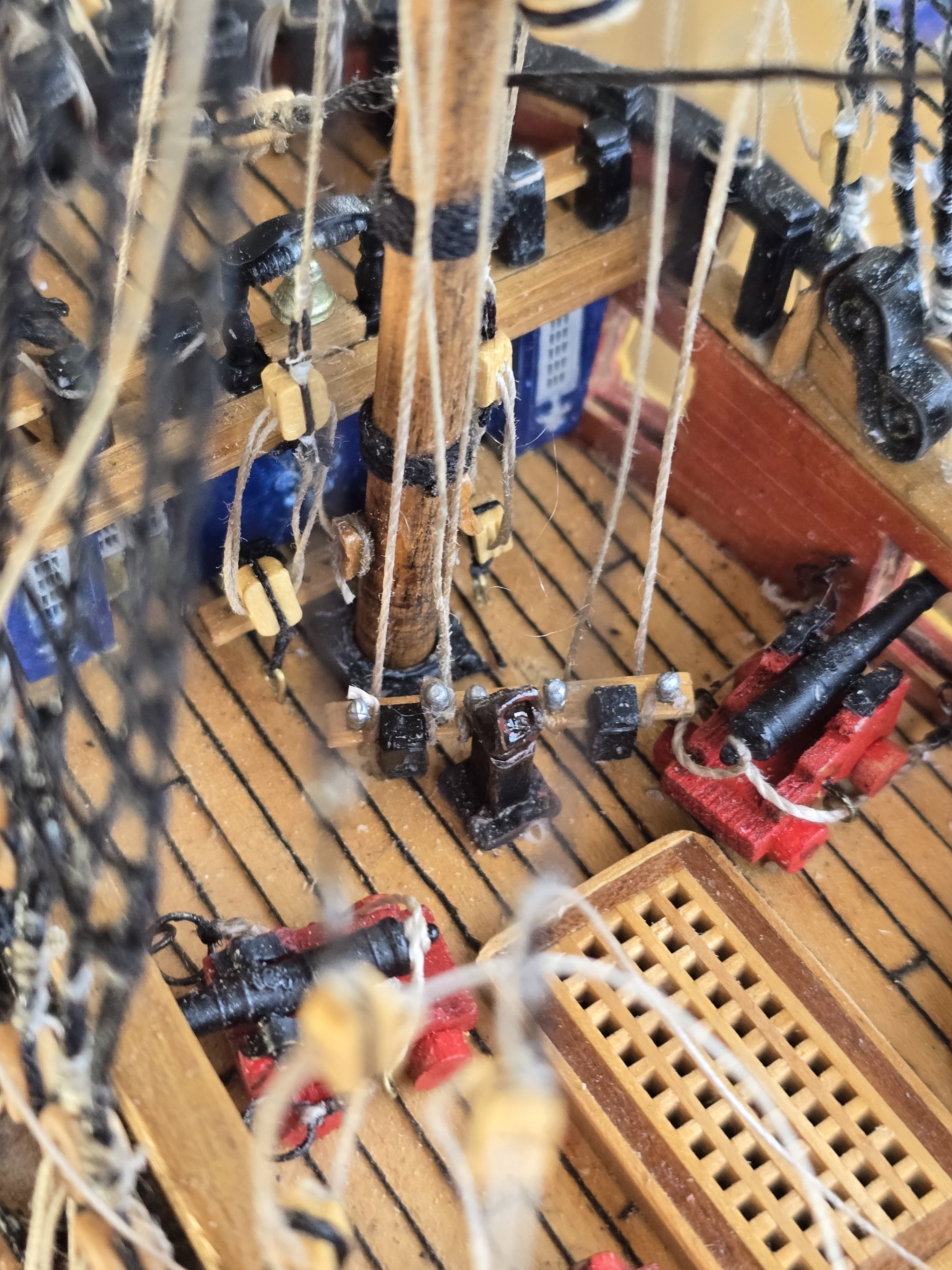

Now i have the fore yard no i am going to start belay pinning down at the base of the mast... again quite a lot of tricky stuff to wind around the belaying pins down there..  might have to cheat and just spot glue it and then put a coil of rope over the rope.

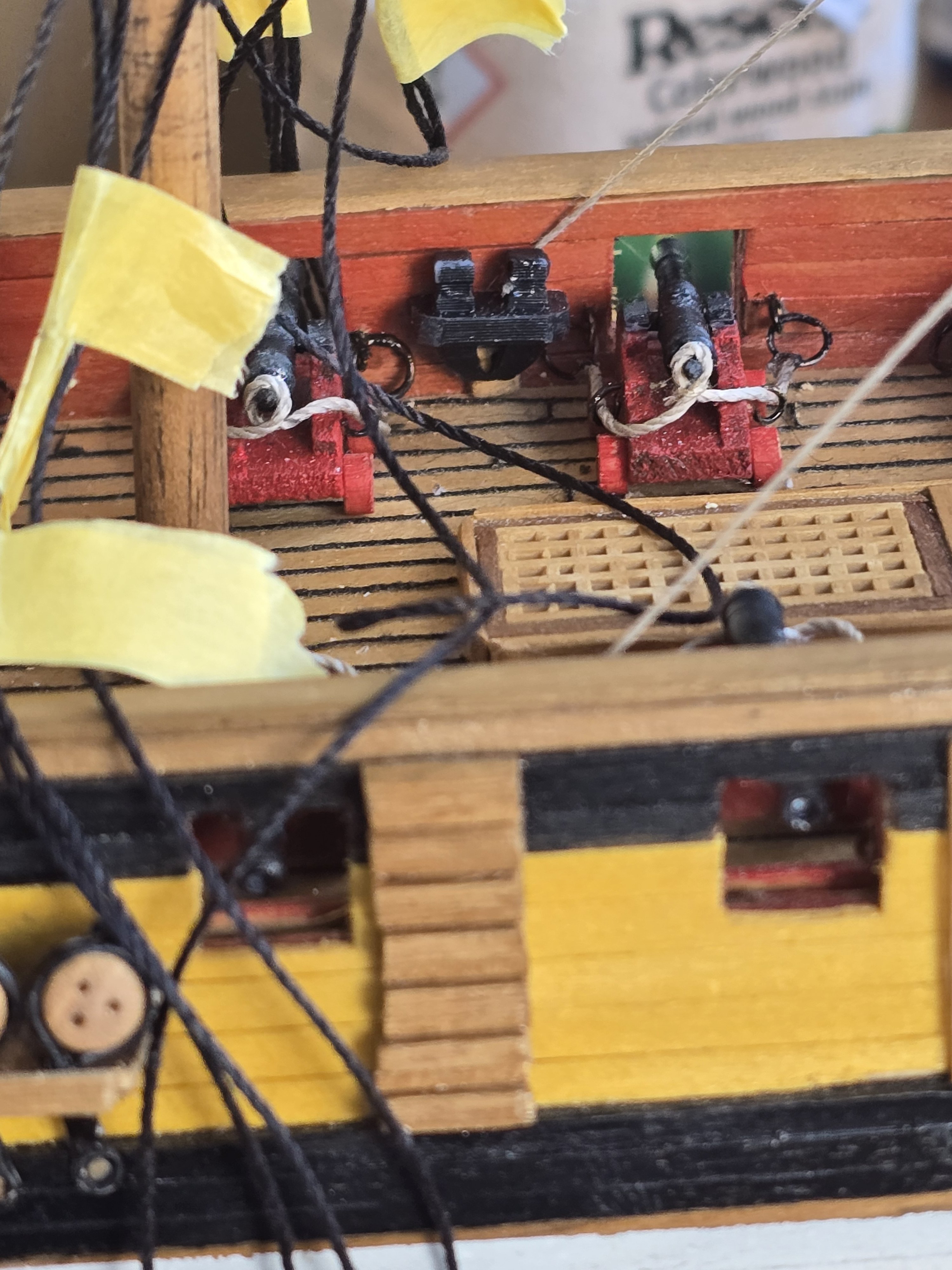

I might be doing this all wrong but ive tidied up alot of the line down at the fore bitts.. my belaying plan is not following any sort of accuracy, im playing with what the kit gave me in terms of instructions. The only thing i am doing is rigging the fore lift near to the edge of the ship on long blocks as per lees book but in the paterrson book it goes to a block on the fore channel. Once again if i had more space i could do that. I put the block on the rail instead.
I will be putting coils of rope over each belaying pin so probably wont see them
I didnt tie the truss pendent correctly but just glued the lines on approximately and also rigged the nave line and belayed it on the fore bitt.

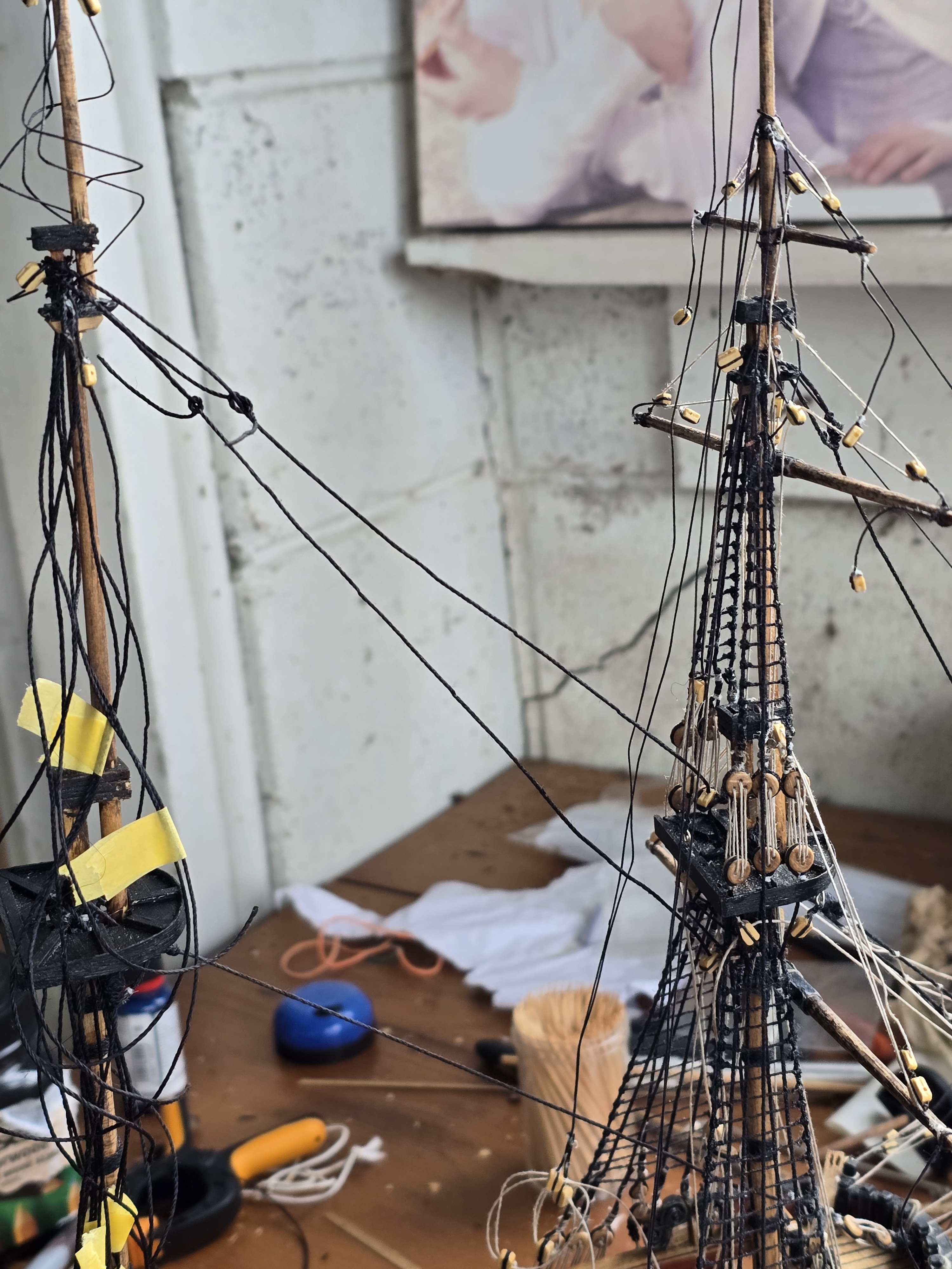

I hve rigged up the fore topsail tie and the fore topsail lift. Its getting  lot of rope up there and a bit messt but i have all the inportant ropes in there. Cant imagine doing a sailing rig on  1/100 scale boat... too many ropes.

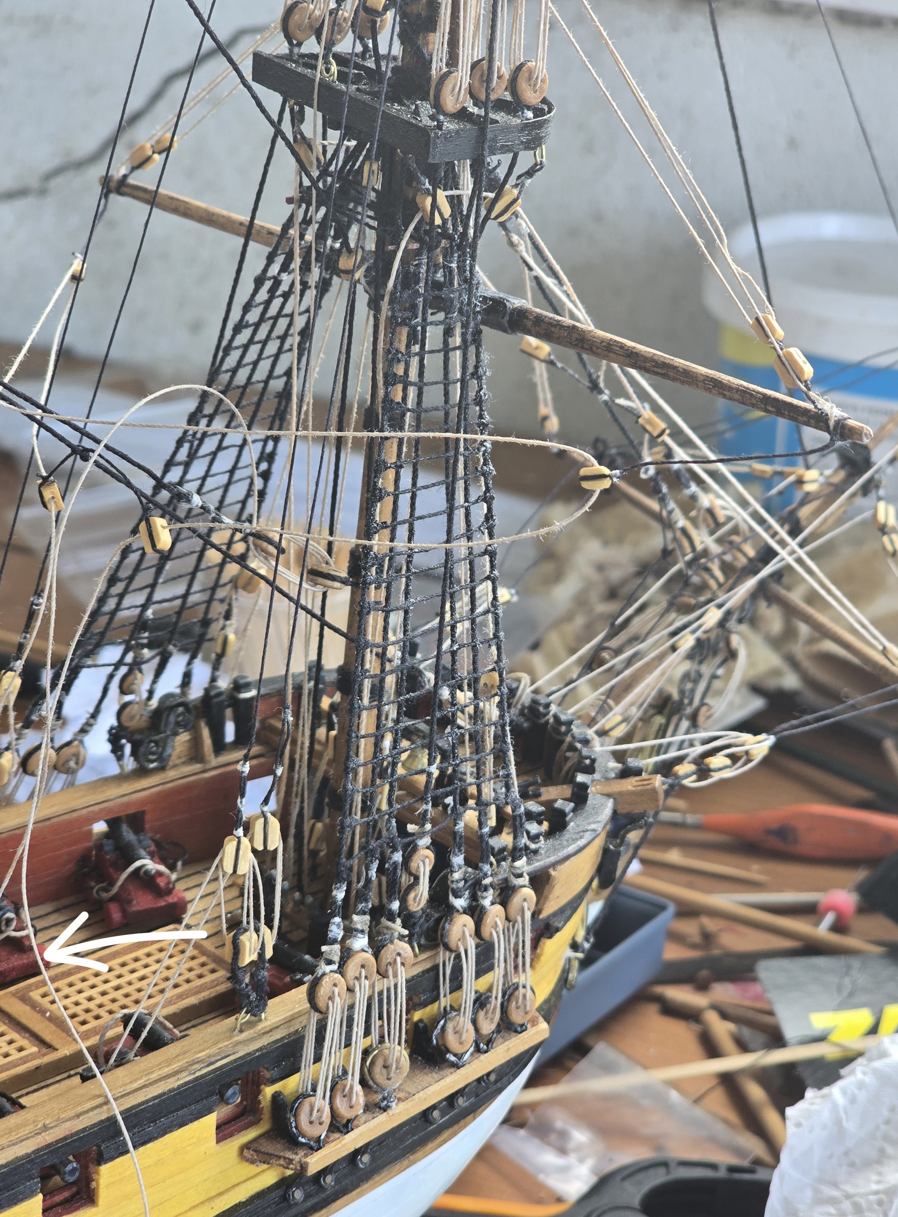

Um... help.. what do you do to fix this?all my shroud loops are on the mast. It looks aweful with one deadeye up so far out of line.
I know i need to take it off but how do i do it as ive already cut the shroud to that size. Bloody hell!!
I managed to fix it by just cutting the binding cords and then ripping it off the block. But because it was too short i had to bind a extra bit on. It doesnt look that good but best i can do... im moving on as sooo much to do and loosing patience.

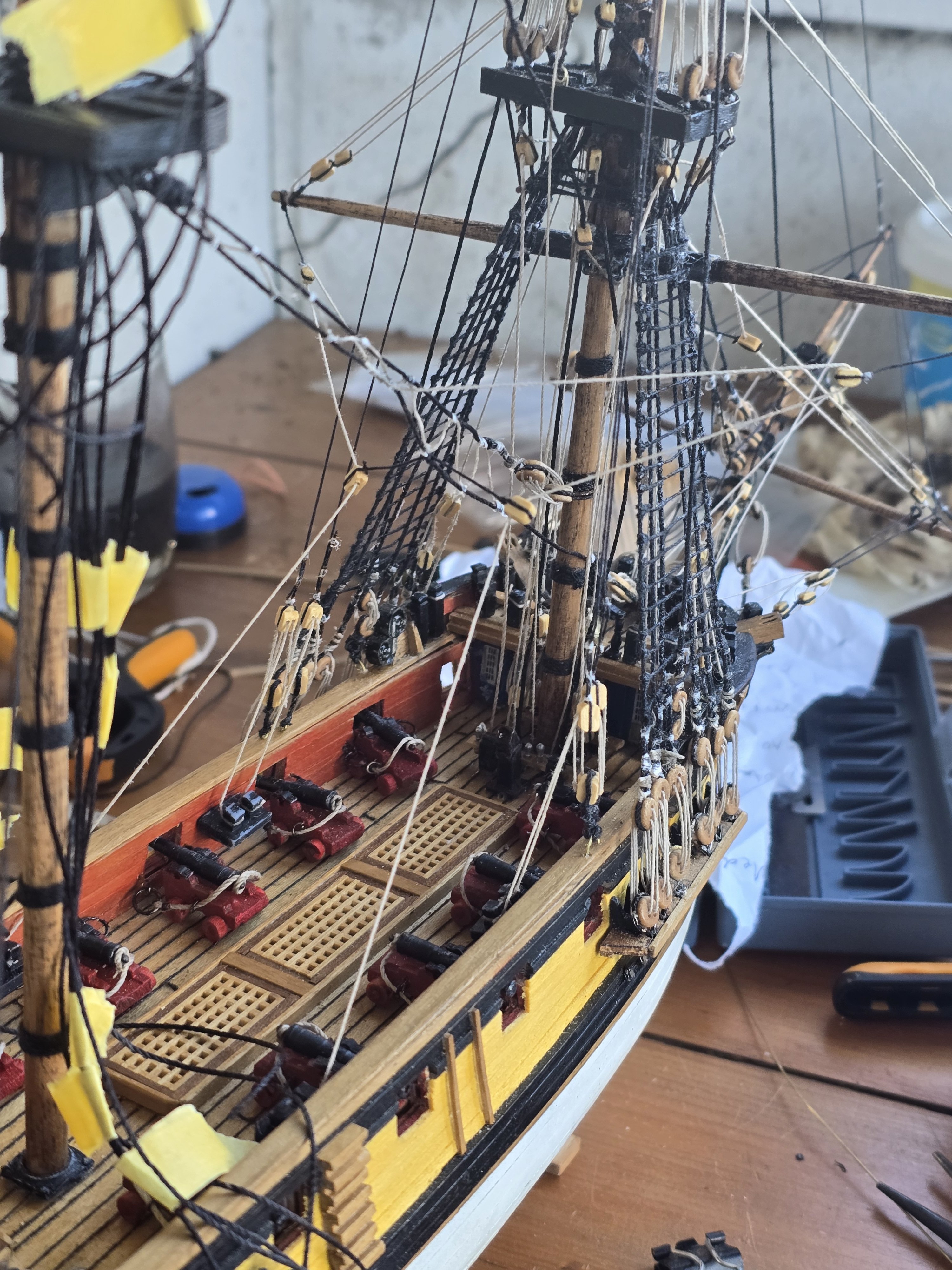

I put on the fore top gallant yard, the top gallant lifts and belayed onto a shroud cleat... small and so cute
Im basically done with the fore mast, except for the catharpins and all the rat lines... not sure what is going to easier doing them first or last

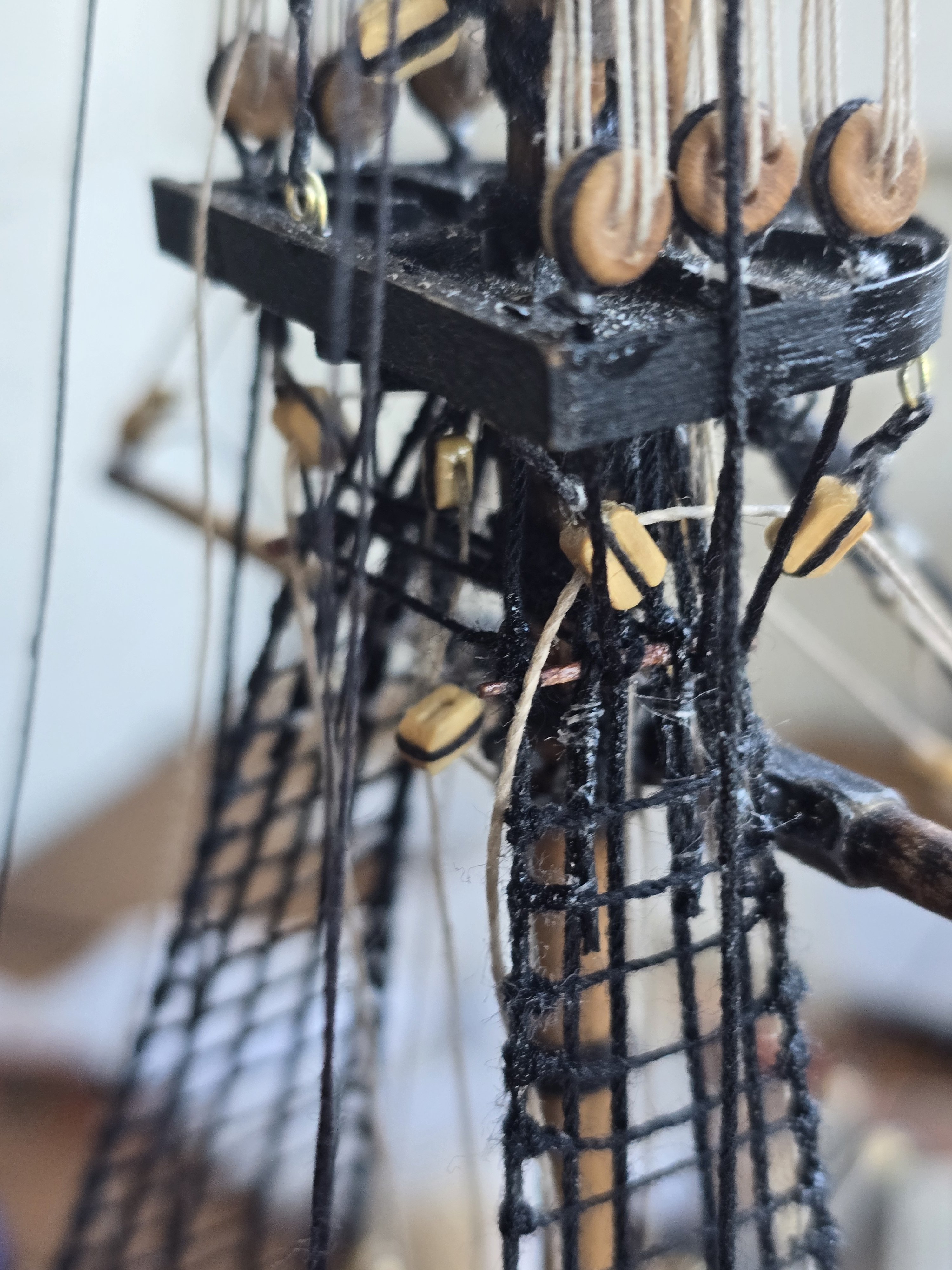

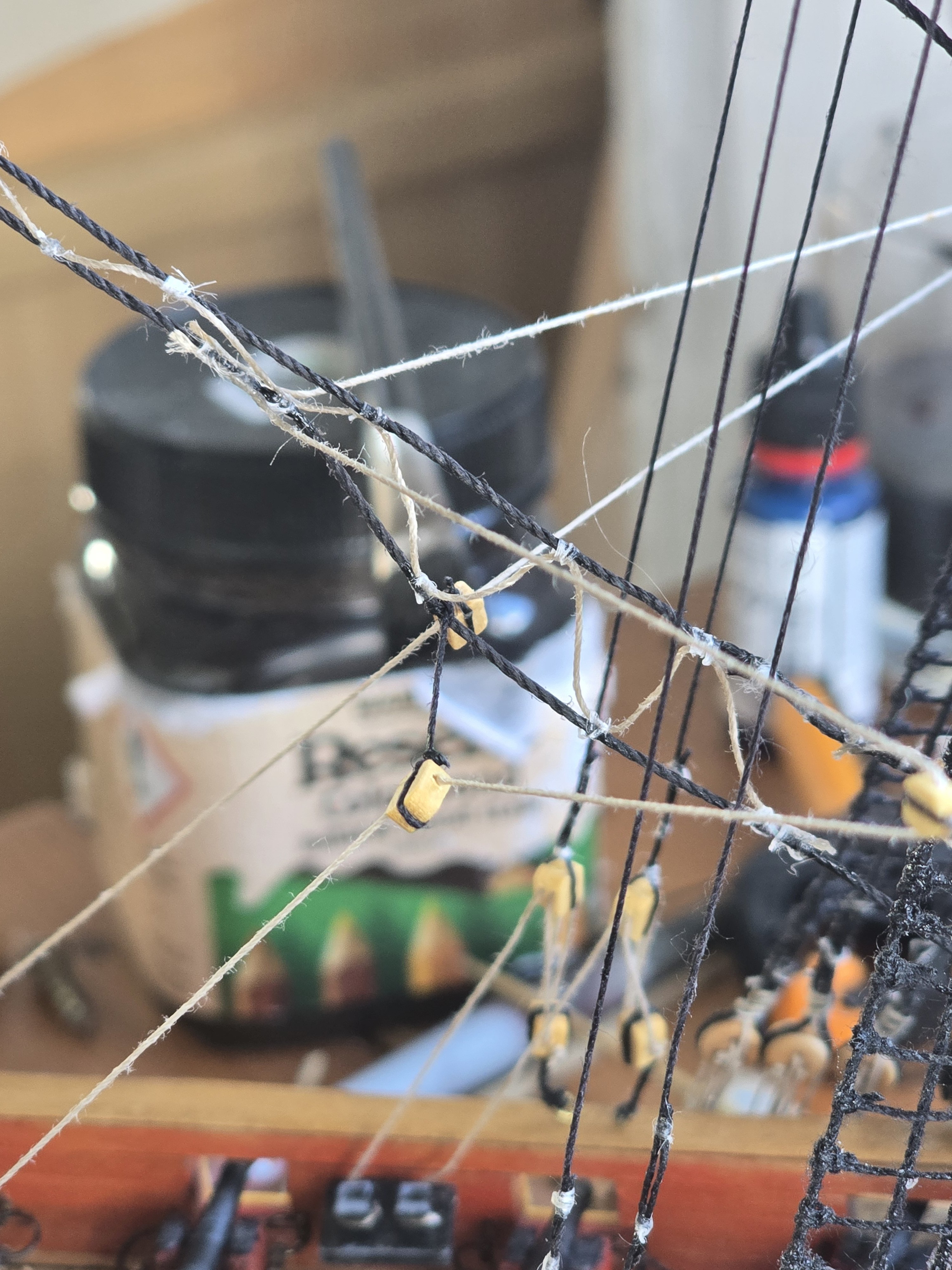

Ive done the port side ratlines using the method recommended for scales 1/100 which is not to tie each ratlone on each shroud but juat glue them on with ca. I seized one end of the ratline to the outmost shroud then using the guide reverse seized it to the other shroud and pulled it tight. I know some people like to have the ratlines sag in the middle but im happy with the straight look i achieved.
I also added the foremast carpathians for the 1720 period which is seized to one shroud and zig zag across to the outmost shroud. Fiddly as buggery but i can see the light at the end of the tunnel for the foremast.

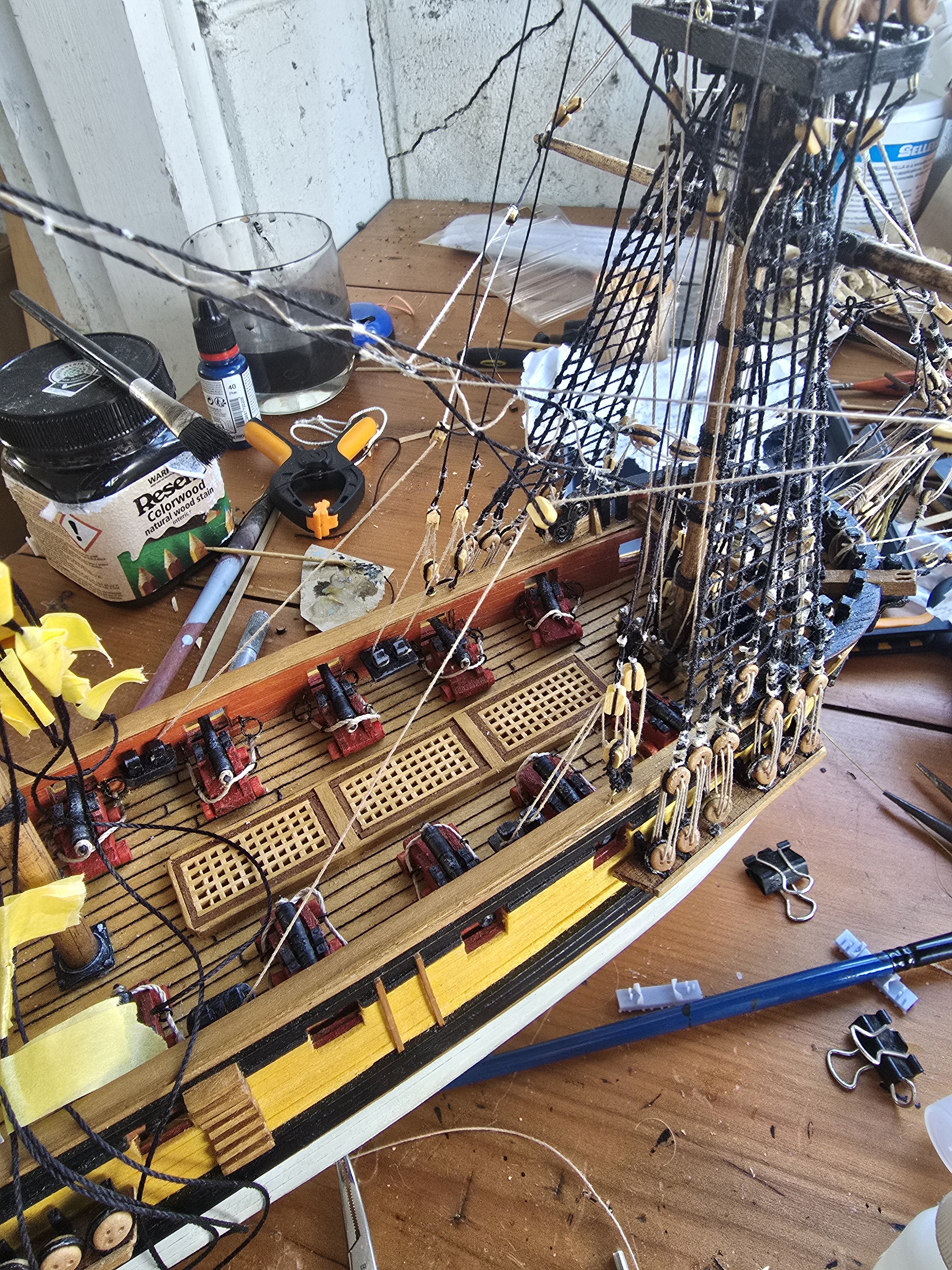

Ratlines on the starboard side and then start seizing the shroud pairs onto the main mast.
Its very difficulylt to get a good photo but i think im pretty much done on the foremast... only two masts to go.

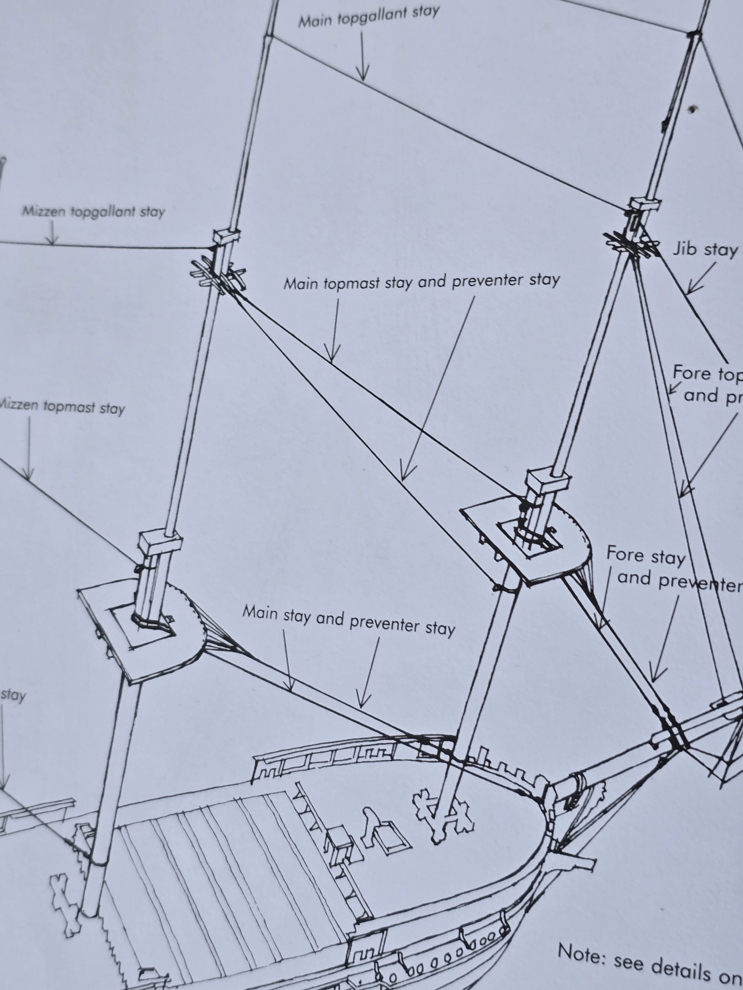

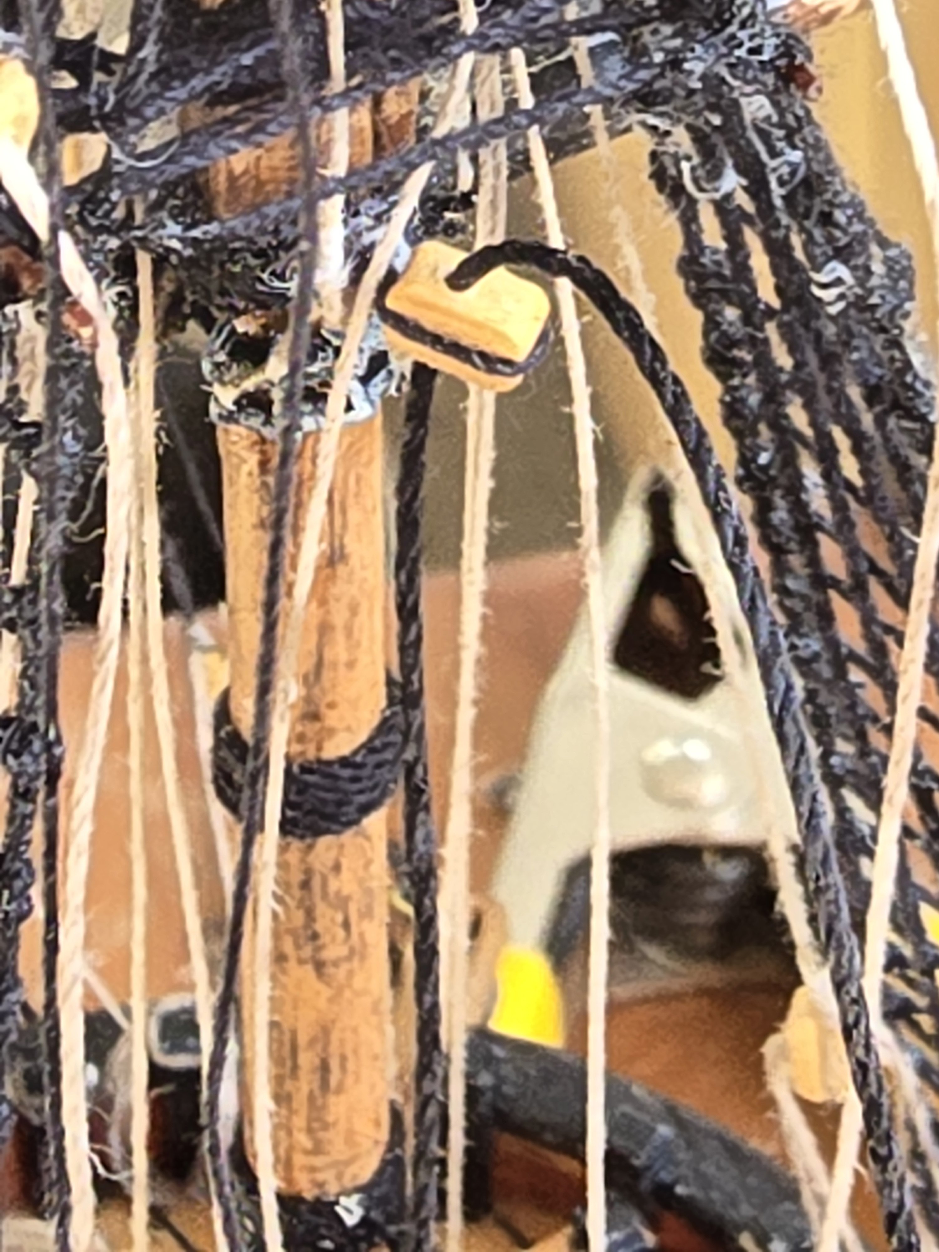

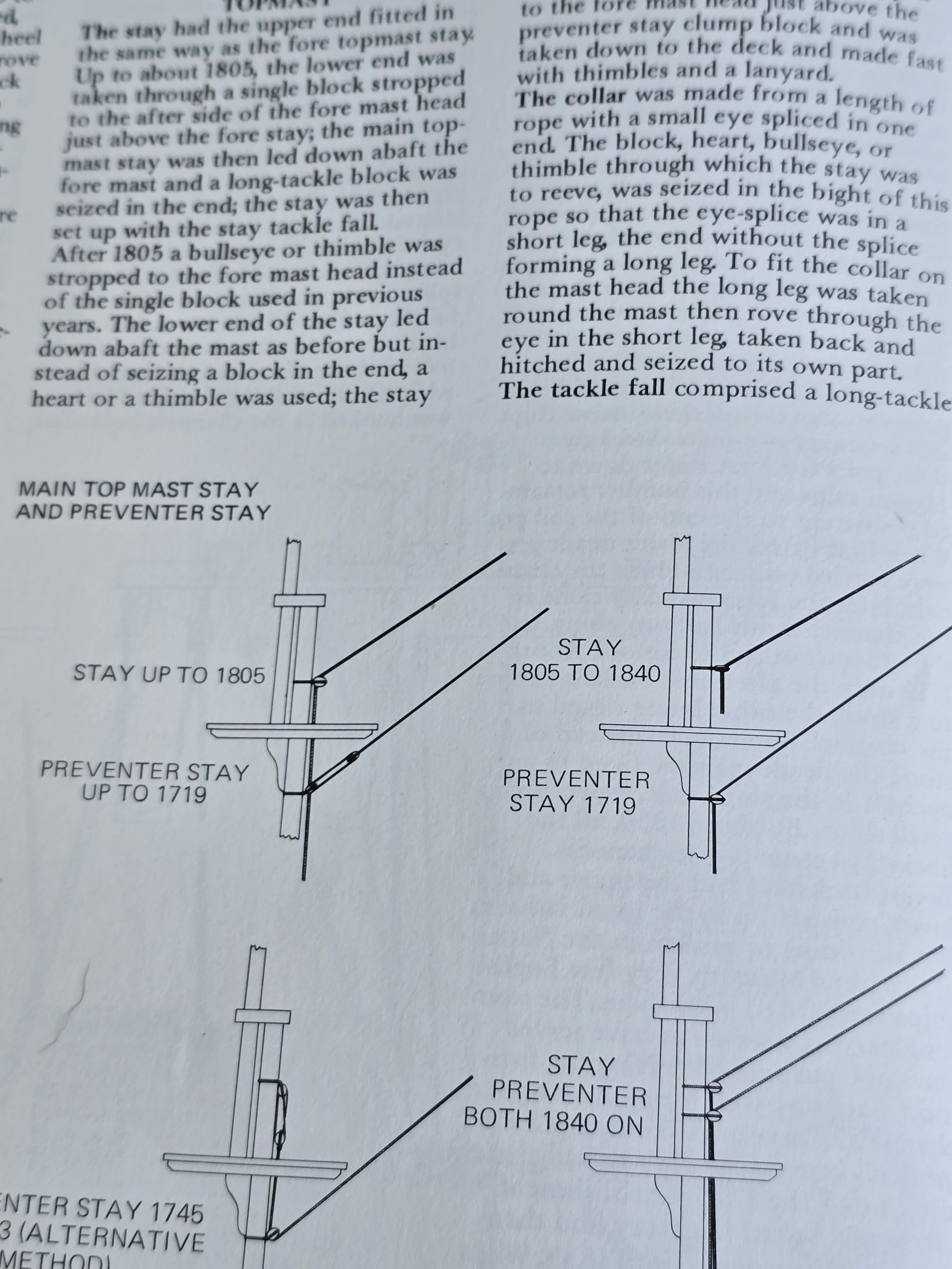

Im wondering about the positioning of this block just under the catharpins... according to the petersson book the main topmast preventer stay goes through this block and there is a main top mast stay as well?
Ive looked in the lees book and it suggests a dead eye for the preventer upto 1719 while the stay is a block to the deck...
Why is the order of the preventer and stay reversed ?
Edited by Srenner
Add picture
I'm not sure why it would matter.. The preventer stay is just a back up, however , Petersson may have got it wrong, or the model of Melampus  may be wrong.
If it matters, I would go with Lees.

At this scale the rigging gets very crowded indeed - I followed Lees for the entire rig of my version of this kit - it was a challenge to get everything just so, but Lees facilitates things through his period-based breakdown of rigging practice by period and rate. From what I've read here, Lees is a very good standard to work to.
I also have no idea what the logic was behind the reversal of the preventer and stay in this case - but as we see all the time, questioning people who've spent their lifetimes learning about specific things is a good way to get things wrong, while following them is a good way of learning how to do things right.

I fixed the main top mast stay and preventer stay... it wasnt easy i had to rip out the fore bitts and drill small holes for the two eye bolts and then thread the stays through the blocks and glue the bitts back on
My heart rate was up though out this tricky bit as wasnt sure i could glue the bitt back on but its on.

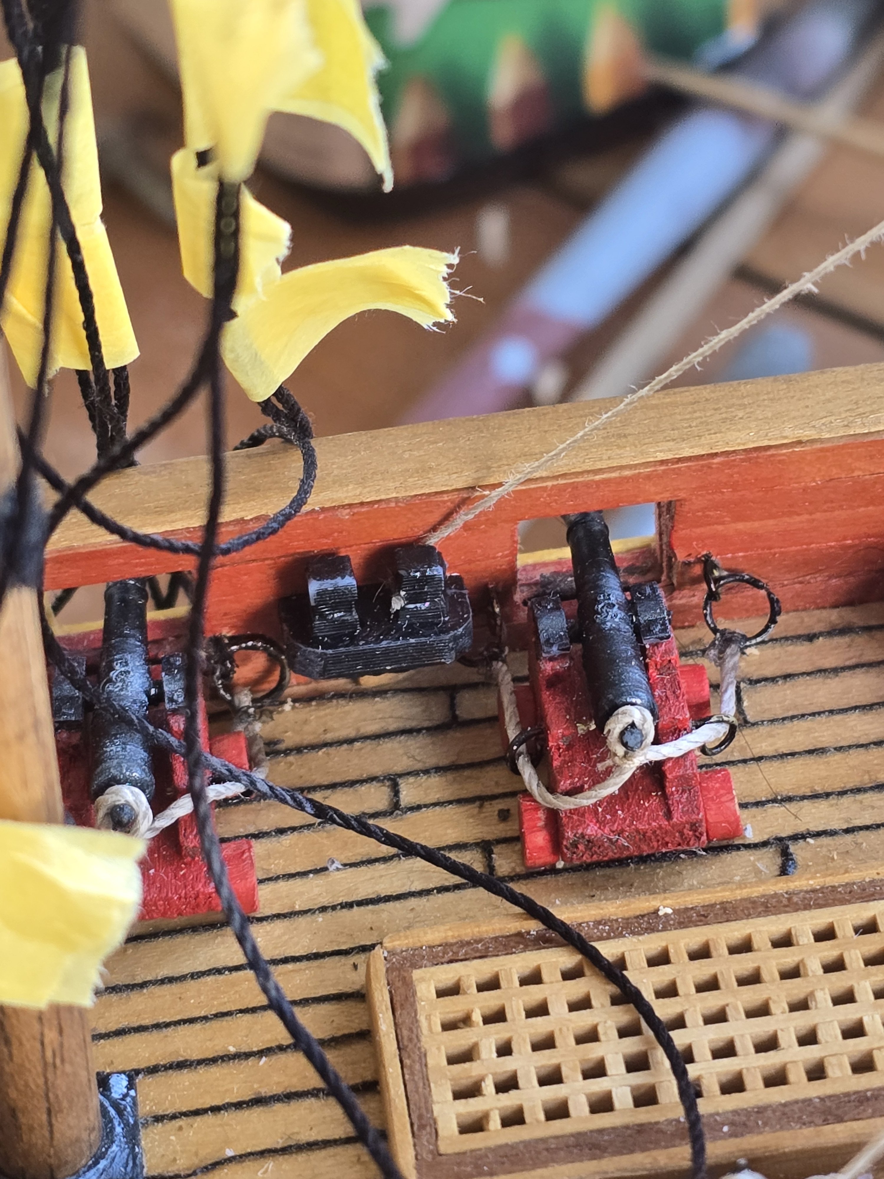

Hi.. another question for this model, where do you belay the rope for the fore yard brace to? I cant find a diagram in any book that says definitely where the rope belays in 1720.. its a bit vague.
In the absence of reslly knowing where to belay the ropes.. i put them midships on kevel blocks near the deck.
In one book they go forward to knight's heads on the forecastle but on this model that looks weird.
Im going to do similar for the fore topsail braces but to a kevel block up nearer the bow and also the fore top gallant braces.
