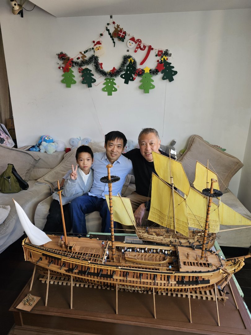

Here is a photo of Tom (blue shirt), his son Jimmy, and myself with his build of Le Renommee to date, and a lugger in the background.

Thanks for sharing that with us. Nice to see Tom with his finished project.
