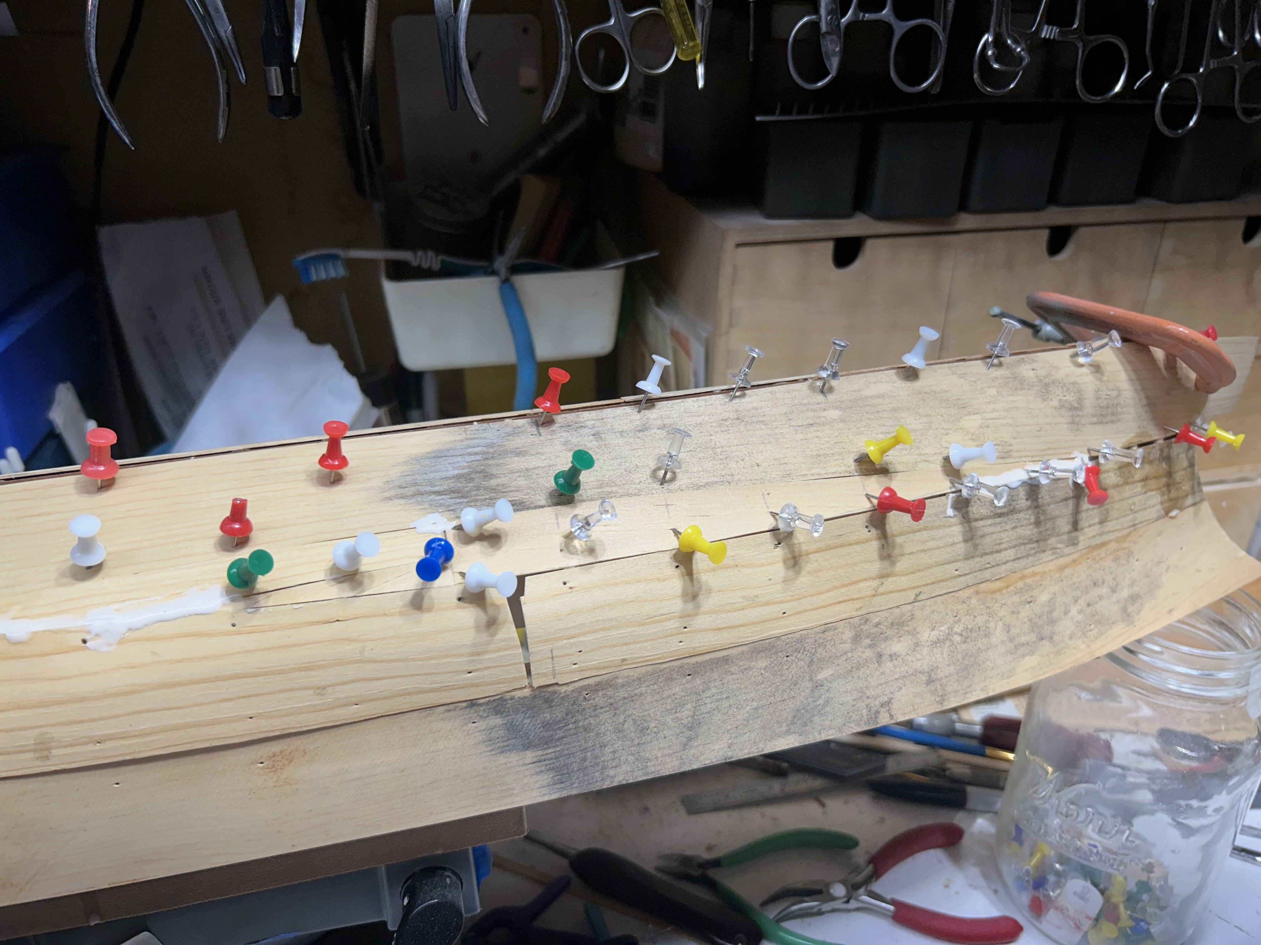

Well getting back on track.
I began the planking on the Staghound.
Before anyone starts to freak out…… remember,  I’m a hack model builder.  I rarely do thing the typical way.   As is my habit…..with Great Republic, Glory of the Seas, I use thin milled planks.  Similar to veneer.   I lay them along the contour, when all is dry, I sand, fill and paint.  Many sessions of filler will be employed I think.  Since some discrepancies are in the bulkheads.
First session.
Rob

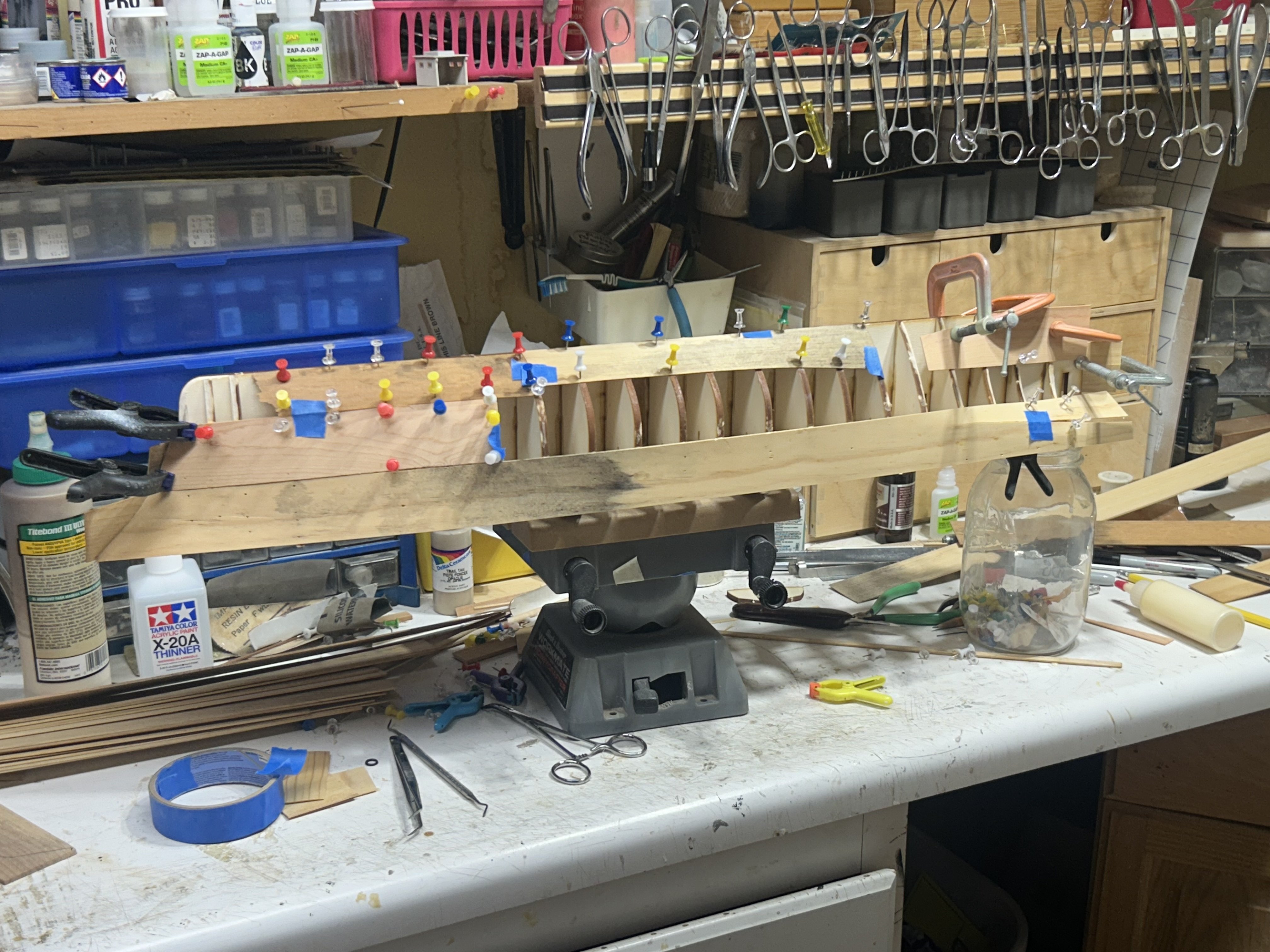

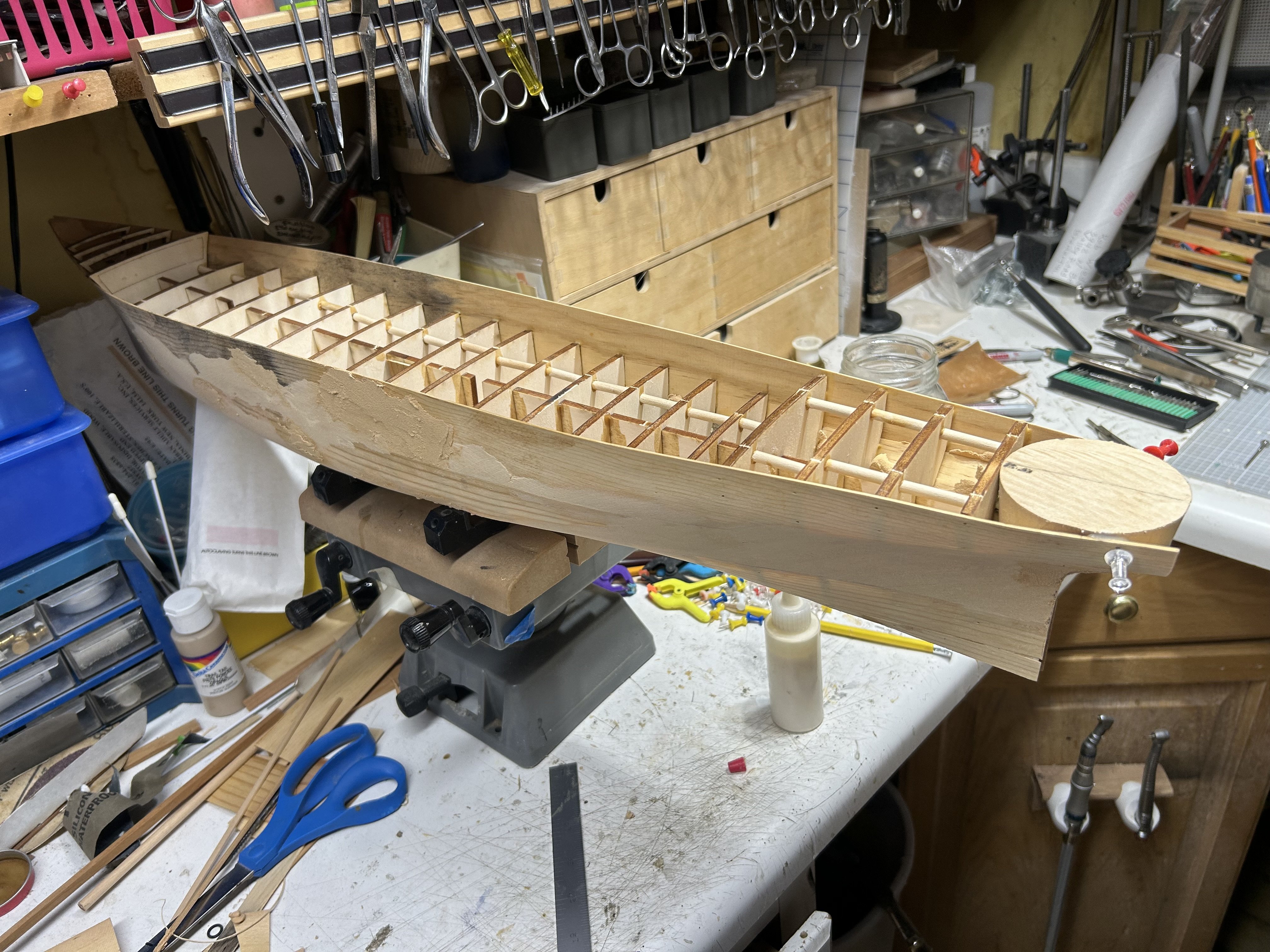

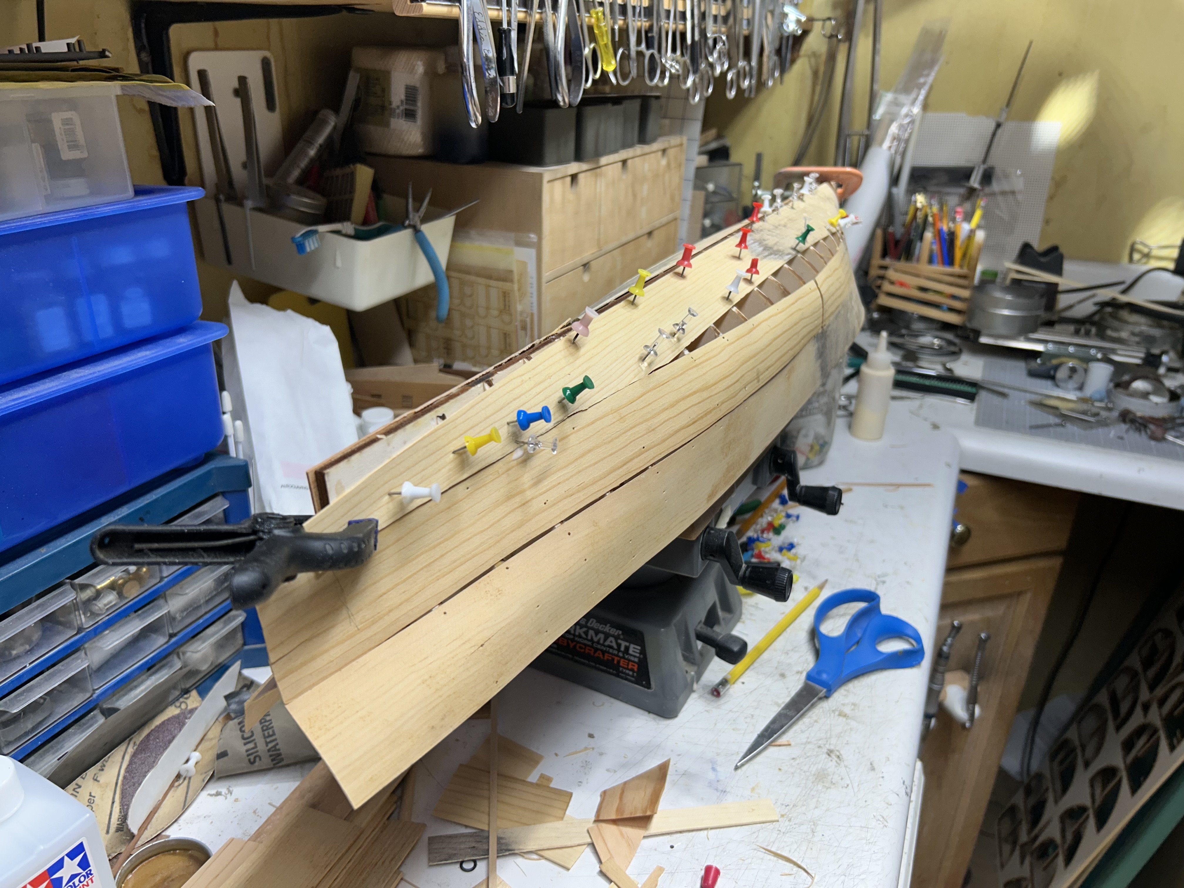

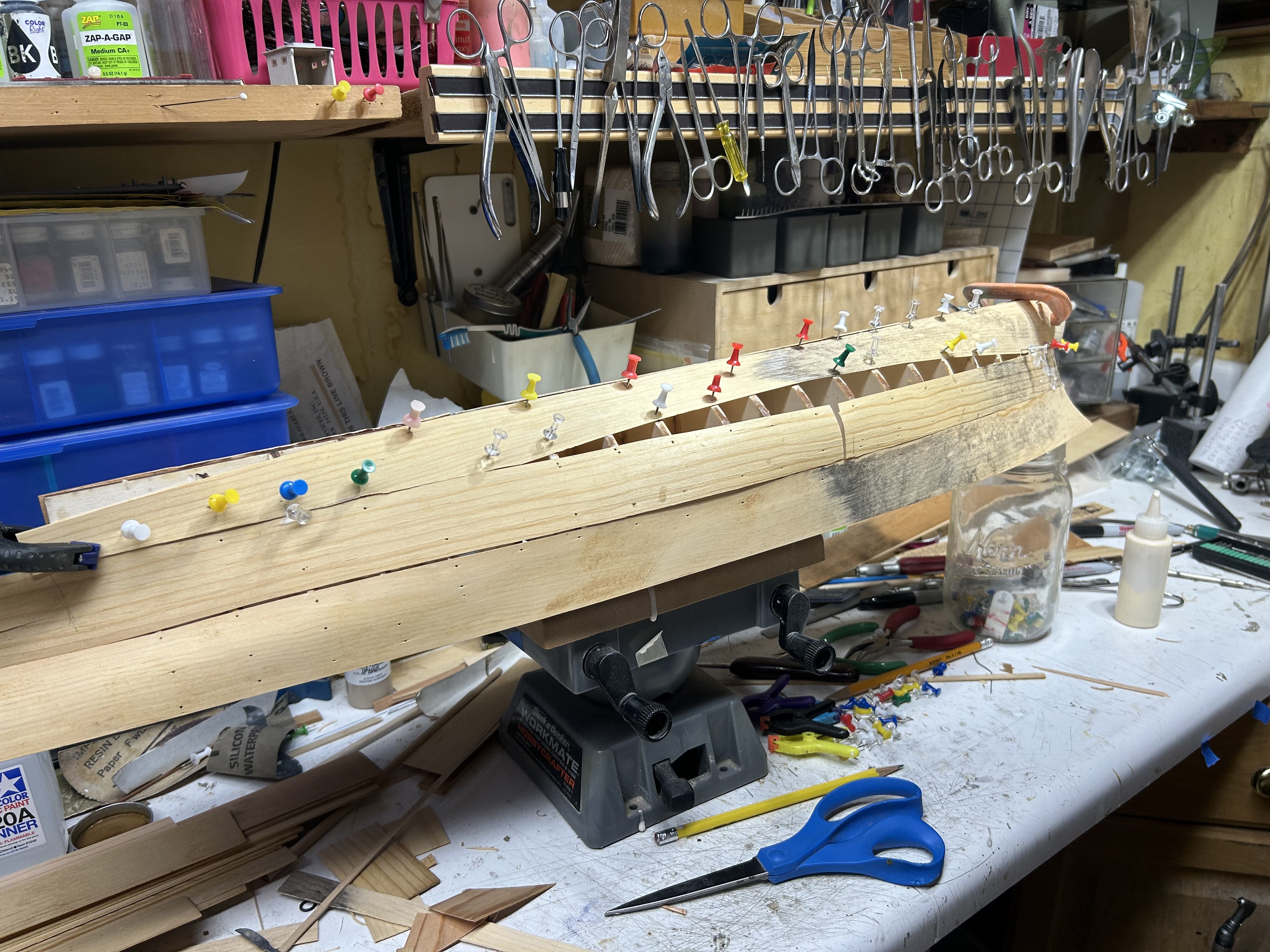

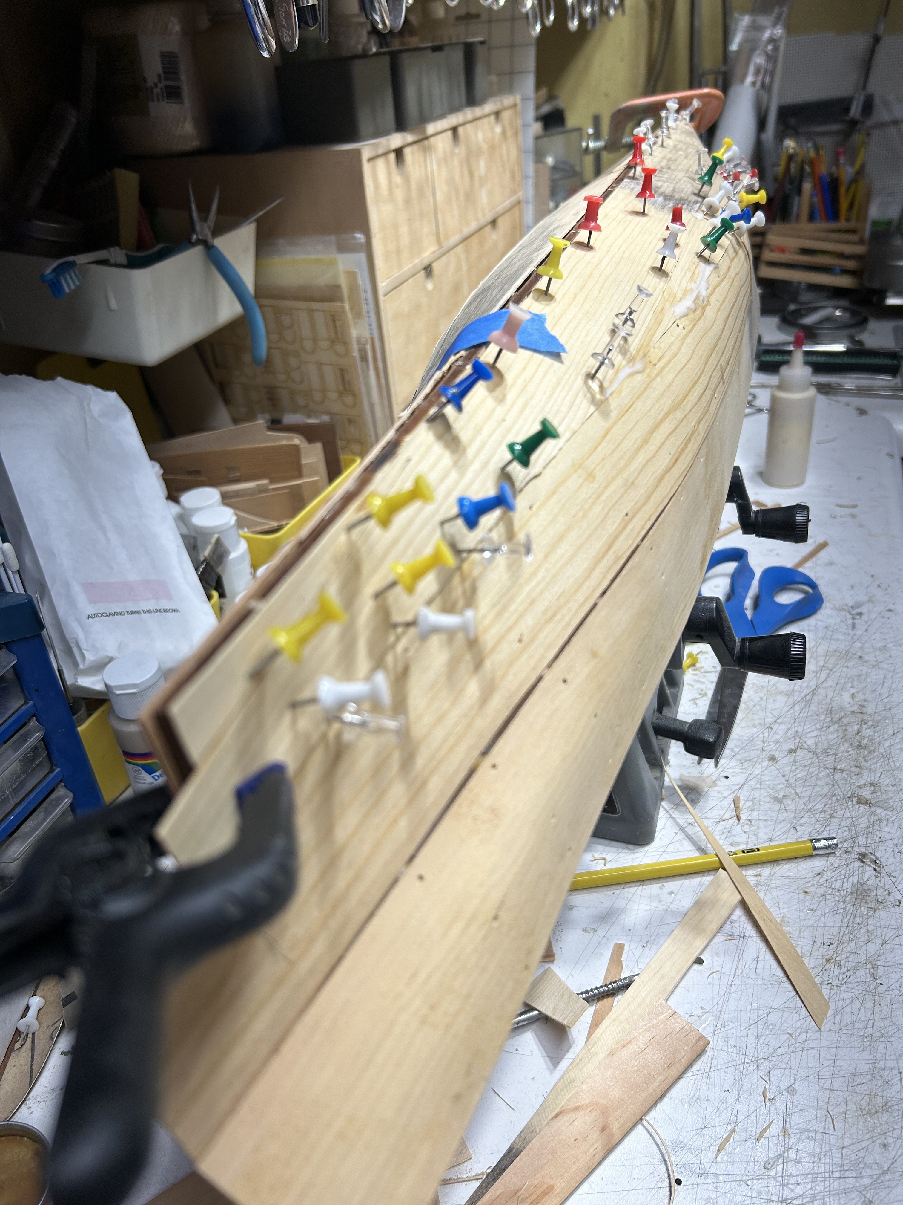

Slowly laying the planking.
Rob

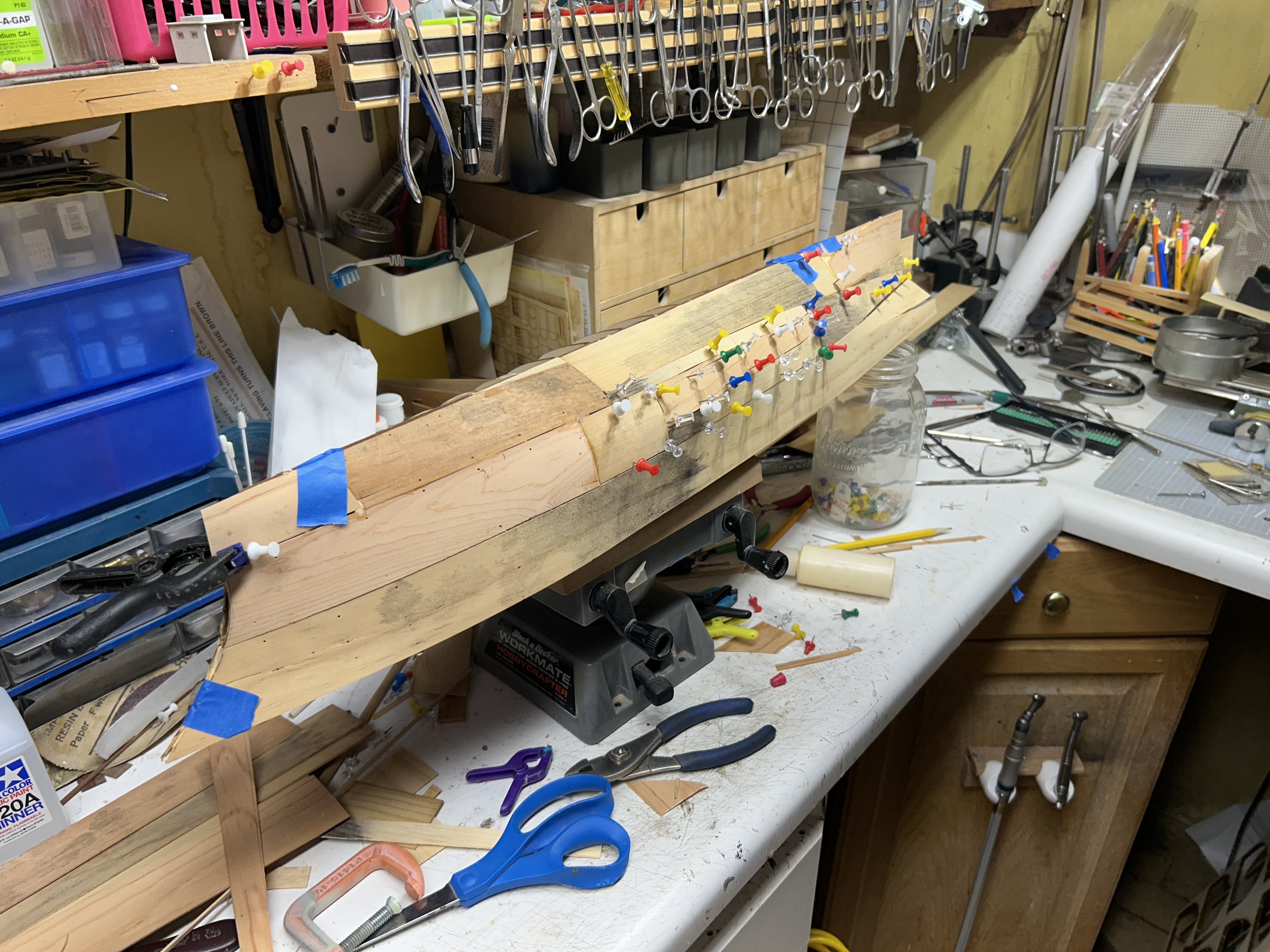

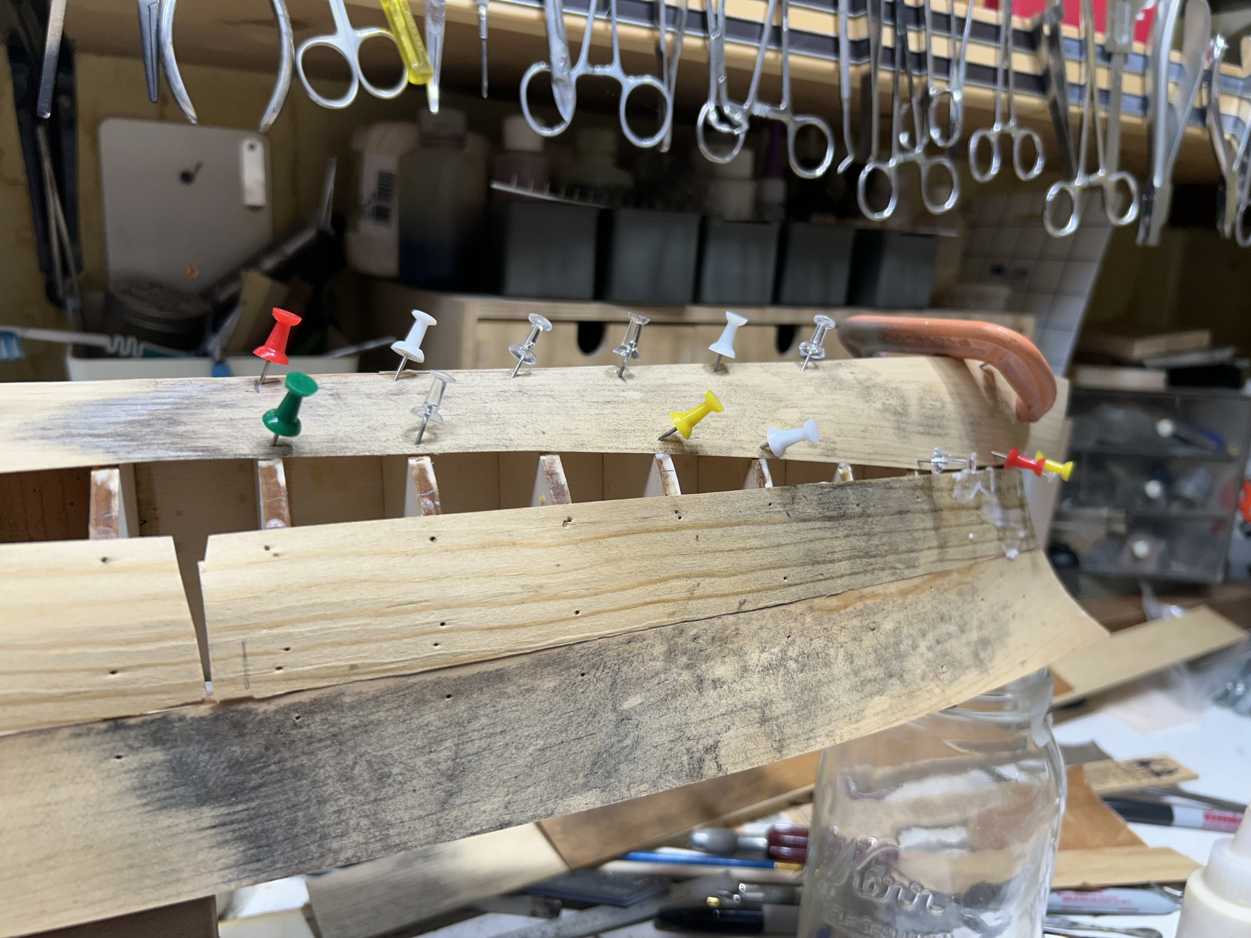

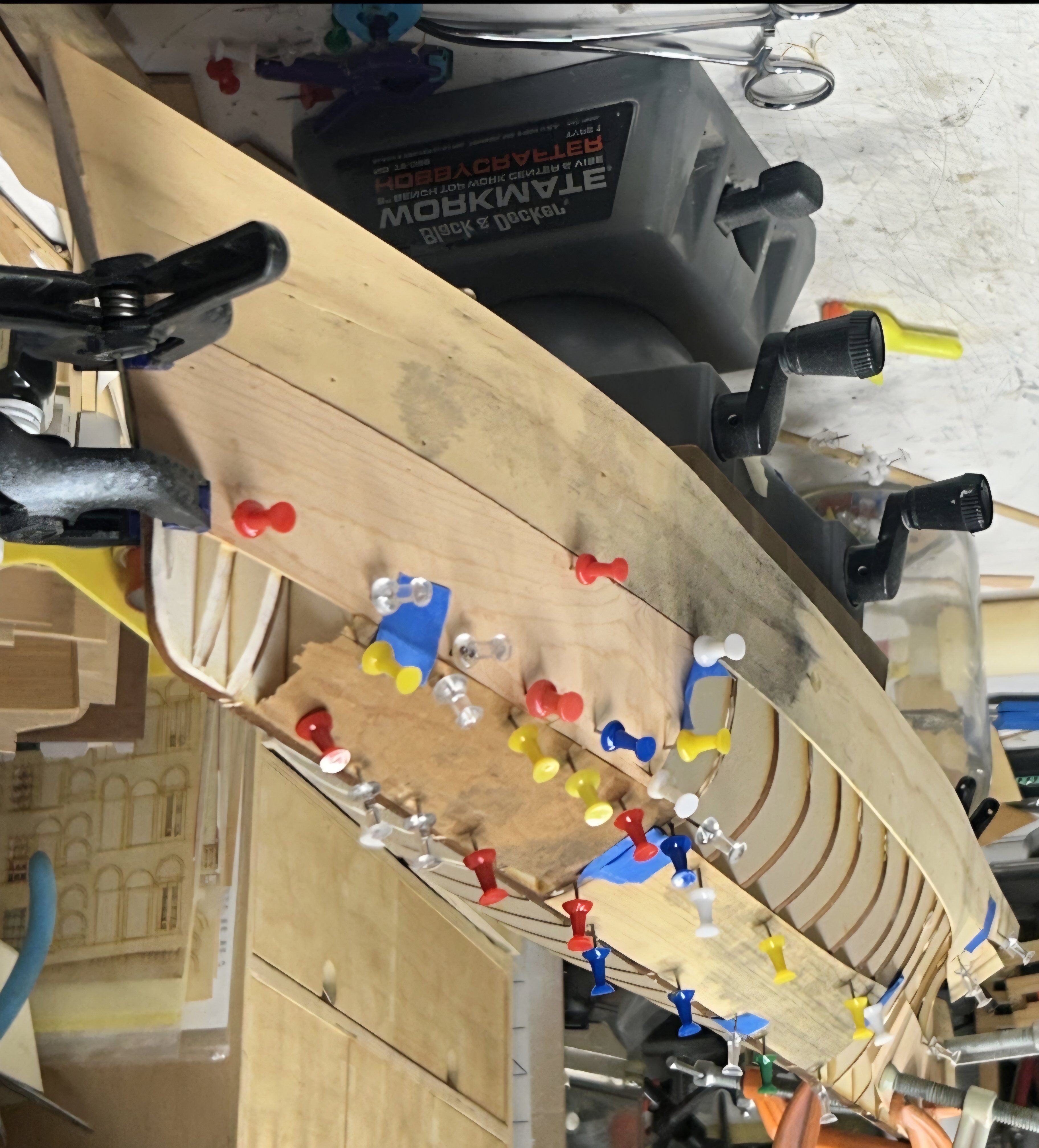

Slowly laying the planking……still. This is the port side.
Rob

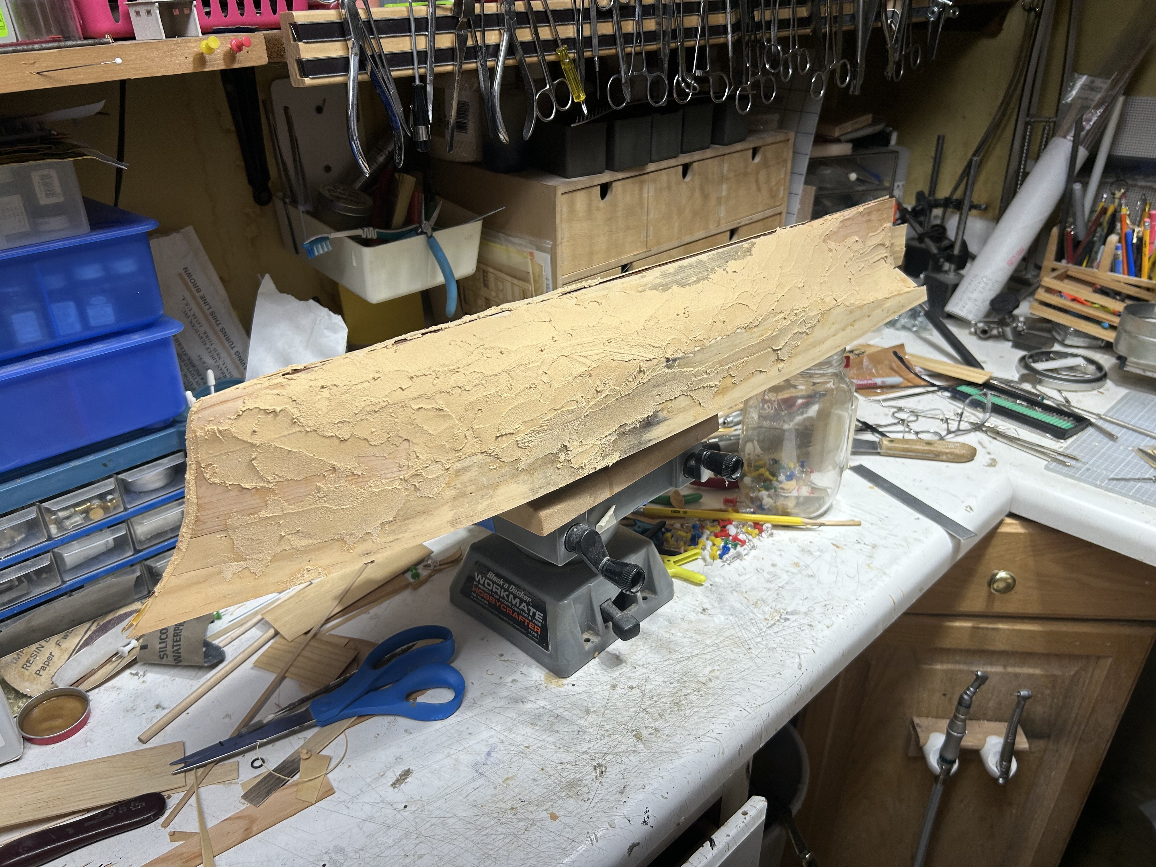

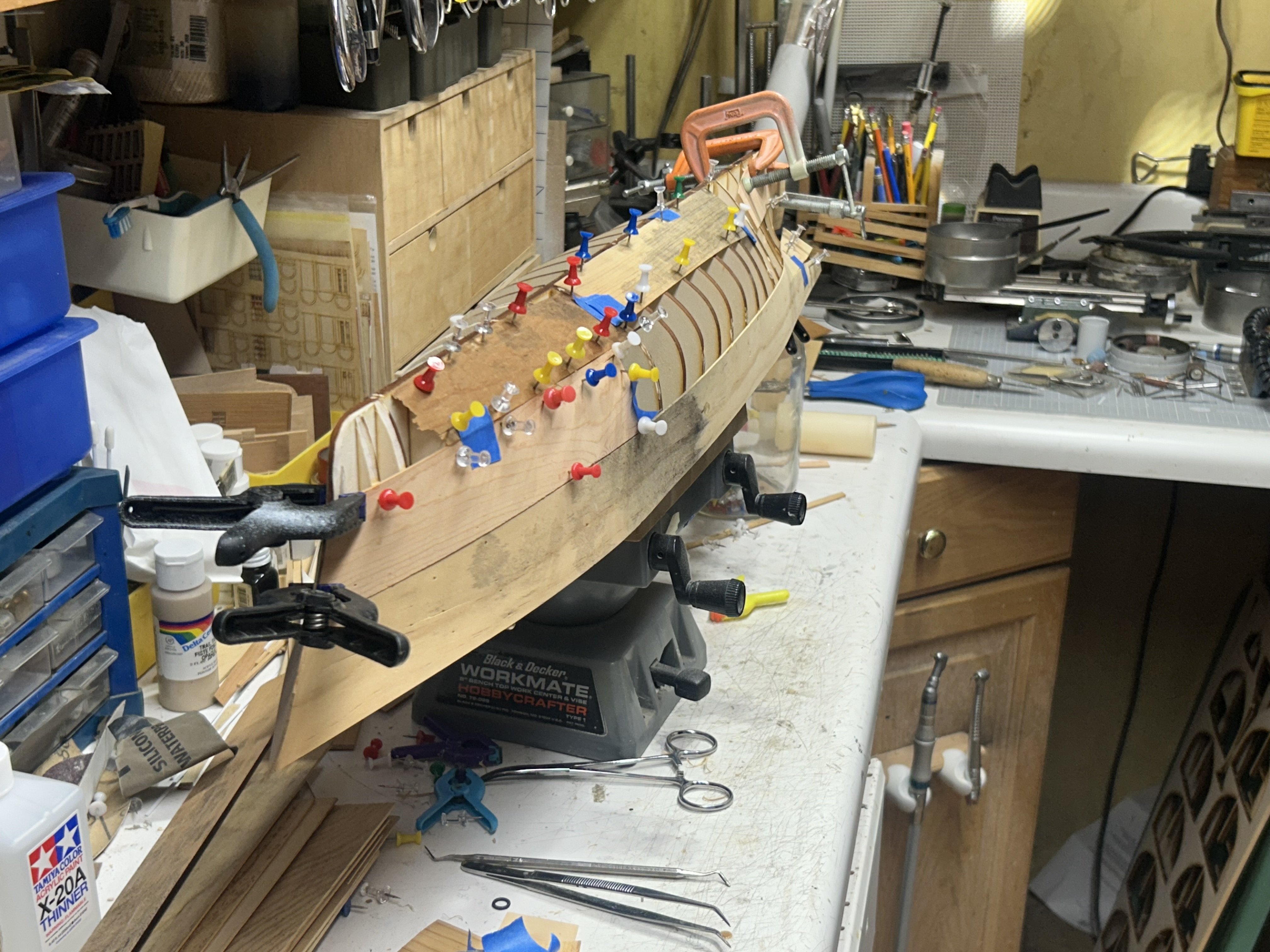

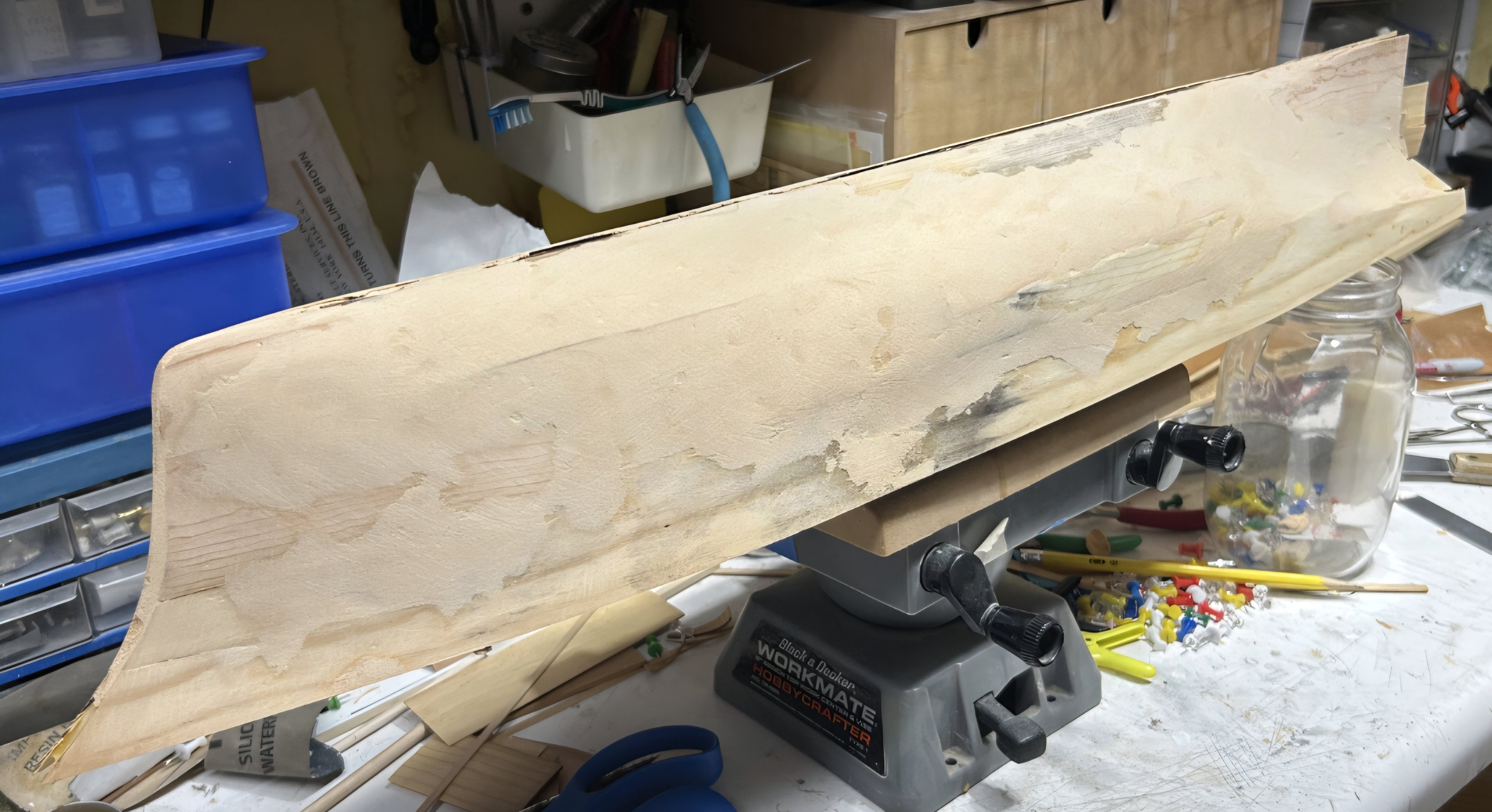

Throwing down some putty.
Rob

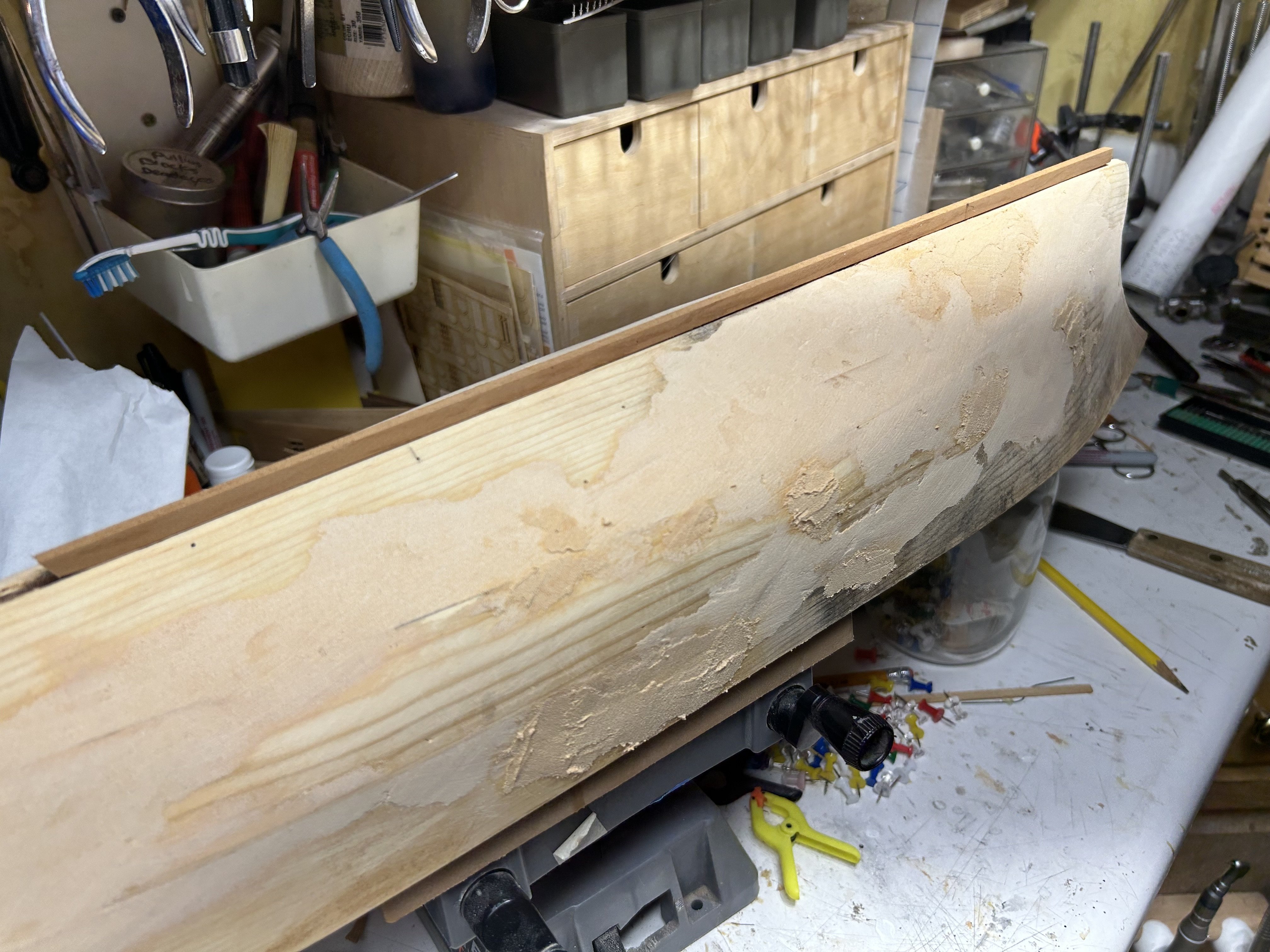

Both sides are puttied up and waiting to dry so I can sand like a madman.   Once all the initial sanding and contouring is done.    I’ll prep for the next coat.    Once this is all done , I’ll cut in the stem and cut water.
Rob

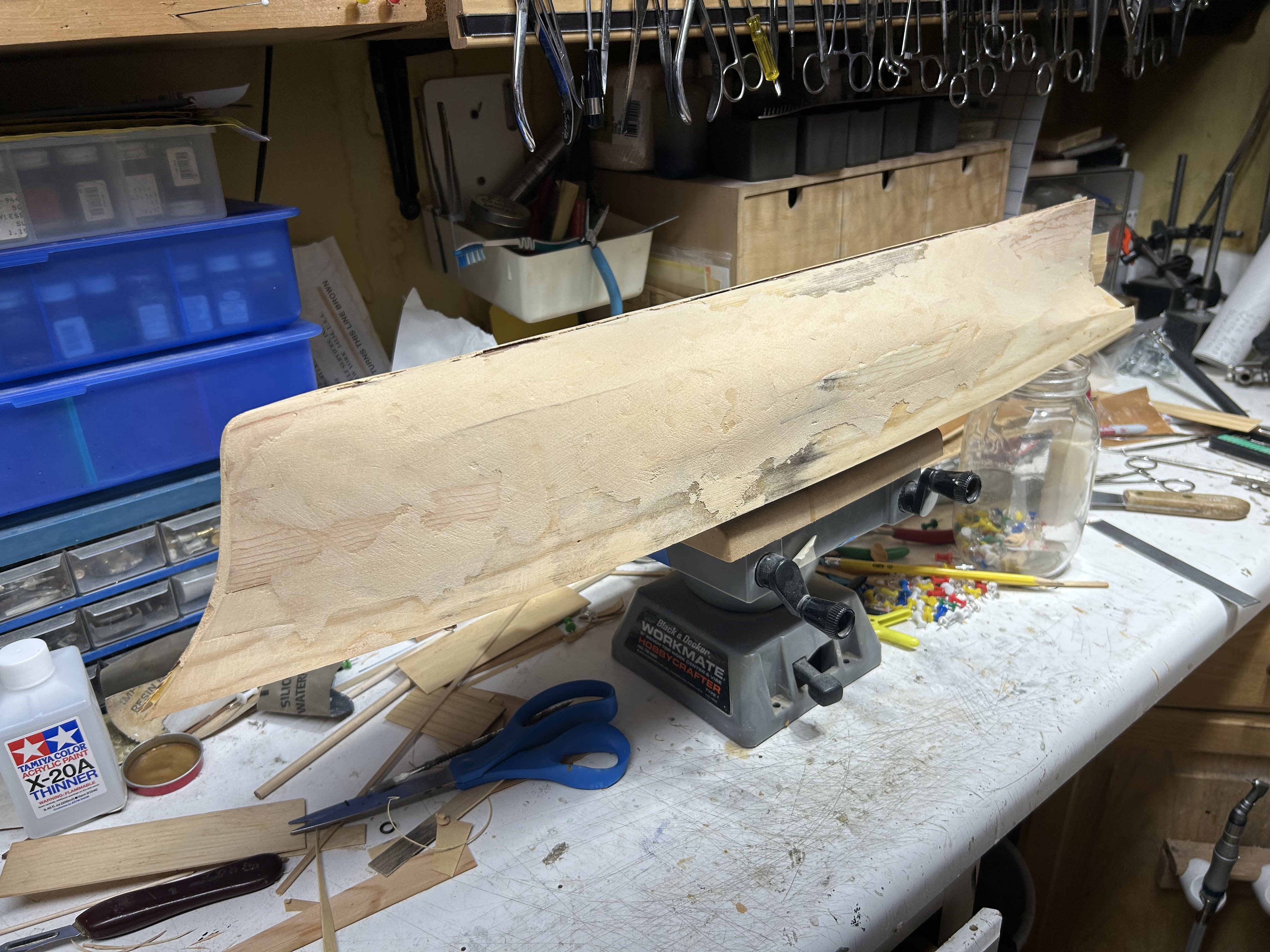

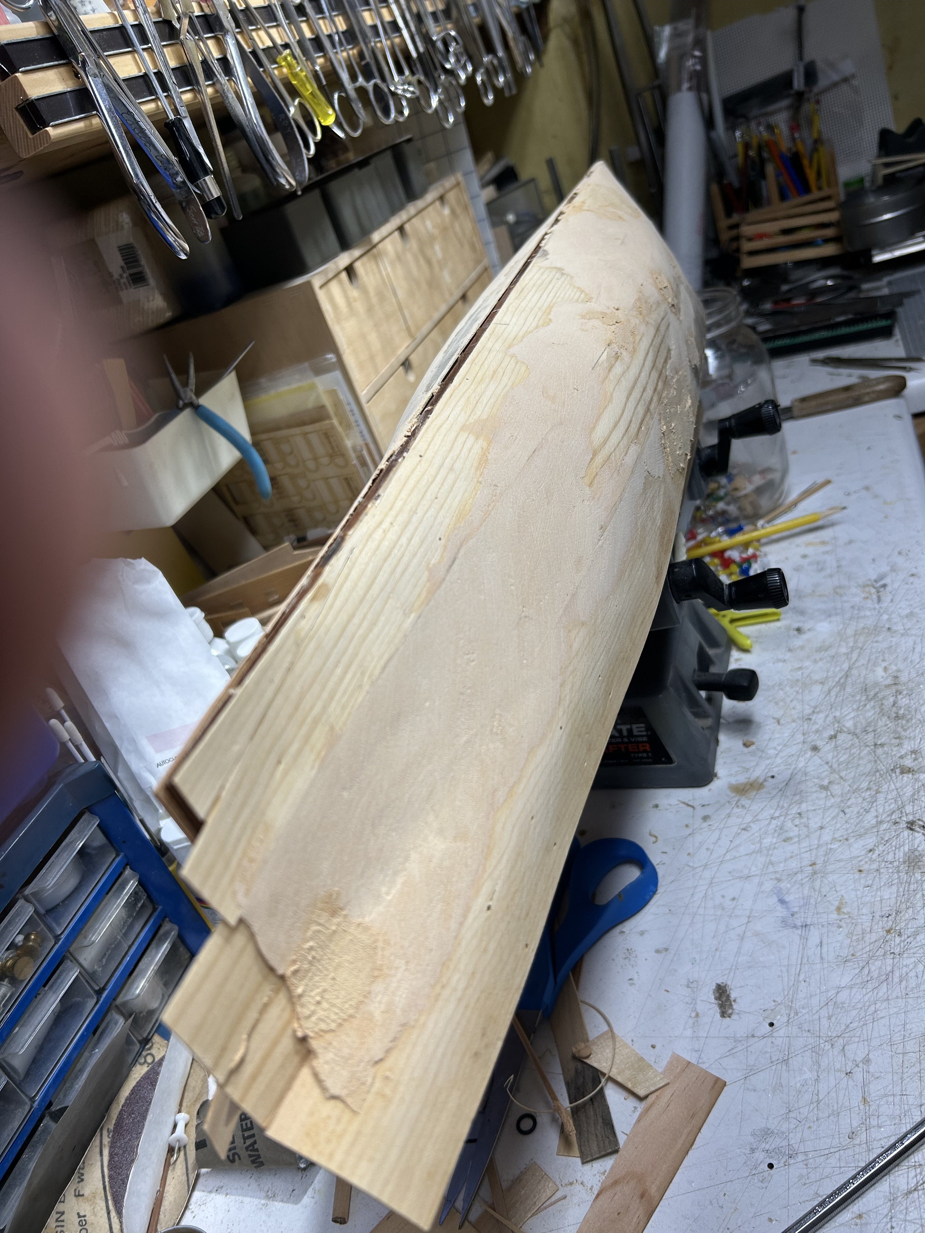

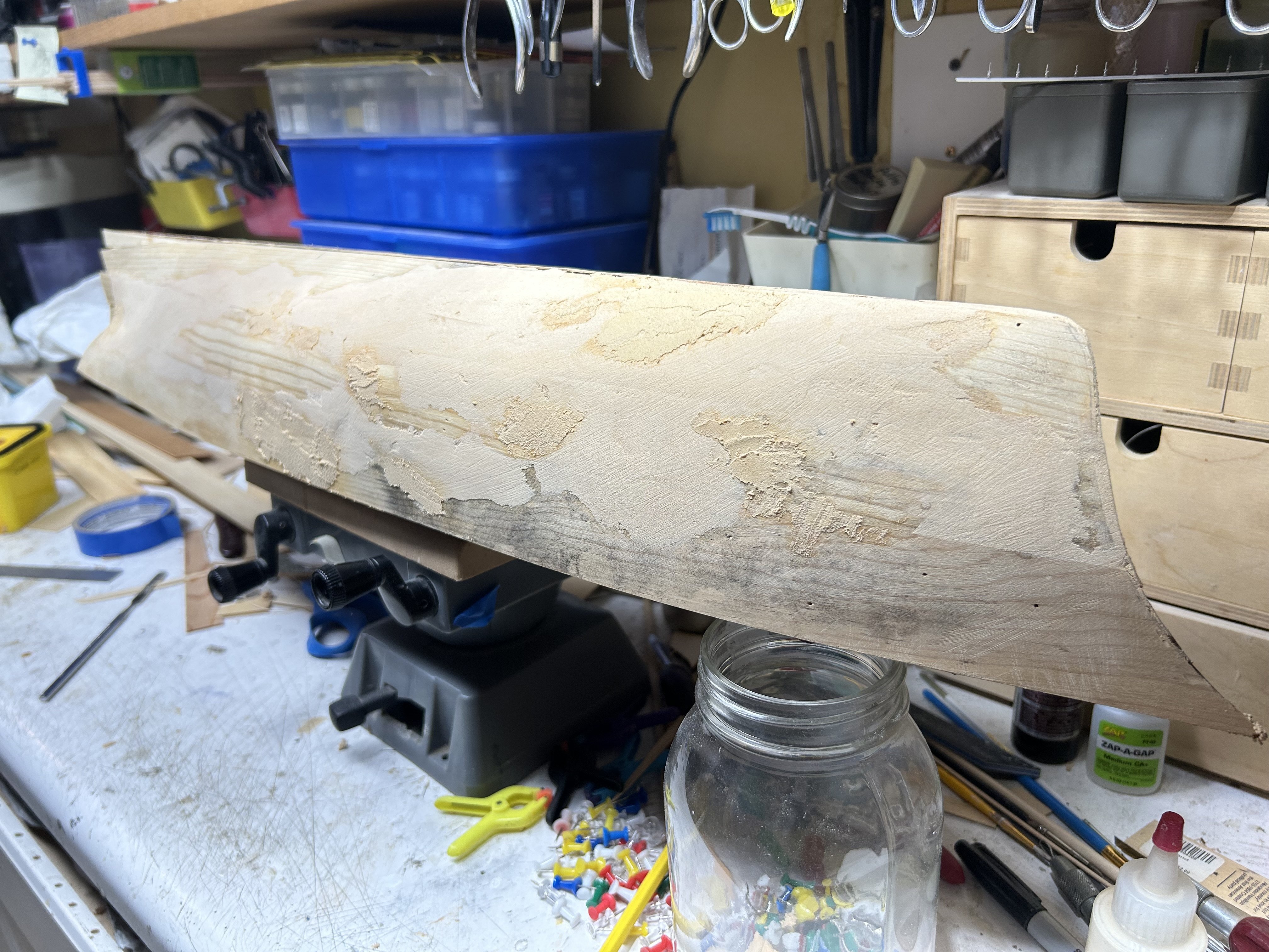

A little bit of sanding.    More filling and contouring.
Rob

48 minutes ago, druxey said:
!!!!  That will be a lot of sanding!
When is it not?   👍😎.
Rob

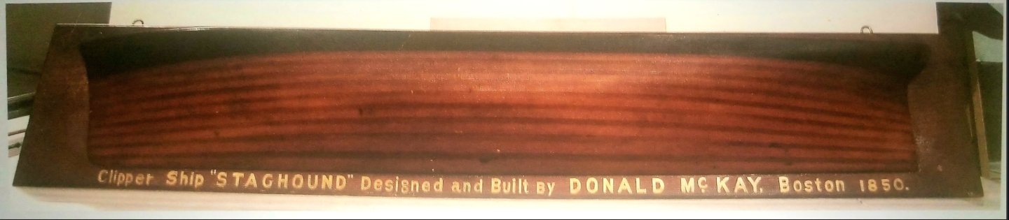

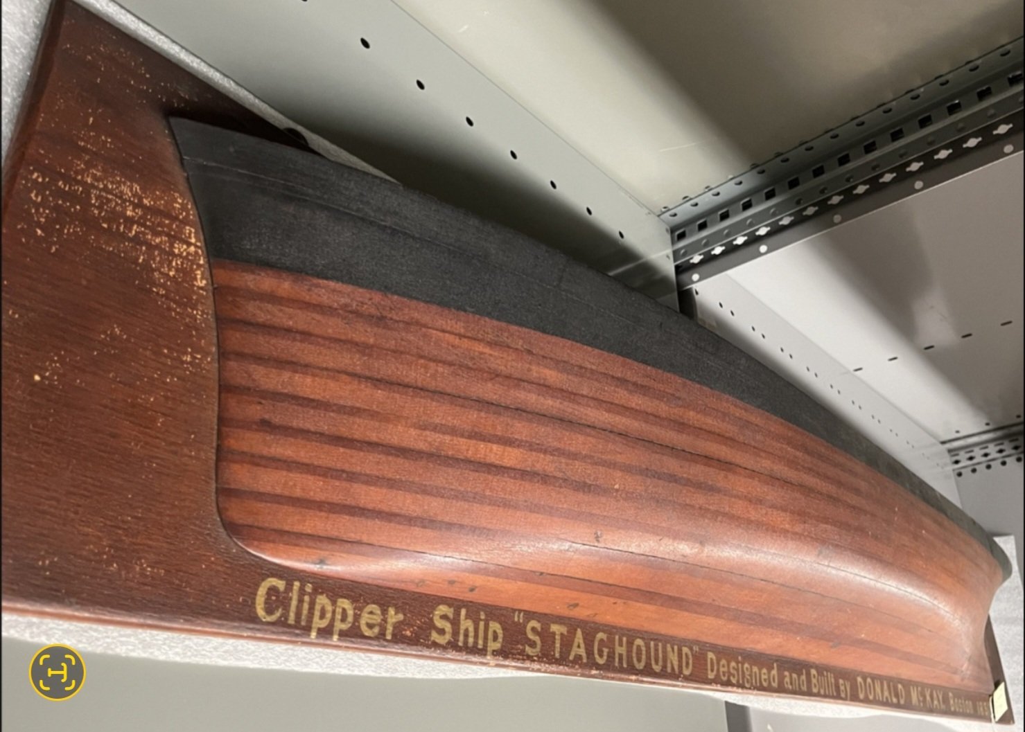

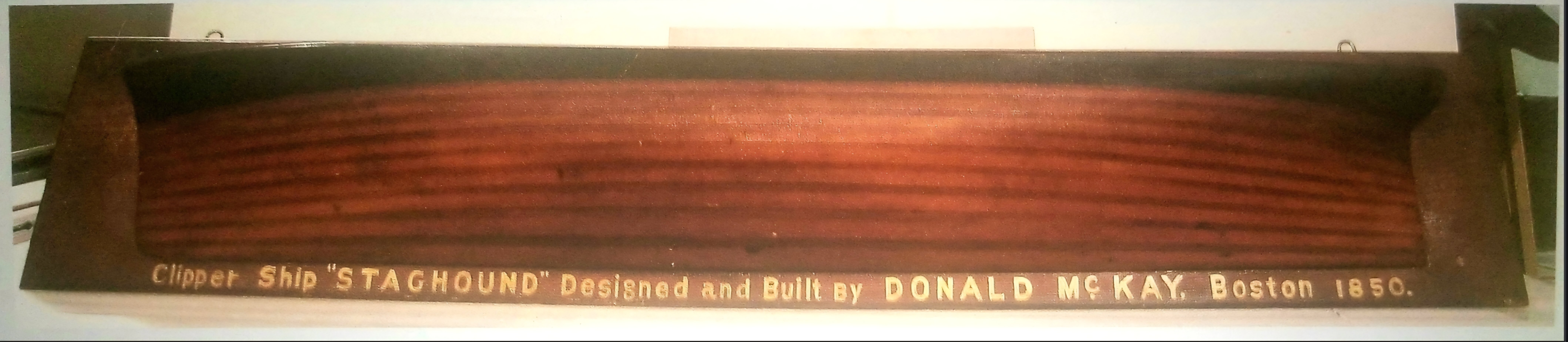

@rwiederrich Rob, your hull is already shaping up to be the most accurate one ever produced. As proof, here's an image of the beautifully crafted 1850 extreme California clipper Stag Hound done by Cornelius McKay as compared to a couple progress pics of your hull. To remind everyone, Cornelius carved his meticulously accurate 1:48th scale 4 footScreenshot_20250510_080535_Gallery.thumb.jpg.246a8e37084c8697ad3cb6b6fb68ff89.jpgScreenshot_20250510_080657_Gallery.thumb.jpg.b5a1e2e65b7cb49555c7f5e2362a88b6.jpgScreenshot_20250510_081114_Chrome.thumb.jpg.ce0dd3096e248dddc840b963dfc91418.jpg half-hull model from the actual lines lifted from the mold floor as the vessel herself was being laid out. Besides being recognition of your abilities it's also a tribute to the incredibly hard work and research of @Vladimir_Wairoa in his CGI reconstruction efforts. Accuracy is uncanny.

I read that it was the other way around - the half hull was the master and the lofts were done from that

For a 19th-Century fishing schooner, yes. But I very, very much doubt that Donald McKay designed a ship that way. He was working in the era of mathematical design of ships, then dominated by waveline theory as Froud's towing-tank wrk did not come before the 1870s.

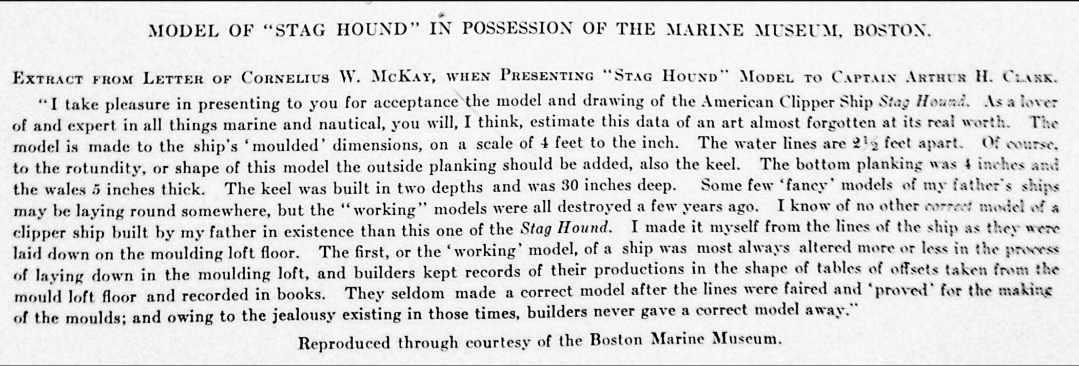

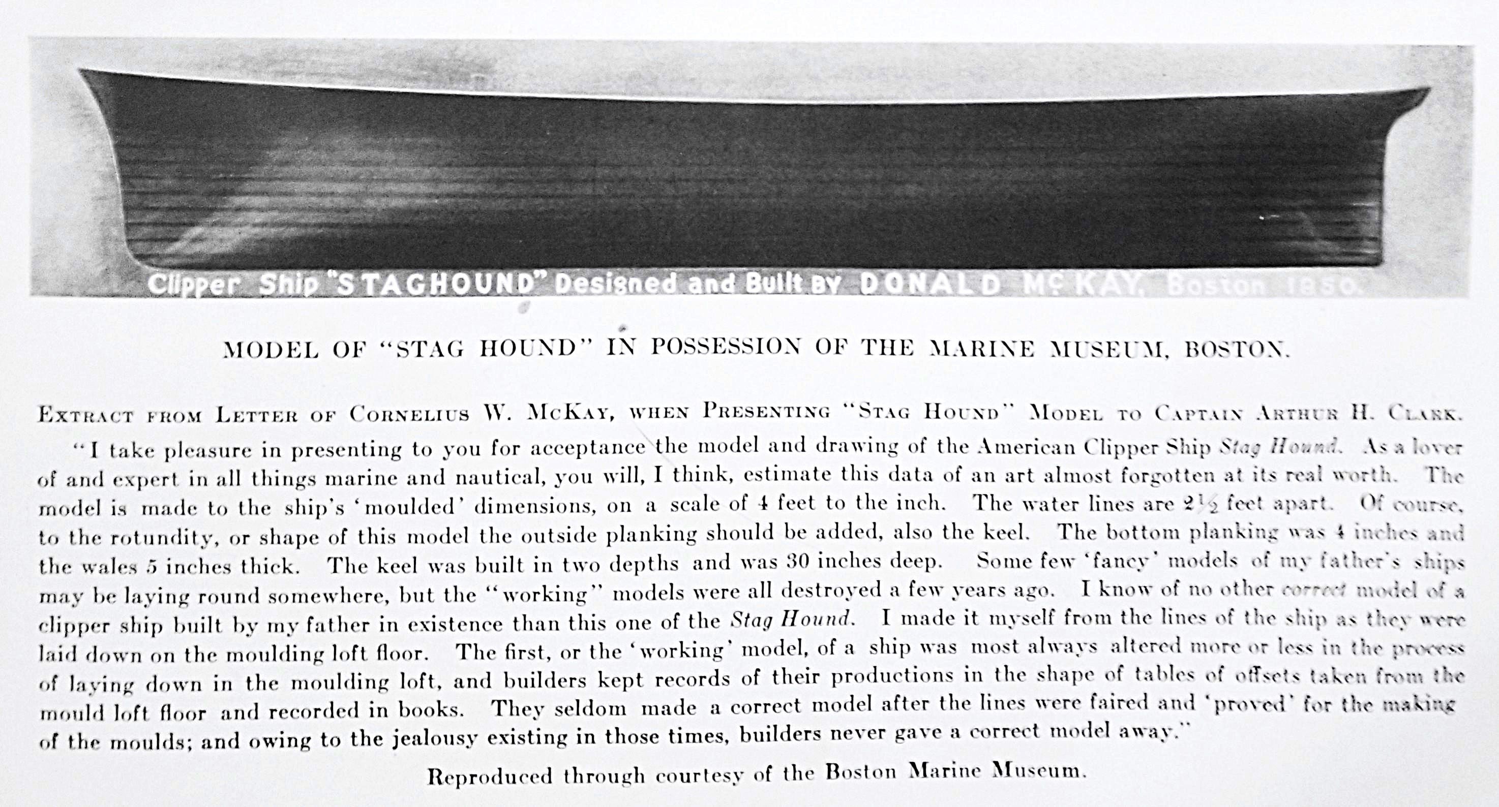

@sob in this particular case, we have direct confirmation that Donald McKay's son Cornelius crafted his builder's half-hull model from the molding loft floor. Here's the excerpt written in his own words. This is from his letter to Captain Arthur H Clark when he turned over his hand crafted builder's model to him. This comes from Richard McKay's book "Some Famous Sailing Ships and Their Builder Donald McKay."
StagHoundRJBestsmed-lt.jpg.e011953816501ef50bfbe58953a567a6.jpg.e5d2535d9e5667d2ad240b379d8d4ab8.jpg
That seems definitive for the particular model. Yet the reproduced text refers to a "first, or the 'working' model, of a ship". On its face, that suggests that McKay was designing by half-model -- which I find surprising but interesting if true. However, the wording is less than fully clear and subject to interpretation.
ClipperFan: Do you know of any definite evidence either way? I understand that nothing survives of McKay's original notebooks or draughts but is there anything in letters he wrote or some such?
Trevor
Trevor

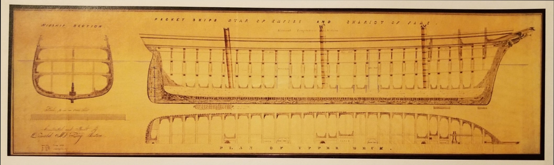

@Kenchington Trevor, I corresponded with a very generous lady at the Bostonian Society by email. Besides many wonderful pics of the original 1850 half-hull model, she sent me digital copies of the entire Cornelius McKay typed and handwritten letters. An intriguing fact is that Cornelius mentioned he included line drawings of the ship as well. She also included an ultra rare Chinese export painting on Stag Hound as well. In respect, I've left their watermark on although I later secured another for $25.00 watermark. In the highly detailed appendix of Richard McKay's book, he mentions that The Peabody-Essex Museum, Salem, MA has the only Donald McKay manuscript which he was preparing for a planned European trip for marketing purposes. A single example is the beautifully detailed construction illustration of the twin packets Star of Empire and Chariot of Fame.

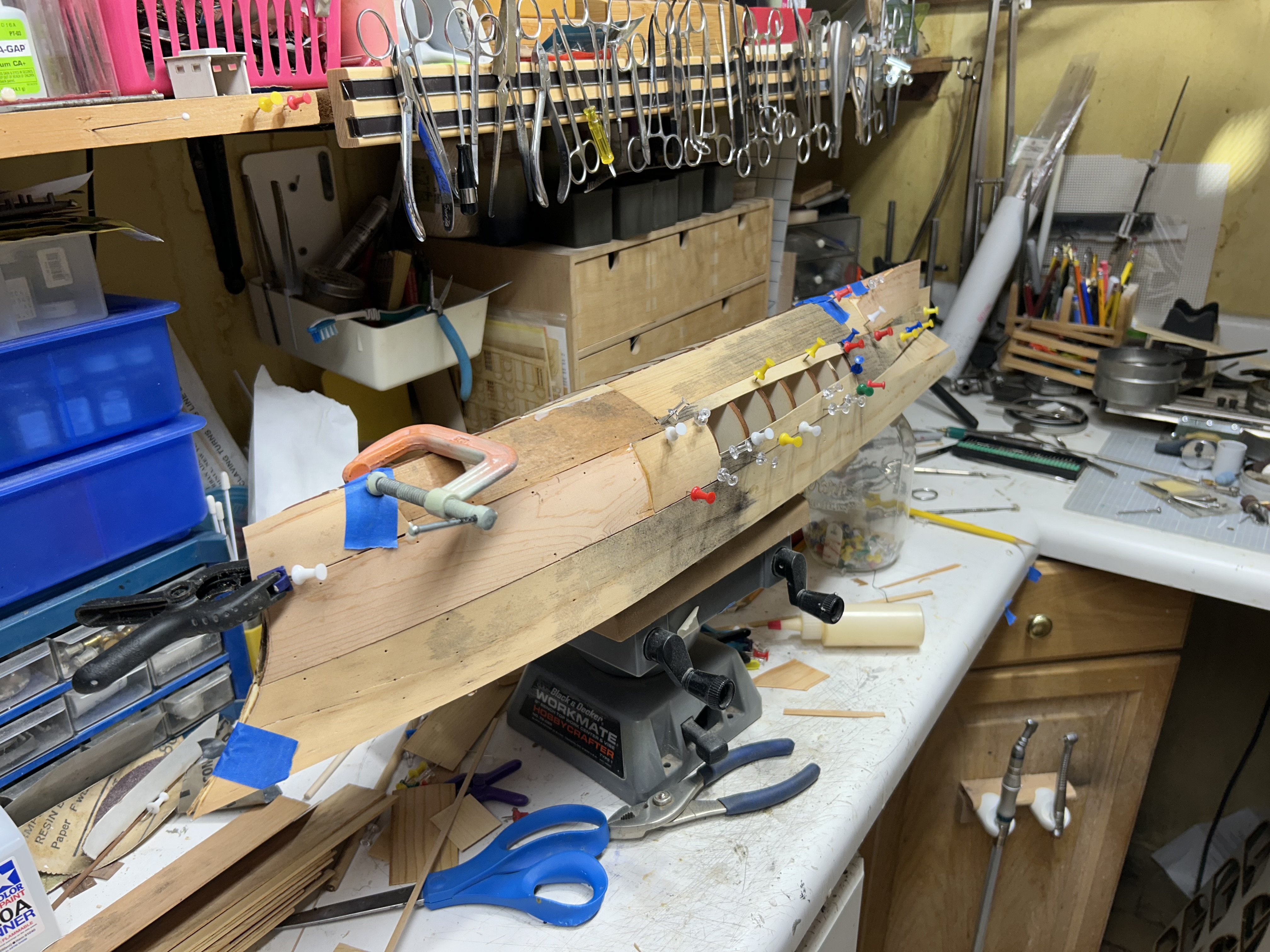

I began the second round of compound application.
Rob

The bow will be cut back slightly.  I over extended it to assure the proper insertion of the stem and cut water.
Rob

I’ve installed the base for the stern.   Lots of carving and woodwork due here.  I also dry fit the forward keel to get some measurements.
Rob
