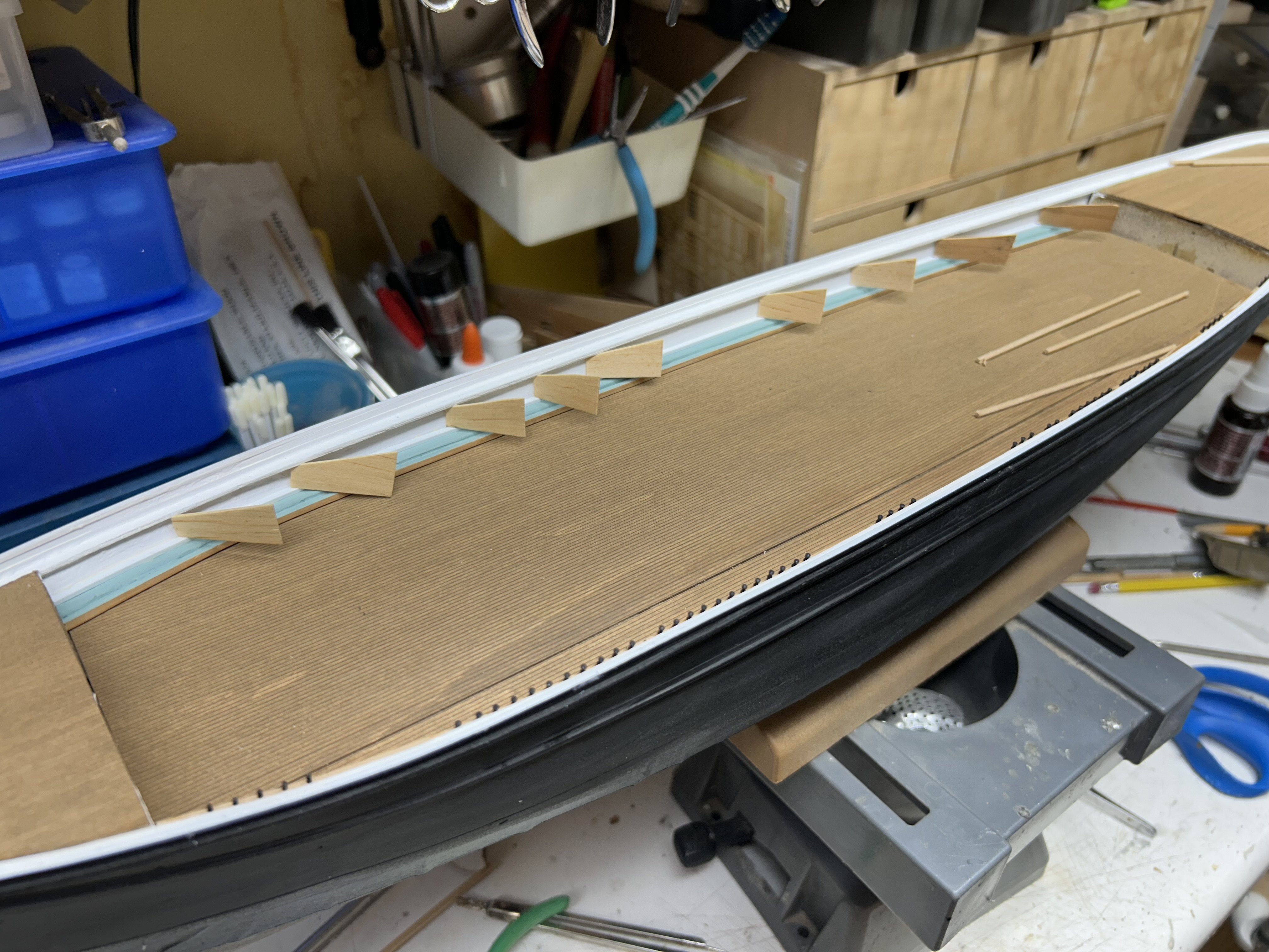

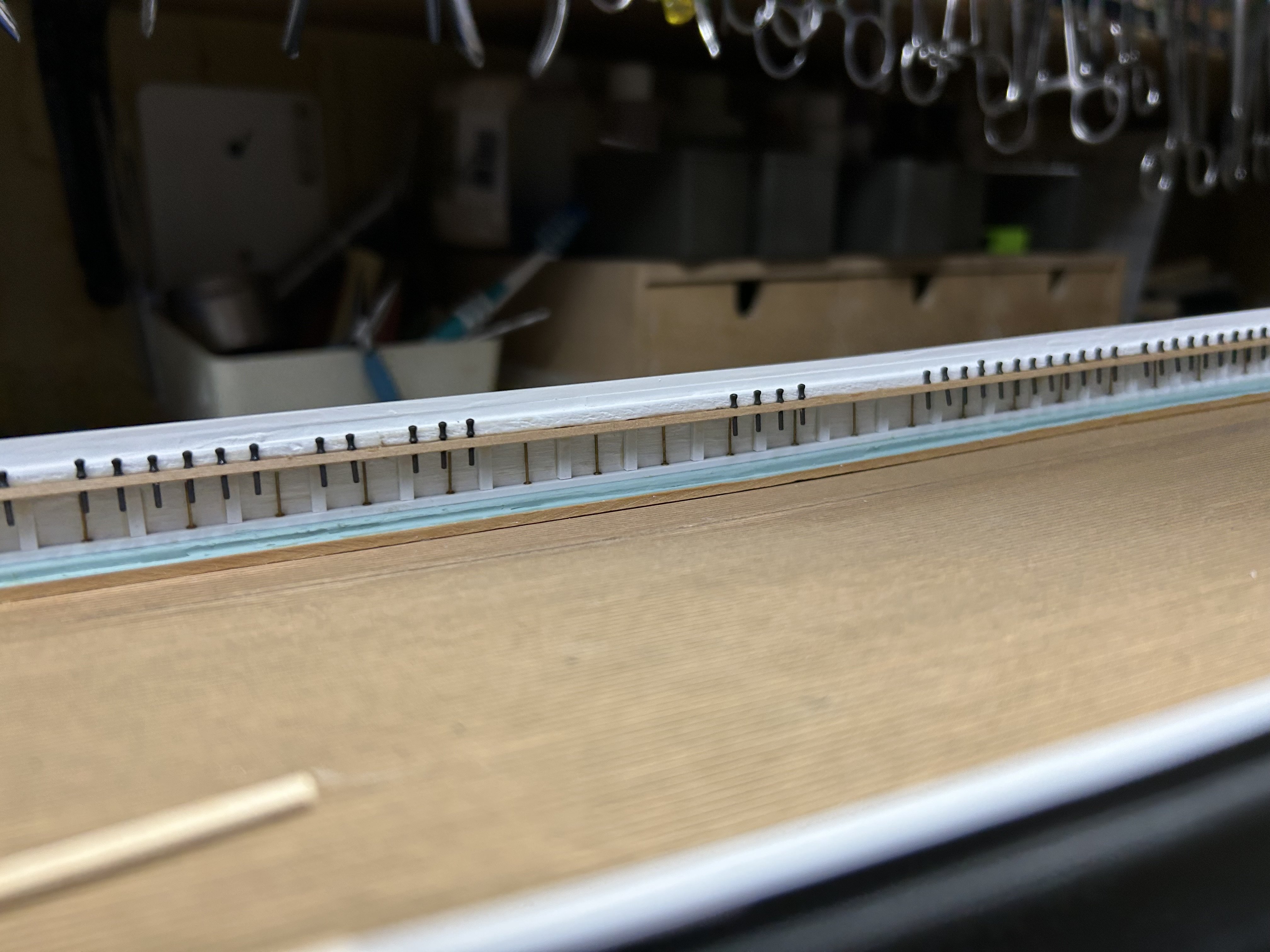

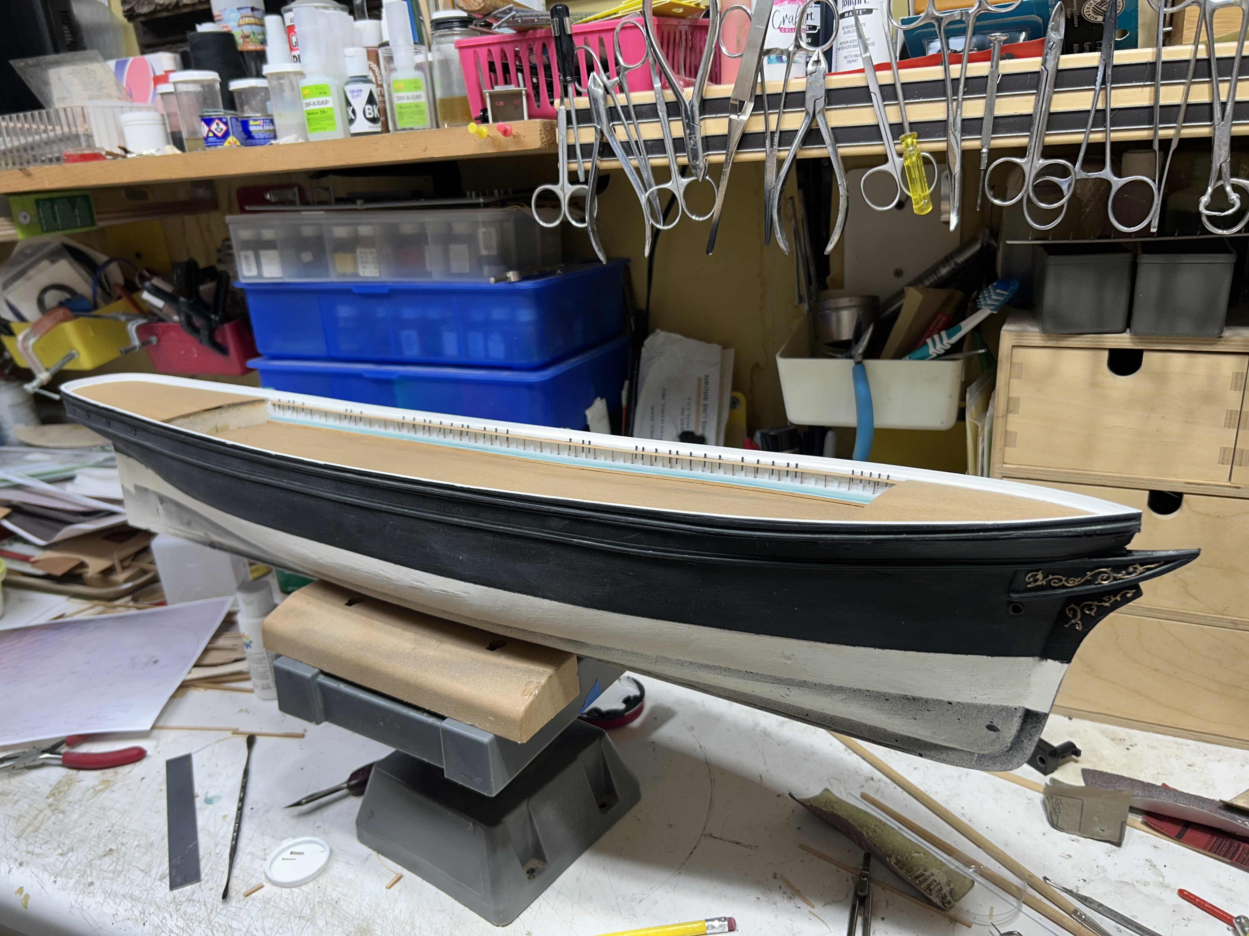

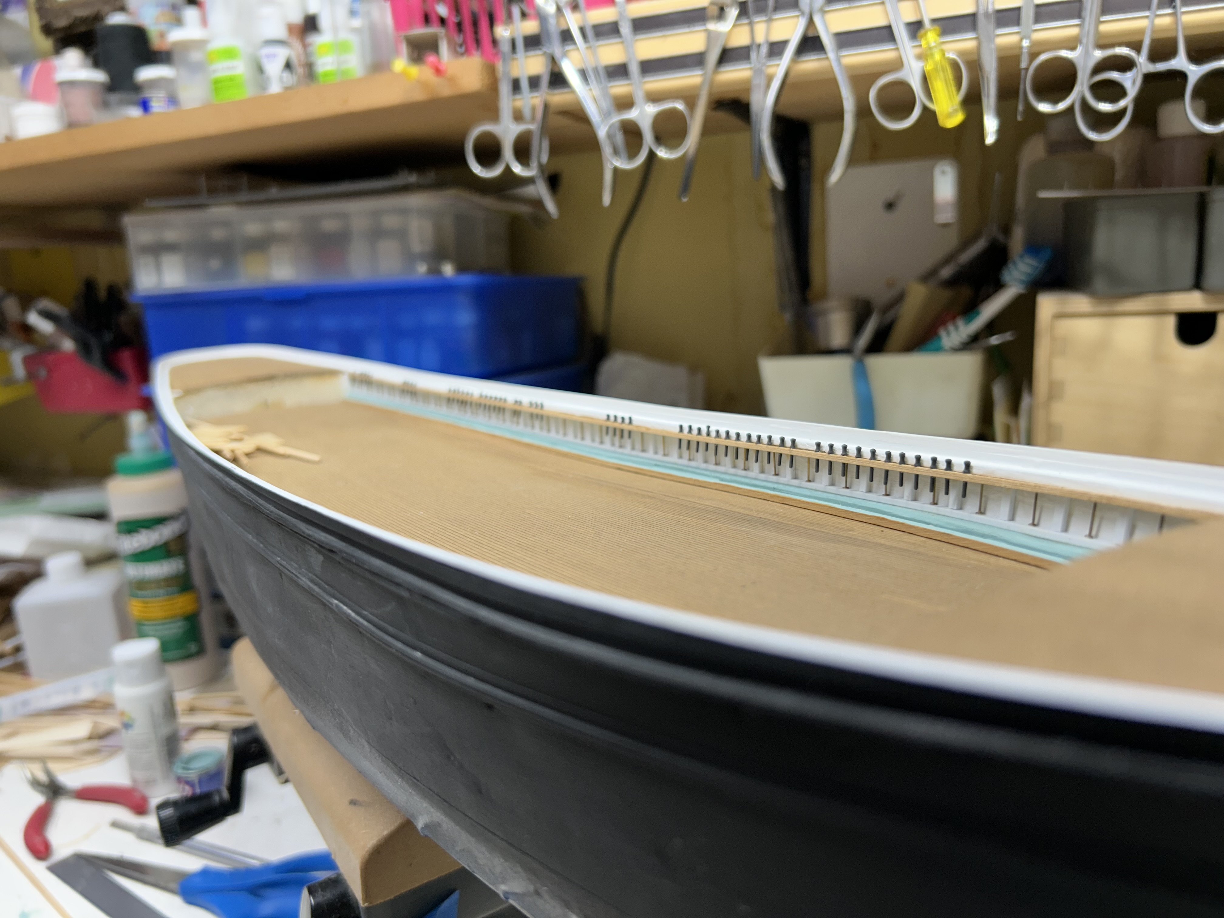

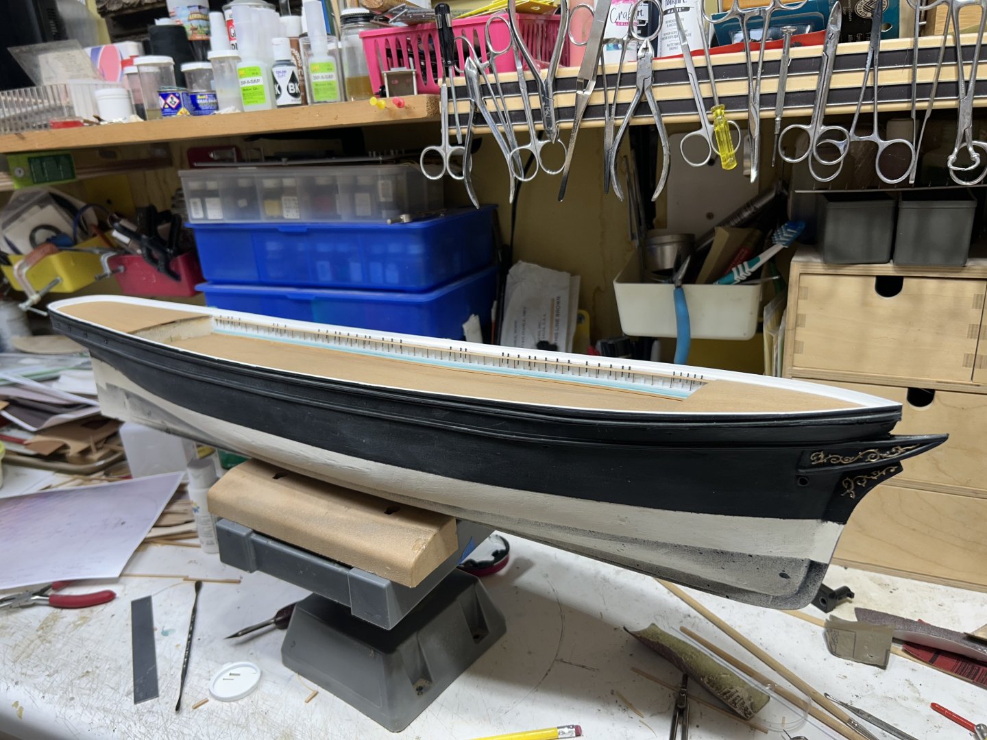

I added the straight copper vent pipes between the stanchions.
Rob

3 hours ago, Luis Felipe said:

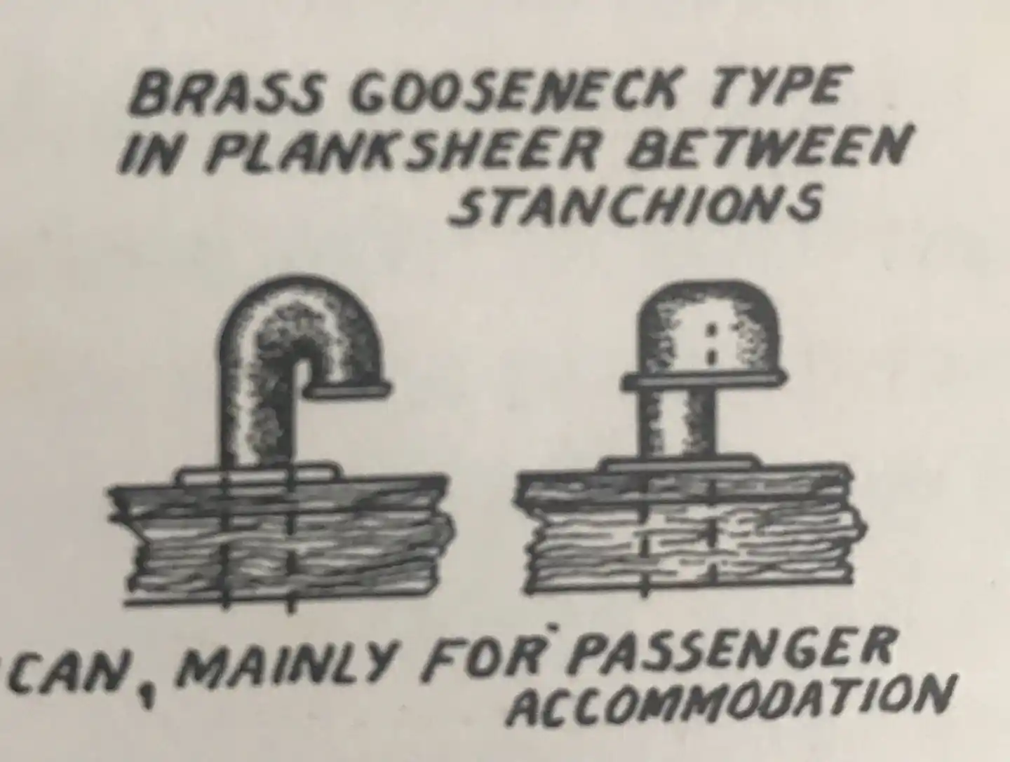

Hi Rob, fine and beautiful job, but? how do you do this?image.png.c72e8395d1f3964ff40128990c8547c2.png

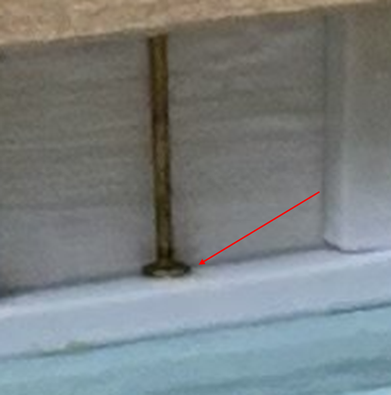

Imagine that…..,   I pondered the fabrication of these copper vent pipes for some time.  Staghound utilized straight pipe vents instead of the typical round trap type depicted on the Flying Fish.  So it dawned on me to use oxidized copper pins with the tips cut off and the heads ground flat…….to represent the  strake seal flange of the vent pipes.   They are good representations ……….I think.
Rob
Rob
Rob,
That's a clever reuse of ordinary objects.
1 hour ago, ClipperFan said:
Rob,
Thanks....I'm always thinking outside of the box.  I knew I needed something that replicated a *flanged* pipe.  Not just a wire poking through the strake.  There had to be some sort of gasketed flange protecting the sleave around the pipe, so water would not pour or drip past the pipe to areas far below...thus wetting the interior of the ship.  It is said the vent system was of a most scientific and engineered application.  And Staghound was acclaimed to be a very *dry* ship.  It's what I came up with....in 1/96 scale.🎼
Rob

2 hours ago, Rick310 said:
Thanks Rob!  Great idea for the vent flange!
Rick
The Waterways were flooded with copious amounts of water...and the vents had to be protected.  The flanges must have taken extreme thought to prevent water passage beyond the brass/copper pipes.  Thanks for the kudos Rick.
I'm always trying to use stuff or reinvent stuff for my own purposes.  Note the flange on these goose necked vents.  Kinda like the ones used on Flying fish models.
Rob

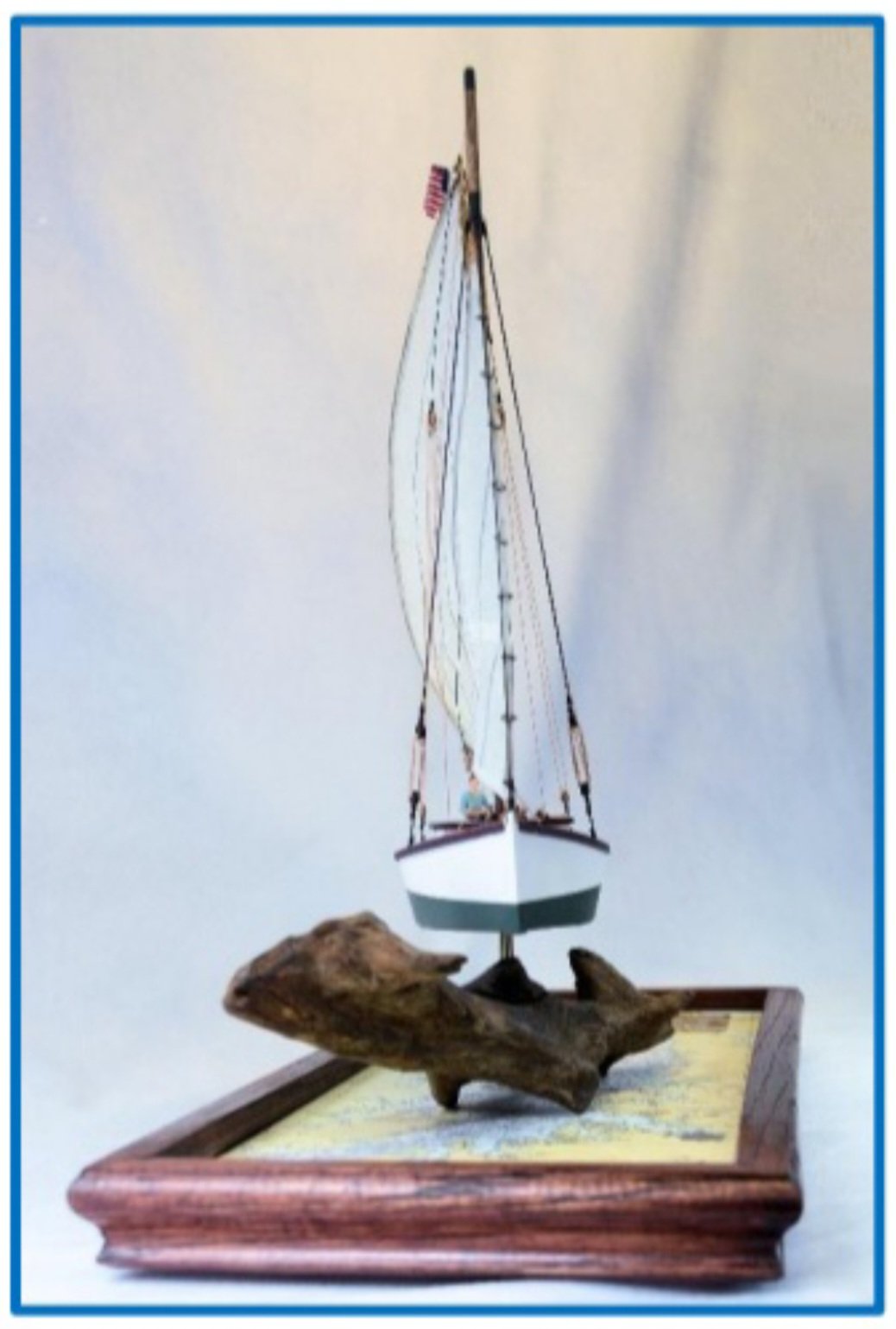

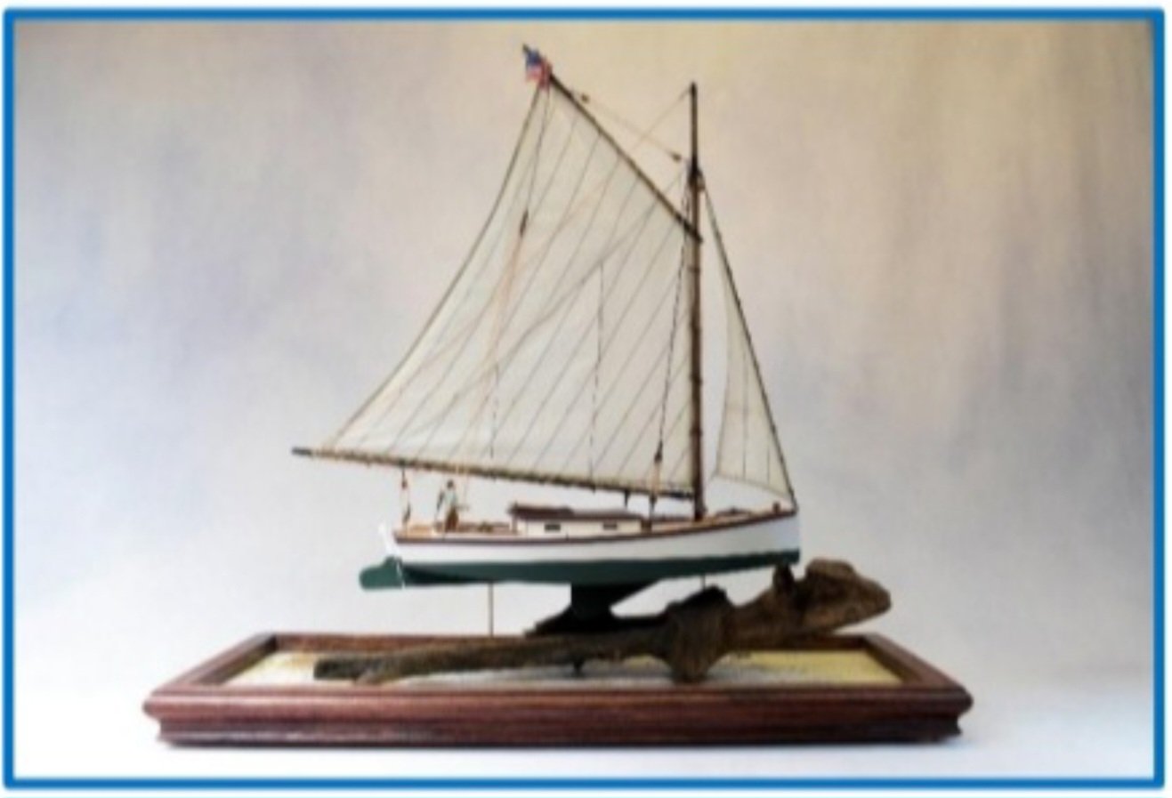

@rwiederrich @Vladimir_Wairoa @Luis Felipe all three of you have created wonderful replicas worthy of entering this NRG Photographic Model Ship Competition (details are in the green banner at the top of this page). I would be more than willing to assist in making selections. That is, if you want any suggestions. Personally I think you all have some incredible models to share.

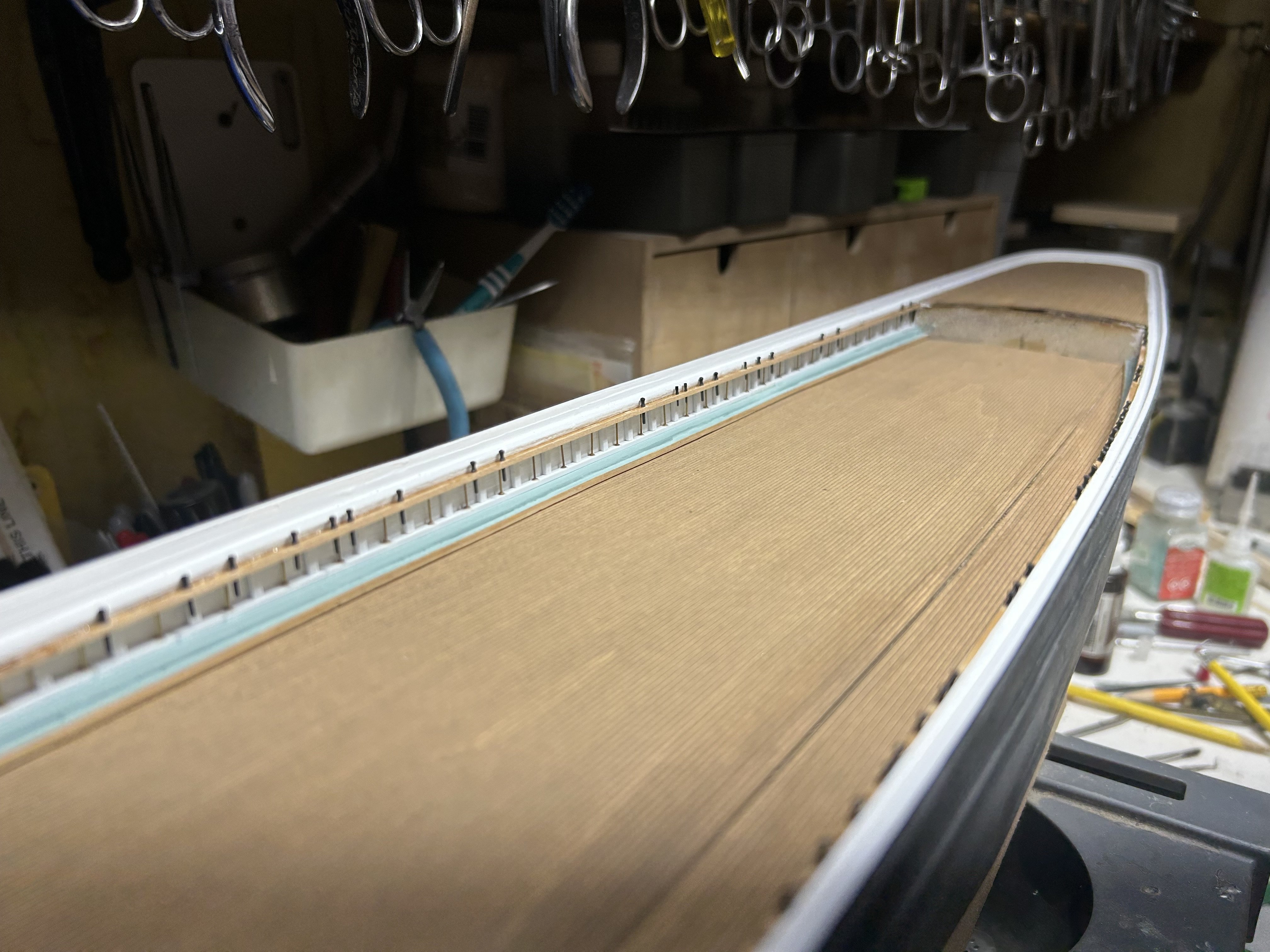

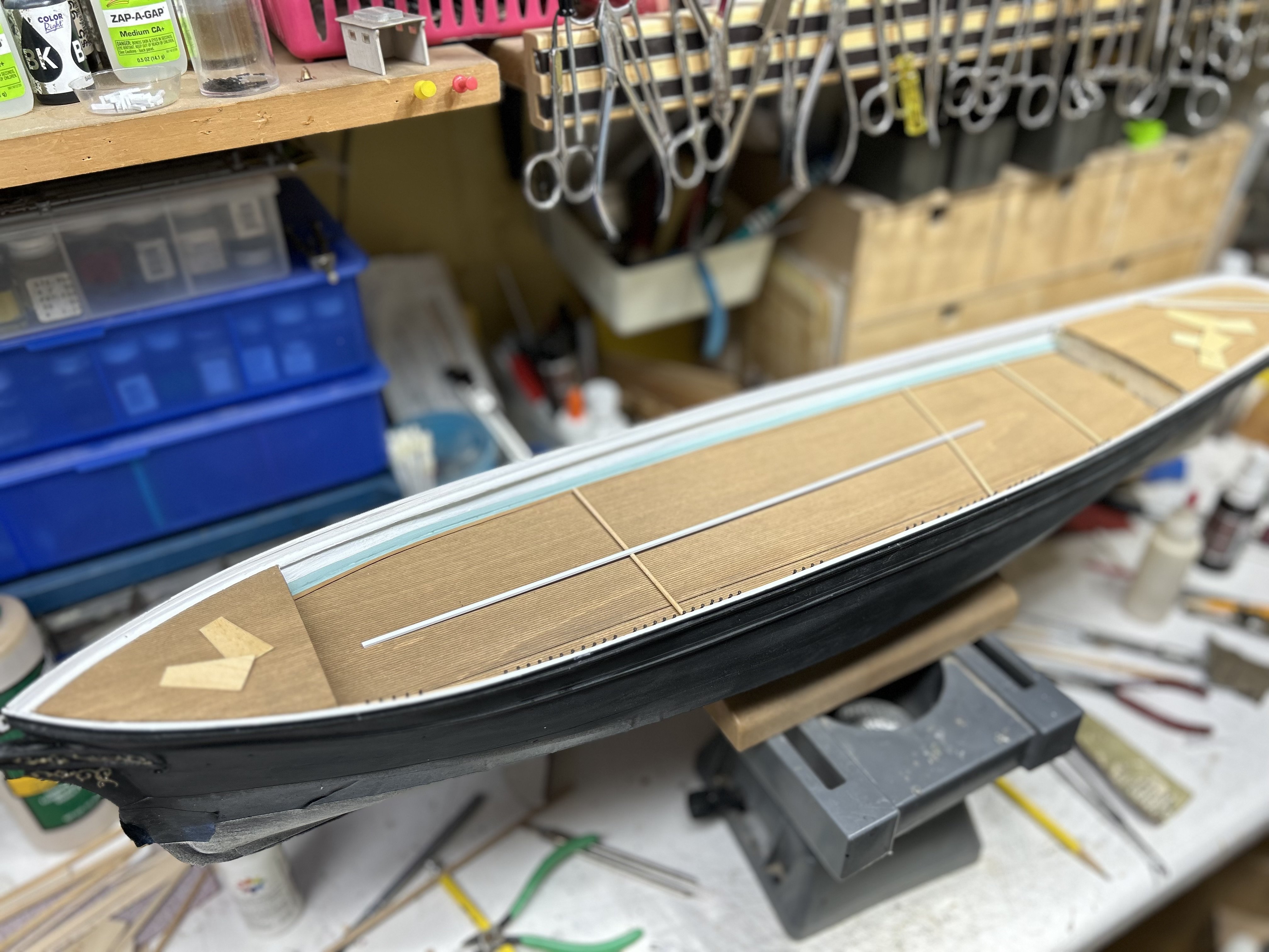

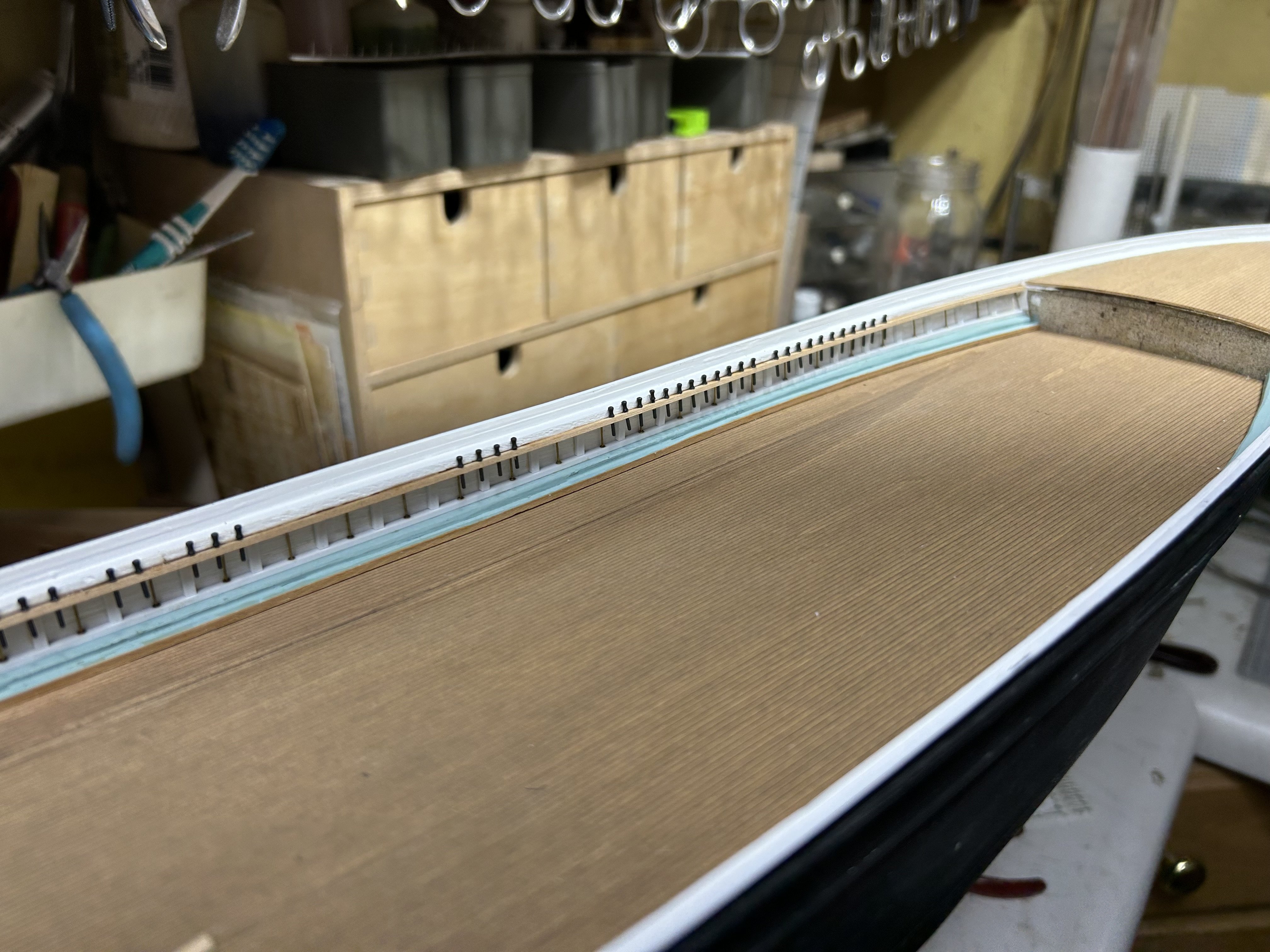

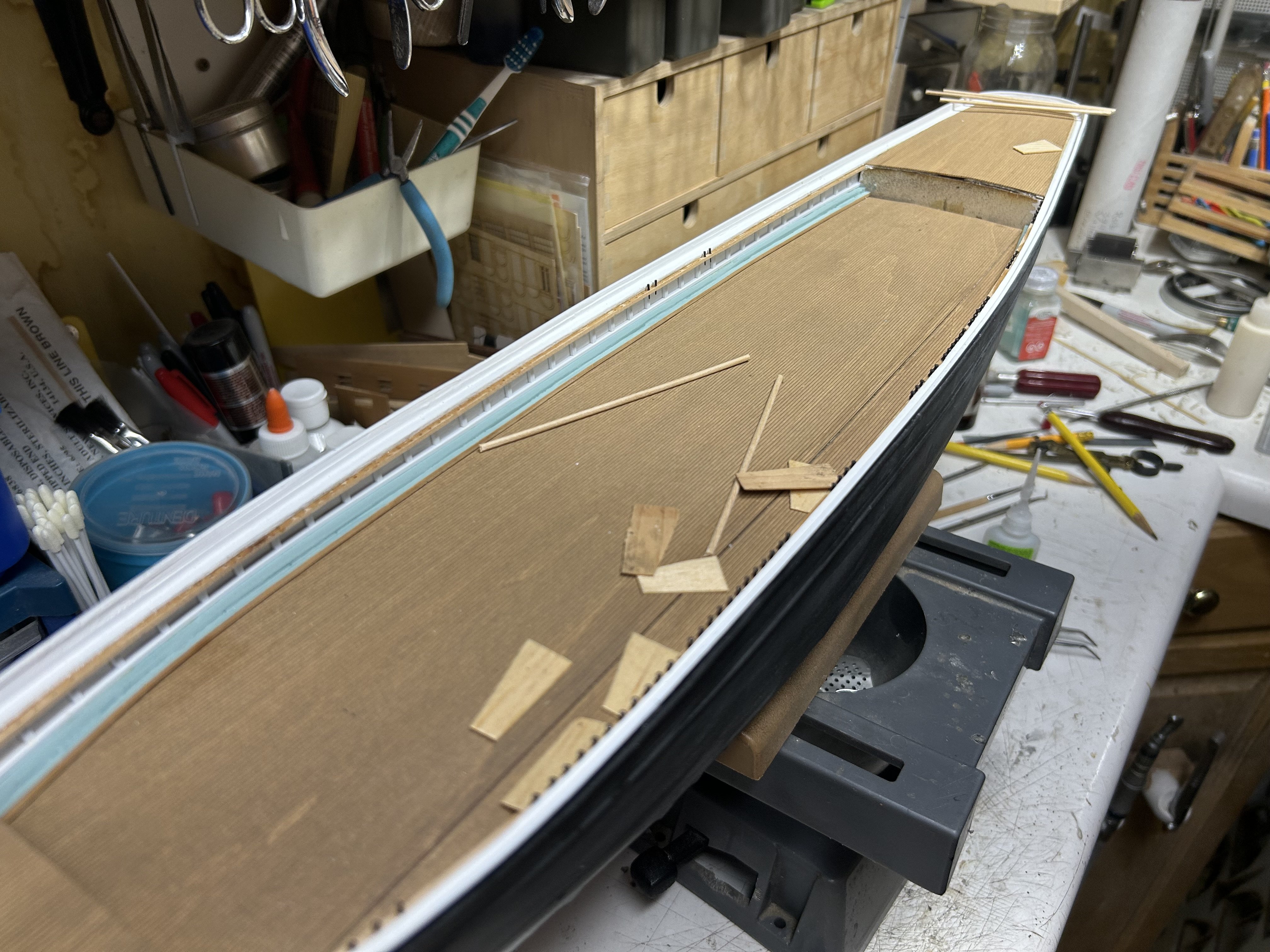

Began adding the starboard waterways.
Rob

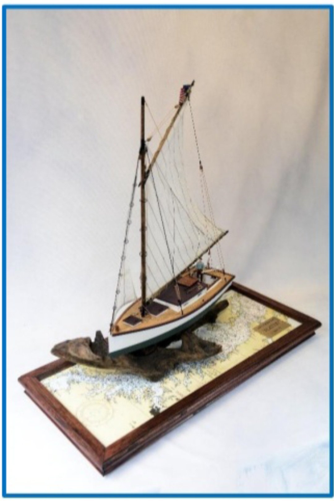

Rob, from a photographer's viewpoint it's probably not the most desirable since Arina's not entirely in the picture. Still from an emotional one, this is one of my favorites since to me it symbolizes "A Dream Realized." I'll keep looking for more images.

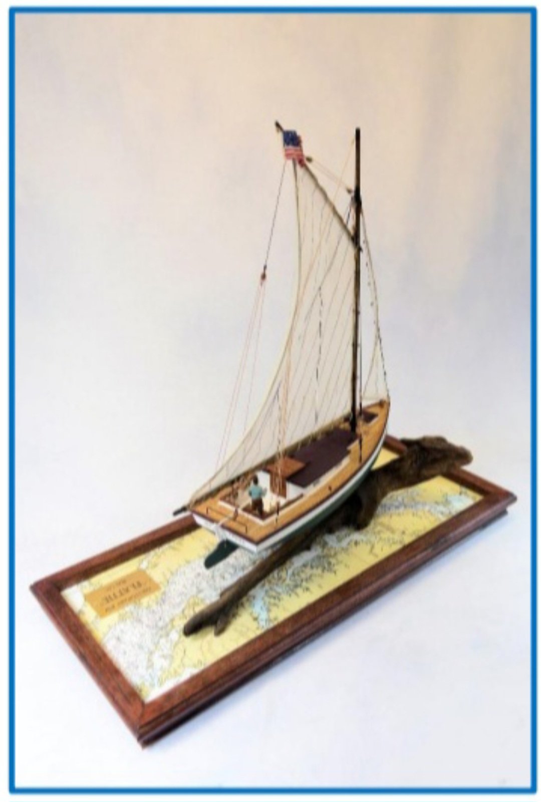

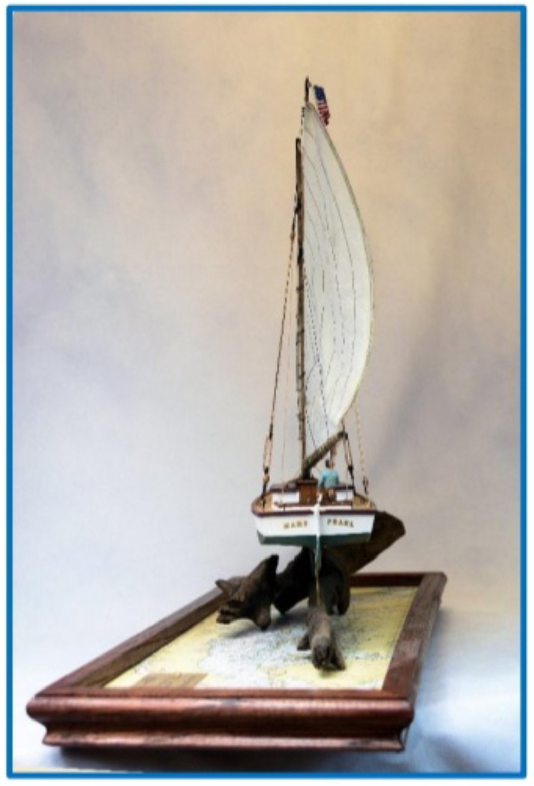

@rwiederrich @Luis Felipe @Vladimir_Wairoa NRG Photographic Model Ship Competition, 8 required picture samples enlarged. A few observations of samples: good lighting to capture all details, plain background not to distract from model and entire model is centered in each picture. Submission deadline is July 31, 2025. All details are available in the green banner at the top of each MSW page.
(1) amidship deck level port broadside
(2) amidship deck level starboard broadside
(3) above stern port quarter
(4) above stern starboard quarter
(5) above bow port quarter
(6) above bow starboard quarter
(7) dead ahead bow
(8) dead ahead stern

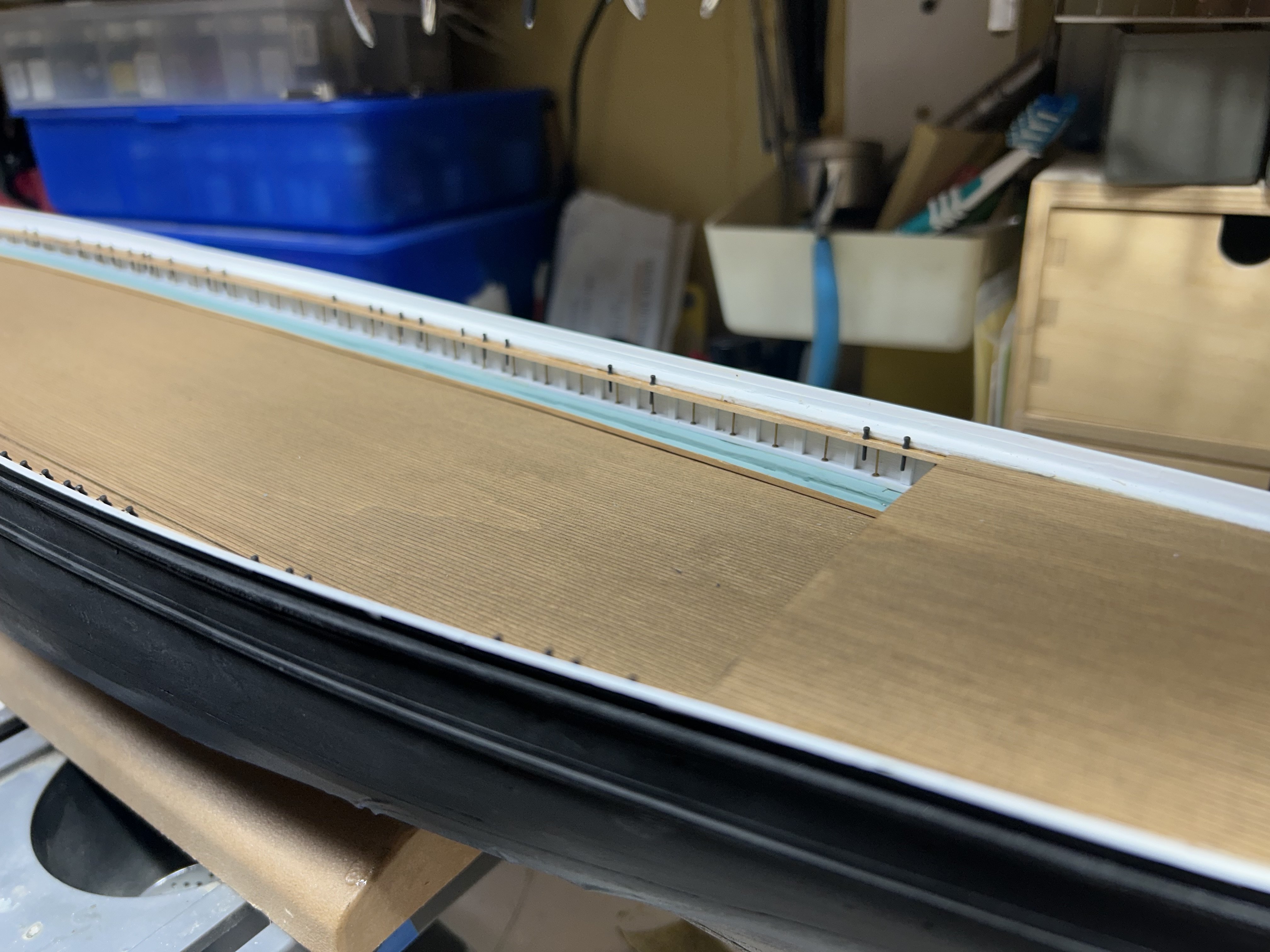

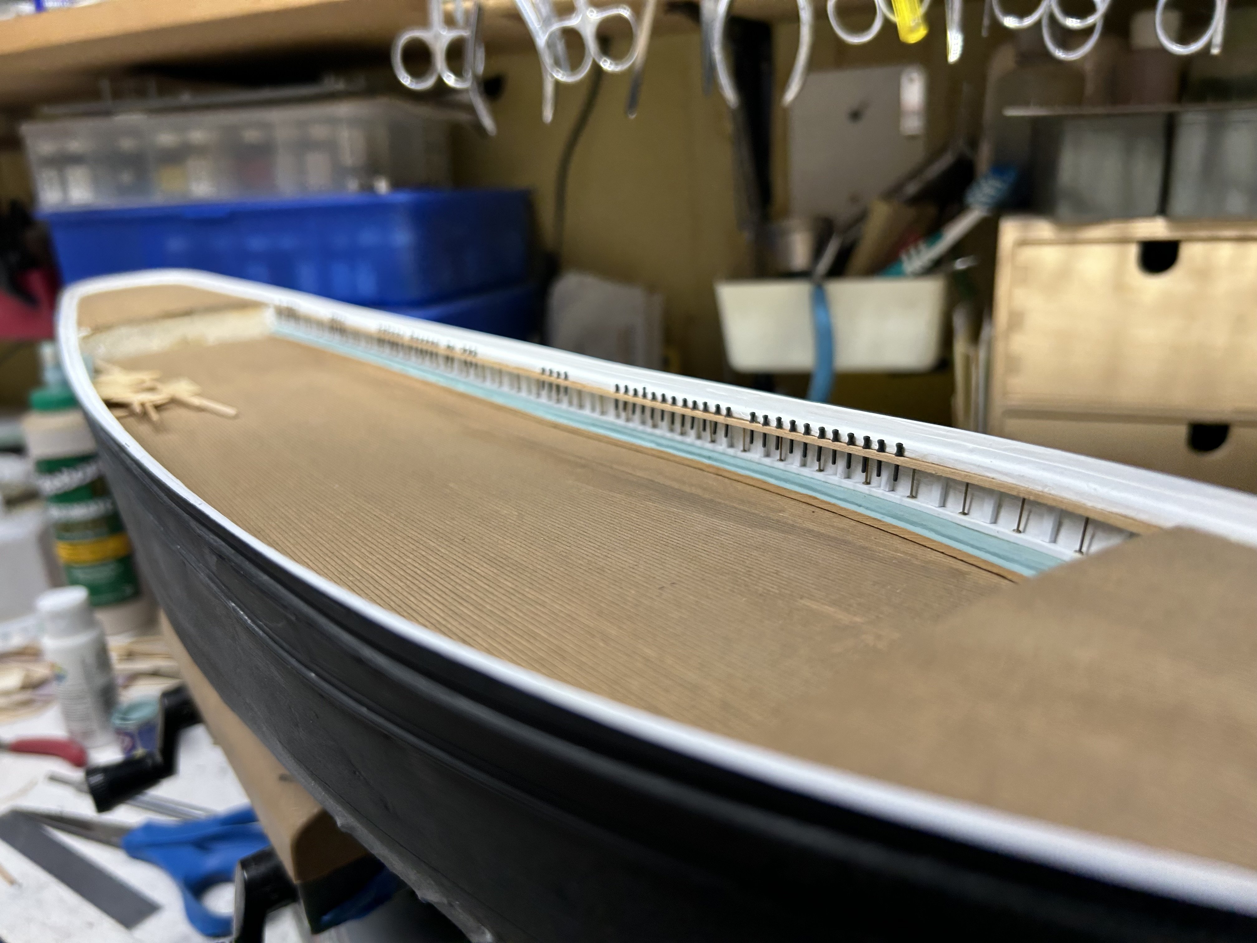

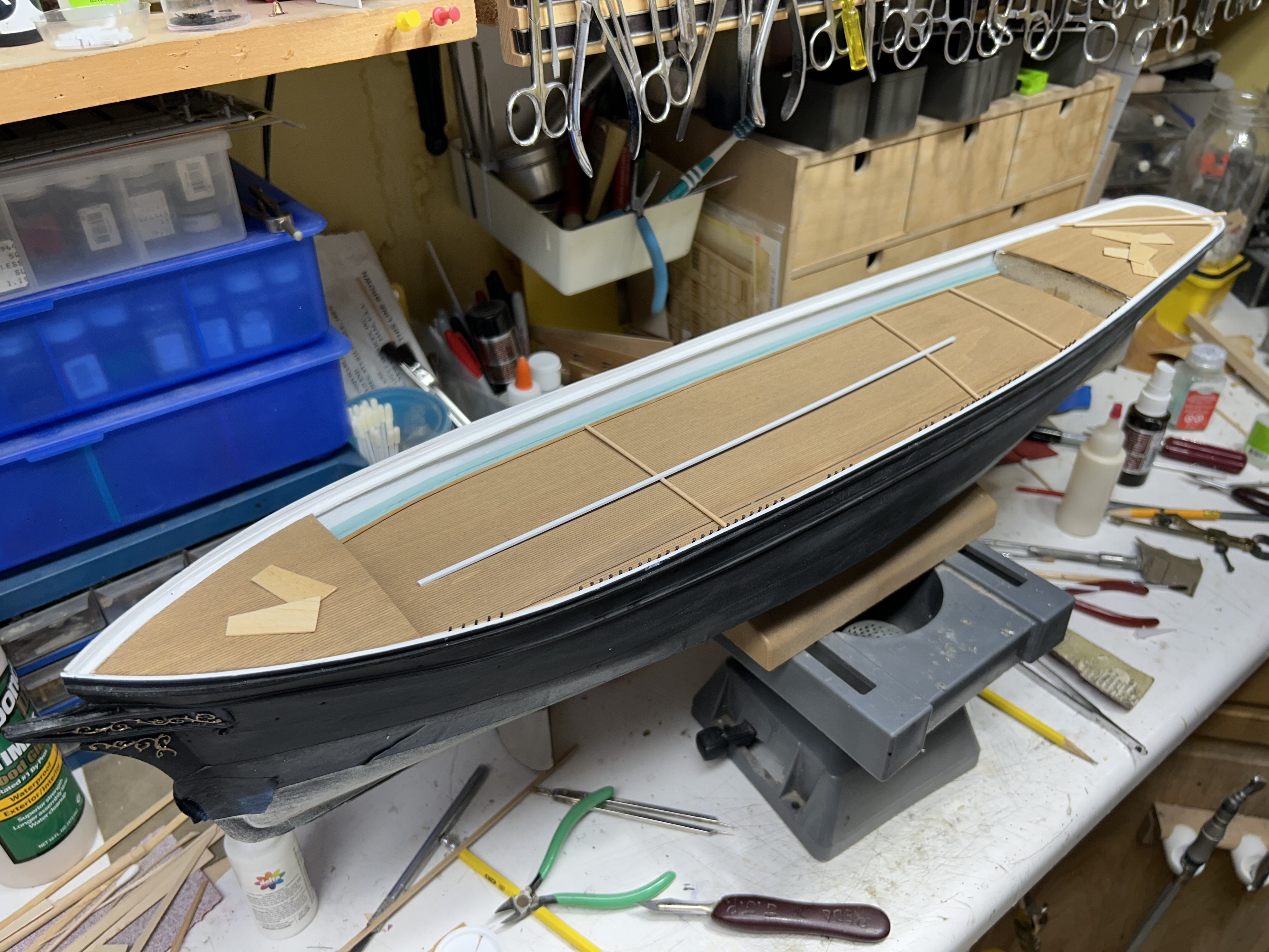

Finished the starboard pin rail and stanchions….. now onto the vent pipes.
Rob

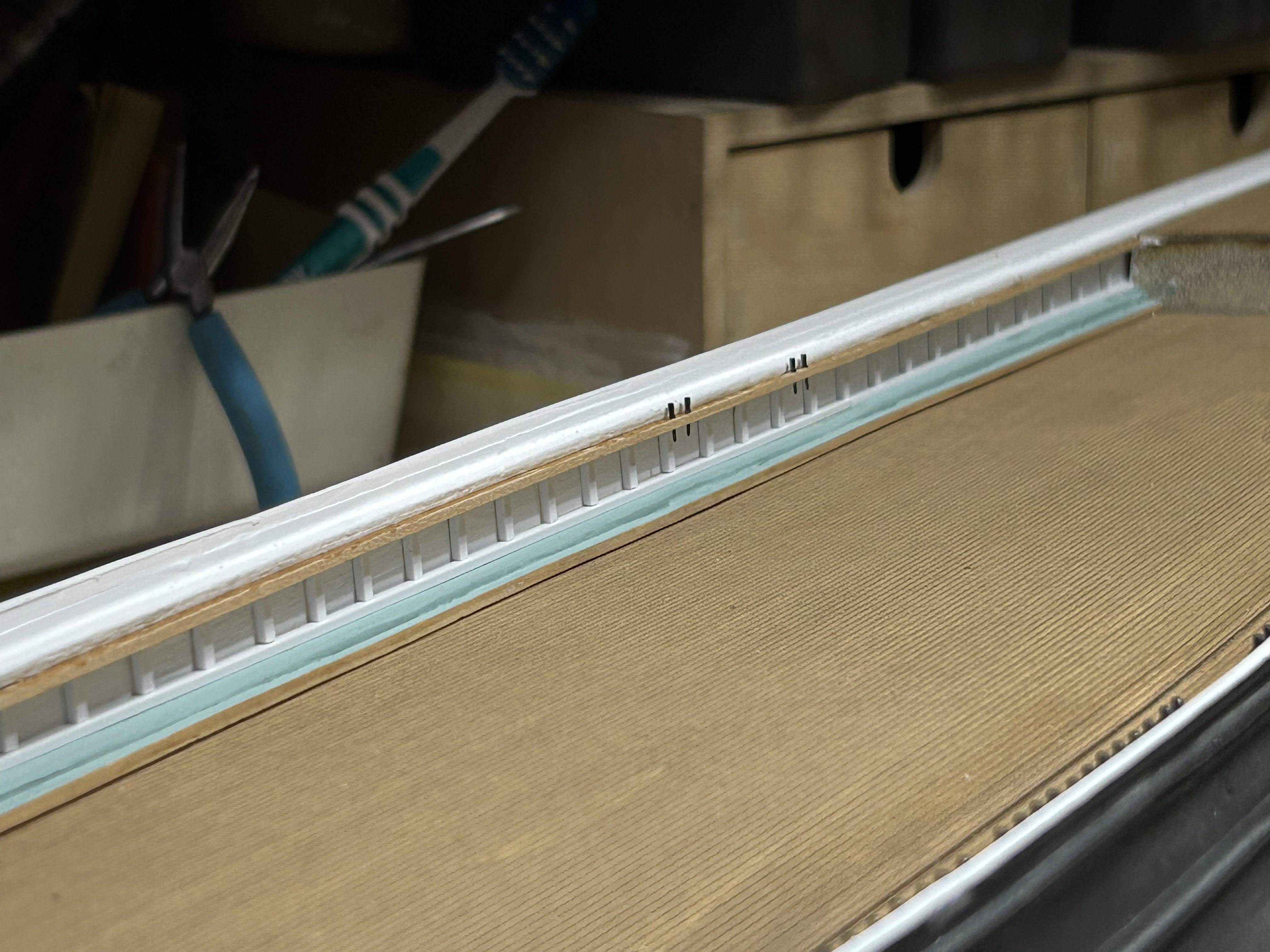

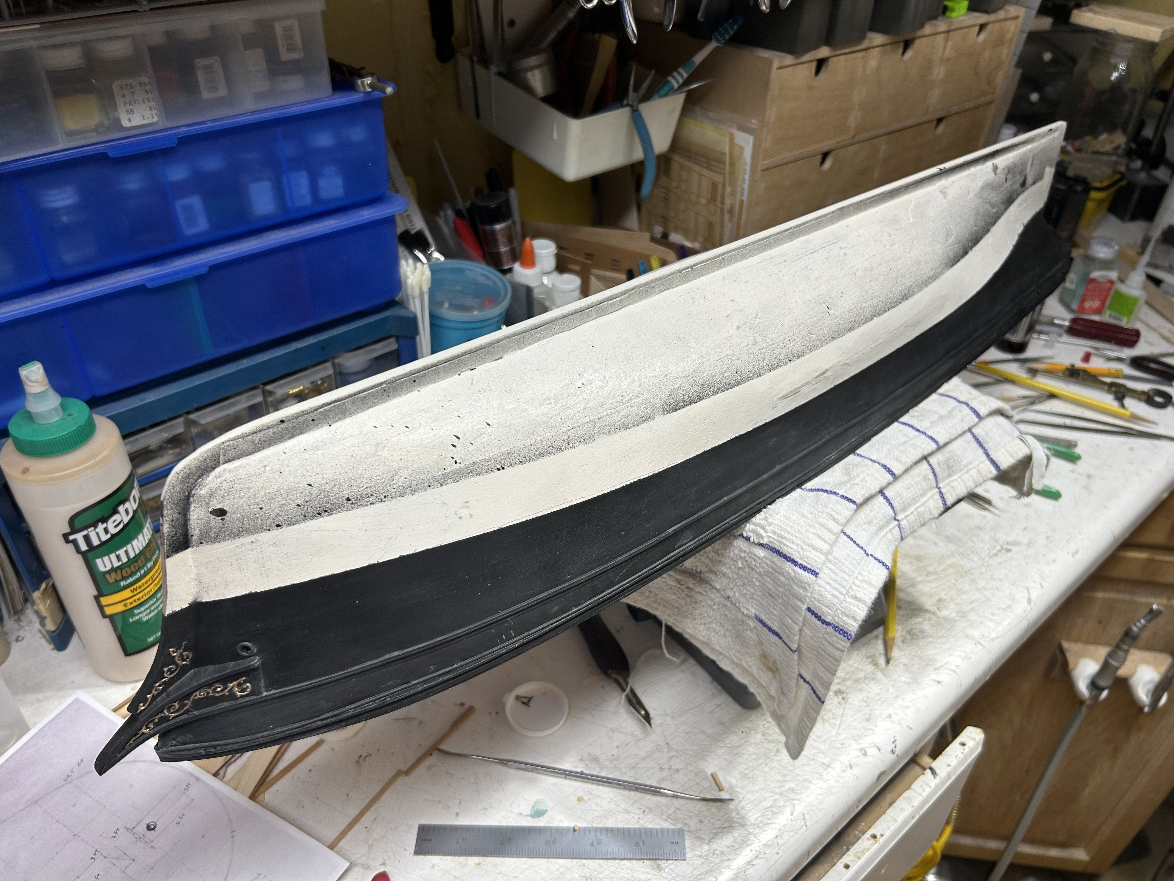

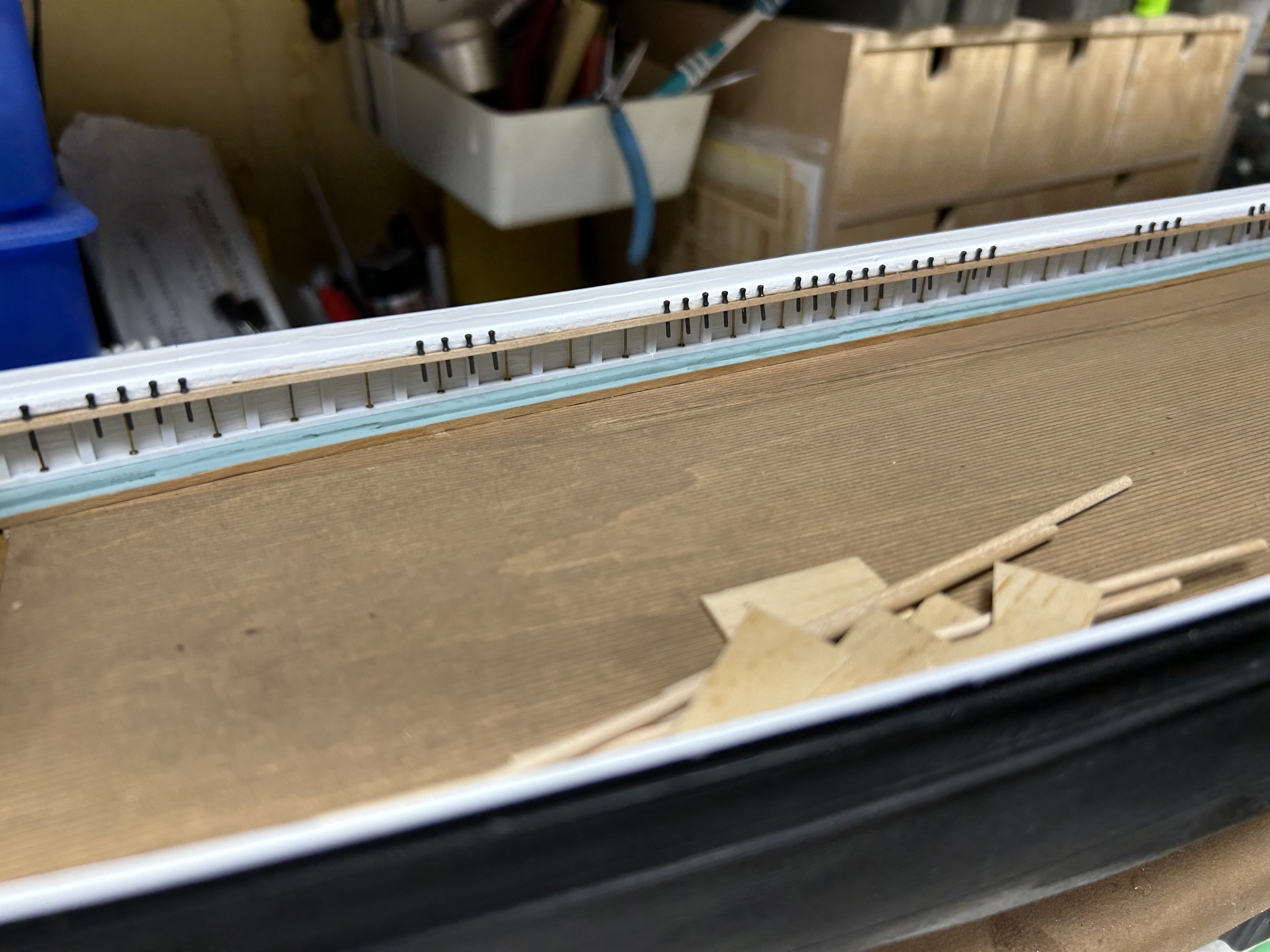

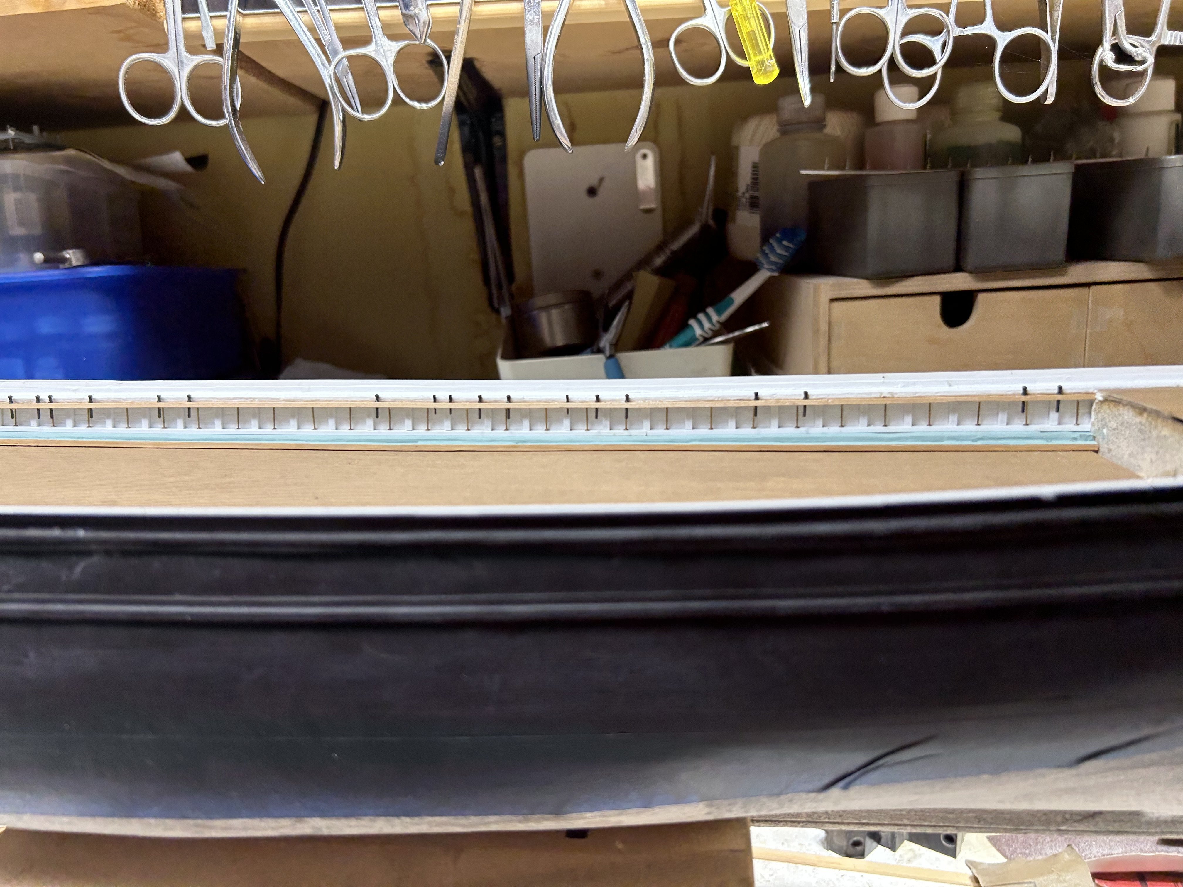

Finished vents.
Looks like it’s time for copper.
Rob

Readying  for copper.
Rob
