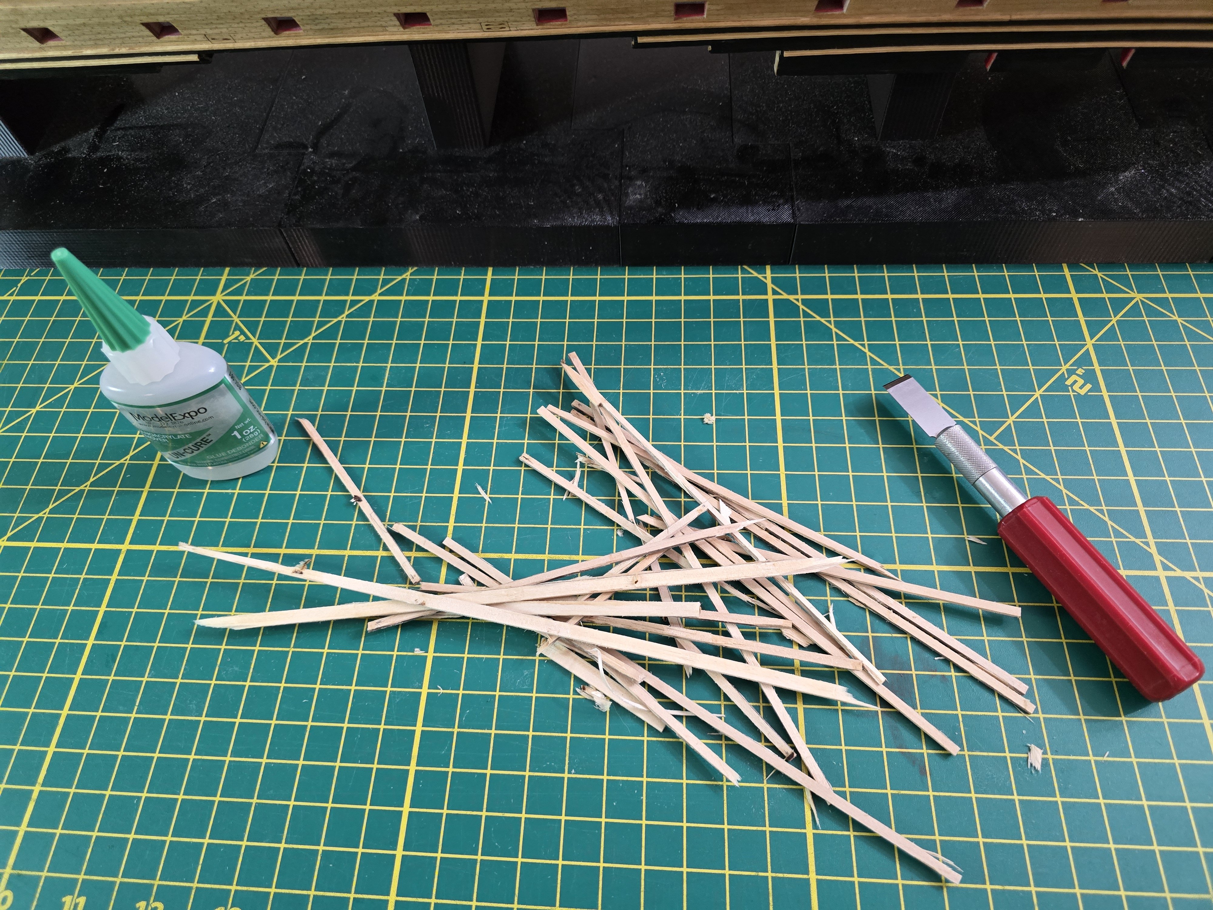

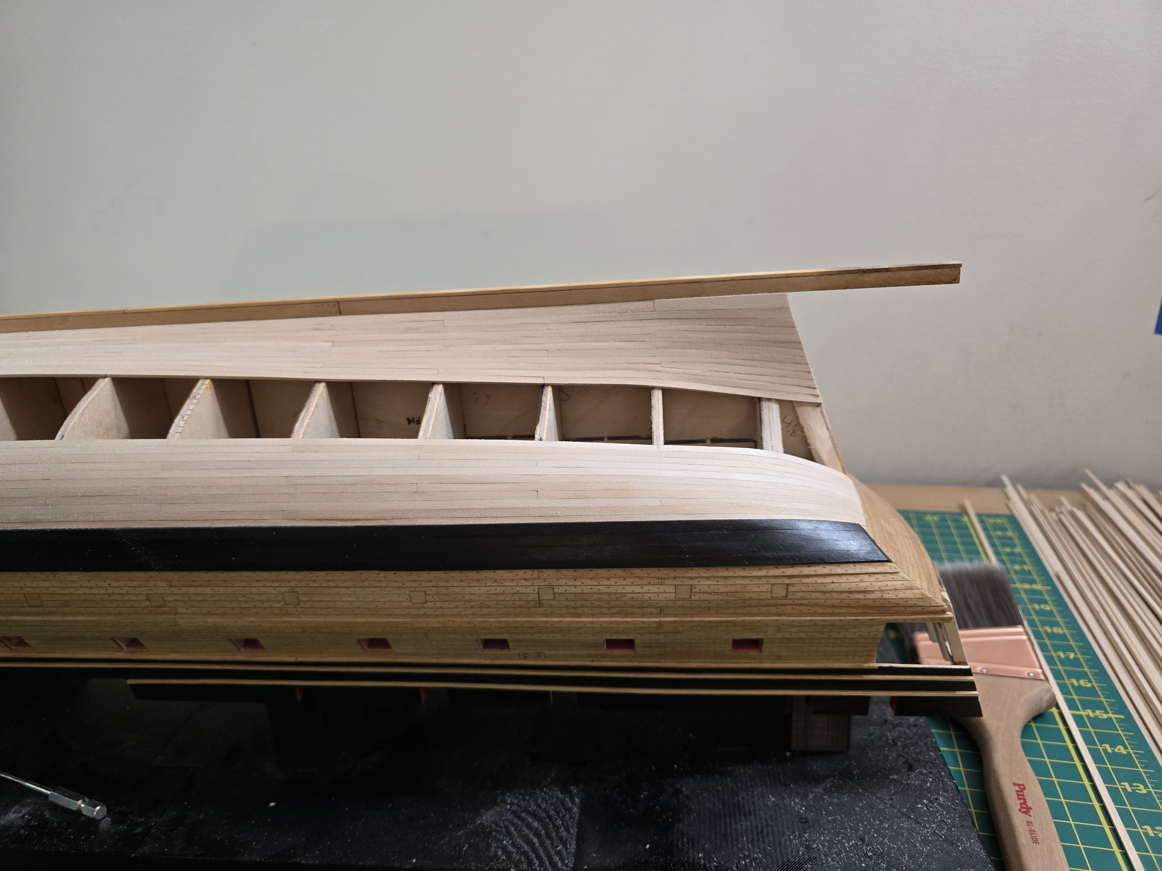

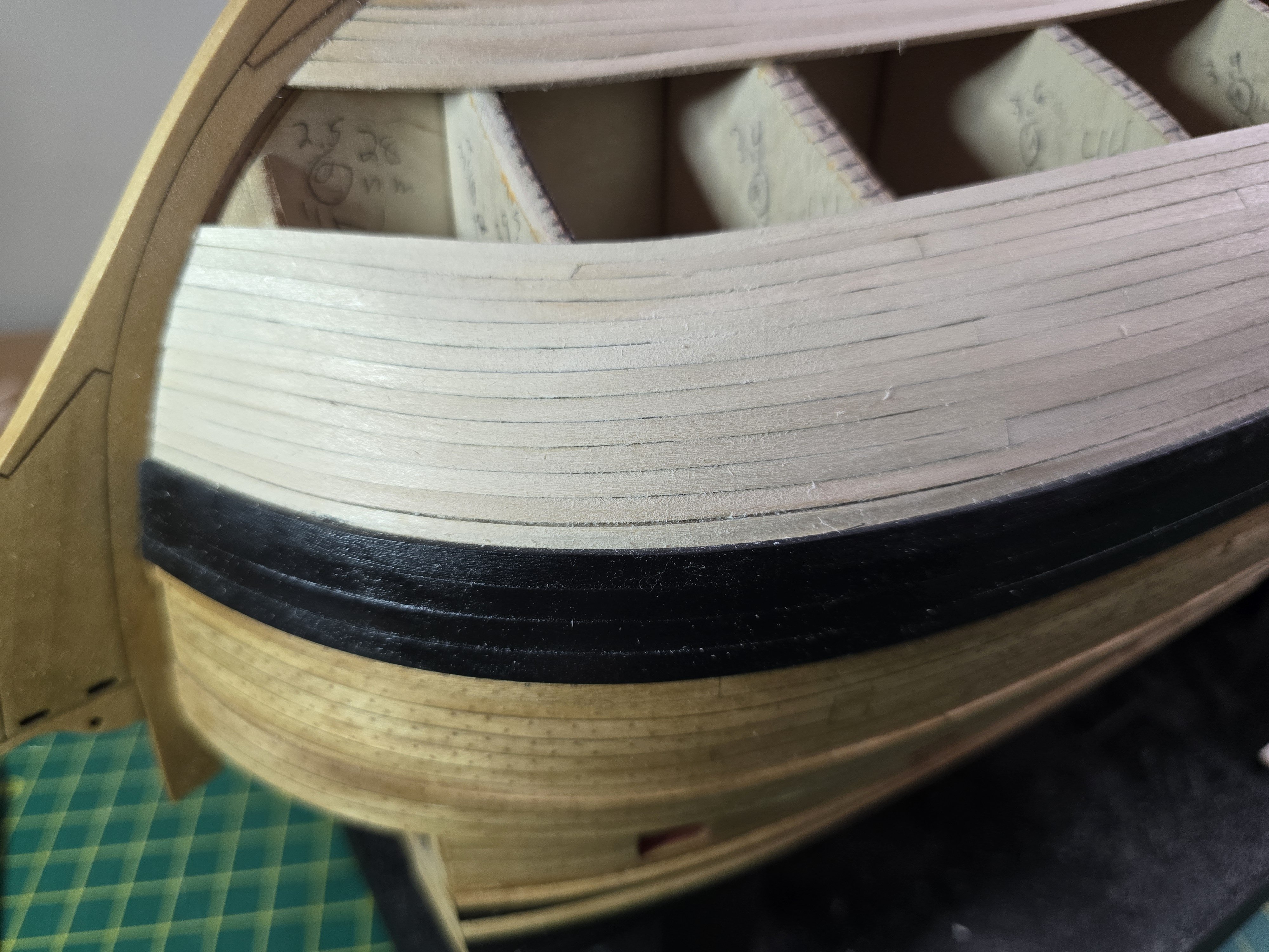

So I have some bad news.  I was half way done with the second belt on the starboard side and I wasn't satisfied with it at all.  At the bow, my second plank after the garboard was way too thin.  This caused a bigger curve than what it needed for subsequent planks.  After 4-5 plank rows, it curved up way too high at the bow.  Im sorry I forgot to take pics of what I mean.
So I tried to remove some of the strakes at the bow.  Because they were all connected together, this was the outcome.
I ended up having to remove all the planks on the second belt for the starboard side.  This also includes the garboard as well.  Thats a lot of work lost that I have to redo.
It's very upsetting to have to do this, but I really didn't have much of a choice.  Because of this, I might have to order more wood strips from Model Expo.
Im waiting for the de-glue to dry before sanding off all the excess wood still attached to the bulkead formers.
I'll give an update once I start the stsrboard side again.

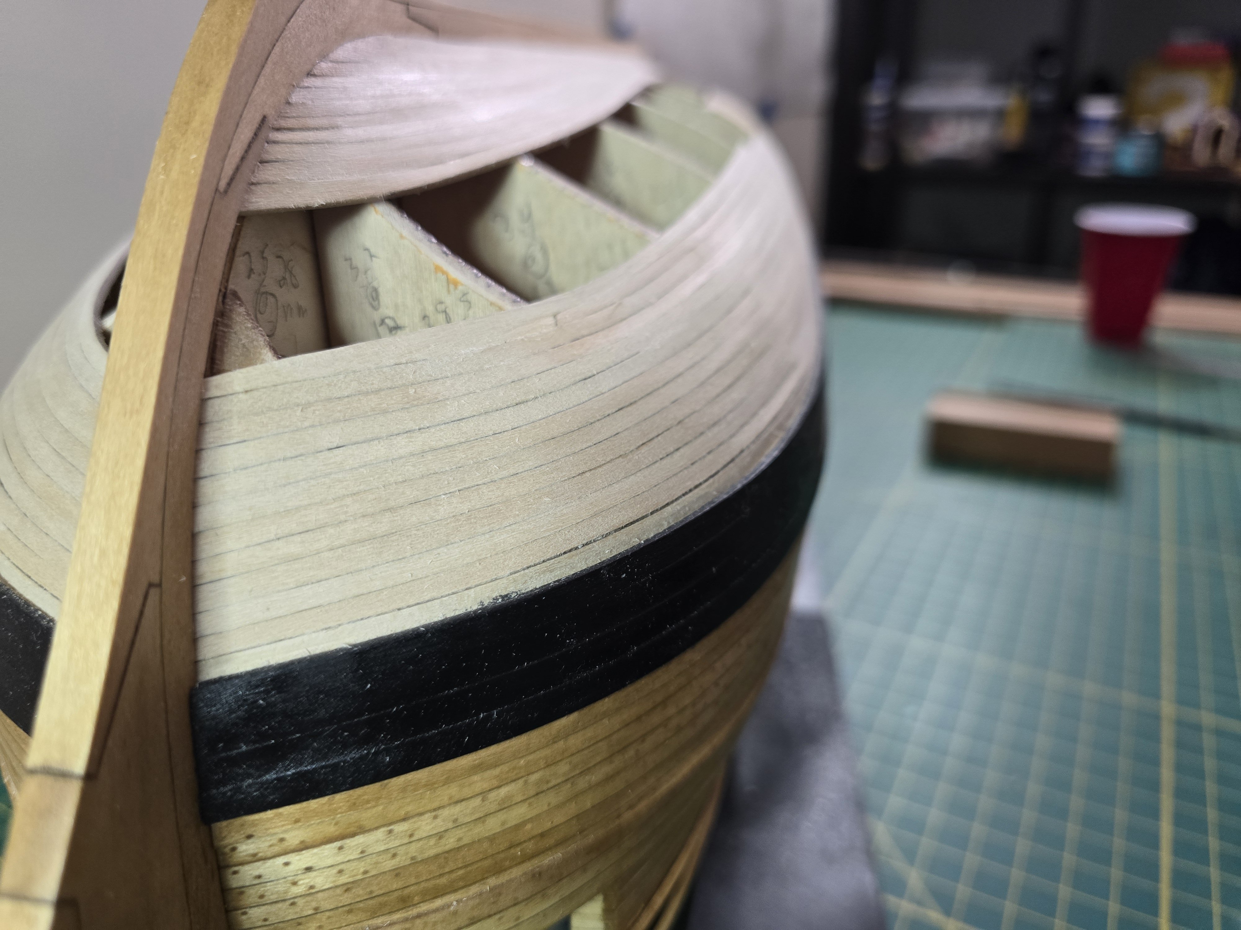

Hey all!

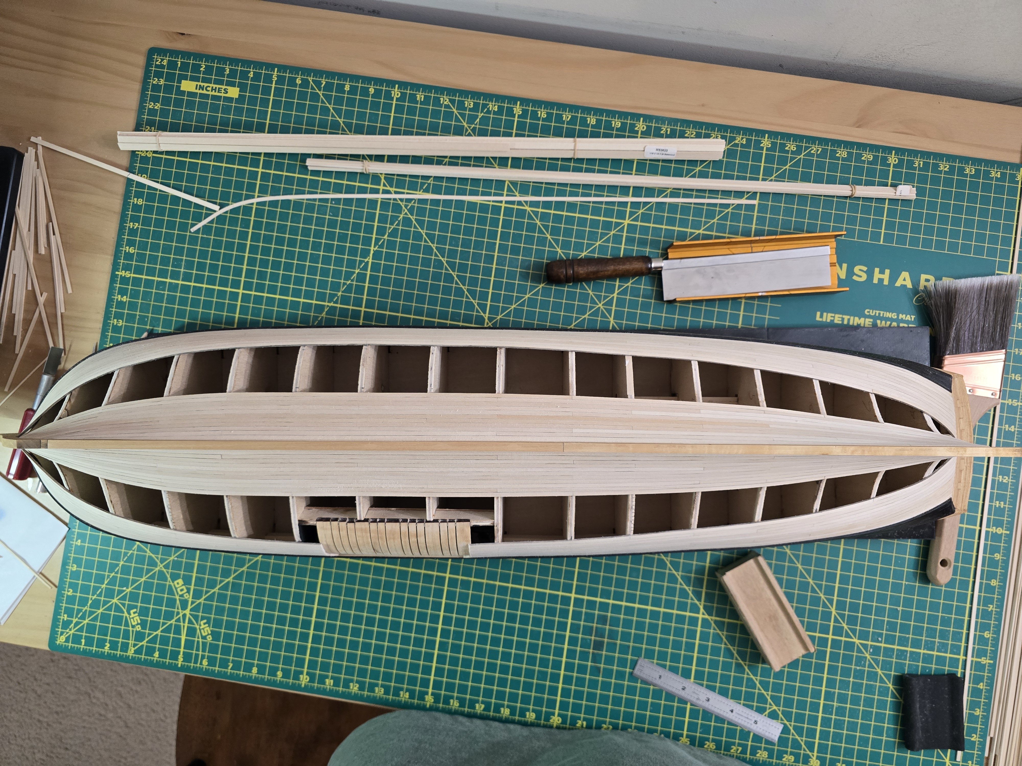

Finally finished the second belt!
That sure took a while.  I'll share some pics.
20250626_221551.thumb.jpg.91184e31c53ed5fe08f9e5c98f3ebf4d.jpg20250626_221557.thumb.jpg.2ac19e612c6eb974985bb88ec5608c2f.jpg
I realized after working on the keel, that getting the correct angle is difficult.  I haven't measured for the 3rd belt yet to figure out the widths of the planks, but I hope I did a good enough job on the first 2 belts so the 3rd goes on alright.
I haven't finished sanding and filling some small areas yet, but I will do that after the third belt is complete.

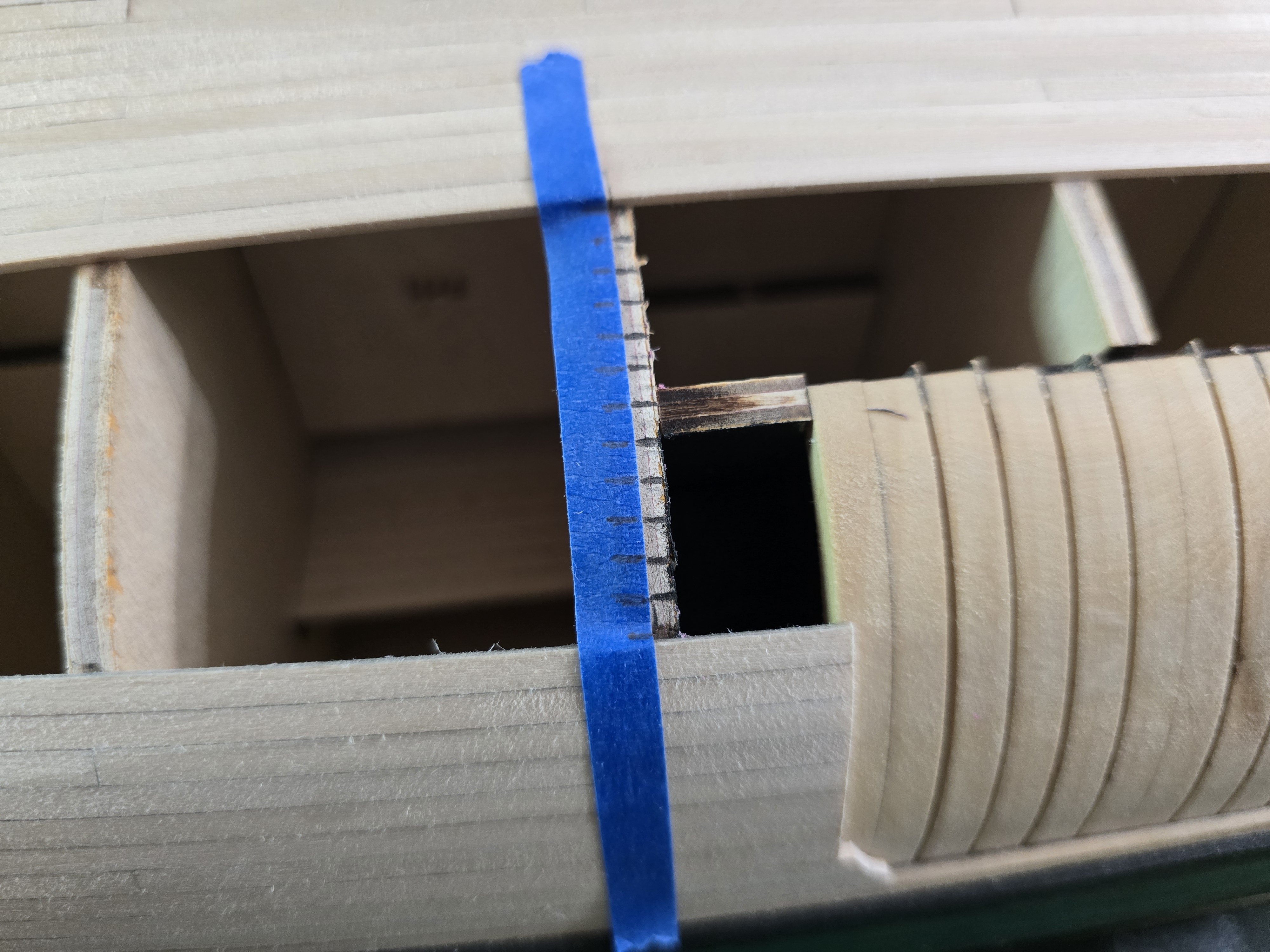

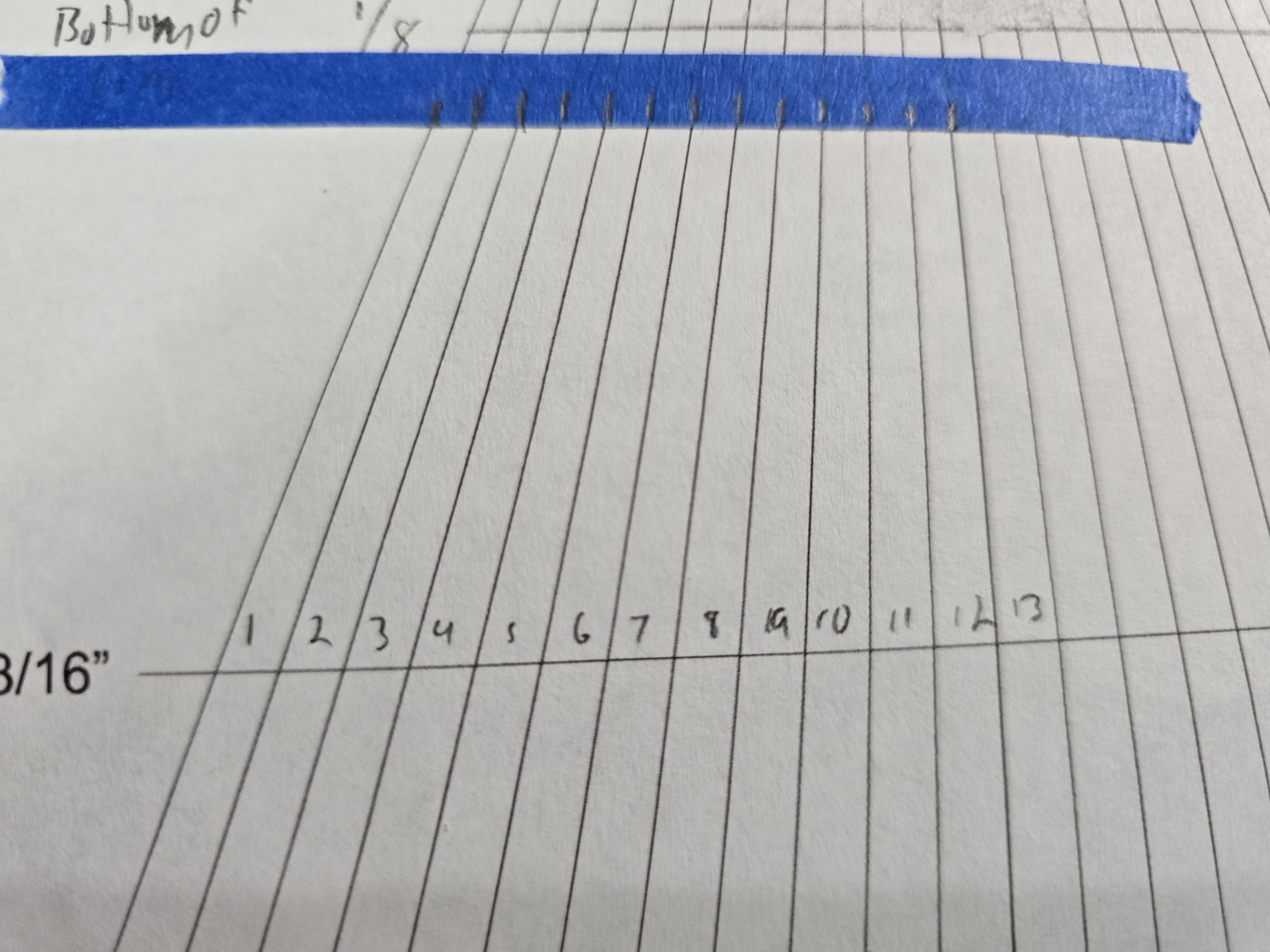

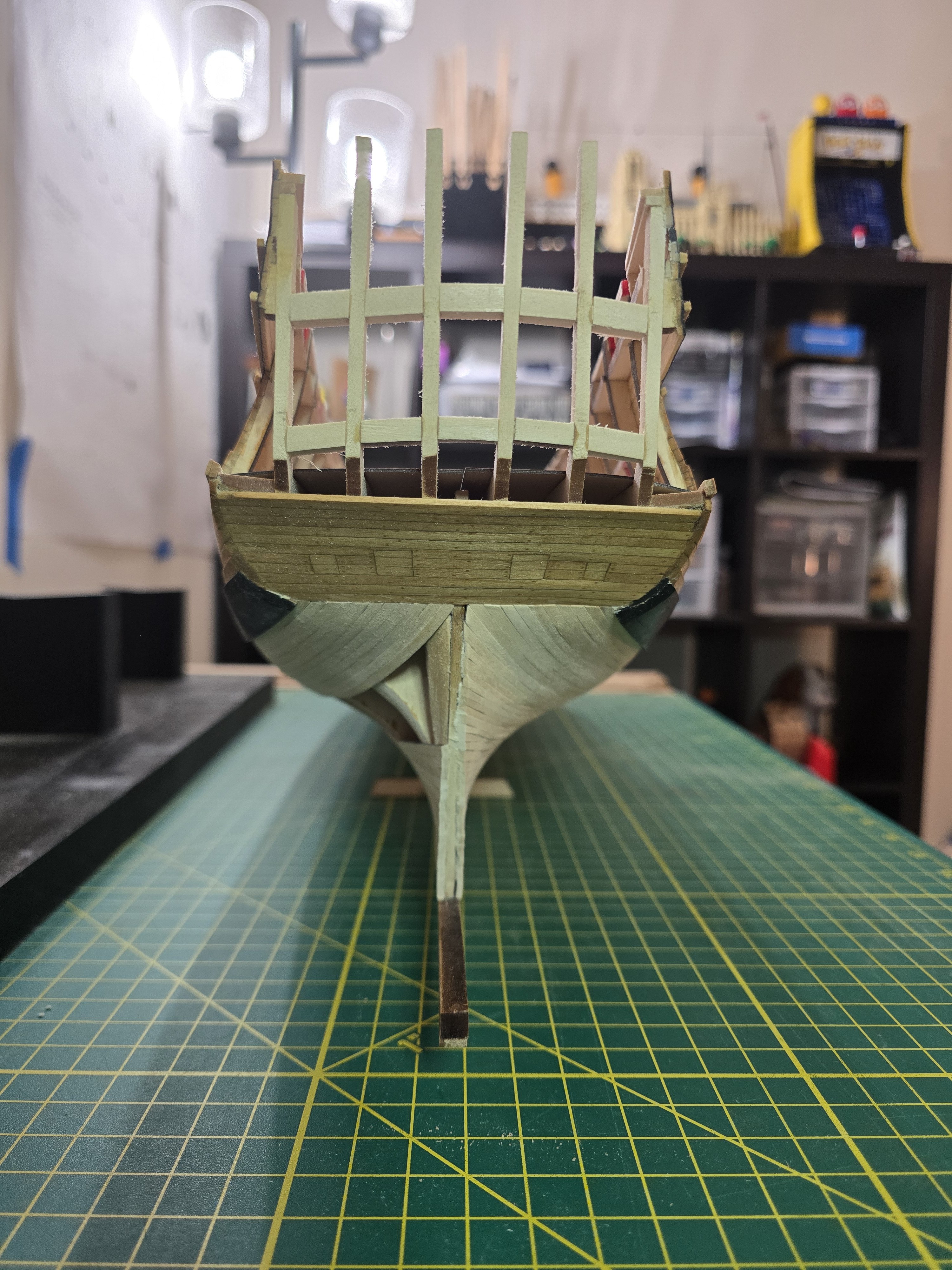

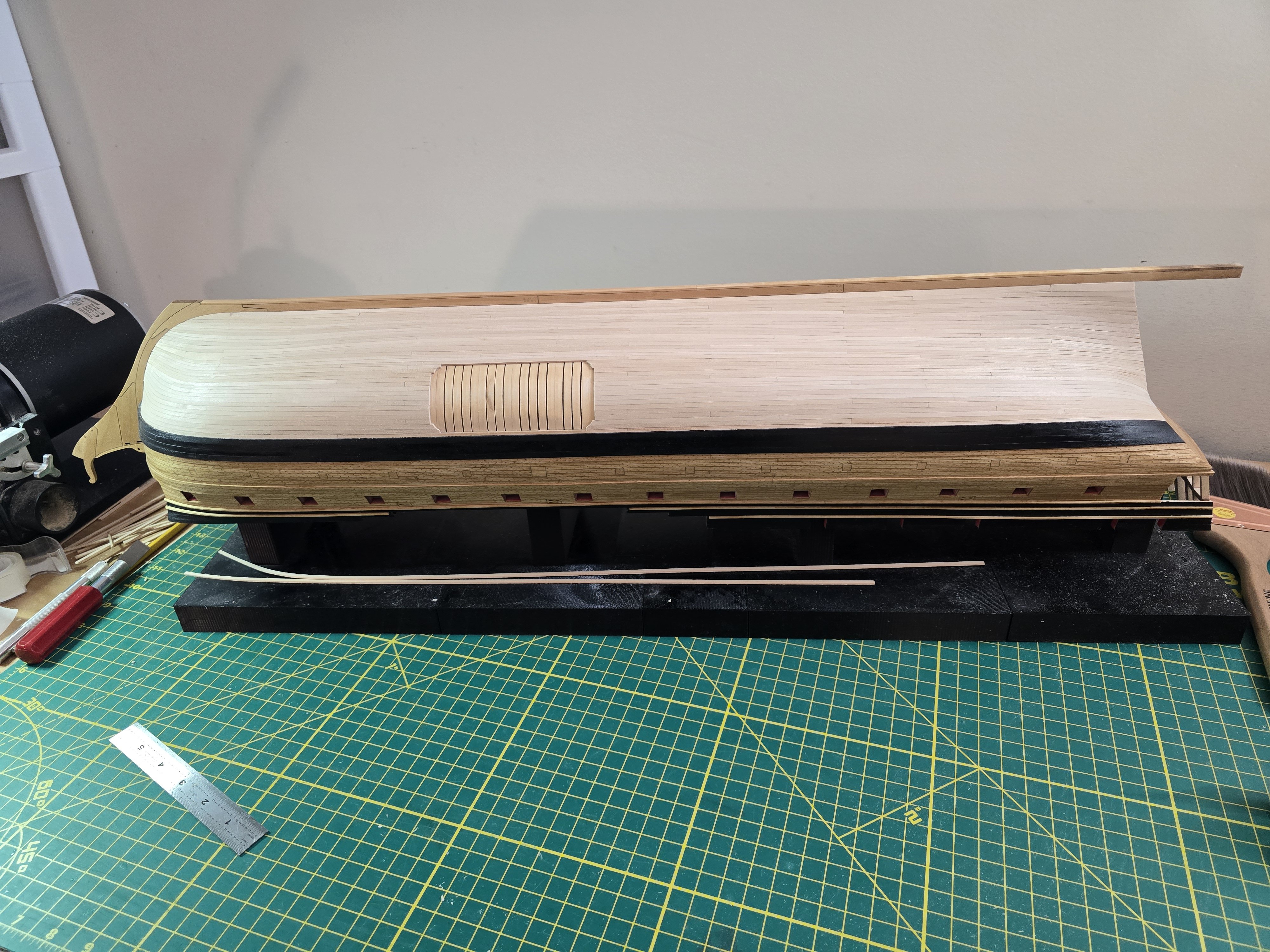

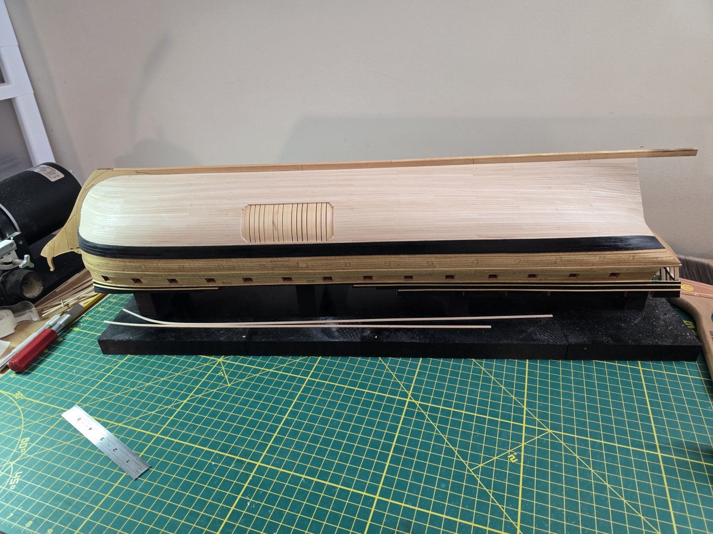

Hey all!
I started on the 3rd belt finally.  I'm starting this belt differently than the last two.  First off, I measured the area of planking at each bulkhead.  I then took the biggest and smallest bulkead areas and figured out how many planks I would need to fill both.
I figured out that I can use 12 rows of planks at the center, but at the bow, I would need 11 instead to not make the planks too thin.  I then made tack strips with painters tape for each bulkhead area and marked the hight of each plank.
20250628_221813.thumb.jpg.48264e058e4b96177ae4c582d7ff65f9.jpg20250628_221947.thumb.jpg.07f8660a2af09ee27f23ff868c876505.jpg
As you can see, I wrote down the dimensions on each bulkhead.20250702_222946.thumb.jpg.9b2253f0668811ece35462f6efbb3063.jpg
This took a while for me as there are quite a lot of bulkheads which is good.

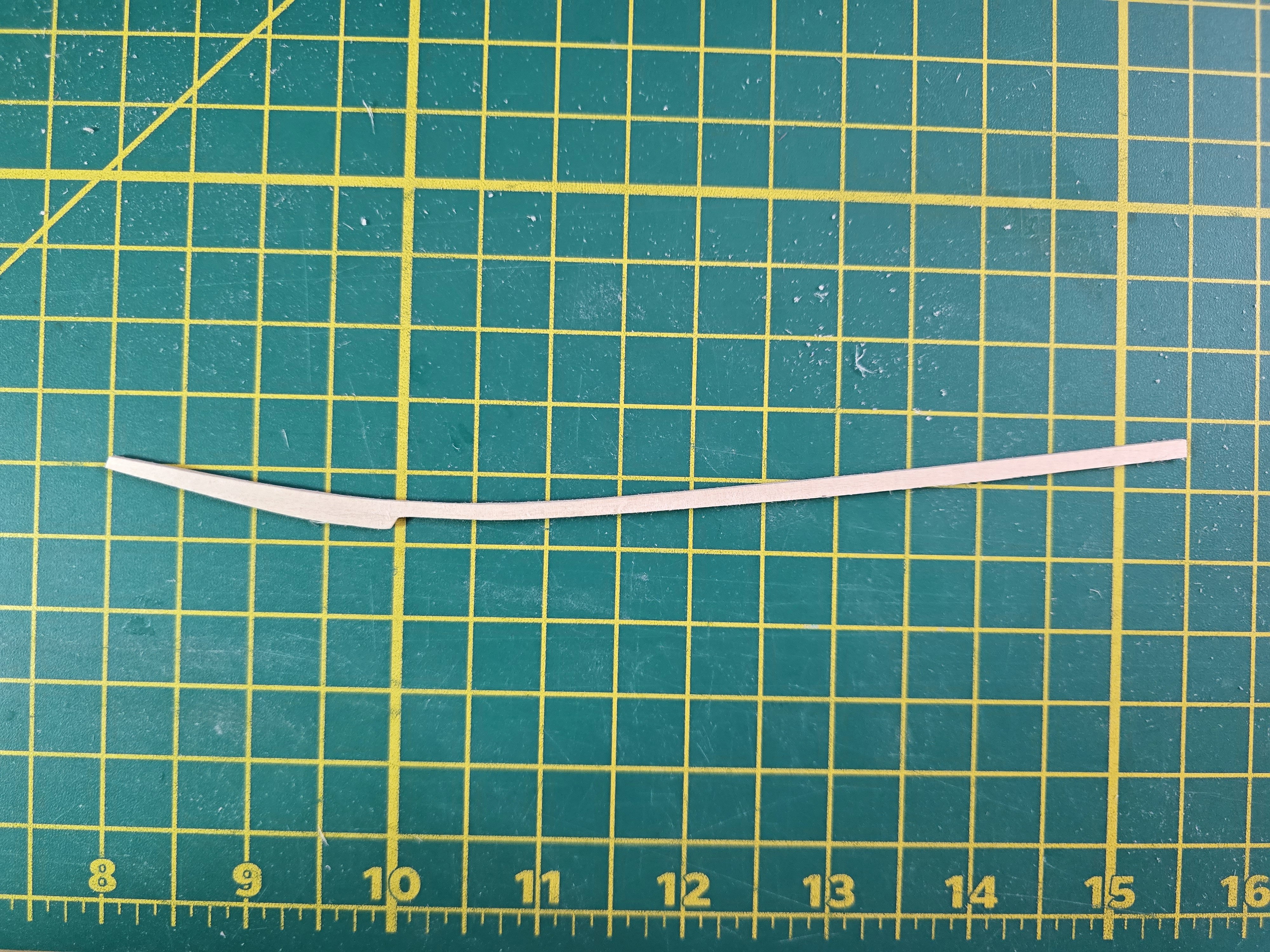

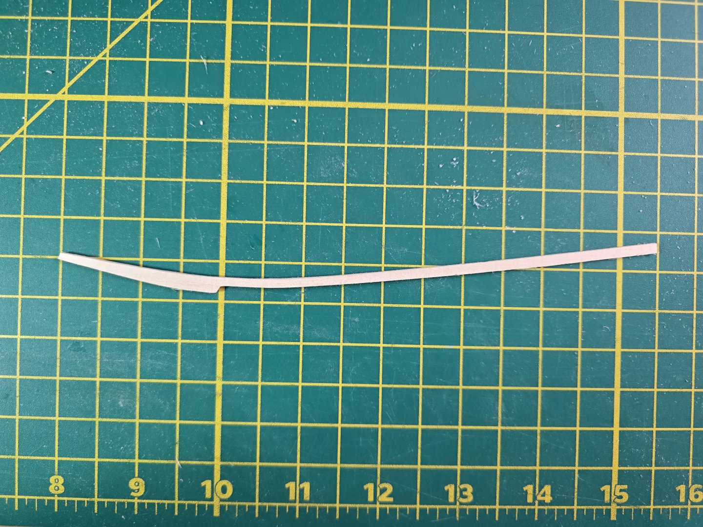

I then, at the bow, had to transition from 12 rows to 11.  So I followed the instructions on how to do that.
I first placed the first batten down as such.
Notice how it stops at the first real bulkhead.
I then had to make this piece.
This piece took quite a number of tries to make over quite a number of days.
Here is how it sits on the ship.
20250709_210558.thumb.jpg.36d89449496b6e5ad0f4a97df67c28d3.jpg20250709_210527.thumb.jpg.6e828dbb0bbf066bb86e6f610c195737.jpg
This was sure tough for me.  The hardest batten to shape yet!  I might be doing some sanding on the top of this batten when I start the next row.

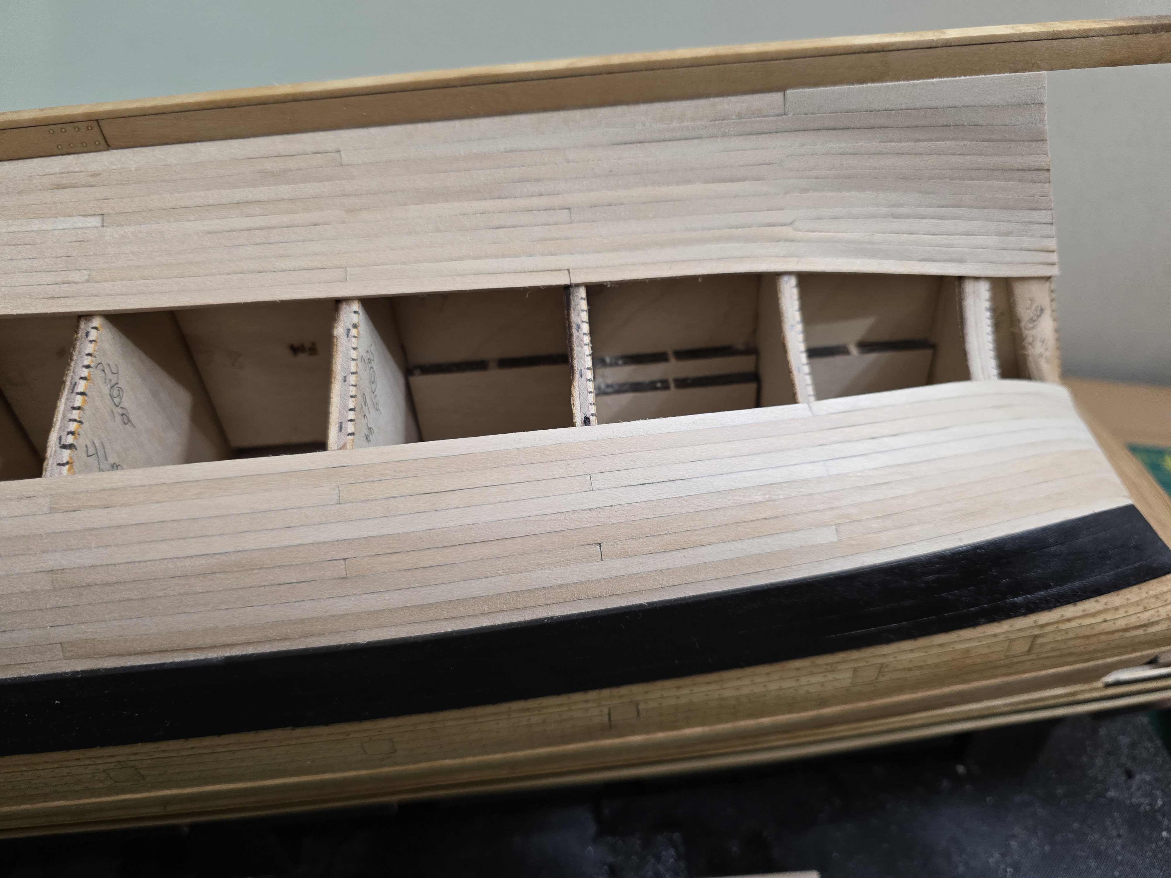

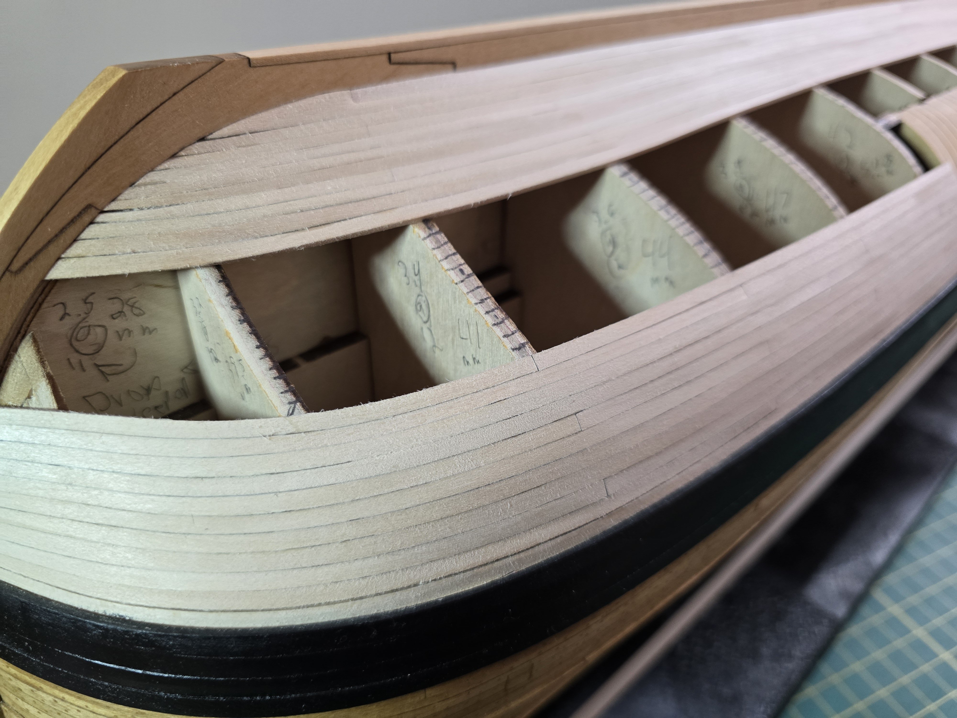

Hey all!

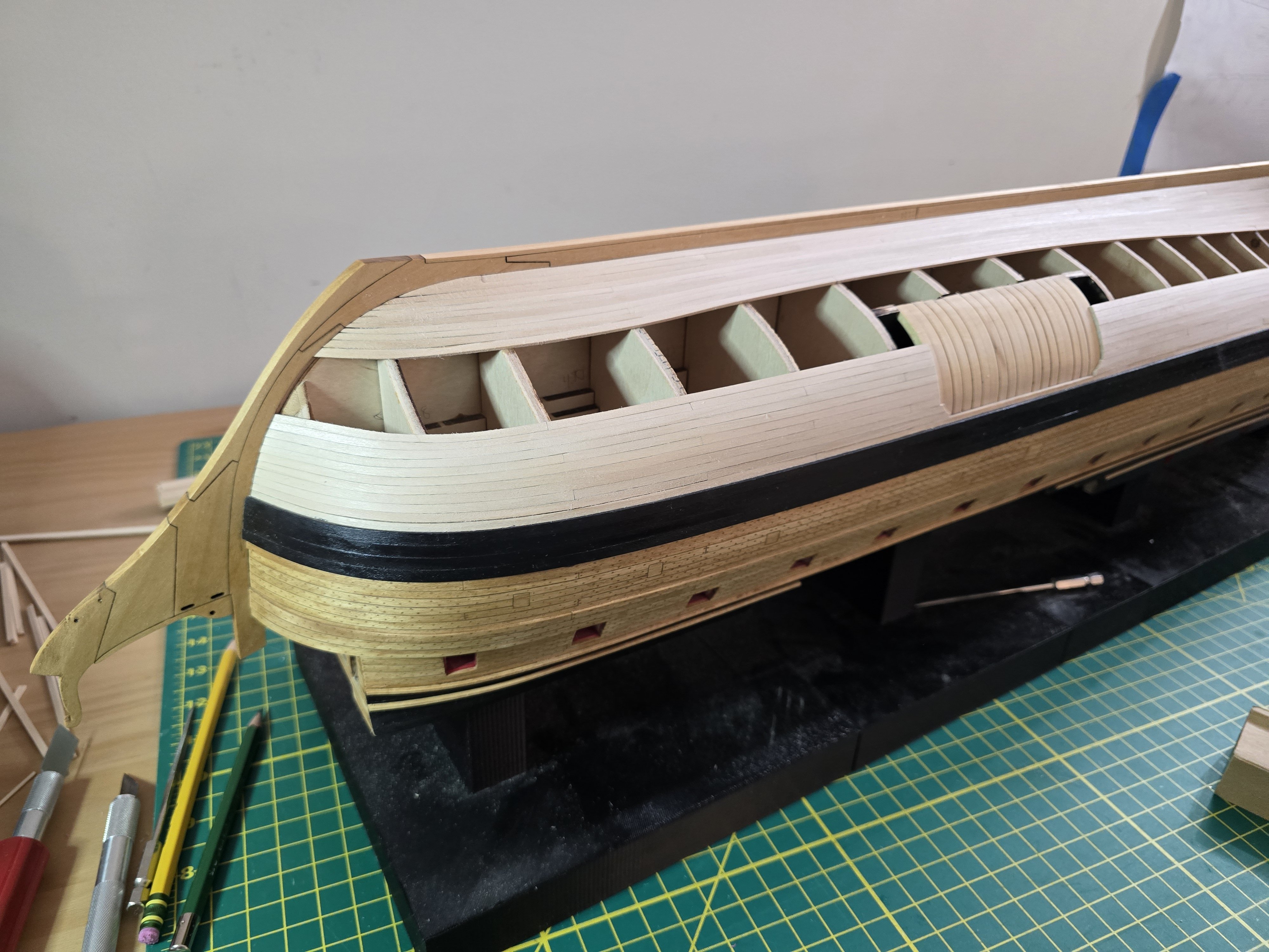

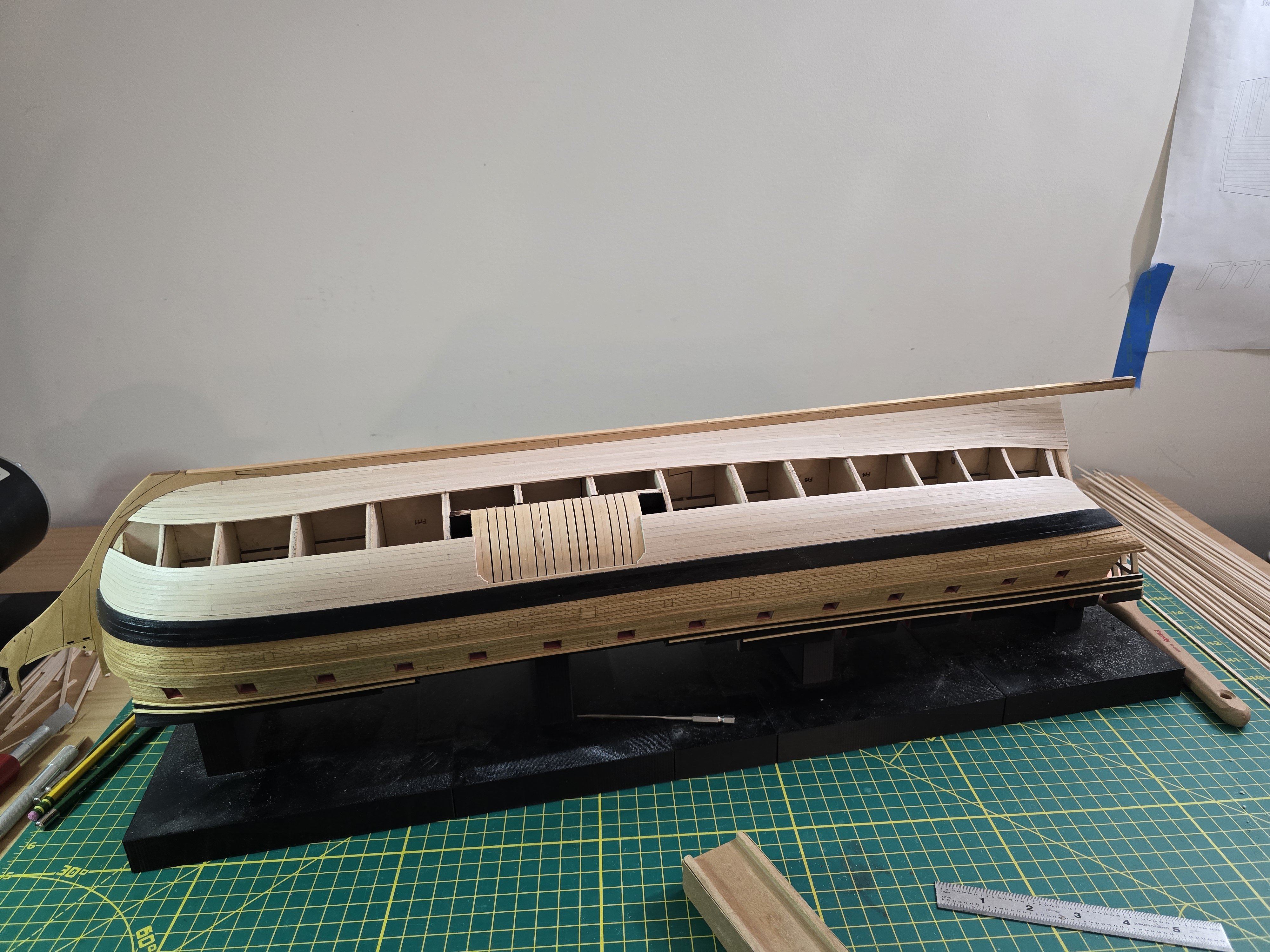

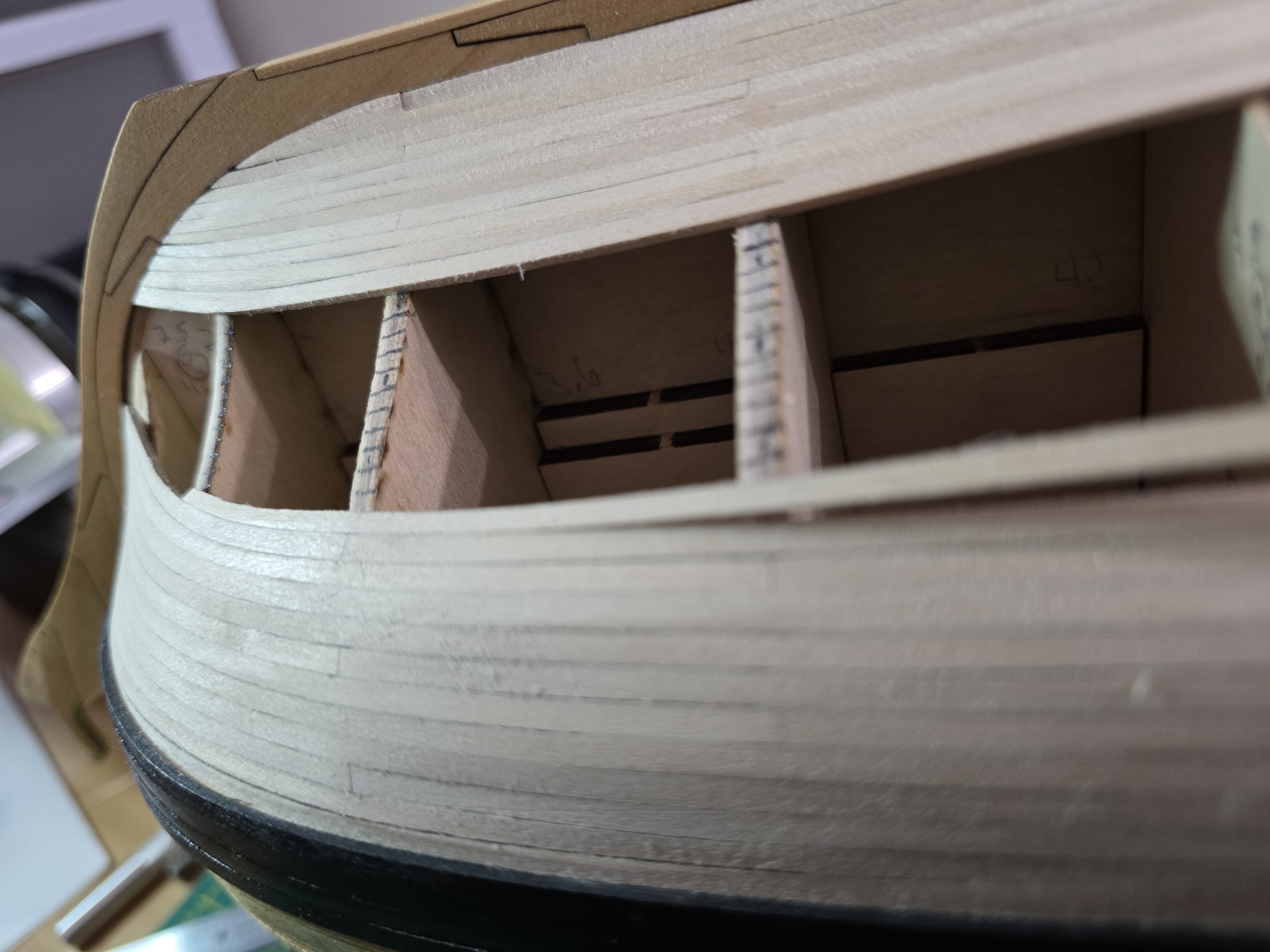

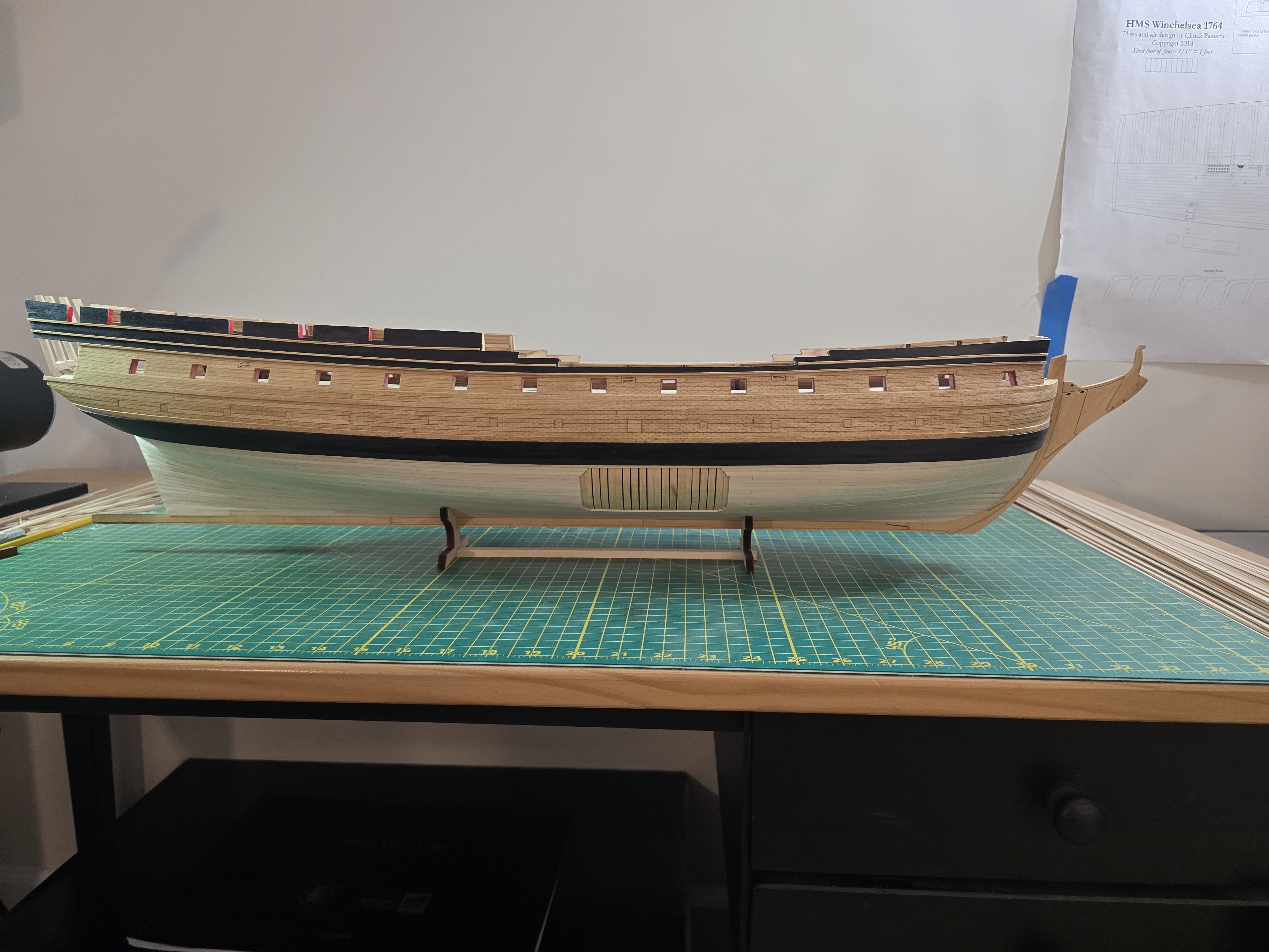

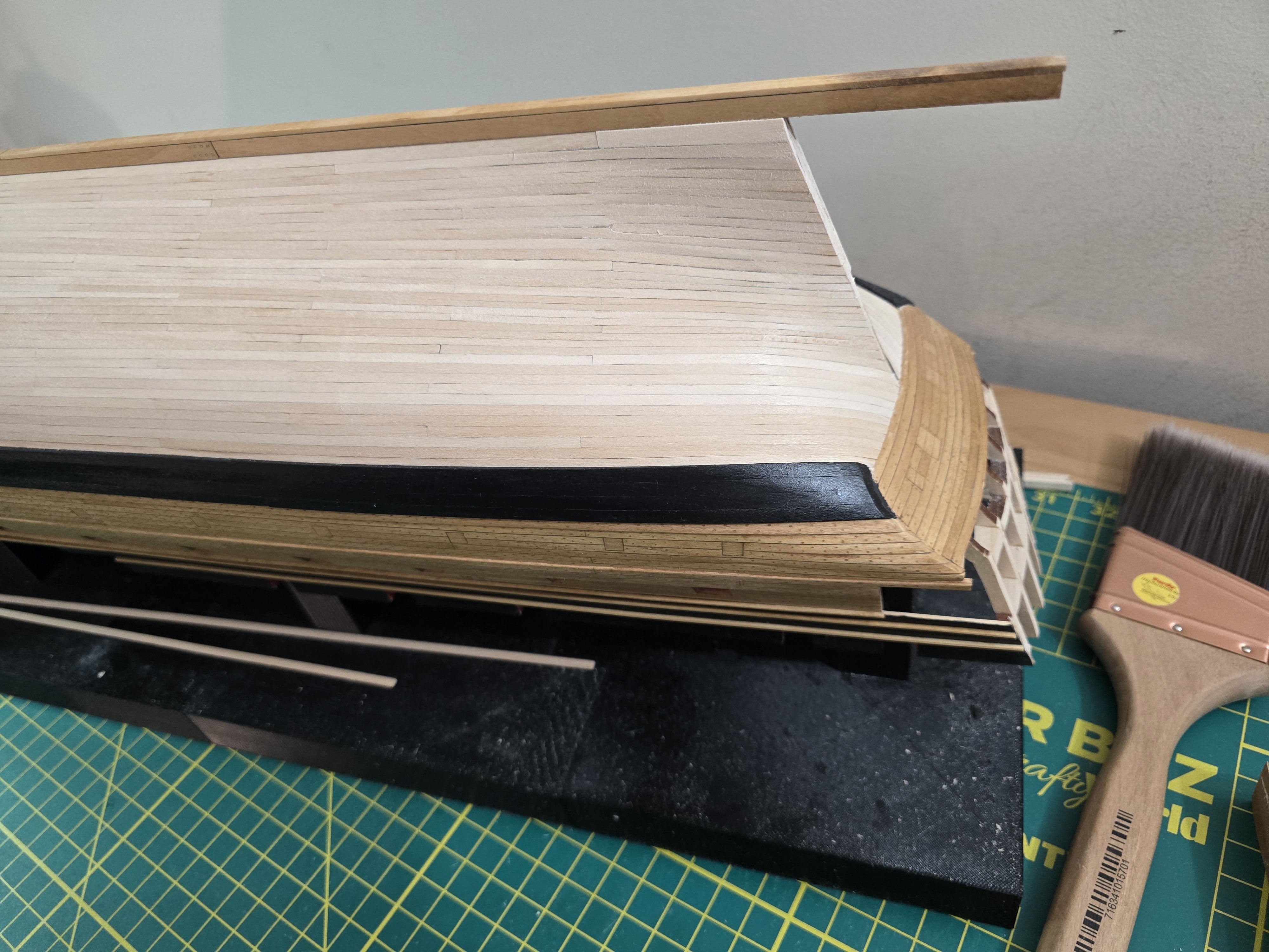

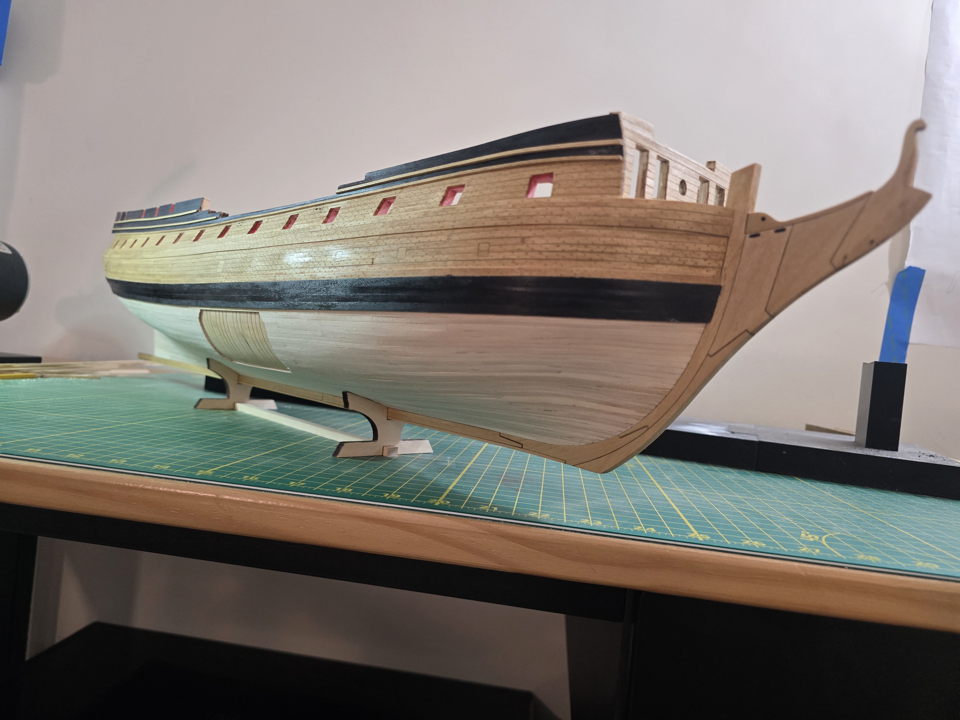

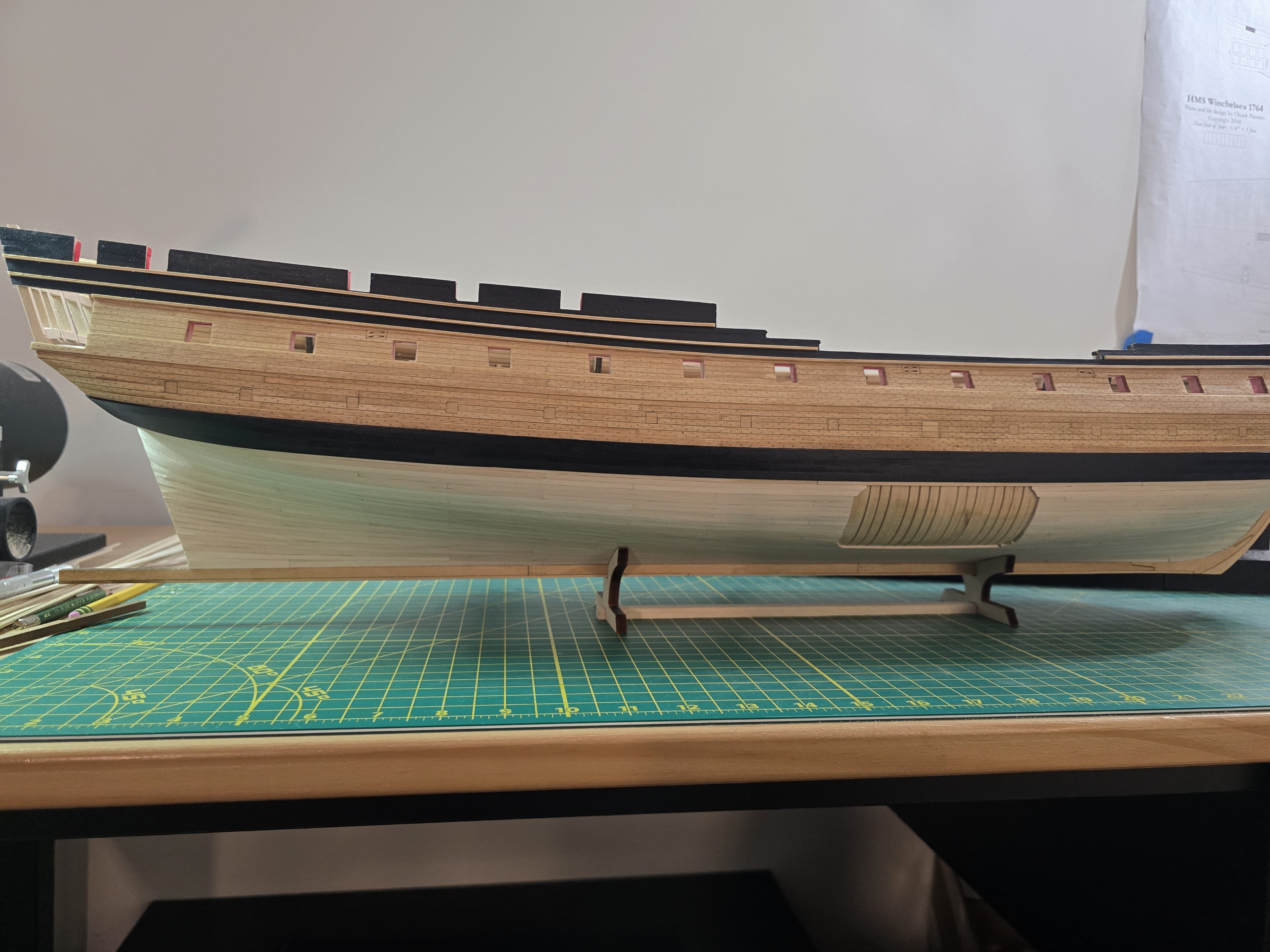

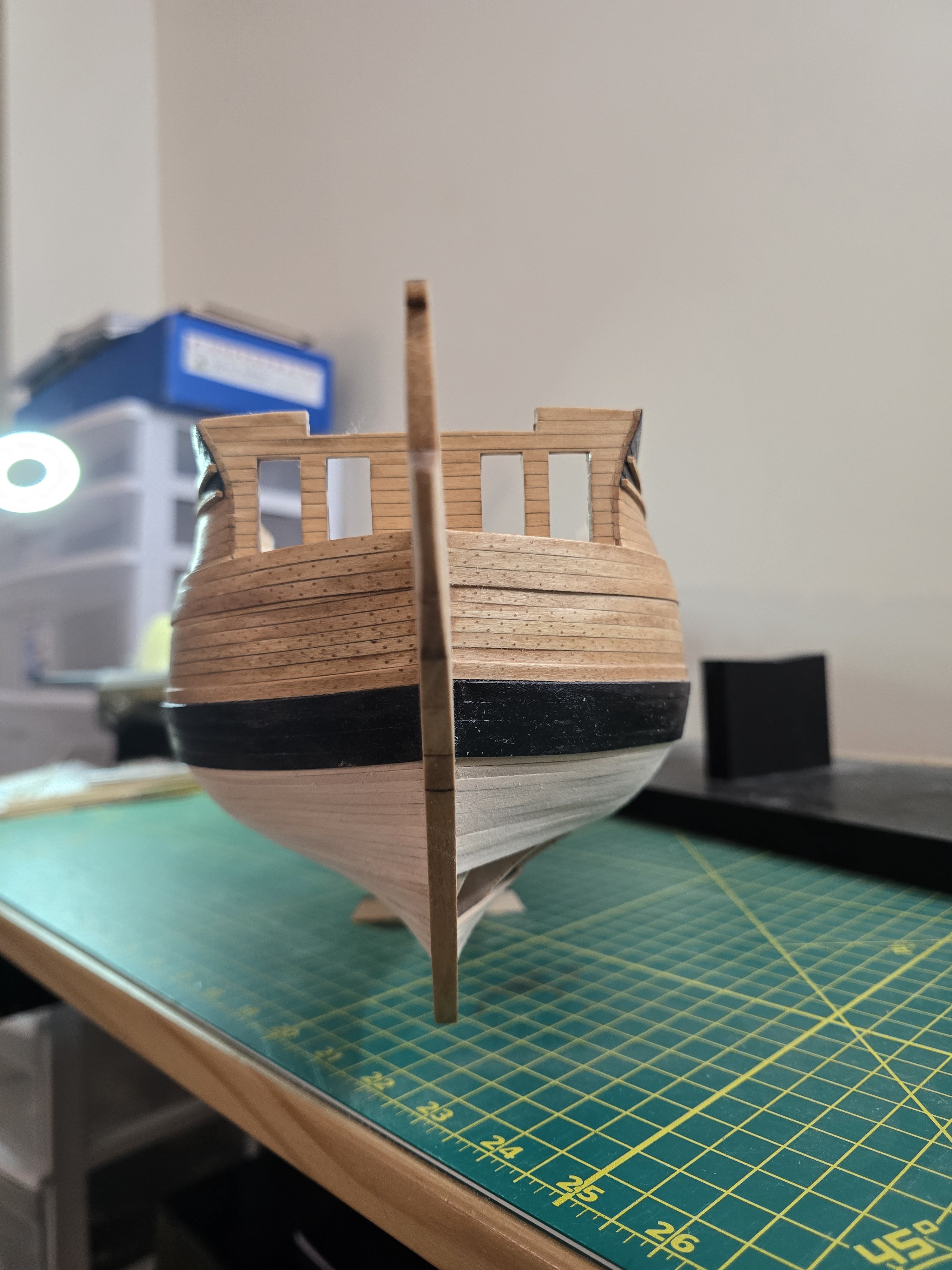

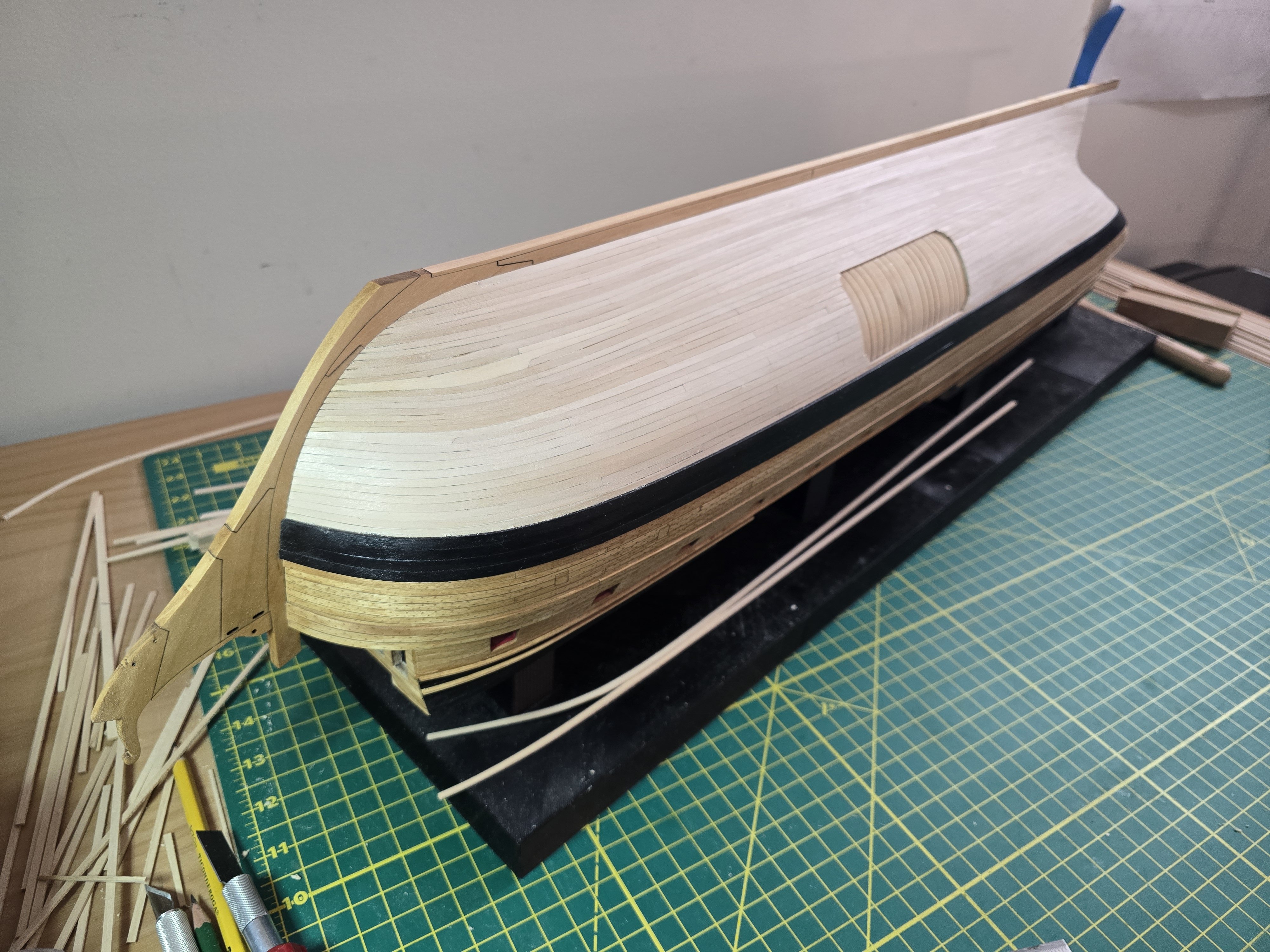

Sorry for the long delay.  Time has been short for me in the evenings with visiting family, summer, and other things.  But today, I finally finished planking one of her sides!
I also constructed the display stand for her and finally placed her right side up for the first time with one side planked. I have some sanding I need to do to even out some parts of the planking though.  This side is definitely not perfect.  No where close.
This was the first time I tried this method of planking the hull and now realized how to do it better for the next model I have to plank (Hint: The Cheerful!)
20250913_213111.thumb.jpg.c6c4aeac38259a3e5f18f6851428547a.jpg20250913_222522.thumb.jpg.1c983de60186acb356b477cb6503d455.jpg
20250913_222716.thumb.jpg.bbb3b7bdb9ff71fc6a827b74a98e6280.jpg20250913_222726.thumb.jpg.40a337f5987160bb6839d066d5e9a5d0.jpg
What a long planking process!  I do have 1 belt left on the other side.  Then finally some sanding and varnish.  Wish me luck it takes me less time to do the other side! Haha!
To be honest,  I'm getting planked out!  This process, especially on the USF Confederacy,  is a lot to plank.  This isnt a complaint about the model at all.  I think the width of these planks fit perfectly with the model and really do the ship justice.  Other kits use wider strips so less rows to plank.  But I think these thinner strips give it a more authentic look.
Thanks everyone for checking in!  Onto the last belt section!
