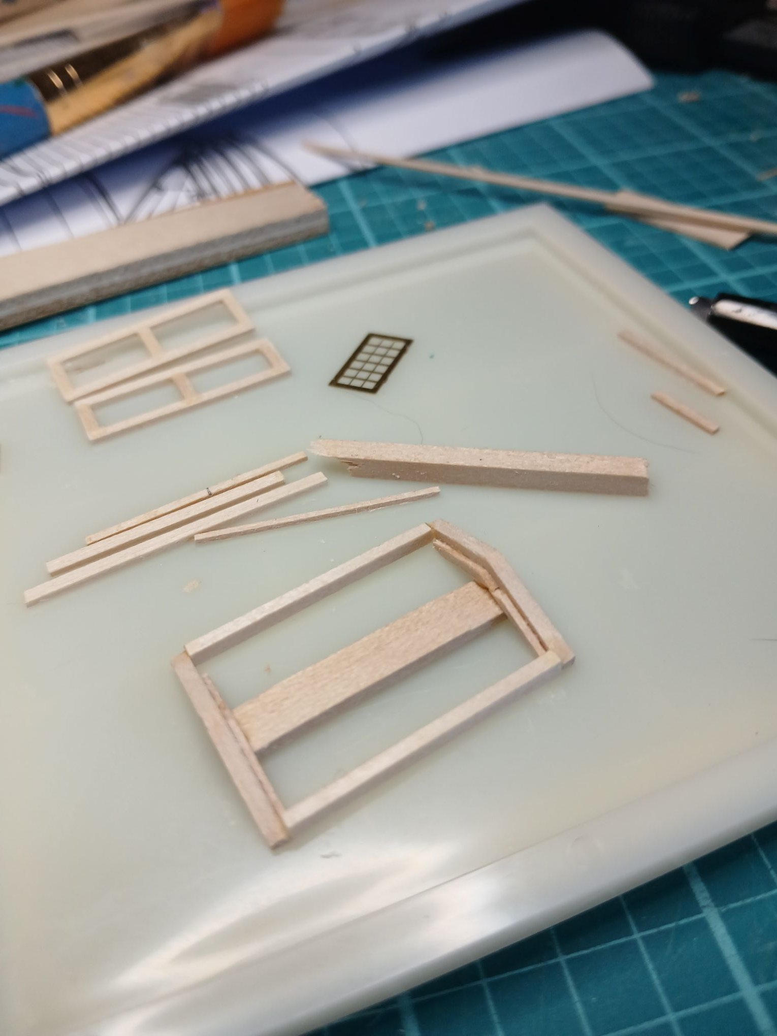

Pictures from the when the America was at the Naval Yard clearly show the large skylight was rectangular panes, not tiny windows as the etched parts have.  In fact the skylight from the America is in the Mariner's Museum in Newport News.  This is the great thing about this build, so much historical data available.  So while the brass guards on the panes might be hard in this scale, I'm at least going to match the 5 pane design, just not sure how yet.

Well that worked out in the end.  A little more cleanup and after finishing I'll back the windows with parchment paper or something similar.

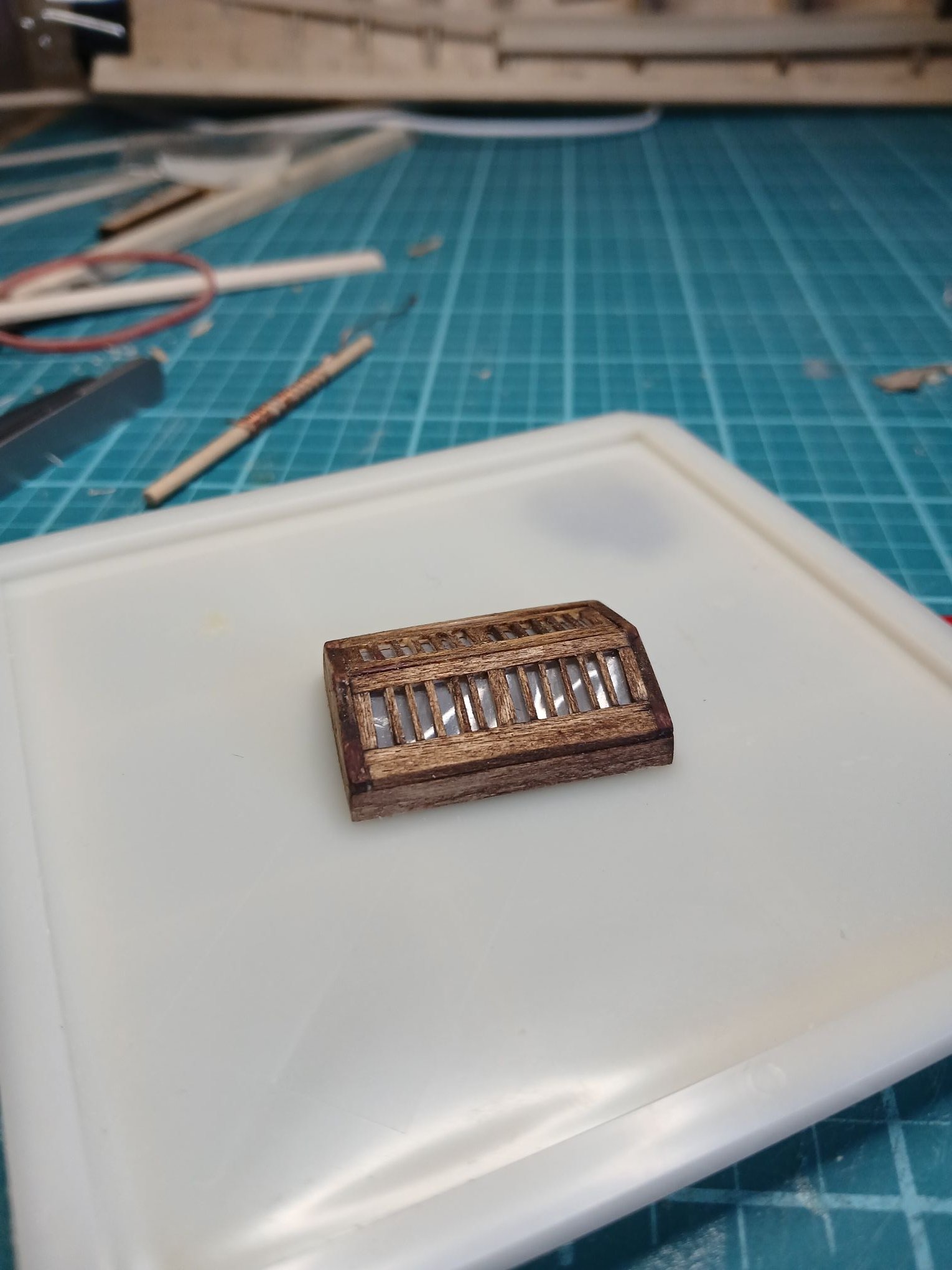

 The skylight turned out very nice, great job. if you wanted to give the skylight the look of glass you can cut thin clear plastic from processed food containers. I've done this a number of times and it woks really slick. You have to do all the painting or staining first and once that is done just add a tiny dab of CA on the inside corners, only doing two corners will work to hold the plastic.  Just add enough CA so it doesn't smear onto the visible area.

Thanks for the tip, I'll try that.

I tried some thin wrapper plastic, and streaked it with some grey paint.  So not clear, but it has the shine of "glass".

 That looks fine but were you not able to come up with some thin clear plastic just to see what the difference would look like?

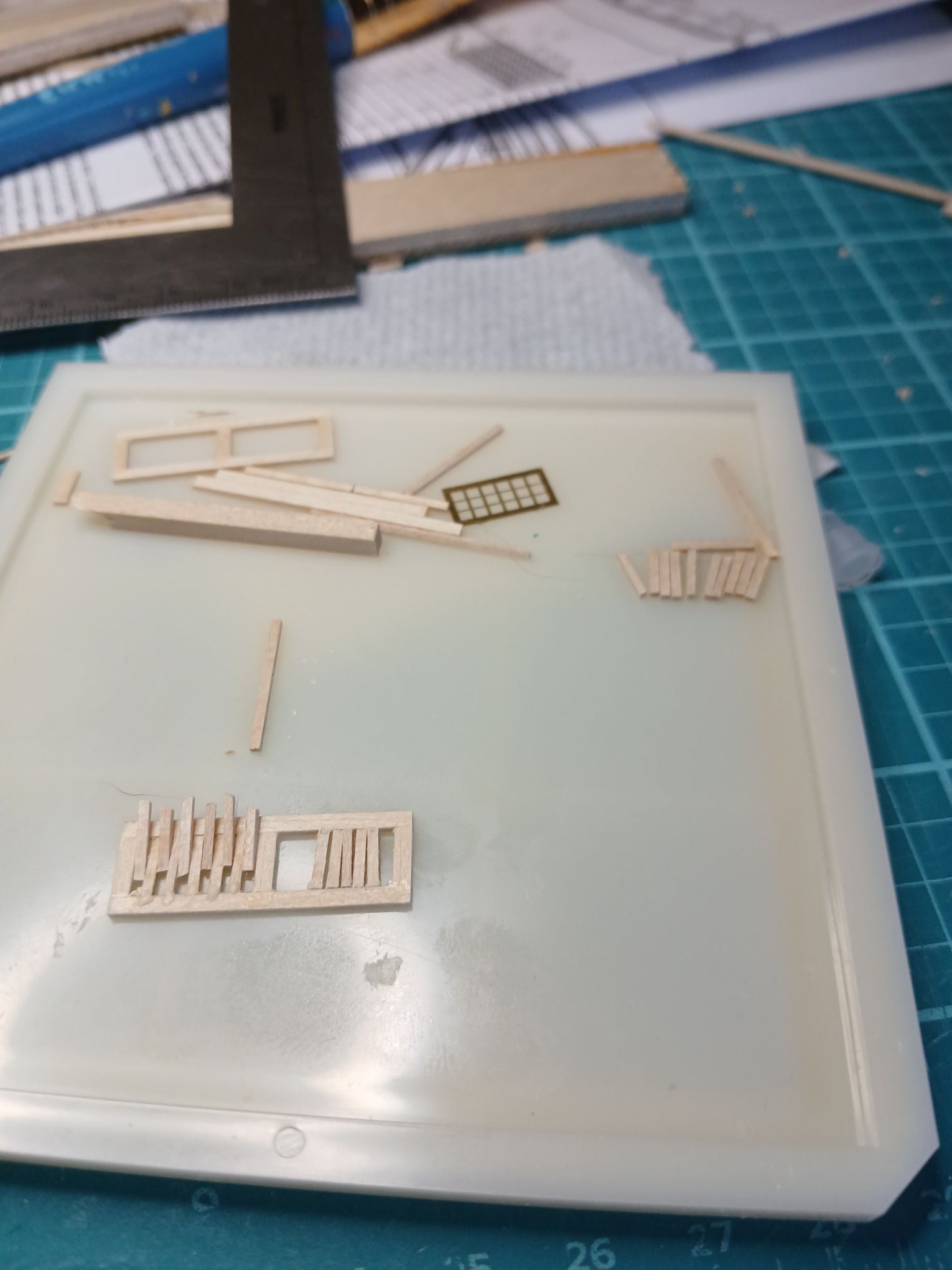

This one took a while to figure out, eventually I got a center post to support the frame rails and glued in place.  Then I was able to sand them down and add the cap.

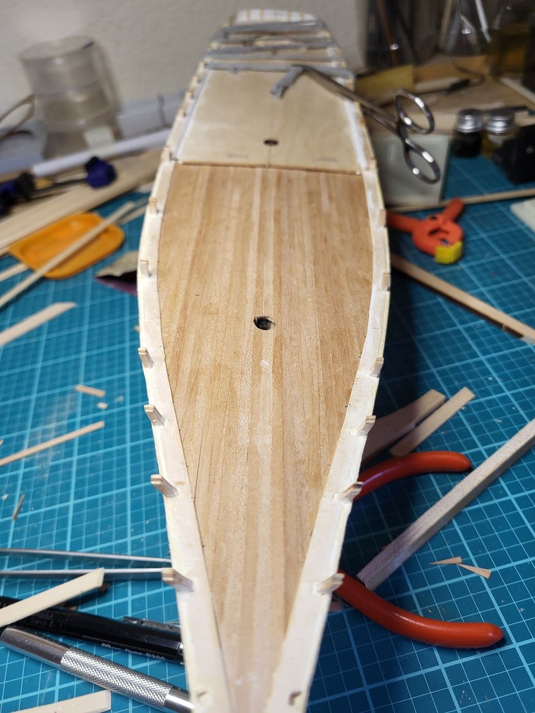

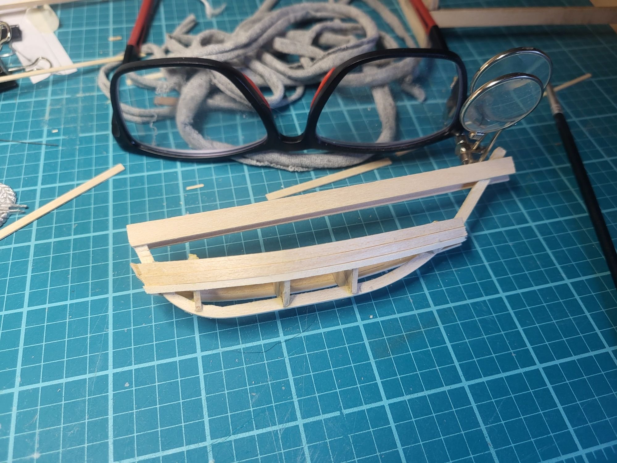

Bouncing around a little, while forming some of the top planks around the stern, I planked the fore deck.  Old t-shirt material works well for clamping, much better than rubber bands in my opinion, especially since you can easily control the tension and get a lot of coverage.  Seen in the back the material is not just holding the plank flush with its lower neighbor, but holding it to the curve.

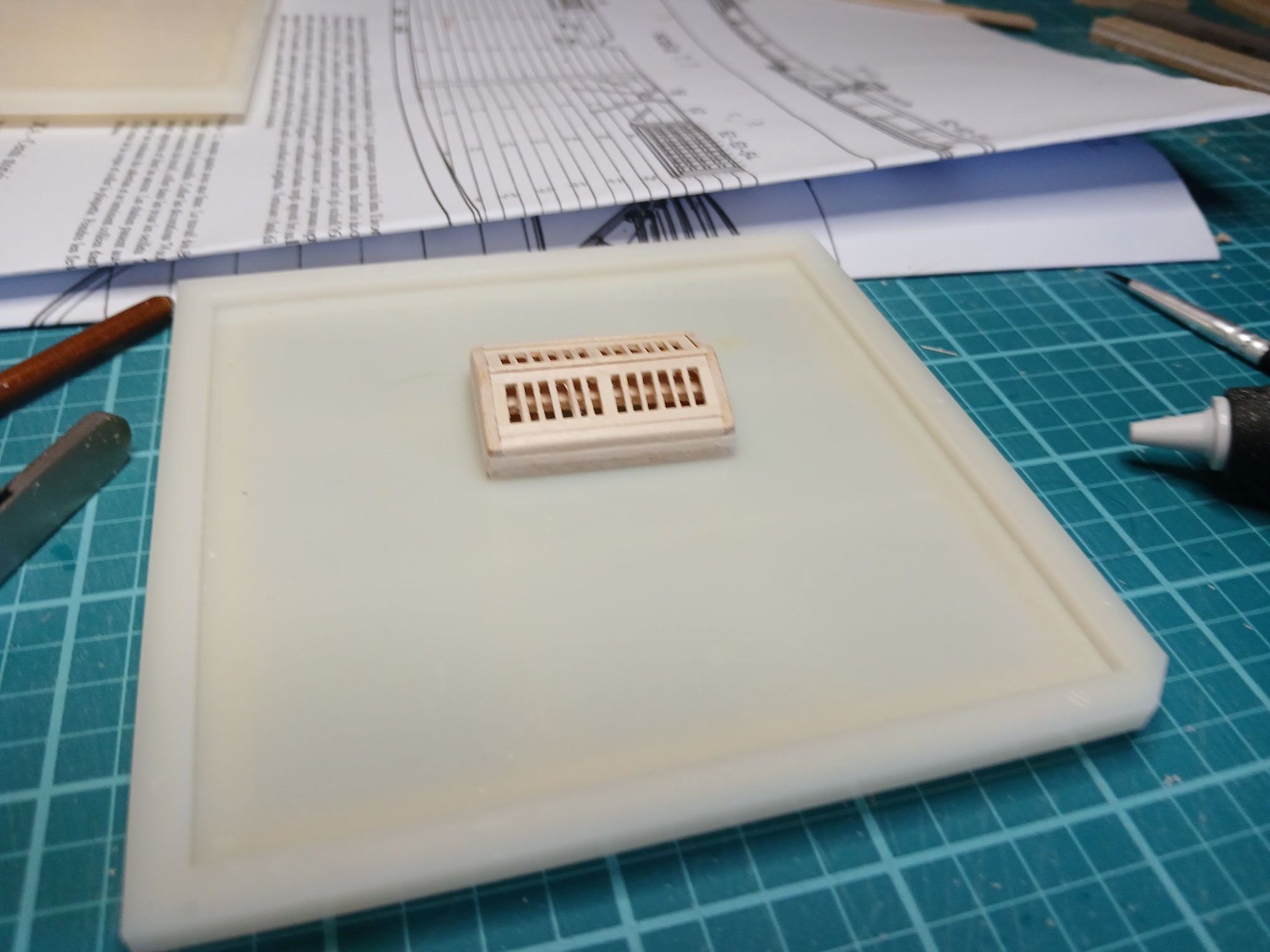

Decking is finished, it still needs fine sanding.  Meanwhile I'm redoing the fore skylight, I think it was probably stained or oiled teak.  Fitment is going to be tricky, but the sides are more uniform than the original painted one.

This is looking good..  So far I'm pleased.  I'll let everything set up and shape the window rails.

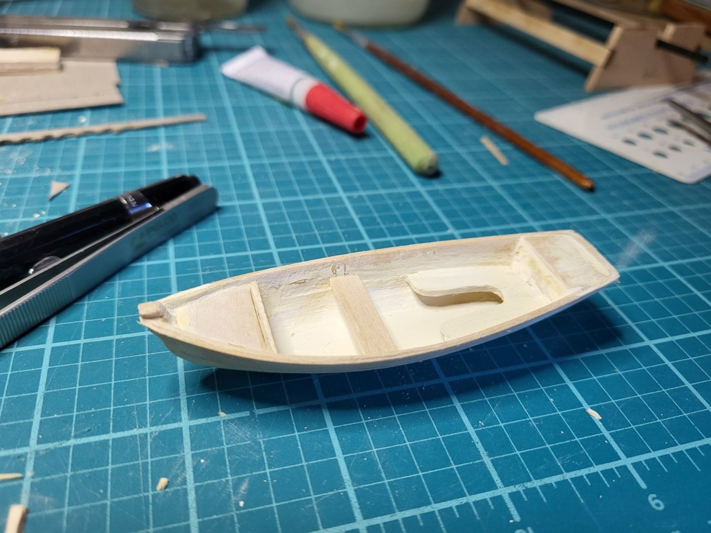

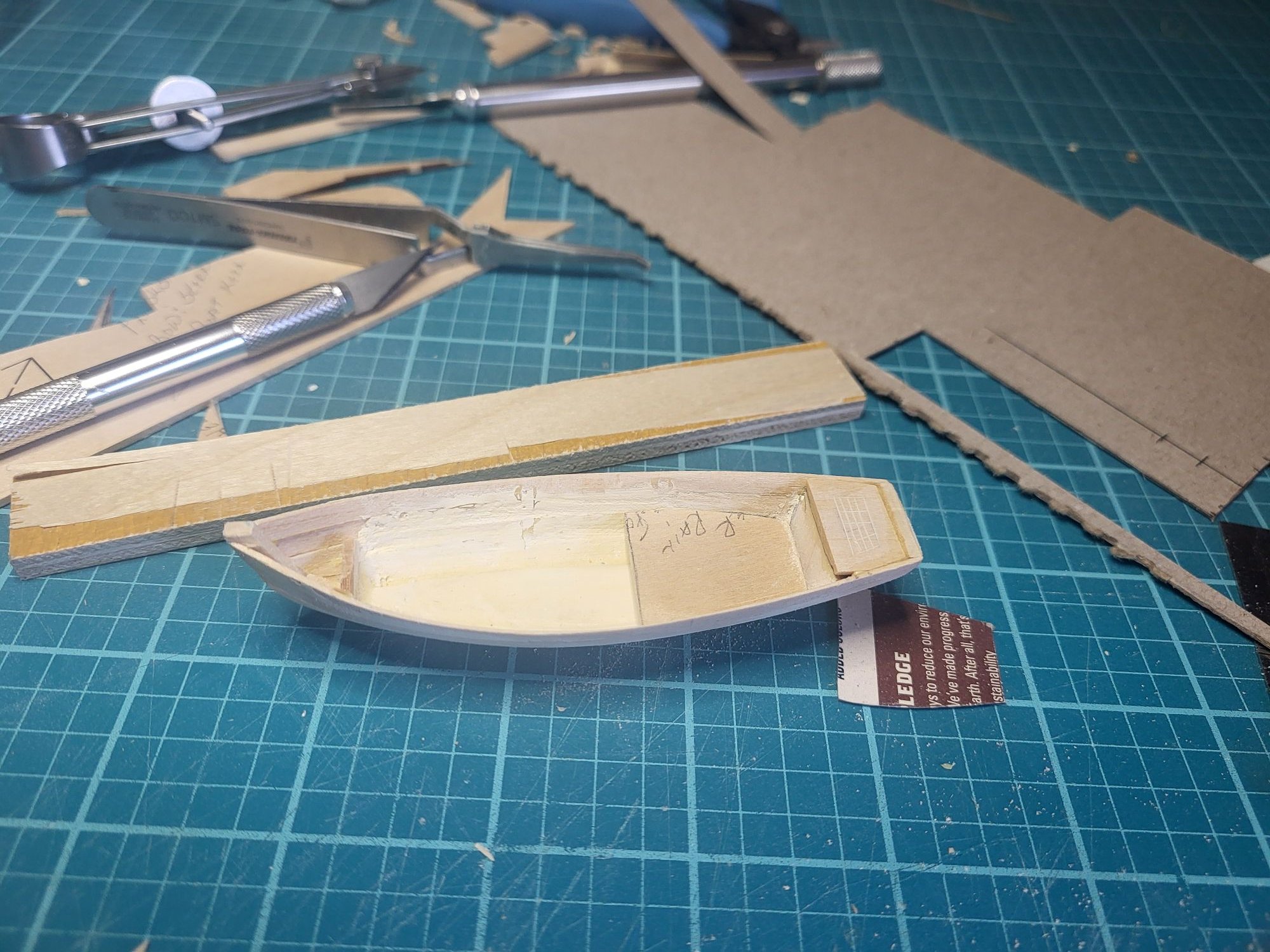

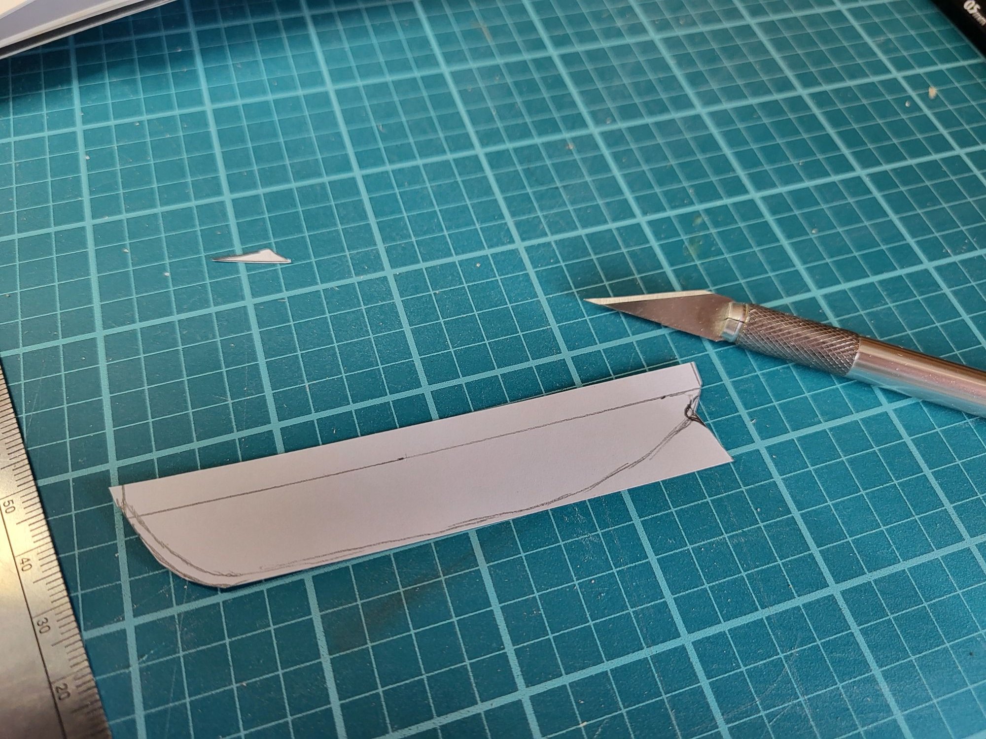

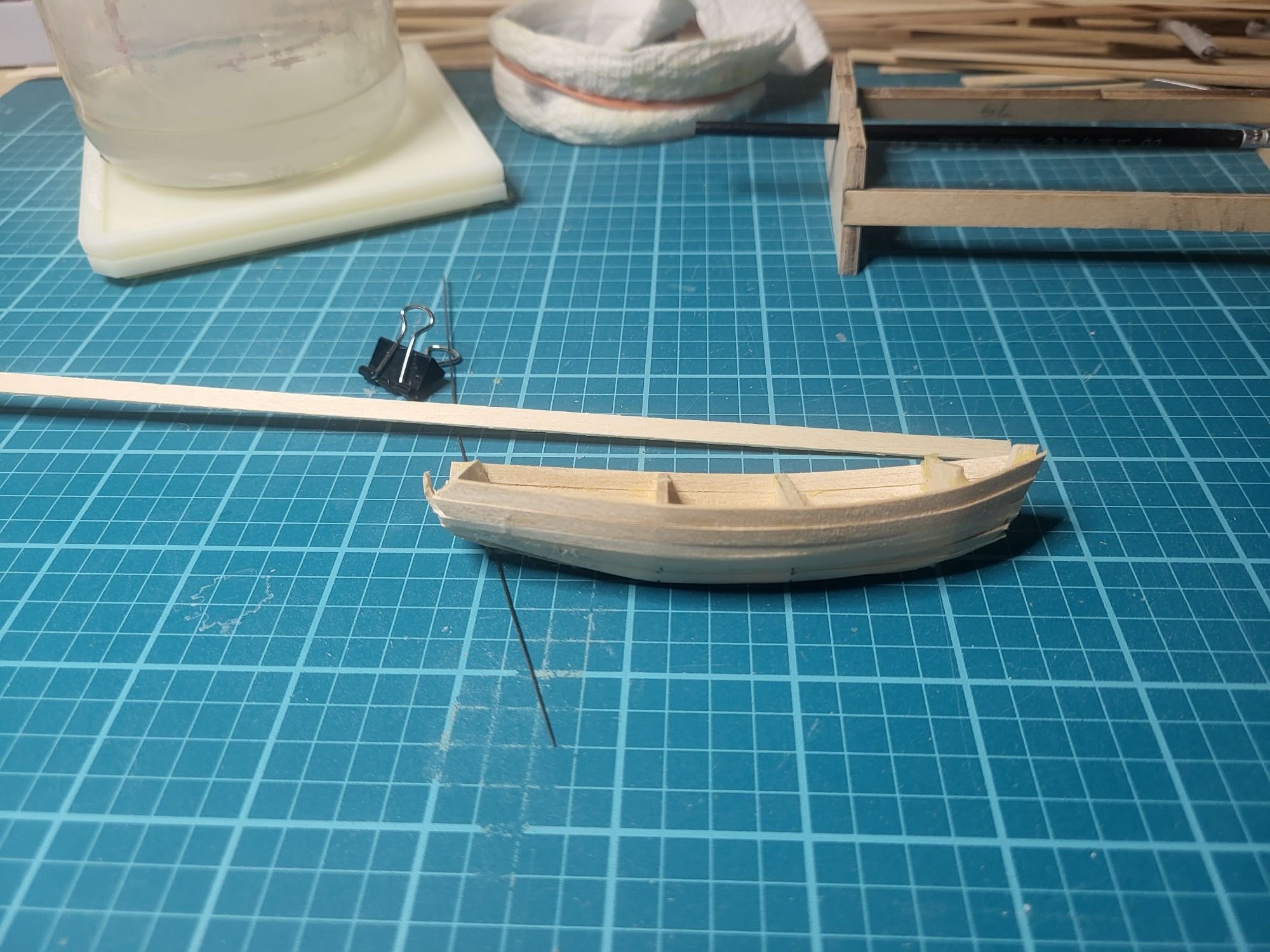

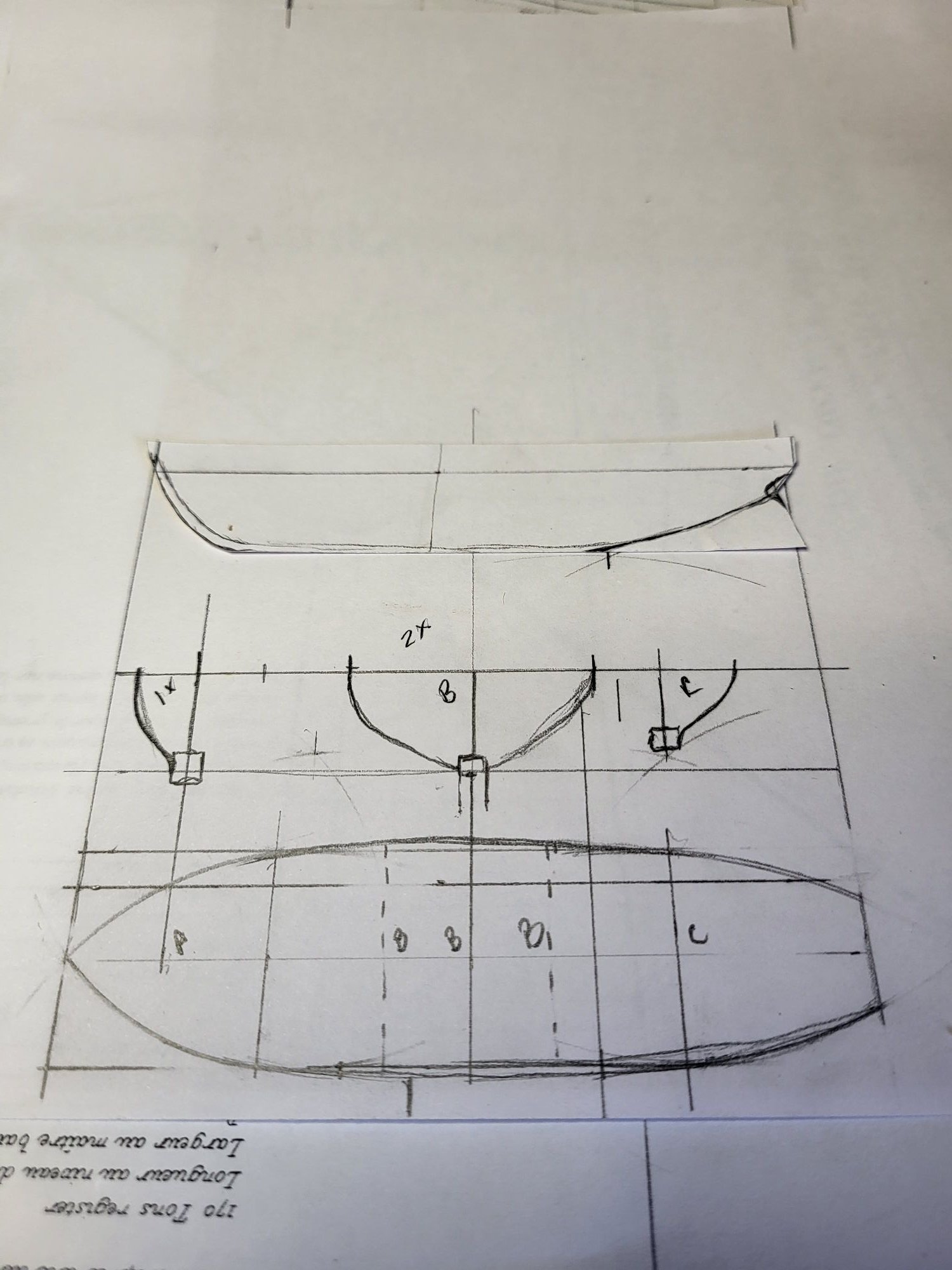

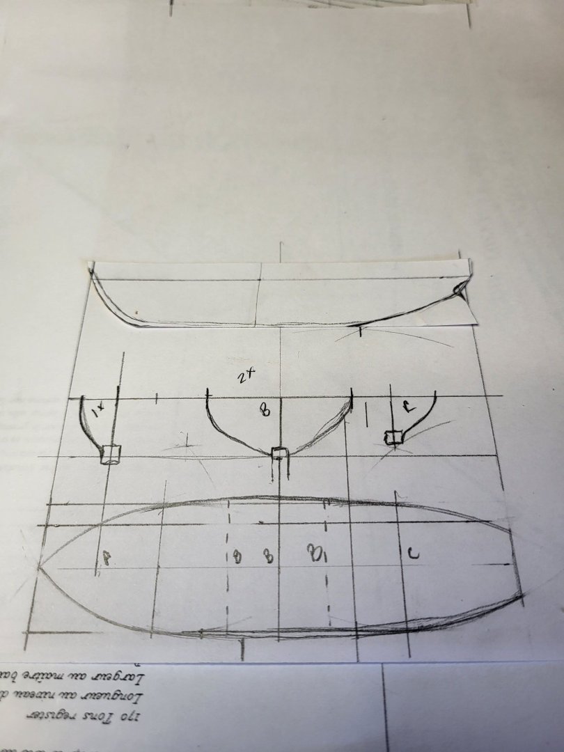

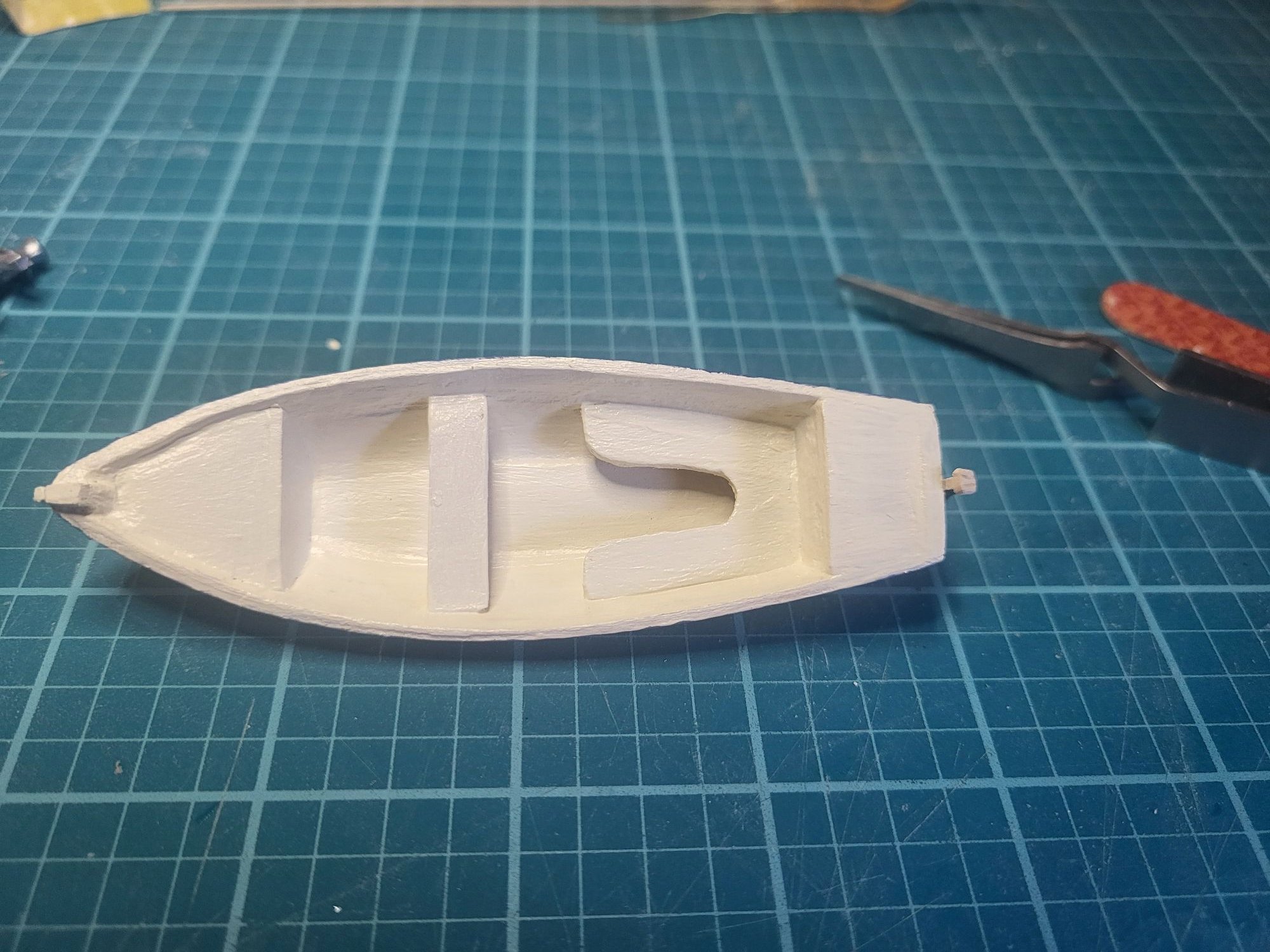

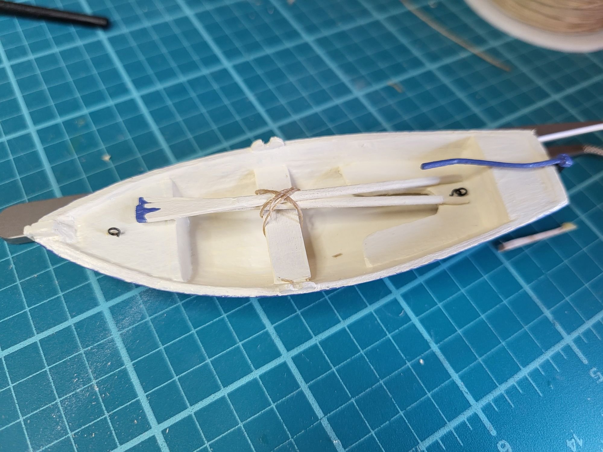

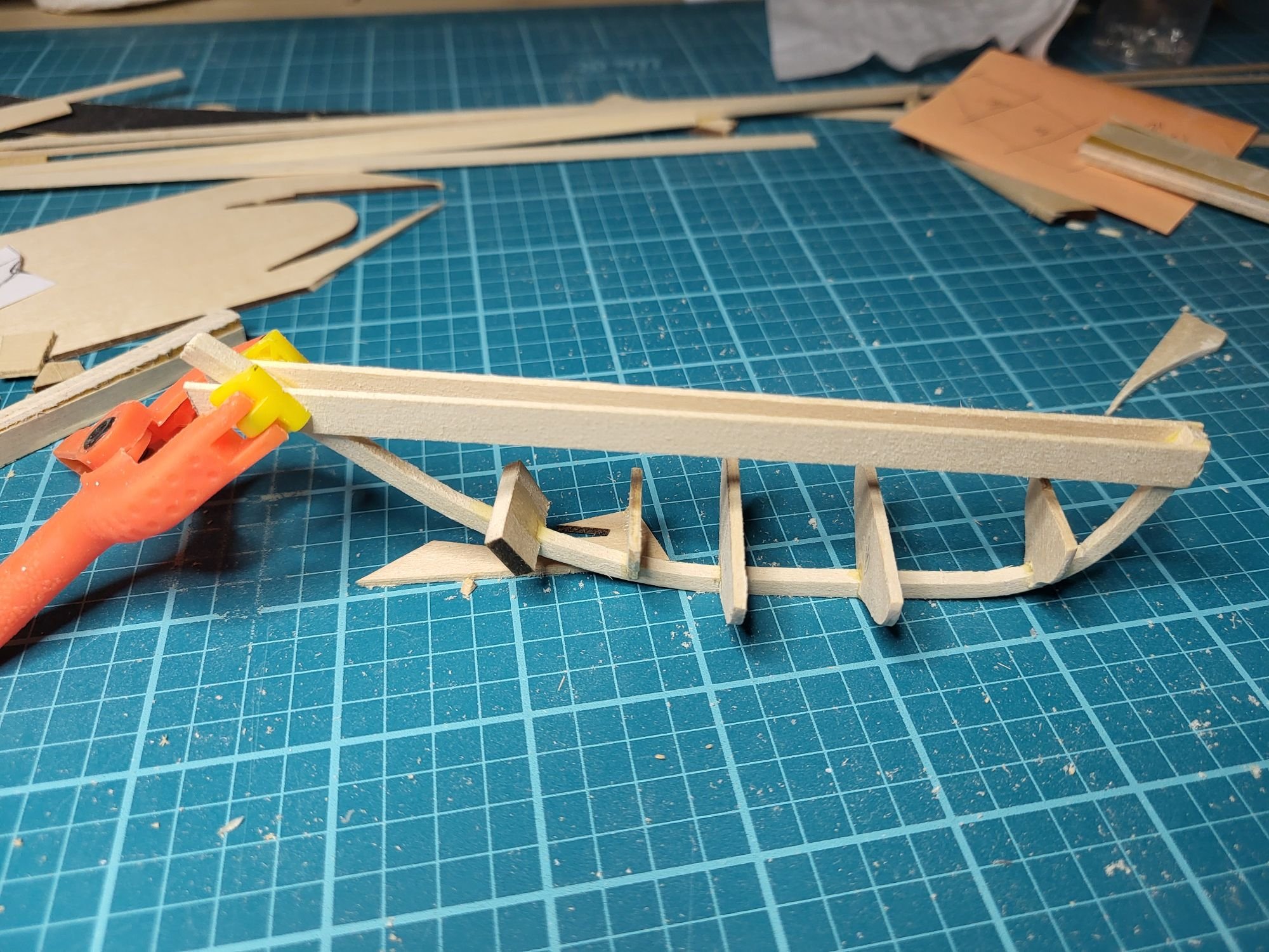

Again we're at "what America are we building" and I think I have settled on the reported state, after spending time in France.  Reports say the copper was removed, and above the waterline was a "dove grey".  To that point the yacht would have a jolly boat or some dinghy.  It's unlikely (thought period paintings show it this way) it was on deck while racing.  I'm using a similar technique as I did for the Benjamin Latham dory, this keel seems large, and it is, but a lot of it will be cut away once it's planked. I used some period paintings for the profile, then guessed at the top view.
Previously:  Bluenose (Can't remember the kit),  Pilot boat Phantom 1/96, Sultana 1/64, Armed 18th Longboat 1/24, Benjamin Latham 1/48.

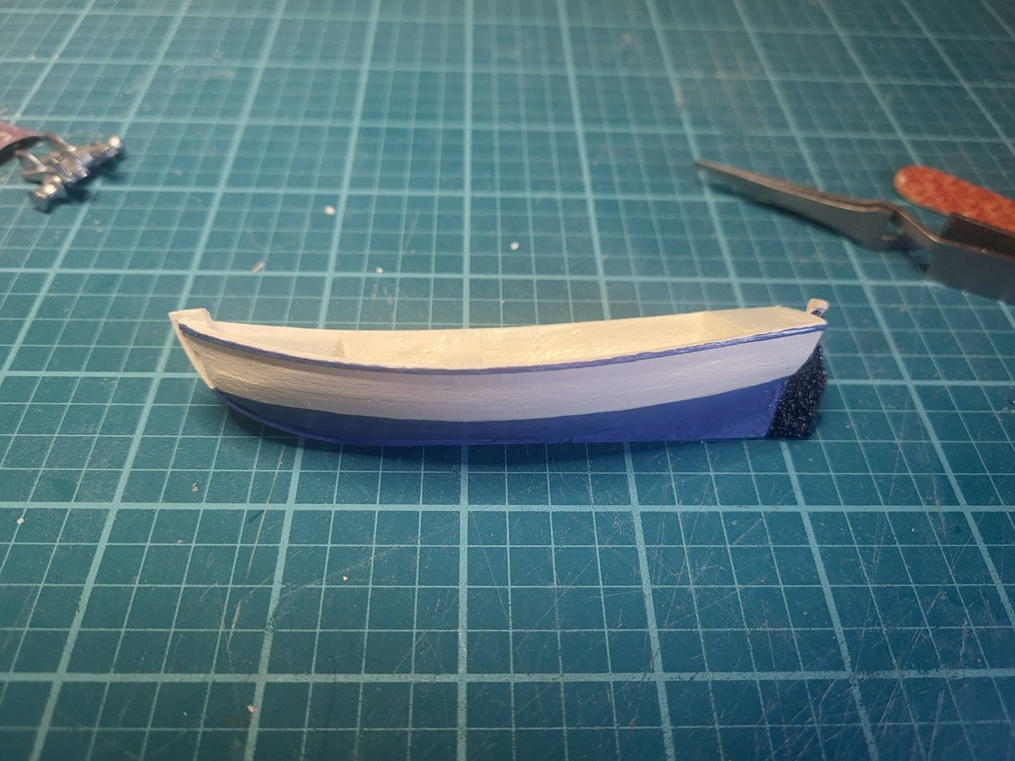

 Marvelous job on the jolly boat, it looks really good. 👍
Thanks @Keith Black

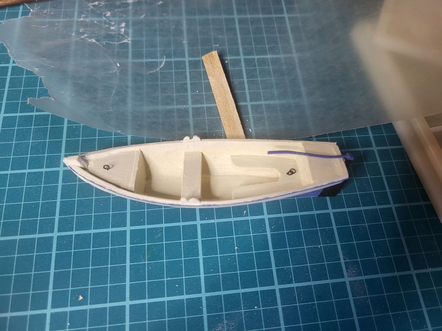

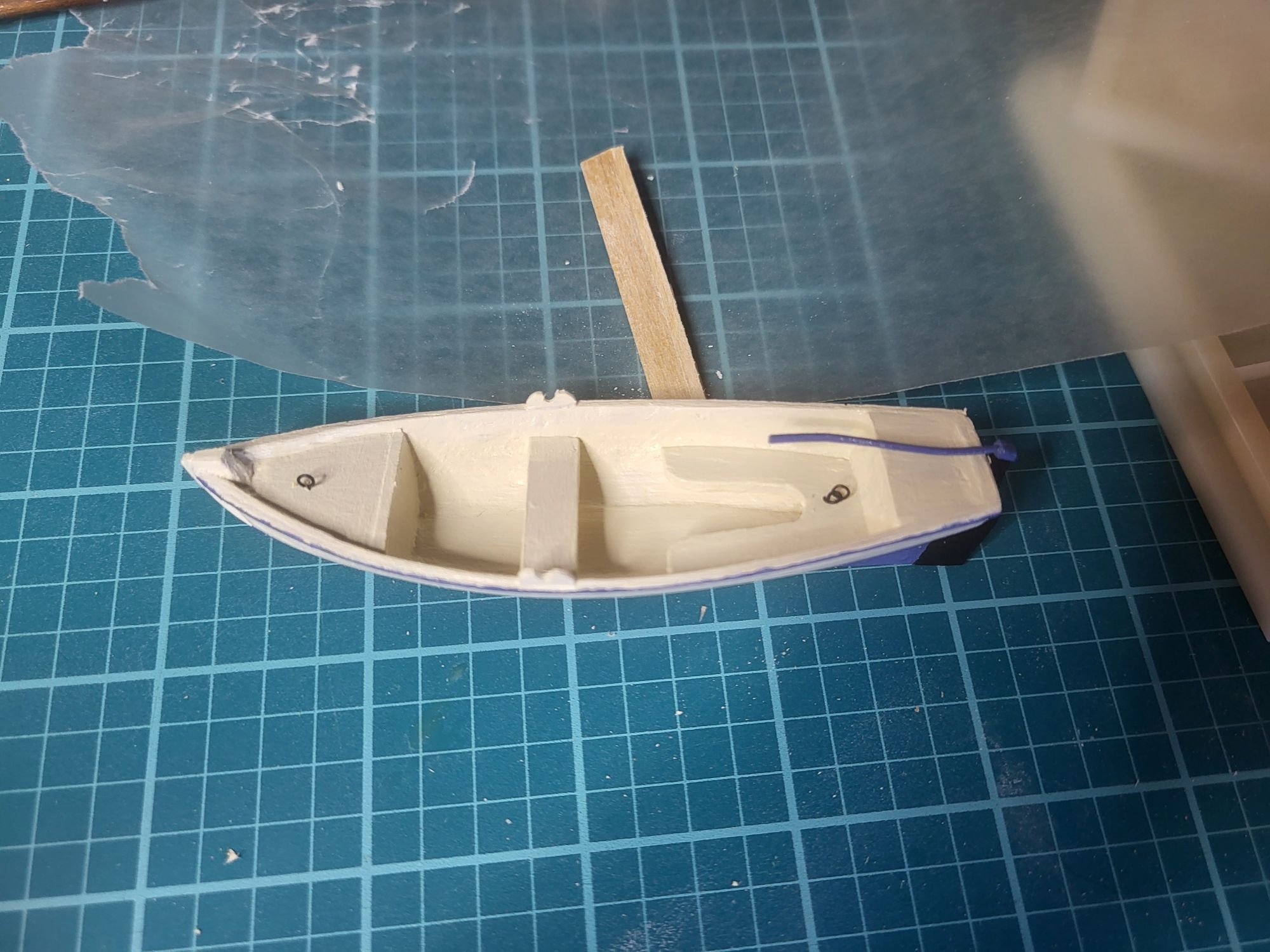

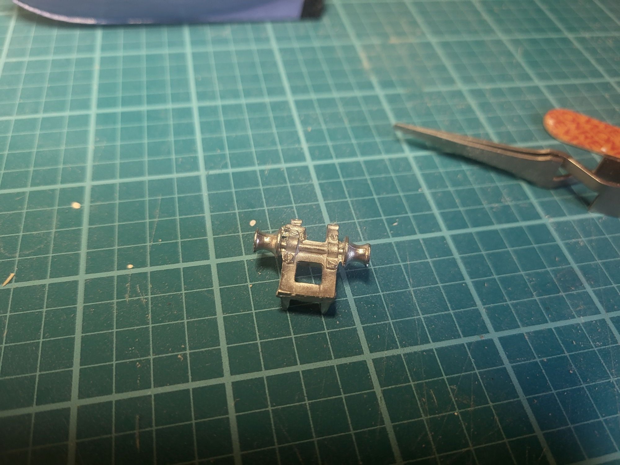

It's about done, I'm bending the handle for the rudder and then I need to add the hardware, I'm likely stowing it upright on the deck so I guess oars are in order.. While I hated making them, the oars for the Latham came out OK.
Next decision is the windlass.  Though it's not really a windlass, just dead pulleys, "power" would be from the capstan,  so maybe the cast piece is fine?
I might have over done it with the jolly boat.. But hey it happens.

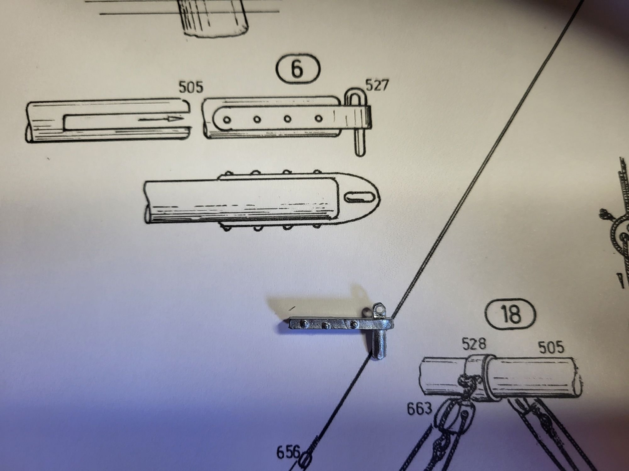

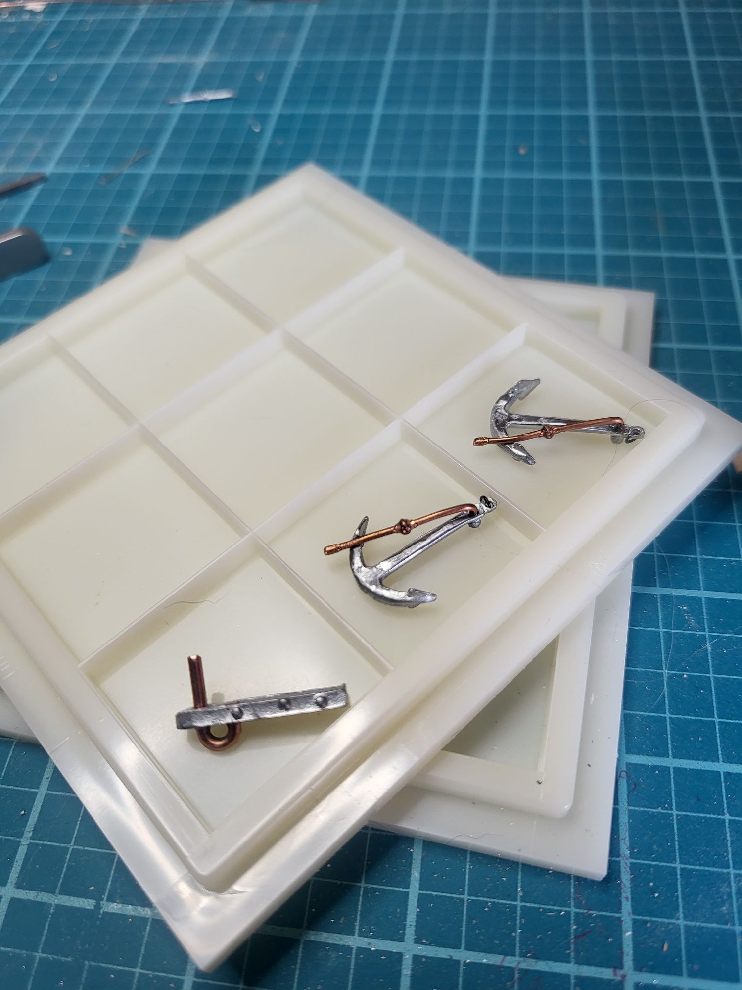

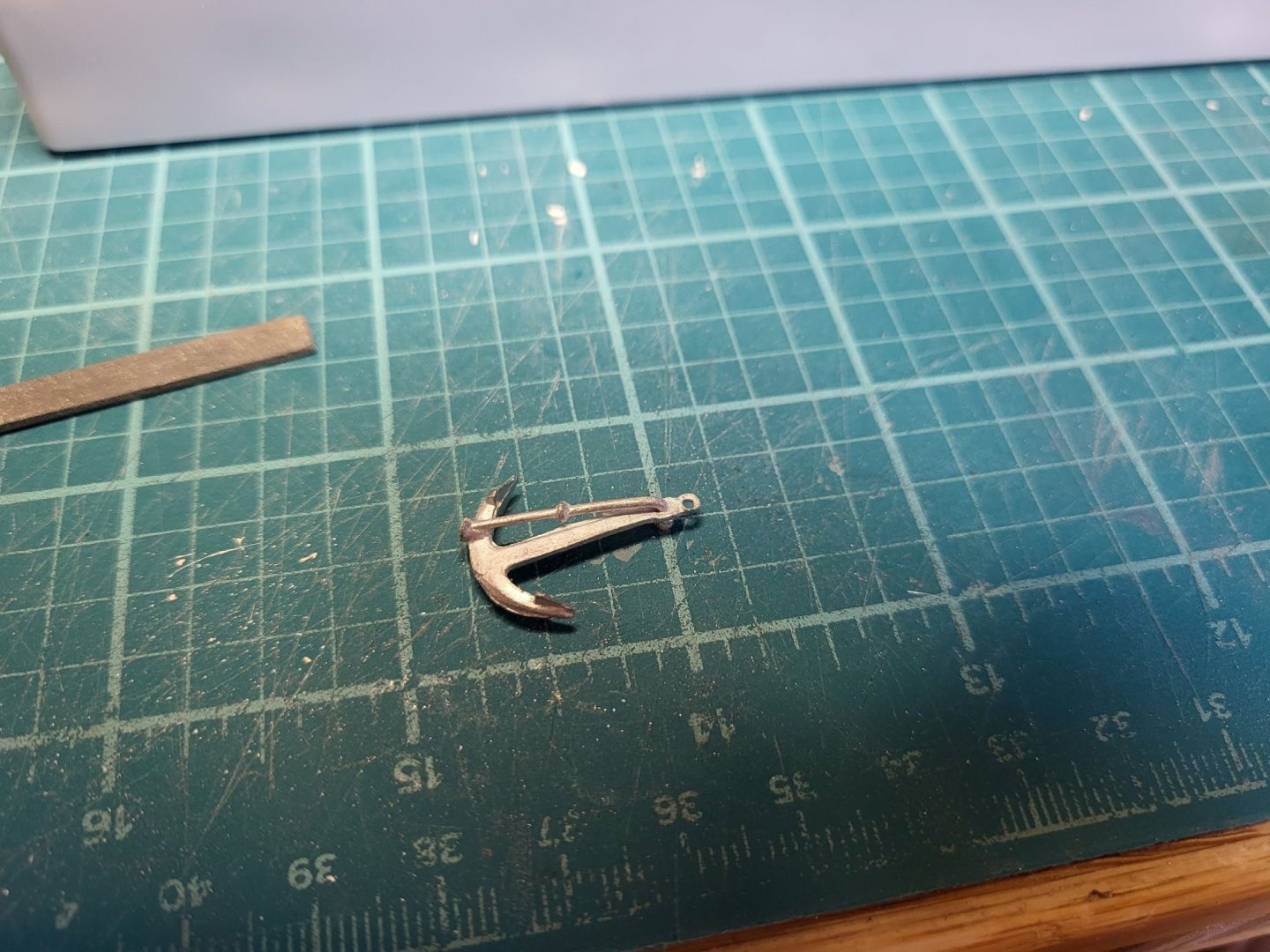

Started working on some of the cast parts, they are on both ends of the scale, some good, some lame.
These two the boom hook, and the anchors are on the lame scale, so I did a little cutting and wire work to make them look better.

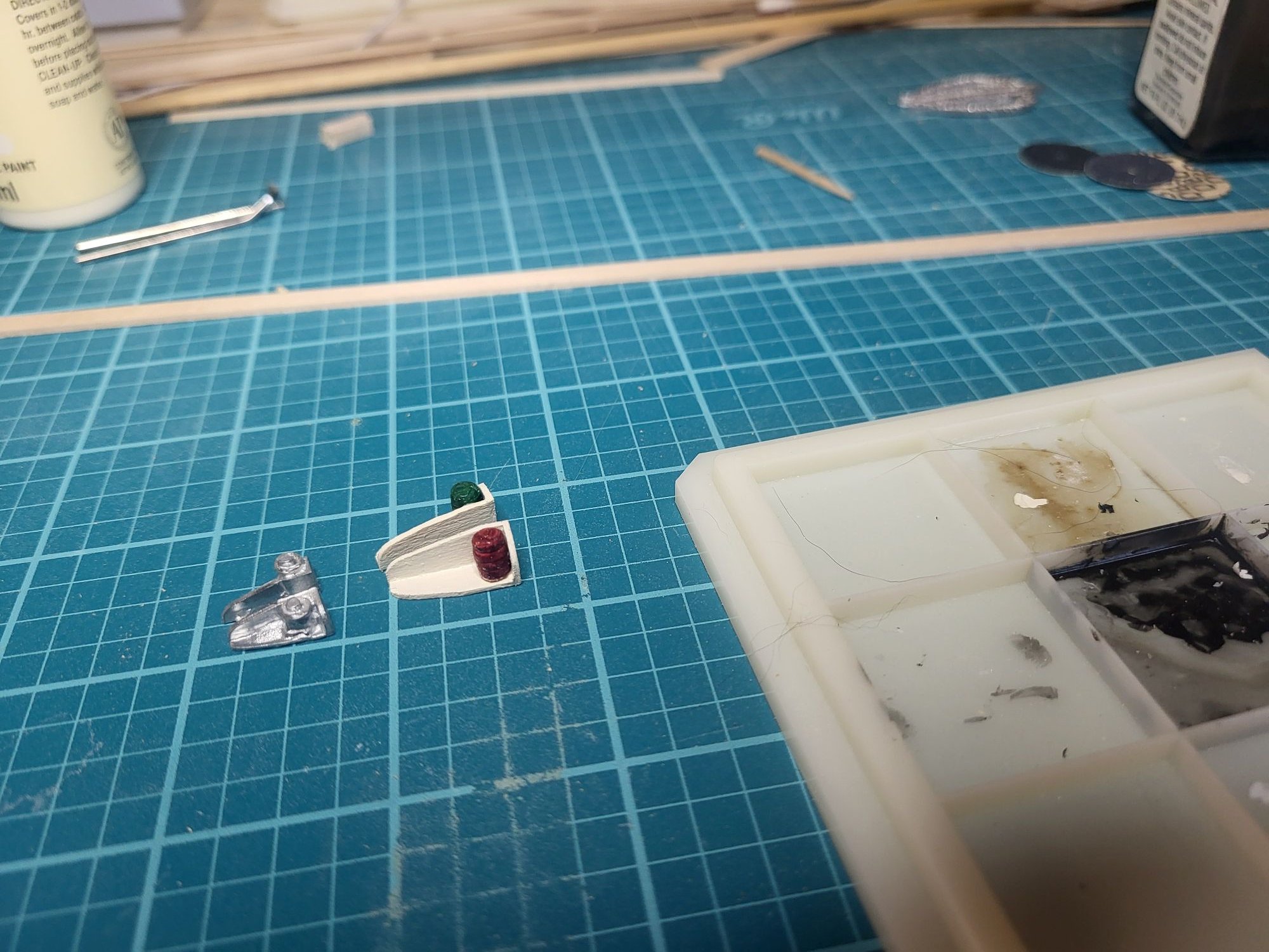

The hoops were good, they just needed some clean up, I did a base coat of "chestnut" then a few washes of thinned black.
The navigation lights were fair, but in my opinion too small.  Navigation lights were mandated in Britain in the early 1800s, so I'm going to include them.
However I completely remade them..

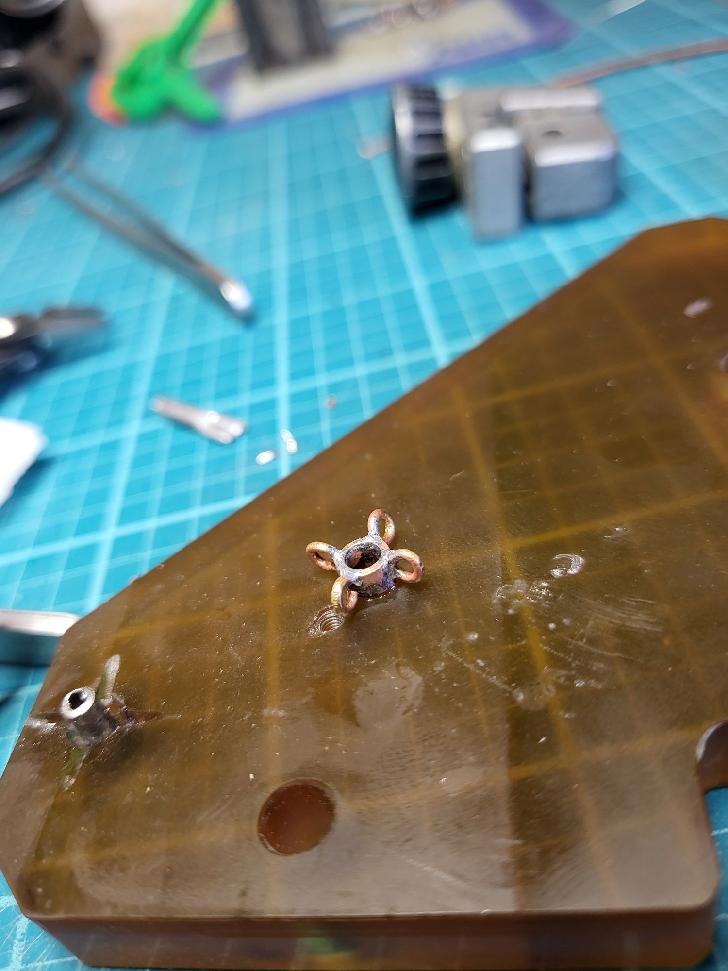

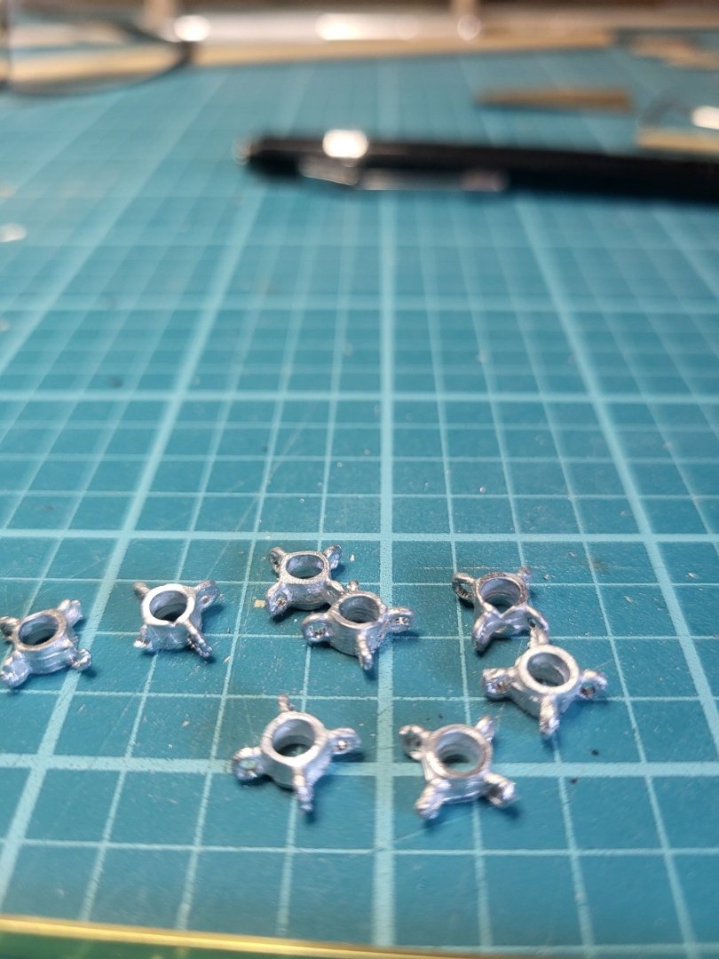

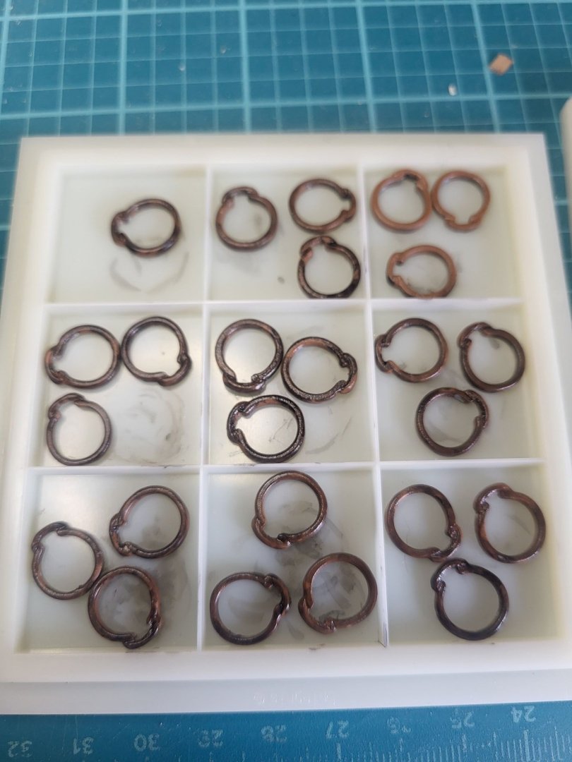

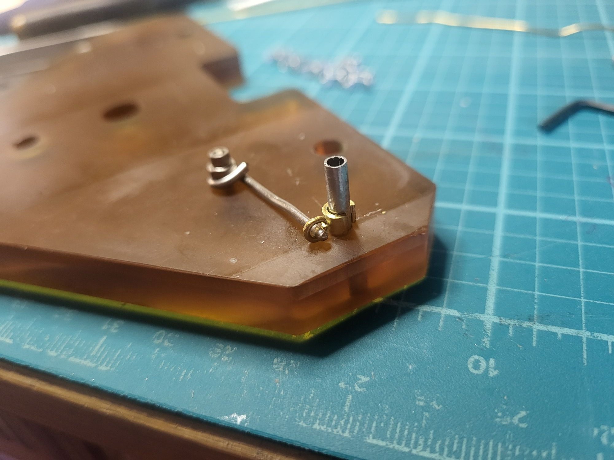

Yikes, these are problematic. On past builds I have made these from scratch, but from wire, maybe one or two from brass.  This kit has several different sizes of bore, all about the same thickness, these 7 are 3mm ID.
No way I'm getting these little ones to work, all the larger ones, 4mm and 5mm diameter I was able to clean up, and drill out the holes.  So, back to scratch; I made a fixture to hold a brass sleeve and a piece of stainless wire to hold the rigging loop.  So that's the next couple of week's work scheduled, soldering these up.  The plastic is a high temp plastic, PEEK or something, the post is aluminum, so solder should stick to anything...

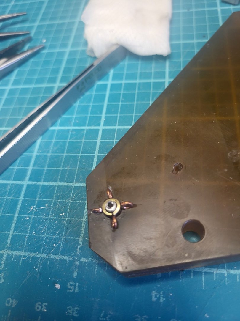

Slight change in set up..  Like a goof I forgot that the brass would het up and the previously soldered ring would fall off.
So I cut some grooves to hold the rings and sunk the collar.  They came out fine, I'll need to clean them up, before paint, but far less work than cleaning up the cast parts!
